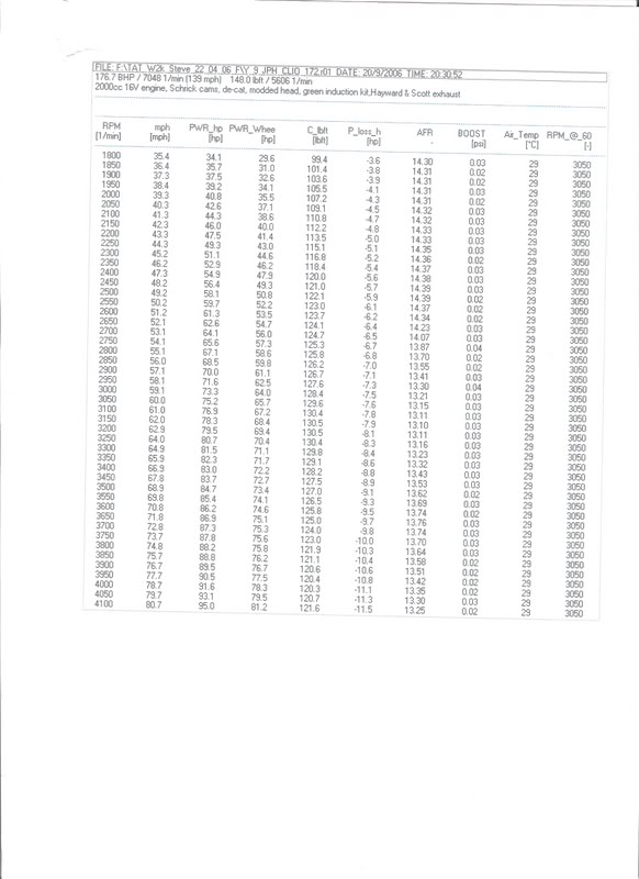

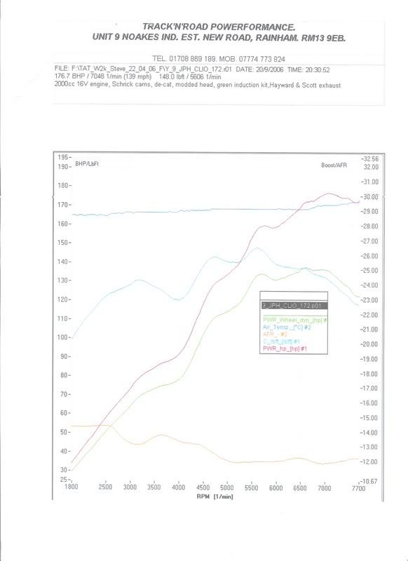

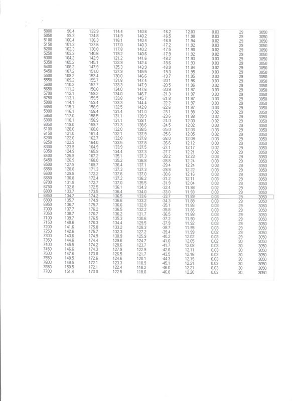

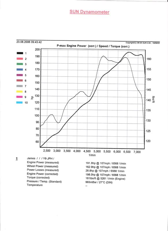

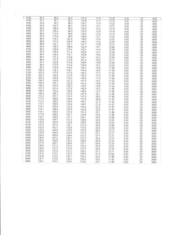

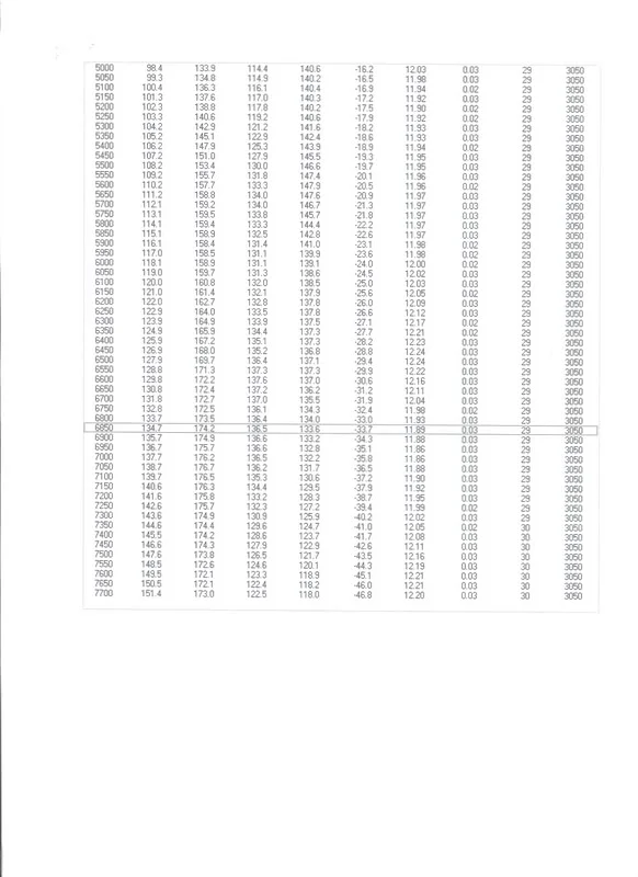

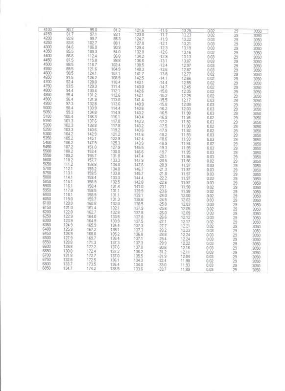

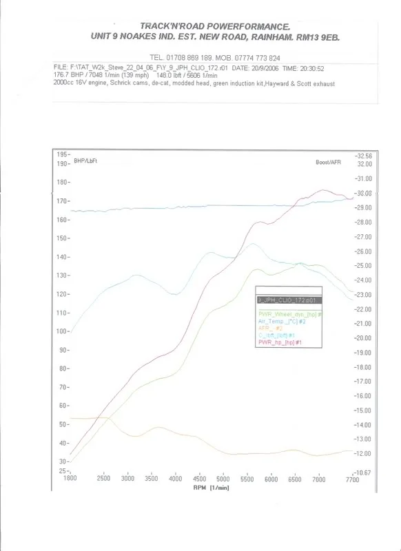

Right this is the graph i got after my cams were fitted
Now all seems ok, a tad low to what i was hoping after all the work ive had done on my car including decat&custom exhaust. then after three goes at trying to explain there was a problem i went to another set of rollers for a second opinion
this is my results
now as explained to me by the guys who ran the rollers the line that goes off to the right is cam timing.
The rest of these pages explain exactly what power the car is running at what speed/bhp/torque/etc.
IGNORE the bit about shrick cams because thats what i was told at first.
You decide what you think!
What an absolute f**king joke, take them c***s to court, poor service, Lies, threats and pretend bhp graph's? DO NOT let them get away with this
  Clio 172 ph2 + 990SM
as i understand it, torque and bhp have to cross over at 5252rpm (due to the laws of physics), and that first graph is crossing over at more than 6000rpm, which will bias the results to make them look higher!
ask pmurray about it, i hear he's a whizz at these sort of things
