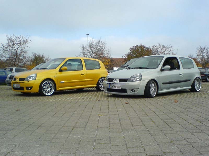

any one got a silver 172/182 with bbs lm alloys on, 17 x 7.5,17 x 8?
can u post pics if u have trying to decide on whether to shell out on them?
like theses................

the yellow one looks gorgeous!!! love that colour! thats the ones!!

Thats 8x17 rear and front to with 215/35 R 17 Dunlop SP9000. Offset 35mm i mean.

This blue one has 9x16 rear and frontside with 215/35 R 16. And the black one 8x15 with 195/45 R 15.
My one is the silver clio. I have got 7,5*16 Ofset 15 frontside with 195/40 DunlopSP 9000 and rear 9x16 Ofset 20 with 215/35

nice, does it mess up the handling at all? i no there will be differences with 17s to 16s but wil the wider wheel make the handling better/worse?
i like the silver one! looks smart!
  Clio RS
Thats an hard question and not easy to explain for me in english.
I mean optimal for trackday is an 7x16" wheel with an 215/40 R 16 tire. Or a 215/50 R 15 on a 15" rim. The area of threshold is much wider as an 215/35 R17 tire on an 17 " wheel.
The 215/40 tire give you an earlier feedback when your car is reaching the his sticking point.
If the 215/35 squeal it is nearly for your car to break out.
But i think the 215/35 looks much better. I mean Sirius, the owner of the yelow one, means too. In Germany we have not often possibility to drive on track because its much expensive and wide to drive. For us from Nürnberg to Nürburgring there are round about 600km one way. But this year i will drive on Nürburgring.
In normal road trafic i cant note an worsening of Handling. But for track its harder to drive.
So i hope you understand my baaaad english :eek:

Here are some better pics from my car with the 17x8's ASA Ypsilon (licence by BBS), they drive good and steering is even nearly as good as the former Renault Alloys.
