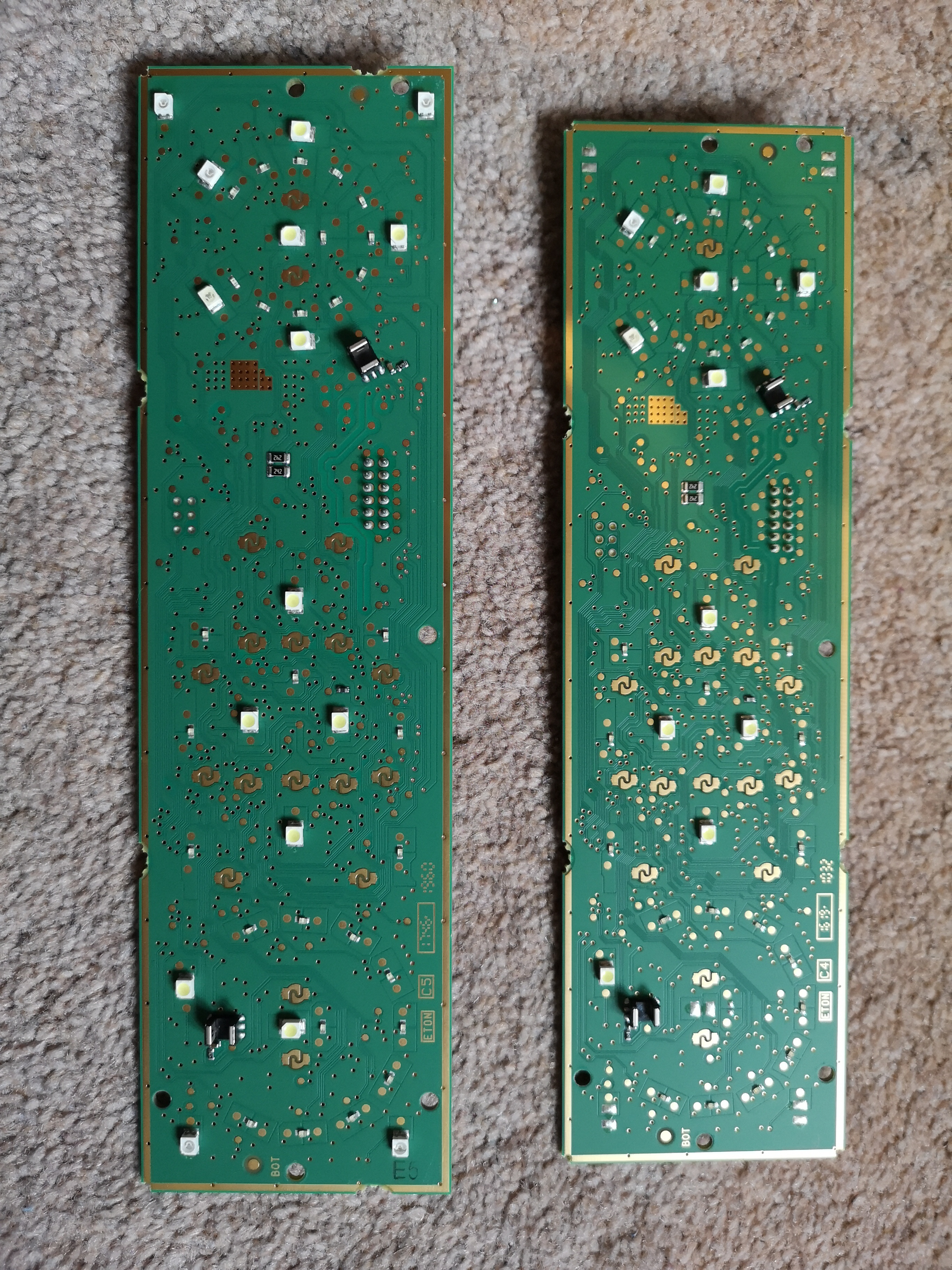

now change the leds on it :)
Had a look, looks way too fiddly for me. Think the last time I used a soldering iron was gcse tech.
Don't mind the blue tbh. @Adey. Will give it a go I'm sure

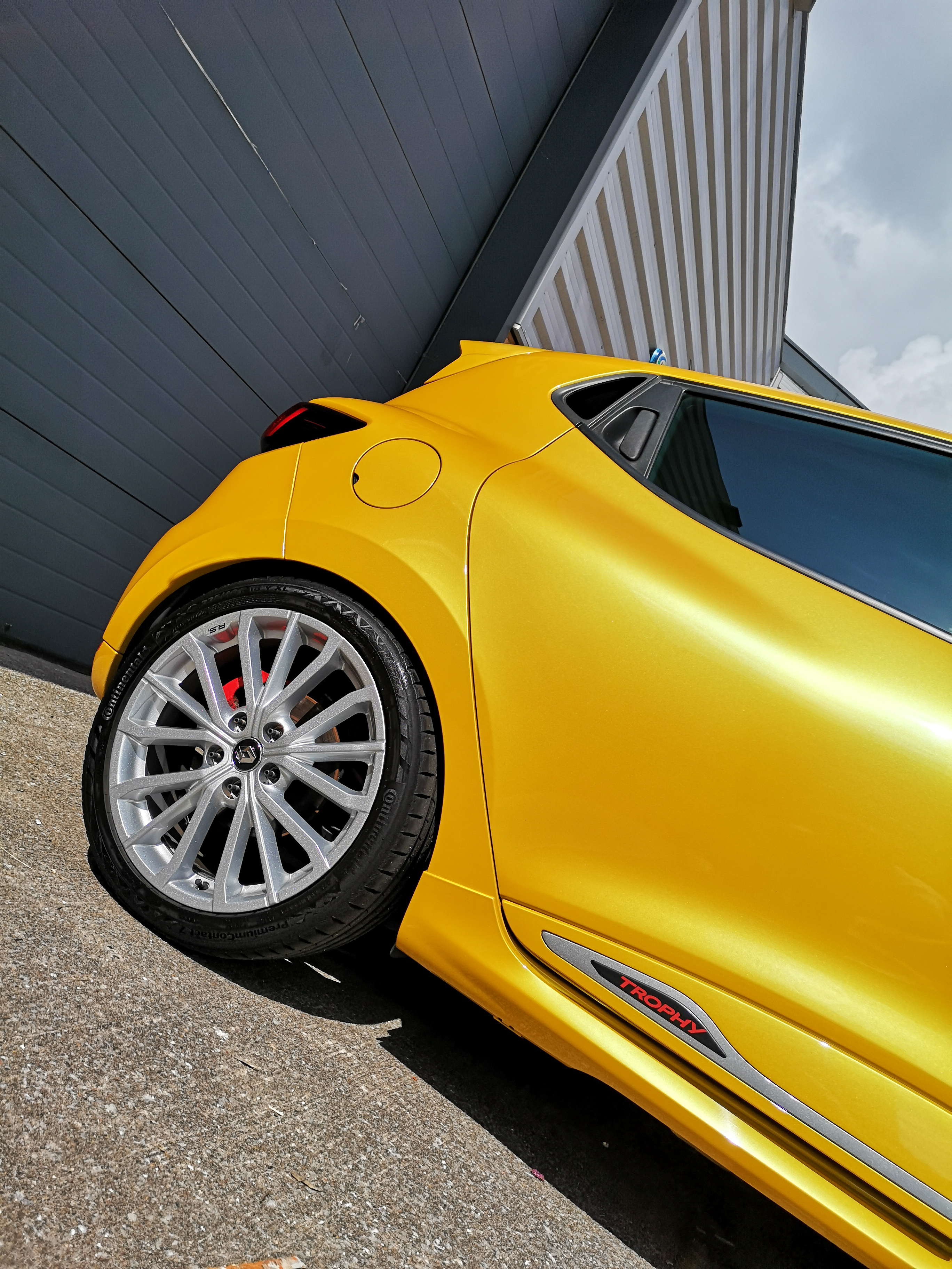

It's stupid in a way, but I think bits like the Brembos make the car way more desirable. It makes it look and feel more special. If these had come with more bits like that from the factory, they would have had more appeal IMO.
That said, as they get older, I do like them more.

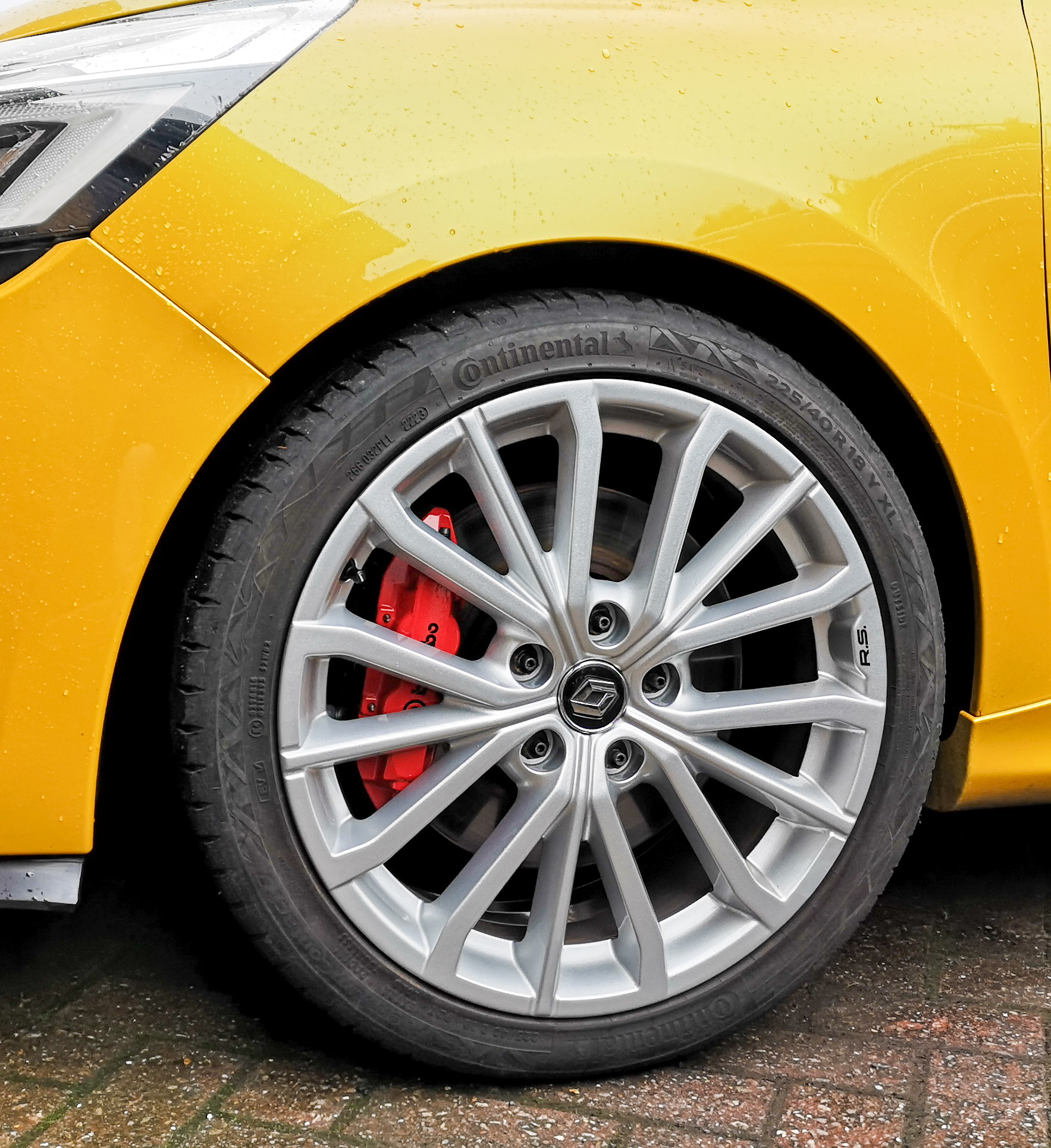

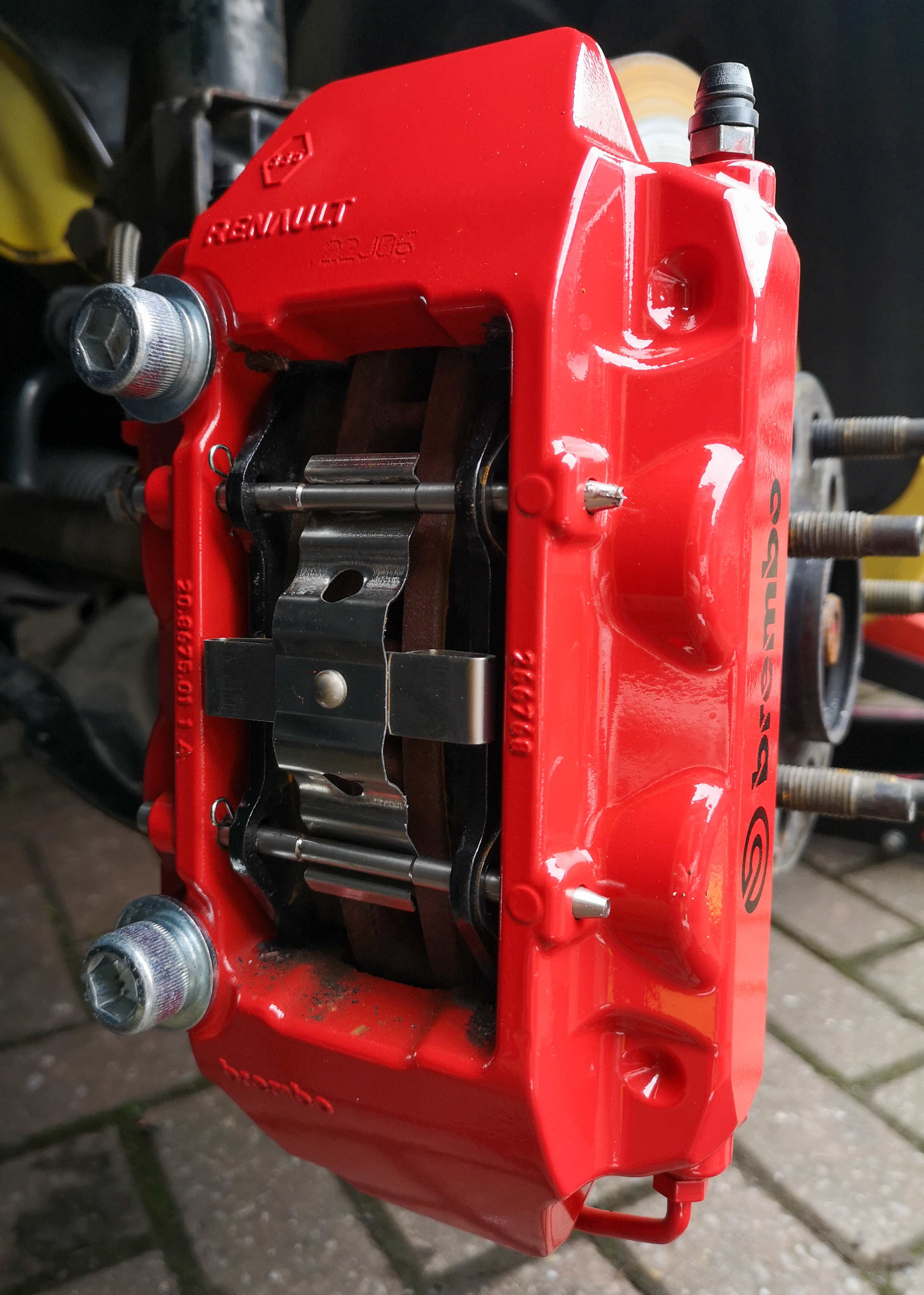

@Danith i know the cars up for sale so may not been given too many miles, but could you give an honest review of swapping to the brembos?

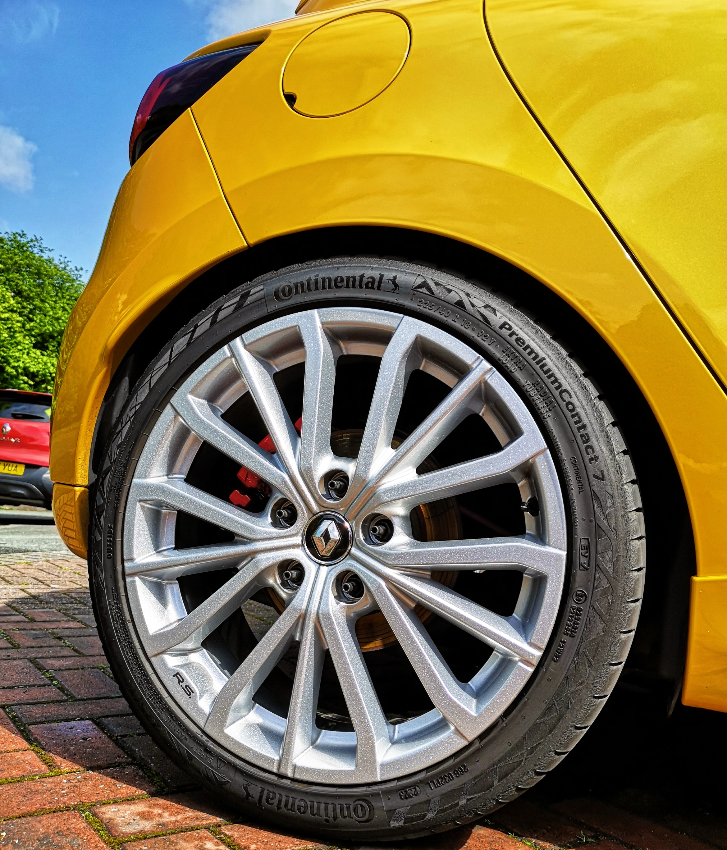

Honestly, yeah out of 4 cars now I've done a brembo swap in only 2 have been worth it, the skoda and this one. Just feel more sharp, not a huge improvement, but then they look miles better, are lighter (not that it matters on a car with a heavy front end 😂) and loads more choice of pads.
Worth doing if can get the calipers for cheap

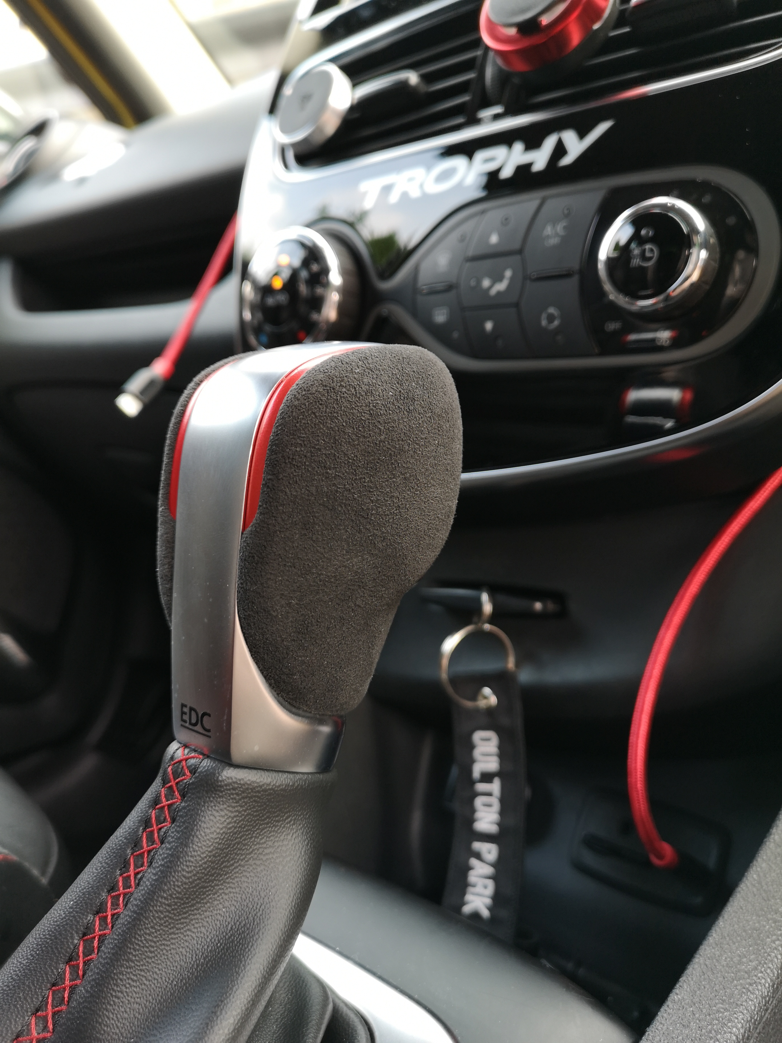

Almost forgot I'd dropped off a steering wheel and the gearknob cover off with @snappy back in Feb.
Got the message off him a few weeks ago it was done and he sent it out to me.

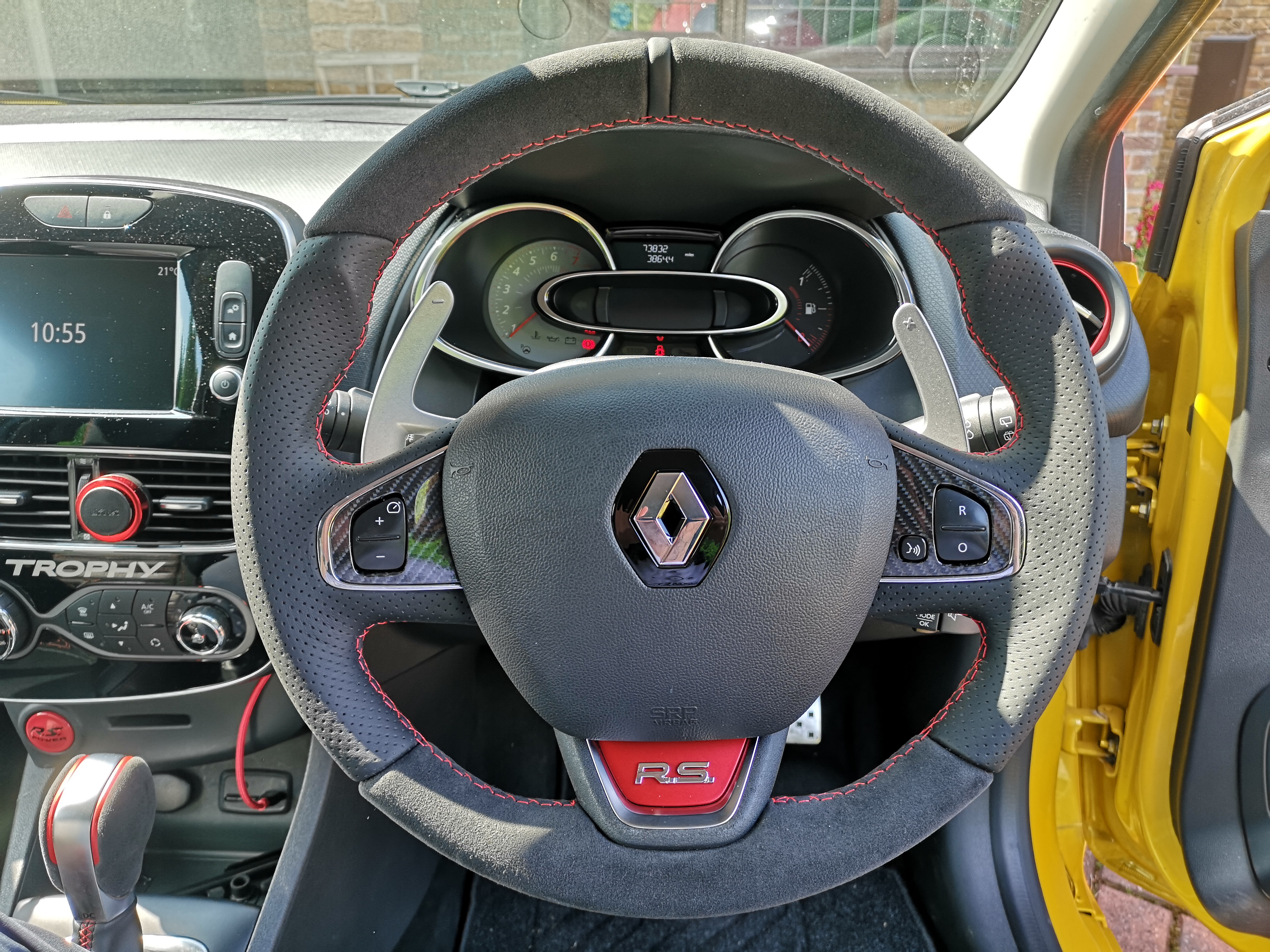

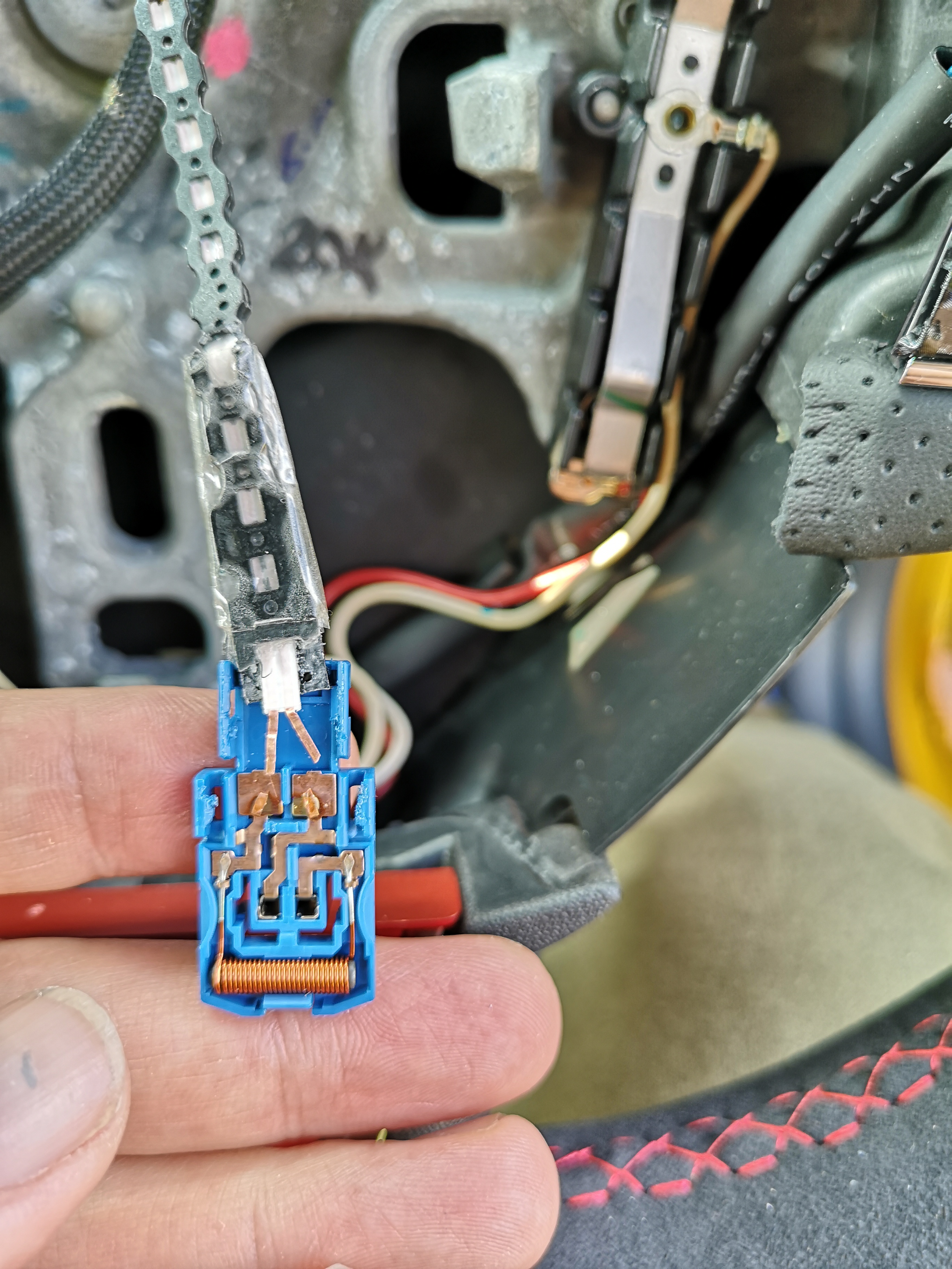

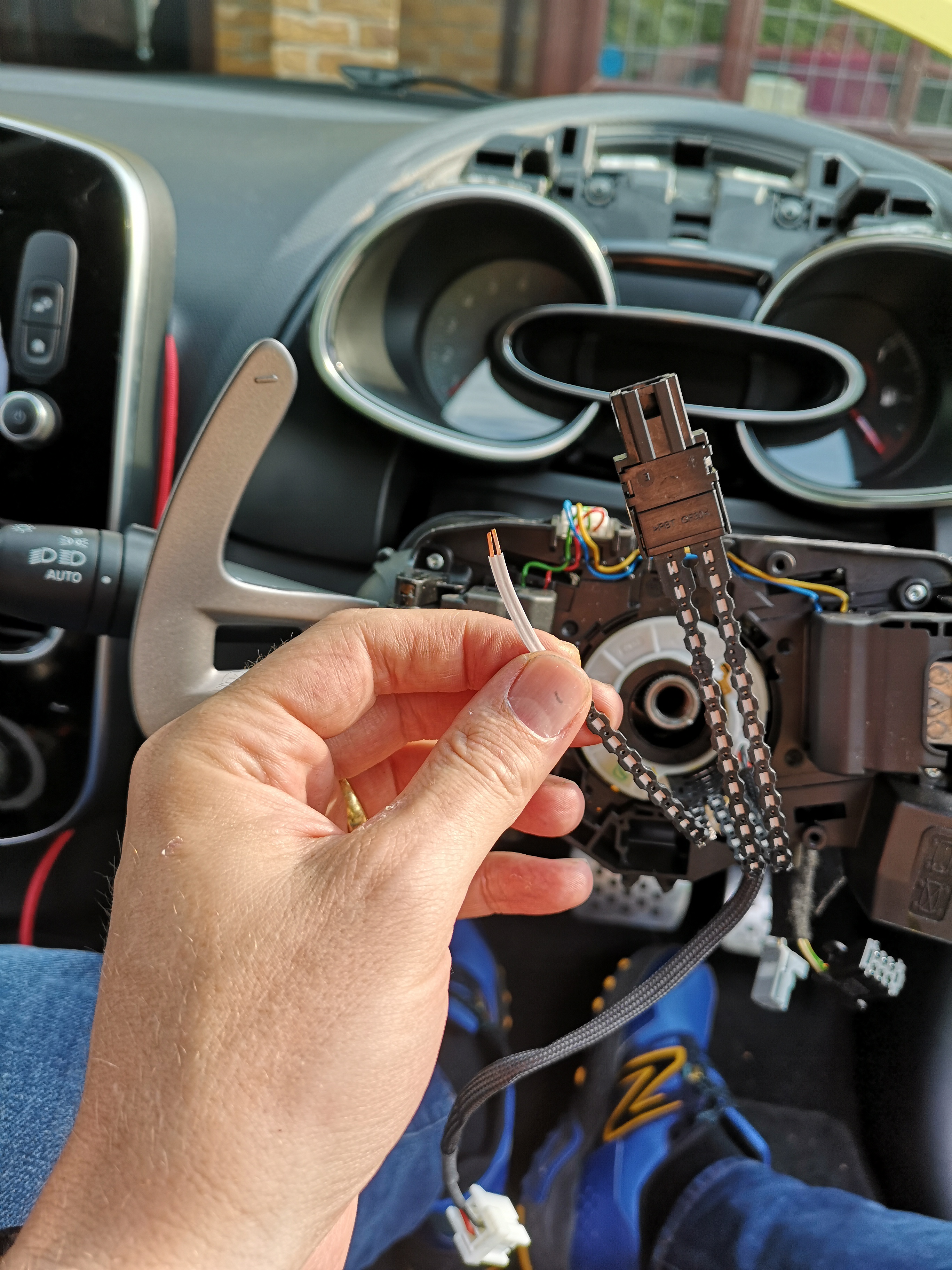

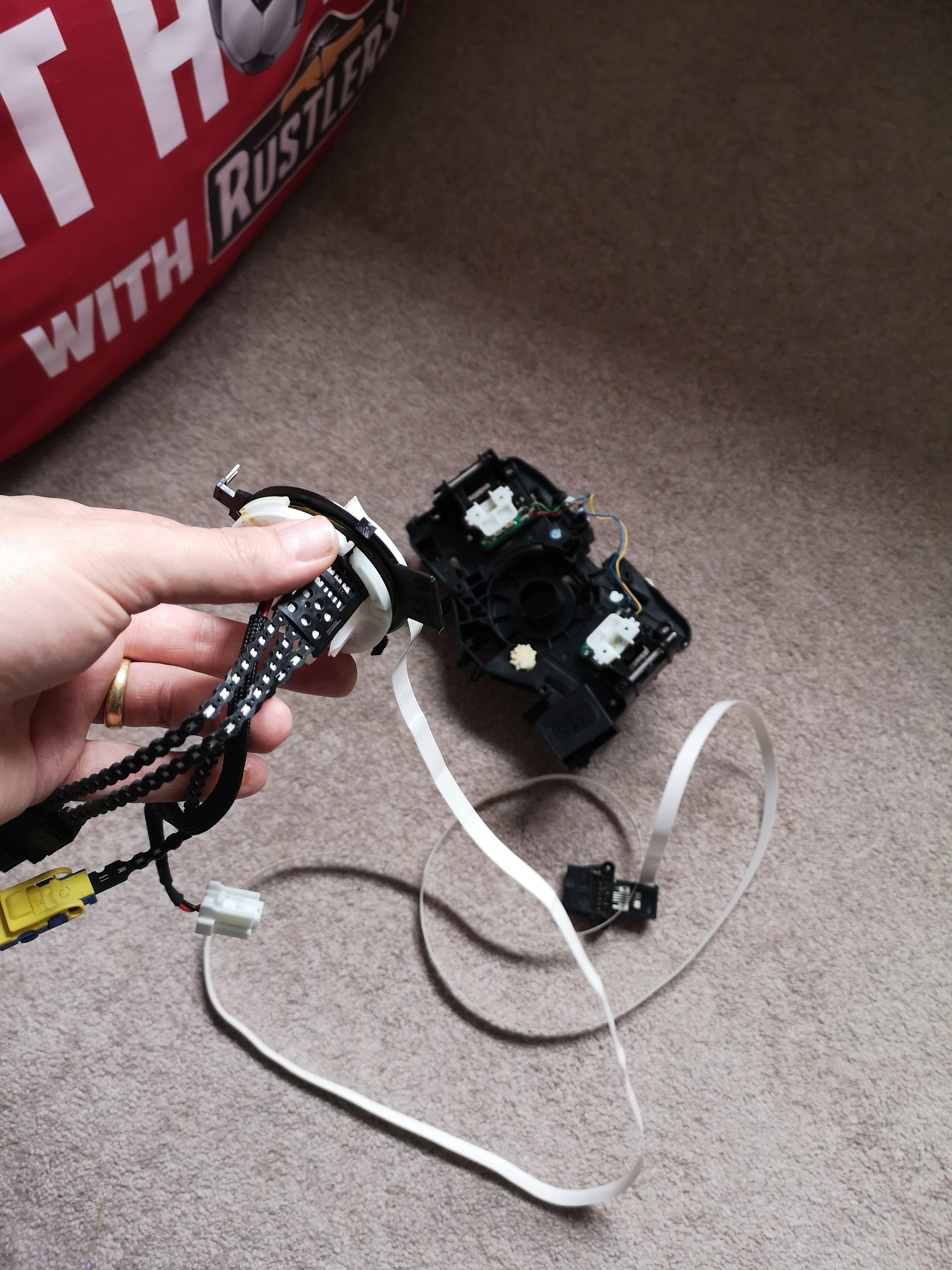

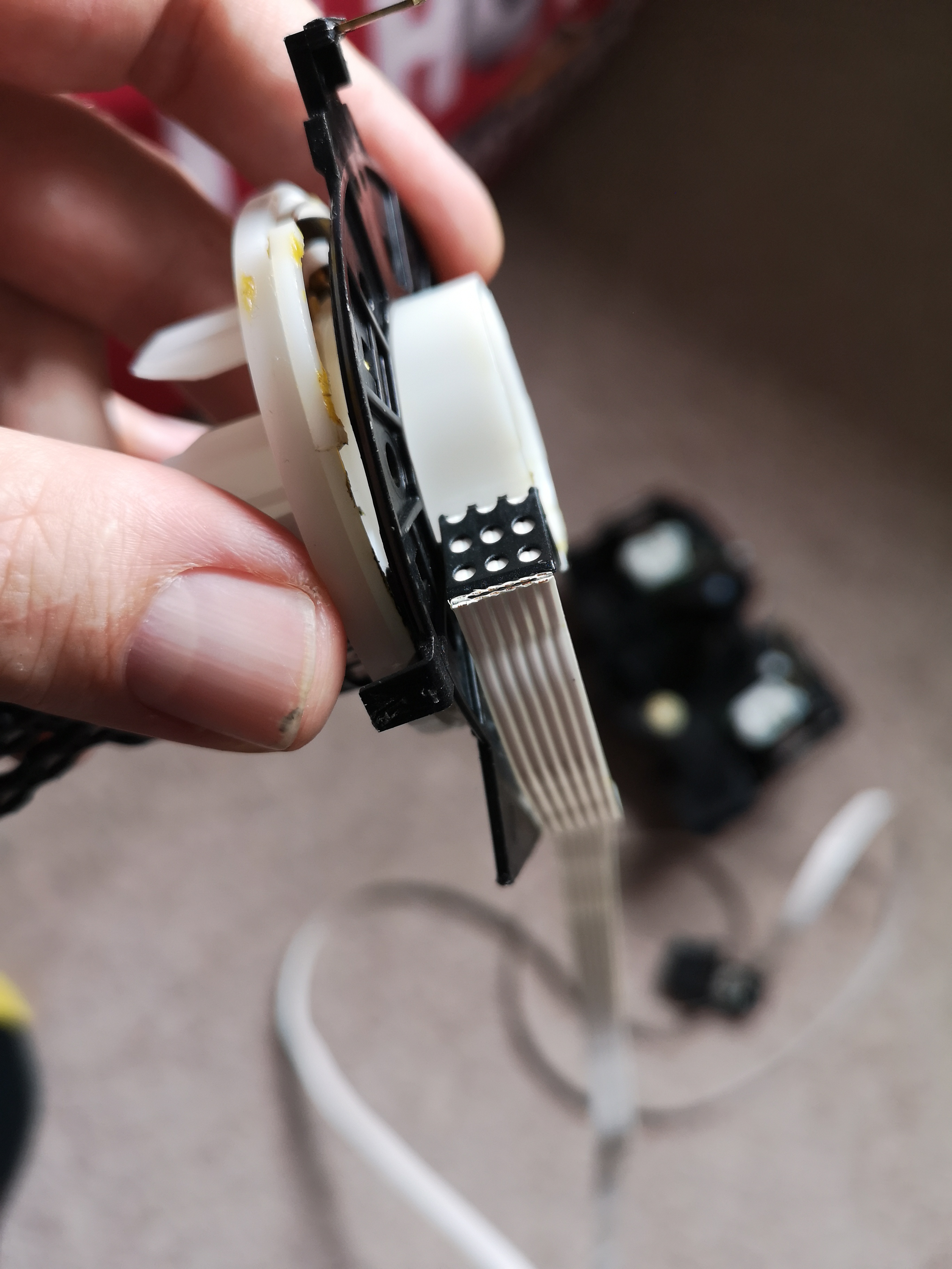

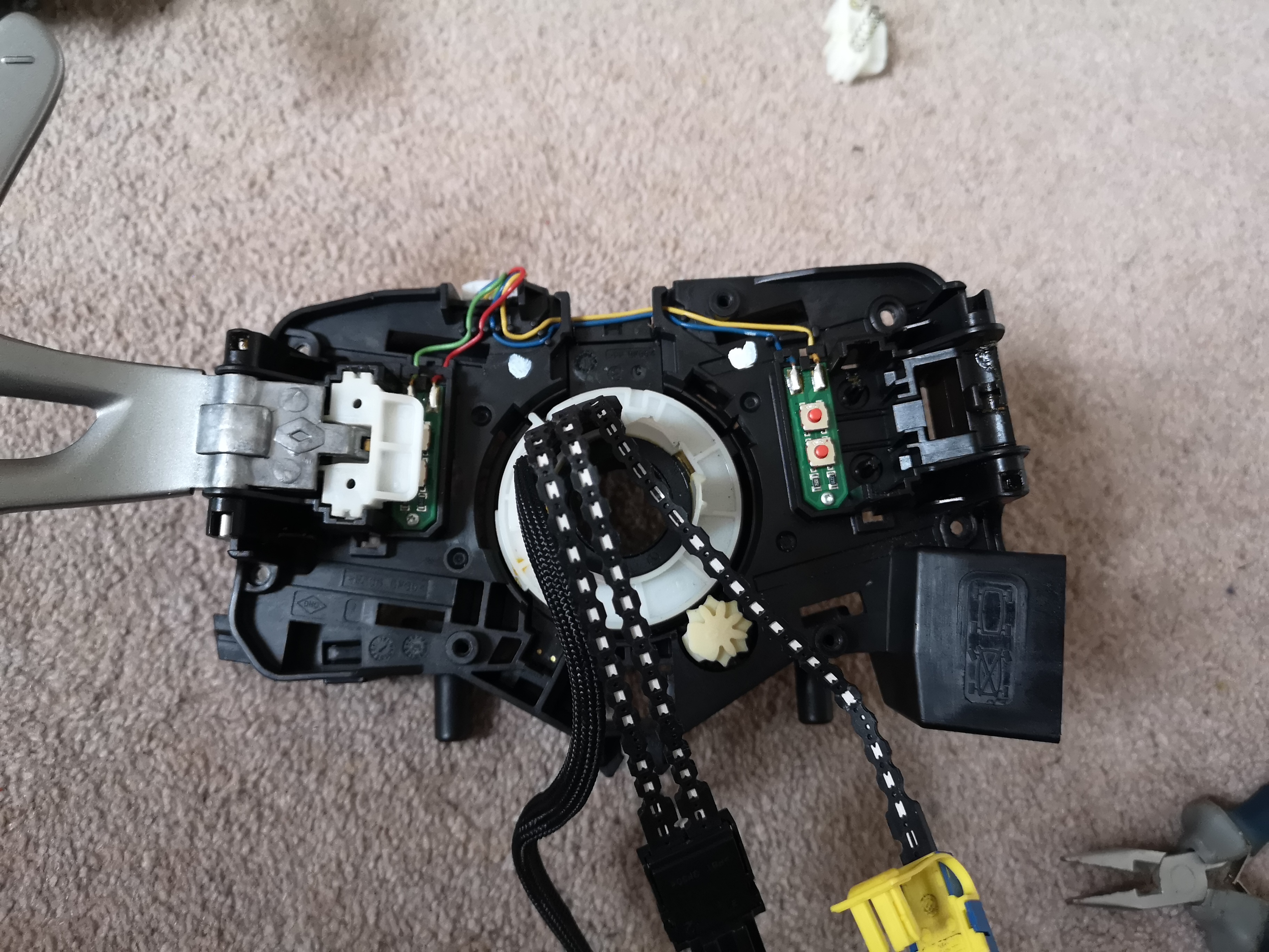

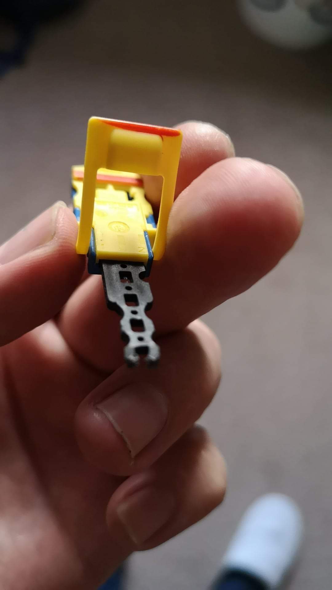

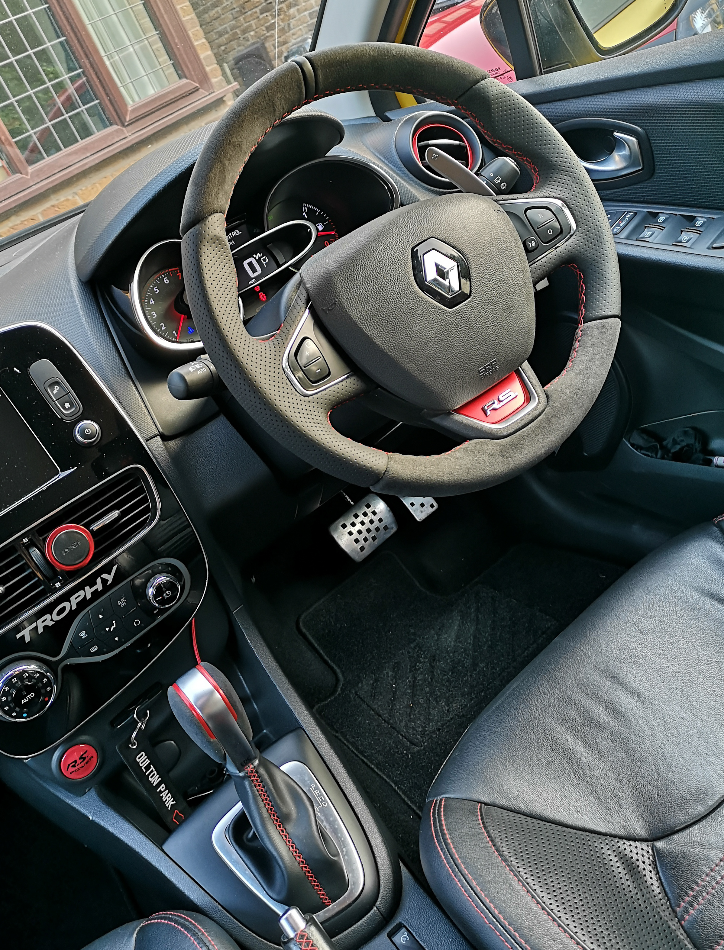

Done loads of cars up til now and all been pretty easy. This car tho, jeez getting the airbag off is a pain in the ass. And the airbag wire is unbelievably fragile. So that snapped when I eventually managed to get the airbag free and I got a cob/panic on and used the twingo til I could find a replacement squib.

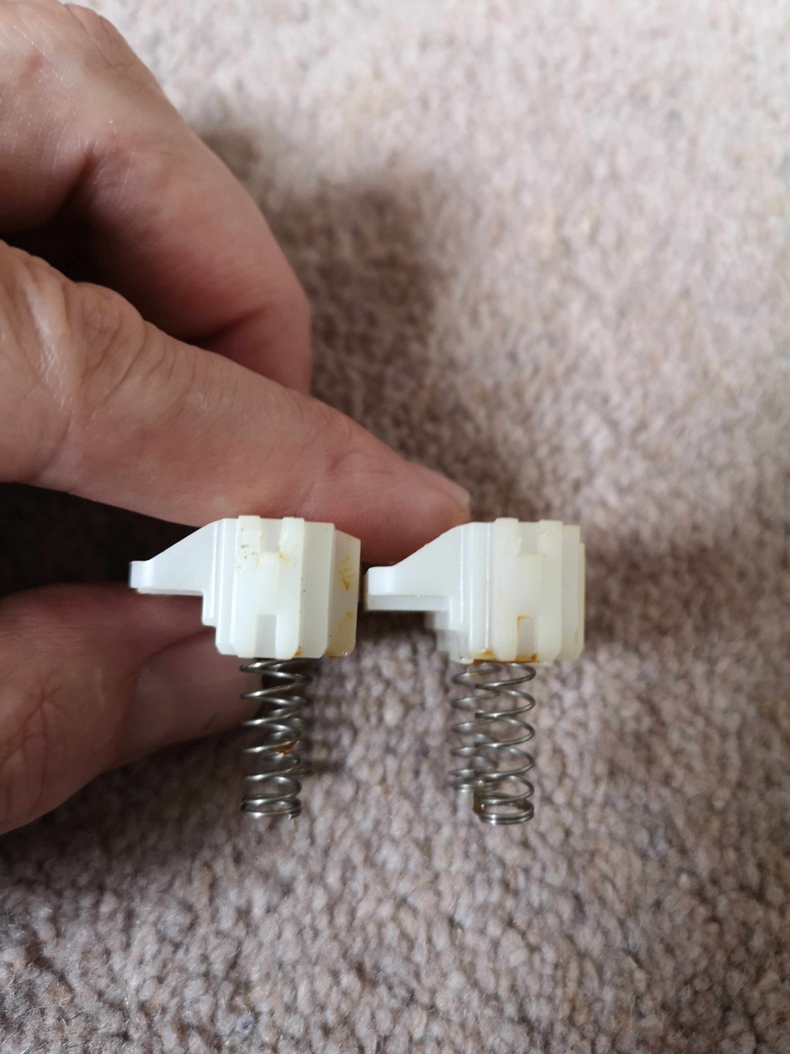

Fun thing with the squib is that the part is specific to a phase 2 facelift trophy as its got the fogs and there's a 30% shorter throw in the trophy paddles - wasn't sure how until I compared a used cup one I managed to get sent over from a guy in Holland 😂 was a lot cheaper than any UK breakers, who all only had preface cup ones. So I took a gamble on this lhd, preface, cup version.
Anyway, after dismantling all the bits off the 2 squibs - paddles, stalks, steering angle sensor, multimedia stalk and (most importantly - after a working airbag wire of course) found I was able to swap the gear change components to keep the shorter trophy throw.
Amazingly this hyped up trophy revision isn't achieved by snazzy paddles or a reworked mech, but just a 2mm notch added to the paddle switch platforms 😂
You can definitely feel the difference though so I braved it and went ahead to work out how to remove and swap them without damaging anything.
So result, fixed. And now have a much nicer, less sticky, Alcantara and proper leather steering wheel, with matching gearknob in Alcantara.

Steering wheel looks great. Pain about the squib, they are super fragile. I hate removing ren airbags for that reason as easily damaged.

Preferring the car stock tbh. No plans to map, lower, make louder or put any massive spoilers on. Brembos are a good touch, as are the stud and nut conversion and silver rims.

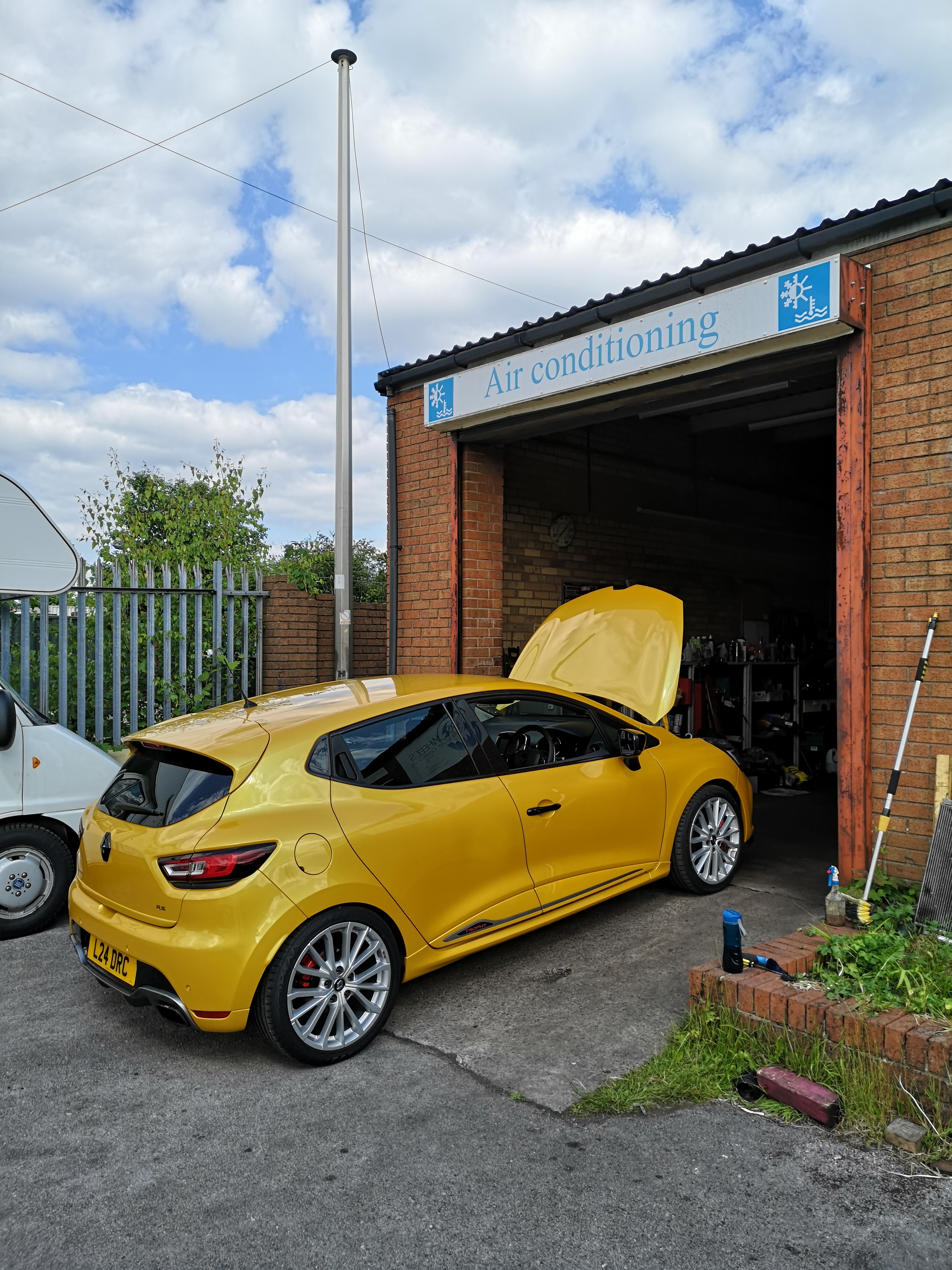

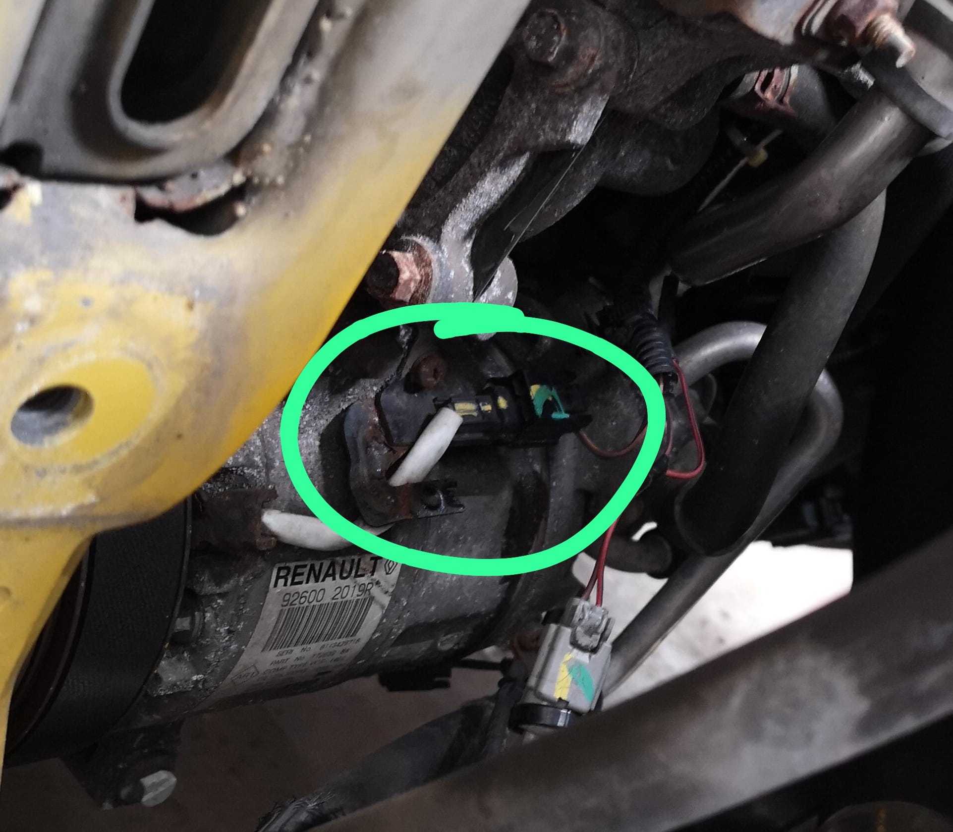

Summer's here! So what does the Clio decide to do? Delete the ac, again. Nice one.
No codes this time. Assumed a leak or dodgy pressure switch. Anyway got it booked in with an ac specialist near me I've used before (top bloke for anyone in St Helens area BTW, called Cool Wheels).
Pressure fine, refrigerant gas ok, no codes, just another mystery.
Then he got it on the ramps and went to test the compressor and relays and the lovely sound of 'click' from the clutch, followed by ice cold air.
Thank eff for that. Loose plug connection to the compressor.

Used squib lasted 1 month :LOL: was worth a try for 40 quid. Took it apart and looks like it's been effed about with previously and someone did a crap job of putting it back together - they're super fiddly so not surprised. Basically it's wrapped around itself and eventually snapped where it joins the spool.
Thought about using another used one as Renault RRP is £390 for new! But decided to just bite the bullet and got one from RPD and yep, you guessed it, it was on back order. Only 2 weeks, so got it this week and fitted it on. All good again, I have no airbag light and working cruise.
Expensive lesson/steering wheel retrim that was :ROFLMAO:
Part number for a Trophy (shorter shift switches) is 25 56 726 71R in case anyone needs one. Comes with paddles but no stalks, audio control or steering angle sensor.

Back to Mick at Diamond motors. AC failed yet again, @Daz. I bet this is your same issue too.
So it's not the power wire/connector that was at fault as we'd thought, but instead the power connector for the AC clutch on/off. Apparently it's the same type of connector used on a few Renault applications, main example being an auxiliary (?) water pump on the RS Megs. You can't buy them from Renault and no one seems to make them aftermarket. You'd just have to put the minimal amount of pressure on the wires to the connector and it'd flick the clutch on/off. So some wiring modification has been done to keep it in the right position. Works fine now, if it goes again he'll try source a good one from a scrap yard and modify it so it's all good. Another option is to just hardwire it to the clutch wire, but then you're butchering the car's loom and we didn't fancy that, bit rough.

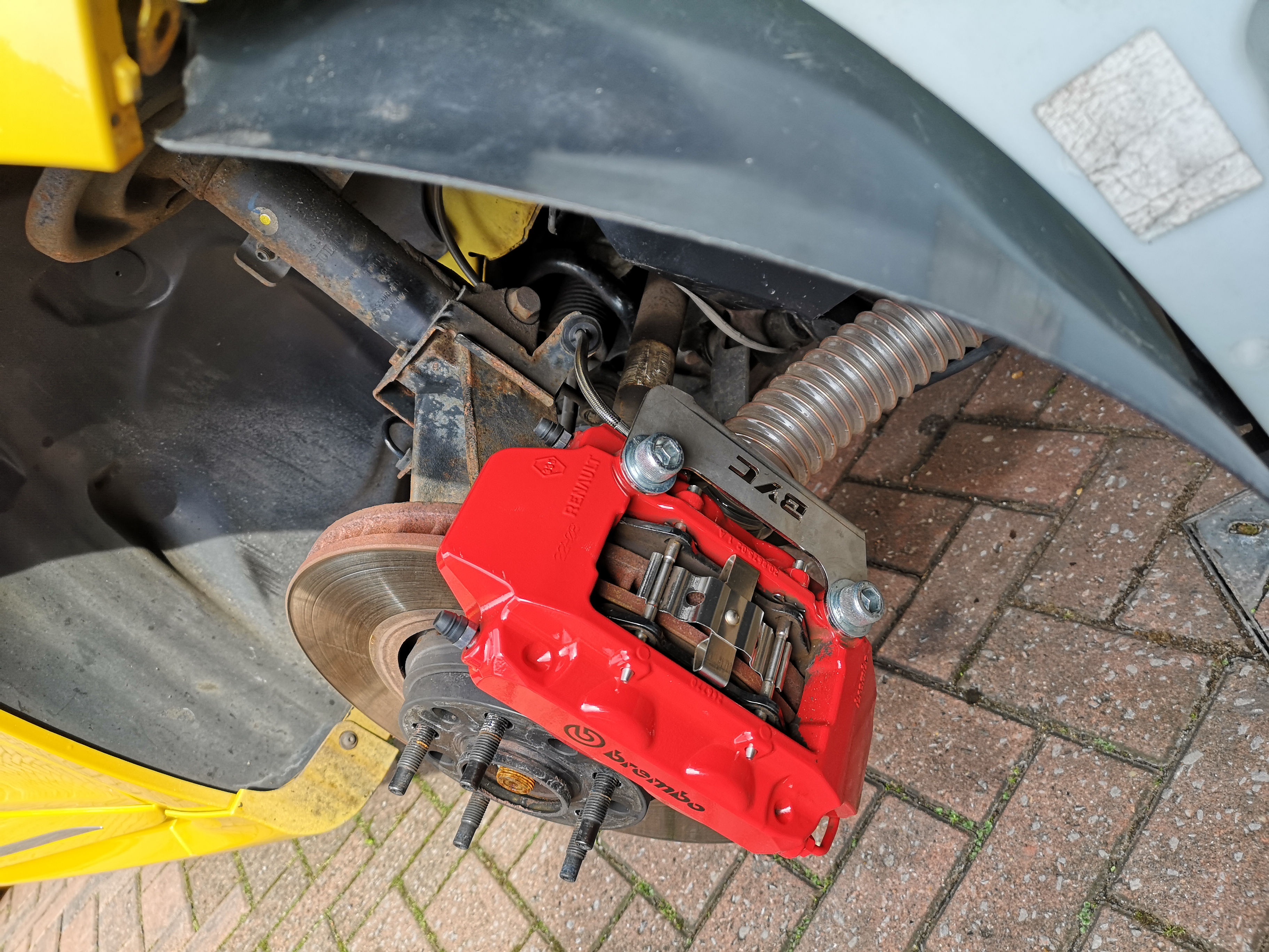

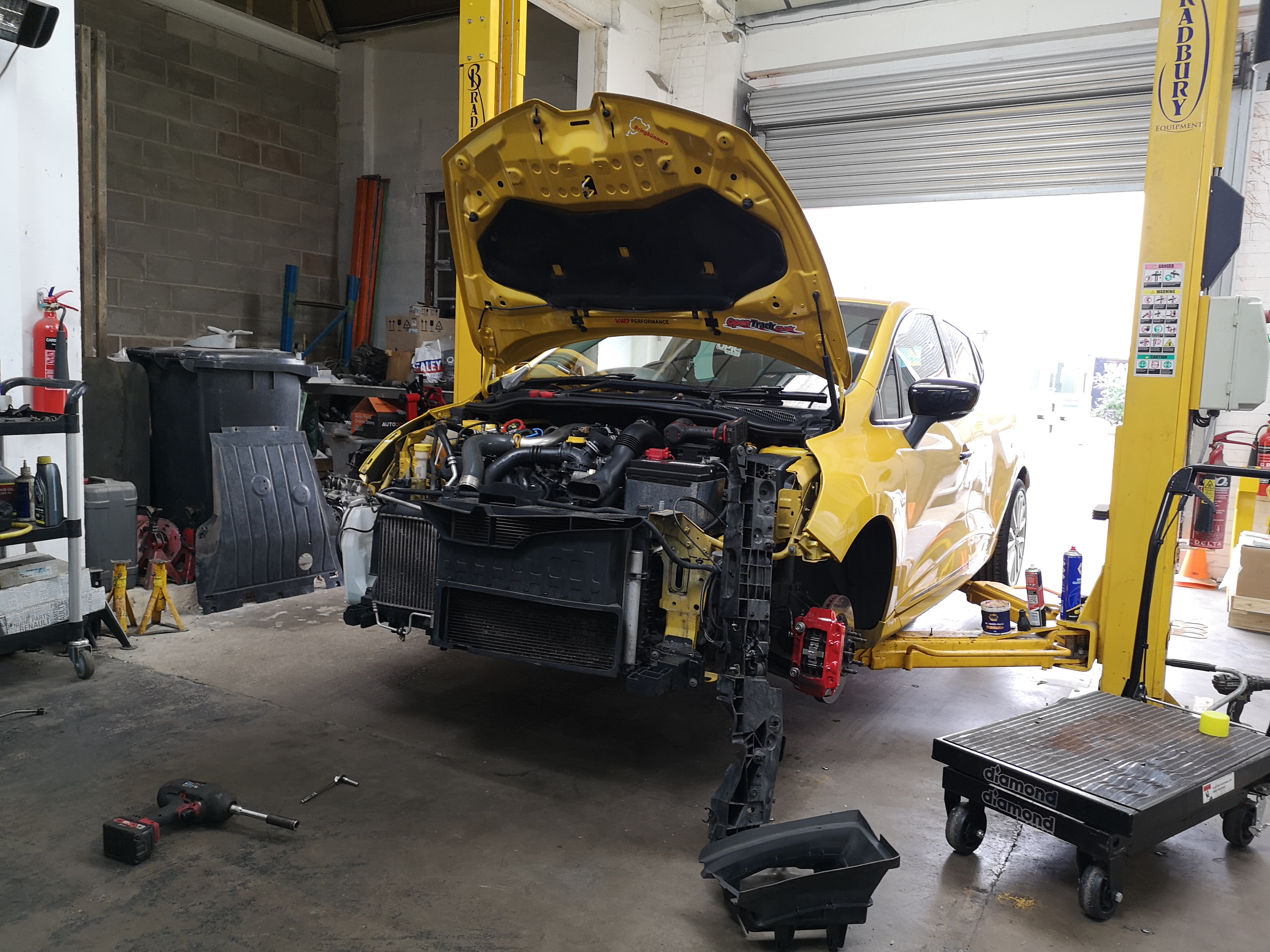

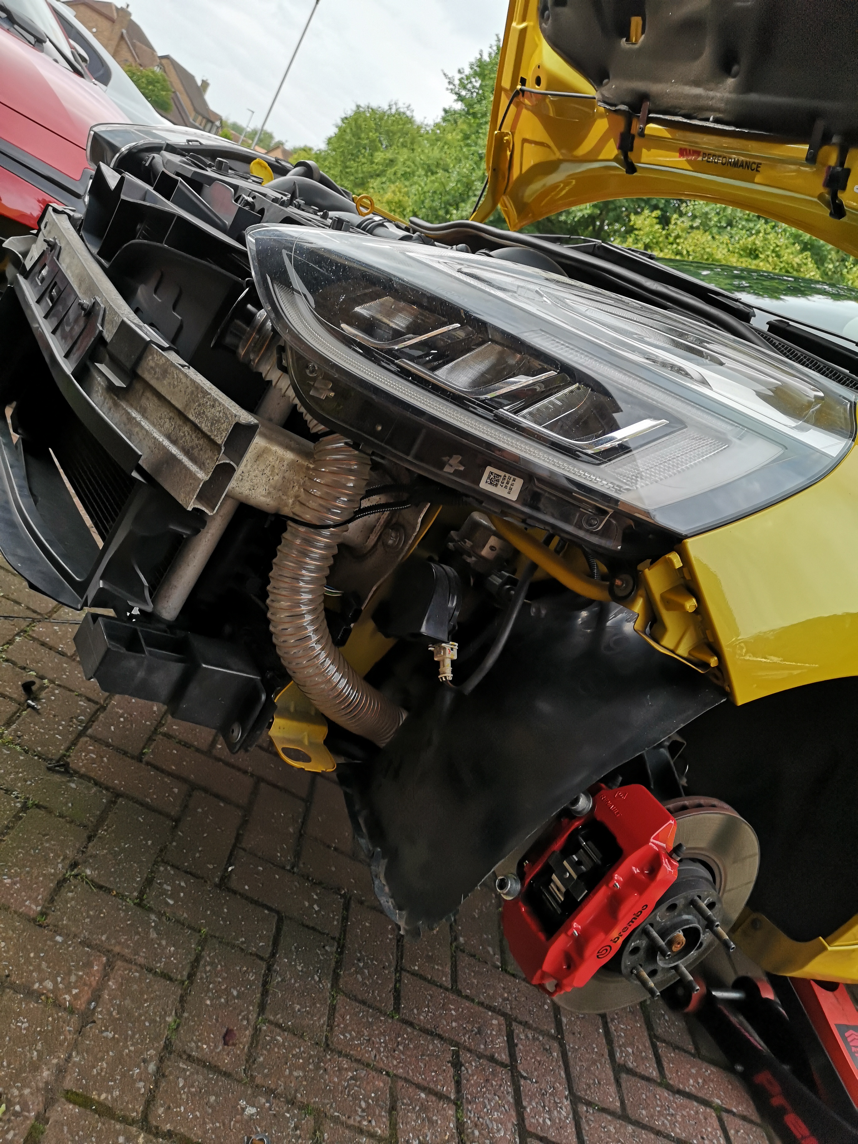

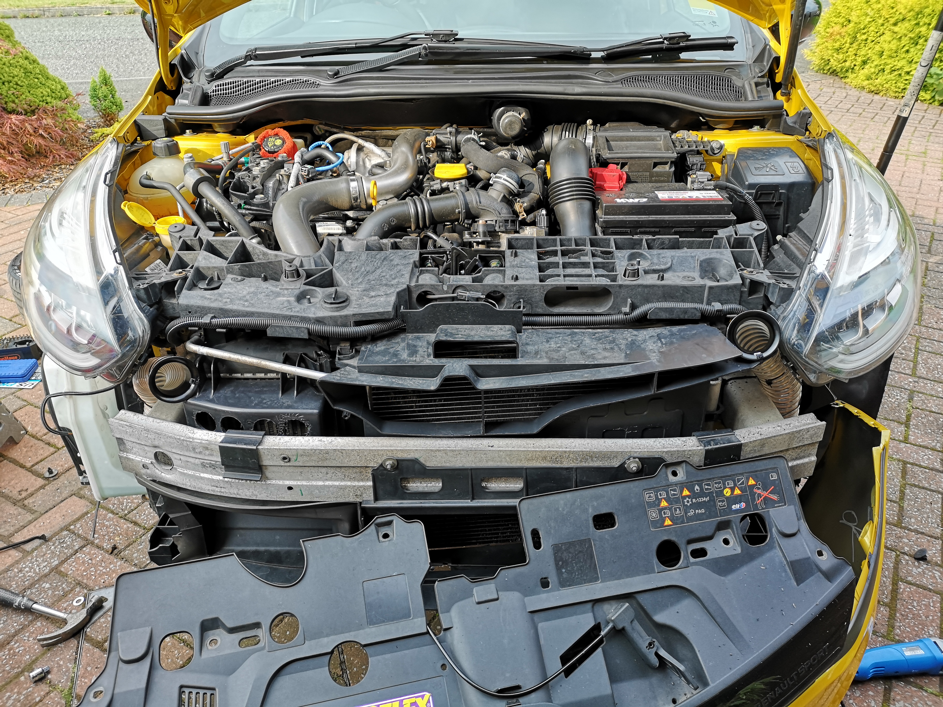

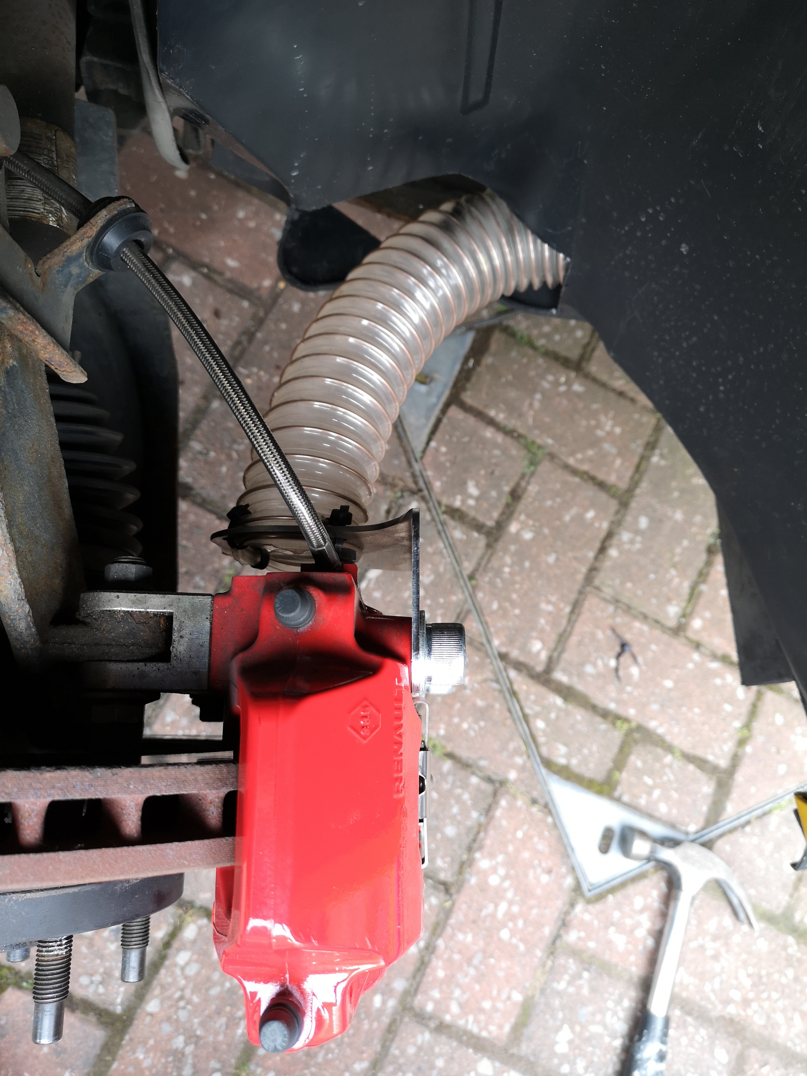

Wash, wax (fusso kog) and I got this BYC Brembo cooling kit off a bloke nearby who tracks his trophy. Total overkill but nice to know it's there. Absolute ballache to get the pipes through on the drivers side and not a lot of places behind the bumper where it's open, for the scoops to sit. Unless you want to chop away at intercooler shrouds or the bumper itself. Not me.
Came with some precut arch liners so I didn't have to butcher my own.
