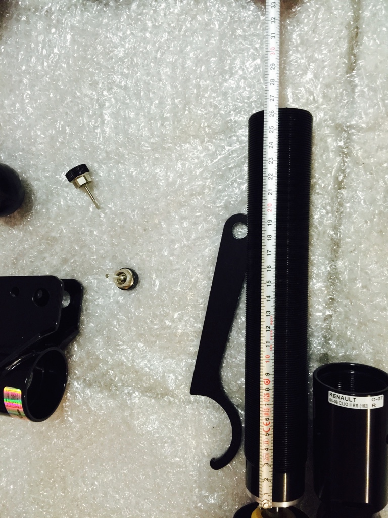

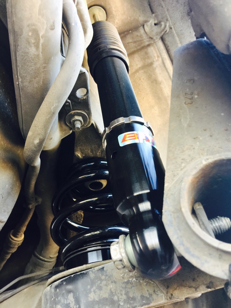

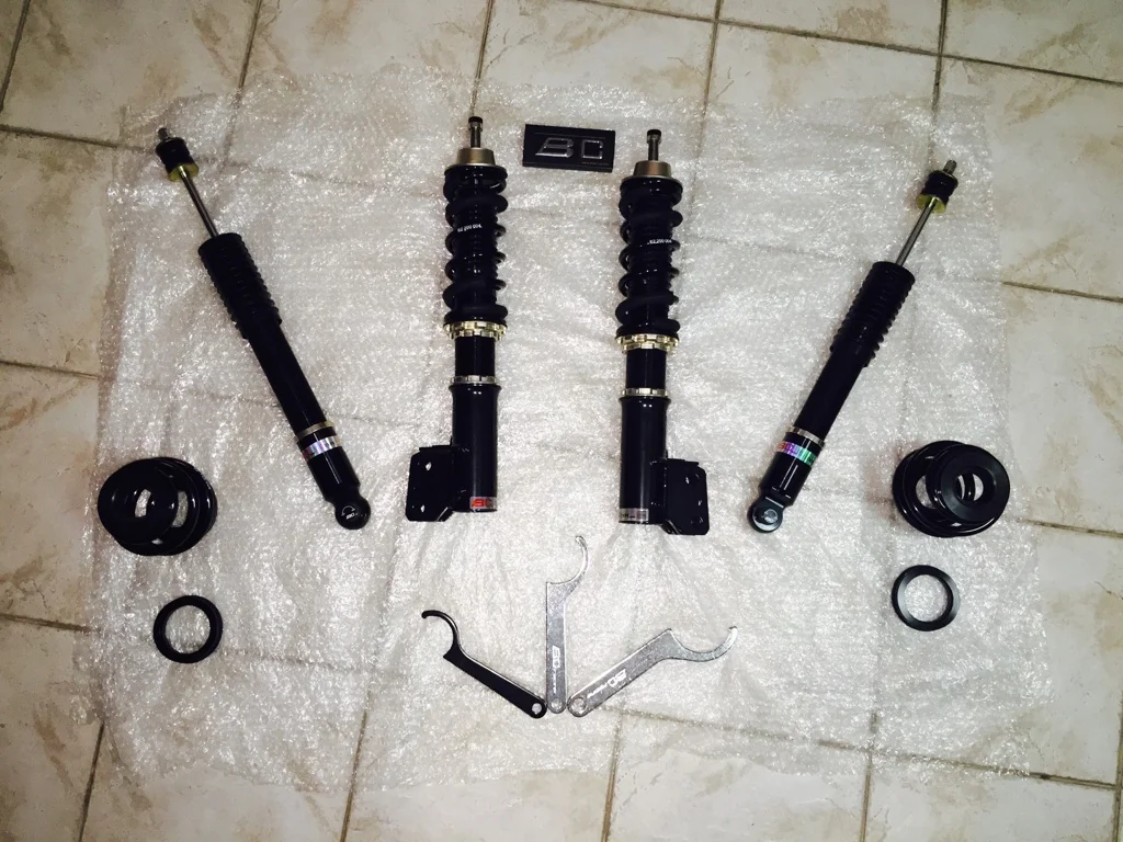

The rear damper is with some kind of adjustment for the damper's body in his lower mount. The spring came with 2 spacers, one thinner then the other.
I installed the thicker one(on the bottom of the spring).
How am I supposed to adj. rear height? By adding one more spacer? Or by screw the whole body up ?

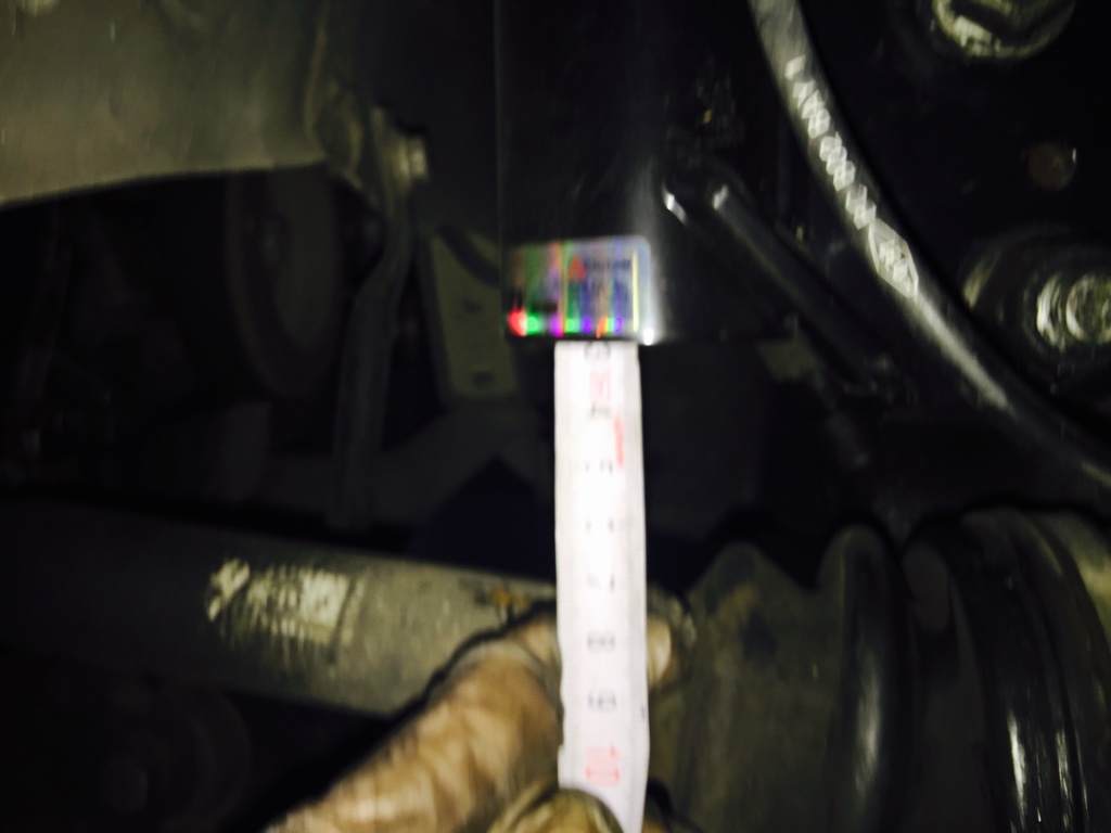

Btw, i measured the front height from the sub-frame and its 11.5 cm. for comparing, the Trophy is 15.9 cm.

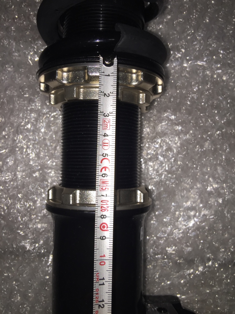

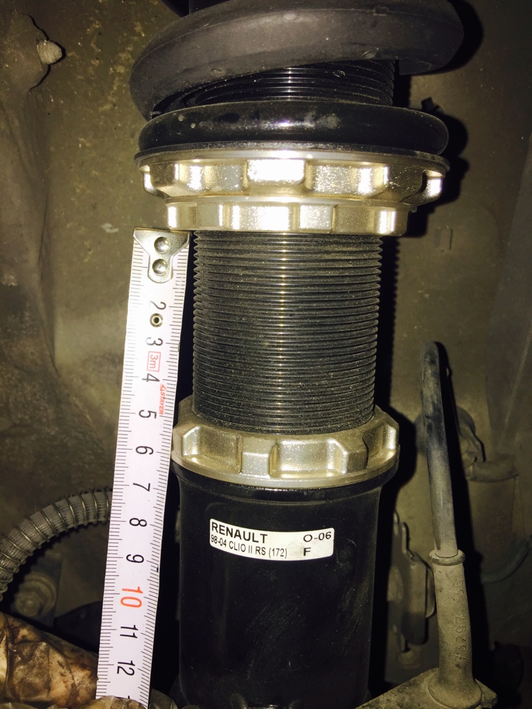

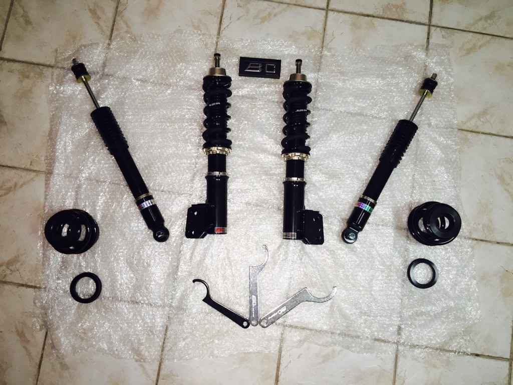

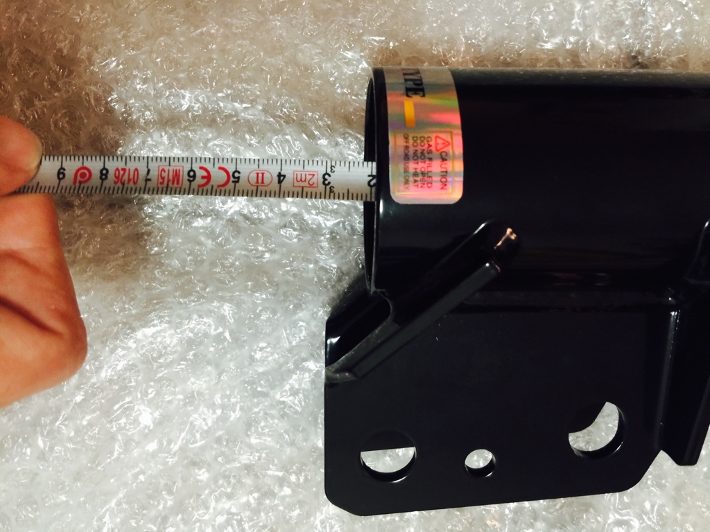

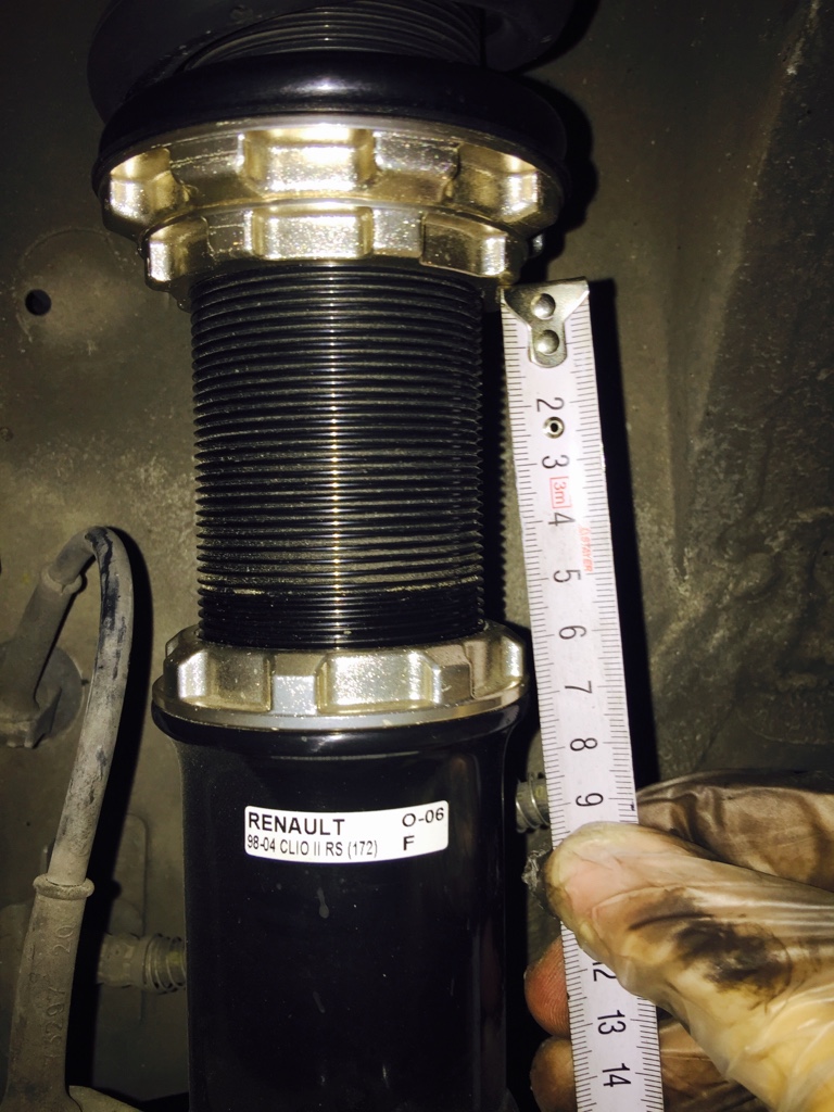

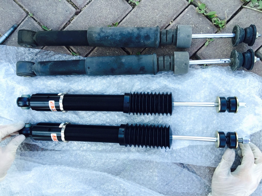

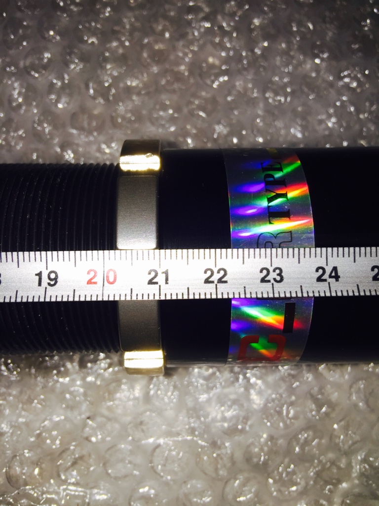

Anyway, since the info on BC at Clio scene is pretty short i want to share with you several pics of the set while i measured some of the coilover parameters. And some pics from after installation. Enjoy

To increase ride height at the rear, put more spacers under the spring.
IIRC they come with a 5 & a 10mm spacer.. So you can have 0 (lowest), +5, +10 or +15mm.

As above, you use the shims to add/subtract height but you can also fine tune with the lower collar on the rear also.
I also run the +10mm and haven't had to adjust anything else:

This is one of the advantages of the 3rd collar which BC/Ohlin use. I'm not sure what the exact value is on the rear collar but you'll have a good +/-30mm either way i'd wager. You're supposed to use the shims to get you to where you want to be and then trim it via the 3rd collar when setting it up on the scales... Do not put that 3rd collar on the last two threads or else the bottom joint will fall off - Use some common sense.

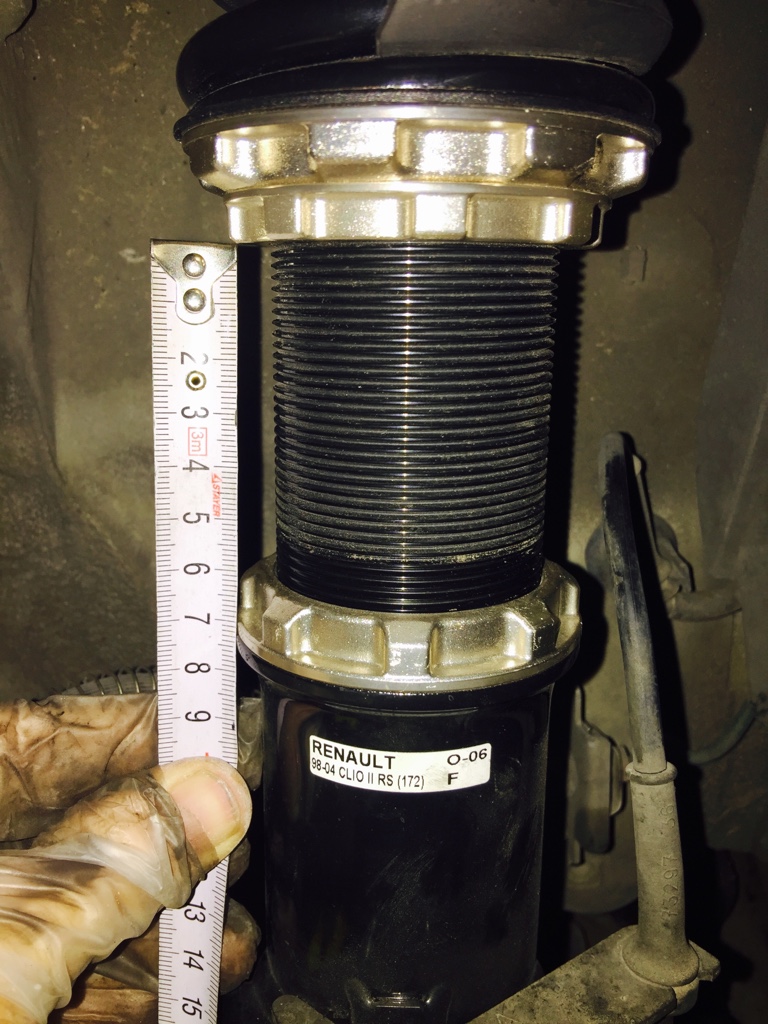

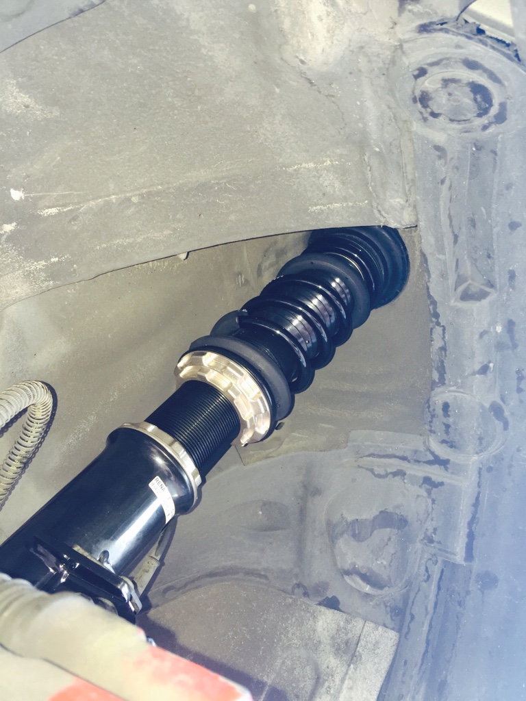

Btw, i drove with the original set up and on hard cornering the wheel touching the arch.. So i screw out the front damper on the front. Right - 1 cm. Left- 1.1 cm( its a Left hand drive clio)
Now the front ride height is 13.5 cm from subframe.

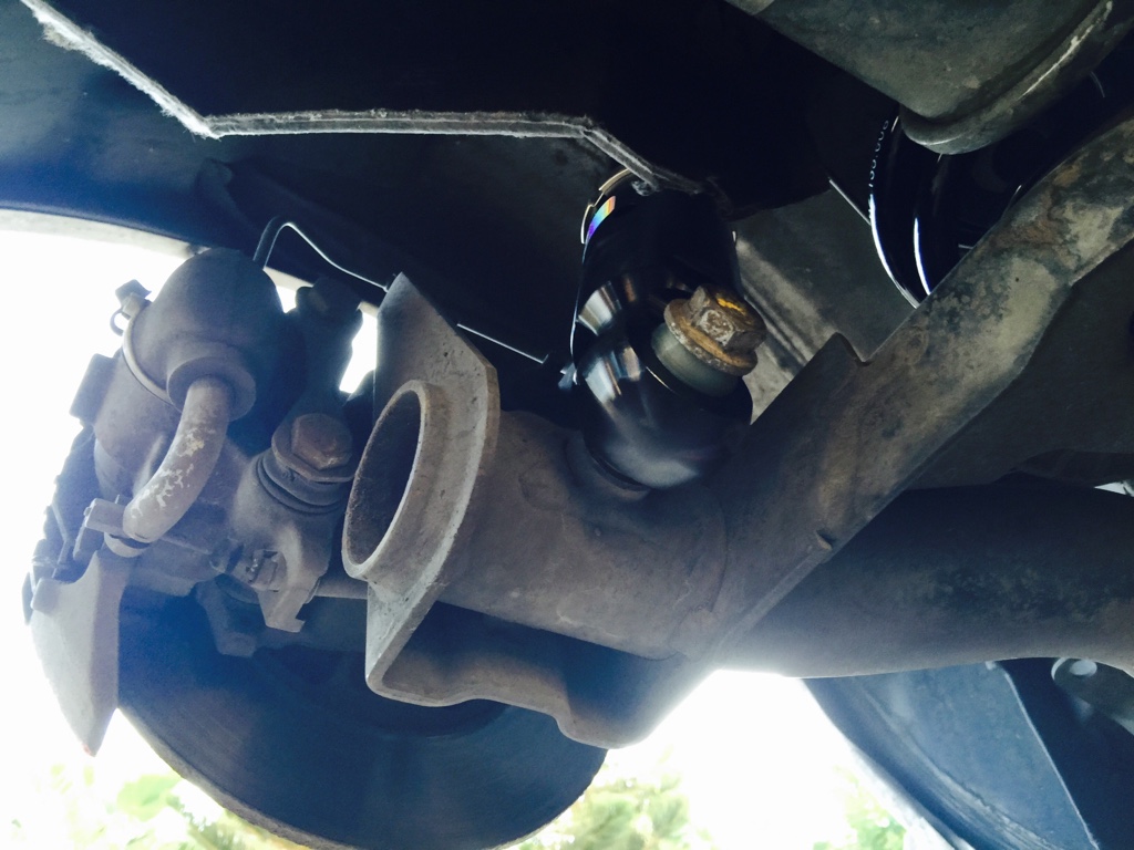

Here are some pics from the process who took only 20 mins.( on jack, popping wheel out, unlock lower collar, screwing damper up with bare hands and measuring)
