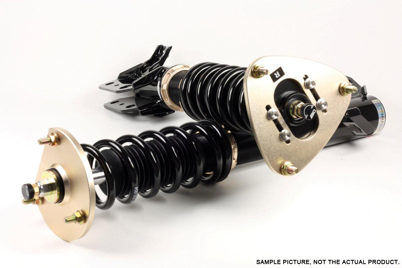

I've just upgraded to BC Racing DS suspension. However the front struts do not use the three bolt holes which my Pure Motorsport Strut brace utilised for mounting. Thee BC Racing struts use plates either side of the strut top hole partially covering the bolt holes to locate the strut. So I have a few options; find a strut brace that will fit, modify PMS Strut brace probably by welding strut top fittings to strut tops, or just do away with the strut brace. My Clio though road legal just does hillclimbs nothing else.
Would welcome sensible thoughts/suggestions

in that case, cutting off the brackets from the pure mounts and welding them on the BC plates (if there is room) would be your best bet.
have doubts about the room though.
next idea would be a new bracket with the larger pcd of the BC bolts.
It won't fit with those style top mounts.
You'll either have to run without the brace or change the top mounts to pms ones.
Thanks.
As soon as I looked at the new struts I realised I had a problem? As you suggested I've just looked at PMS site and unfortunately they only do one mounting type, so if i want a strut brace I'll have to make up brackets. However do i really need a strut brace??
