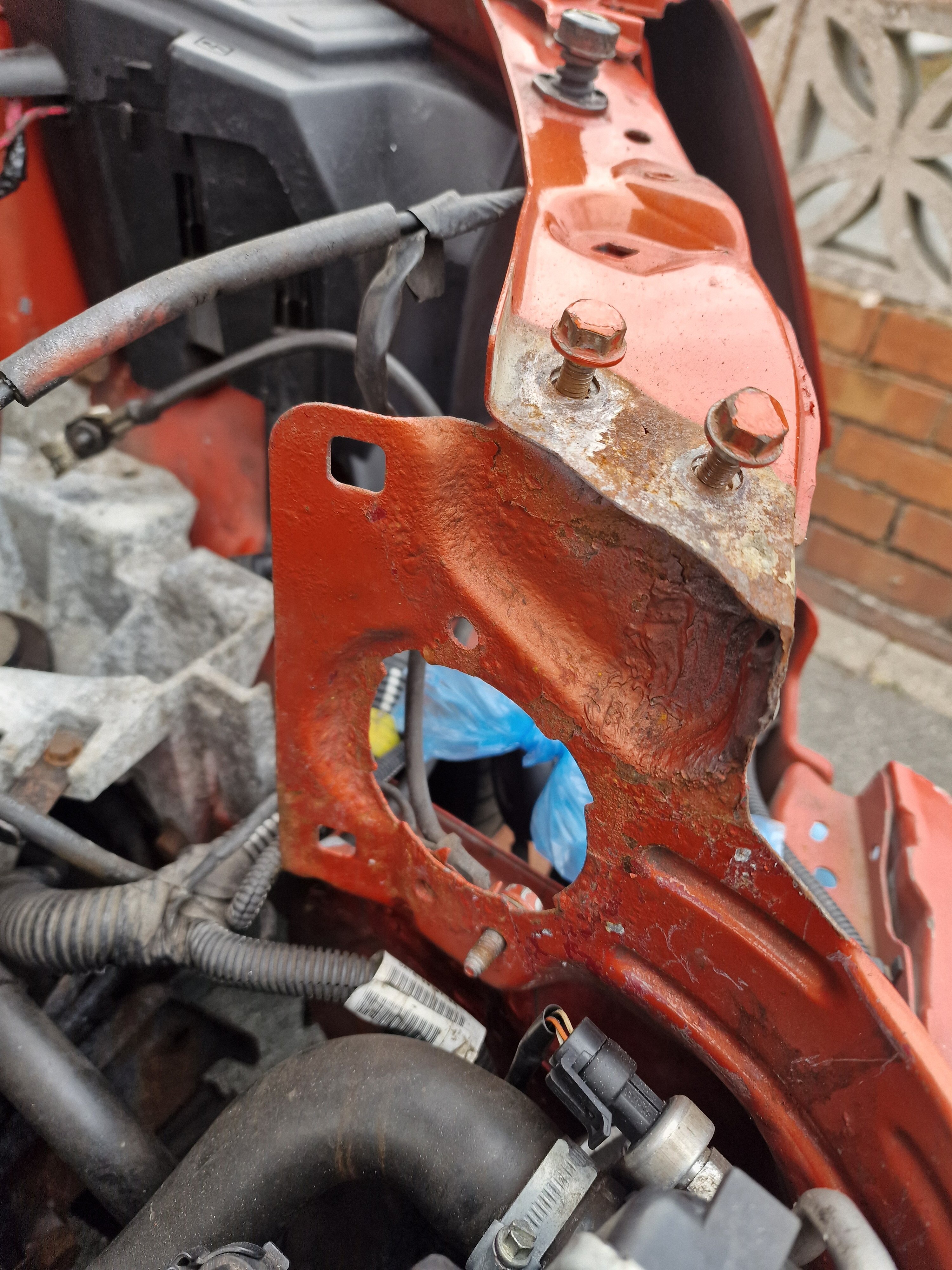

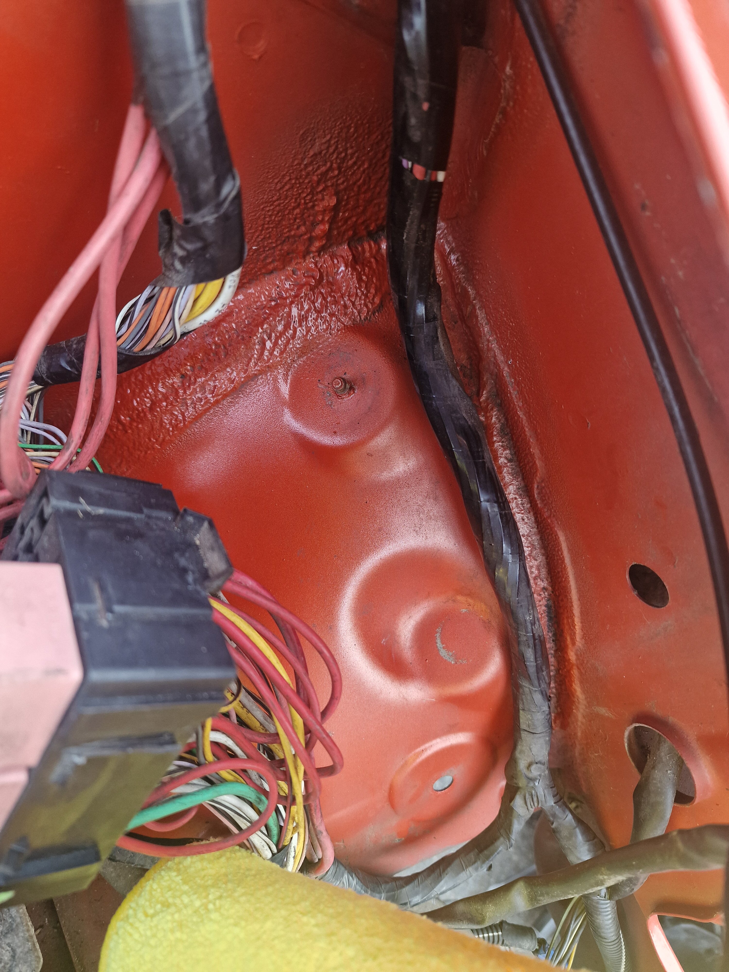

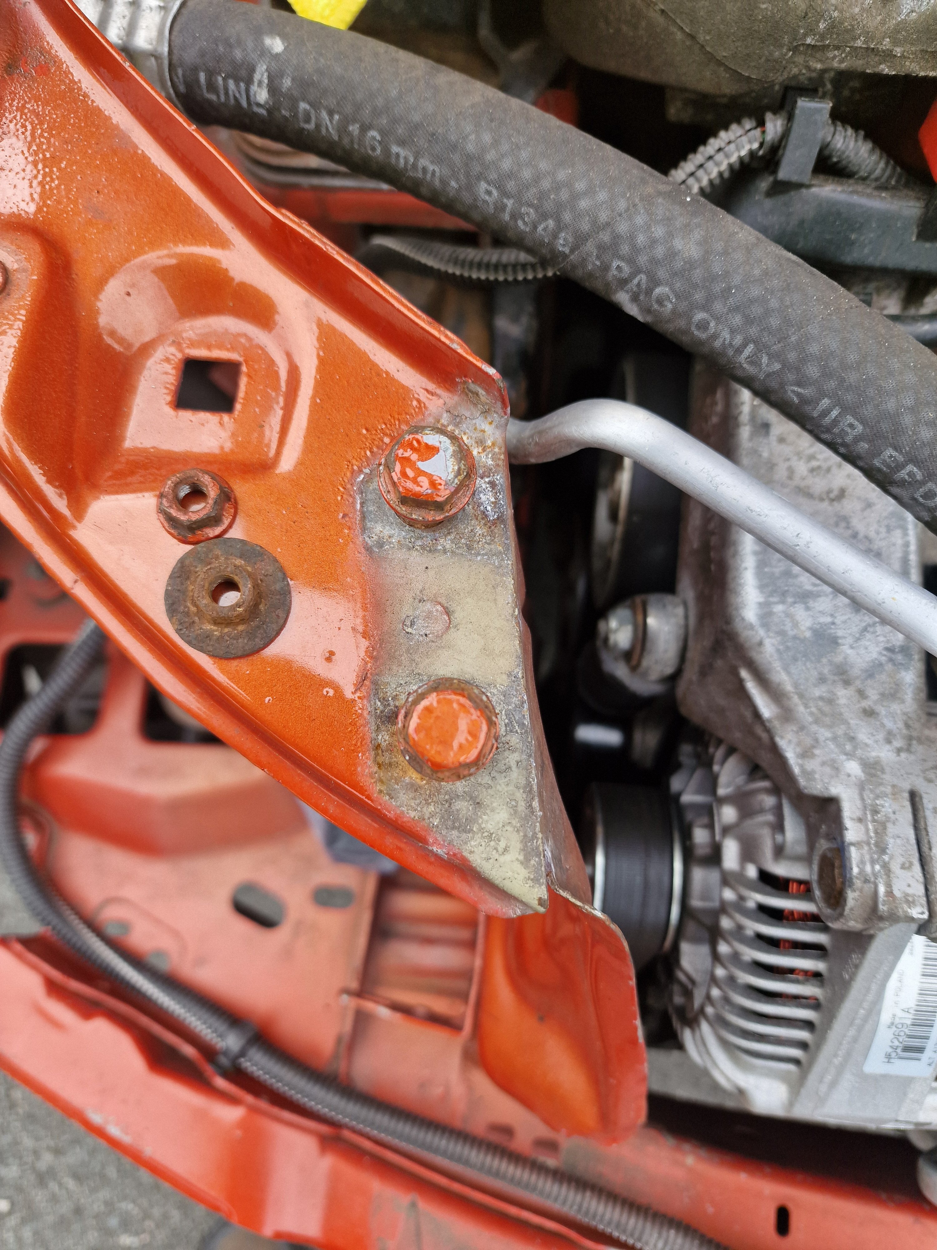

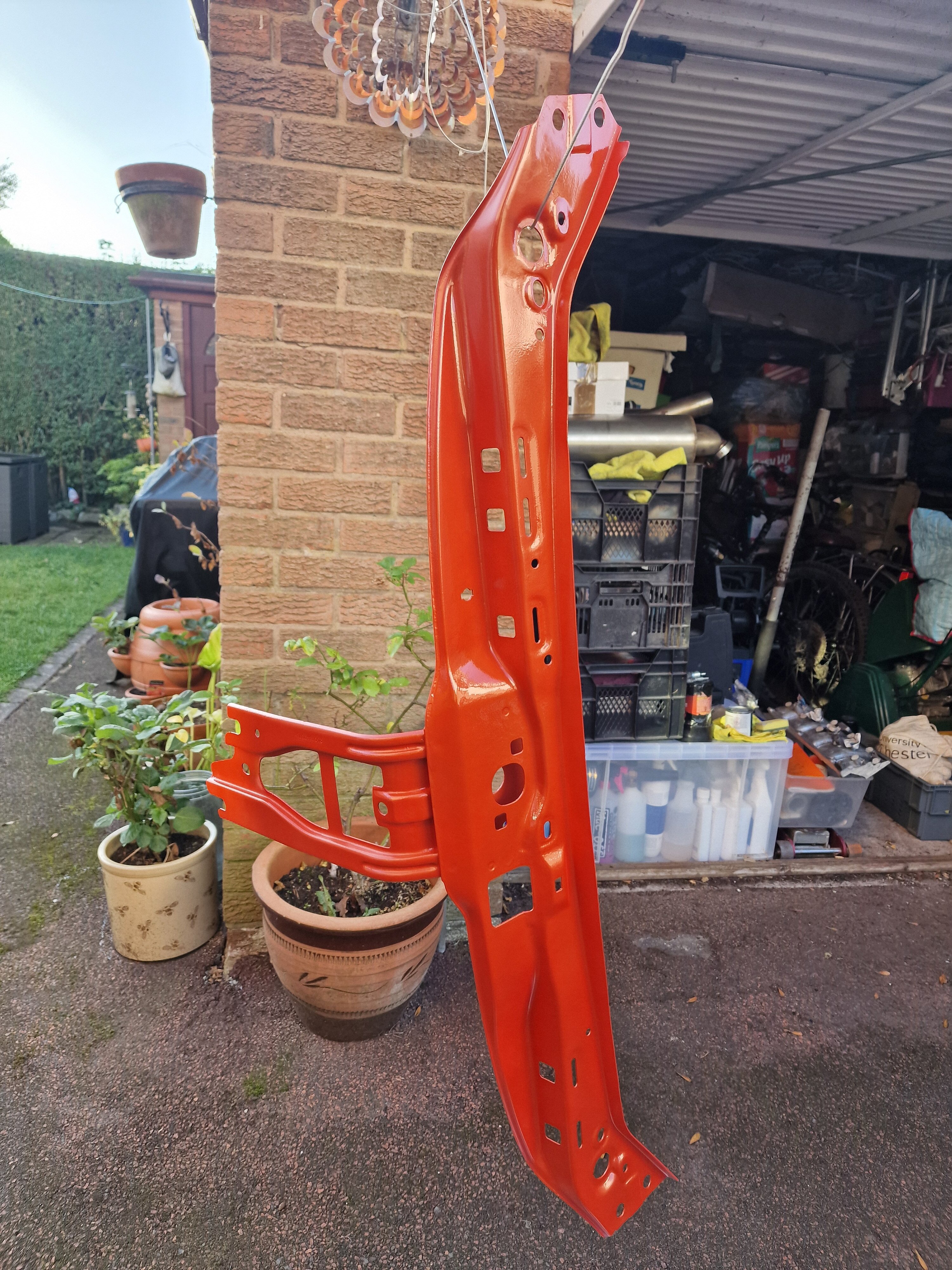

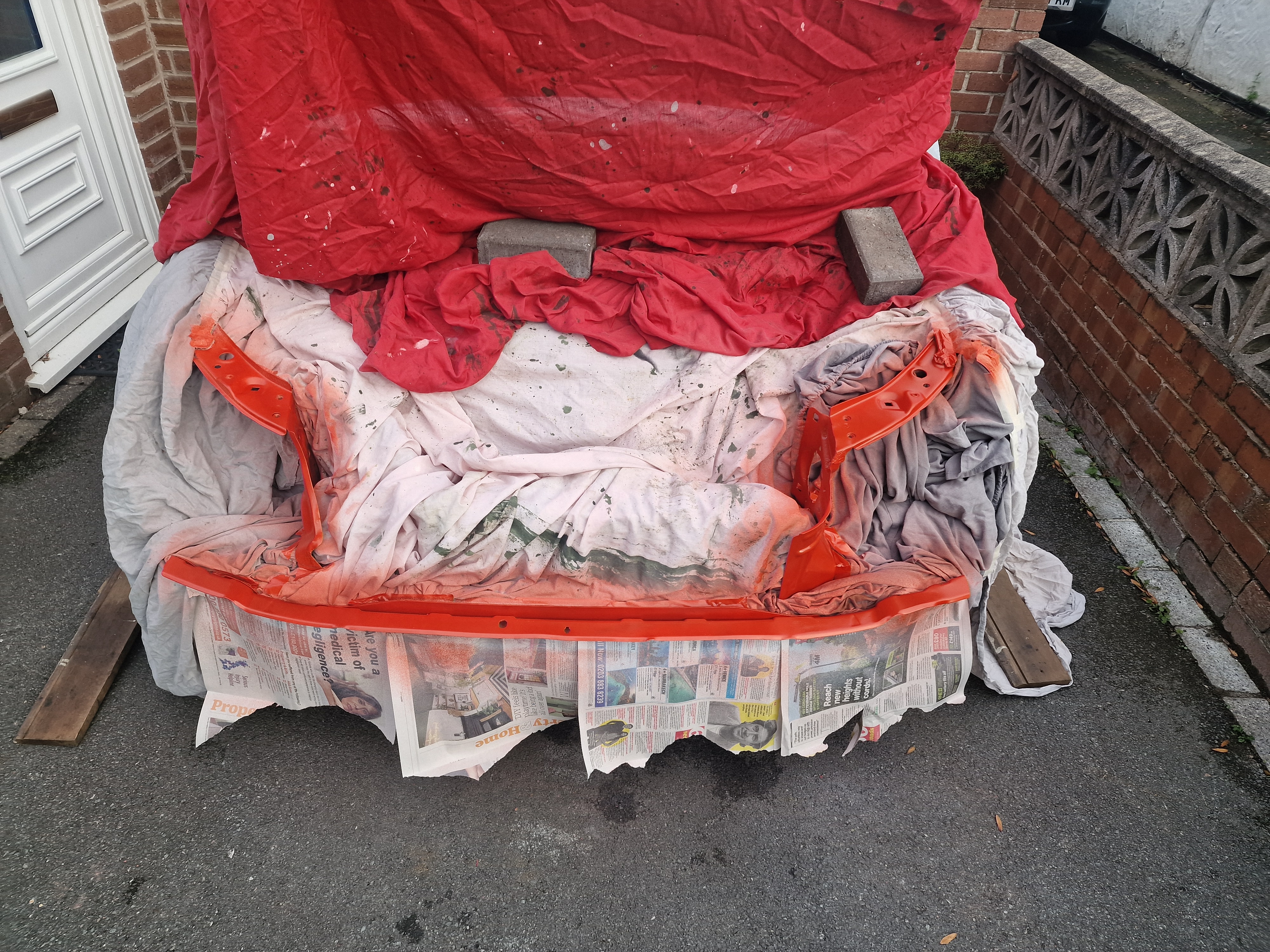

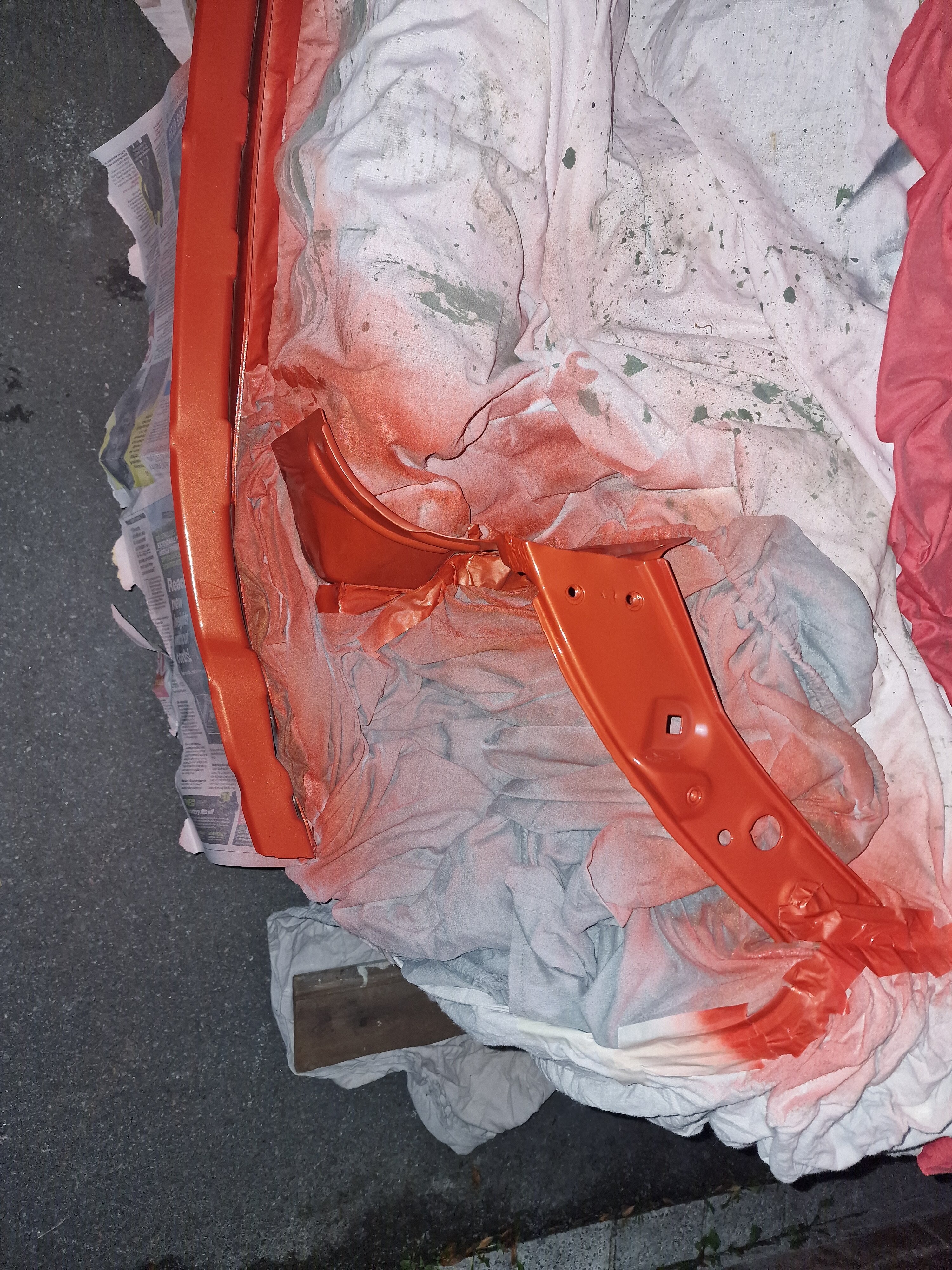

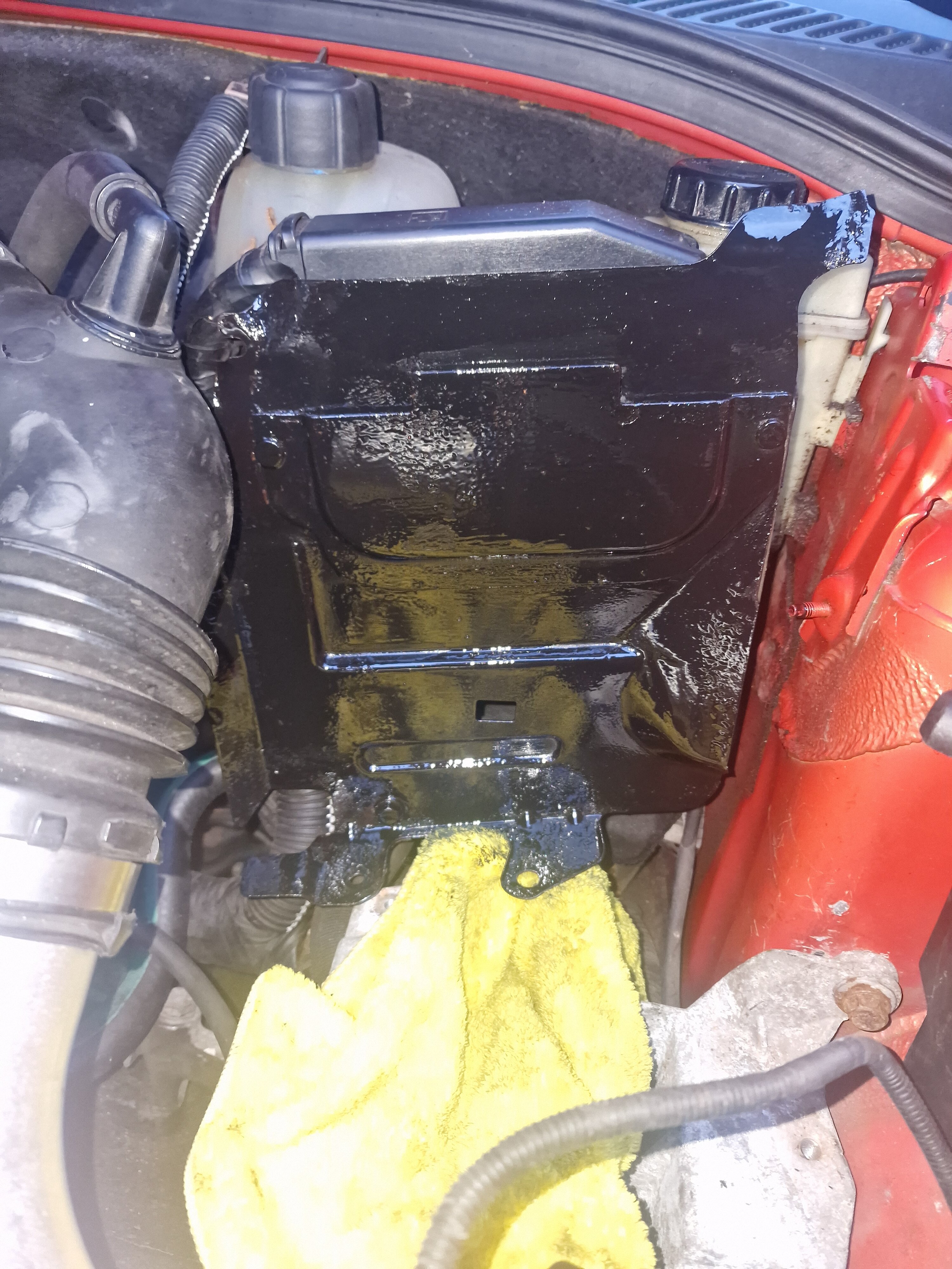

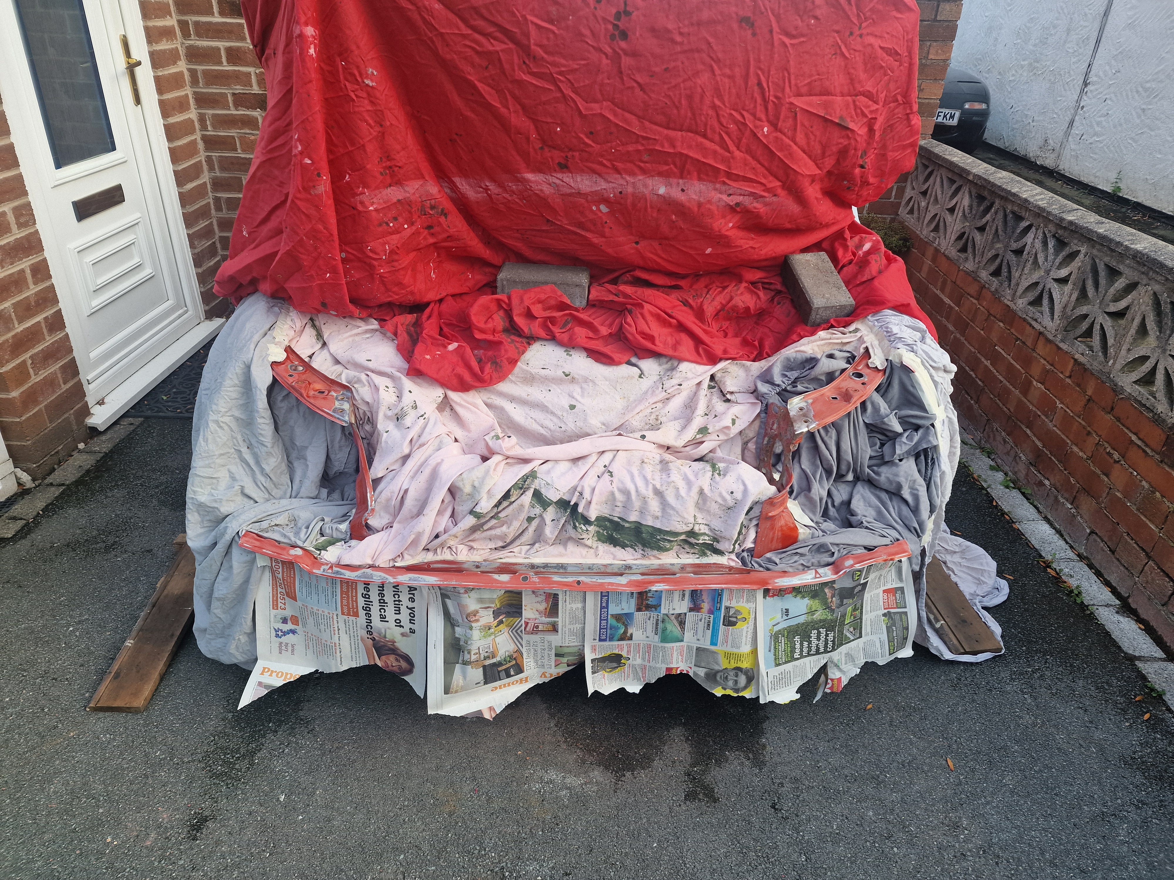

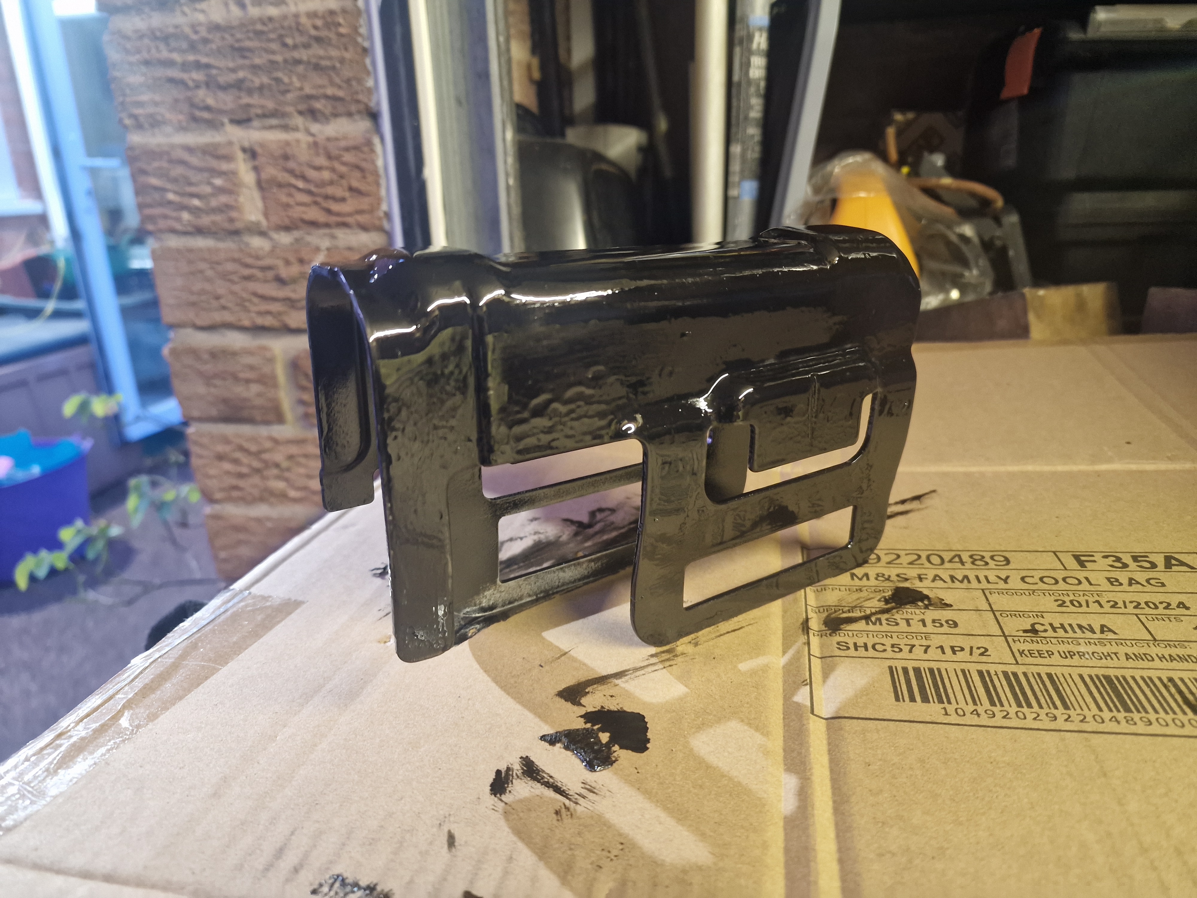

Painted the front end to bring it back to orange. Some before photos

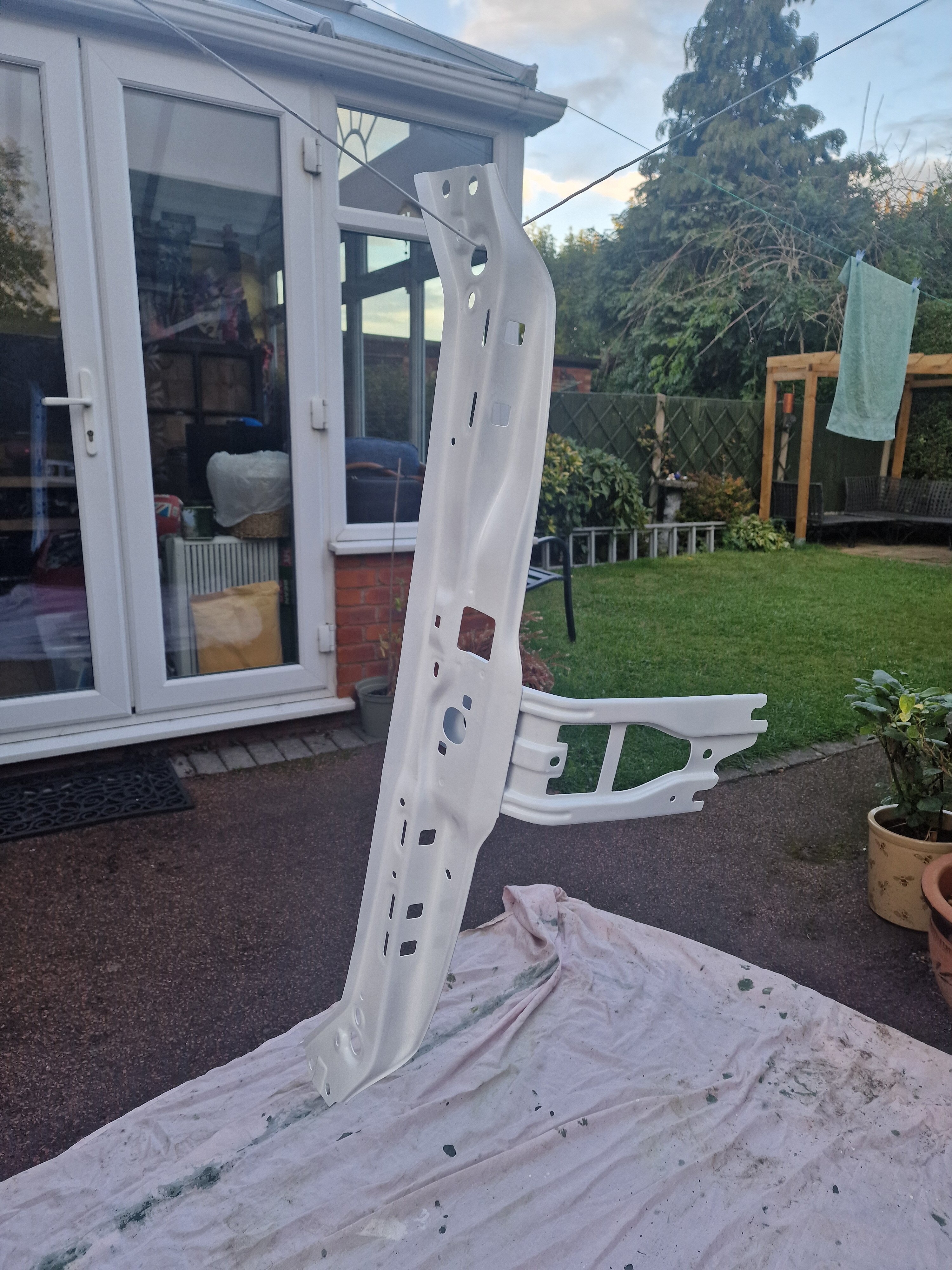

Progress & full painted using 2k white primer, colour matched spray paint from a company local to me & hycote clear lacquer

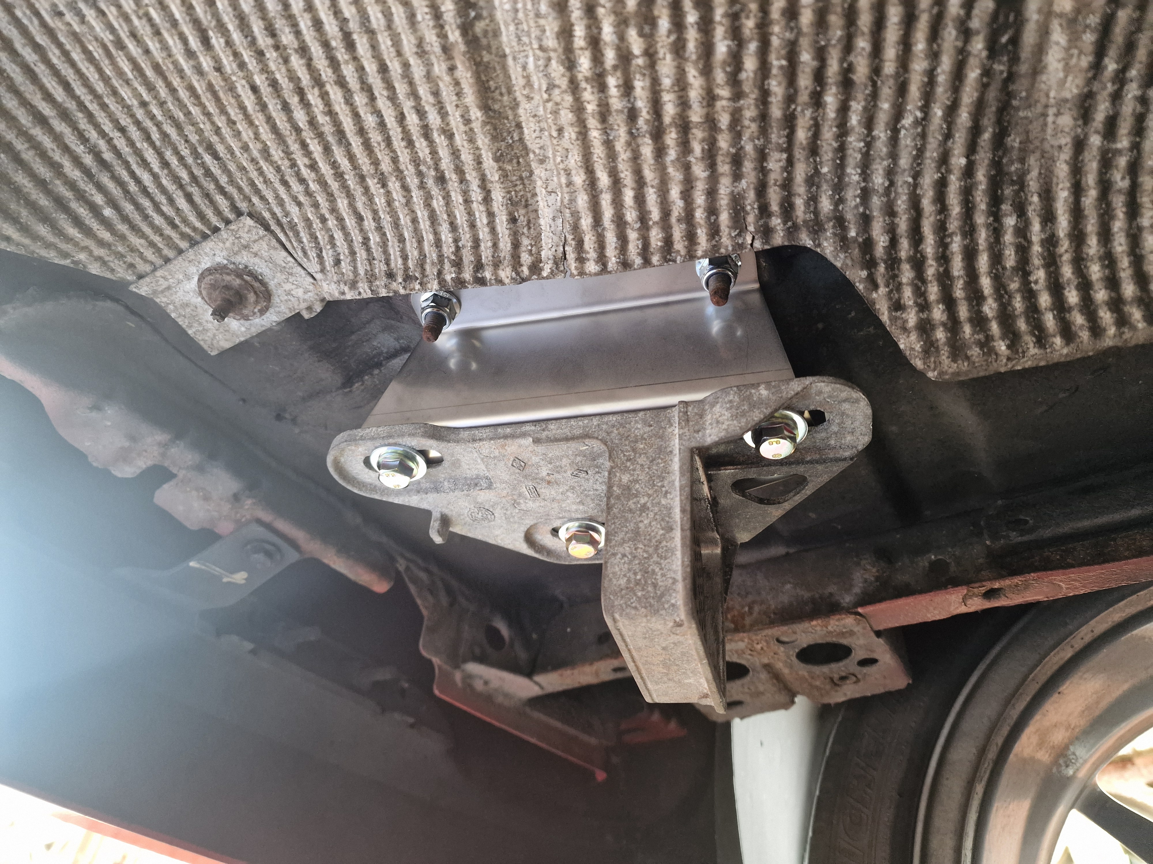

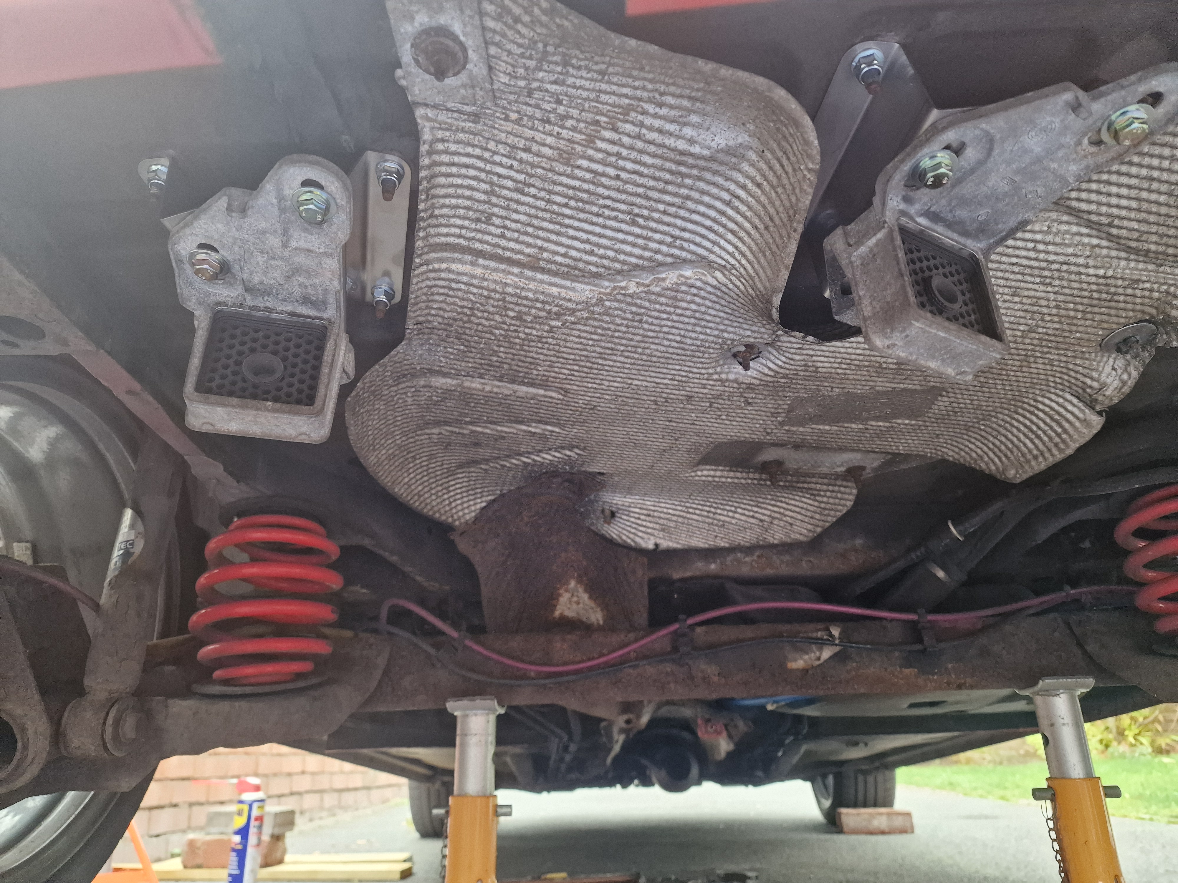

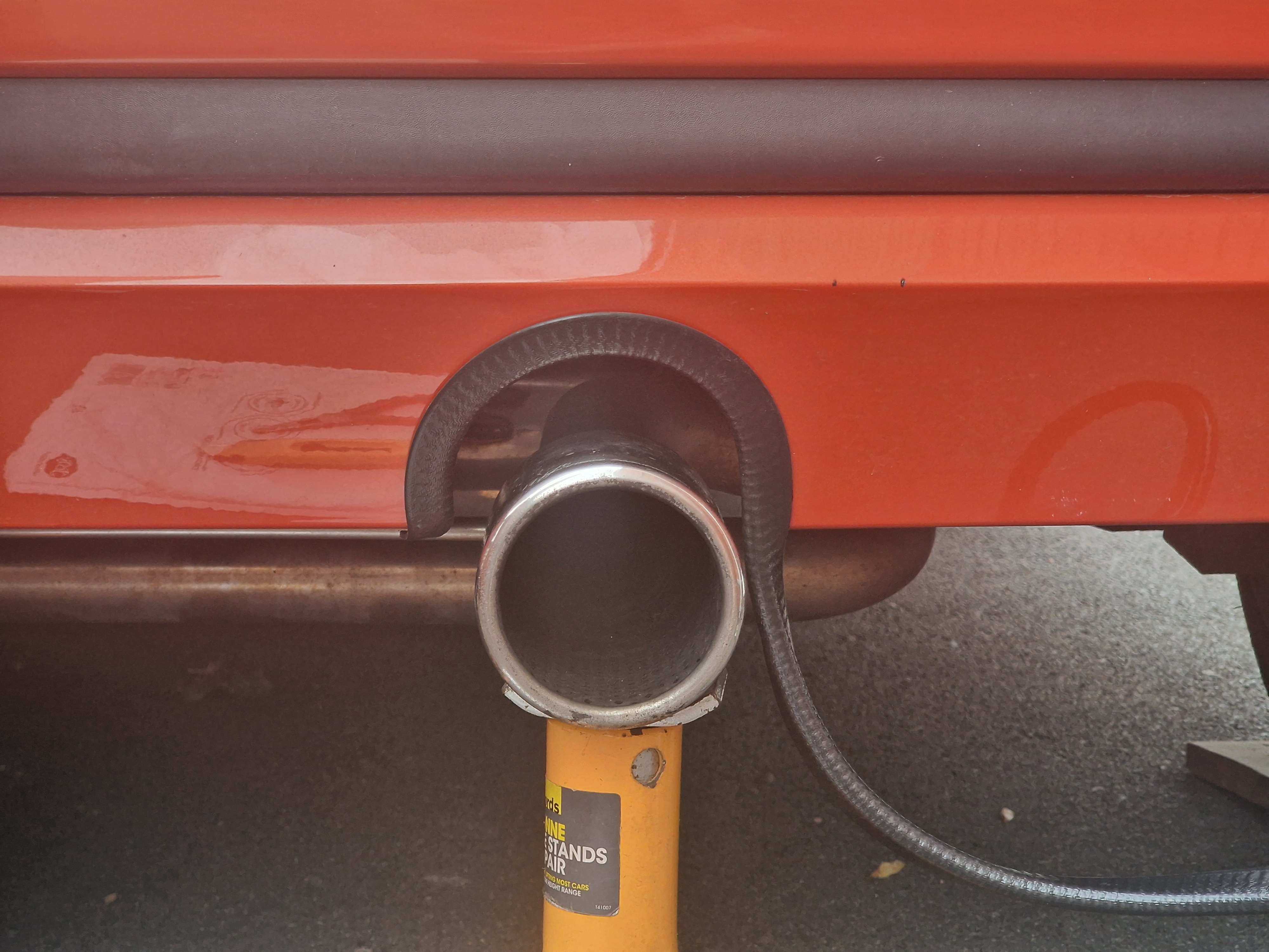

While working on the engine bay I was also working to fit the new to me exhaust (the cgr I have posted about on here previously). I wanted to do the job properly so I bought a new exhaust hanger mount kit from Pro - Am, a pair of gram exhaust mount bush's and a new OEM centre exhaust hanger.

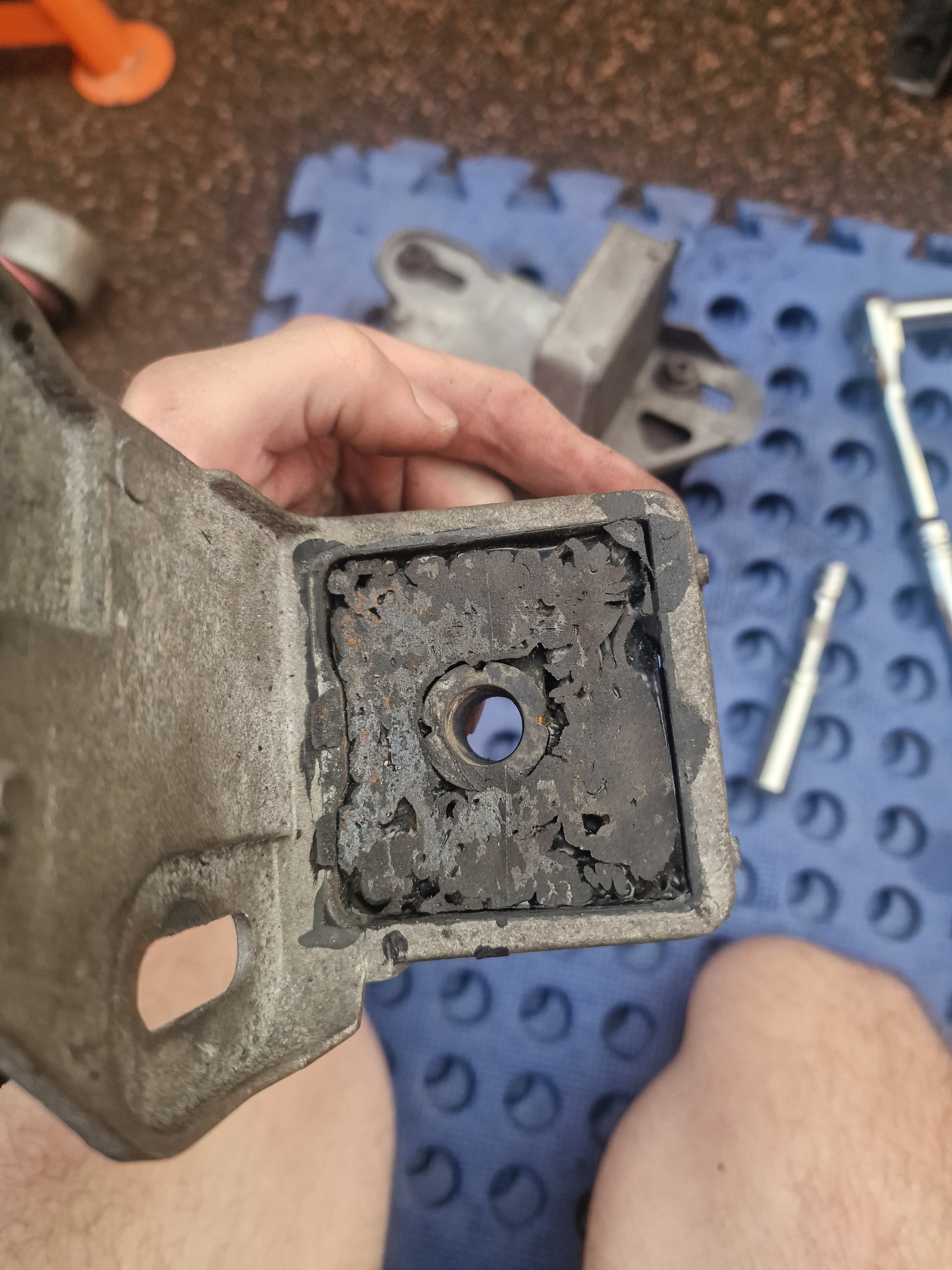

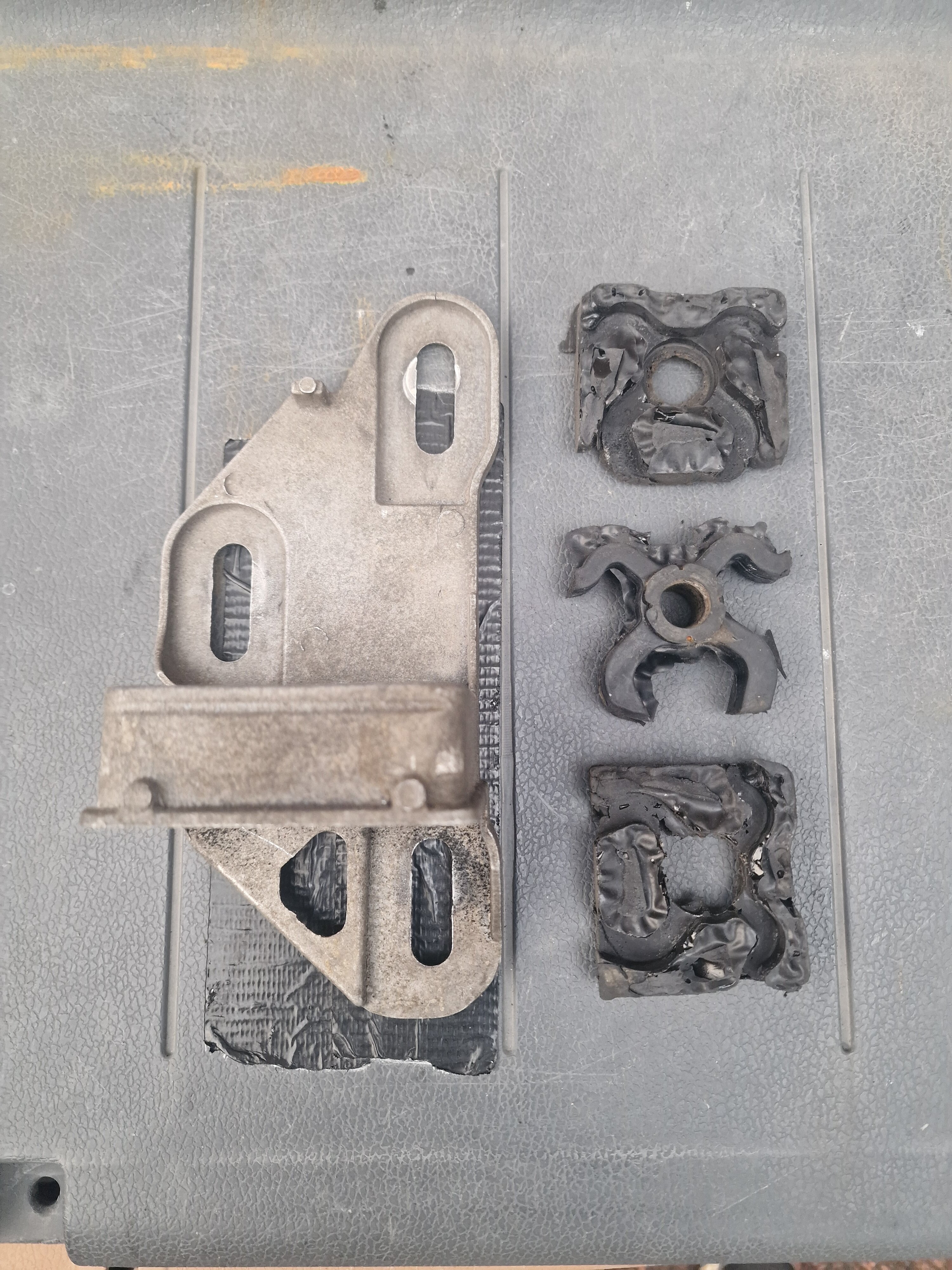

Alot of the bolts were quite rusty holding the hanger mounts to the car but alot of wd-40 later they all came off. The hangers had previously been worked on by someone, they were standard but had been diy'd to look like a powerflex style bush but it wasn't great and once cut out came apart very easily. Very glad I replaced them for some proper bushes.
I cut out the majority of the bush material and then used a flat head and a hammer to remove the remains around the edges and then a file clean up the final bits. Having spent a decent amount of time cleaning them up I was happy with the finish and went to put the gram bushes in only to find out these weren't genuine hangers! And they wouldn't fit properly 🫣 so I had to start the whole thing again and I ordered 2 used genuine hangers off eBay.
Lesson learned always check parts if they are genuine! Especially on old cars like these. I hope I don't make this mistake again 😂

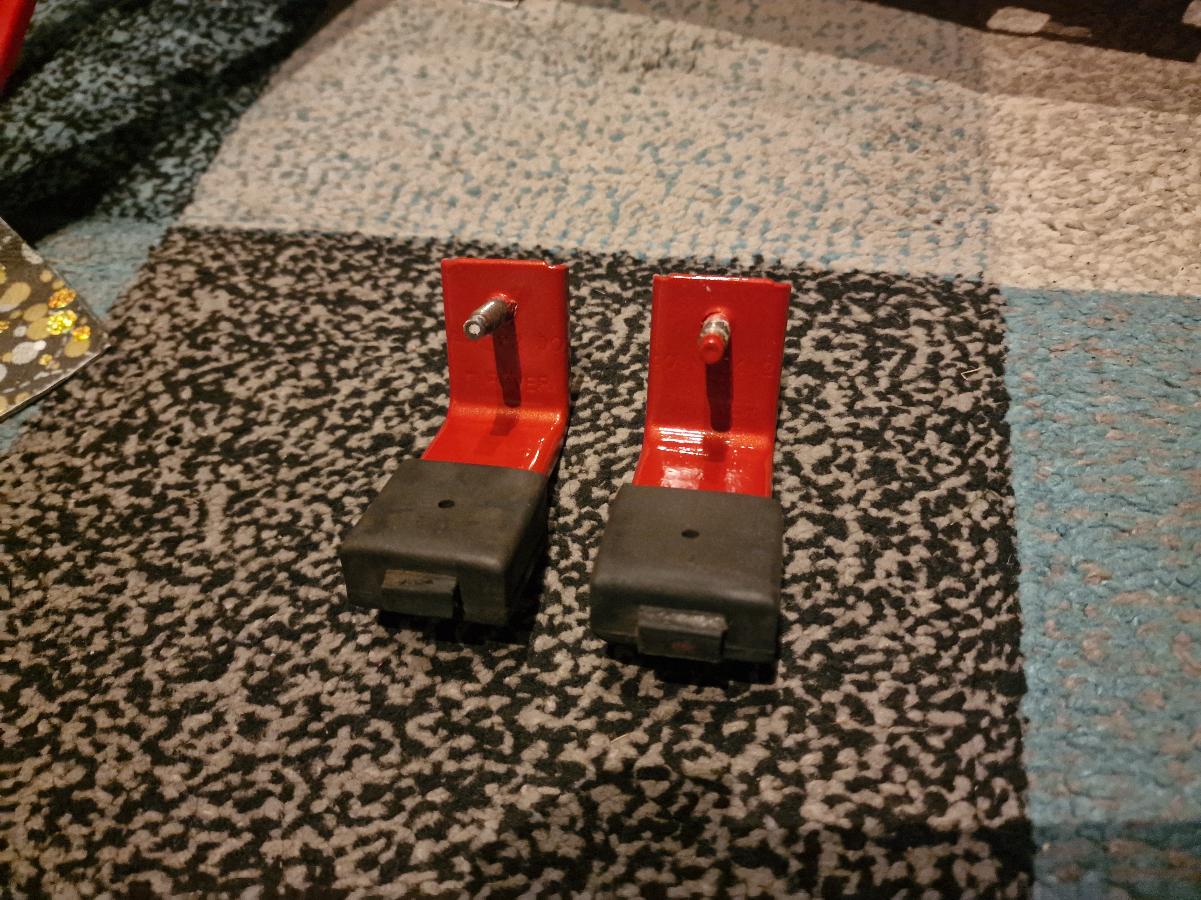

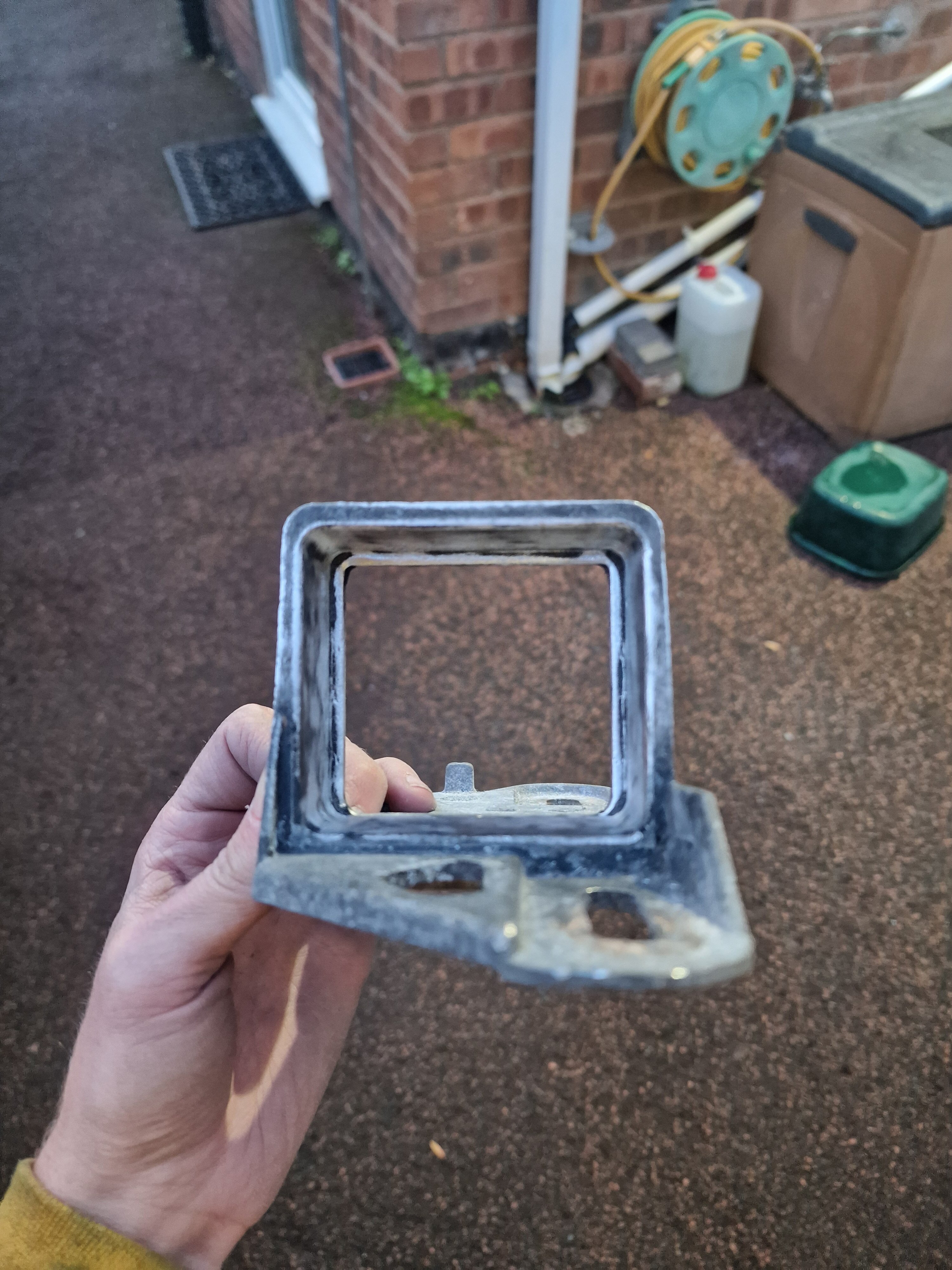

New hangers arrived a few days later and I set about cleaning them up. AGAIN 😬 this time it was easier and I'd learnt how to do it better. So I cut the main hanger out and then used a combination of the flat head, hammer and a wire wheel on a drill to clean them up and they were done much quicker.
Then I got to fitting the new bushes and test fitting them all onto the car which all went smoothly.
Knowing it all fitted, I put the new middle exhaust hanger on the car and set about tidying up the exhaust surrounds on the rear bumper. I took inspiration/copied Mr Underhill's idea of using the rubber edging and it worked perfectly and looks miles better than the old plastic that was on there as the old ones were white and wouldn't clean up but I've kept them to try and bring them back to life later down the line.

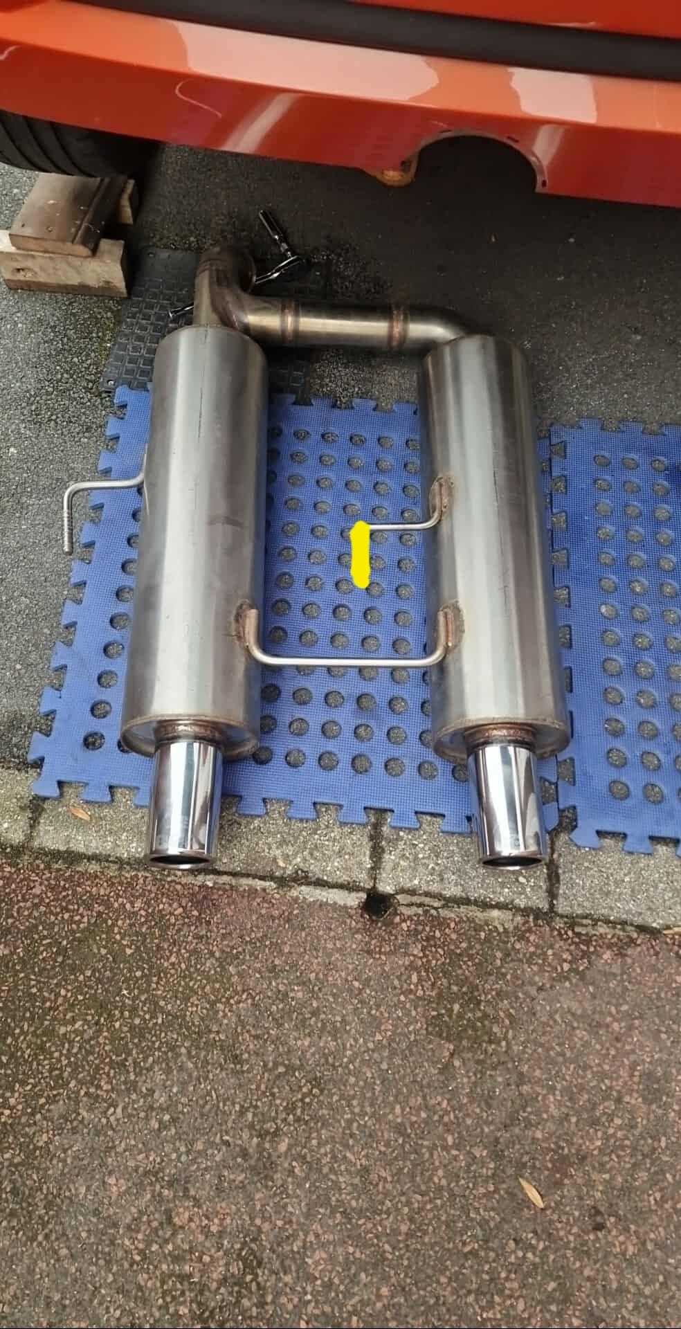

I then went to fit the new exhaust. This is where it goes down hill again 🙃 the new exhaust is missing part of the metal rod that would sit inside the hanger, it doesn't look to be cut off it looks to have been manufactured this way so the car it came off must have had a different hanger setup which I wasn't aware was a thing.
In the picture below the yellow line is what is missing
So after all this work to fit the new exhaust I ended up refitting the current ktec system to the car (in the rain which was not fun) and I now have another job on the list to manufacture and weld a new hanger to the back box and get the exhaust on the car.
But overall the exhaust sits much better and there is less rattle so it's a positive and I've cleaned the car up which is the never ending goal. (I don't have a photo of the finished result 🙃)

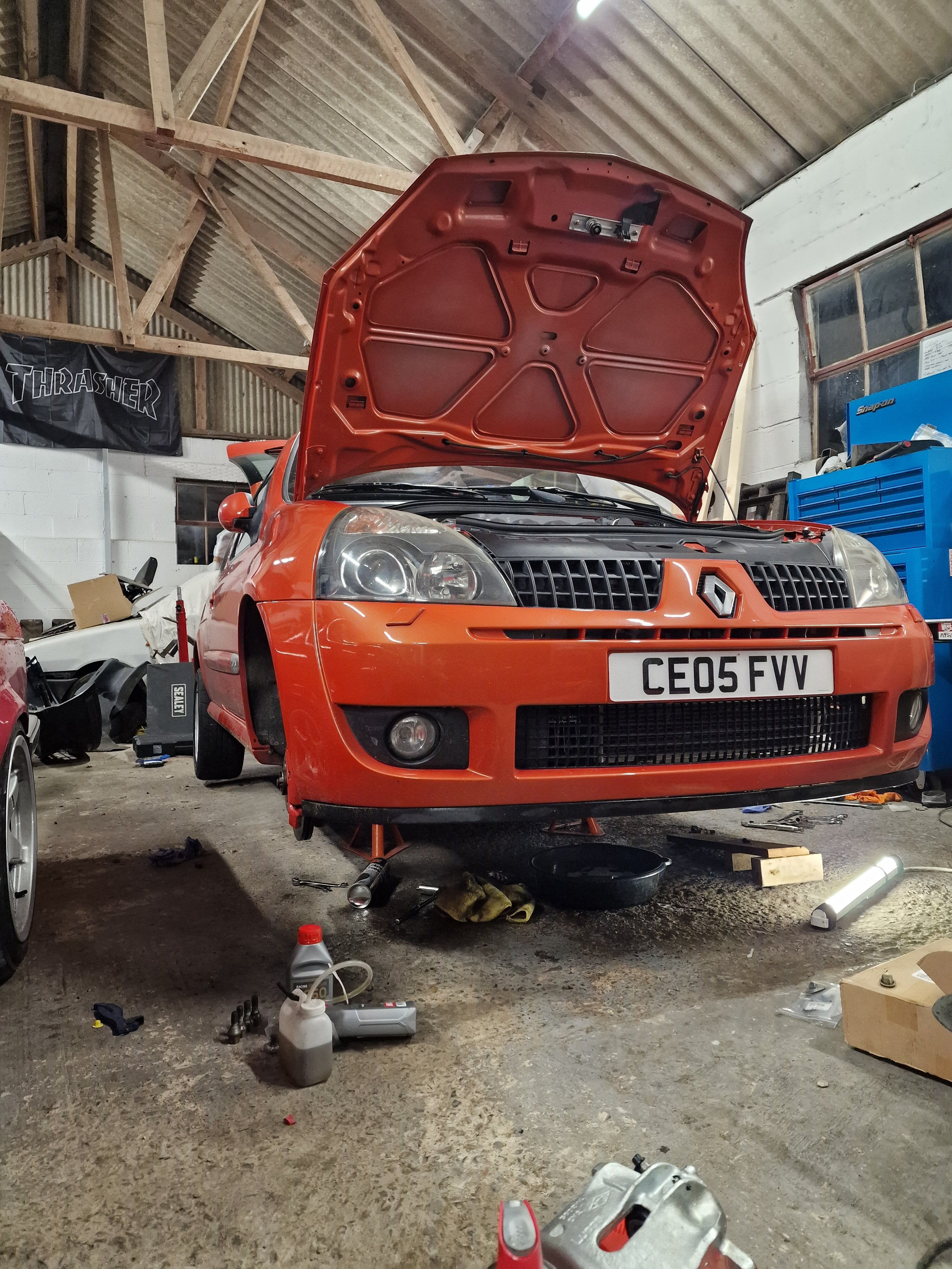

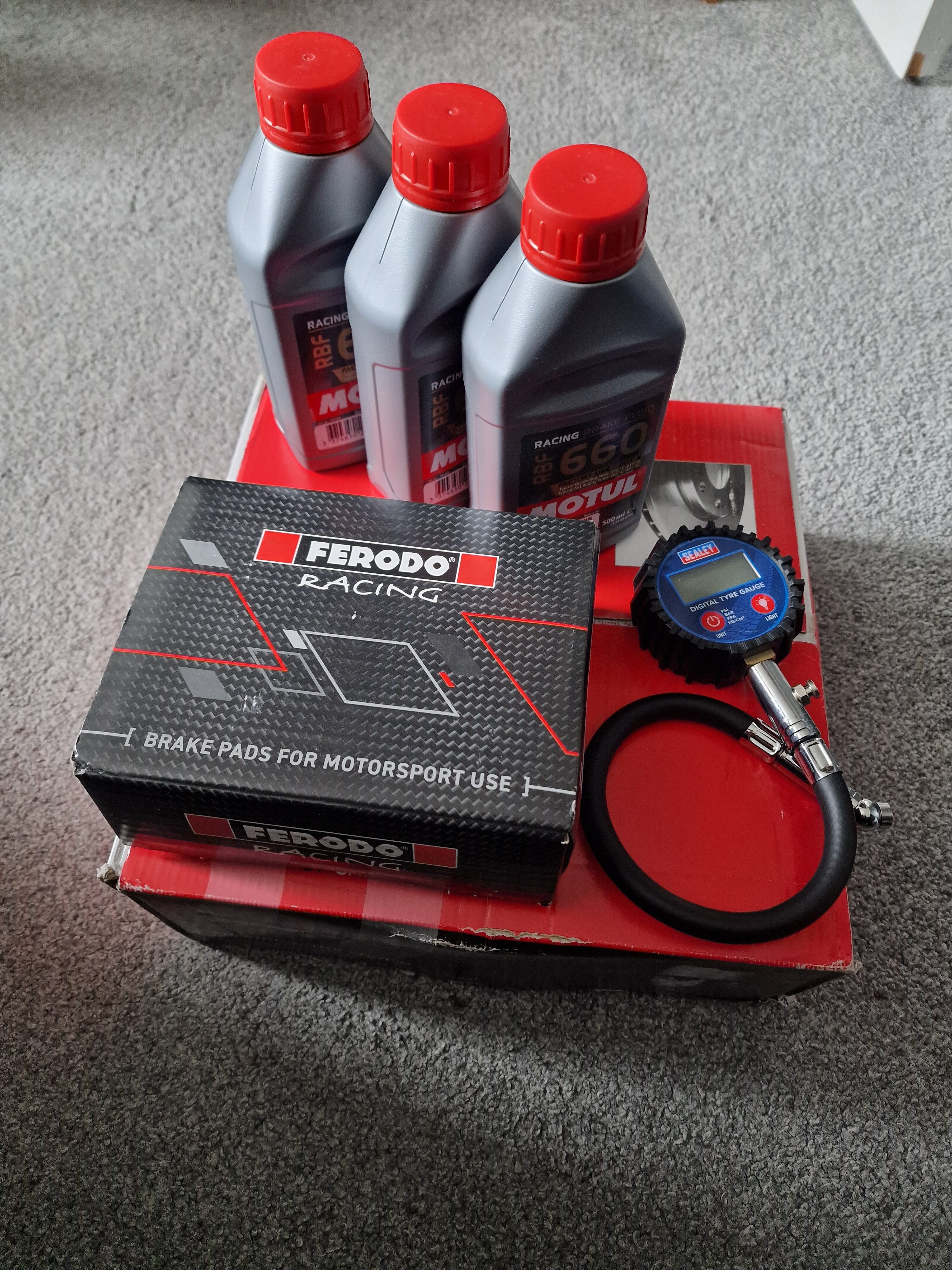

Gearbox oil change
New front brake discs - Brembo High Carbon
New front brake pads - Ferodo DS2500
Brake bleed & flush using RBF 660 fluid

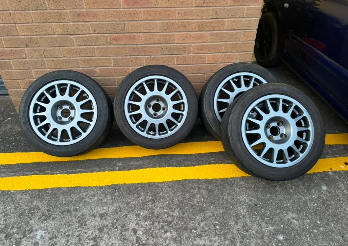

Swap over to my mates wheels & tyres (RPF1's with AD08r's on)
These sounded like relatively simple jobs to sort in time but I ended up leaving the jobs fairly late due to being busy (including working on a go kart which I need to start another thread on) so with 2 weeks to go before the trackday I began work on the brakes and of course they did not go to plan

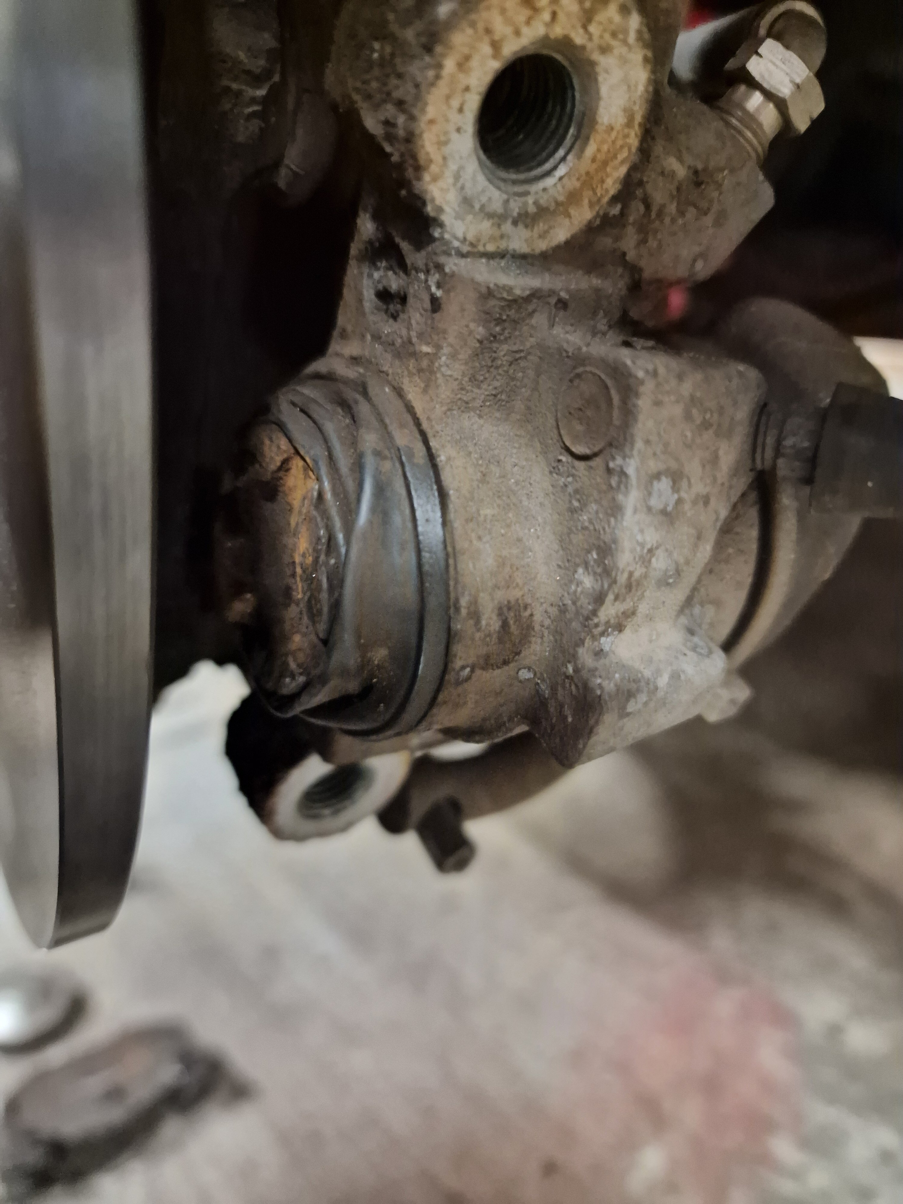

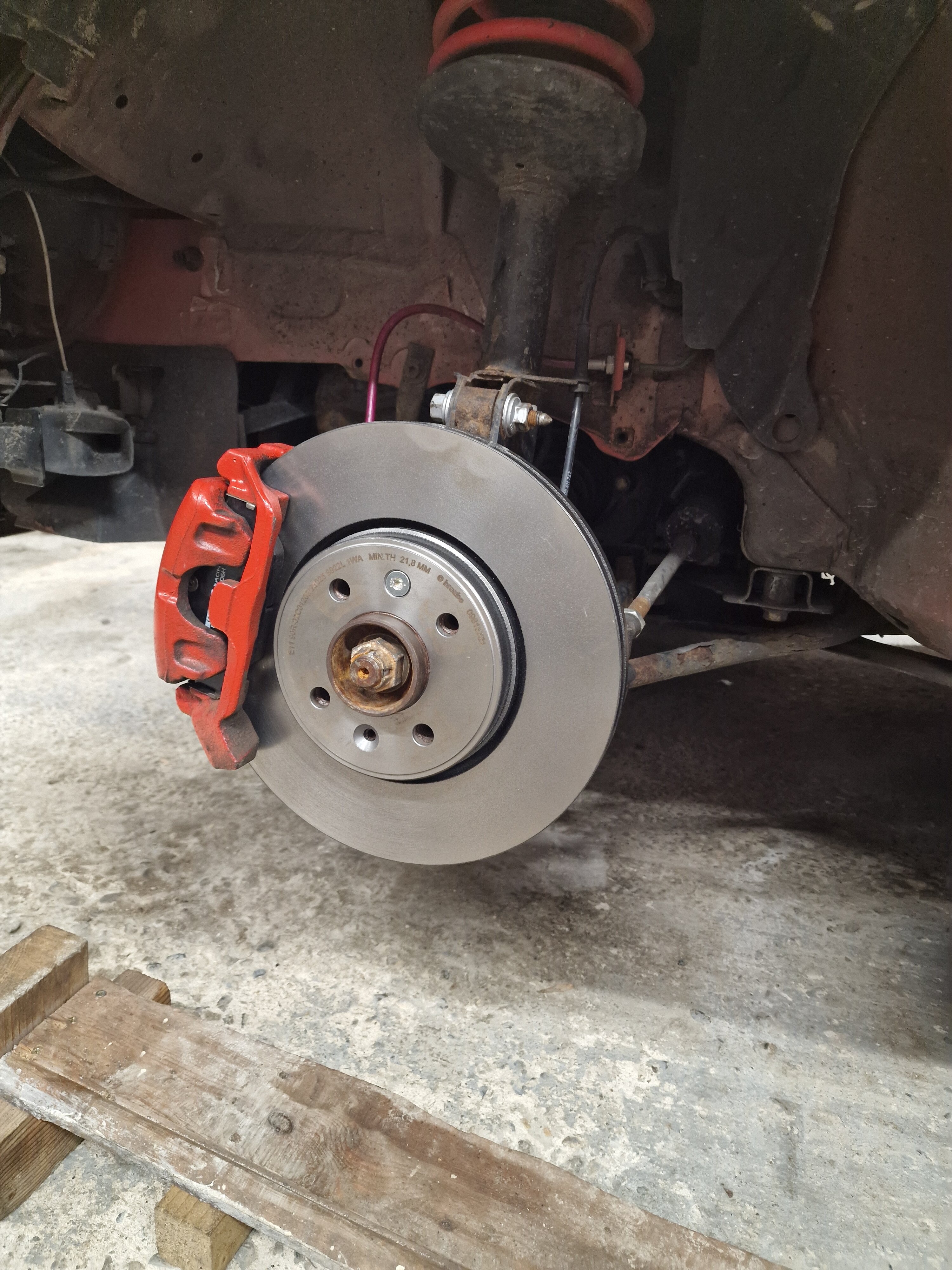

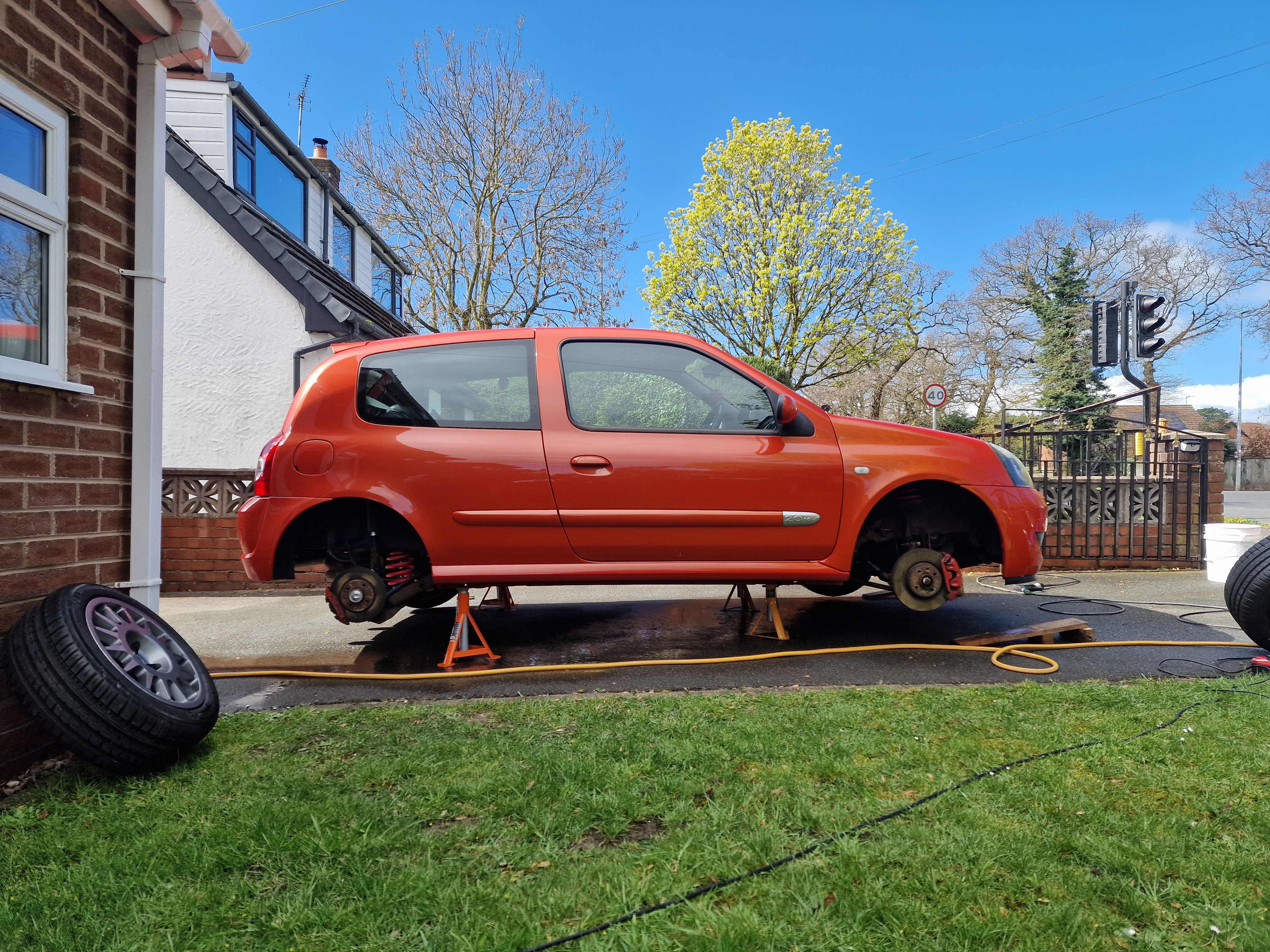

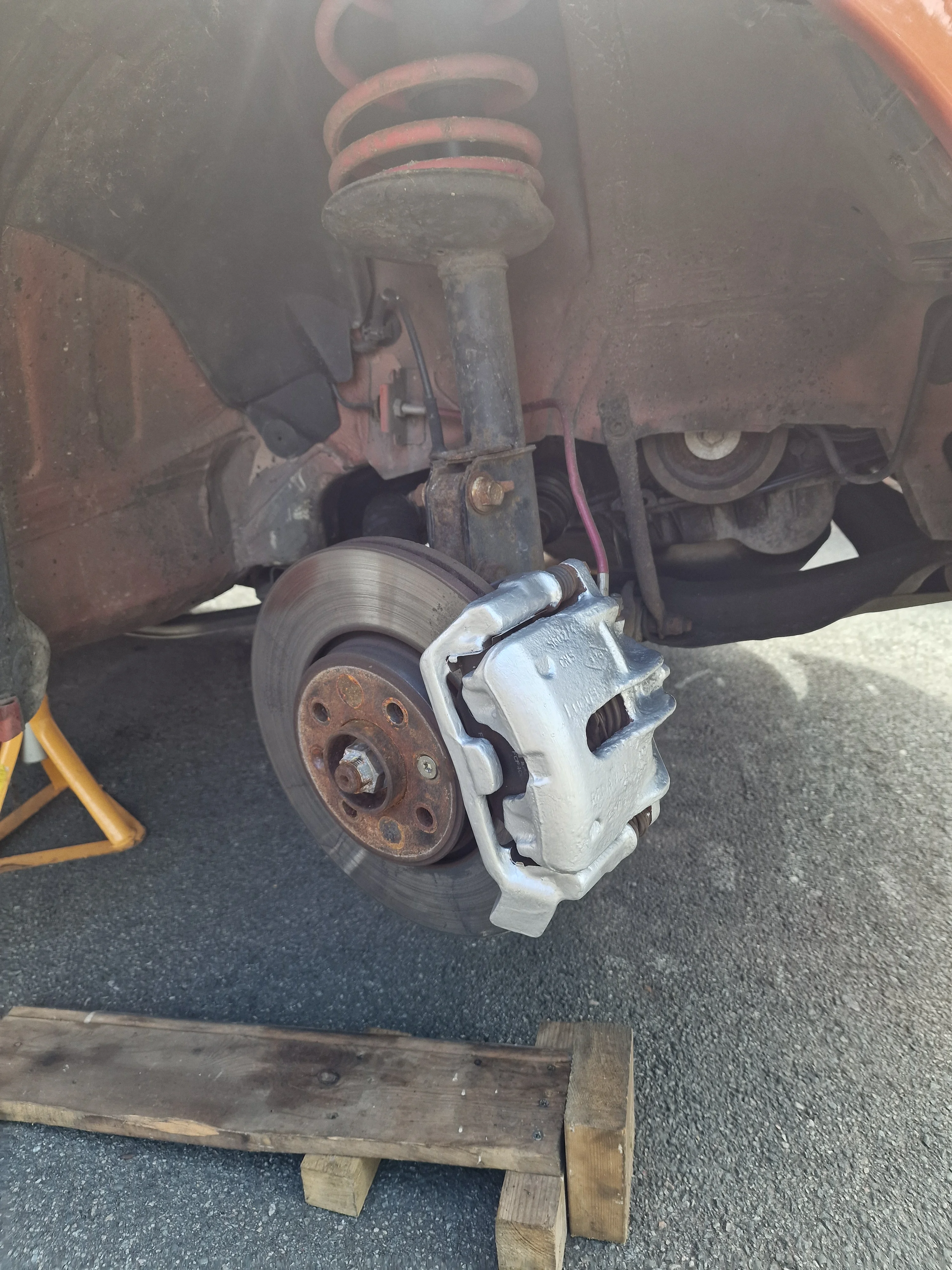

Front brakes came off somewhat easily other than the passenger side caliper being seized so I ordered a set of new replacement calipers for both sides on the front (TRW / Lucas variation as this is the OEM manufacturer). So I buttoned the front up temporarily to come back to the following week as I still needed the car.

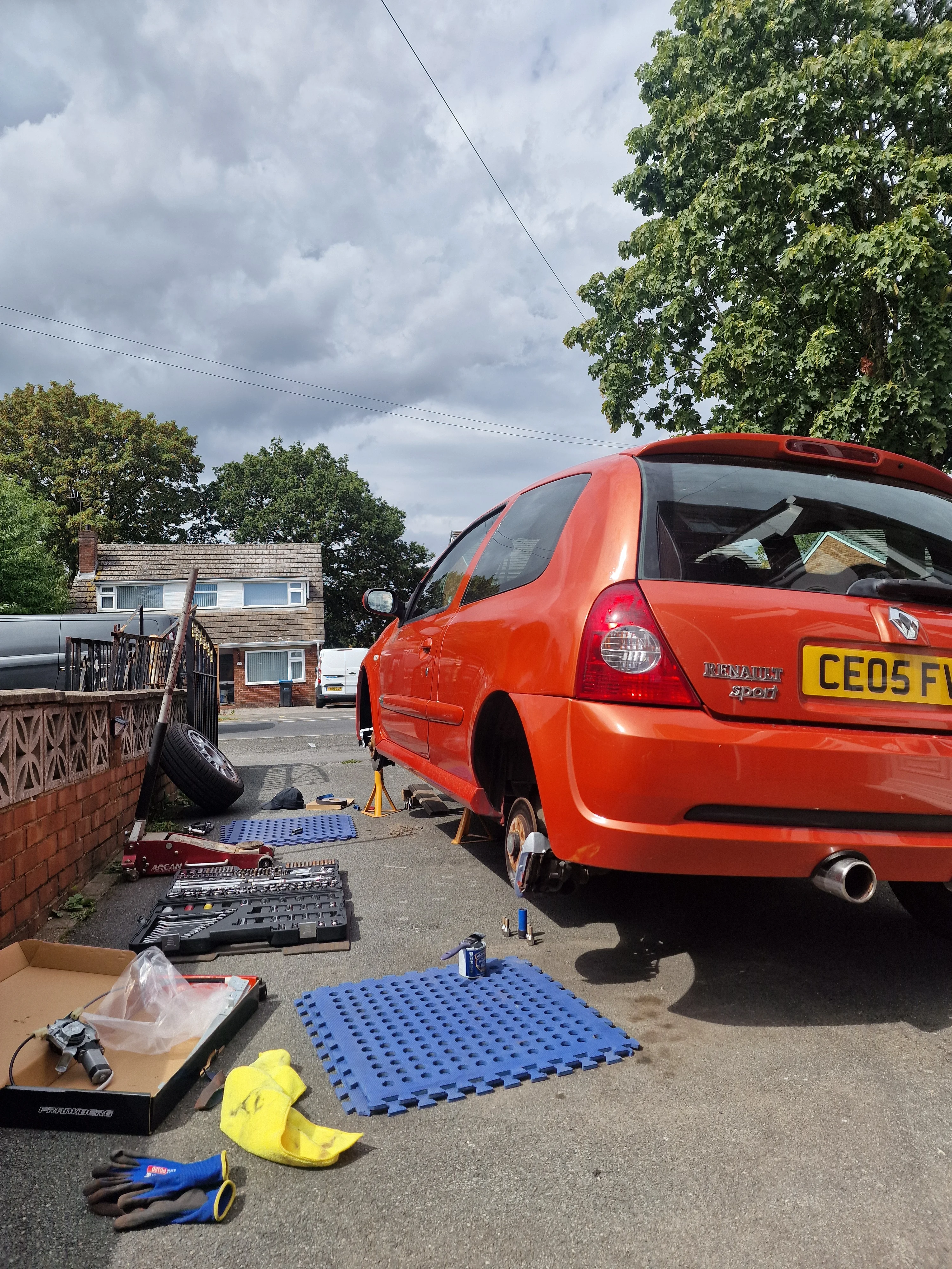

Then while I was doing the front brakes I was suggested to do the rears as I had rear discs sitting in the garage, so I bought a set of brembo rear pads from euro car parts and hoped these would be easy. The rears wen't on fairly easily but the rubber seals on the sliding pins and piston were perished or torn so I needed a rebuild kit to fix them. So again I buttoned the rears up temporarily while I waited on the big red rebuild kit.
As you do while I was waiting on the brake parts to arrive I was thinking of what else I could do and thought it would be a shame to leave the pair of bucket seats from my old twingo out of the car. It was like it was meant to be, I found an OMP drivers base on Facebook marketplace in Llandudno cheap and I was passing by there later that week so it would have been rude not to go pick it up. 1 OMP base purchase later I went about fitting the bucket seat to the Clio using the hardware from the Twingo as in this area they're basically identical. However, as I have read on here previously the OMP bases sit quite high so I spent many hours in the dark on the drive adjusting and readjusting on different side mounts to try and get a good seating position. Eventually I did get one all be it abit too high for long term use but good enough for the trackday. The OMP mount will be sold at somepoint and replaced with Jon Fozz mounts to get the right seating position (when I have another car and can put bucket seats in permanently)

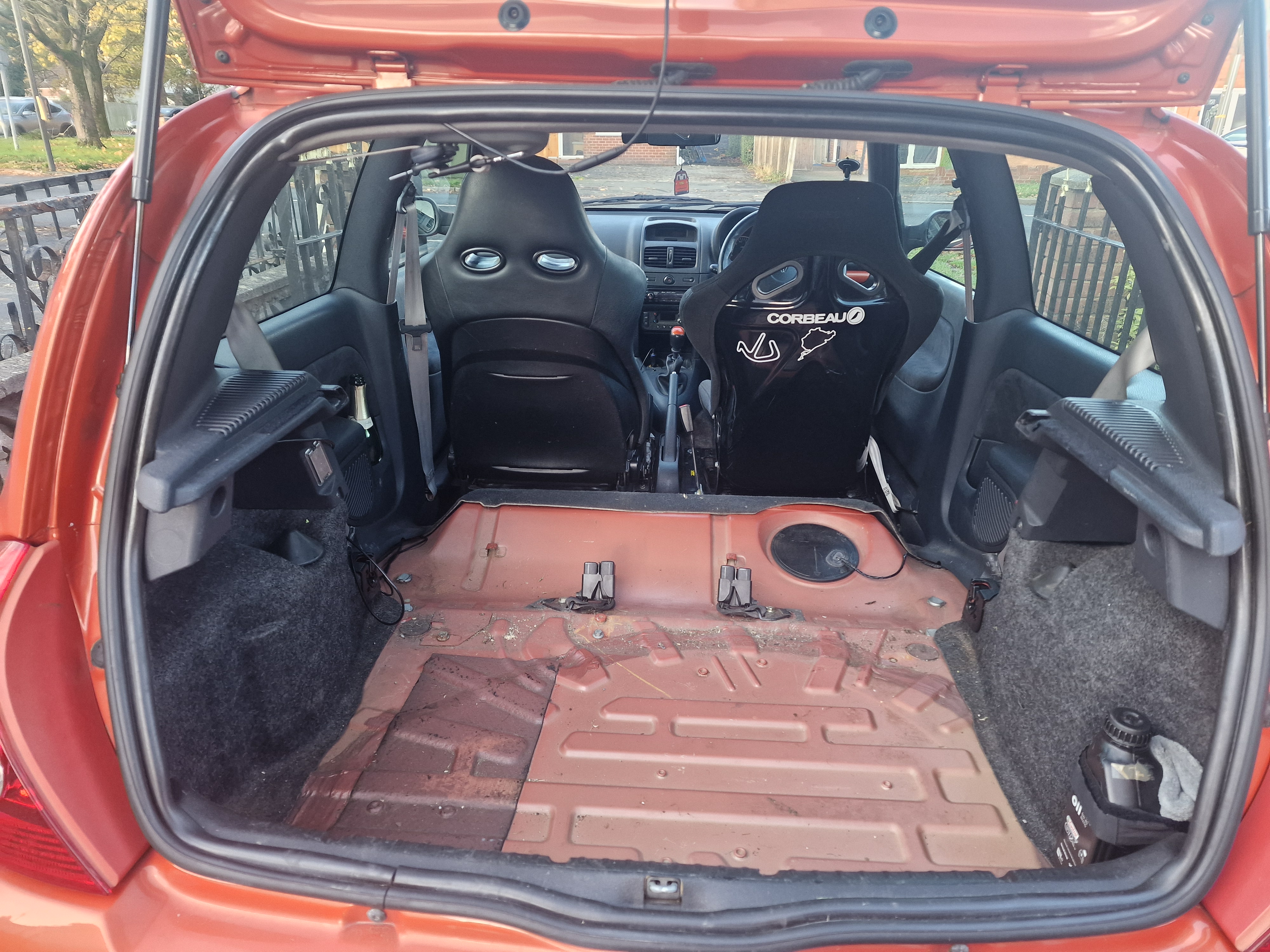

But I wasn't done there, I got bored waiting to do the brakes and thought the rear seats were useless so I removed the rear seats, boot carpet and parcel shelf. This made driving round in the car a very loud experience but I don't mind cos its all abit of fun.
Having done all these extra jobs we now get to Tuesday the week of the trackday and the parts have arrived. I fix the rear brakes using just the rubber seals from the rebuild kit and then bleed the rear brakes with the help of a friend (I just pushed the pedal)
Then I go to fit the front brake calipers but the new drivers side caliper destroyed the threads on the braided brake line and inside itself meaning I couldn't refit the old caliper. Not what you need the week of a trackday, slight panic set in while I tried to find replacement lines at 10pm on a Tuesday night that I could fit on Wednesday. I resorted to ordering a tap & die kit from amazon for the next day delivery in size m10x1 (the size of the thread on the brake lines, Cliosport coming in clutch with this information) with a backup set of front HEL braided lines being ordered for delivery later in the week just in case. Coming back the next day with tap and die kit in hand and luckily for me the kit saved the day. It took about 45 minutes of trying to persuade the die onto the brake line threads but I managed to get purchase and gently managed to rebuild the threads. So after all of that the old caliper was placed back on the car with the new one firmly going back to the supplier under warranty. Alot of hassle to have got no further forwards but ah well.
The passenger side caliper went on a breeze in comparison and then we bled the front calipers (me on the pedal again)
Last job being a gearbox oil change which was simple enough and 3ltrs later the gearbox definitely feels better.
Mates wheels on and the car was ready for the trackday (baring a clean) with 2 days to spare! And of course to finish my collection of jobs going wrong I had to wash the car in the rain as I had no other time.

  • Drivers side bucket seat fitted
  • Rear seats & boot interior removed
  • RPF1's & AD08r's borrowed & fitted

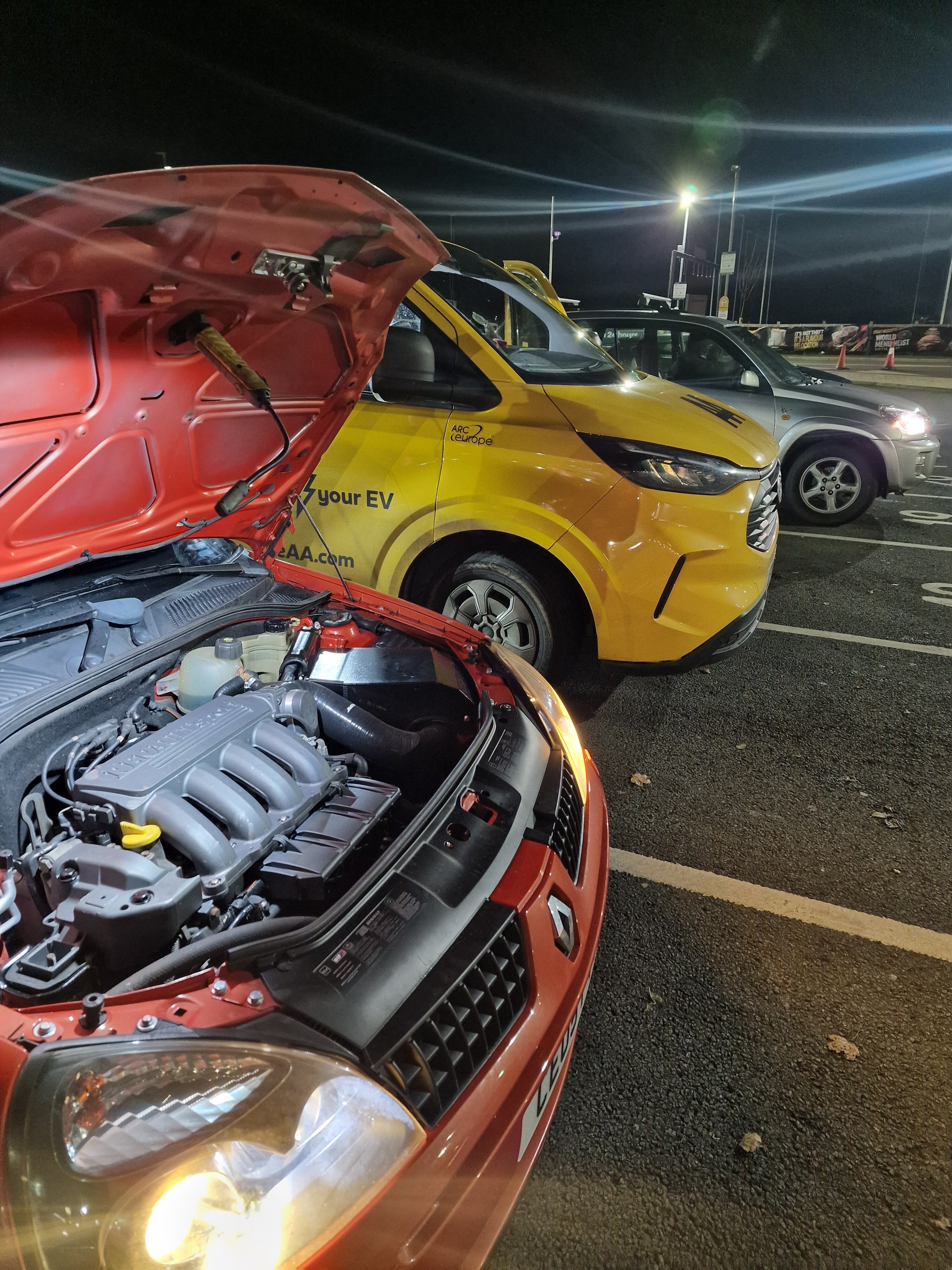

Clio started juddering on the motorway on the way back from a weekend away in York but the misfire light wasn't illuminated on the dash so I thought it could be fuel as it was getting low but as I pulled off to get fuel I got the misfire light but only for a few seconds and then it cleared which was odd. So I brimmed the tank just in case but it only got worse. So stopped in a services had a quick look under the bonnet for anything obvious which there wasn't and decided to just phone the AA.
Luckily we only waited about 1.5hrs for them to arrive and we got the nicest AA guy ever, he checked everything he could but there was no obvious issues or reasons for the juddering so he followed us for a while on the dual carriage way to see if it persisted which unfortunately it did and so he dug further at another services. All he could figure out was he reckoned it was cylinder 2 and it could be a HT lead. So with no obvious fix I limped the car back home and set about finding a solution.

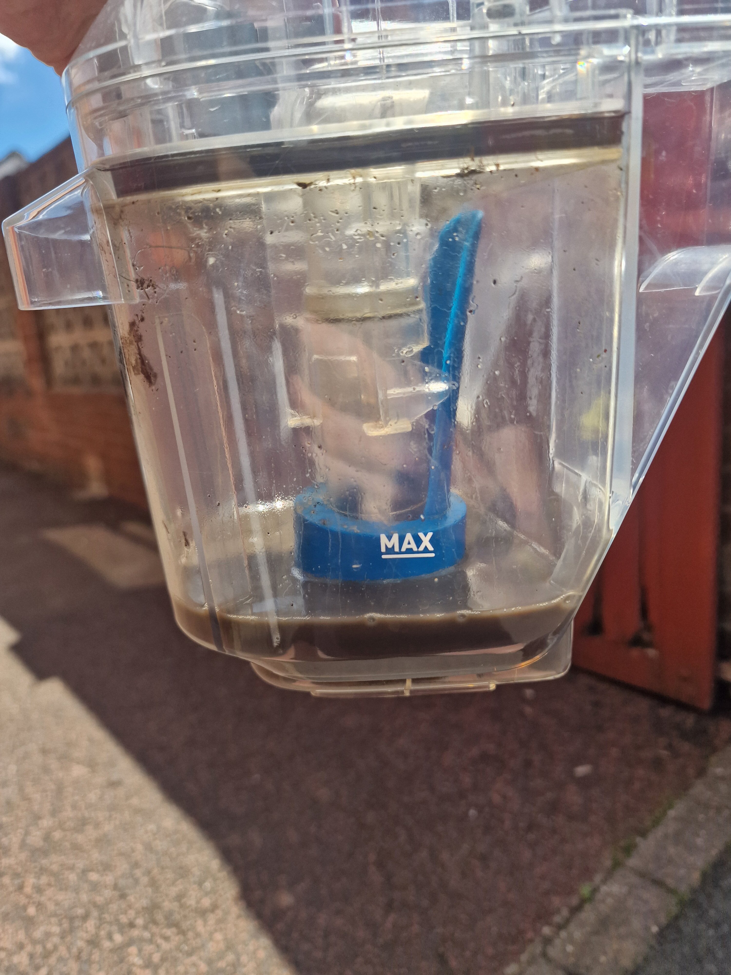

5. Been looking at getting a wet vac for ages and my GF bought one for me so spent some time cleaning the seats, carpets & mats in the Clio. The amount of dirt that came out was very satisfying

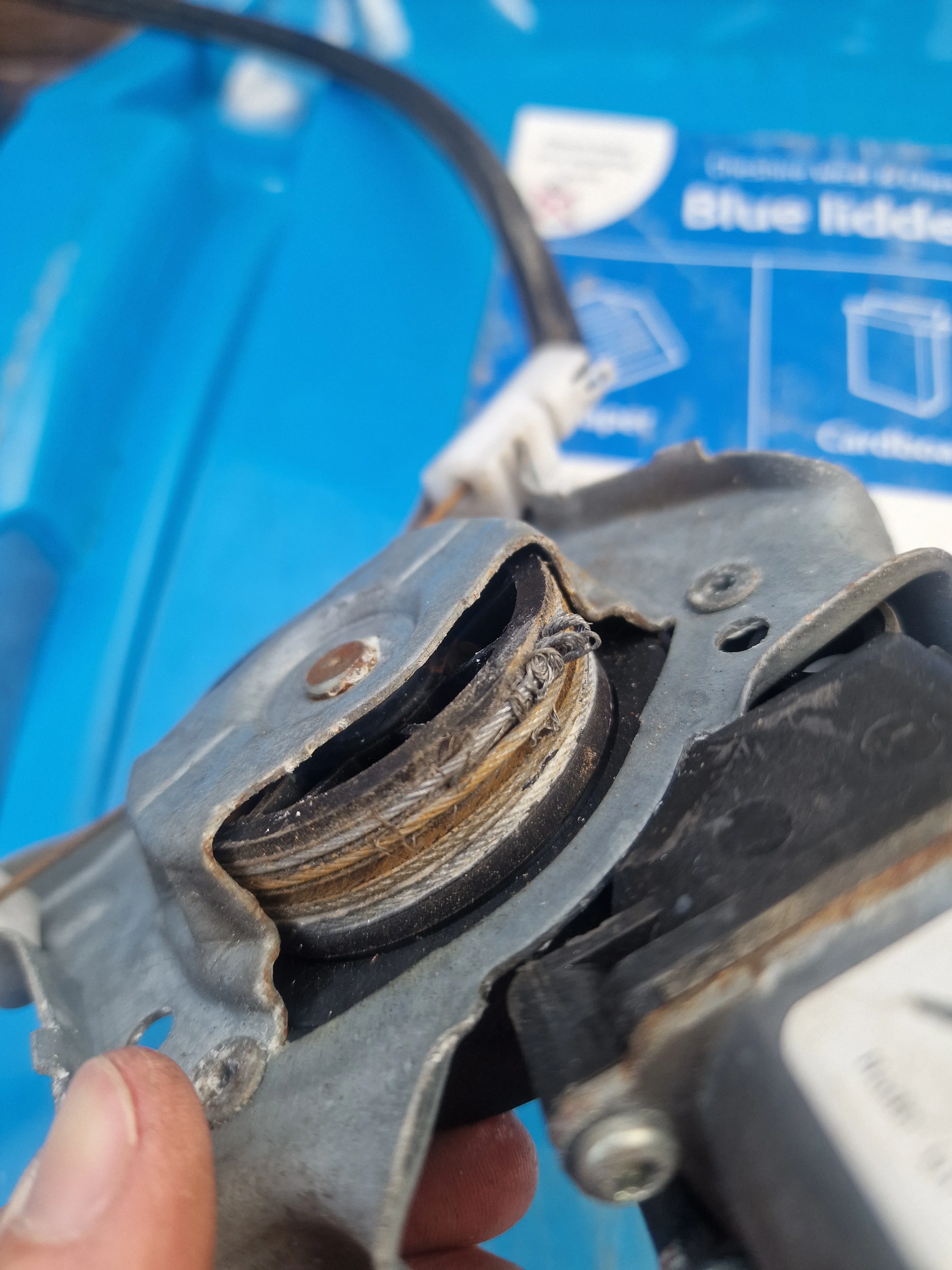

Now onto the little issue the Clio has had over the last few months. While on our way to the Cotswolds the passenger window went down but wouldn't come back up. After some gentle persuasion (me pulling the window back up while my GF pressed the window switch) we got the window closed and didn't dare try it again. Once back home I took a look and it seemed the window would go down but not up. So after some googling and reading some threads I presumed it was the window regulator. I took the door apart to take a closer look before ordering the part but nothing seems obviously broken. So I tried the window again and the problem has changed now the window will go down and up but only by a very small amount and then just stops.
I've felt the guides at the front and back of the window and the runner for the window regulator all seem free and clean. I suspect its a faulty window regulator but wondered if anyone had experienced this or had any advice as the problem keeps on changing.

Fixed the passenger window, turned out it was the regulator as can be seen when I got the old one out

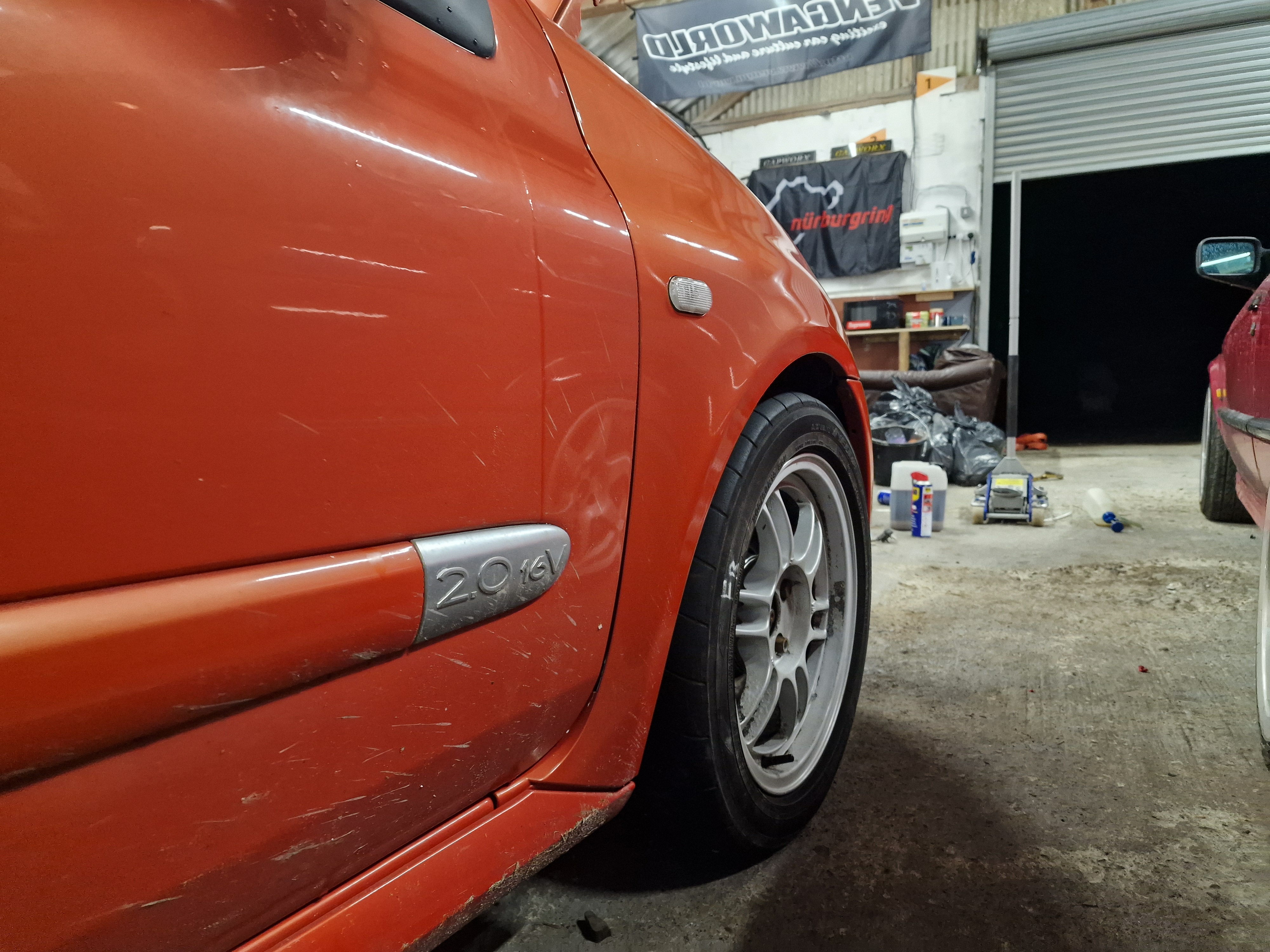

Fixed the wheel fitment at the front with 16mm hub centric wheel spacers. Never ran spacers before but the 2118's are et38 and as can be seen didn't fill the arch so spacers were the only option.
Before
After

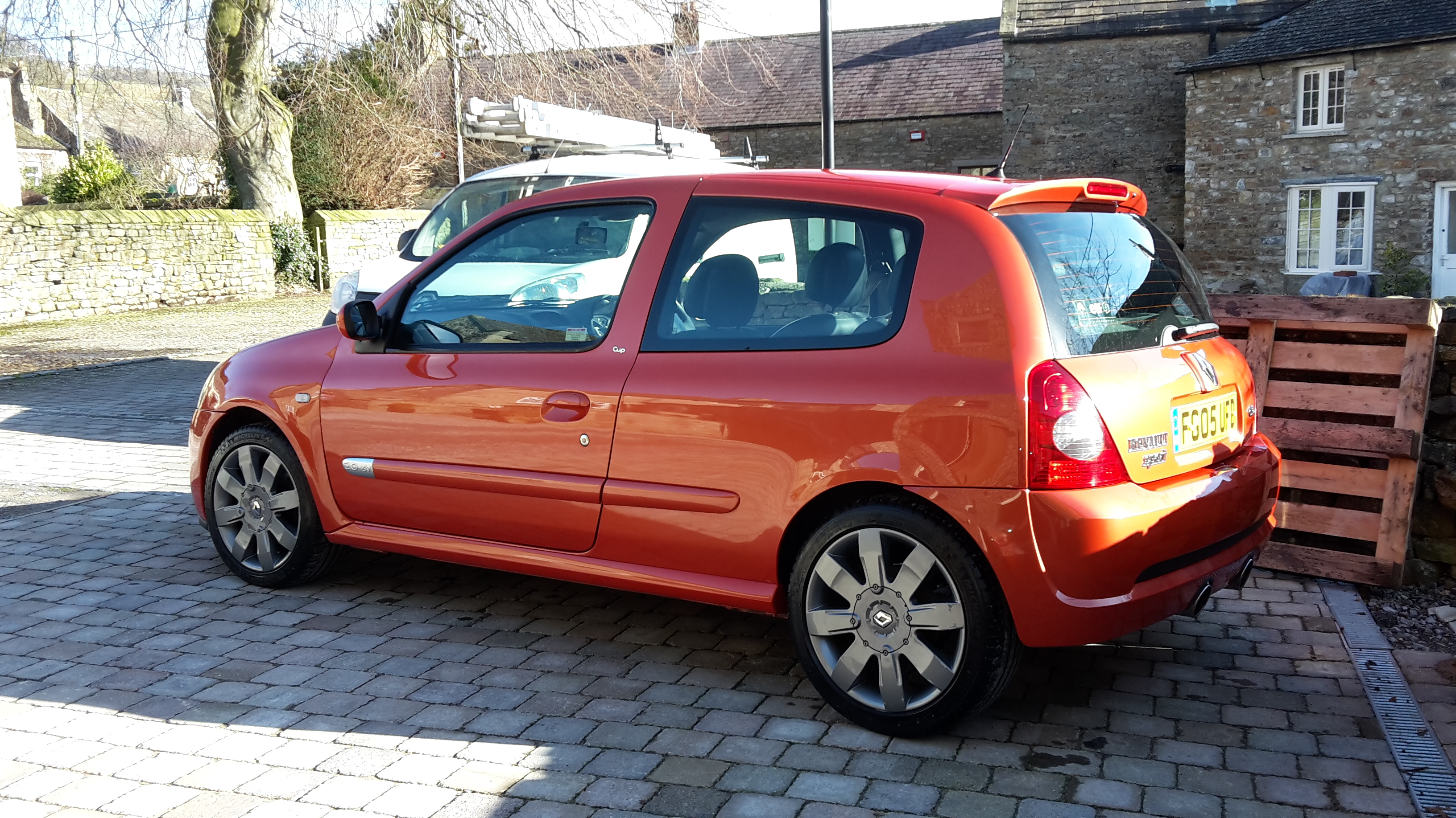

Took the Clio to Prestatyn Classic Car show again this year. It probably doesn't classify as a classic but its good fun.
Joined in on the drive out on the Sunday which was a great blast haven't driven the Clio just for fun in a while. 107 miles through North Wales starting at Prestatyn through Rhuddlan, St Asaph and Denbigh before a lunch stop at GYG Kart circuit and then going through Bala, Llandrillo, Corwen, Llangollen, Ruthin, Denbigh, St Asaph, Rhuddlan and back to Prestatyn. Some lovely roads to drive on and some brilliant company from a range of different classic cars.

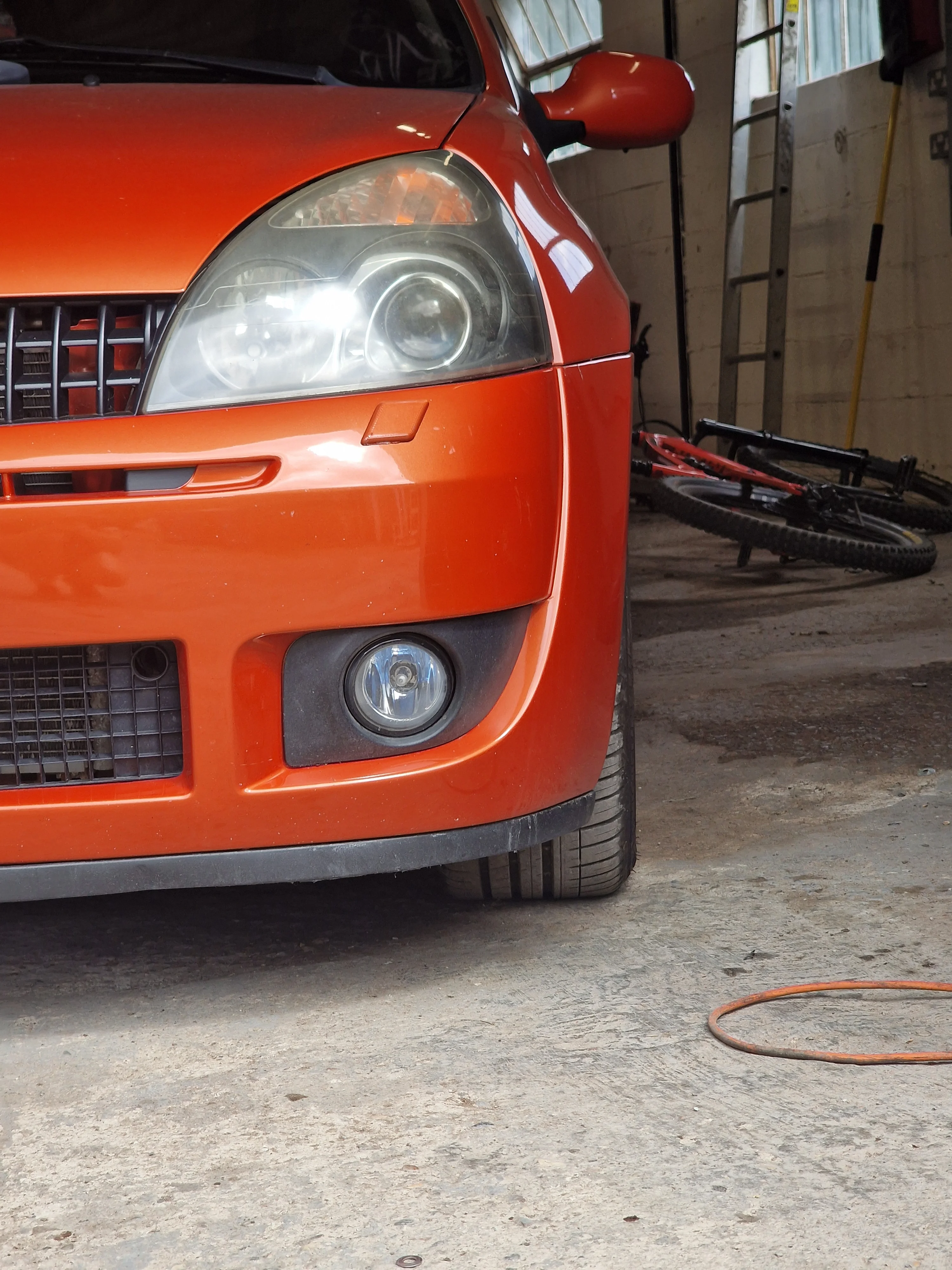

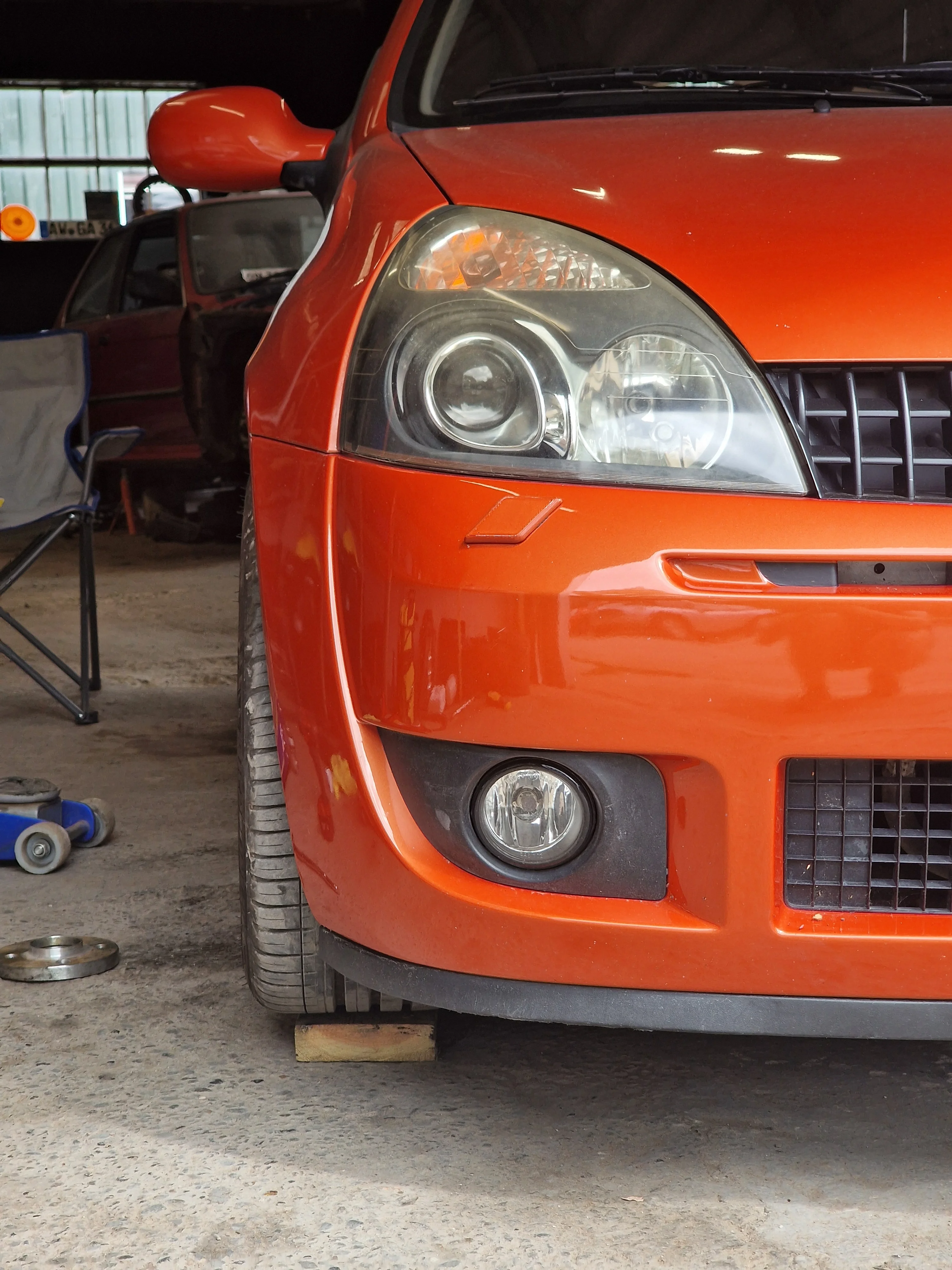

Had to give the headlights a polish before the event as they have gone yellow again but a quick polish and they are good to go with wax and sealant applied. (I forgot to get a before photo but here is the after)
