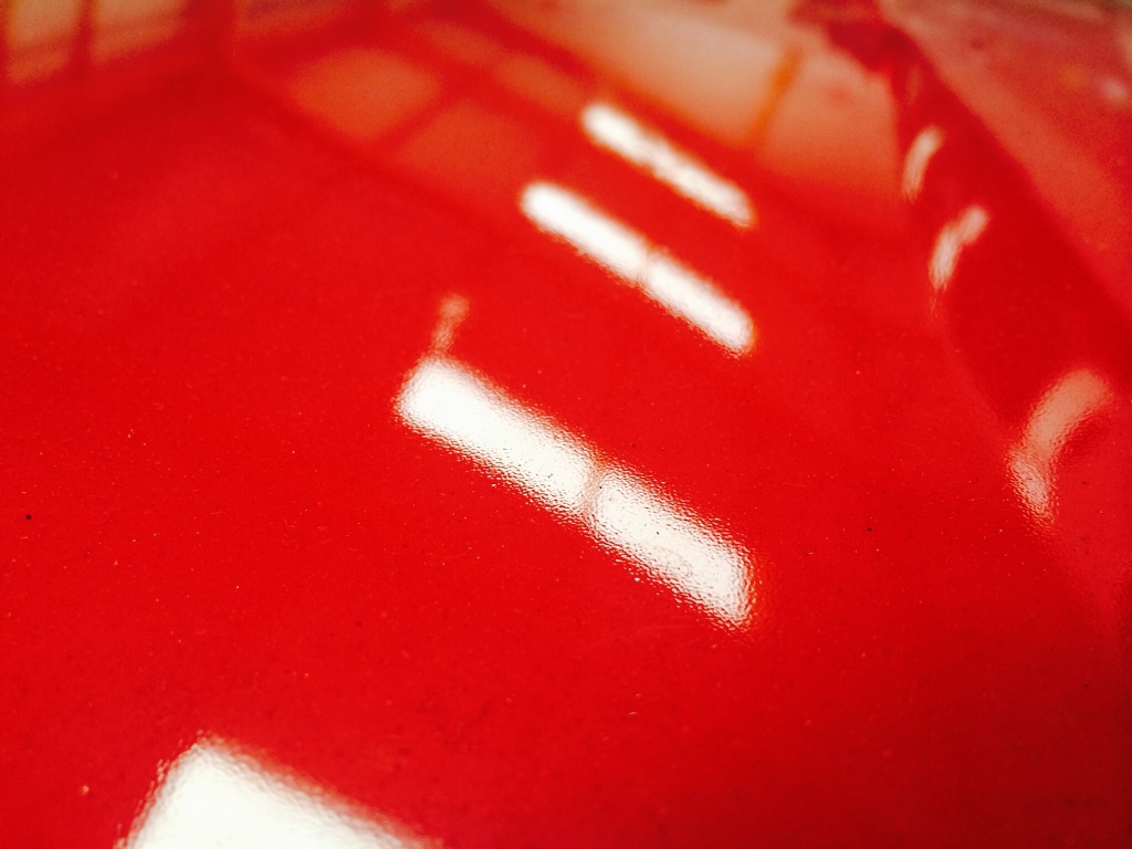

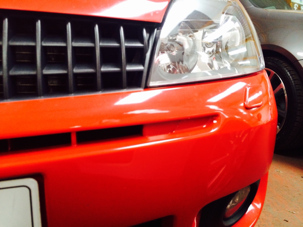

-The front end has been sprayed, badly. (seller claimed it hand't been...)

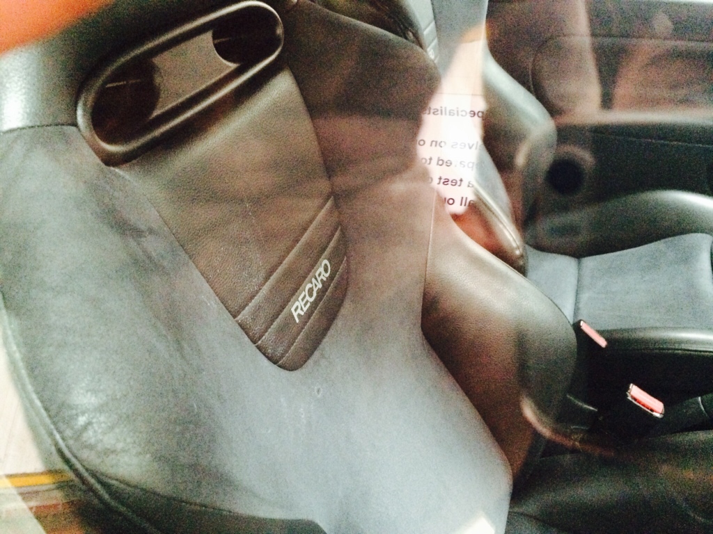

-The seats weren't the best condition with stains.

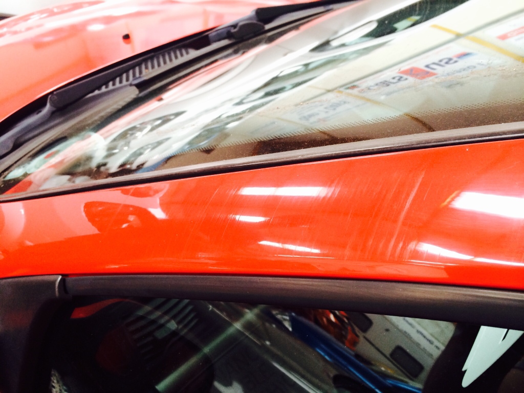

-Paint was flaking from the bonnet.

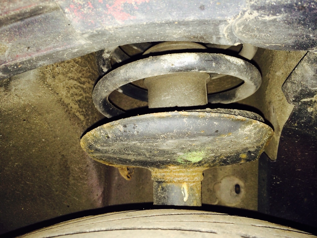

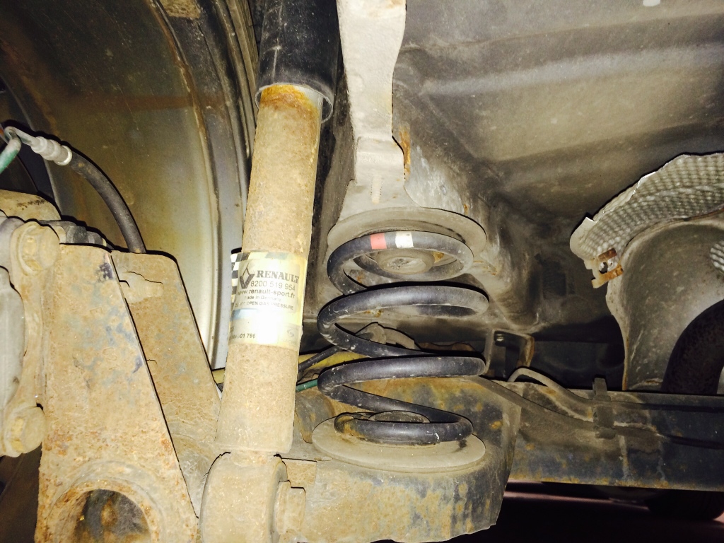

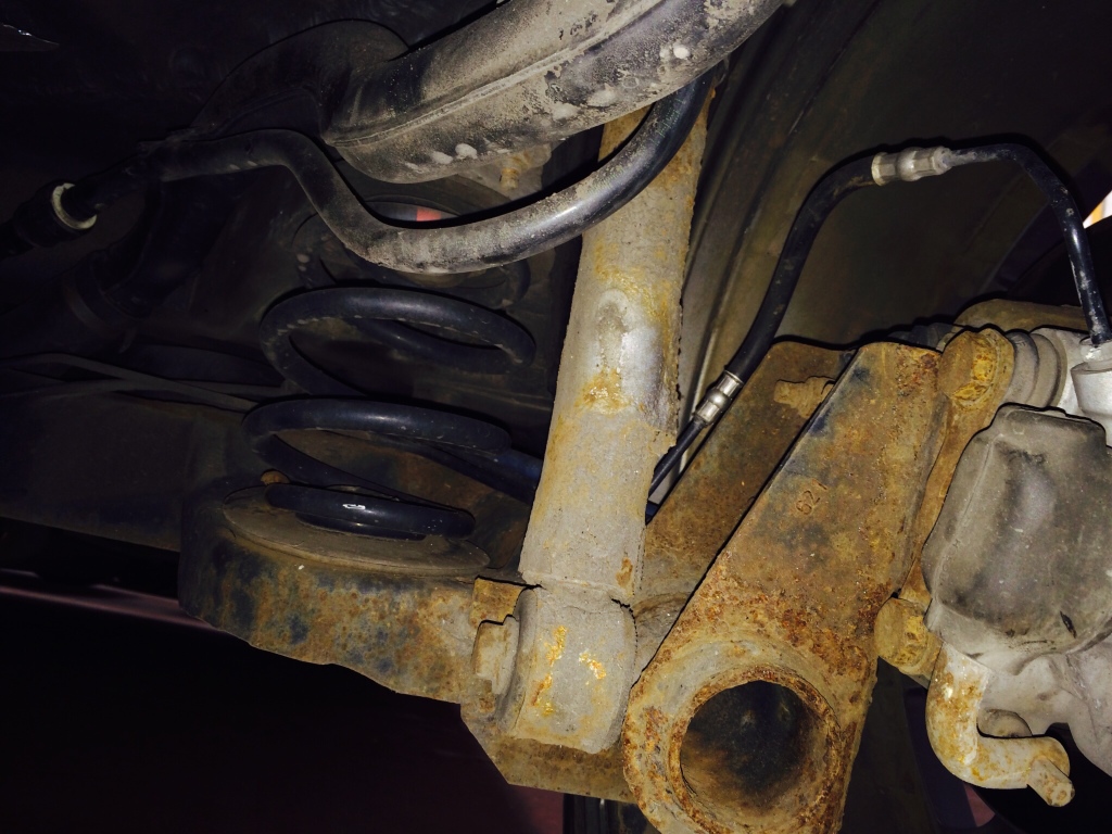

-Suspension looked very corroded.

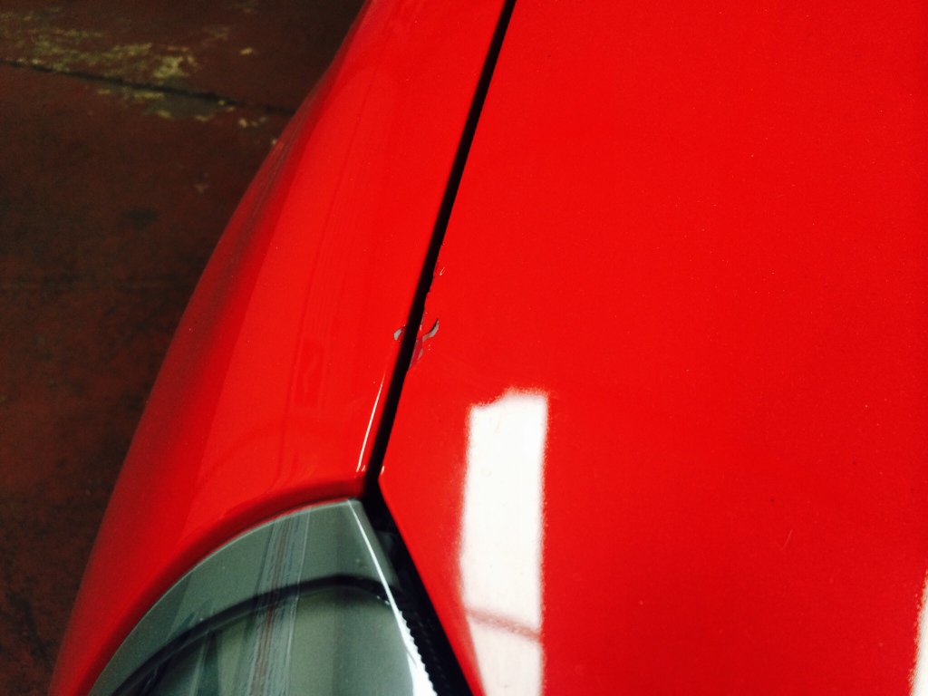

-Paint was chipped where door hits body.

This is very common.
The top corner catches the bodywork slightly.
At the World Series think there were 16 Trophy's most had this, so would not worry about that.

Every clio I've owned has that chip.

Who wants to buy a £4400 car with suspension that needs a refurb, air con fixing and wheels sorting. FYI the suspension refurb will be £400 on a trophy plus unless you buy a set of cup shocks the car will be off the road for two weeks.

I wasn't expecting a car of this age to be perfect but as I'm stood in front of the car asking why it's been resprayed and he tells me it hasn't when it clearly has.... It makes me start to question how genuine the seller is.
Goodj I don't fancy messing with one of five hundred cars and potentially messing it up. Who's to say it hasn't been in a front end unrecorded collision?

Is this at the top corner of the drivers door yes?
Always wondered how that got chipped...
To the best of my knowledge (happy to be corrected) it's from the repeated shutting of the door over time moving the catch on the shell. Eventually it gets moved far enough that the corner of the door contacts the shell. Can be fixed by moving the catch back.

Just had a quick scan and can't see it mentioned but those are not Sachs dampers on the front either, probably cup.
