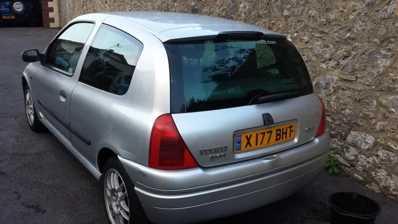

Once a deal was negotiated I set about starting to tidy the car up abit starting with removing a huge rear window sticker of a local garage in Exmouth where the car had come from. I then set about giving the rest of the car a clean and tidy and ordered a new rear exhaust hanger as it was shot.
Heres how it looked when I got it (minus most of the rear window sticker which I`d already started to remove)

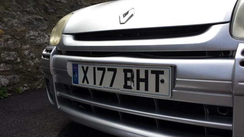

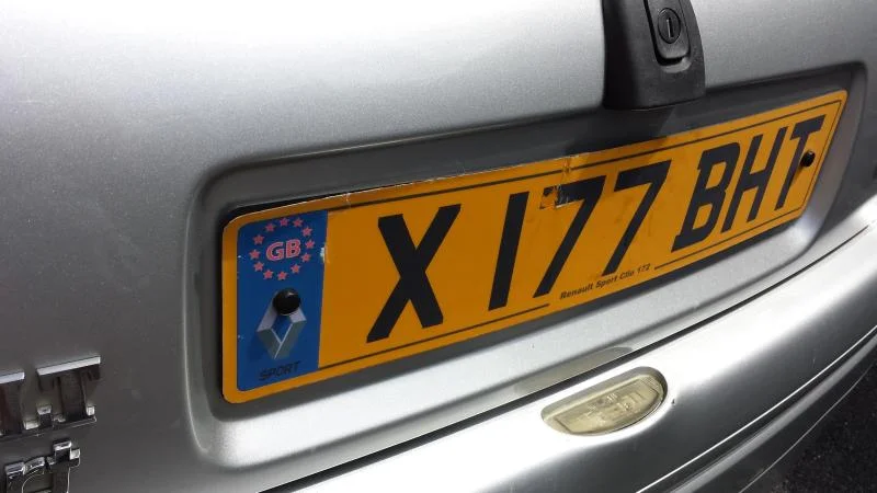

Number plates had seen better days

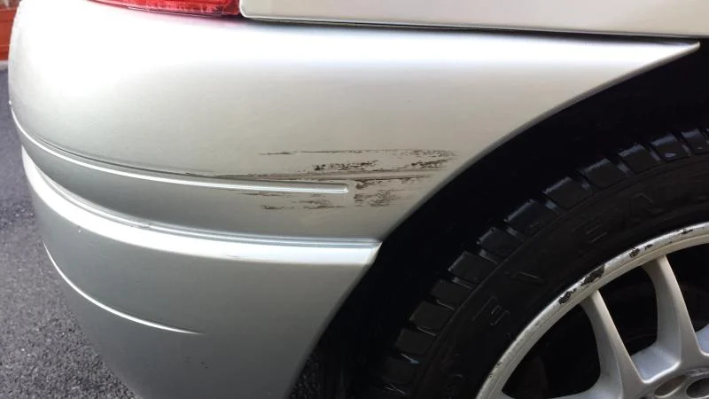

Also had a few scrapes on rear bumper to tidy up

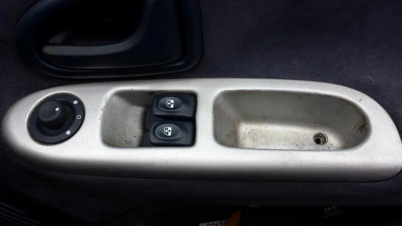

Interior was pretty tidy apart from usual melted steering wheel & slight tear on drivers bolster and a bit of bobbling. But both inner door handles were absolutely disgusting and needed sorting

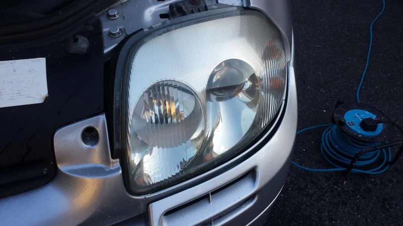

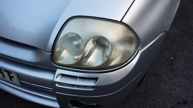

Next jobs to sort was to polish up headlights and clean engine bay
Before
After

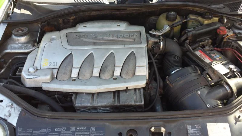

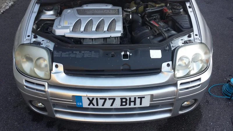

Made a quick start on the Engine bay
Before
After (can also see difference between the polished/non-polished headlights)

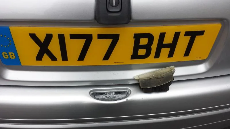

Decided to replace old rear number plate light

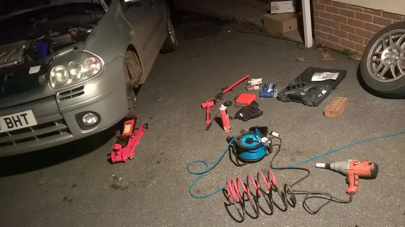

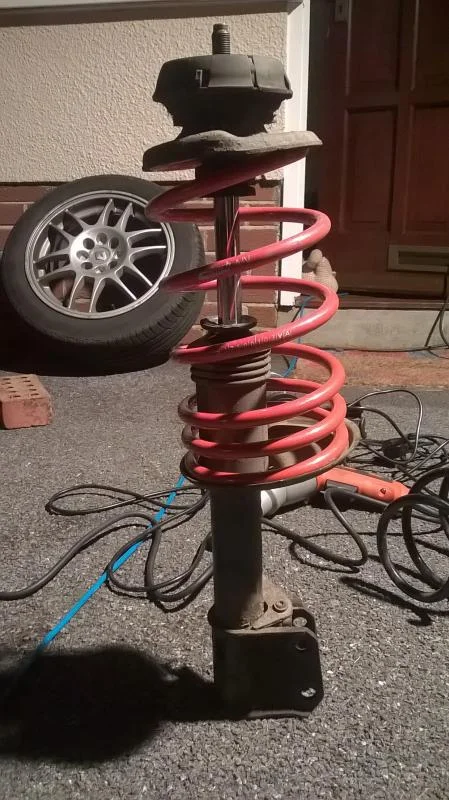

The car failed on a broken front spring and advisory on a cv boot & badly corroded rear springs (which they weren't). I had planned on upgrading the suspension anyway so I ordered up some Eibach Sportlines. Only problem was I needed to get the new springs fitted asap for the retest. Despite somebody saying they would be able to help me out at where they work in a local garage this fell through the morning I was due to drop the car off.... This resulted in a not very happy me! So I thought sod it I`ll just do it myself as I have done it years ago on previous cars with manual spring clamps which I don't have the greatest confidence in!

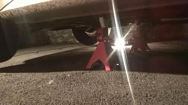

So on I went to fit the springs after I finished work in the dark with help of a security light and an inspection lamp......... it didn't last too long as I couldn't get the bloody nut off the top of the strut :( Also the inspection lamp only lasted 10 mins and was missing a few other tools which I thought would do the job...which they didn't. So yet another day was lost!
A day later I then went and purchased a nut gun complete with sockets which is more than capable of the job. But unfortunately the socket was too shallow to undo the nut so I had again lost another night to do it!! So I finally managed to pick up a deeper socket the next day and it was sorted...
After getting the spring/shock unmounted from the car I then had the task of getting the springs off using the manual spring tool I had. This wasn't really working but managed to figure out away to do it with much swearing going on!
Also had a problem putting nut back onto the top due to the tension in the sping so got an extra pair of hands to thread the nut on whilst I pushed down on the spring (if I didn't have the extra pair of hands I would of just gone mental and immediately sold the car I think as I had such a ball ache getting tools etc and with the short space of time I had to get the car sorted and it being dark and cold didn`t help either)
Finally fitted spring

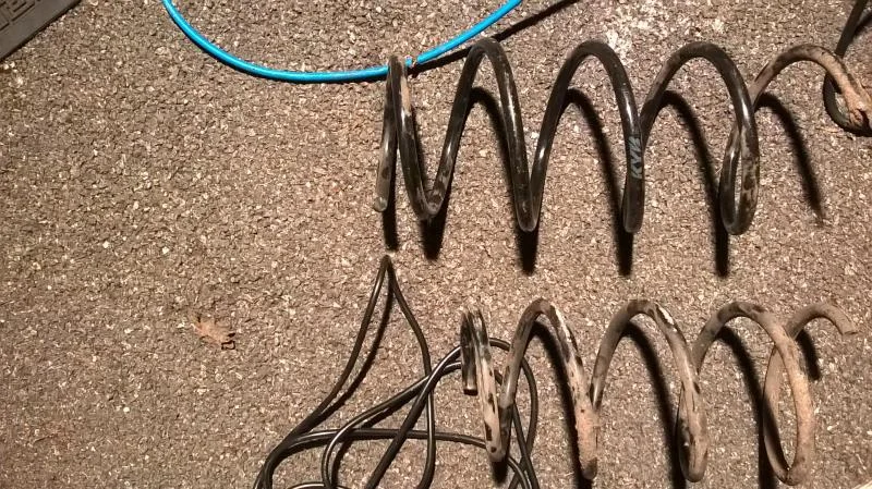

With fitting the new springs I did spot this little issue with one of the front springs being longer (is the offending broken spring too). I checked in the service history and the spring had been replaced by a local garage a while ago. I suspect that its off a standard Clio.

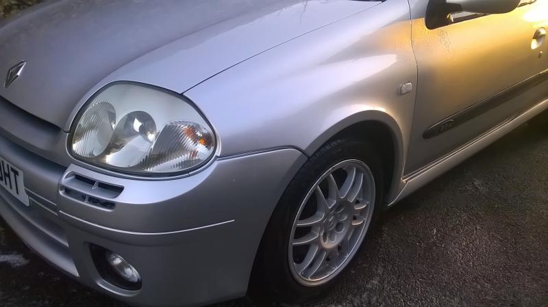

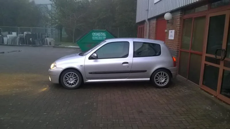

Since the MOT iv`e only used it to drive to work and have tried to keep up with cleaning it over the winter.

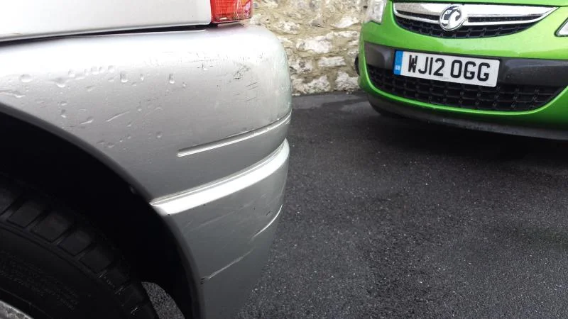

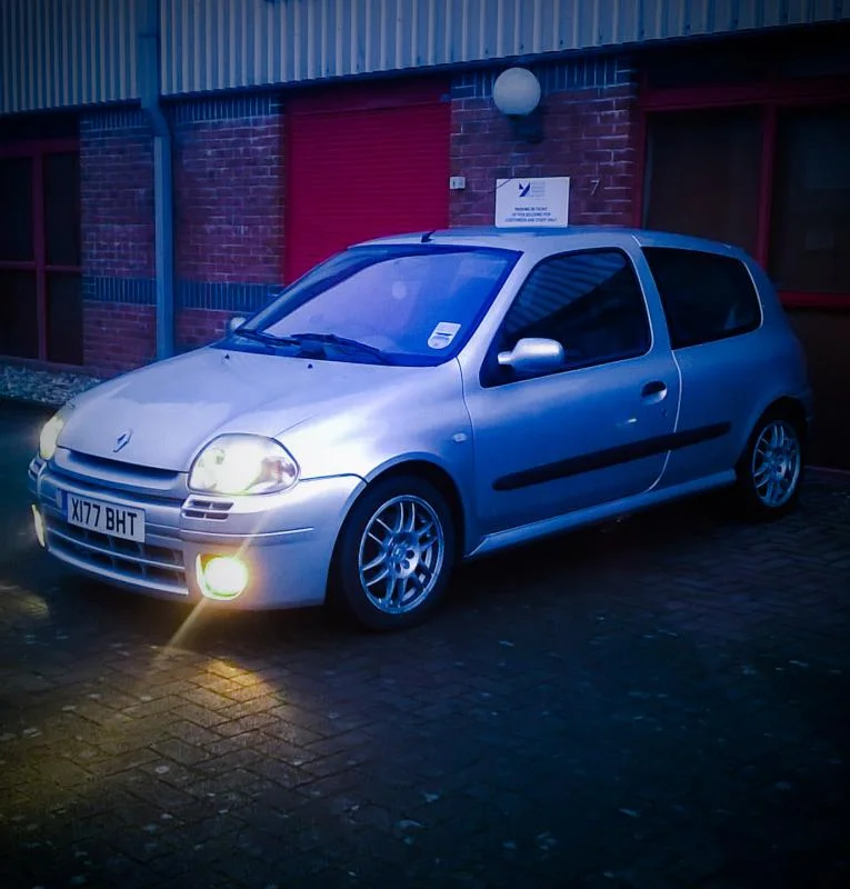

Heres recent pics of the car

You shouldn't have needed spring compressors mate. They're not under tension like normal cars, but the fact you needed one to fit that spring suggests, like you say, it was a spring from ma standard car!
Car looks nice and I like how you're restoring it :)
Yea that's what I found, I started to use them on the longer spring side but didn't really need to use them so didn't bother on the other side.

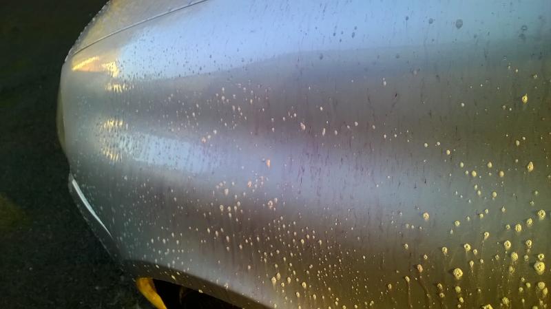

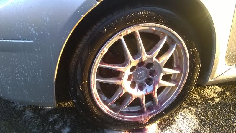

I have ordered a few items to start to detail the car soon and decided to have a bit of a try out of some DoDo Juice ferrous dueller iron remover which turned up today.
After washing a front wheel, wing, bonnet & bumper I sprayed the foul smelling juice on for it to work its magic...
After
Must say I`m really pleased with the results on the wheel and bodywork even if it is just a decontamination, considering it probably has never been done. Can`t wait to detail the whole car and get it looking like it should.

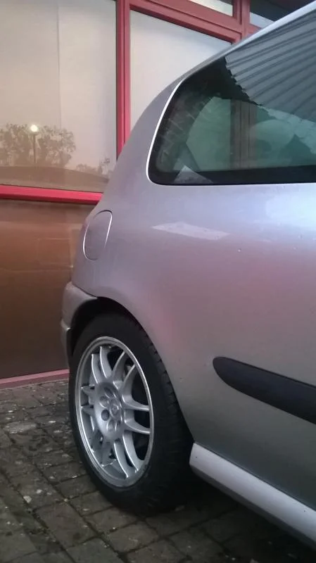

Yea so far happy with the springs, not too harsh but can definitely feel the difference between these and the standard ones. Only downside is that I wish they made the car sit lower really as it does look like the standard height. At least I can sail over speed humps without any problems what so ever!
