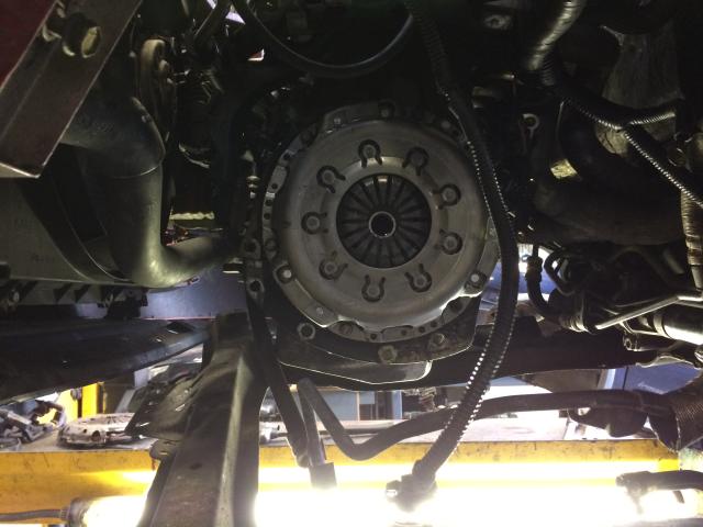

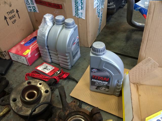

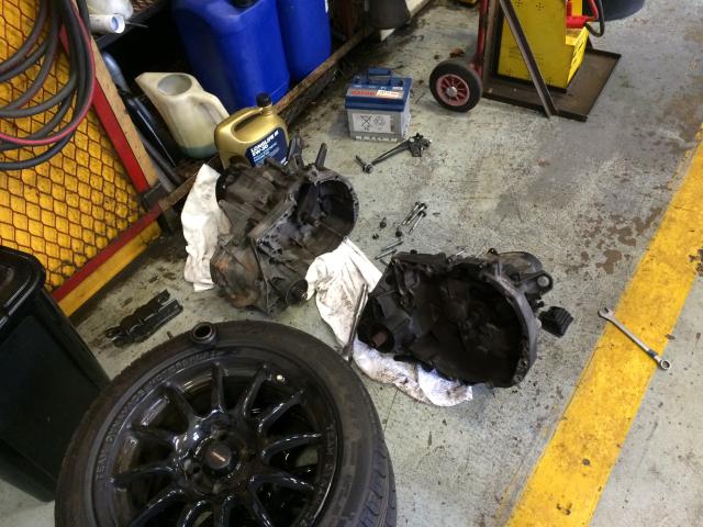

Rebuilt box with atb, new clutch and fresh gearbox oil

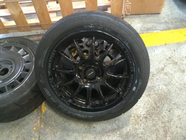

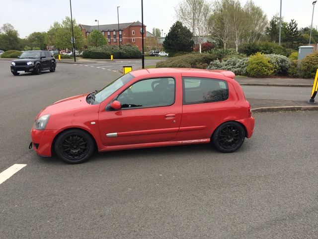

Bought some pro race 1.2's and fitted them with some Dunlop direzas
I think the willy's look better on the lower profile road tyres too :)
I won't be in a rush to do another gearbox but pleased it's all done now :)
Also refreshed the hubs with new bearings and track rod ends and redid geo, 2 degs camber on the front now

Yes I'm on a RC kir[emoji106] are the brakes a good improvement over standard then? And I suppose they won't fit under pro race 1.2's [emoji24]
Cub.
On the road they feel much better. Yet to test on track as I had to miss Bedford. I've only upgraded them because with the extra power I need better stopping power aswell.
They will go over Pro Race 1.2s with the right offset. @Ph1 Tom runs them with Pro Race 1.2s. I just like Willys wheels :smile:

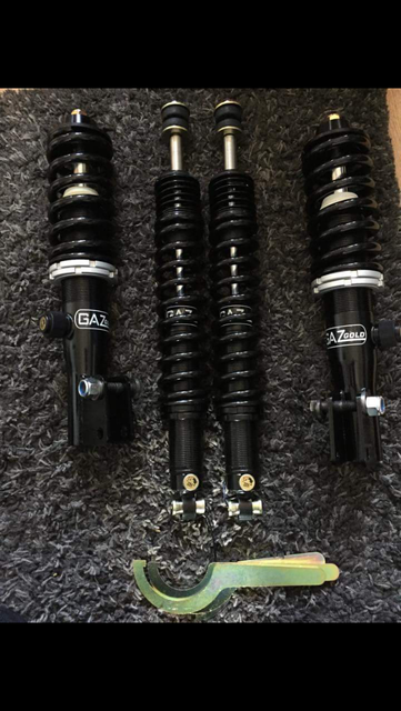

Sachs removed and sold

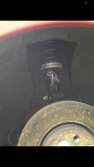

New suspension ordered [emoji106]
Going for Gaz golds with 650lb front and rear springs
Open to thoughts on the suspension choice [emoji106]
Ph1 Tom
Any reason for going for gaz gold over some ast sportline 1?
Also 650lb is 110nm, so I suppose you won't use it on the road again, unless you don't anyway.

My gaz on 400lb is bad enough never mind 650! I hope it's a track only car....
R.I.P your bum
Will be used to commute to and from trackdays but that's it, which usually is with a car full of stuff so only steady.
Springs are not expensive so if it's a mistake I will change it out later [emoji106]
Also 650lb is 110nm, so I suppose you won't use it on the road again, unless you don't anyway.[/]
I've heard good things about the latest model, and also I've used Gaz before and know they have very good customer service.
It's our trackcar, it's insured taxed etc but only used for commutes and testing in the road [emoji106]

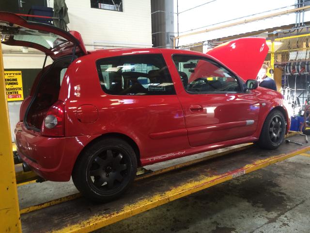

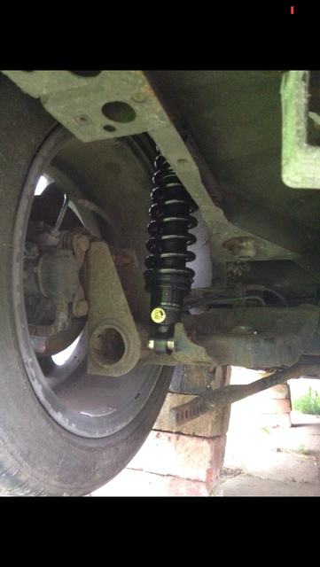

New suspension arrived and fitted [emoji106]
Couple of pics during fitting

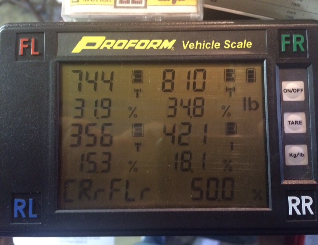

Corner weighted
Weight with half tank and me in drivers seat 1058kgs
Weight without me 979kgs

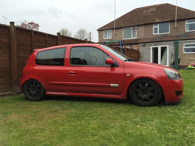

Just after fitting
After a grew up
