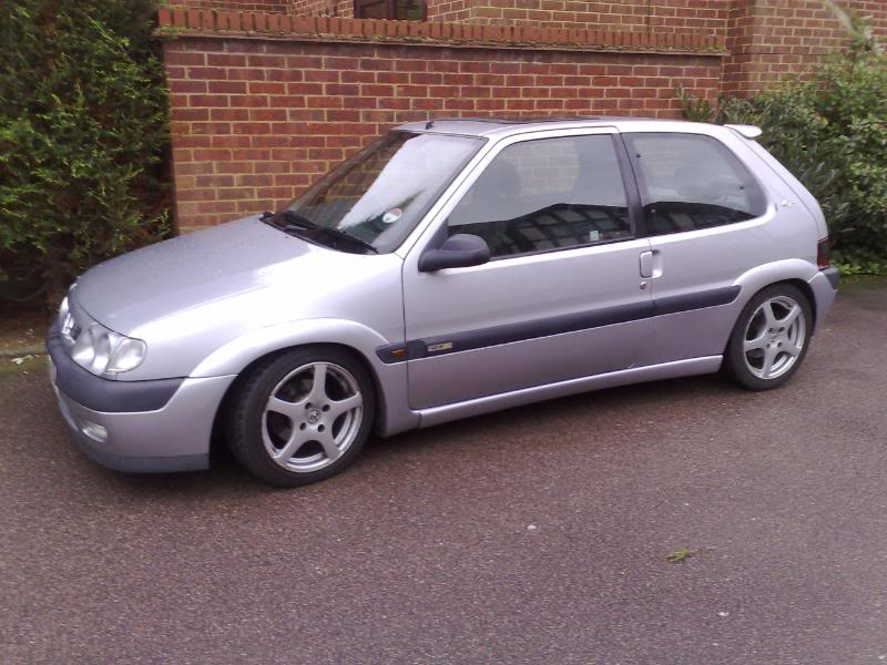

Well chaps, when we thought the Clio Valver project was coming to an end we decided to start another project out of Moo's newly aquired Citroen Saxo, I know it's not a Clio I know but i'm sure you'll let it slide as many of you know Moo and will agree he's a pretty decent chap and knows what makes a good car/ project.
Well since moving out to his own place the Vx220 had to go as it's far from cheap to keep this free'd up space for another french car and since this one was cheap and pretty quick it seemed like a good start.

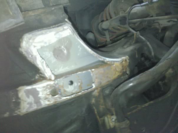

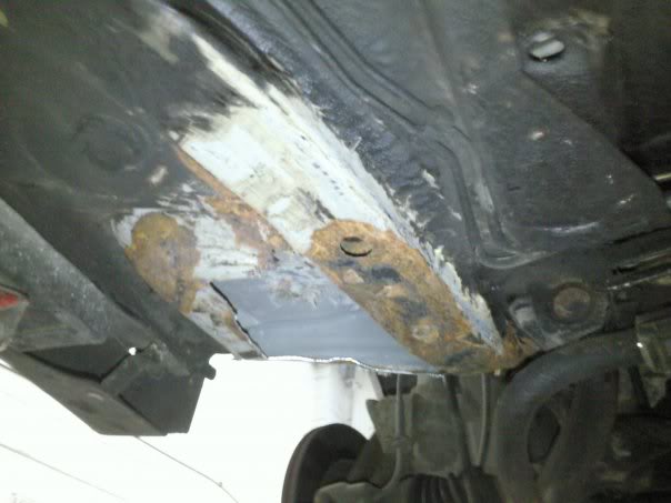

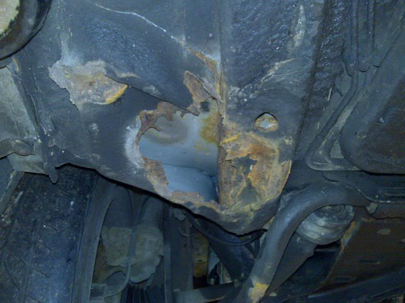

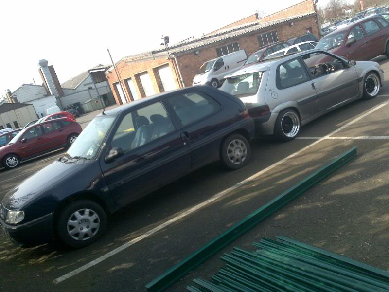

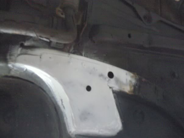

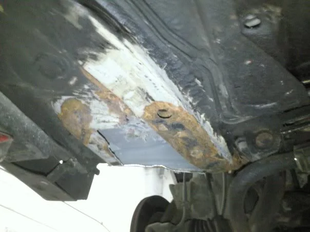

The car is a 1998 Saxo Vts with 86k on the clock and a years ticket however that didn't seem to mean a great deal as the floor had 2 gaping holes in it which needed mending first off. So it was down to my work for good ol' Pete to work his magic with the welder.

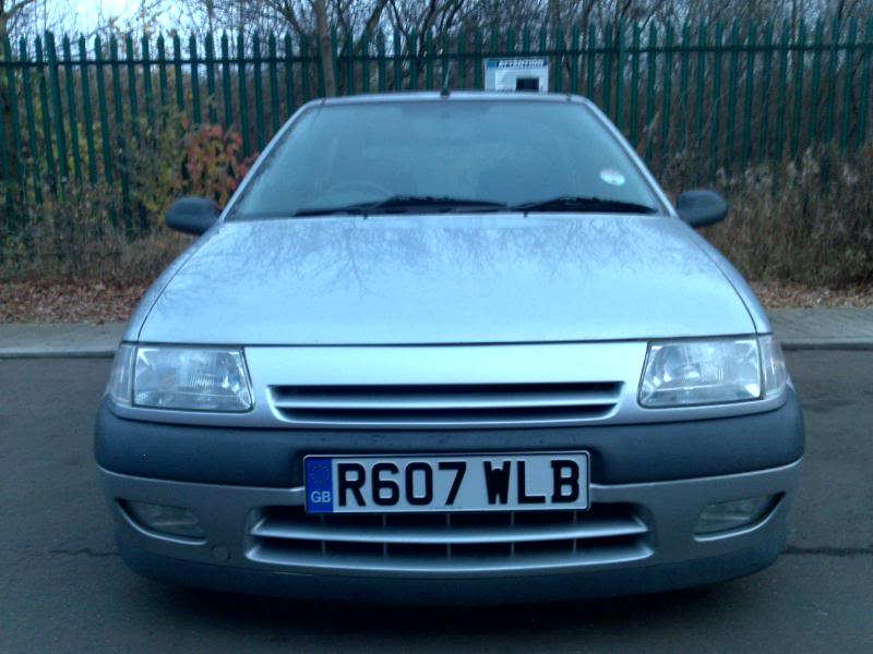

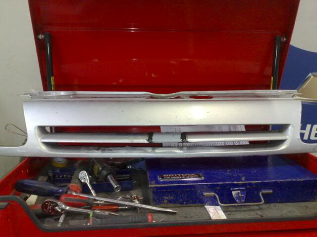

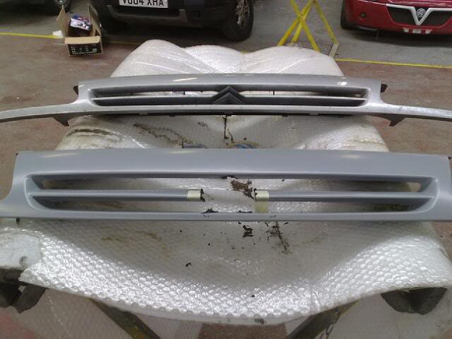

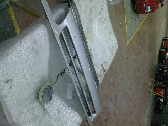

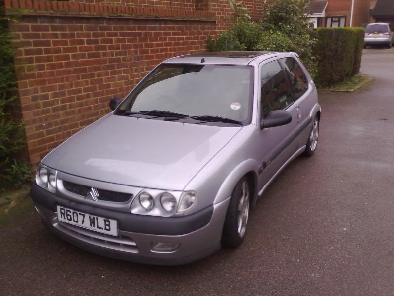

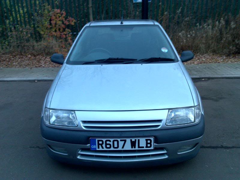

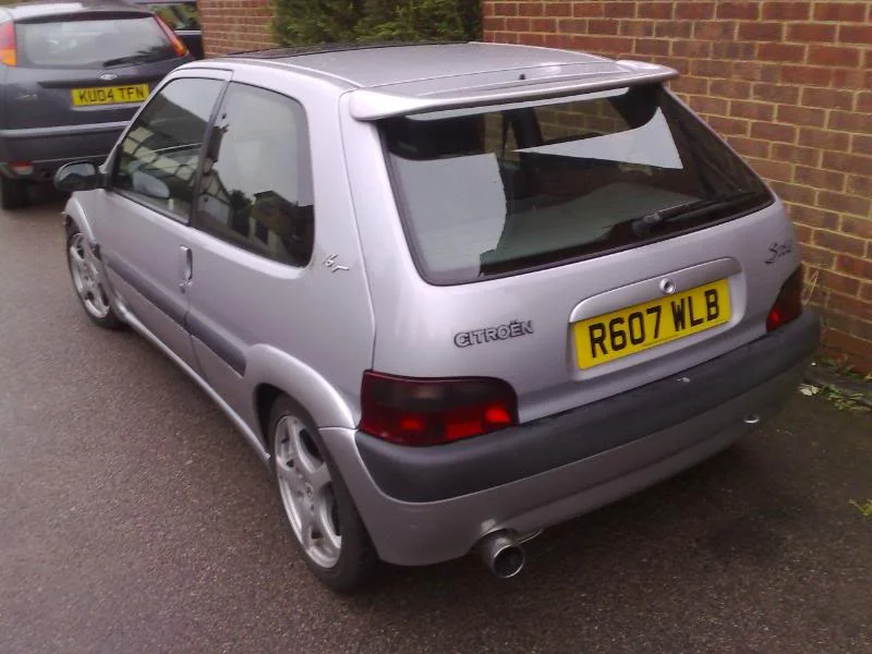

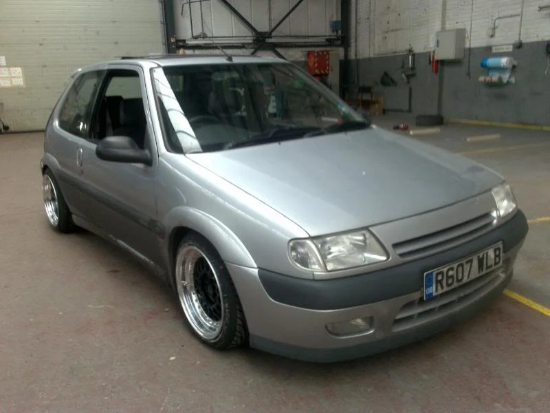

To replace these we went for standard headlamps but the grille we wanted something smoother so we sourced a standard grille and a second patern one which i combined to make this..
Happy as Larry with that we set about the most important part of any Euro car, the wheels. This meant dealing with people in the fatherland involving tonnes of dodgy translations and confusing currency conversion rates. However in a very efficiant fashion these arrived and we couldn't wait to get them to bits and start "specialing them up"

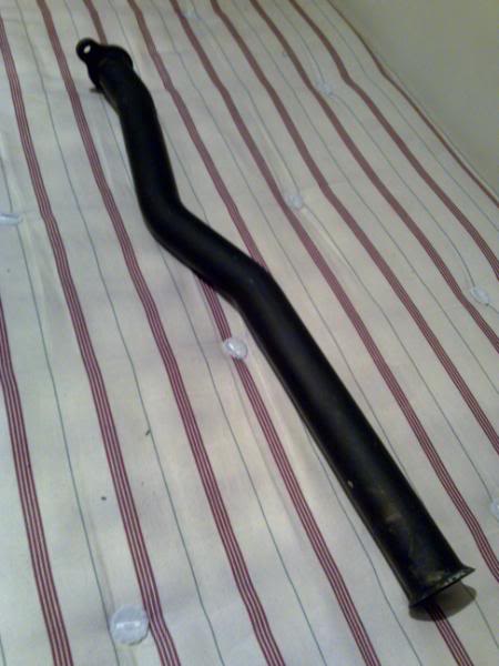

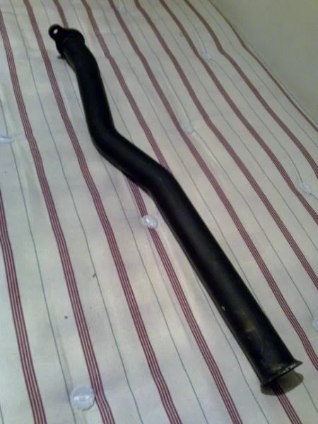

Also in order to get the ride height right we'll need rid of the cat as even at this height it spends more time on the floor than not.

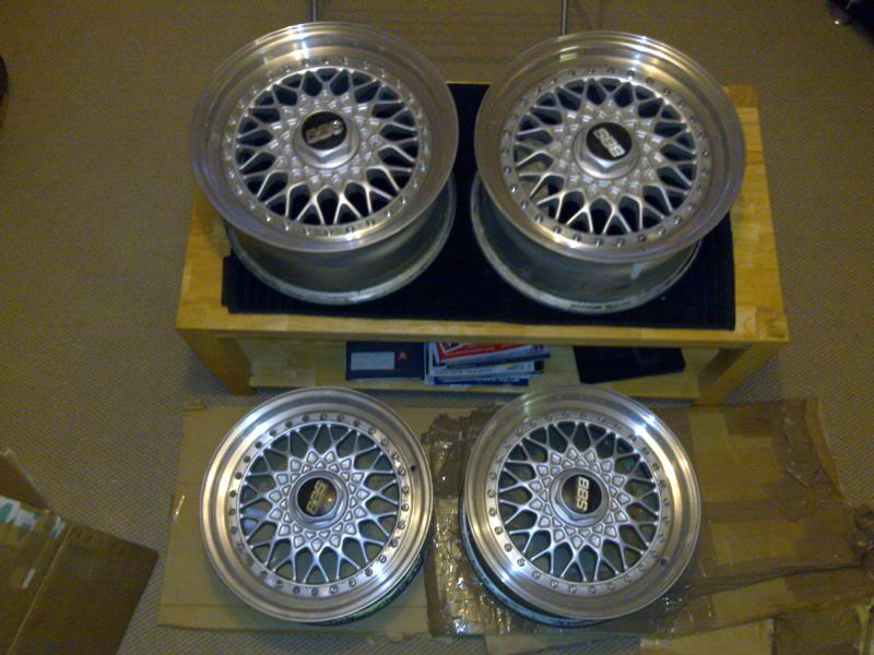

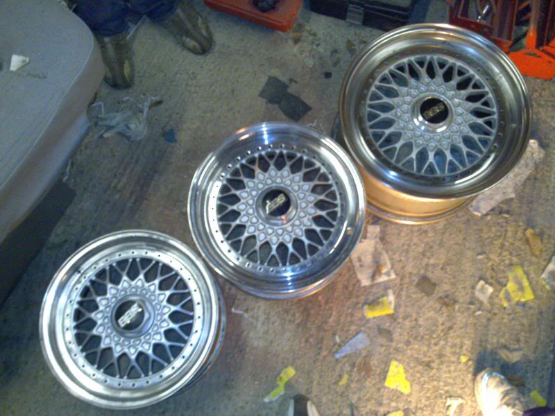

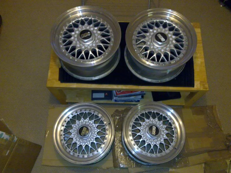

We went to see our favourite Wheel***** and advice centre Jeff for the BBS rim socket and set up this photo (mainly for winston lol) 15" 16" 17" RS's all together.

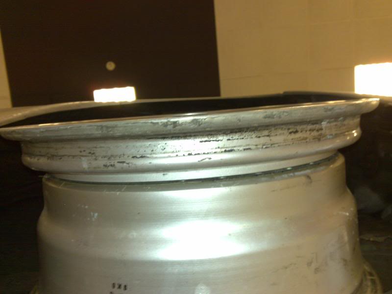

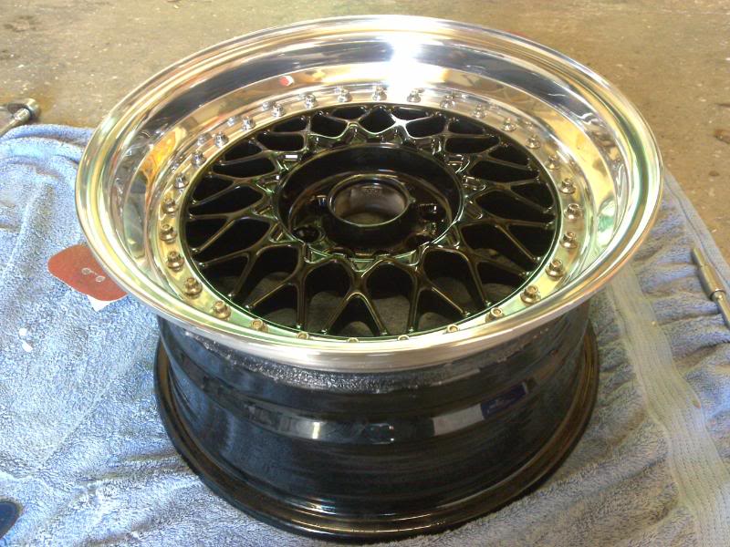

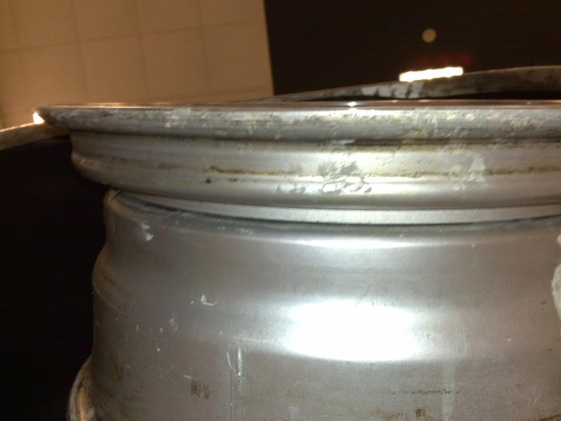

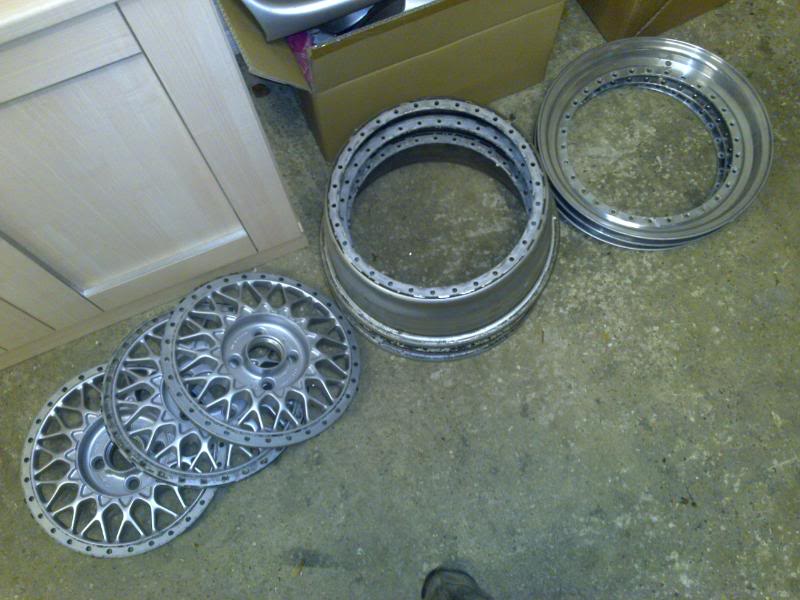

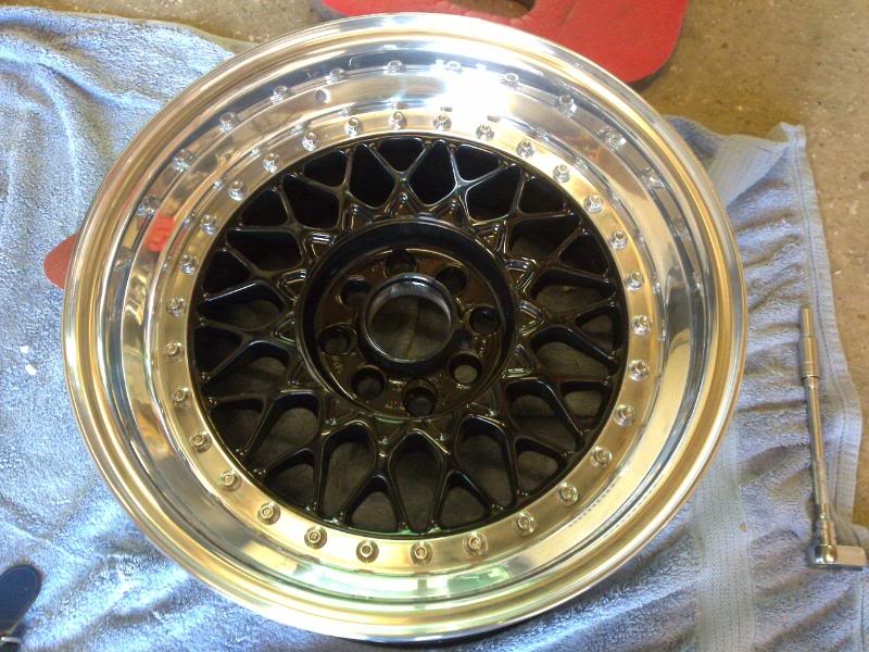

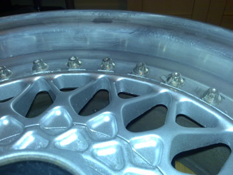

Once that was done we headed back to our garage and after 120 bolts, a bit of heat and a good twatting we broke the wheels up into they're individual bits to start the redrilling. Polishing. Sand blasting painting and powder coating.

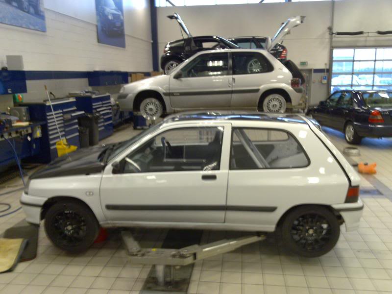

Then we had the rare privelage of a massive state of the art workshop to play in (cheers julio) so we took advantage of it and get loads of little things sorted that've been on our minds for a while now

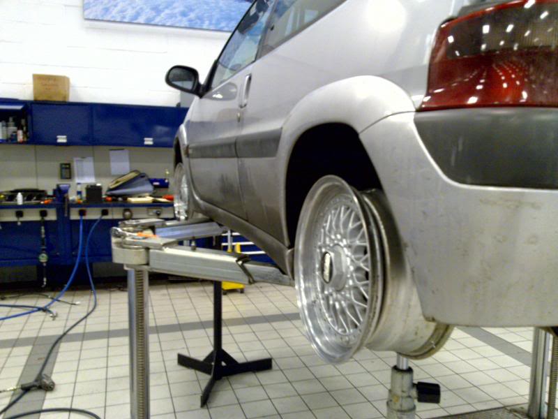

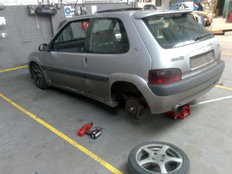

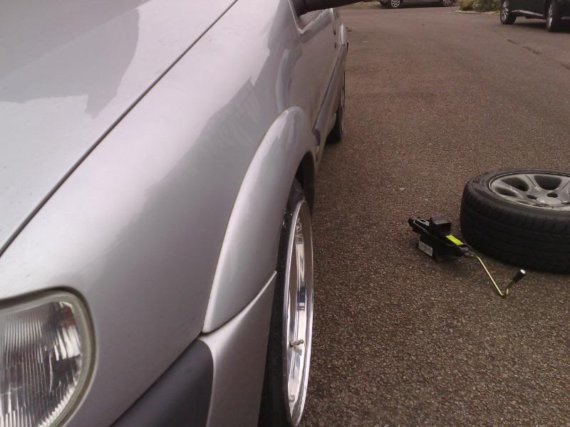

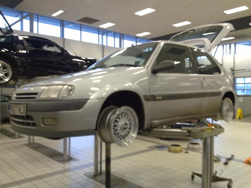

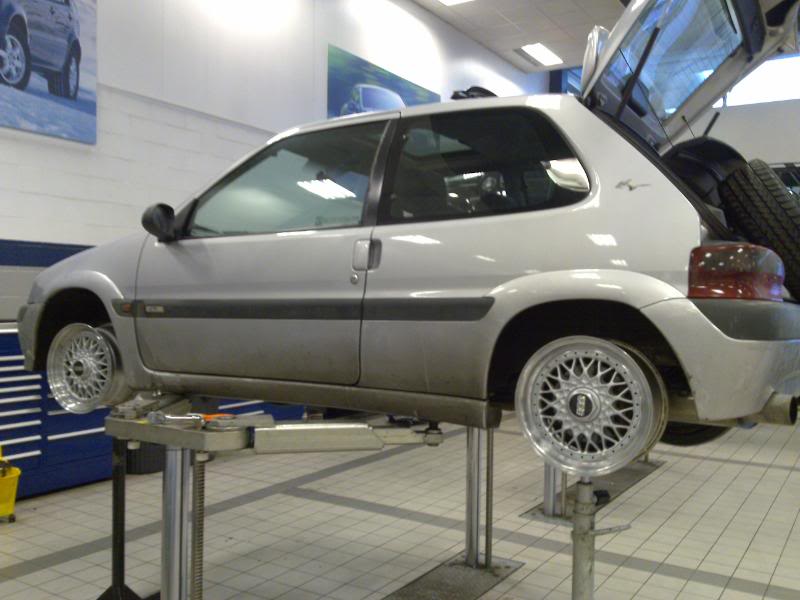

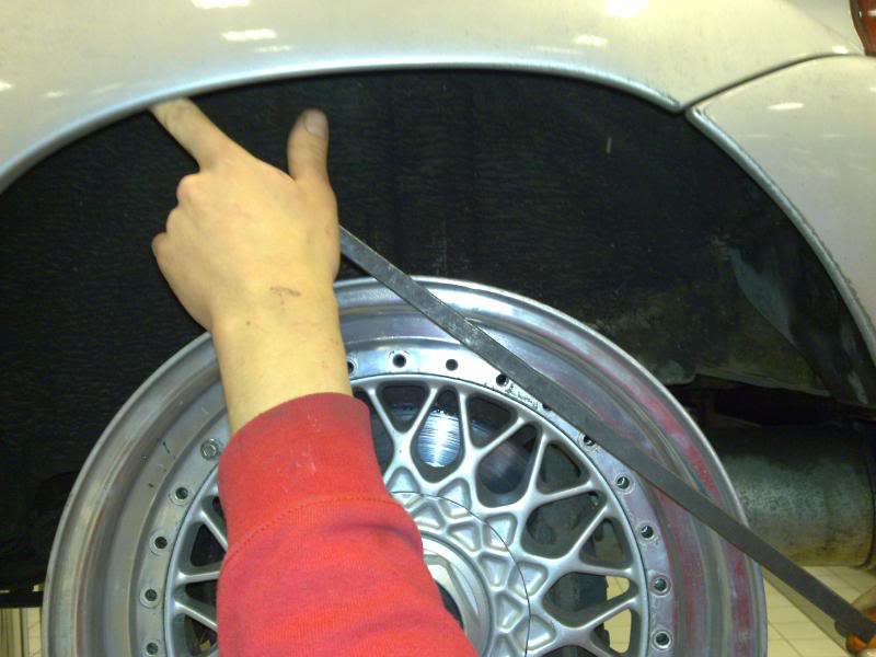

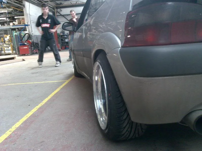

The BBS's returned over the christmas period redrilled to 4x108 and since the lancia delta they were originally off of had the same offset as a saxo they were ready to trial fit and do some measuring to see how deeeeeeeeeeper rim we can have on the back. Started off getting the car onto the ramp, got the wheels off the N/S and trial fitted them. Next we let the car down onto some tall stand to load up the suspension (and with a few wheels in the boot to stop it tipping off the ramp lol). heres the results and we think you'll agee, Uber,just Uber.....

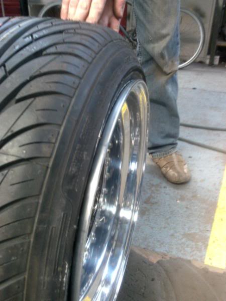

Difficult to make out what your looking at here but basically your looking upward at the wheel and showing the clearance to the arch. This is the front and as you can see there pretty much a spot on fit and width.
This however is the rears and as you can see there's some clearance to be rammed with shiny shiny dish! Woooo So we using a straight edge (read massive pry bar) worked out we had the width of the prybar and Beanie's forefinger clearance which in european measurement is 1" meaning we will be getting 2" of juicy rim under the rear.

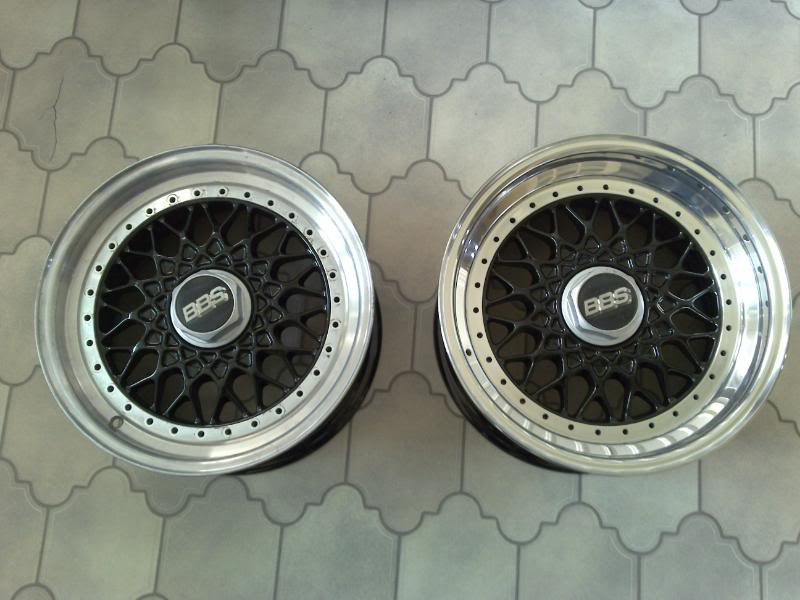

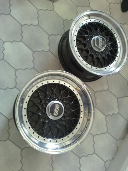

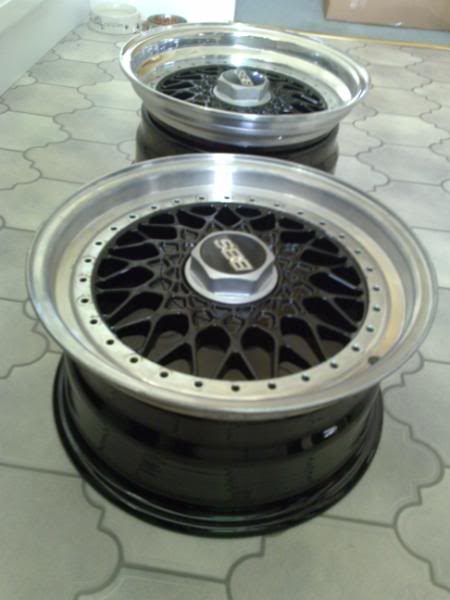

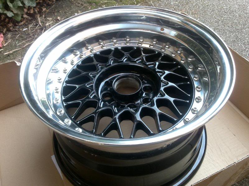

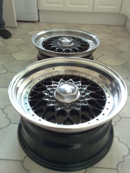

I can safely say I had no idea at all that putting new wheels on a car could ever cost this much, take this long, or be this complicated but i'm so sure now they will be more than worth it all. This week more provisions arrived from the fatherland in the form of 2 brand new rear rims. Then a week after expected but more than worth the wait the rest of the wheels returned from powder coating. Anyway enough waffle heres the pics.
Still got to get the front rims and the centre nuts polished, and some new centre caps to arrive but they are certainly coming together, and beginning to look like I really wanted them to!

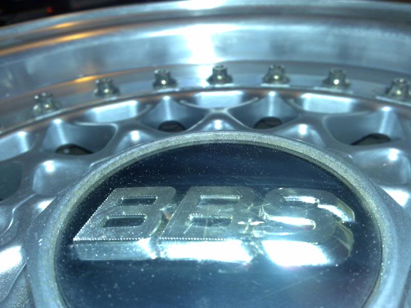

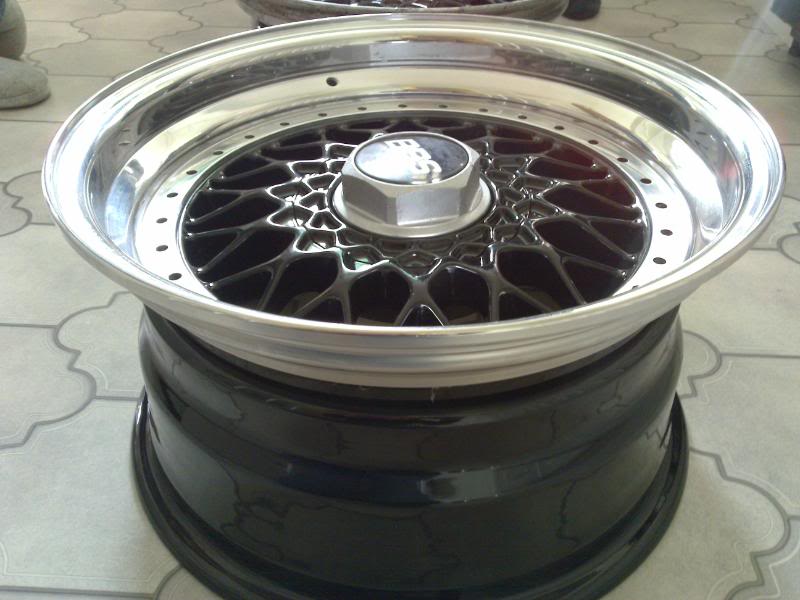

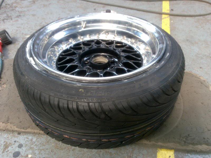

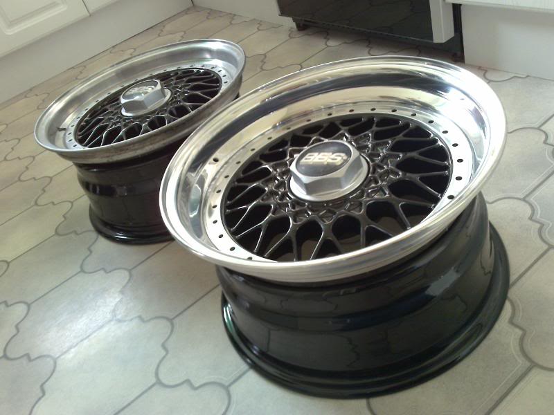

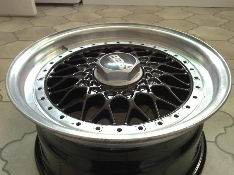

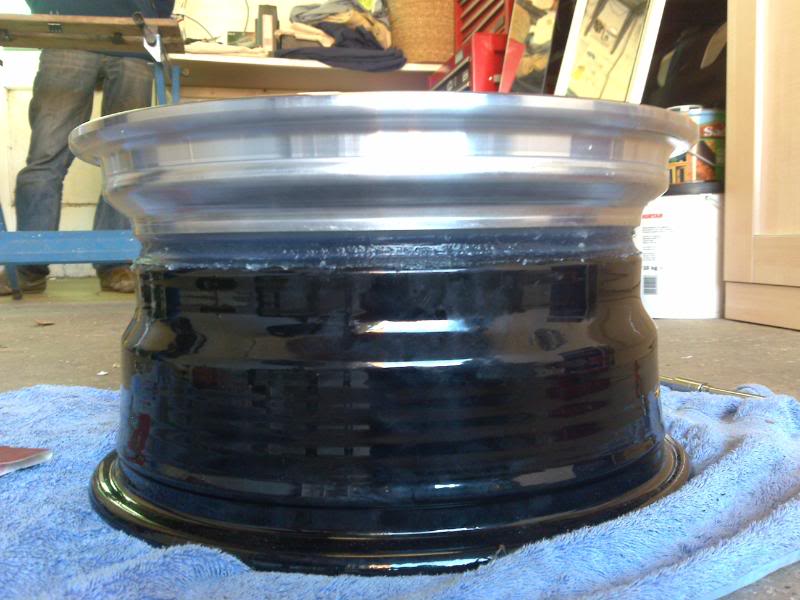

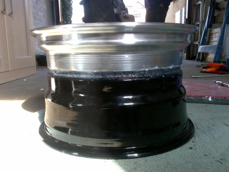

Well we might have been a bit quiet on this one recently but it doesn't mean we haven't been busy. First thing we realised was we had enough parts to assemble the rear wheels so we headed to the garage and soon realised that polishing 120 rim bolts is truely a boring pain in the arse!! But it was deffinately worth it as the rest of the wheels looked so good. That done we (using clear bathroom sealant) assembled the rears and they look amazing.
As if by magic the following day the tyres arrived and so with suprising ease we were able to shod the 8x15 wheels with the 185/45/15 Nankang
Ns2's

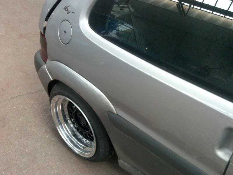

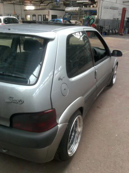

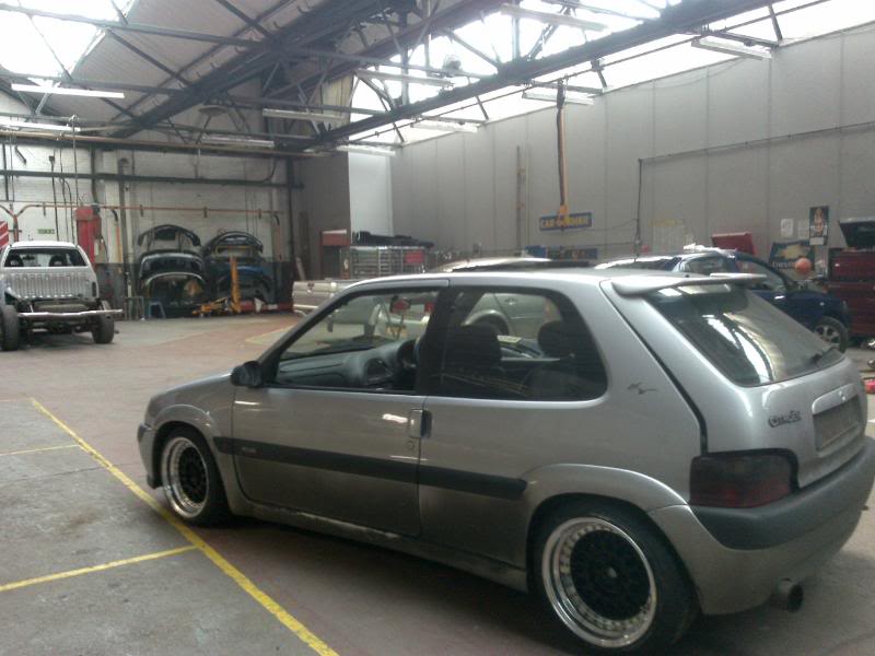

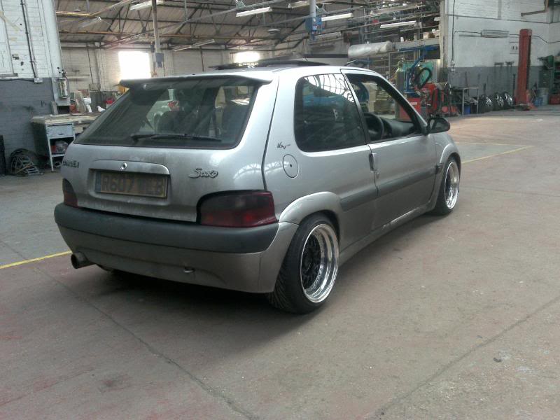

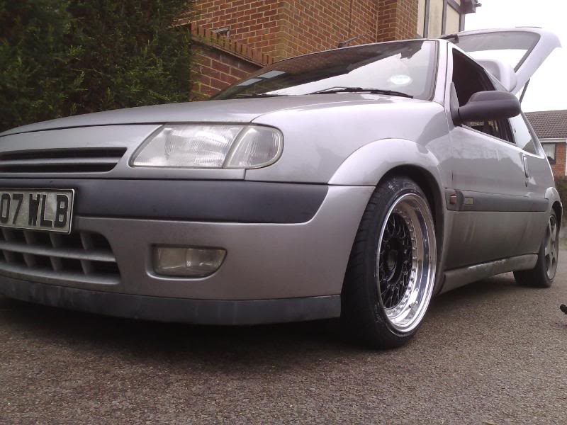

Suprisingly a fitting we didn't have a camera for showed us that these wheels on the back looked CRAP! So we decided to try them on the front and I think you'll agree it's where they belong!
The car obviously needs to be lowered a lot but with my birthday fast aproaching i've been busy dropping hints for some coilovers to anyone near enough to hear them really.
A big plus to all this means we're now sure the rear arches can confortably swallow 9"s without any modification 8) so the credit card came out and some 3"rims and some 195/45 nakangs to throw over them are now winging they're way to us.

I think they mean that they were not wide enough for the rear arches so they're going for wider rear rims? Looks like it gonna be awesome with a tiny bit more of a drop!
  Some of a Clio 1.8 16v
I've only got 1 set of BBS's just adjusting the width to suit They all came with 1" rims which were going to stay for the front.
Put a 2" rim on 2 wheels, they were going to be on the back but decided to put them on the front as they fitted better.
Now have 3" rims on order to fit to the wheels that were origonally going to go on the front with 1" rims, for the rear!
Think that makes sense

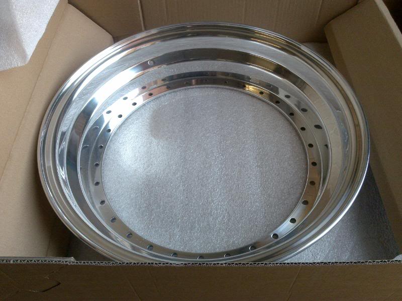

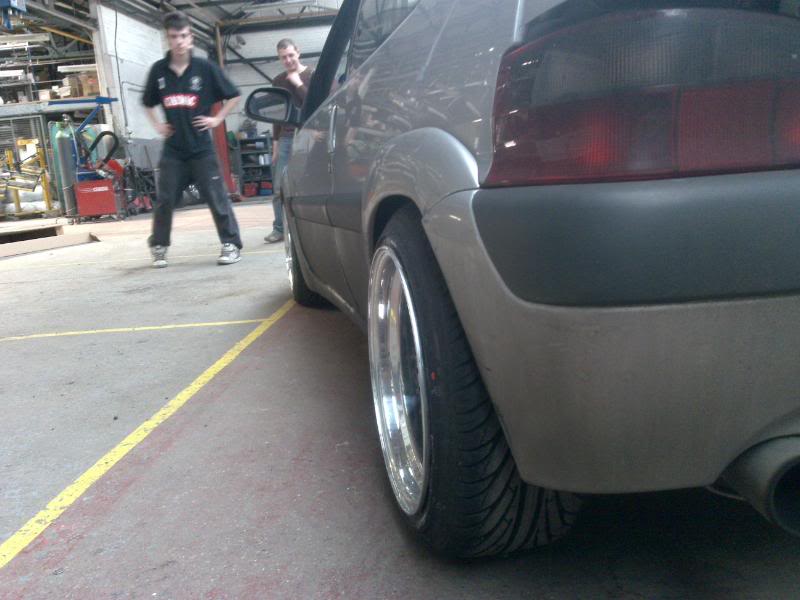

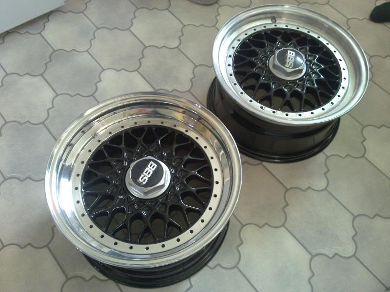

Woooo! I'm back again and although i'm fairly sure your all bored of pictures of these wheels i'm not bored of posting them yet so look away now because this is a picture whoring post lol. In the week the parents rang to say that they'd missed a delivery for me and there was only one thing it could be so 8am saturday morning I was banging on my brothers door to come for a trip to rushden to collect these from the postal depot....
We then spent a couple of hours on the now well practiced assembly routine to produce two of these...

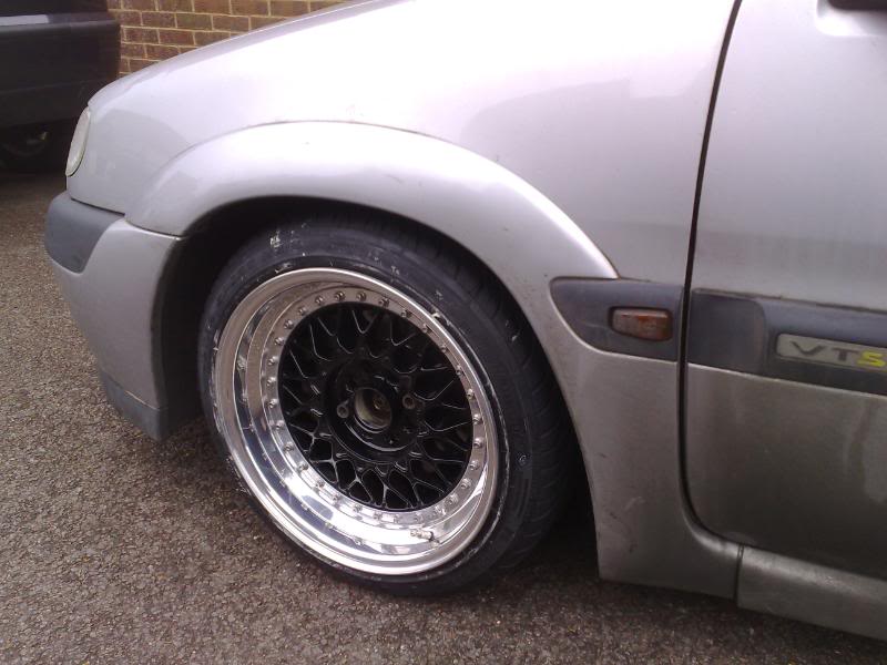

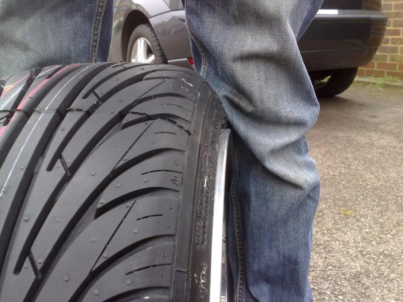

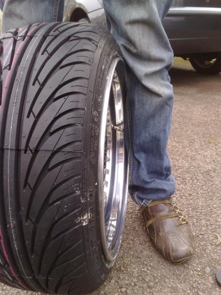

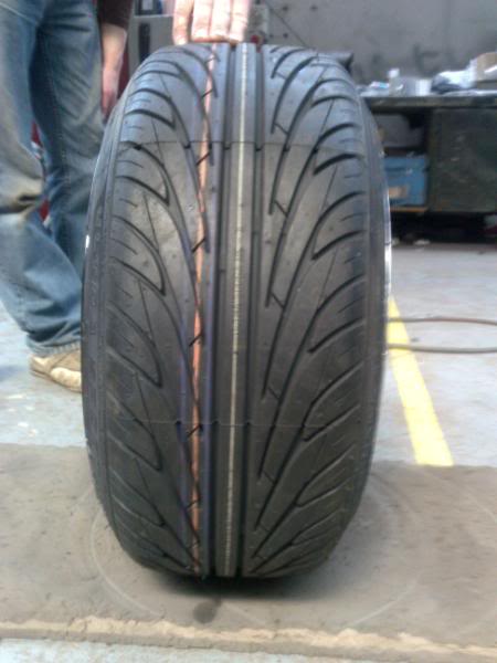

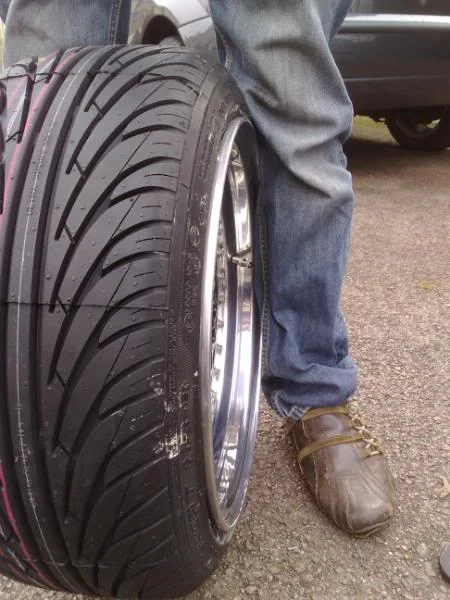

Next job, Tyres and it proved to be nowhere as near as simple getting the 195/45's on the 9" rims as it was getting the fronts on. Getting the tyres over the wheels wasn't terribly hard at all but once they were on they hung around the middle like a rubber band on a foot length of drain pipe. A few ideas came, failed and went, but it became clear pretty quickly that there was only one way, FIRE :evil:
2 cans of brake cleaner and 1 can of lynx vice later and my brother had no fringe or eyebrows but I had my tyres on and was a very very happy bunny!! :D :D :D

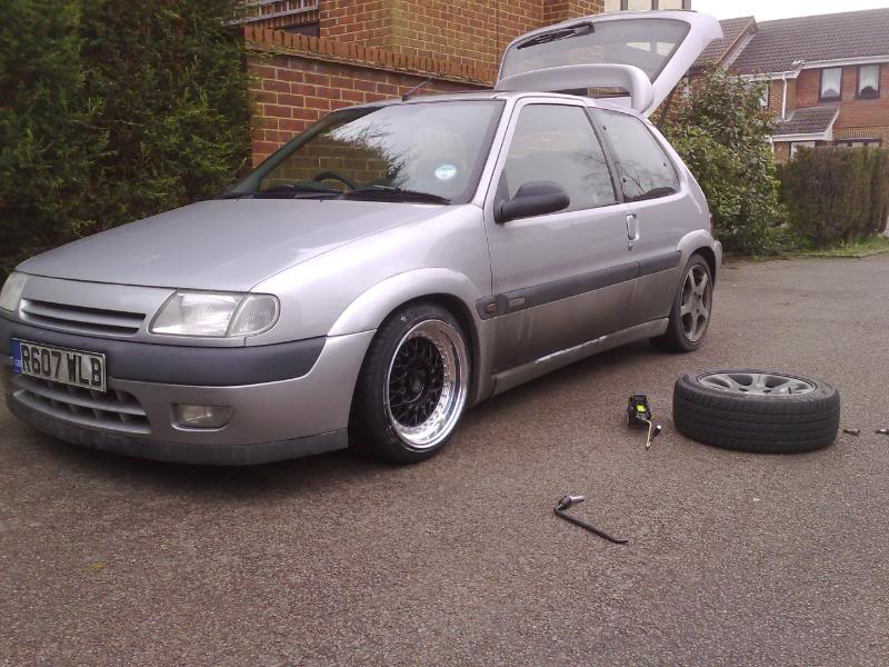

Only one way to go from here now though we thought... try em on fro size.
There are obviously loads more pictures but I couldn't very well post them all Lol. Unfortunately as we've not got the car low enough yet and there are big big plans for the rest of it we then put the car straight back onto the 3 fox wheels and one VTR :(
Cheers for looking and please check back soon for exciting updates
