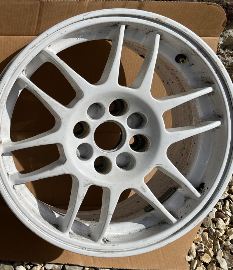

Bought some alloys purely for track use which are white.
They have etched in brake dust and wondered what you guys find best to remove and the method.
I’ve bought some iron out which has got the non stubborn dust off however the more stubborn black dots in the corners don’t want to shift.
They are only for track but if I can get them back to being nice and smooth I can then wax them to save it getting as bad next time.

It’s like stuck on bits of metal is the only way I can describe it.
Like you could pick them off with your nail, only you can’t.

If you zoom in you can see the bits I mean in the corners and also inside of the rim itself.
Auto finesse iron x hasn’t really helped at all apart from making them look cleaner.
The hardened particles are still stuck in place.

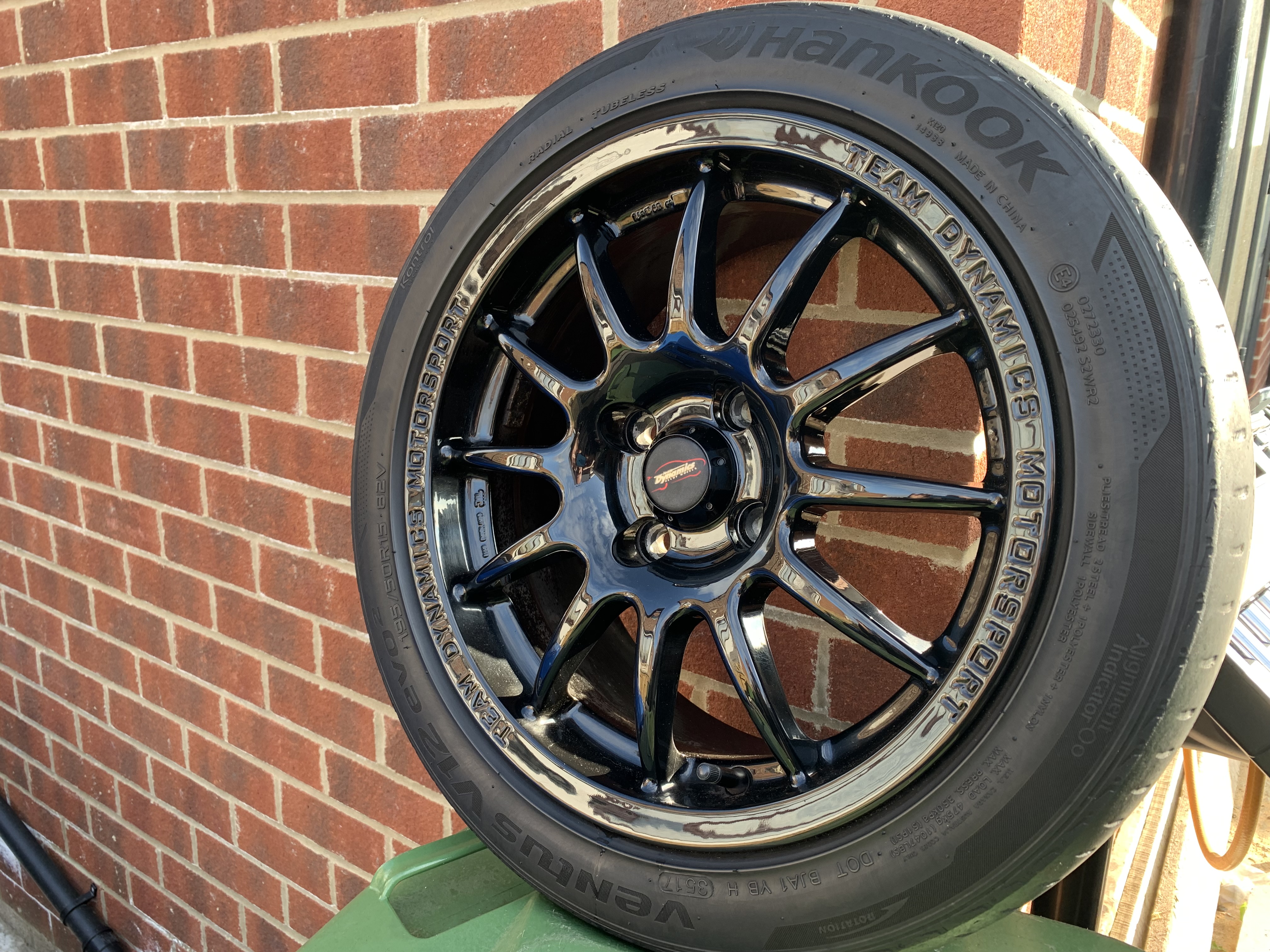

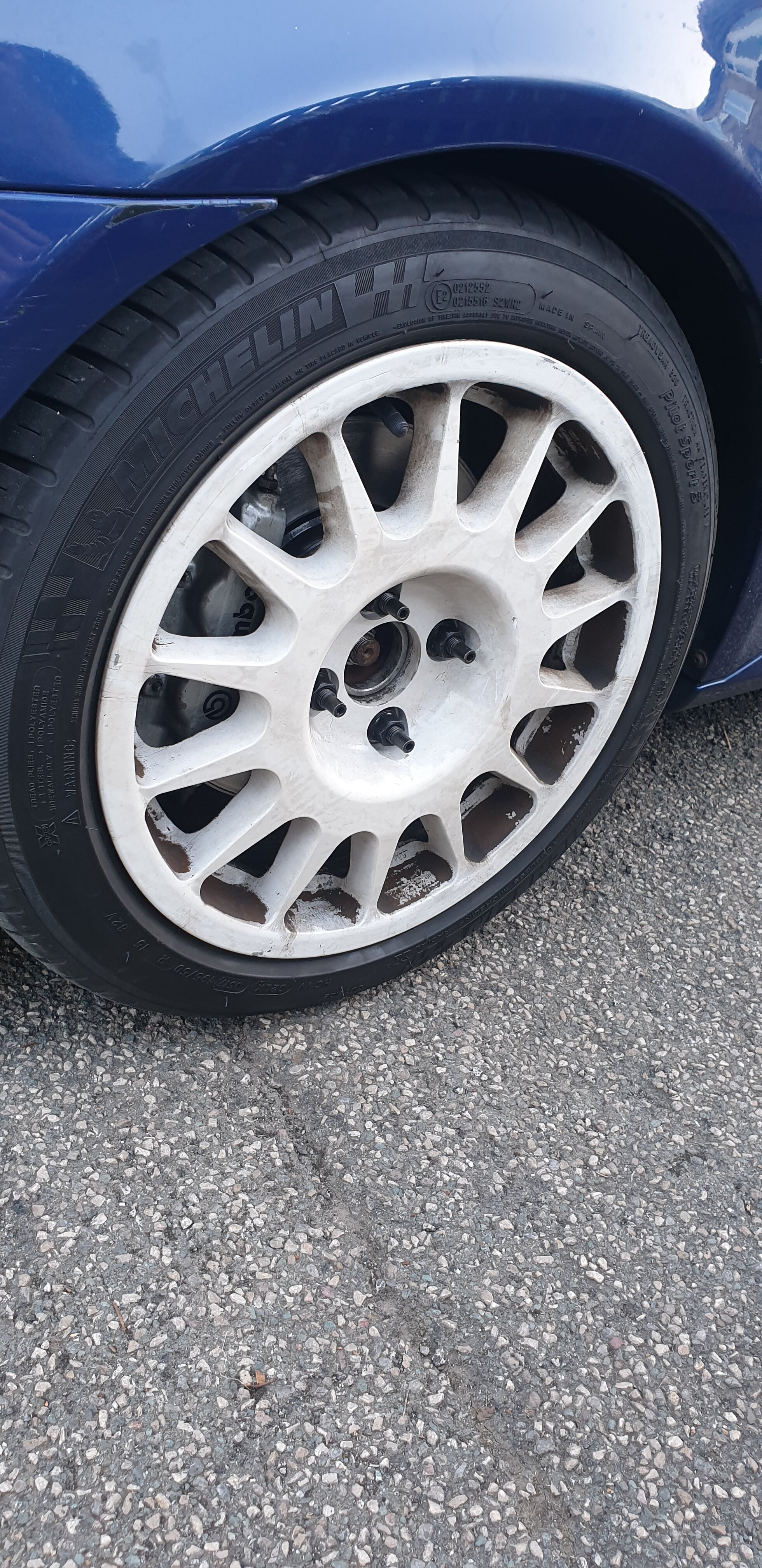

Exactly like mine were. You can still a bit in the image I posted. I just gave them another coat and it all went.
Stuff is House of Shine acid, got it on eBay for like £20 (5 litres). Had a quick look and they dont seem to do 5litres anymore, only had a quick look though.
