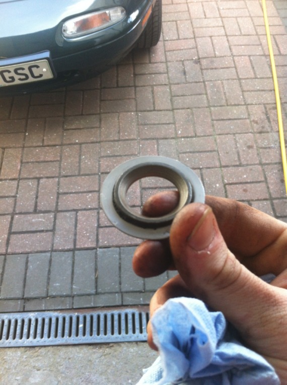

Before I change my disks, is this the spacer?
  RS 182
Is this the spacer everyone talks about remembering to put back in before putting on your rear disks?
Cheers
  RS 182
Cheers guys! I ended up only changine one side, as one of the spacers was missing! And instead of ruining my new bearing, i'll order a spacer, and change the disk when it arrives :)

As I said above, they often get stuck to the back of the disc and then thrown away when people are fitting new ones. They then fit the new ones not knowing that you need to reuse the spacer.

Part number is 6000073518
I try to tell people about these when they are ordering brakes. They can often get thrown away by mistake by previous owners as they can become stuck to discs when removing them.
They should come with/be on the car and refitted. They don't come with discs when you buy them

Yeah mate, Fred @ BTM told me about this when i ordered the brakes! He did say, if i fitted them without the spacer, it would just ruin my wheels bearing in a matter of weeks, soo Feates172, maybe worth ordering a couple and getting them on asap if your not too late?

Can these be seen without removing disc? If so ill check tomorrow. Deffo dont remember them being on the disc. But wasnt looking tbh.
Hopefully they didnt get chucked with the discs and are still on there.
What the issue they cause when they are missing?
Worried now. Done discs and pads on every car ive owned and never come across these.
Mine ended up with one off Fred's own car after I went down for new rears on a Sunday and nowhere was open! :hail:
I think basically without the spacer when everything's tightened up there's too much pressure on the bearings, so they just destroy themselves eventually.

i can tell you if the spacer is fitted by looking at the rear hub nut, post a picture if you are worried
