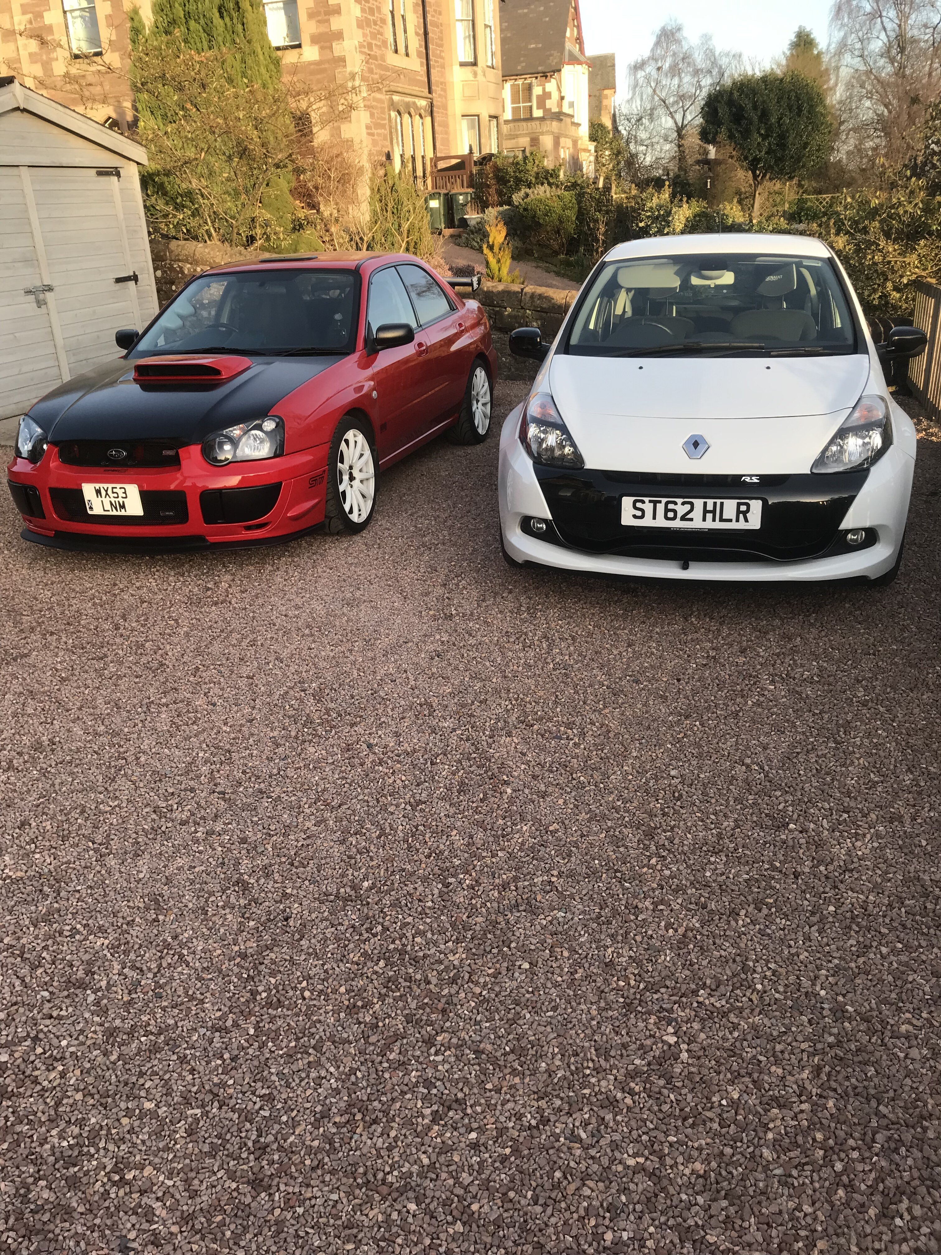

Hello Troops ,
Probably been discussed many times before but the timing belt is due on my 62 plate 2013 RS200 Clio ,2:0 litre n/a engine. I work at a car dealership so can get one of my proper old school mechanics to do the job,not a young lad who is just a “fitter”. Can someone give me a list of the parts required ,maybe special locking tools and the best place to get them?
Also, it is due an oil change service,best type of oil to use for the engine and also the gearbox?
Annoying thing is it has done 18,000 miles in 5 years but i know it is whatever comes first,time or mileage.
Thanks in advance.
