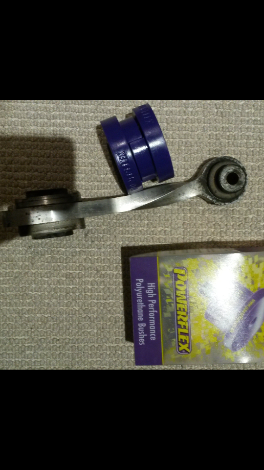

Hey guys - just received a used dog bone I bought on ebay to fit with powerflex bushes. It is lightly bent - I know its supposed to be twisted ;) but not bent. It's not a lot but is this normal? I assume it should be fine if I straighten it back?
Its bent a few degrees to the left - thats not normal right?
That's normal the small bush is offset in relation to the large one. Both genuine Renault parts I have had have been like this hence its important to fit the small powercrap bush the correct way up.
