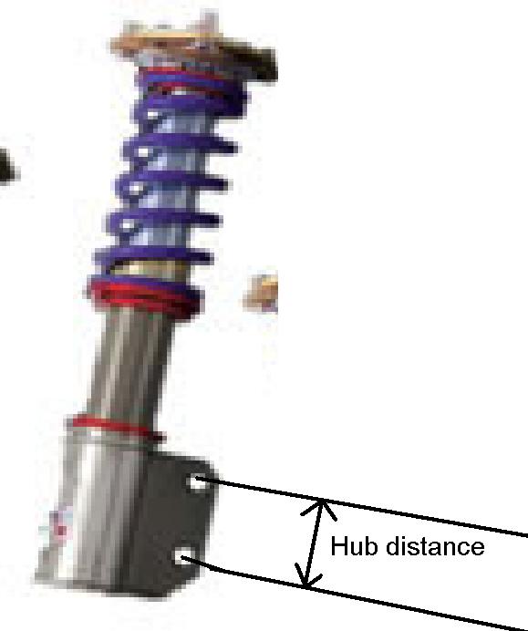

Best shop around try all the compnaies. Drop john2modified on here a message mesure your hubs (see this drawing for what you need to measure) put the wheel on full lock and measure that distance in the picture The hub bolts onto this and your strut won't look idential to that but you'll get the idea. John sells them at a good price and gets good reviews on here.
have a look on the net for what you want there a good selection out there Apecx are the ons I'd fo got for cheap but decient quality. I;'d always go for a full kit of springs and shocks it makes the difference (the Mk1 only had frotn springs the rear is torsion bar still uses shocks but you need to get the torsion bar adjusted if you want the back lowering.
