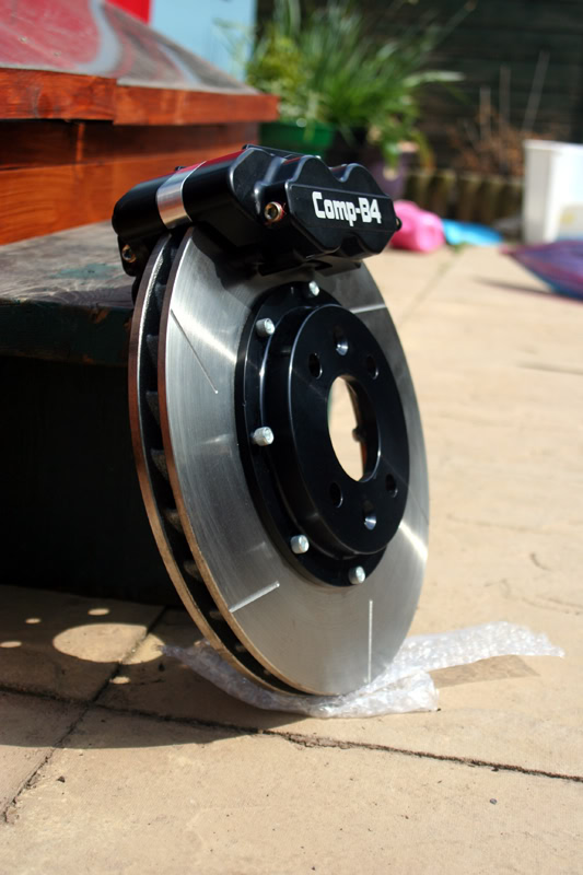

Are there any other manufacturers that make 4 pots that are slim enough to fit under my wheels though?
The thread from jam-sport, although written a while ago now, seems to suggest they are the first to offer such a set-up?
The compbrake and willwood 4 pot set-up are both quite similar, and both run 295mm discs.
The only thing that would put me off the Jam-sport willwood kit is the fact they don't run separate bells and rotors, like the compbrake kit does.

Fletcher, I've seen mixed reviews about the willwood, haven't seen any on the compbrake though. Do you have any clue on price? Or where I can find out.... Having a separate rotor is definitely a plus though...
I paid £650 for my Compbrake 4 pots through a CS group buy a few years back. I've had mine fitted since April 2008 and have done about 40-45k without any problems.
www.compbrake.co.uk
