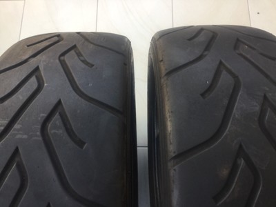

@Brigsy these look okay? I guess age is the important part
Look fine to me mate, the ones to avoid in my eyes are the well used tyres with a good jagged edge and near the wear bar. Will you get away with 50 profile? The sidewall and tread compared to normal tyres is quite beefy.
Thanks mate, sorry for all the questions lol. Cars not overly low and 500lb front springs so should be good. I would stick to 205/45 but £££, new r888r (cheapest) cost 250 ish for a pair, thats for 87w, 83w is 300
