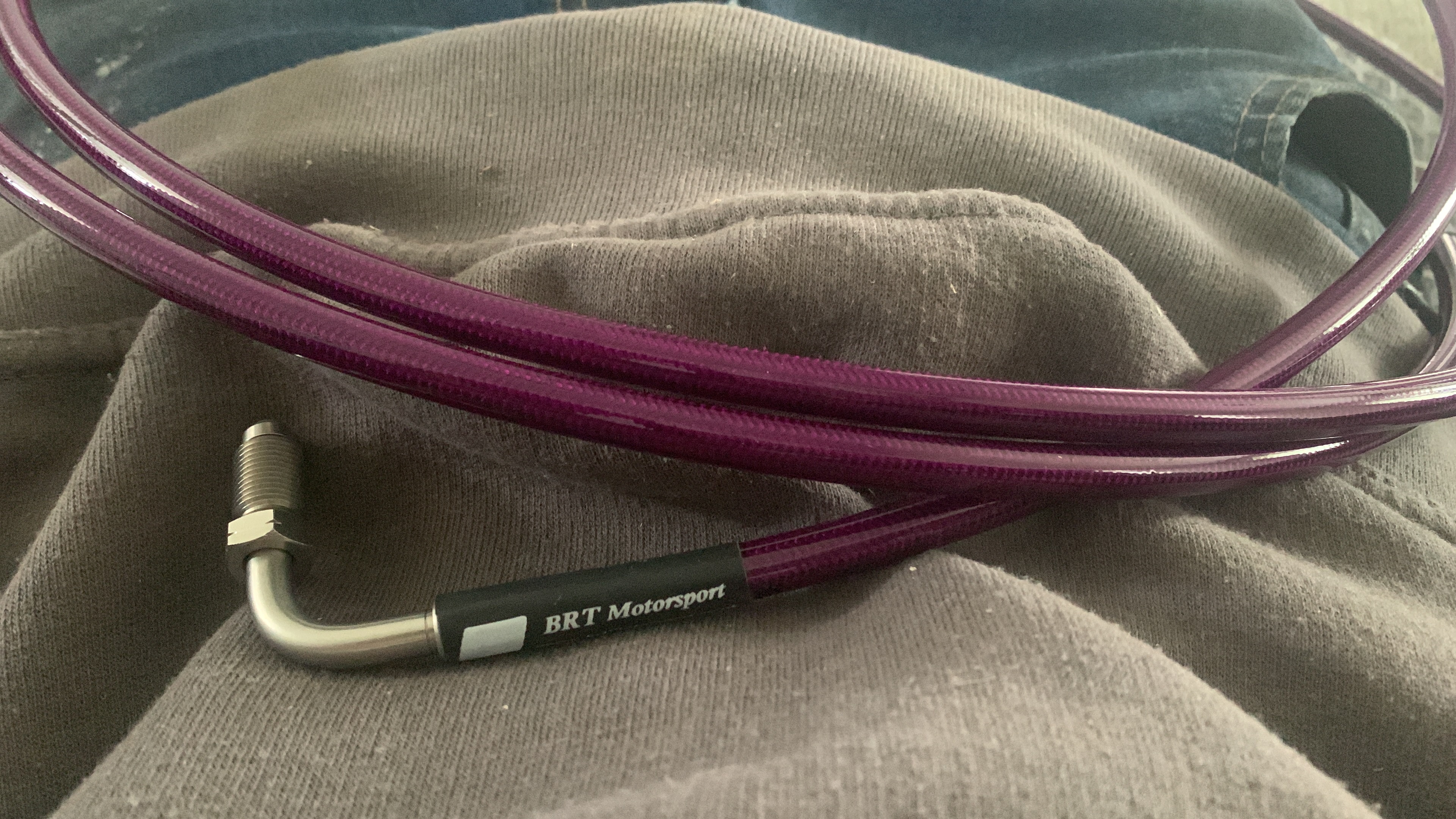

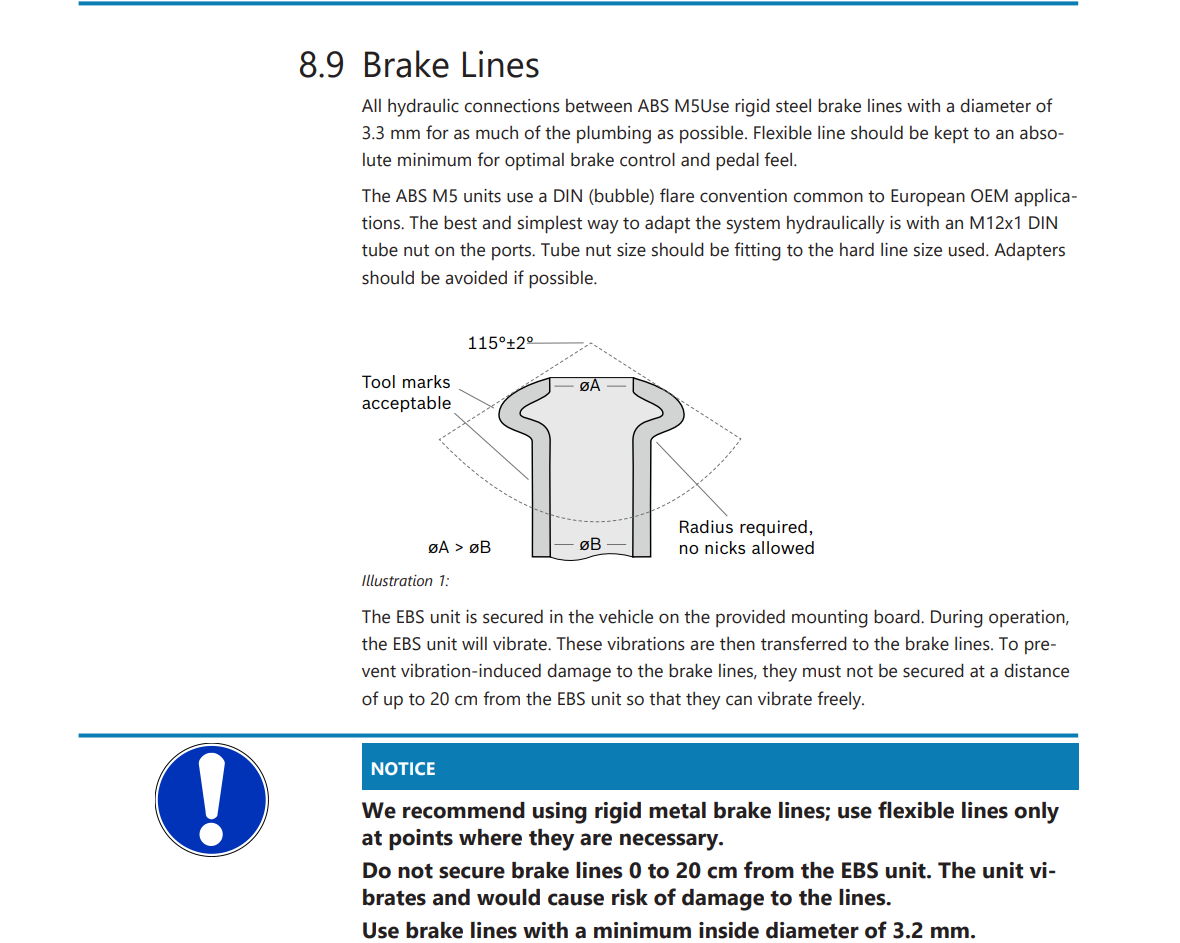

Nothing wrong with hardlines, the rears only suffer because they are badly exposed to road much and rub in the clips. I don't mind the rear braided kit replacing the hardlines as its a quick issue solved however if you were building something you would have as much hardline as possible.
