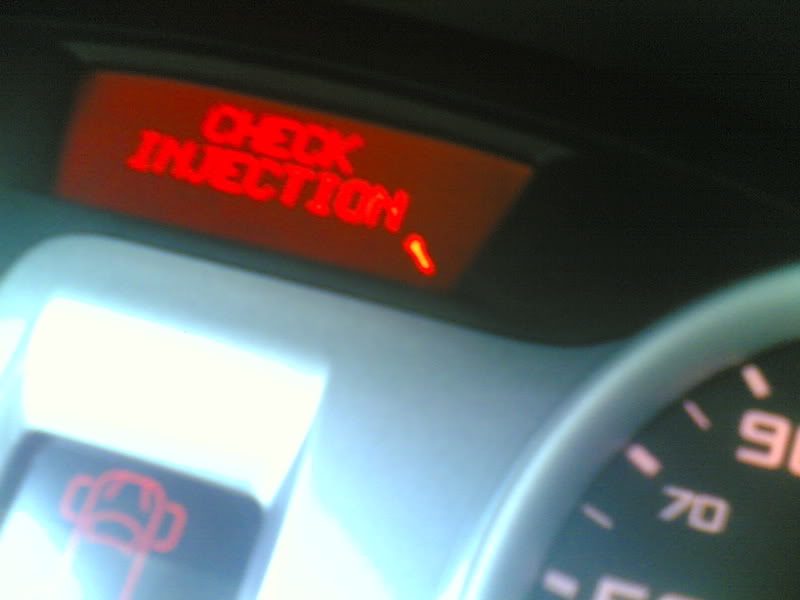

while driving to the dealers (slowly, barely keeping the car alive) this showed up on trip. comp.
so they took out the injectors, cleaned them (one of them was down due to LOUSY FUEL) .
All good now
