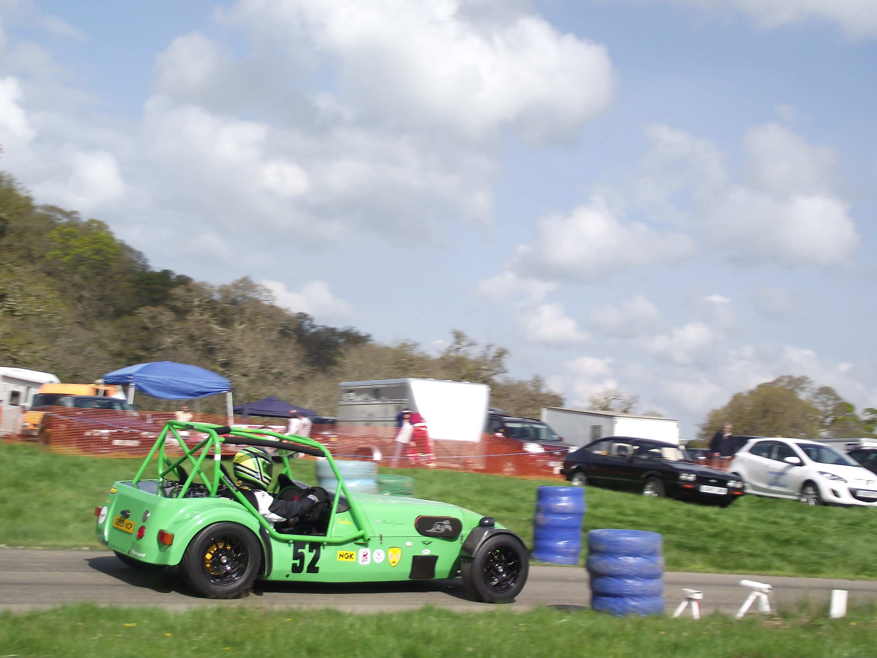

I have drum rear brakes(albeit Sierra estate so quite big) on my 300 bhp kit car but they are only hauling down a 700 kg car. No fade issues as they are only used for a minute or so at a time in hillclimbs and sprints, or driven sanely on the road.

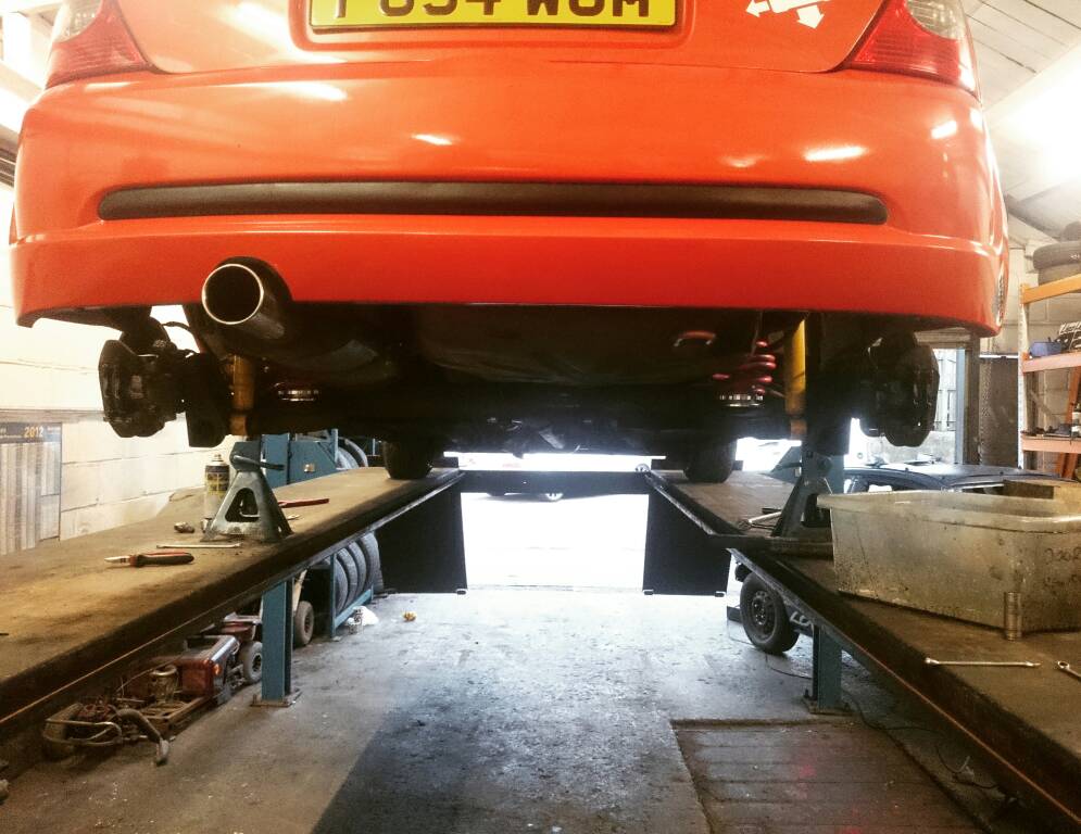

We literally pulled the full setup off a 182, dropped the beam, fitted new sensors as the sport ones don't work on a non sport, fitted new pads and bolted it on and then connected and bled everything
I'm honestly really happy with it, I never planned on the conversion, but circumstances meant I needed a new rear beam so I thought it be a good subtle upgrade
Haven't had a problem other than replacing a calliper after breaking the bleed nipple
