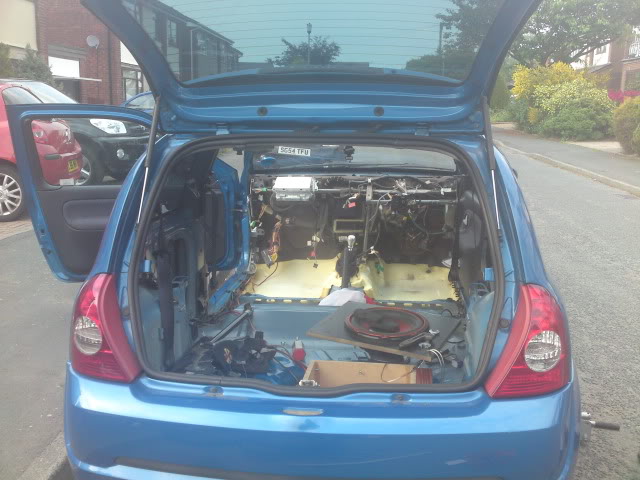

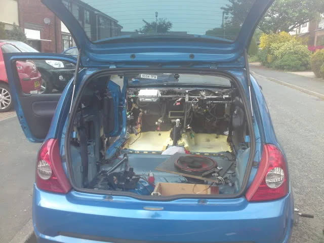

About 5-6 weeks ago i started an engine conversion outside my house on the road with a mate, from a 1.2 to a 2.0l to make the car afull cs rep. 6 weeks later the car still isnt running, the engine went in fine and started up first time but when ever you set off it just seems to run crap and cut out within 200 yards.
Ive changed everything i can think of, sensors, relays, fuses etcc... i even got the lads from NW performance to come up and have a look, after they dipped there heads in the bonnet for a couple of hours they were totally stumped still but we manged to find out that it only cut out and the rev's dipped when you turned the steering wheel, suggesting that its an electrial problem. So this last couple of weeks i stripped the car totally out and swapped the interior wiring loom over to a sport, tried running it again and still no luck, did exactly the same only this time blew the 'stop' fuse everytime i set off and now wont even start :dapprove:
So atm im totally out of love with the car, theres bits and pieces EVERYWHERE, literally all over the house, from sets of wheels in my front room to my old 1.2 engine down the side of my house. I have no idea what the problem is now and just basically totally lost on what to do with it.
I guess i have to options atm,
1. Send the car to the guys down at NWP and just leave it for them to look at which could would mean endless money could be spent, paying for them to find the problem, and whos to say now its been messed about with wheather it will have problems in the future.
2. Sell the car as a non working car and everything i have ( spare parts wise) and run away from clios altogether, this would mean id lose alot of money. Ive put alot of effort, time and money into making the car get to where it is today, looks wise, so running away would be quite weird as im associatied with my car and how much effort and time goes into it. Ive also spent alot of money on insurance for the 2.0l as im only 19 which ive already payed + id feel as though id have to get a new car that has at least the same power as the 2.0l engine would of had.
I need to take a big decision very soon as im really struggling to live without a car.

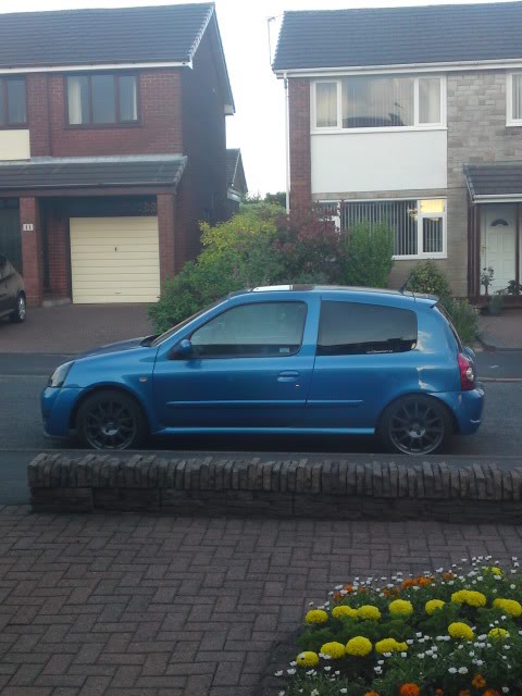

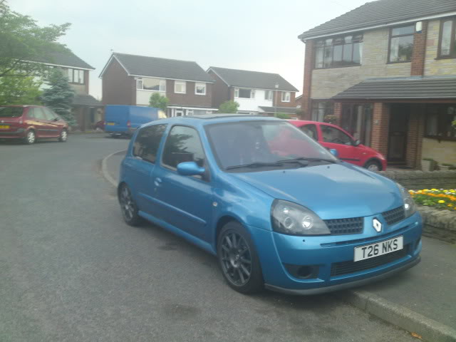

Yeah i guess i have learnt the hard way, dont get me wrong i really have enjoyed doing it (till it got to the 3rd week) and ive learnt so so so much about clios/engine's so i guess some good has come out of it.
This is how shes standing atm
  Evora, C-HR & A180
Hope you get it sorted mate. It would be a shame to get rid after putting so much effort into the car, you'l soon fall back in love when you take it on a first run once its sorted, hopefully it is the power steering switch. Id keep it tbh mate
car looks spot on such a shame you cant get it to work. surely if you are putting a 2l in doesnt it mean you really should change other things too such as gearbox, and rear beam with brakes? fair enough you say you young but i just cant see doing all this would be cheaper than getting a 182. but fair play for giving it a go, hope you get it sorted asap
