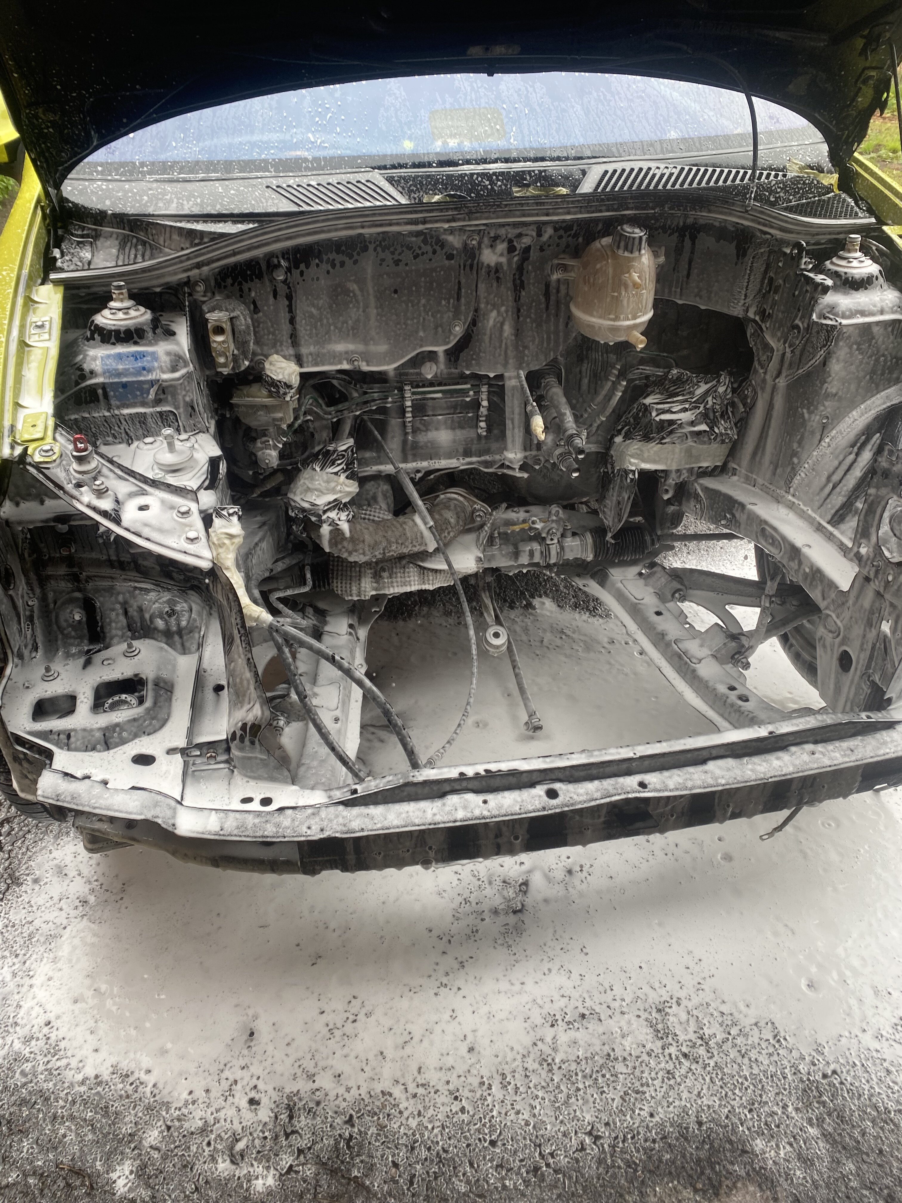

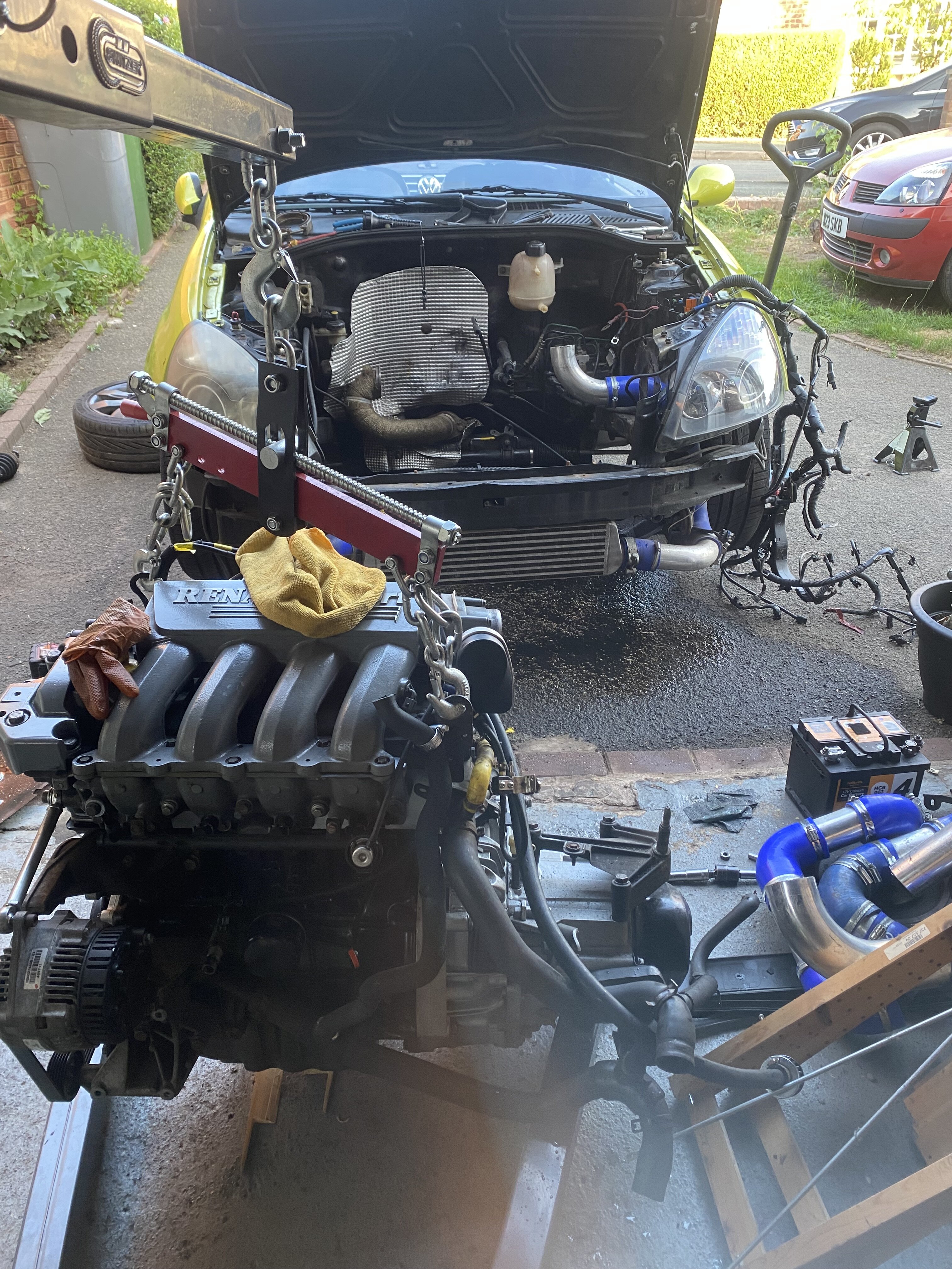

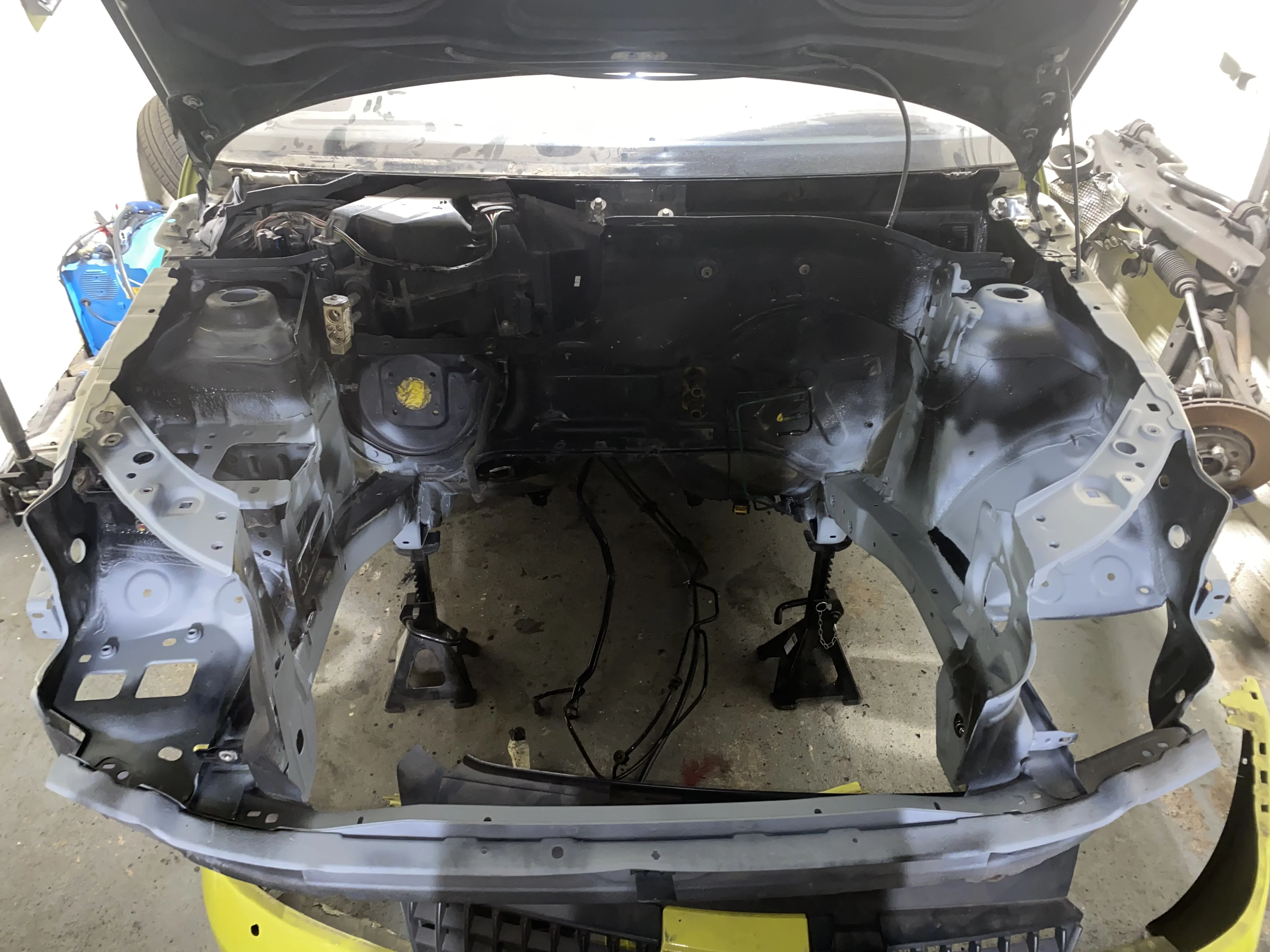

Currently, the car is on stands with the engine removed as the sump seems to be leaking so I thought id remove the engine, sort the leak and get round to painting the engine bay to match the rest of the car
After removing and wiring and boost pipes out the bay I gave it a decent clean as it was caked in dirt oil and grease

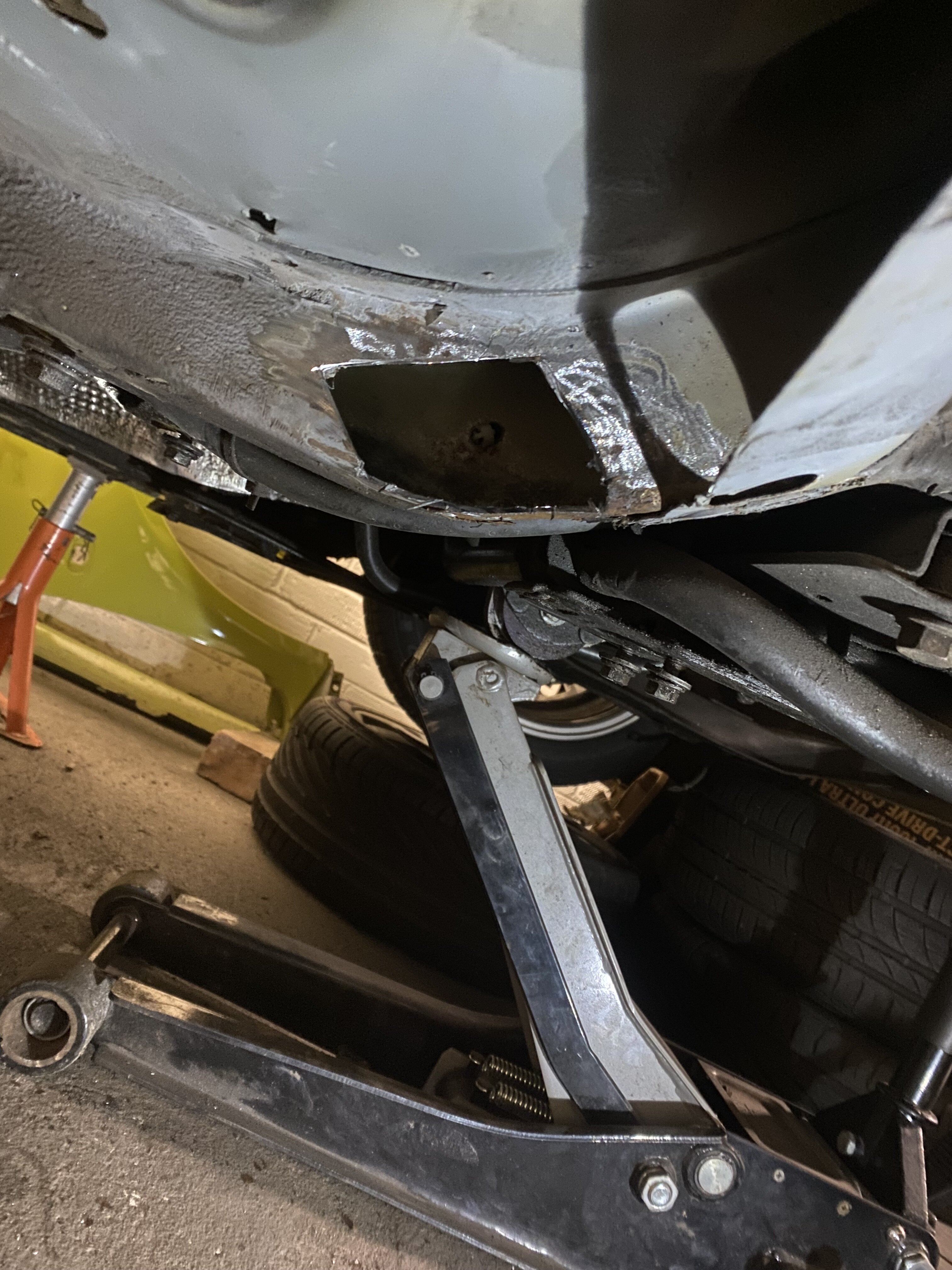

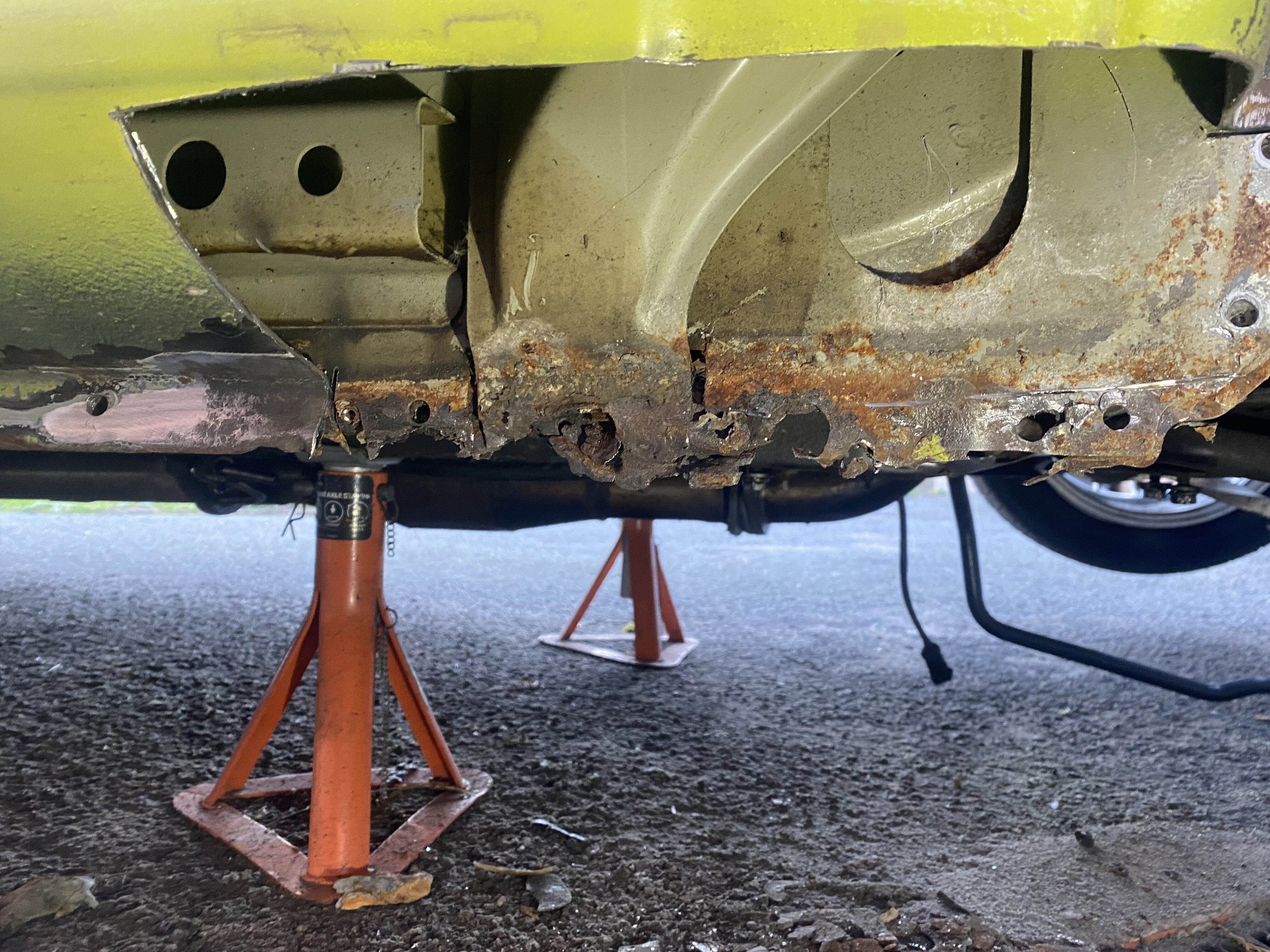

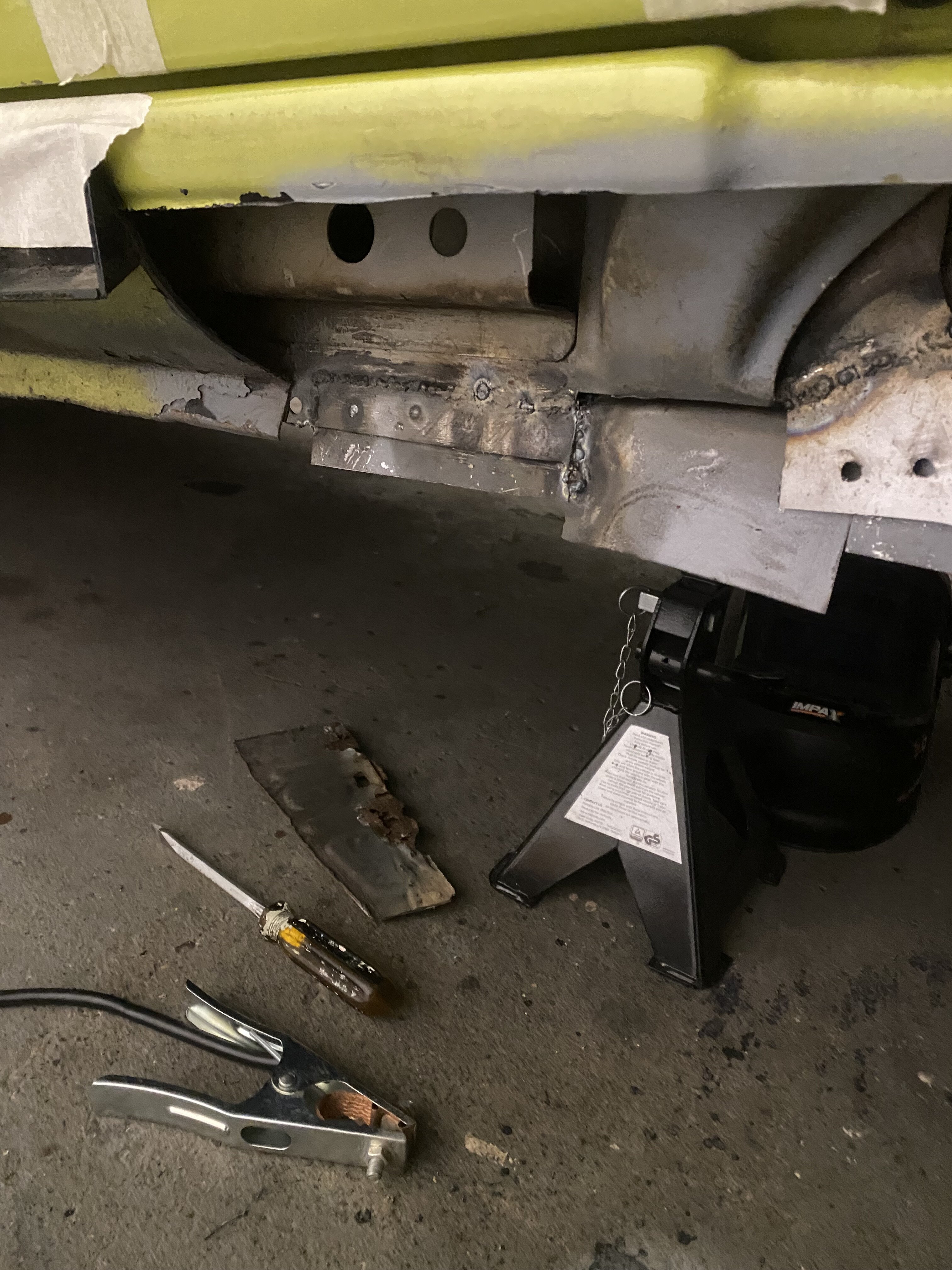

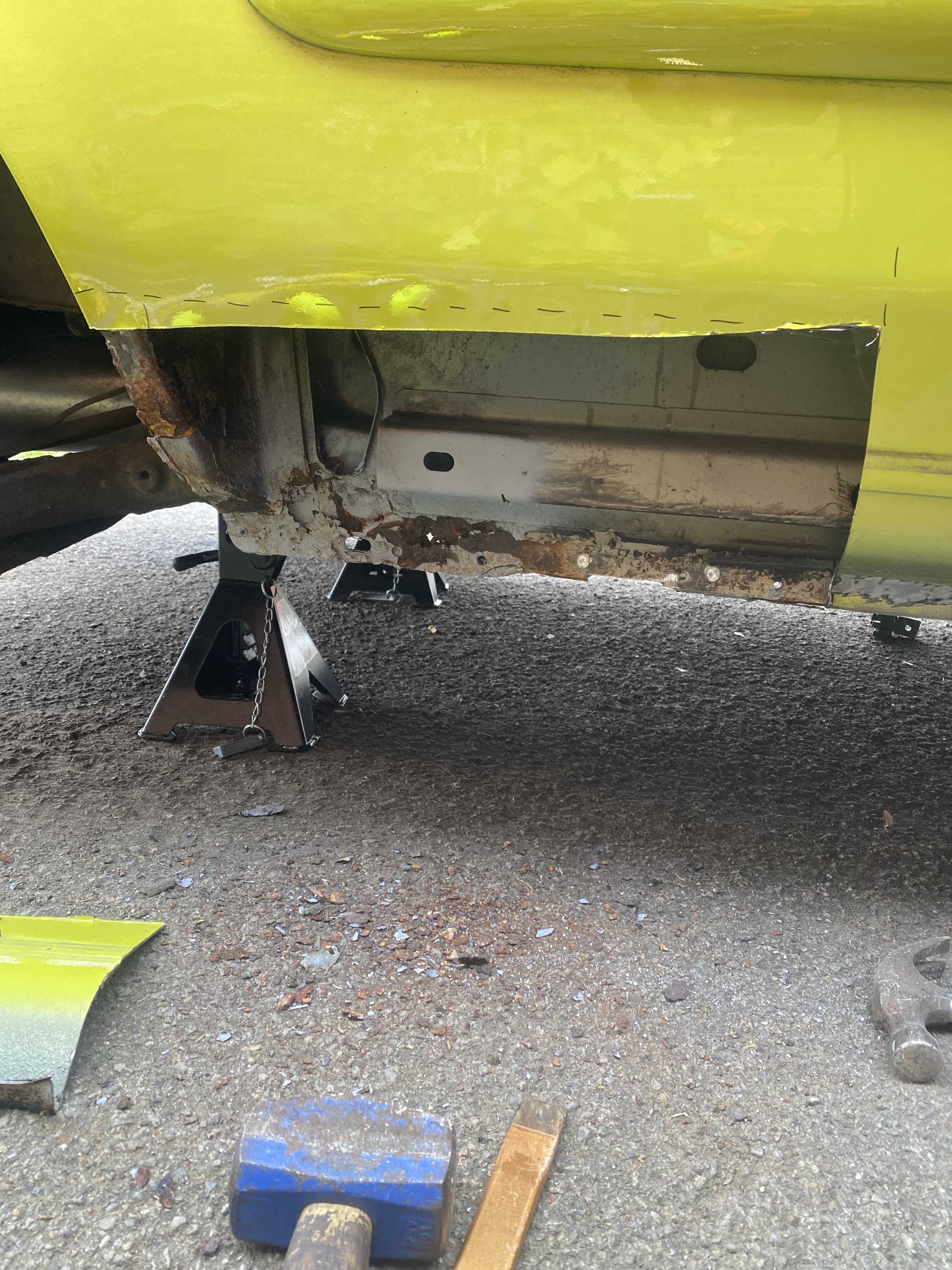

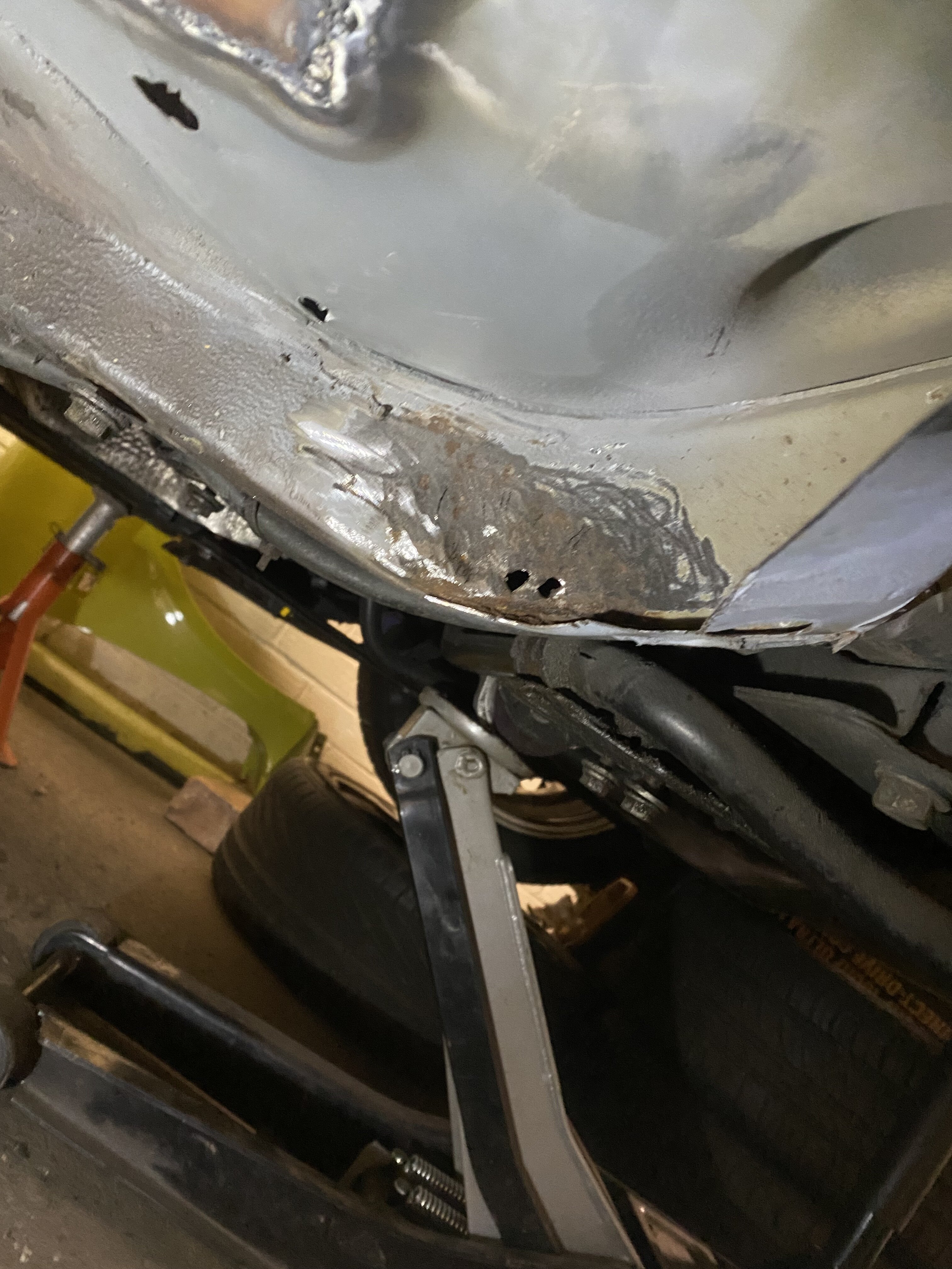

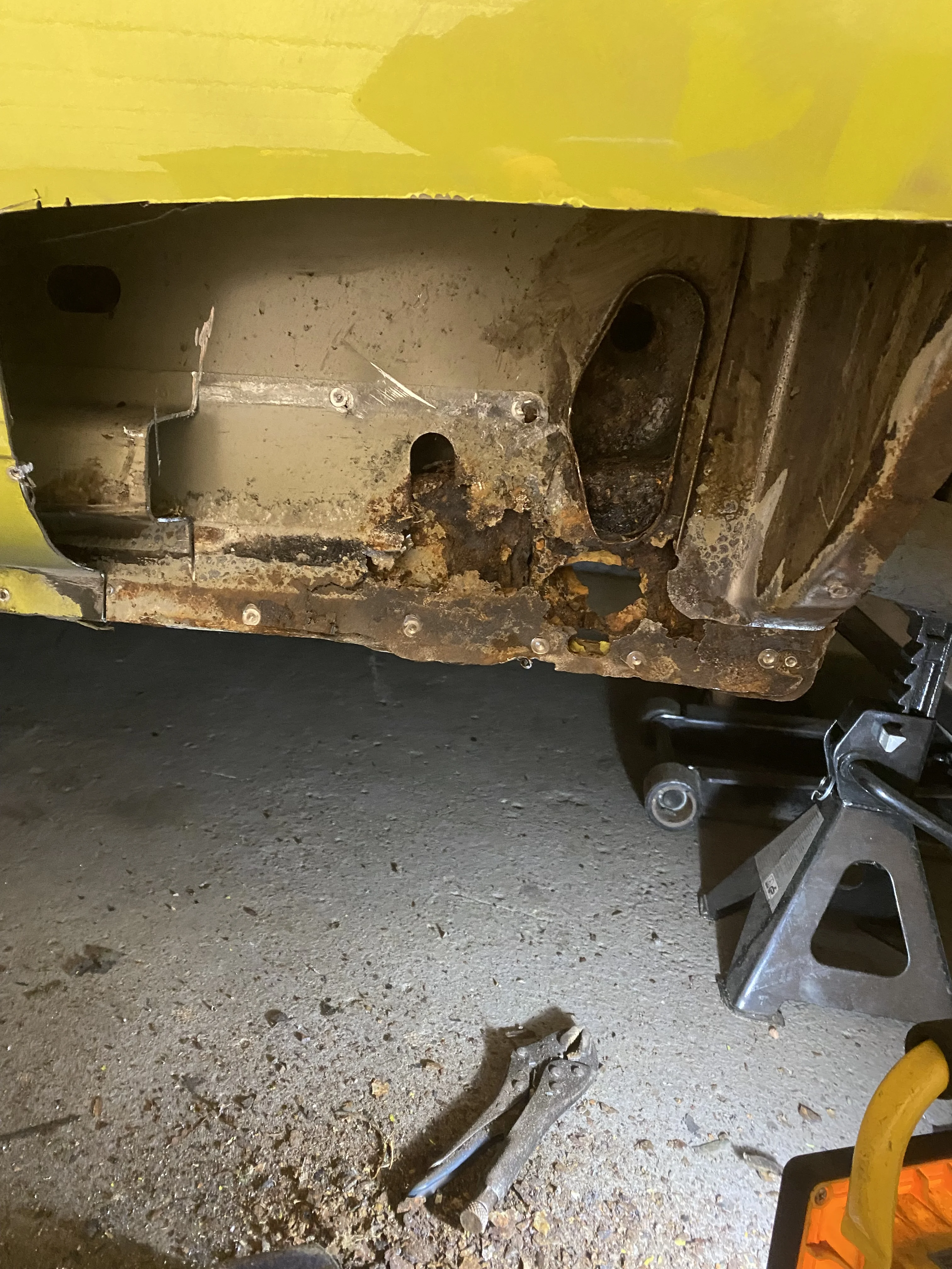

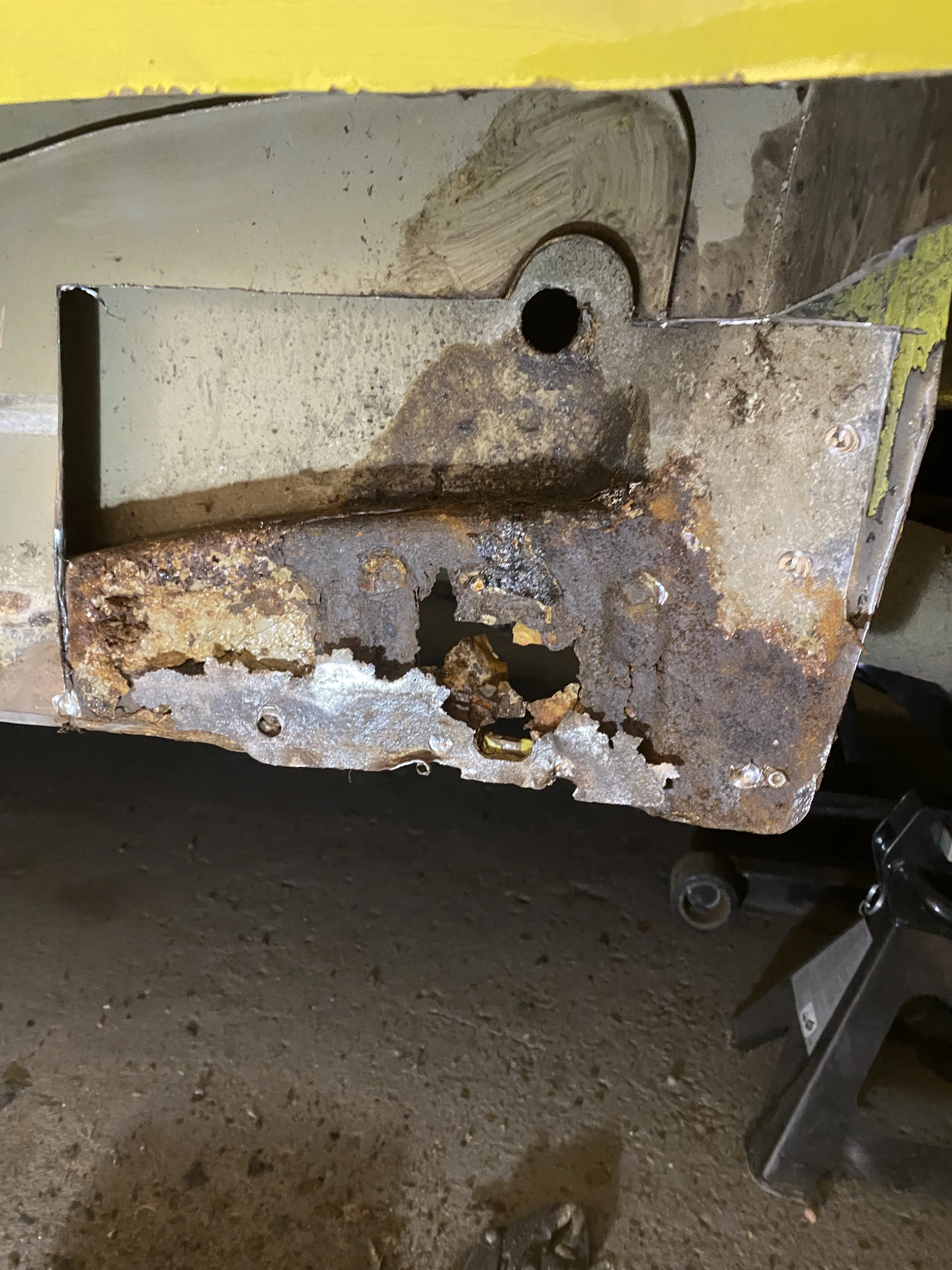

Fast forward to today, I wanted to spend some time on getting the engine bay prepped for some epoxy primer and I also wanted to see if i could do anything to my front jacking points…
Which led me to this…

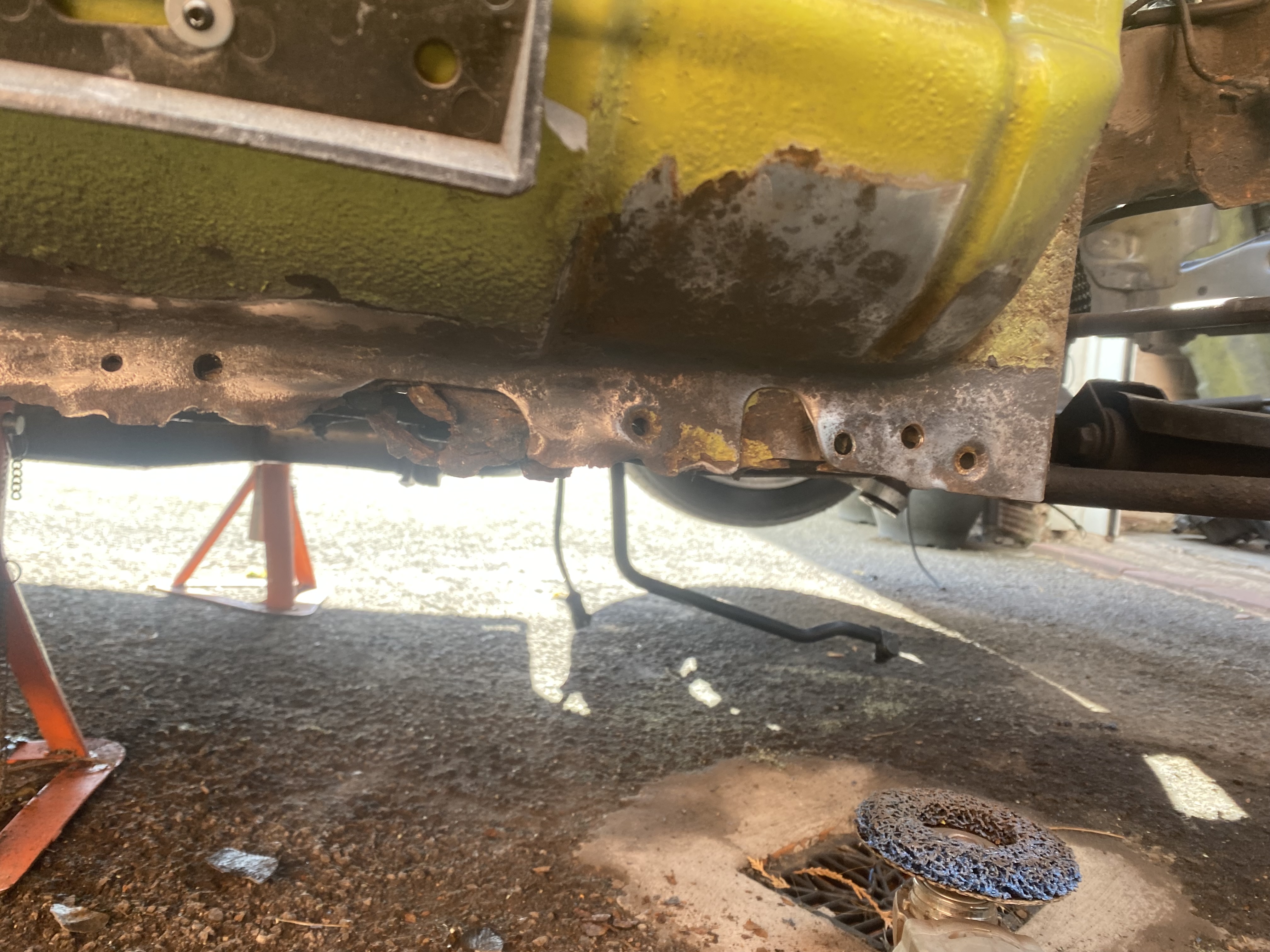

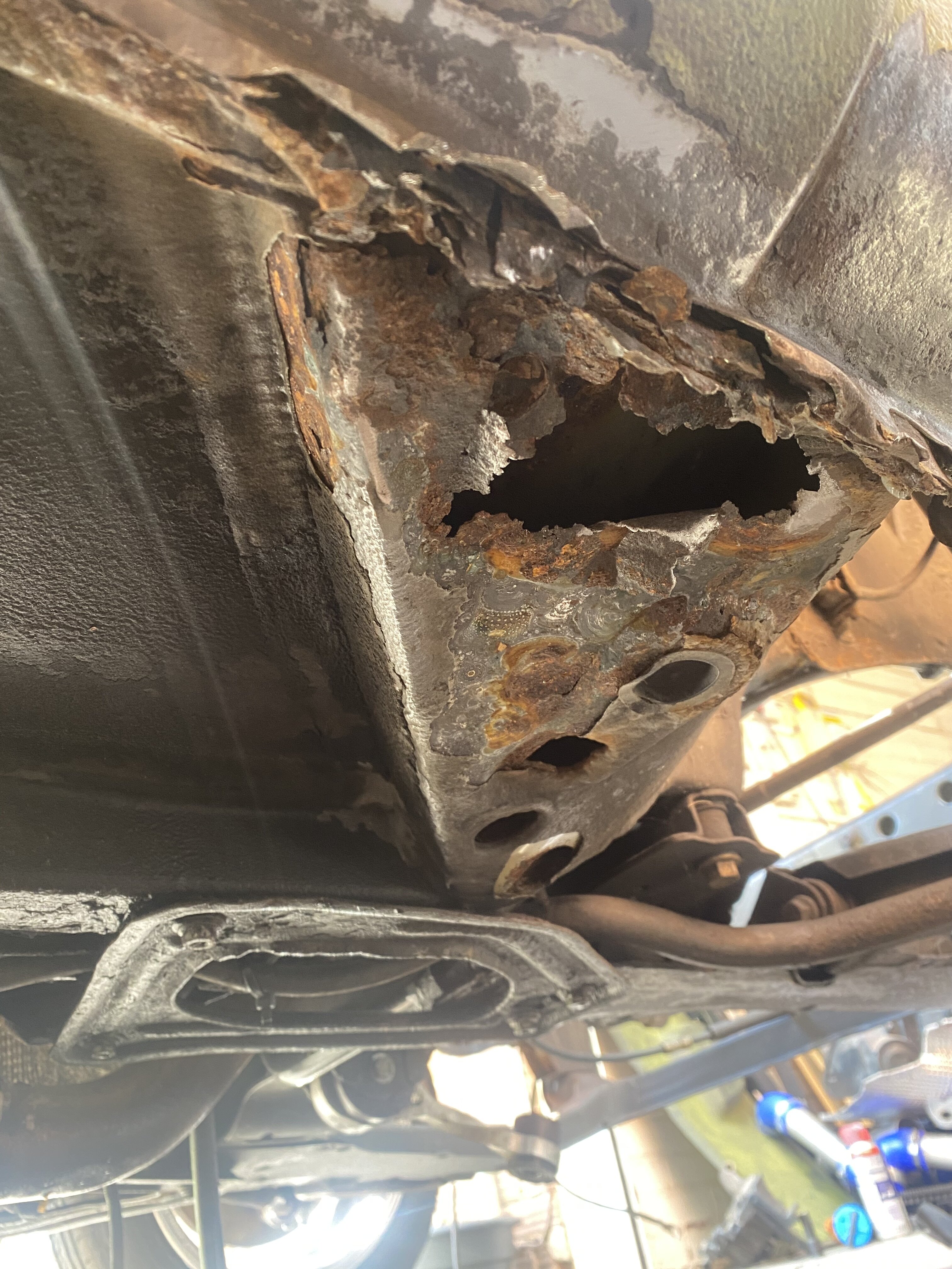

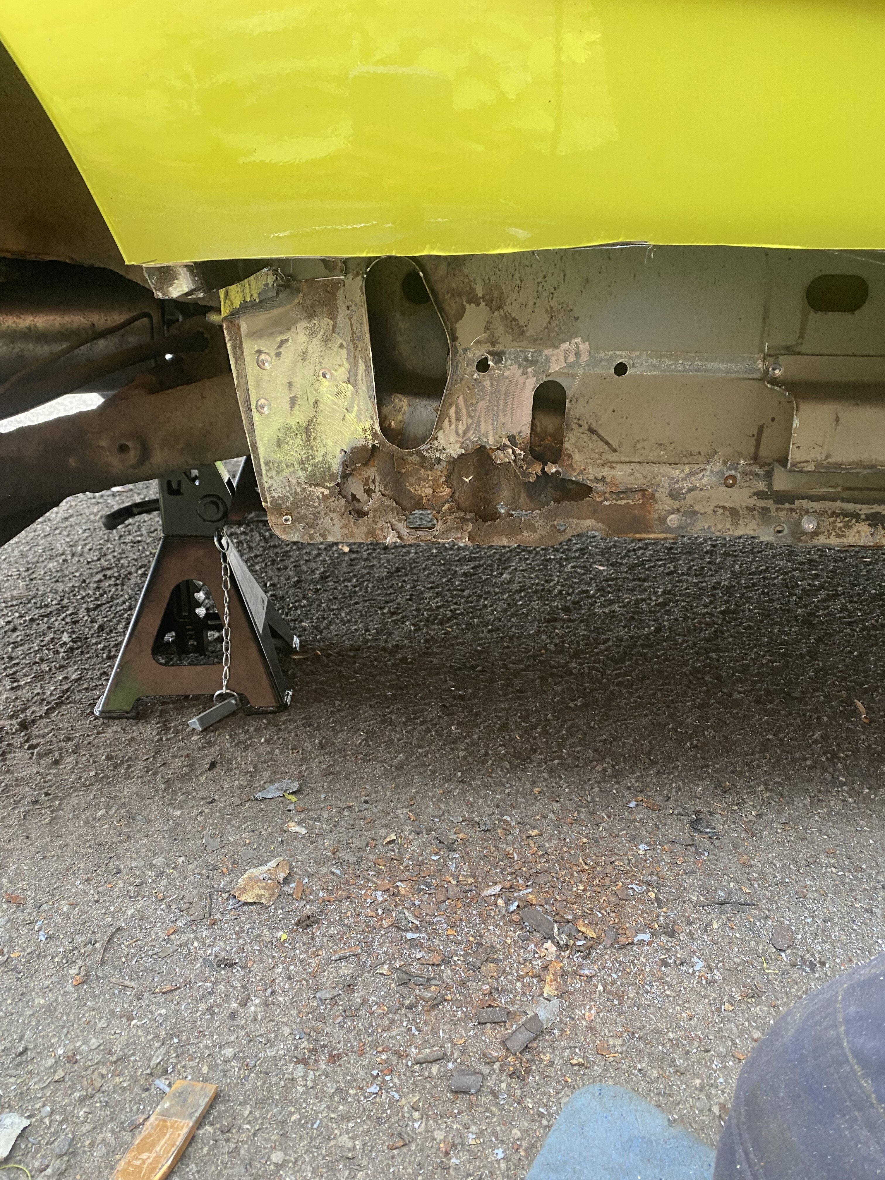

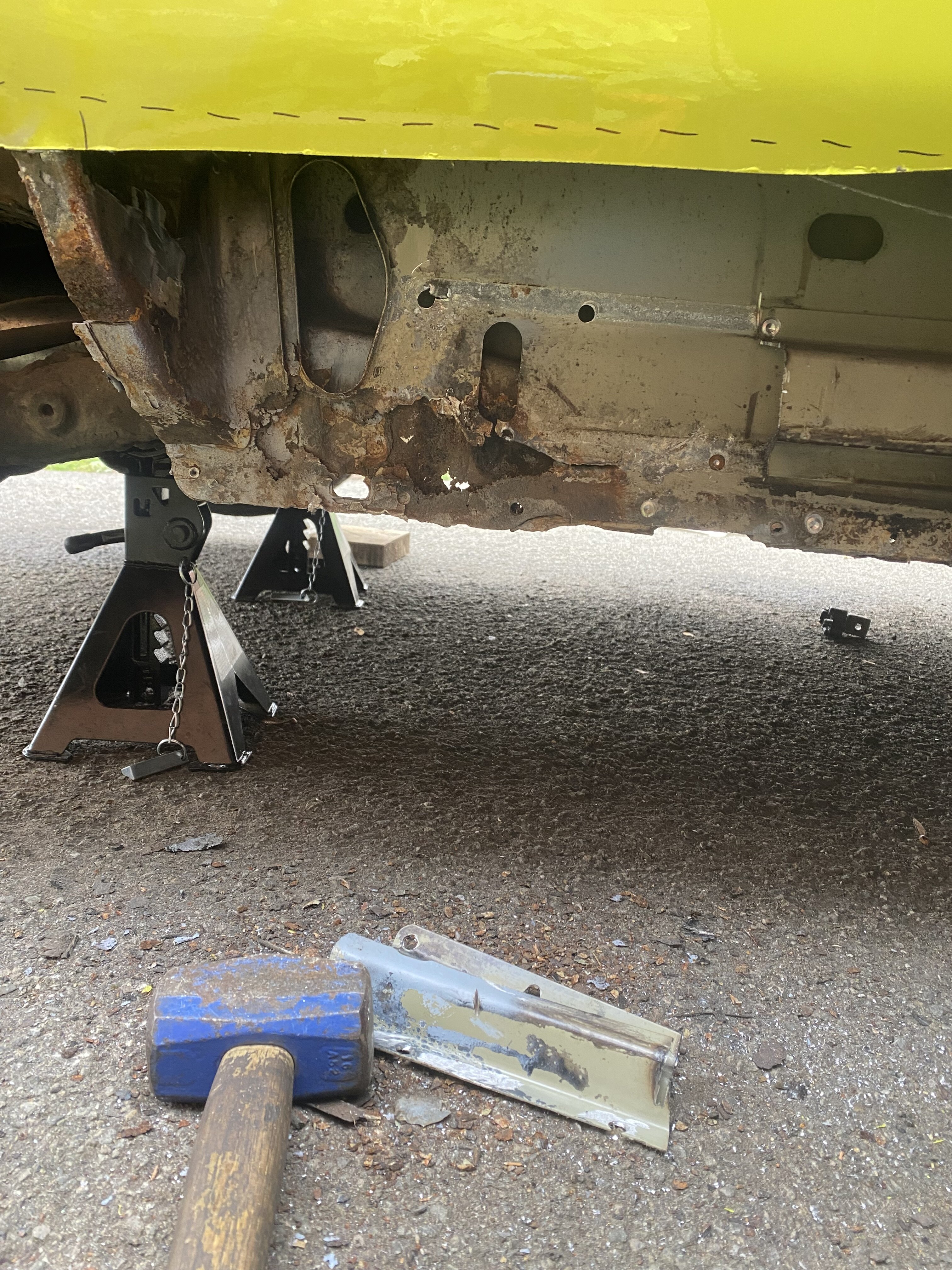

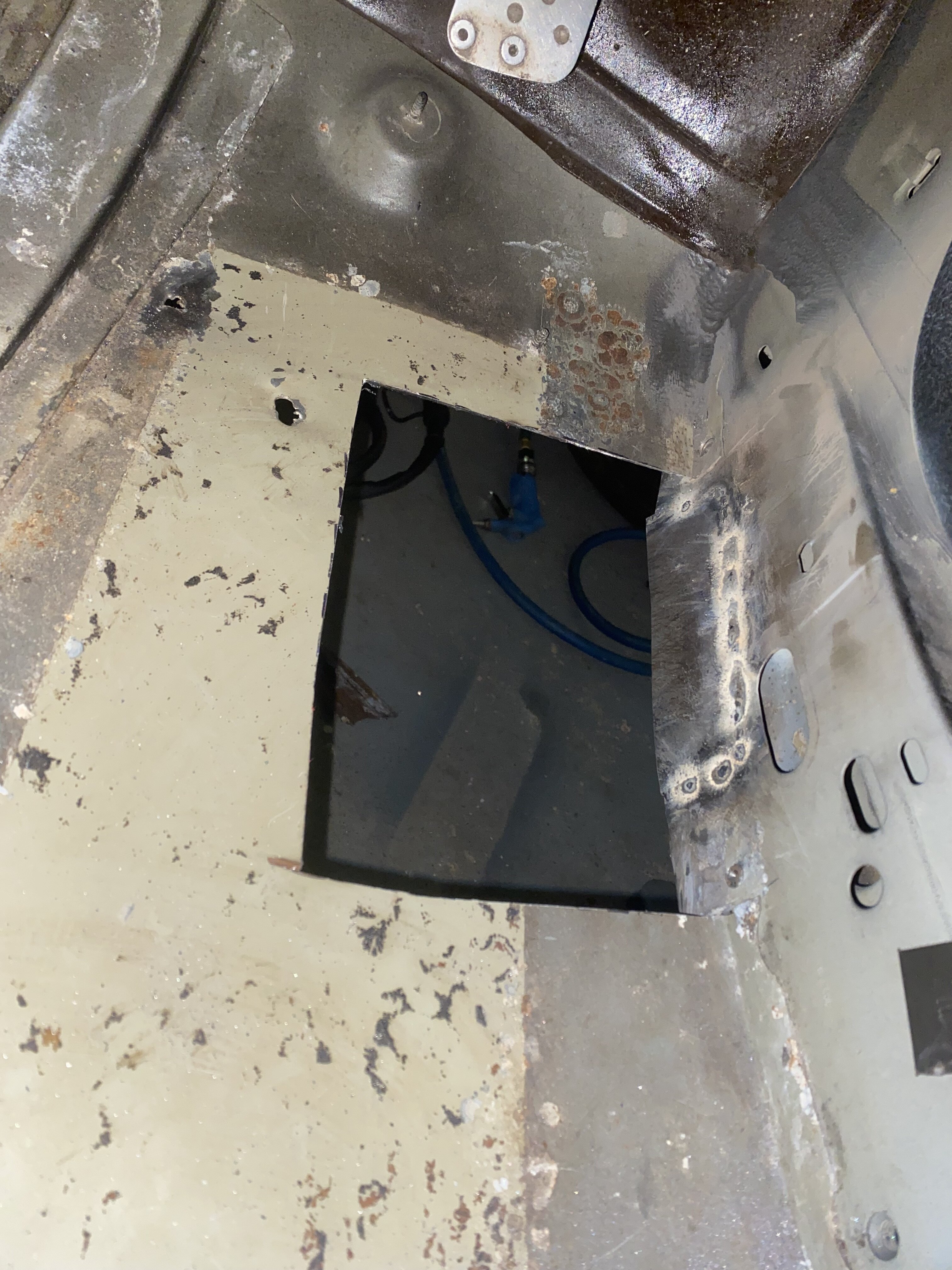

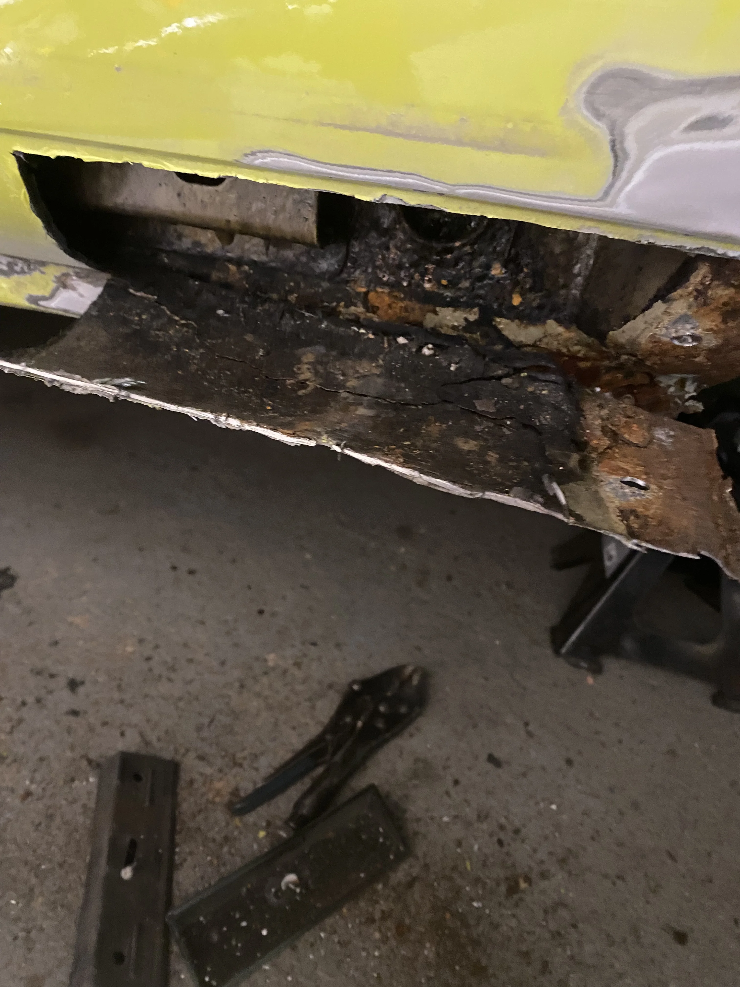

I knew they were bad and needed some attention but I had no idea what was hiding under the underseal… I decided to get stuck in and cut out any bad metal and make a plan on welding in some fresh metal
So this is where Im up to now, still need to do the N/S but I might concentrate on the O/S for now

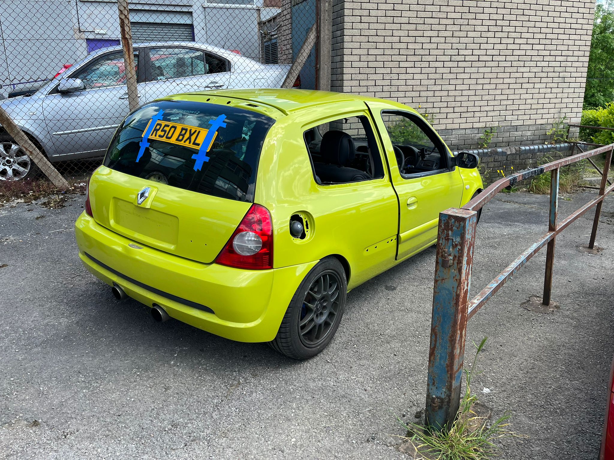

This is beautiful! Do you have any better/more pictures to drool over? The colour suits it really well!
Good progress on the rust repairs too. Strange how these are so bad, I was sure they were galvanised from the factory!
Im so bad for taking pictures but Im sure i have some better ones
I think the factory underseal hides a lot of the horrors underneath, as soon as the rust sets in, its only a matter of time sadly, im glad Im sorting mine while it’s relatively minor
Those pictures really show off the colour. Suits it so well!! (I know it’s a Clio (v6) colour, but still!) I wonder why they didn’t offer it alongside liquid yellow and petrol blue.

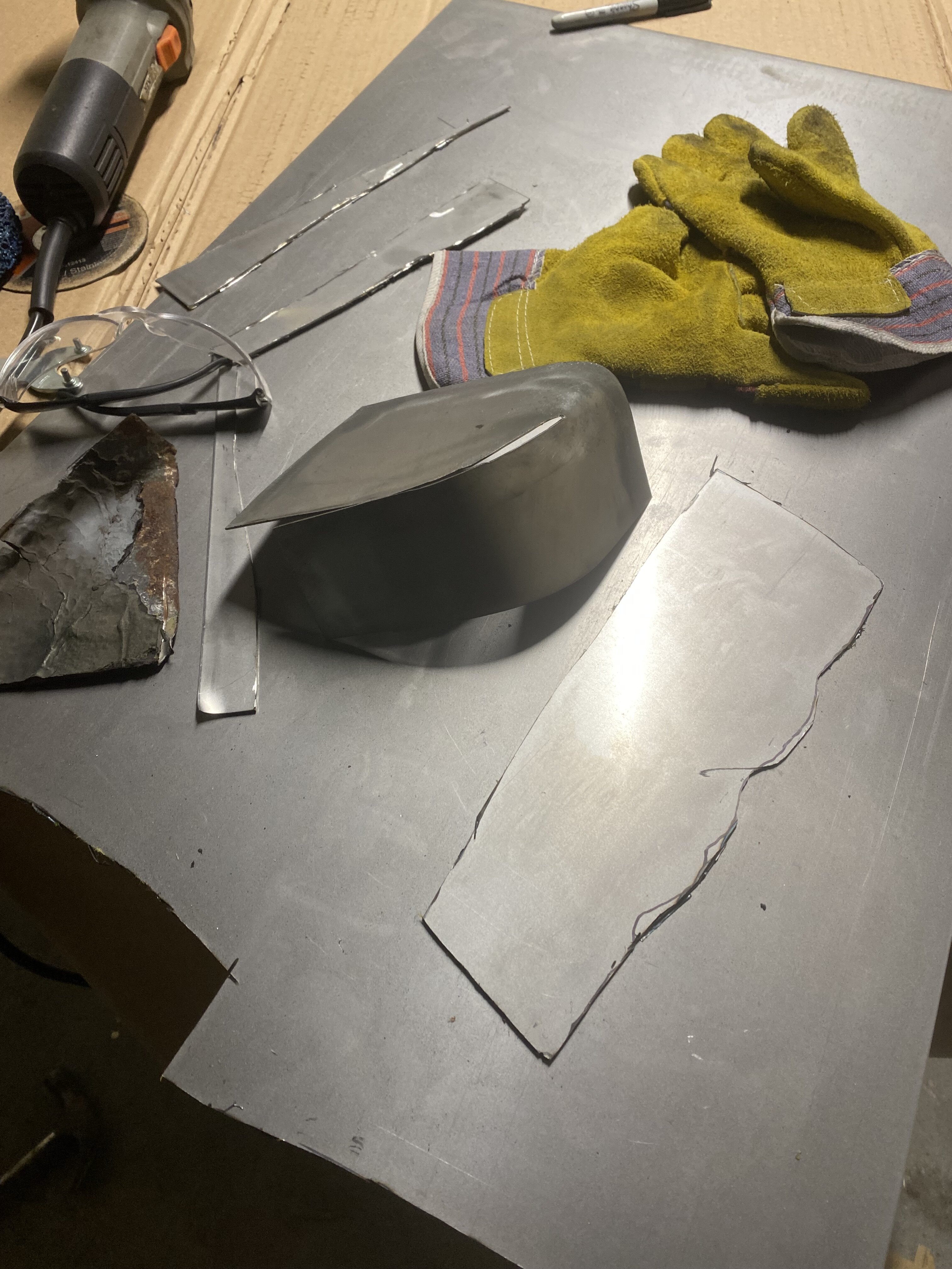

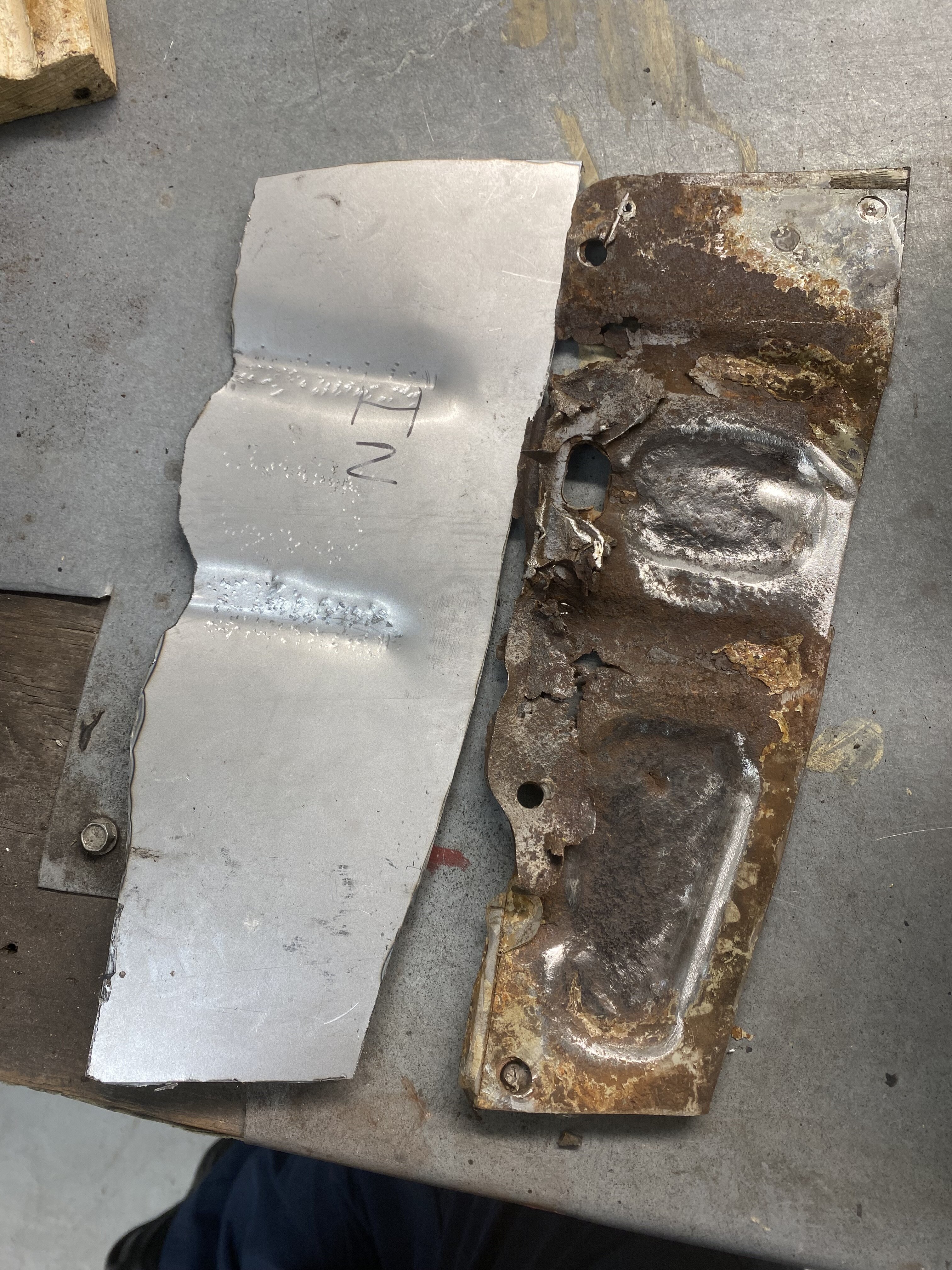

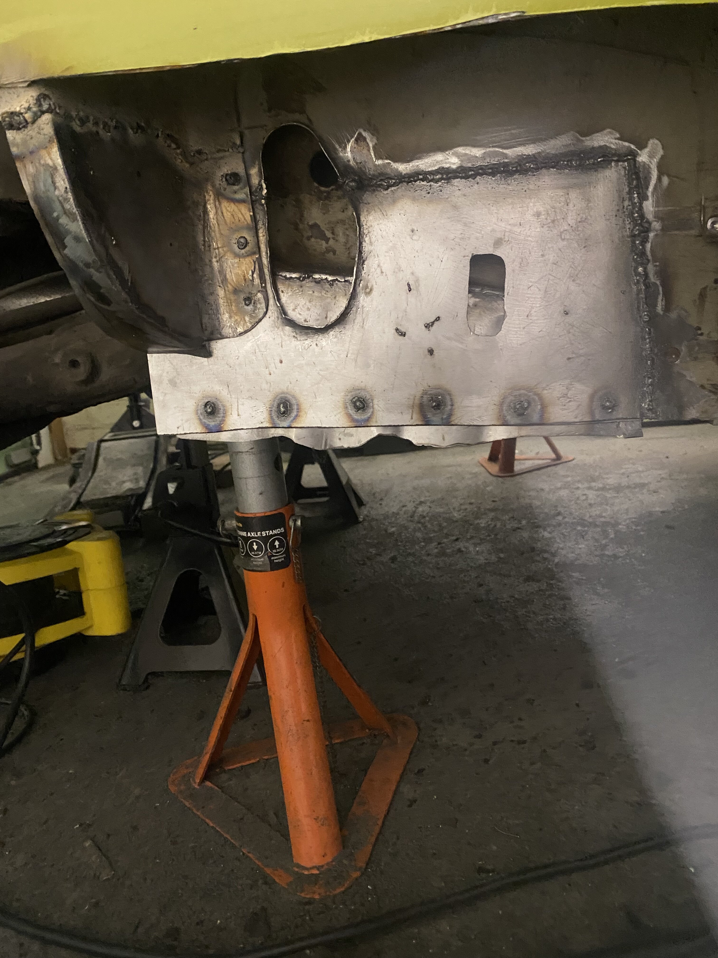

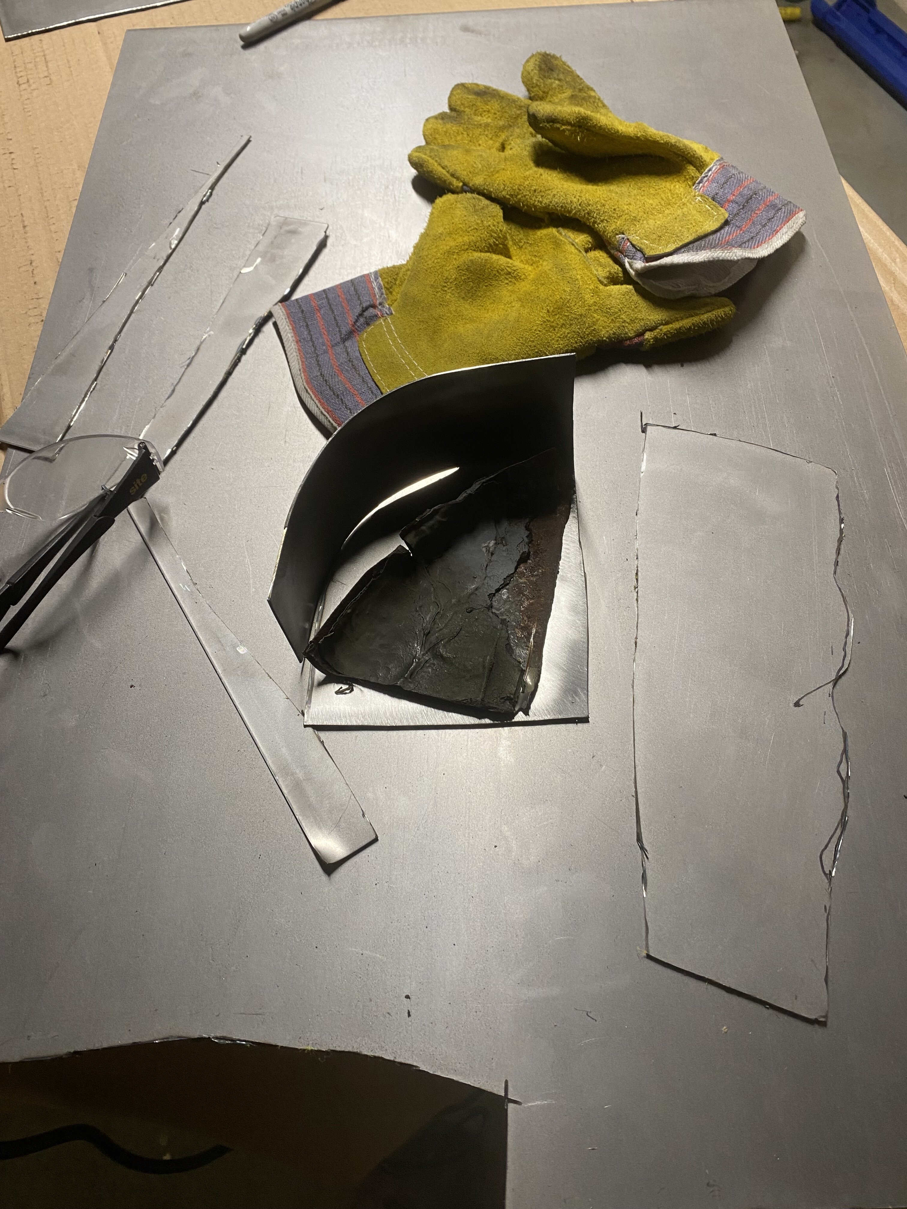

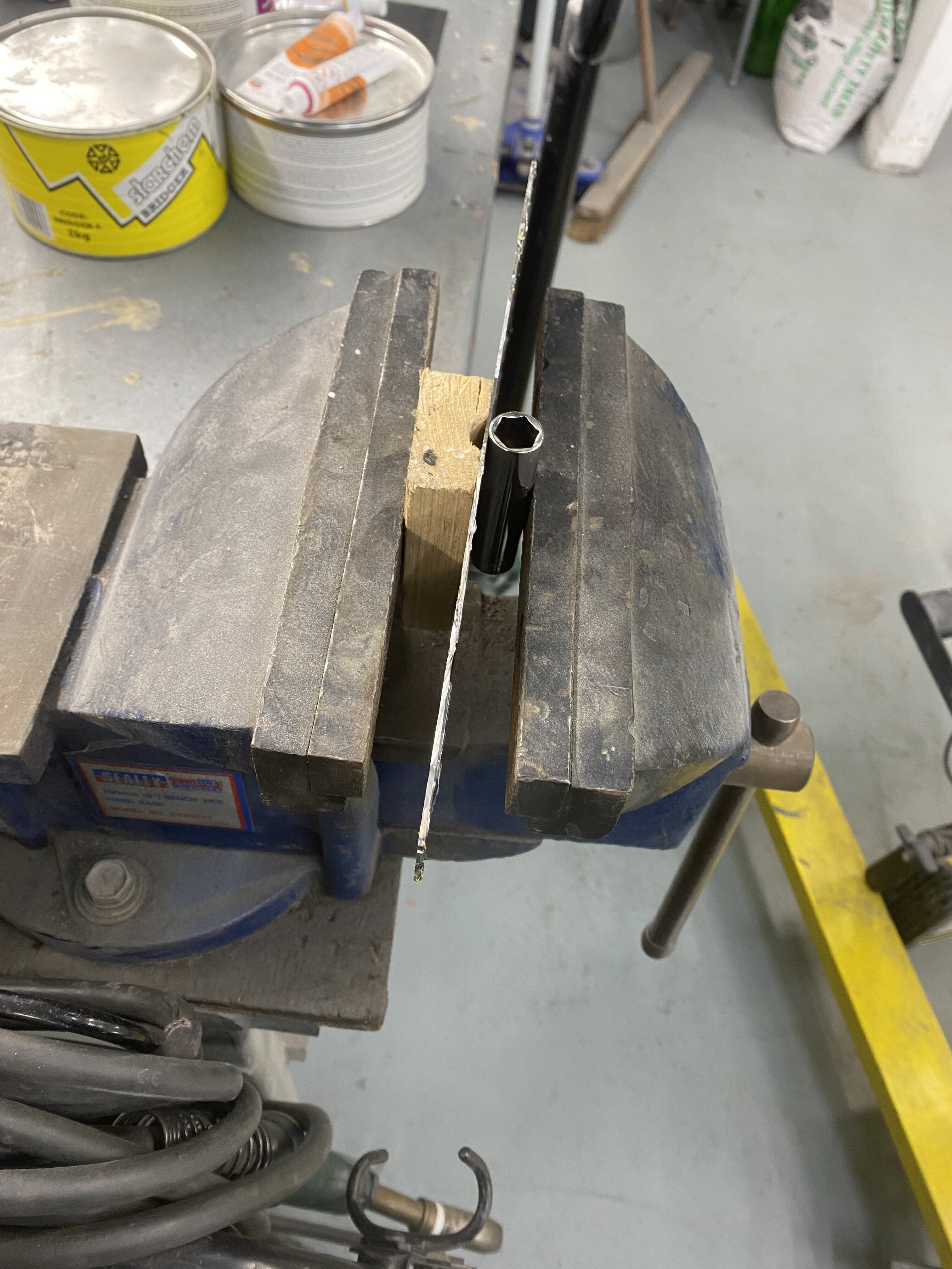

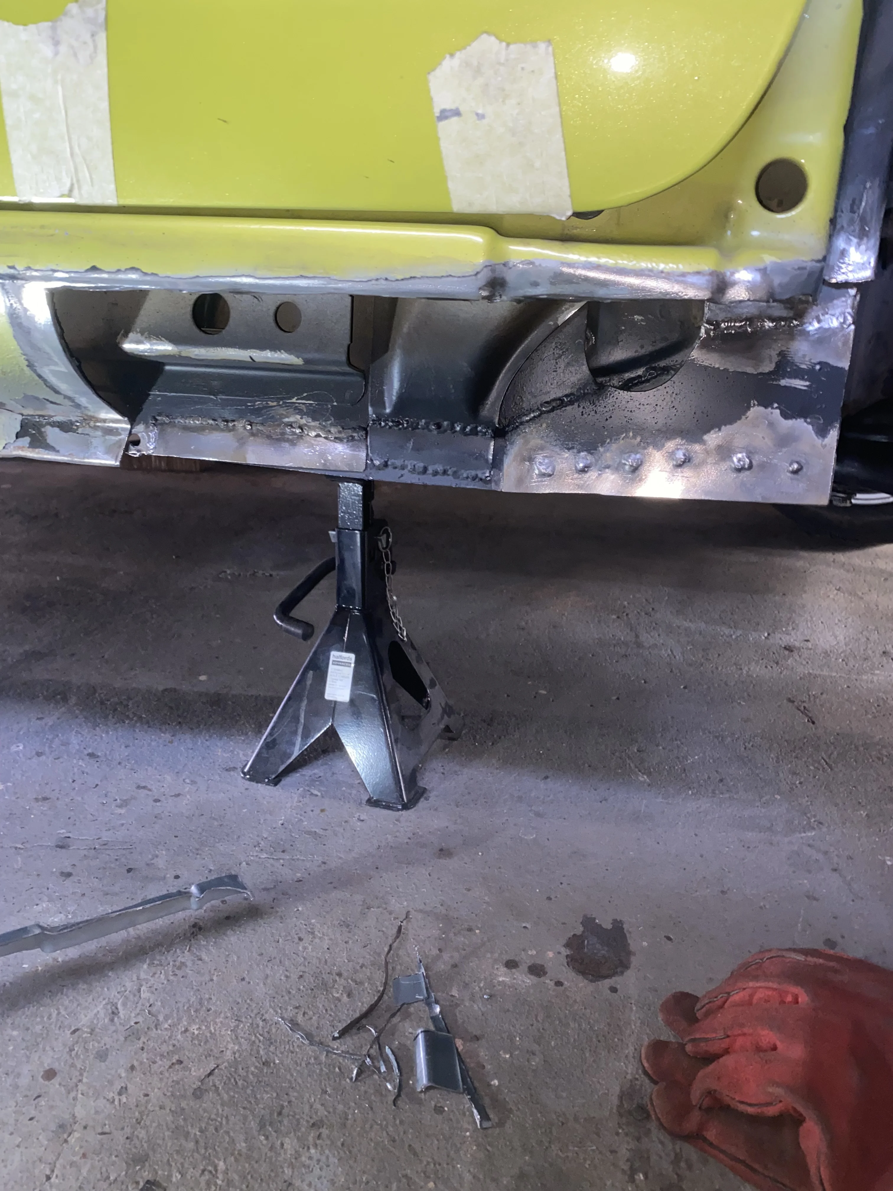

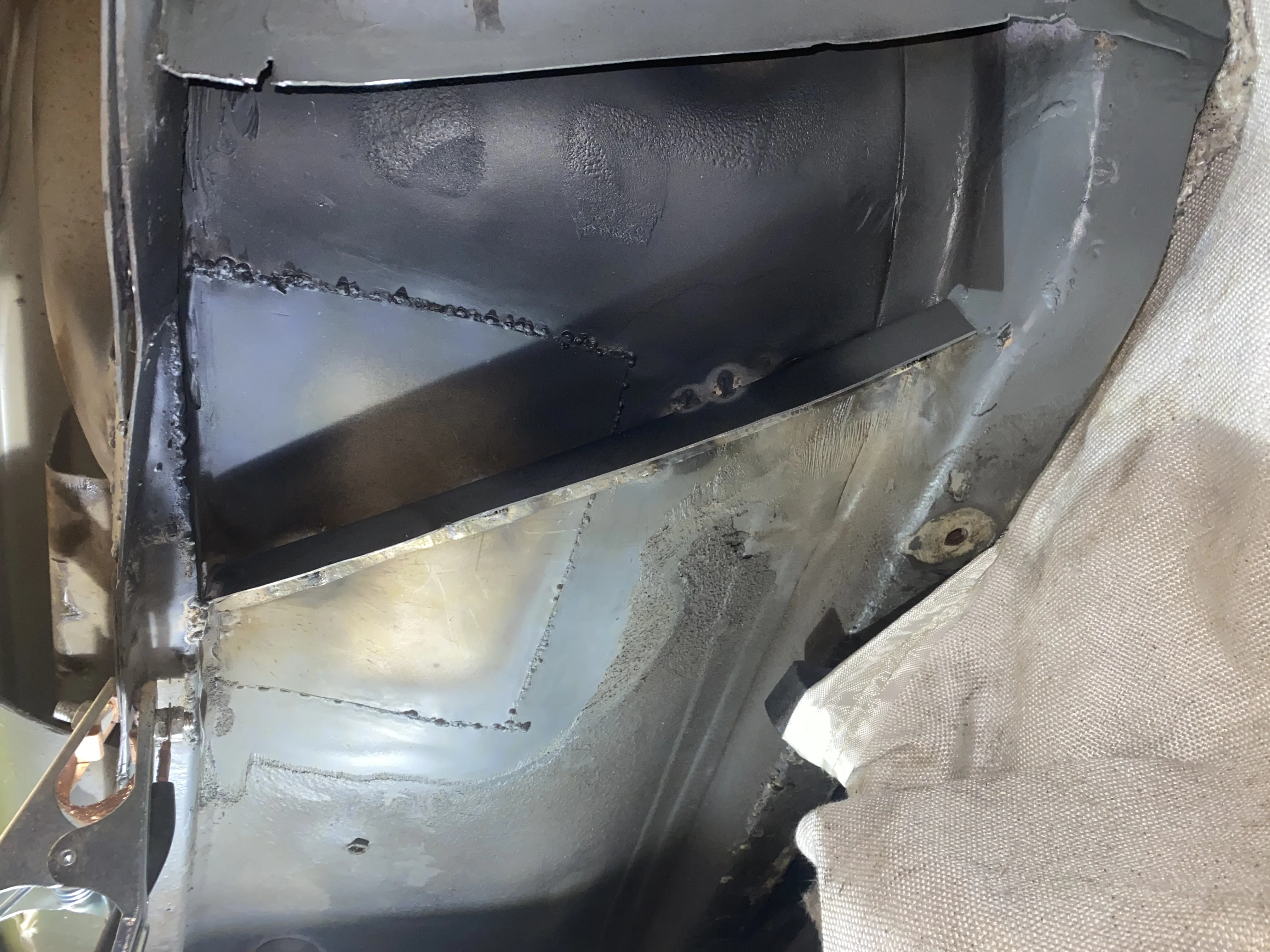

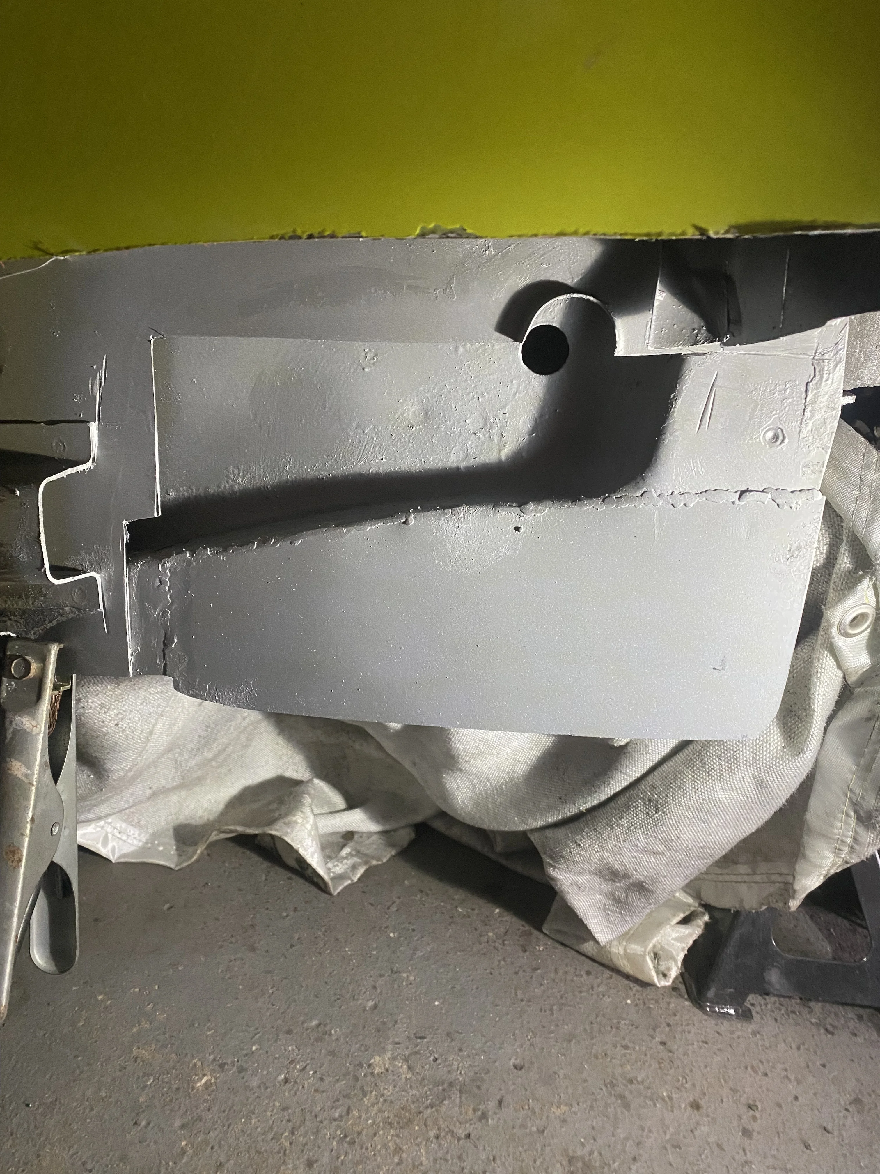

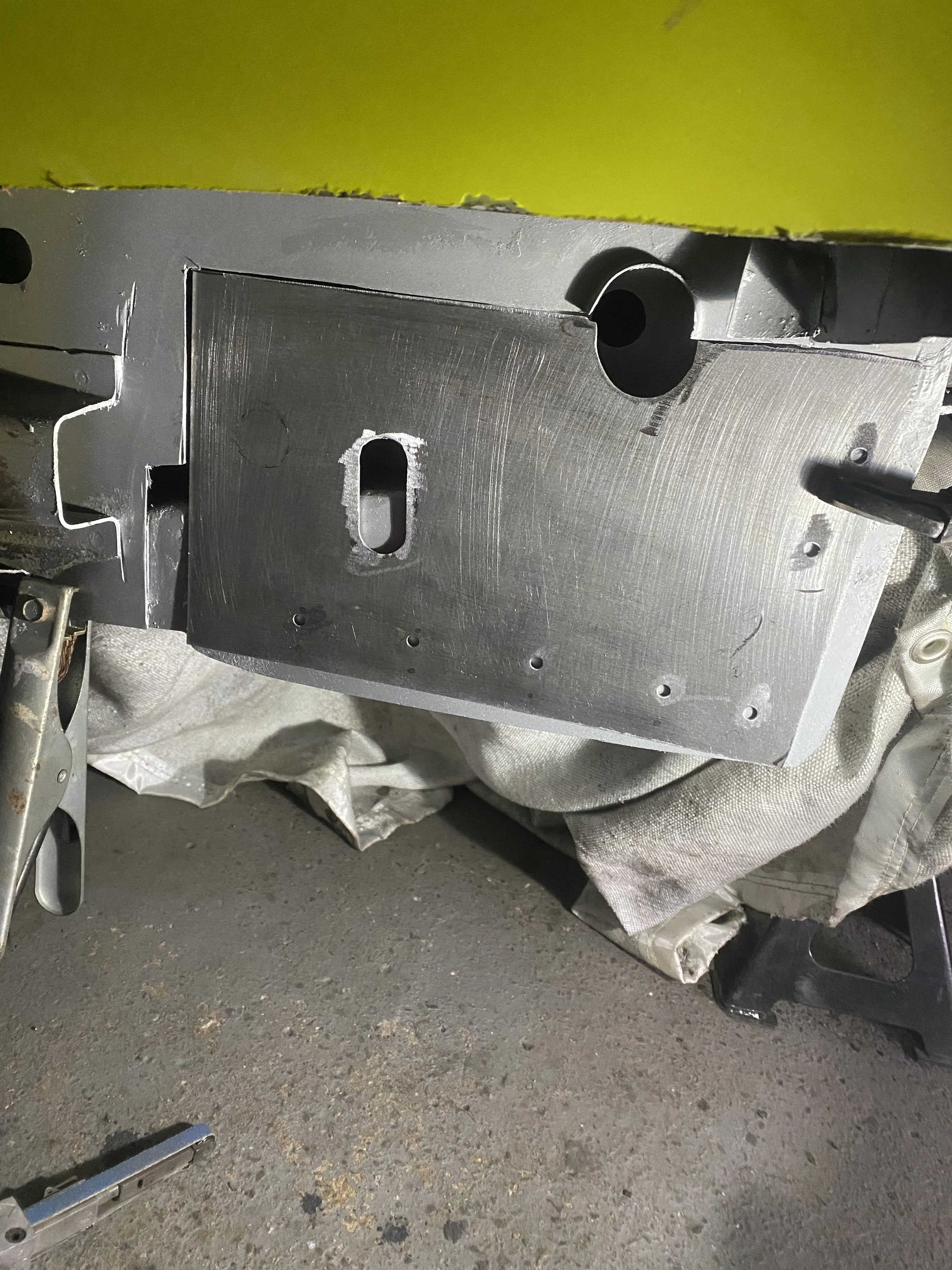

Got round to making some of the repair pieces. I don't have access to a bead roller so I decided to make something up and it worked out pretty well, its not 100% perfect but does the job.

Looks great, take loads of pictures of the sill repairs as it's a job i need to after looking under it recently haha, good work!

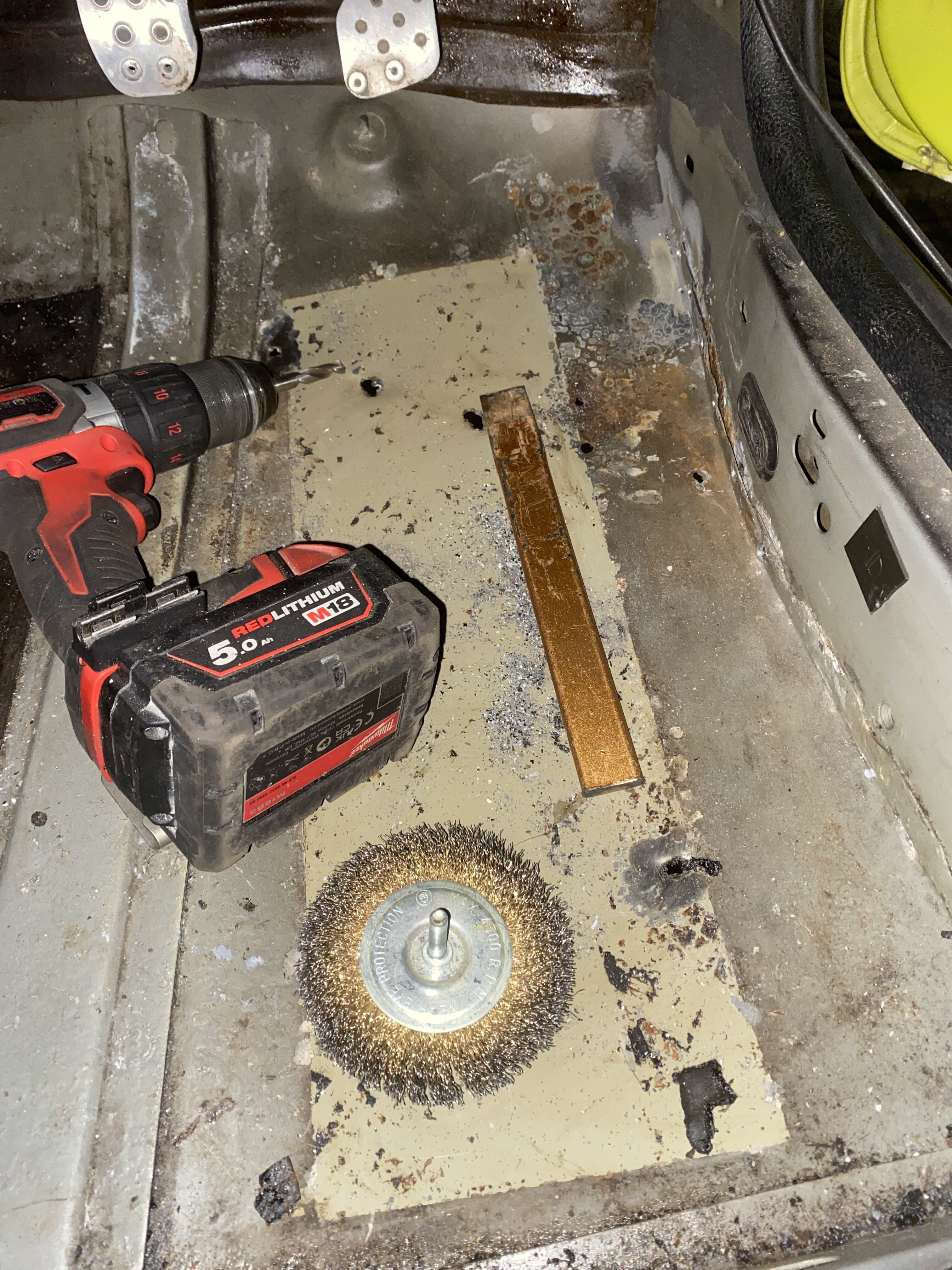

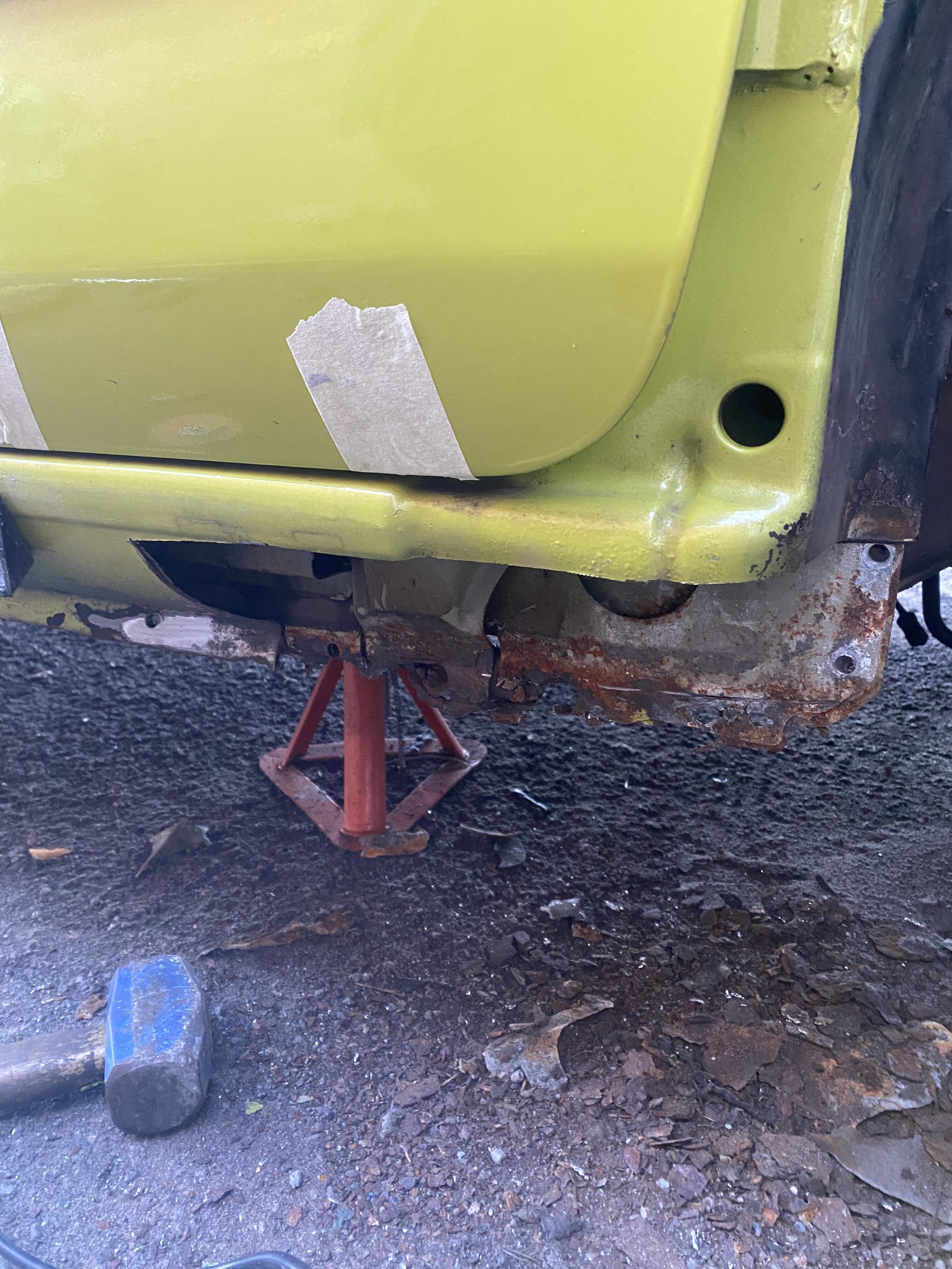

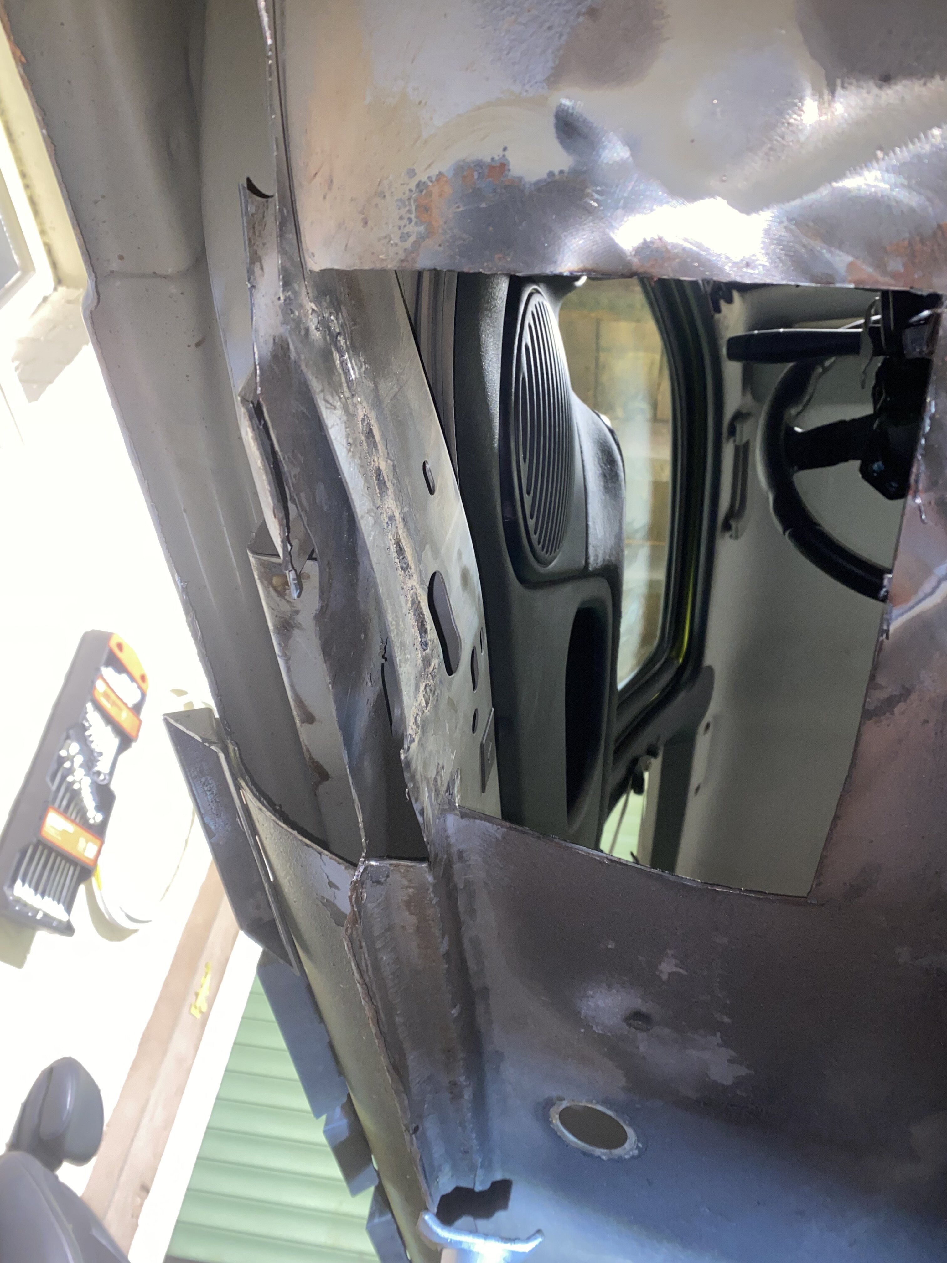

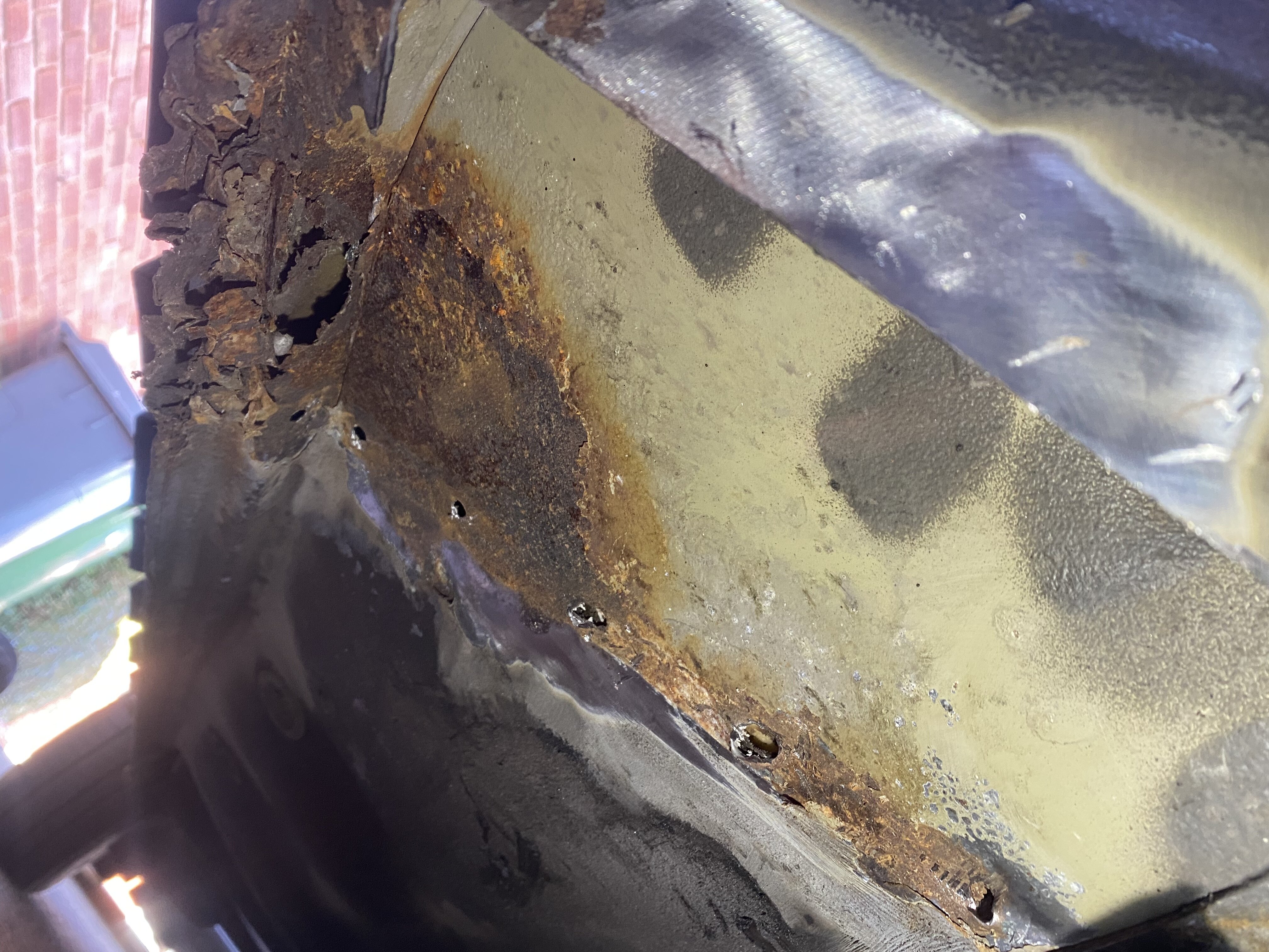

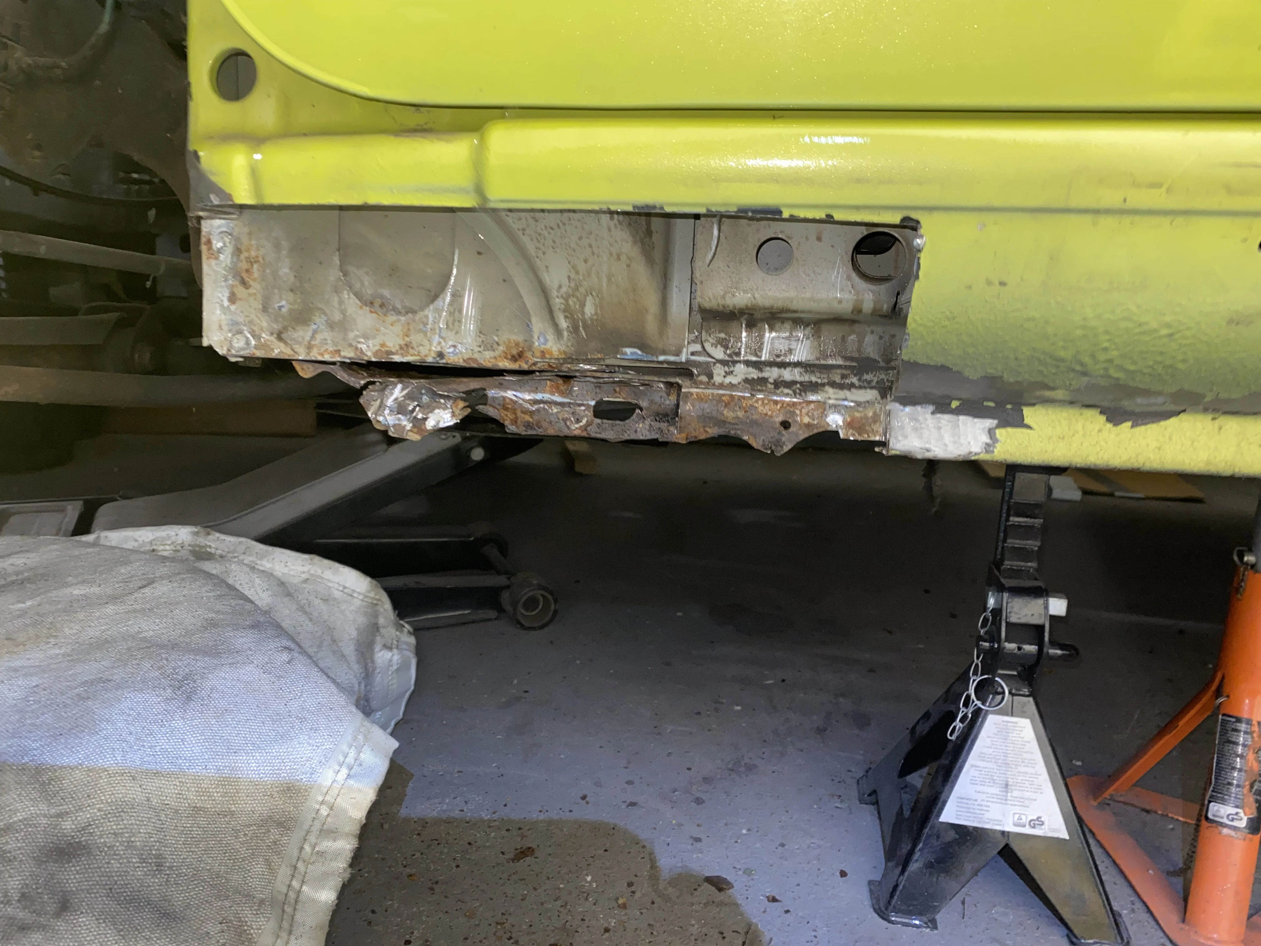

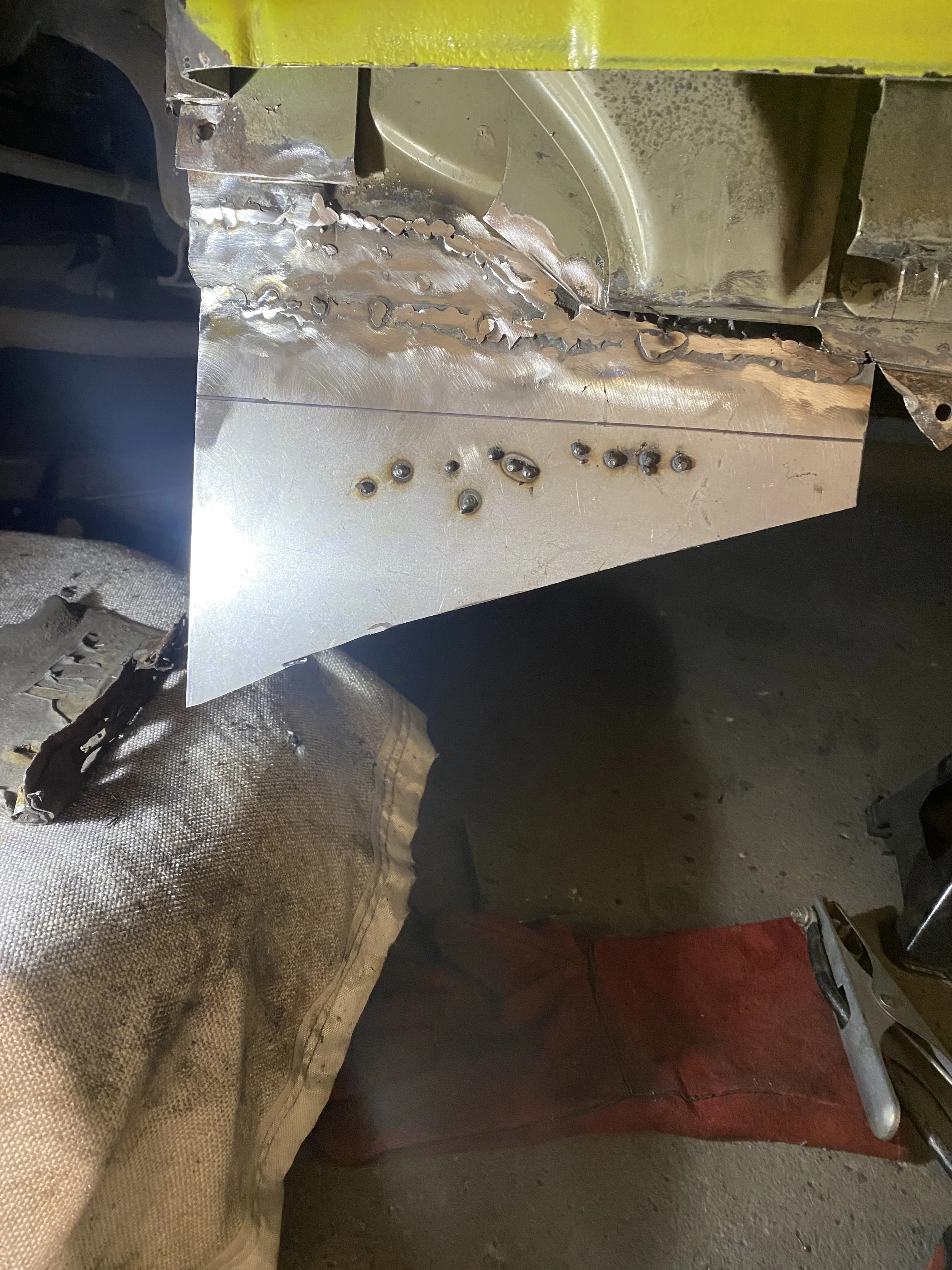

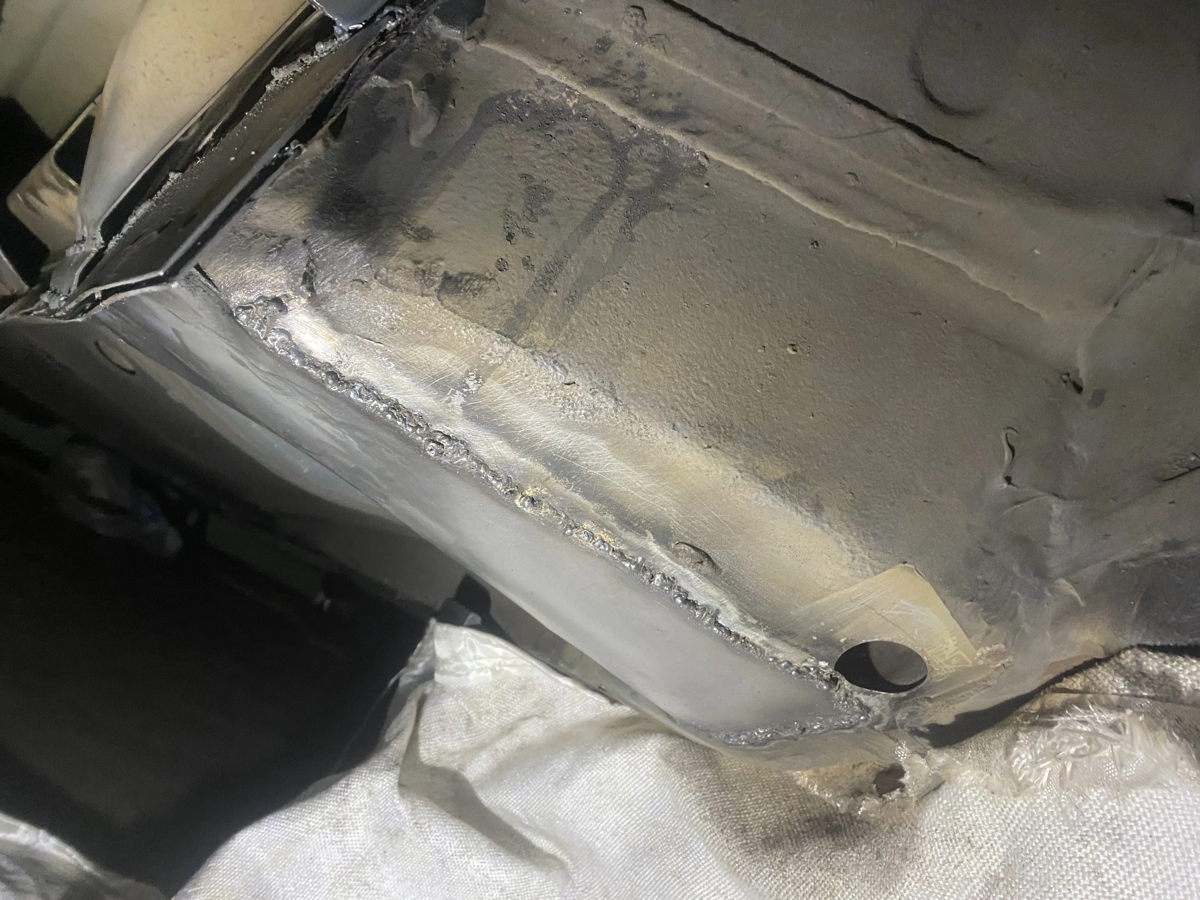

Made some decent progress on the O/S front. The rust seems to be never ending lol
I hear you on the rust. I have all that work ahead of me.

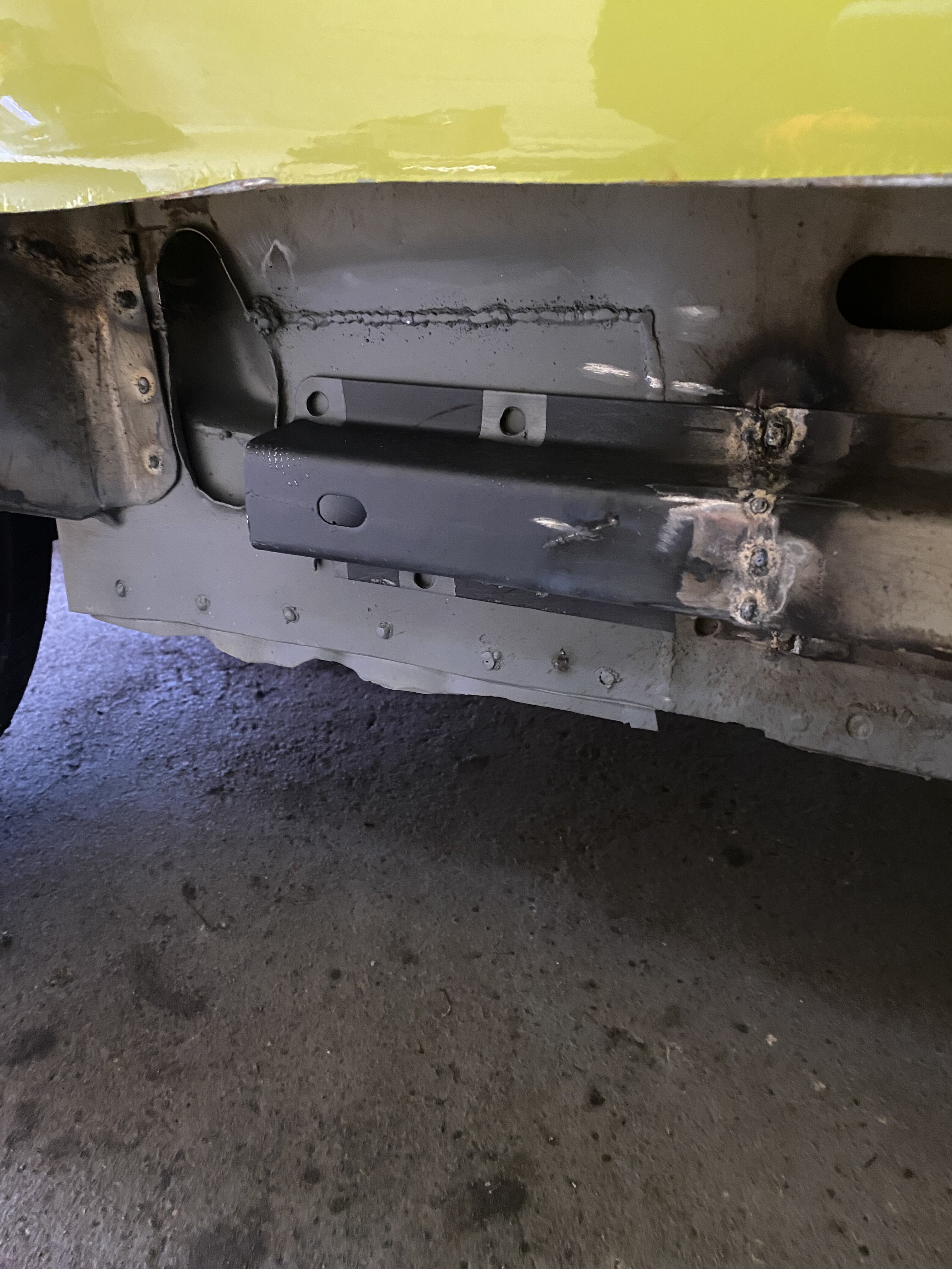

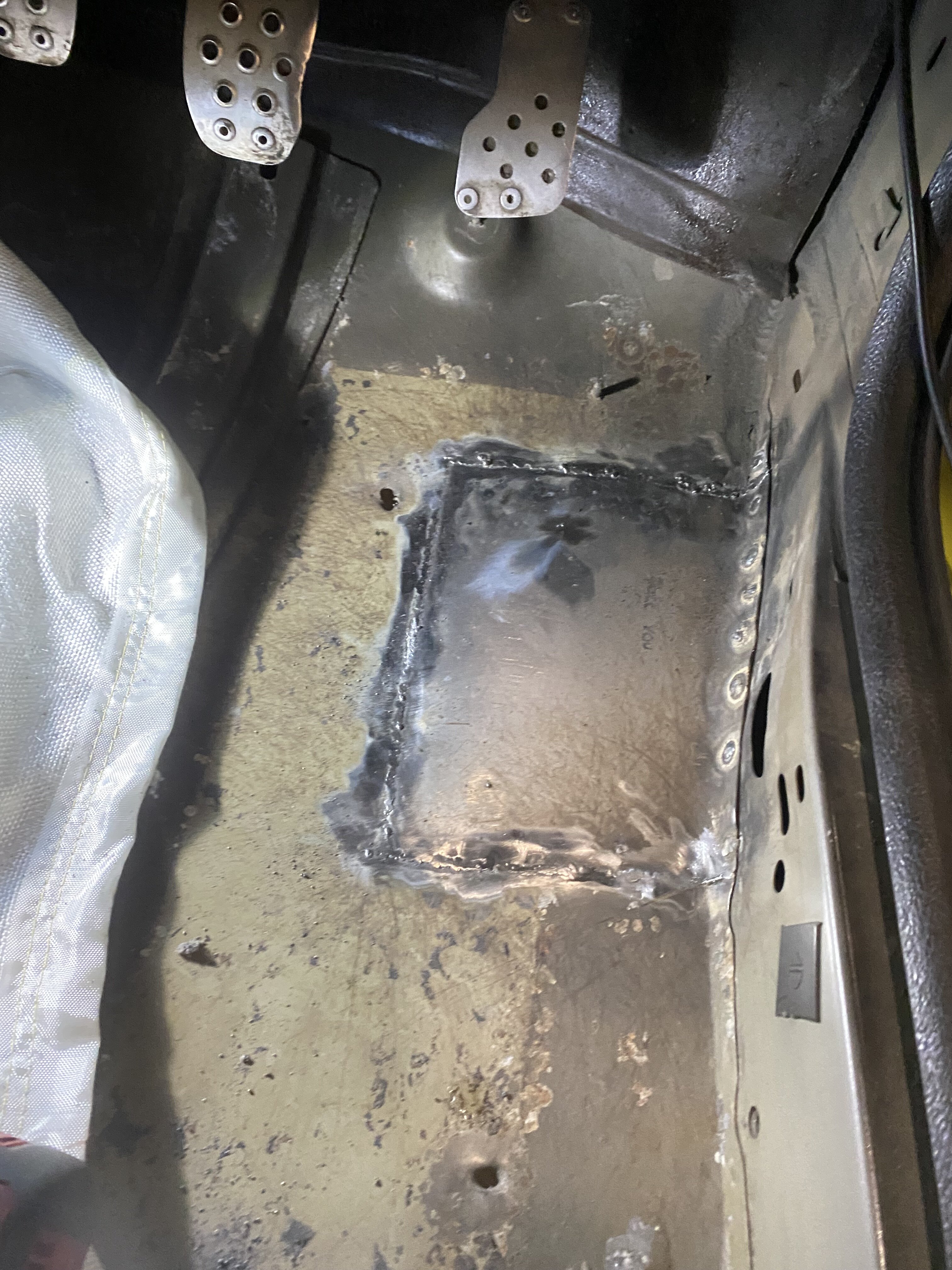

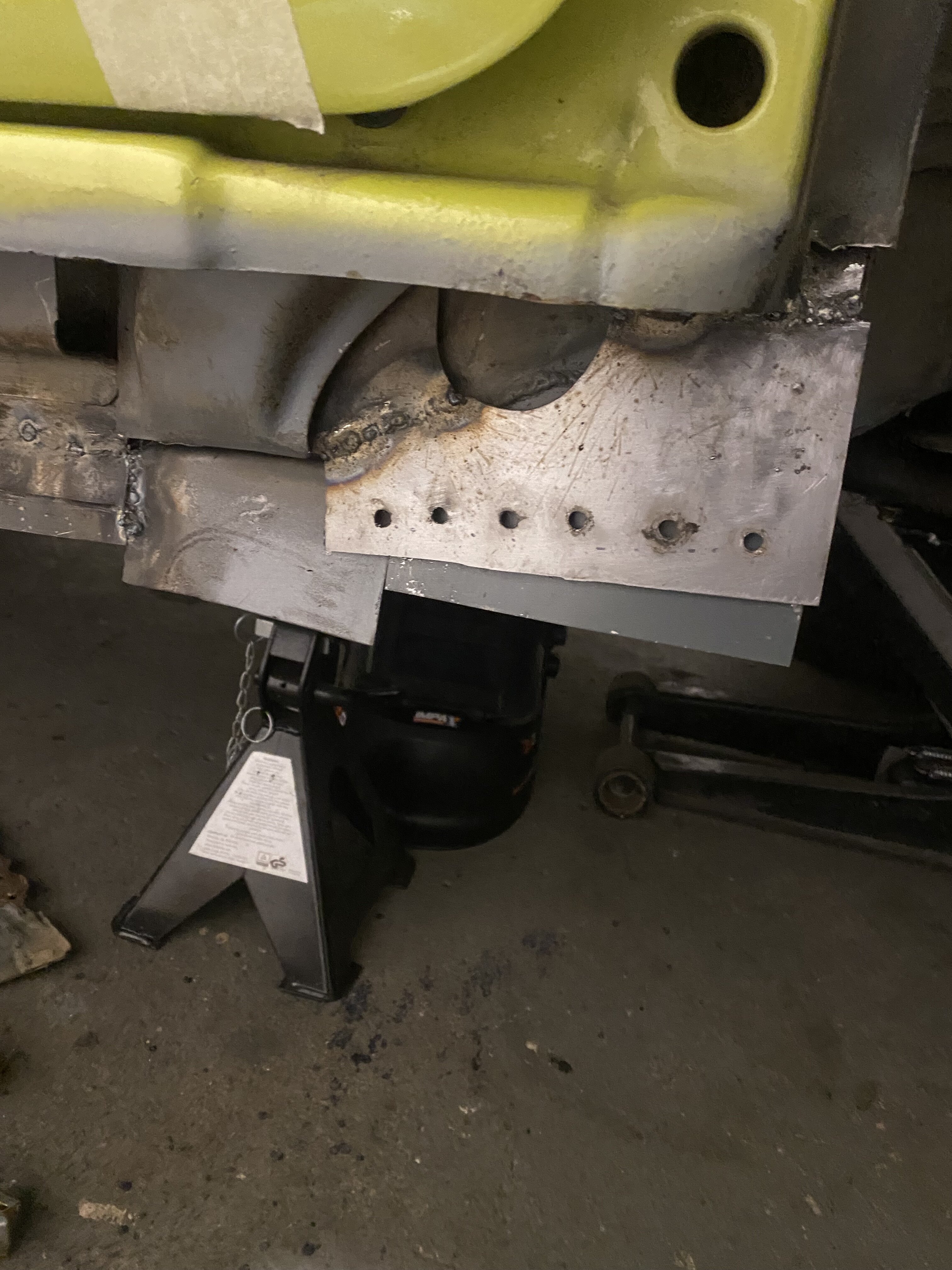

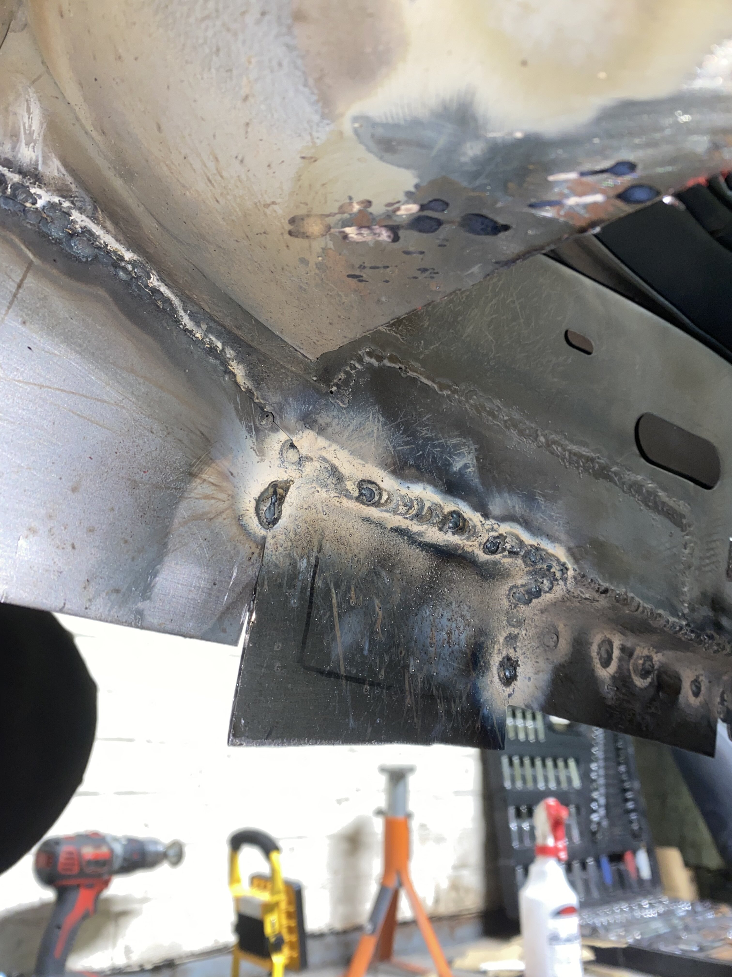

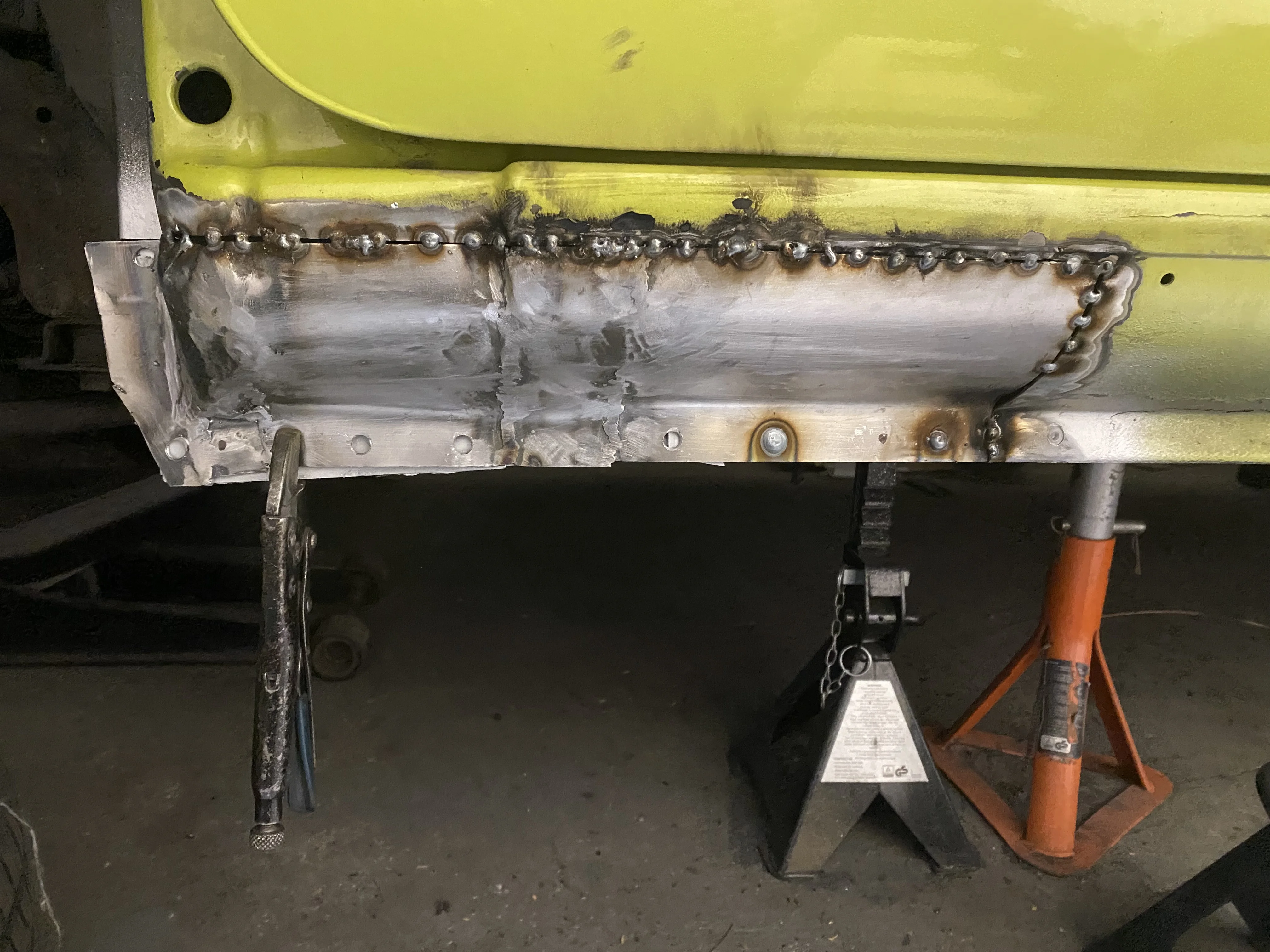

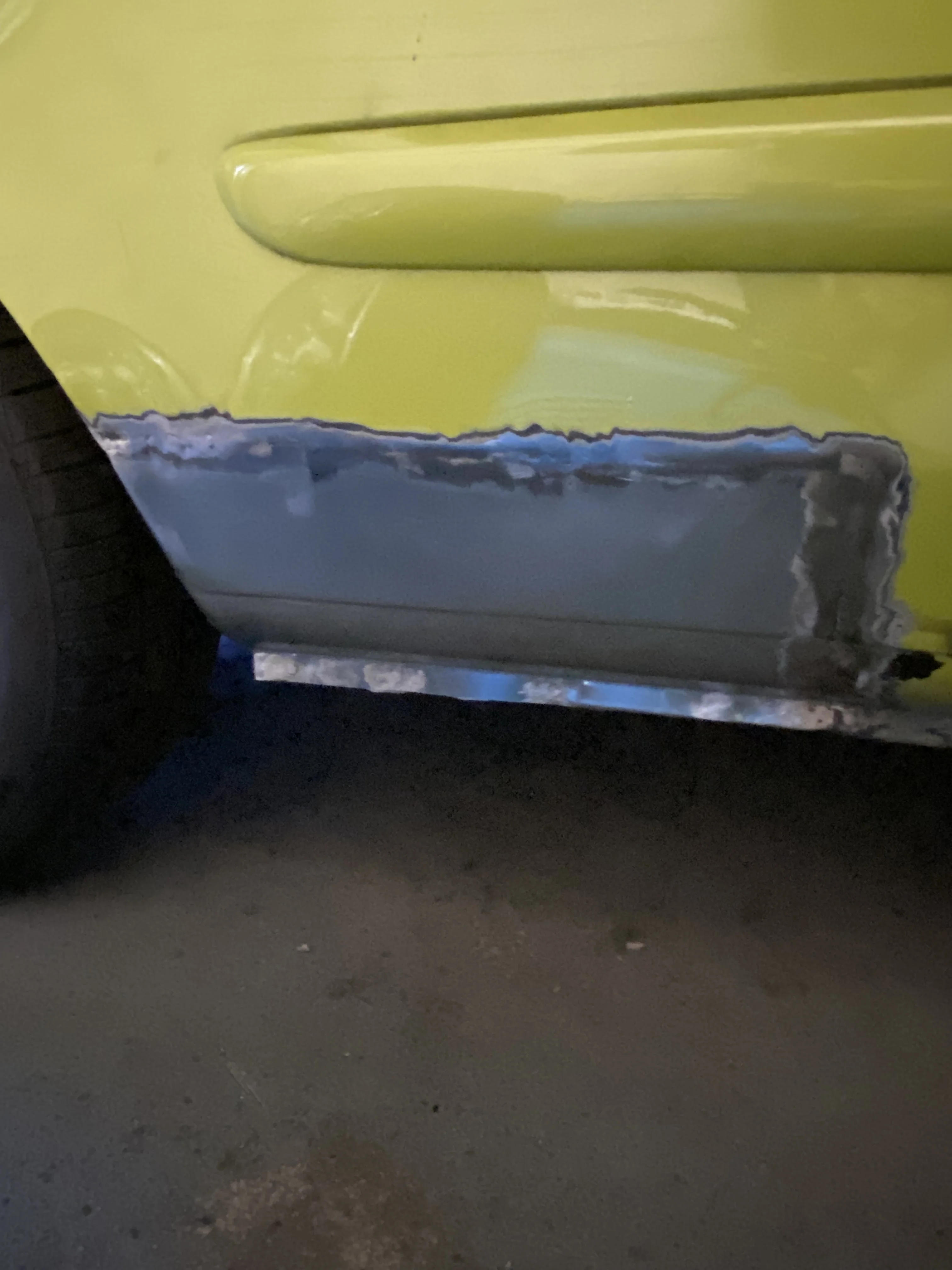

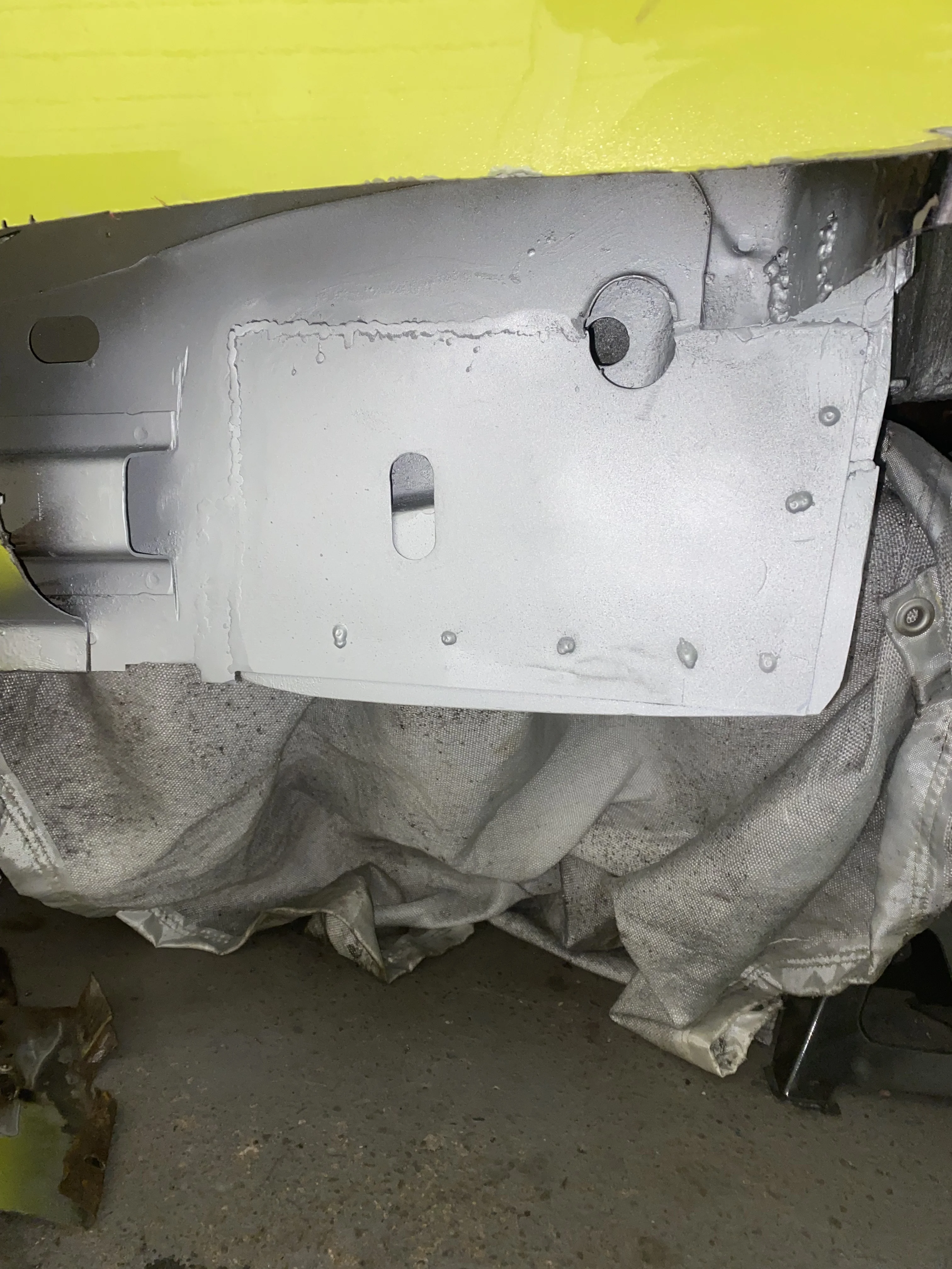

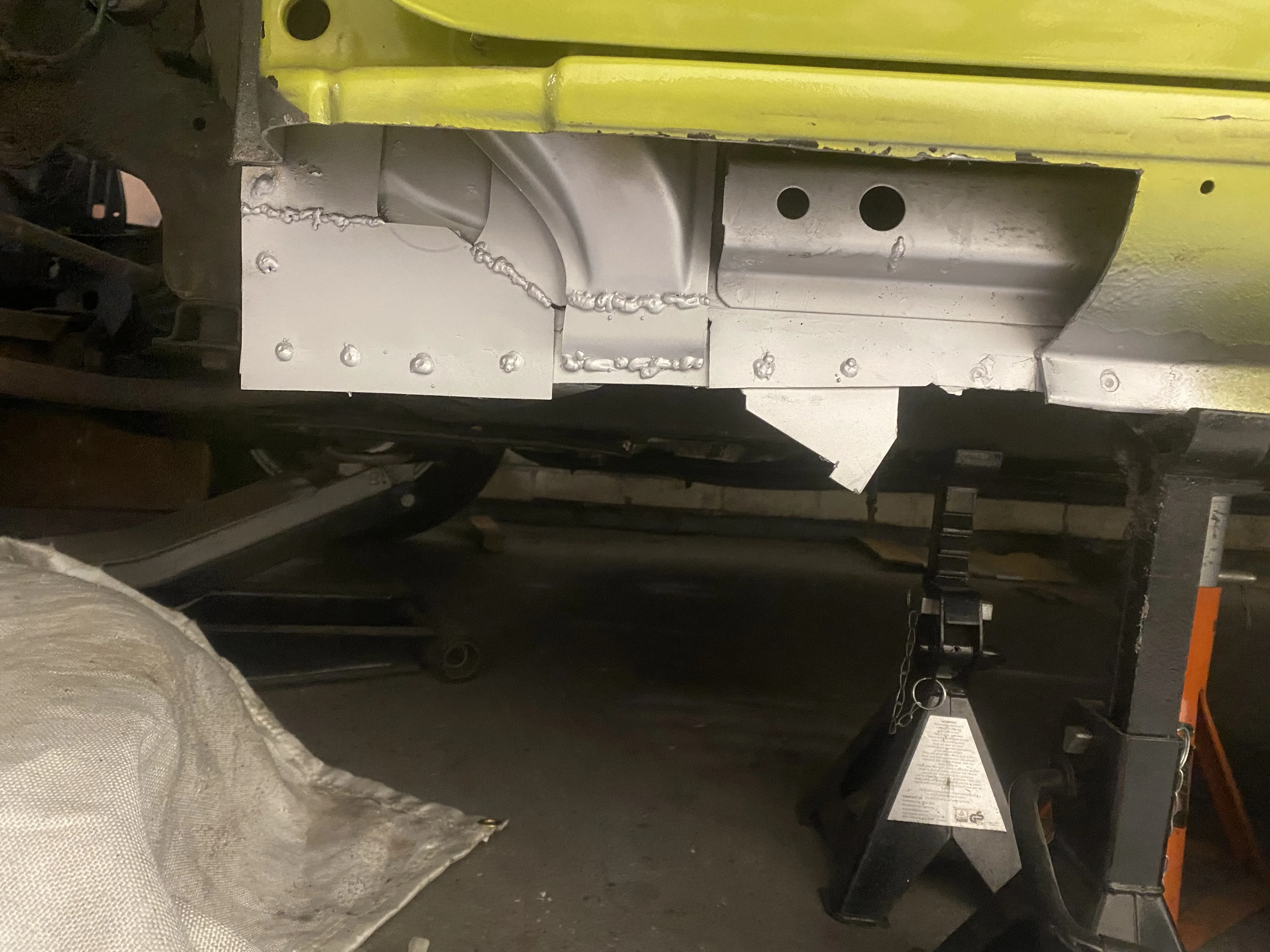

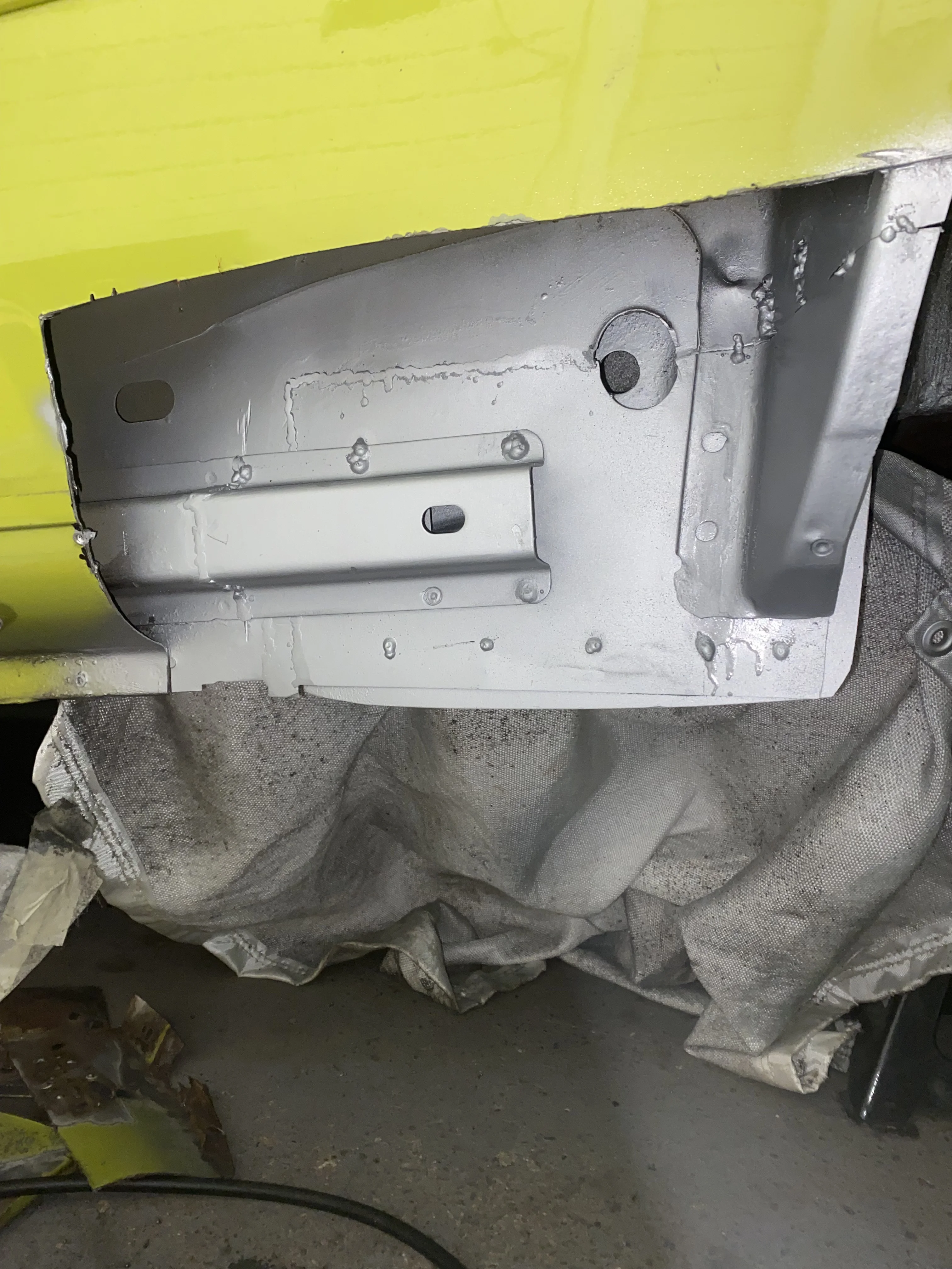

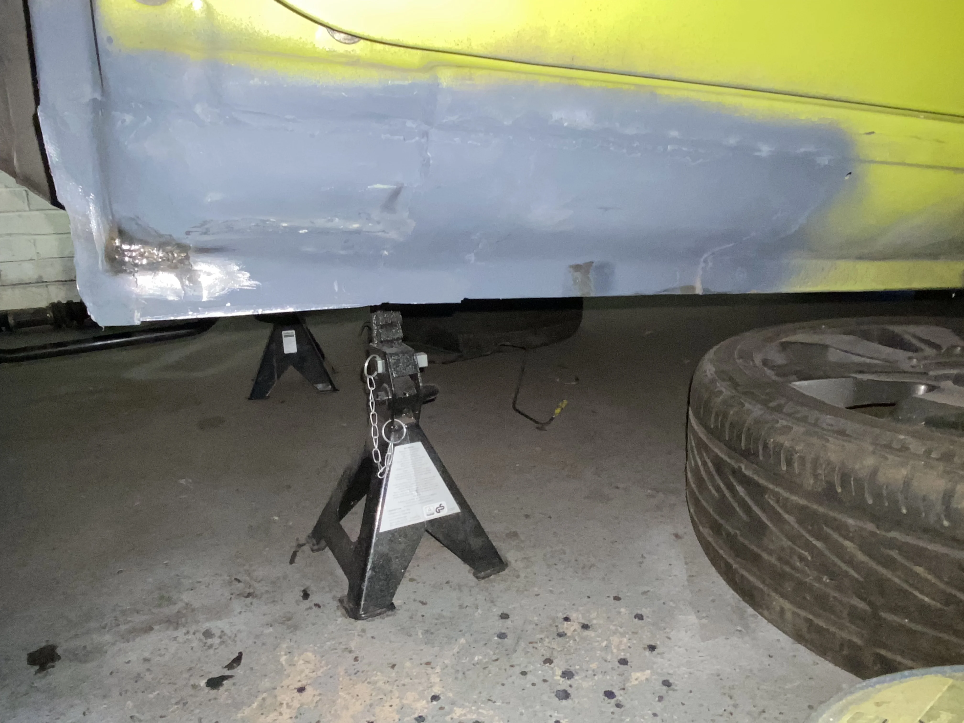

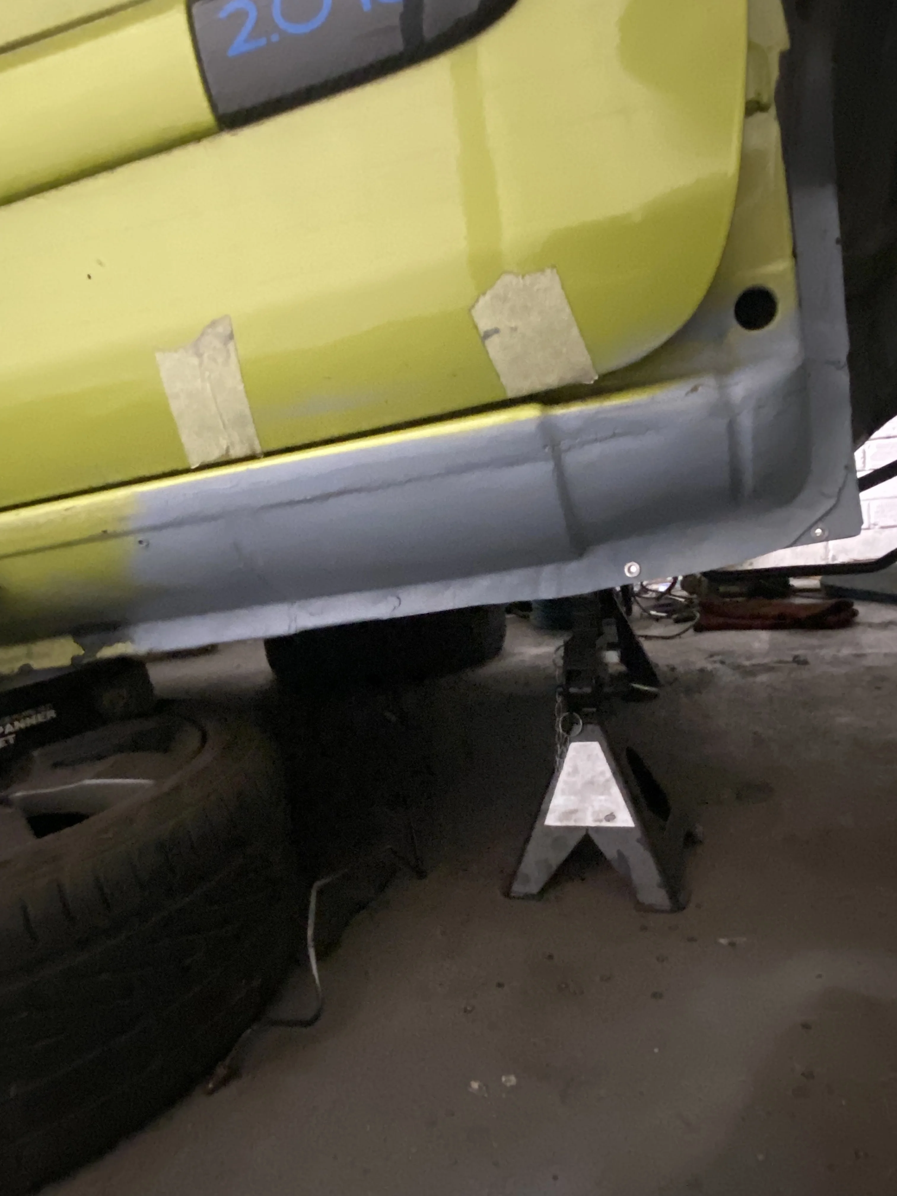

So I've got all 4 corners welded and theyre pretty much ready for some epoxy primer. I ended up having a crack at making the outer sills for the N/S. The front wasnt so bad as its a fairly simple shape and itll be covered by the wing and side skirts anyways. The rear was a bit more difficult to make with limited tools but itll need some work getting it looking right but ill show this when it comes to the filler work. For the O/S I opted for a aftermarket sill to save some time and it made it so much easier just to cut and weld these panels in.
Ive started prepping the engine bay and front wheel arches which are pretty much ready for paint. Im debating whether to record the painting process and post it to youtube, let me know if anyone would be interested in seeing this.
Overall its been a long process getting to this point esp as I only have a limited amount of time in a week to get it done. I really just want to get it back on the road at this point but theres still plenty more work to be done

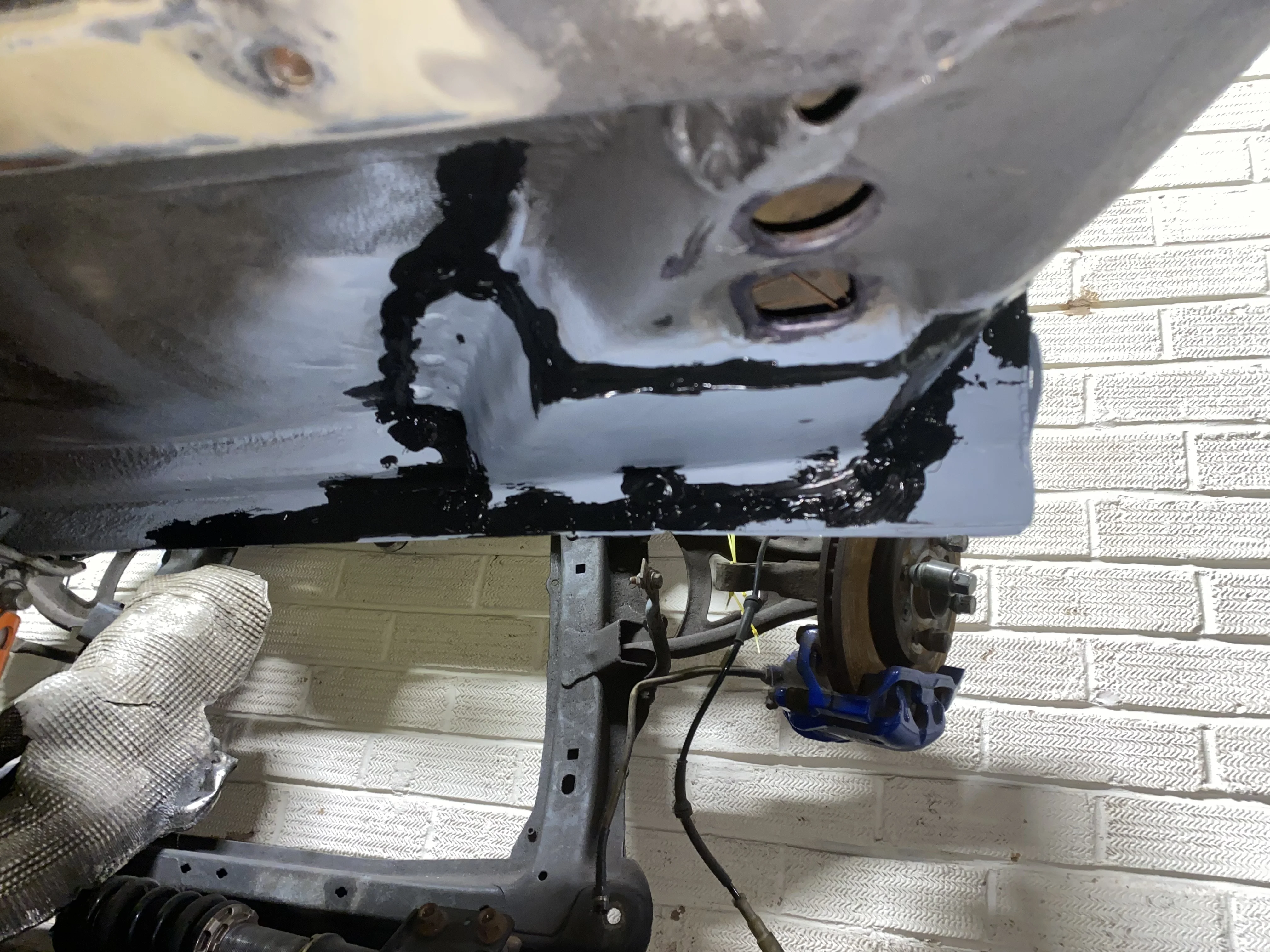

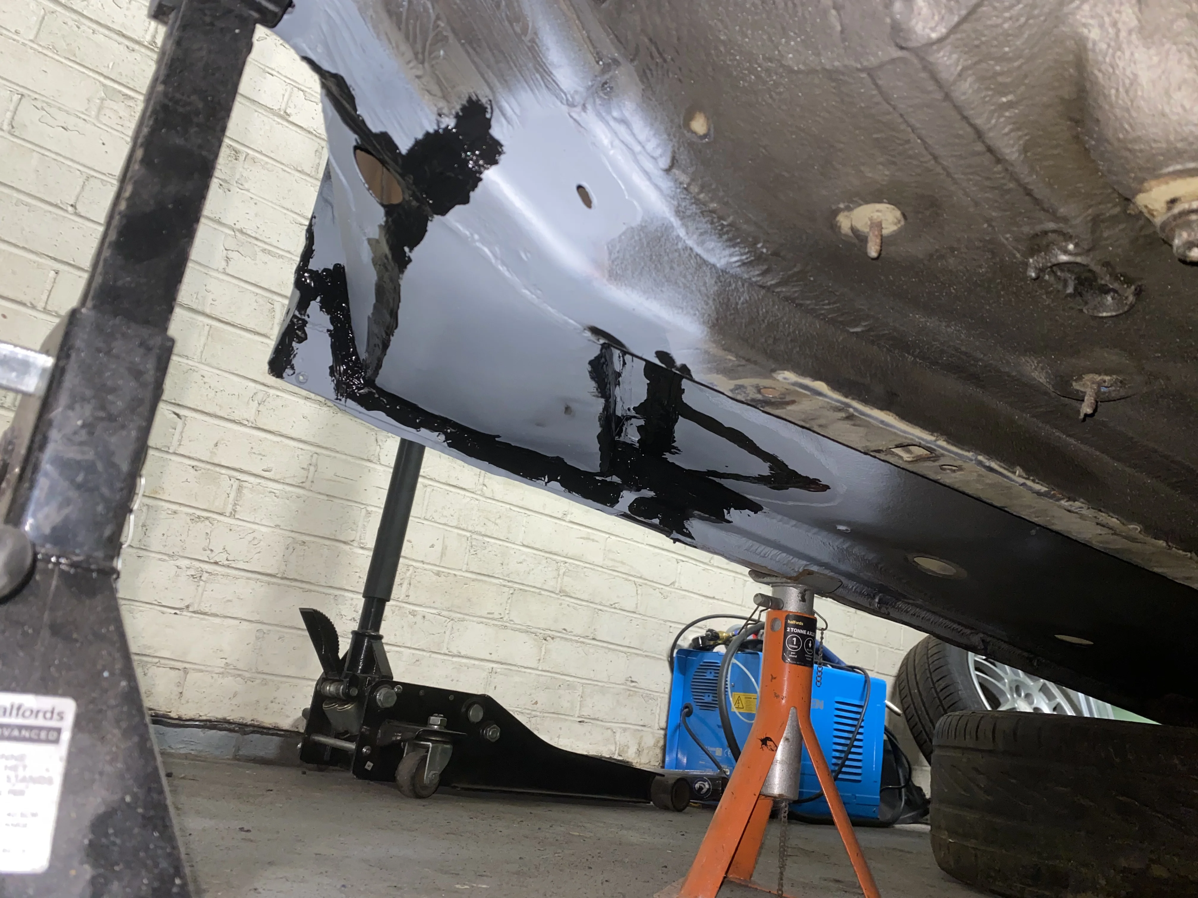

The sills are in epoxy and seam sealed so after a quick scotch, Ill get some stonechip sprayed. The engine bay is pretty much ready to paint too so hopefully Ill get that masked and painted in the next week or two. I spent some time wiping the bitumen type underseal off which was a bit of a pain but it looks a lot cleaner now.

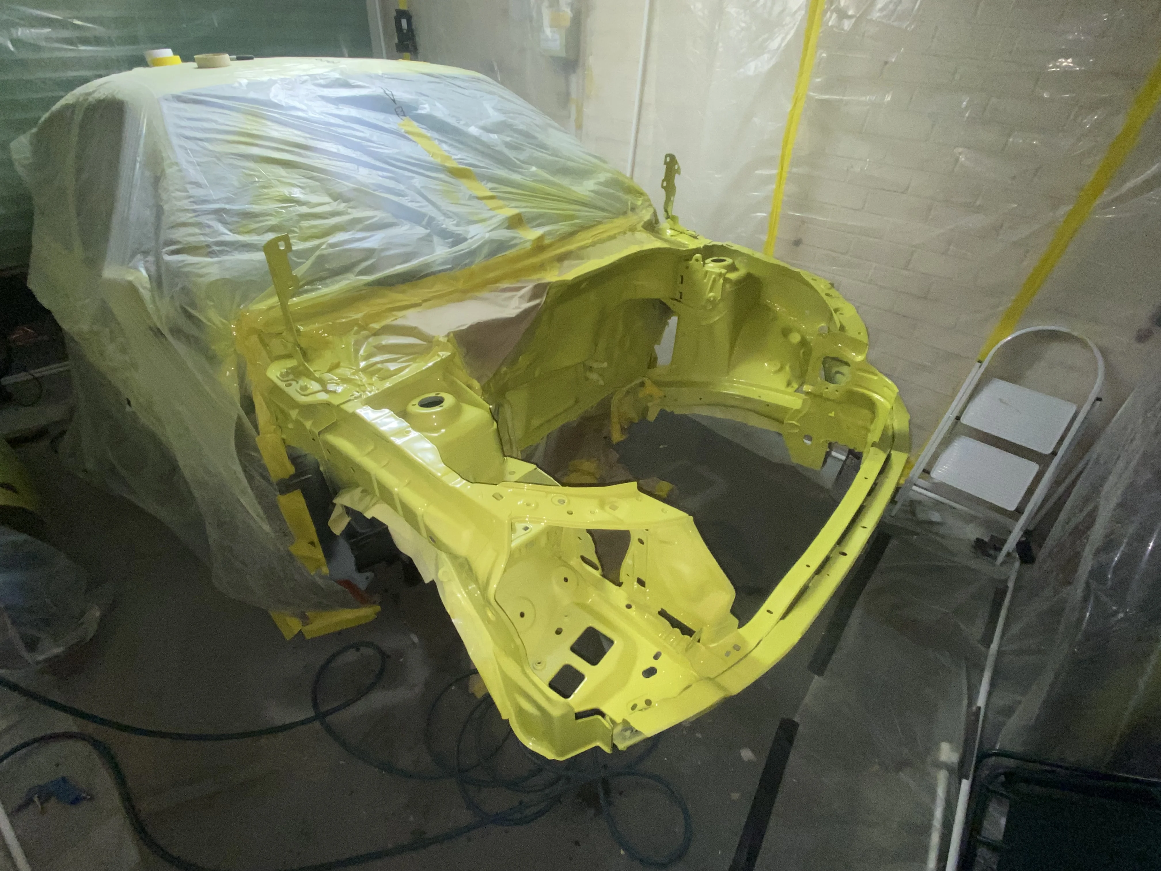

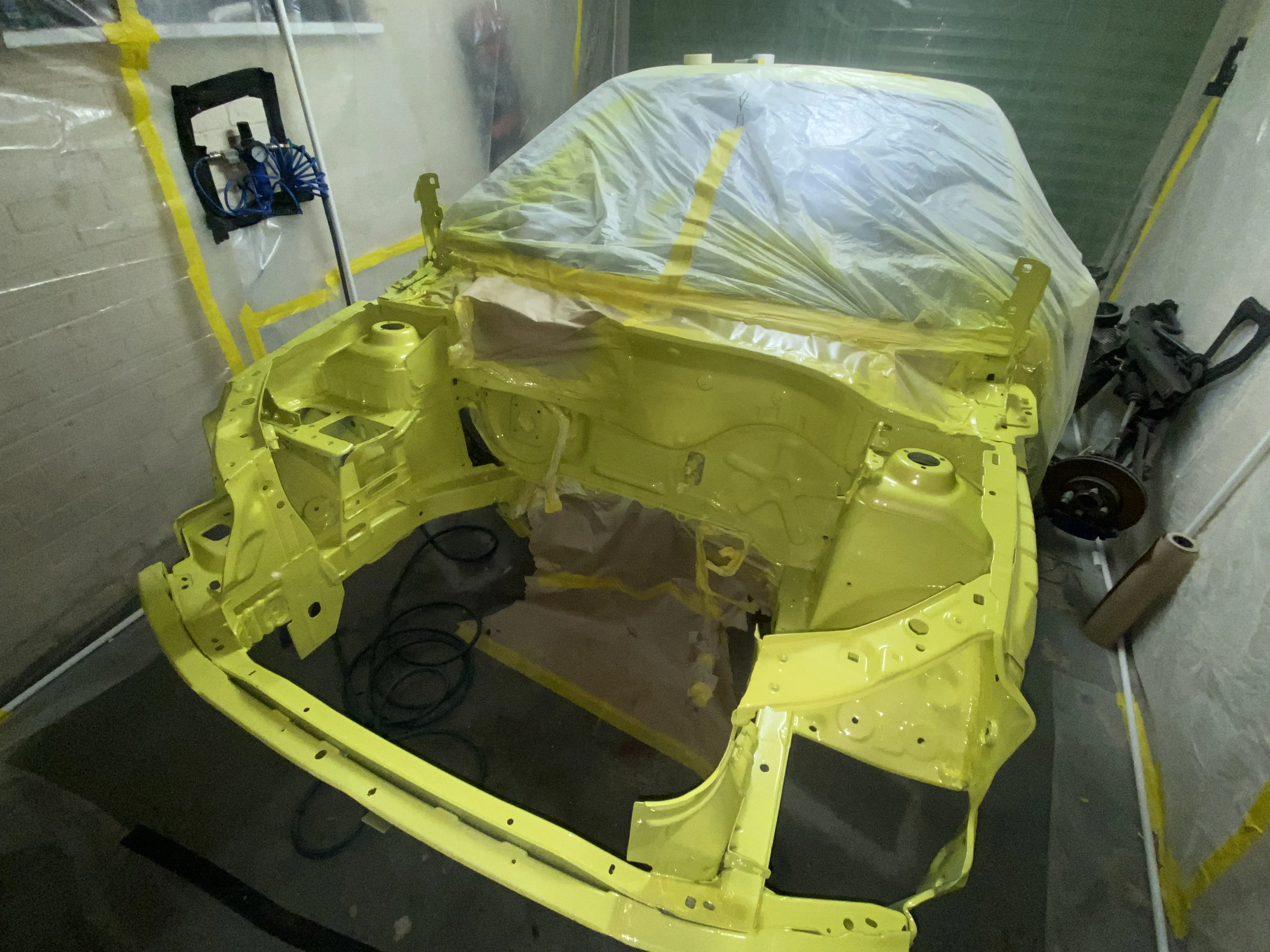

Ive finally painted the engine bay and it looks so good in acid yellow, cant wait to finish this car and take it on a drive. Sadly theres still much more to be done.
Next up I need to prep and paint the brake booster and abs unit bracket/holder and start putting things back into the engine bay. (I hope I remember where everything goes 😬)
