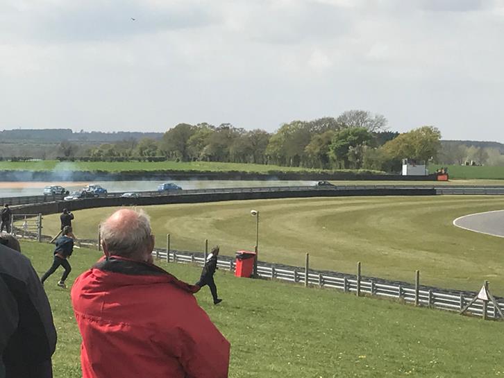

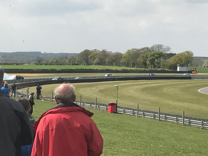

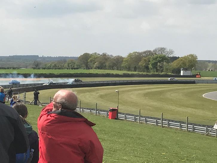

I've posted some images someone got from snetterton
