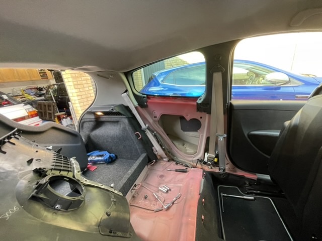

Well just over 24 hours of ownership and I’ve already dismantled the bugger!!

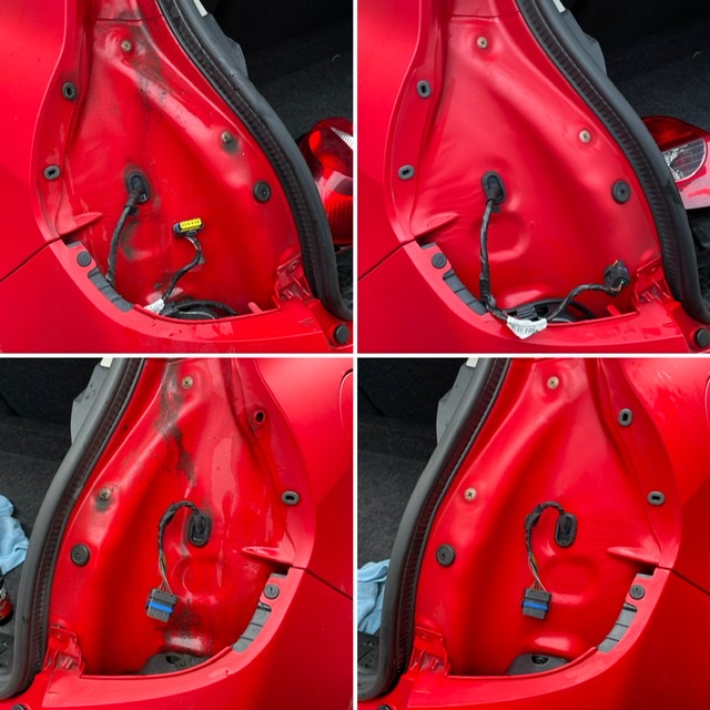

Wanted to see what the deal was with the dent on the rear qtr, and see if my local dent-man would be able to get behind it? Of course, it’s a Renault, loads of open space back there!! Tried to take a pic of the dent:
It’s a bloody shame it’s there really, as it brings down what it otherwise a super straight car.
I’m amazed at the lack of stone-chips at the front of the car, the engine bay certainly needs a bit of loving tho...
Phoned my dent-guy up today to see if he was working/available this coming weekend. Tells me that he’s free today if I take it over..
£30 quid later and a bit of stretched metal, and the dent was a gonner

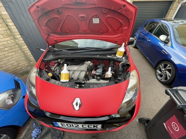

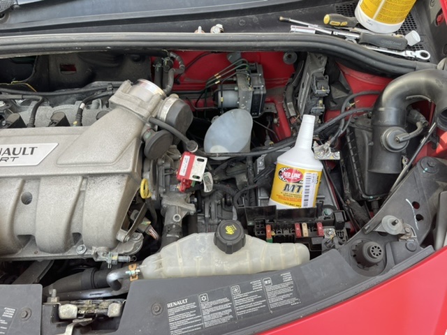

Have noticed a little notch in the 4th gear when I’m driving the car... with spirit..
Chatted to the CS Gearbox Guru Mr @NorthloopCup and he recommended I change the fluid for some Redline MTX and bleed the clutch hydraulic line:
Did that this evening, and took the car out for a run. Noticed a discernible improvement in the shift action now into 4th, so it’s definitely done something. Will monitor it over coming weeks and see if it needs more investigation.
On similar investigation notes.. I’ve noticed the A/C system seems to make a noise when it’s running.. like a whistling.. wondering if it’s the pump on its way out after 9 years of service, or..???
Any suggestions welcome.
  200 cup
Lovely car, I had a similar issue with fourth in my 200, did exactly the same with a clutch bleed and redline, gearbox has just got better and better, the stuff is amazing!

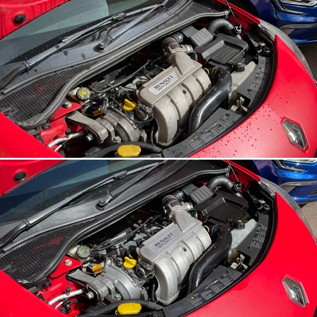

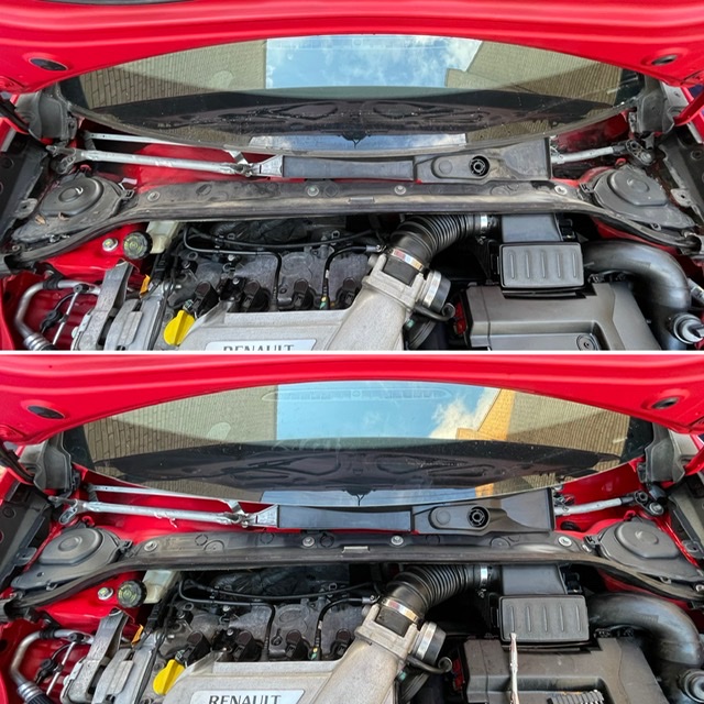

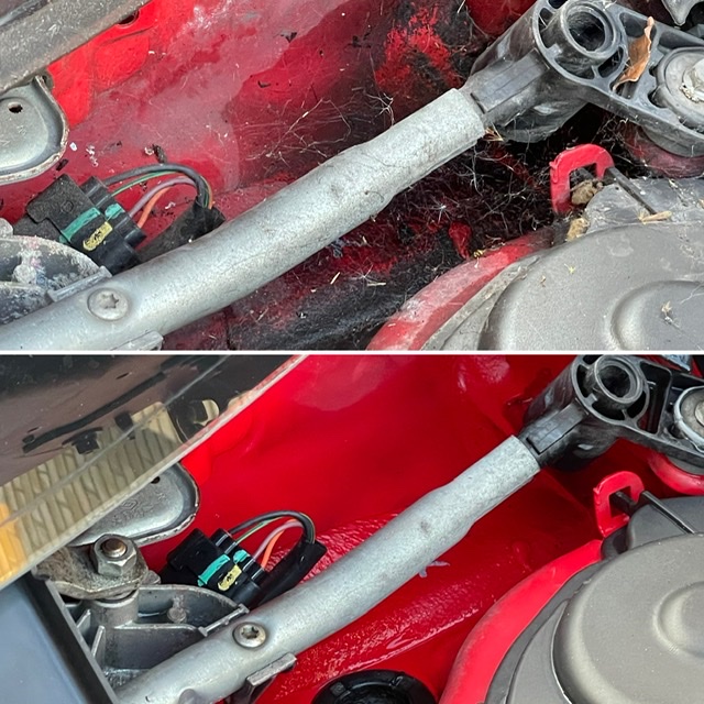

Love that this car is super original with all the OE brackets, cable clips and stickers present and correct. However the engine bay is a little bit grimy from 75,000 miles of daily usage so wanted to spruce it up a bit.
As you’ve seen on some of my other builds, my usual course of action is to get everything out and blast, re-plate and paint.. but I don’t want to go down that route with this car, I want to retain its originality.. so I had a quick Google and found this video from Chris Fix on YouTube detailing his procedure:
Thought I would have a punt at his process, so bought various brushes and cleaners, and some scotch pad wheels for my rotary multitool (Dremel).
Well after a couple of hours this morning, I have to say it certainly looks a LOT better under there, and now a lot more presentable:
Thanks for Raidering 😎

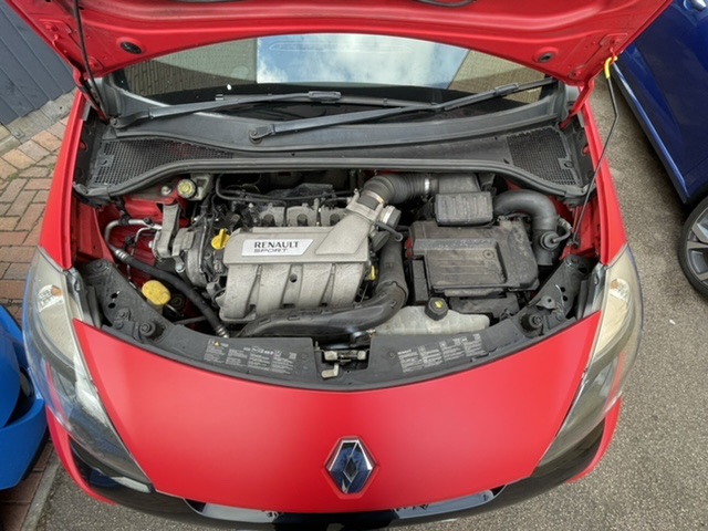

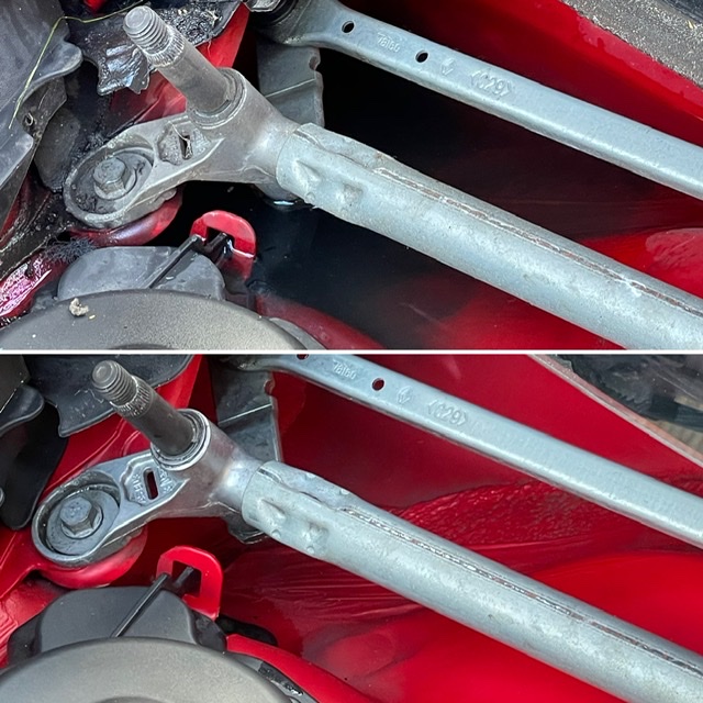

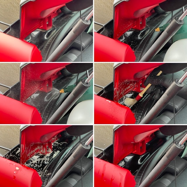

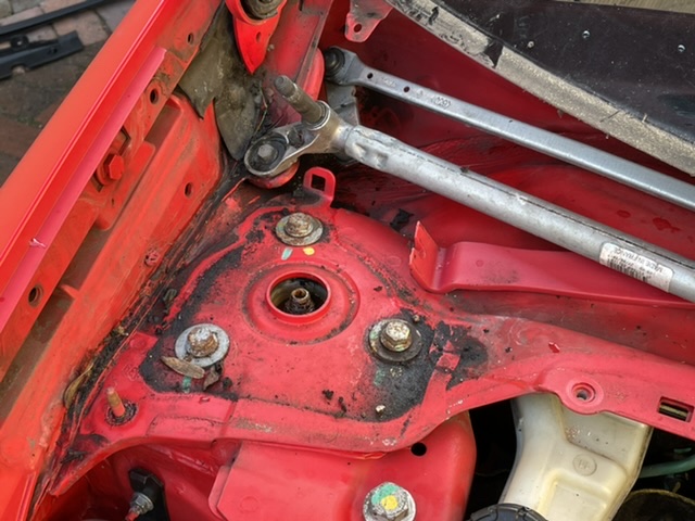

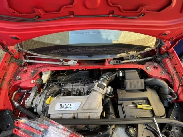

I got recommended to have a look at the scuttle area as these cars suffer from blocked drains. Whipped the scuttle panel off this evening and found a good 9 years of grot:
And a nice blocked scuttle drain and pool of black stagnant water on the off-side:
A couple of hours of scrubbing soon had it looking better for itself:

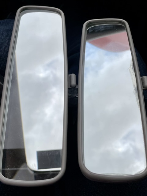

I then fitted a new OE rear view mirror I picked up of eBay as the original one was damaged:
Thanks for visiting.
Big_Steve_T
How did you remove the scuttle? I have never done that before
  1. Wipers off first
  2. Then remove the 2 screw clips on the right and left hand sides of the scuttle panel.
  3. Next pull off the rubber seal from the front edge of the scuttle panel.
  4. Scuttle panel will then lift off.
  5. You will then see you can remove the front scuttle panel moulding by removing the shock top covers (don’t forget to undo the 10mm nuts on each shock top cover first) then remove the 4 x 10mm bolts along the leading edge of the cover, and lift it off
To get the best access, you want to remove the left and right hand windscreen mouldings and then the other covers/mouldings in the left and right hand corners of the engine bay.
That should then leave you with something like this:
