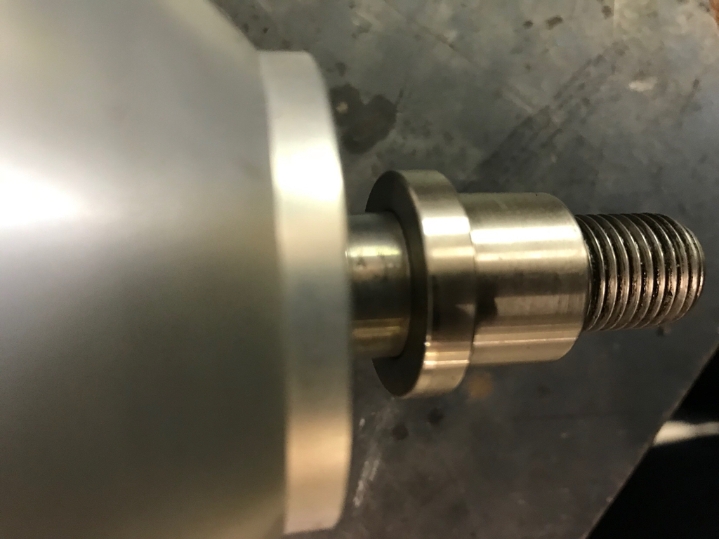

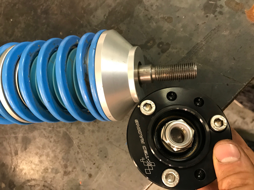

I’ve just tried to mock build my front struts into the top mounts and hit a problem. The lower insert in the top mount does not fit all the way over the strut piston. It goes over the threads ok but is not big enough in diameter to locate onto the top spring cup.
I’ve taken a couple of pics to assist in my description
Any ideas??
I'm also fairly confident that the helper spring should be on the bottom of the main spring opposed to the top as these have been delivered. Does it matter??
I had the same issue with the top hat. It will fit but you have to tap it down with a hammer.
Before fitting I would get some of the washers that PMS provide to bridge the gap between the bilstein top spring plate and the ktec top hat.
Mine appear to be knocking pretty loudly and I think it's this. I'll be investigating soon.
Spring helper wise, I'm not sure! Can't remember which way mine are and I've been meaning to check this again too. All I've seen have been helper springs at the bottom but I'm sure mine are this way round too.
@Louis - Gave them a light clean up with some emory paper and they slot straight on. My top hat and collar sit flush, not sure any need for a washer but will try when fully rebuilt & see if i notice any knocking. Thanks for your reply!
You sure there's no movement on the top hat and the collar? I definitely had some movement as the bilstein has a slight step in it.
