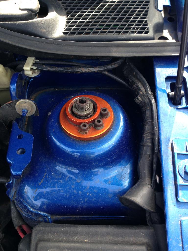

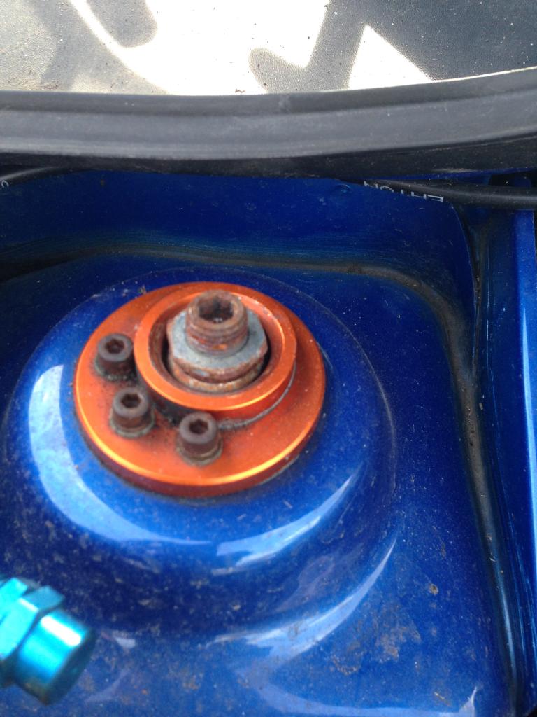

This was how mine was set up with Biksteins and same top mounts,hope this helps
Thanks for the Reply. Do you know what your final -Camber was with that setting ? to me looking at your photo's they're setup roughly mid way between max negative camber and max postivite caster which is rougly how I set mine up initially also but got bugger all negative camber or positive caster with those settings :(
