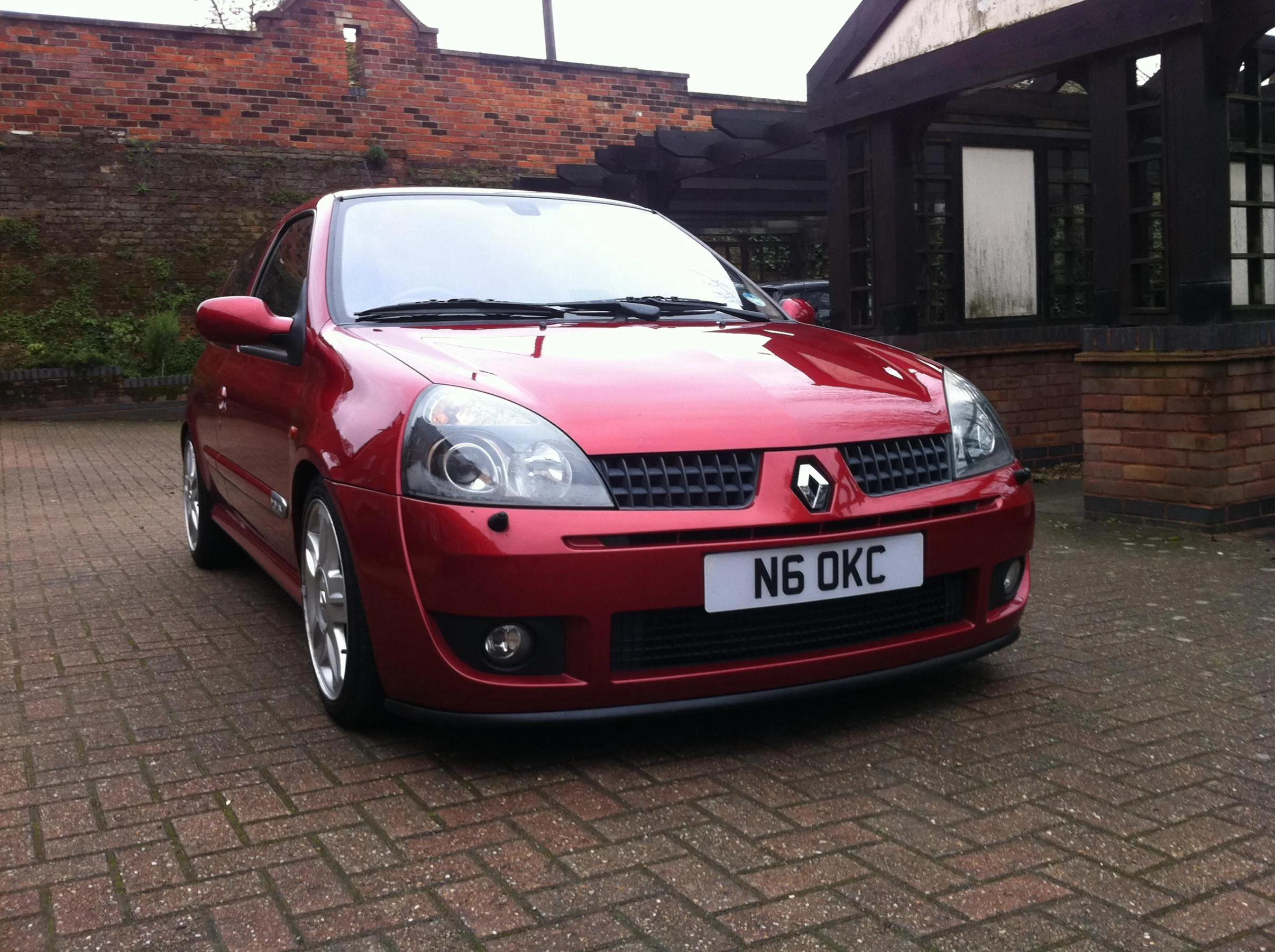

I've just put them on my previously standard 172 and I'm very impressed. Agree with Phil in that its more fast road with occasional track use, but for sub £1k i'm very happy. Piccie attached.
