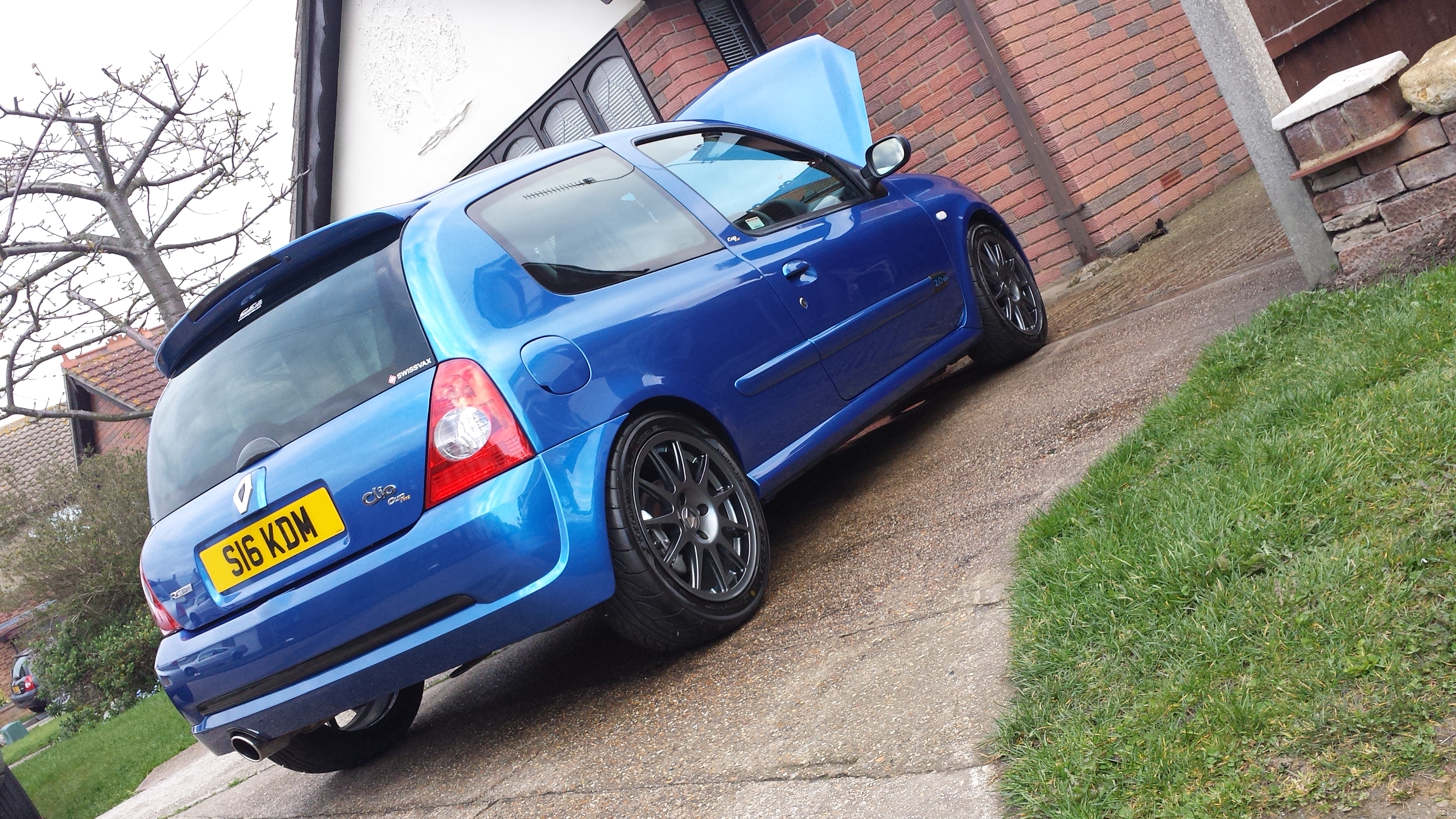

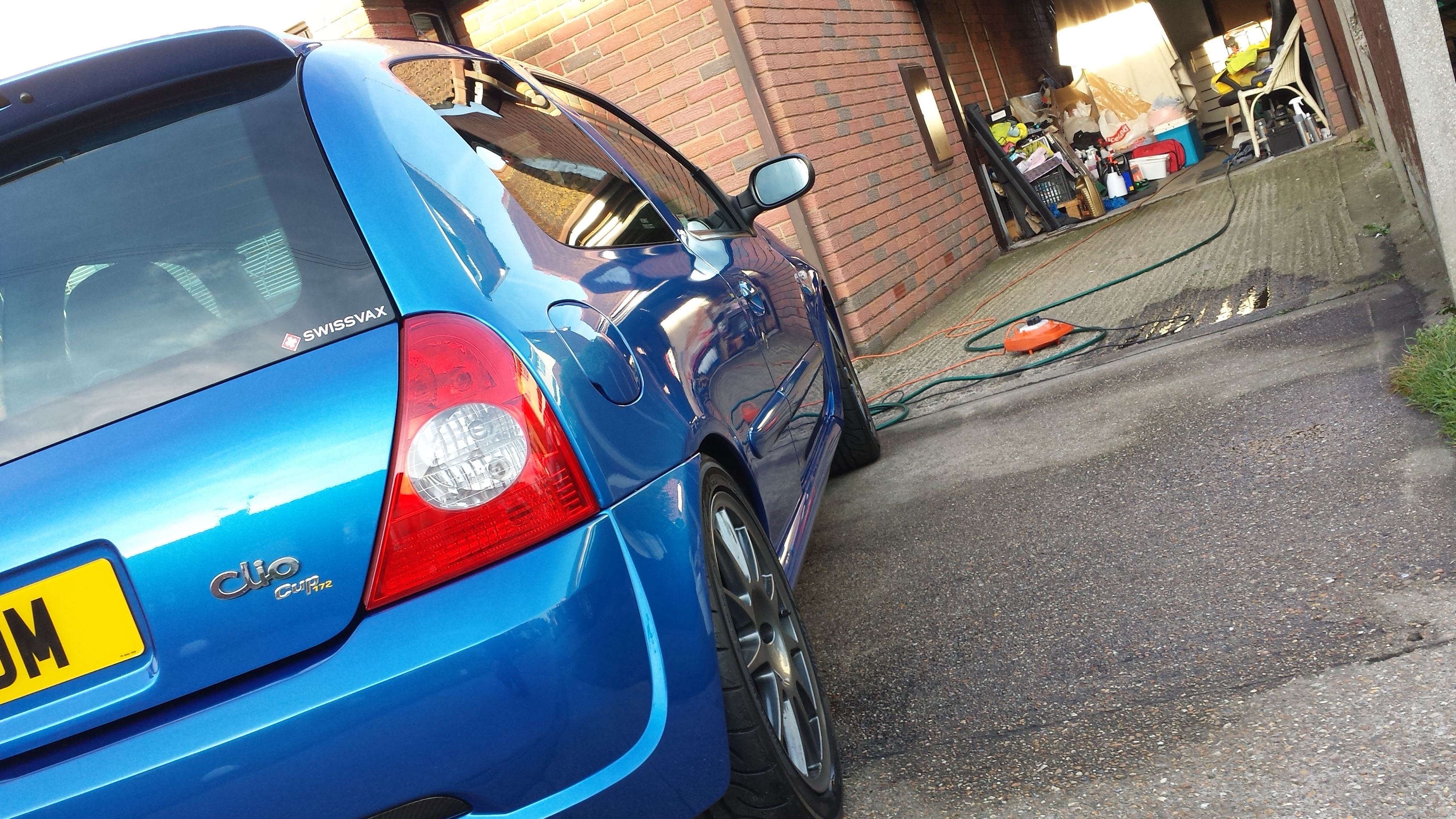

Im just wondering will they drop the rear low enough like the same as how my car currently sits? The back seats are out aswell
And would i benefit a lot in handling performance? Some pictures would be hugely appreciated
Thanks
  172 Cup & Mini C 1.6

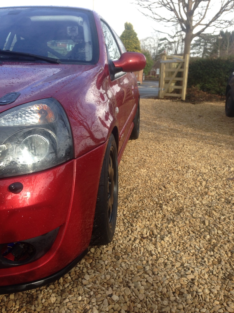

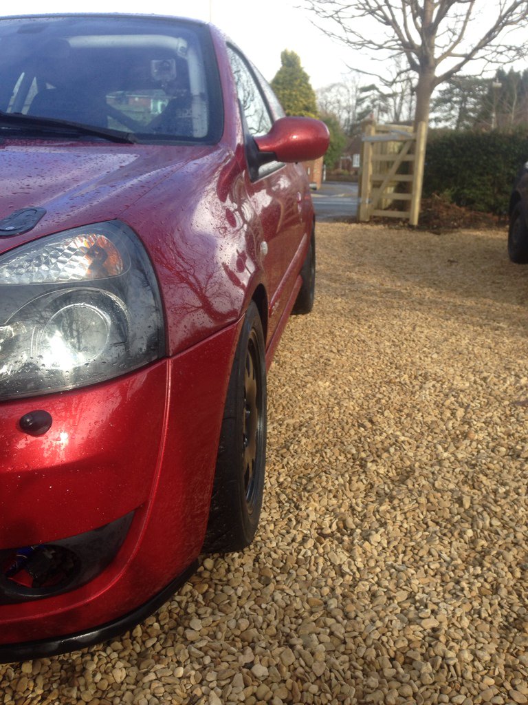

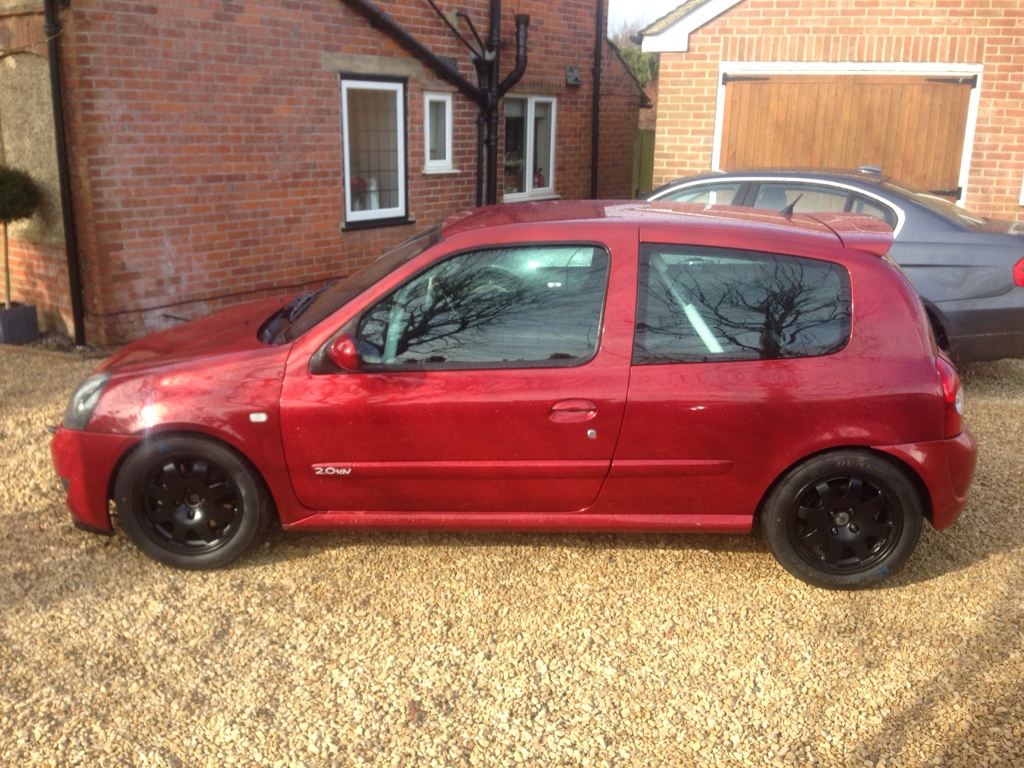

This is how im sitting on V-maxx

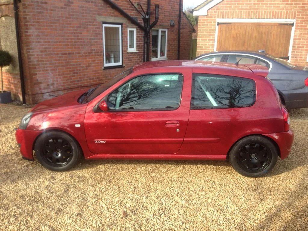

It will sit low enough, even stripped. As you know, mine is stripped;
In fact, mine sits low enough it currently scrubs on 205s, 16mm spacers and the RC kit. Not good.
Nice one cheers cub thats gave me a lot more confidence now. I can get them from Germany for £400
