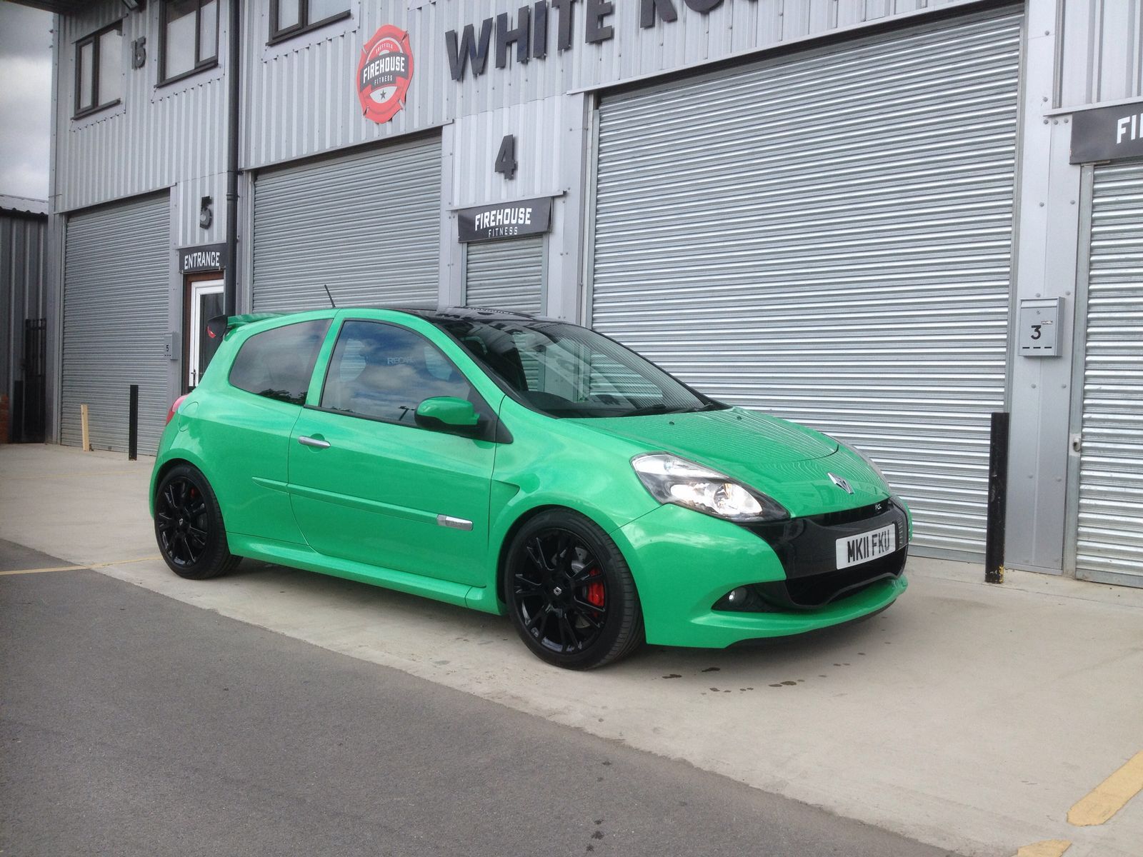

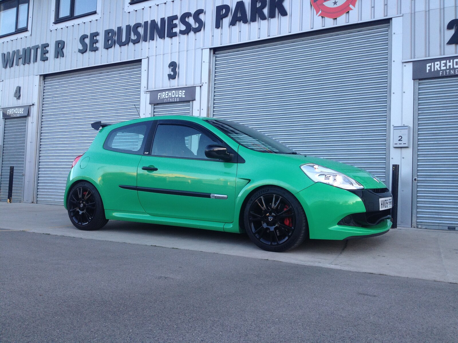

Here are photos of the 2 AG's i have owned. The full fat had H and R's with cup suspension on it.
@NorthloopCup bought my first AG of me and he tracked it and i believe it performed very well for him on the track.
i think from most the reviews you see online, the grams springs with cup shocks would suit your requirements better.
i use H&R's with later cup shocks on my track car and love them, but people often complain they're crashy.

how much do they lower the car Ben? Have you got a photo of them fitted?
View attachment 1455481View attachment 1455482

Quite a bit softer Scott. I have owned 2 x 200's with Bilstein coilovers and 2 x 200's with H and R's and cup struts. I do prefer the lowered stance of the coilovers and learnt to live with the ride but the H & R's were lovely in comparison but just not low enough, lol.
