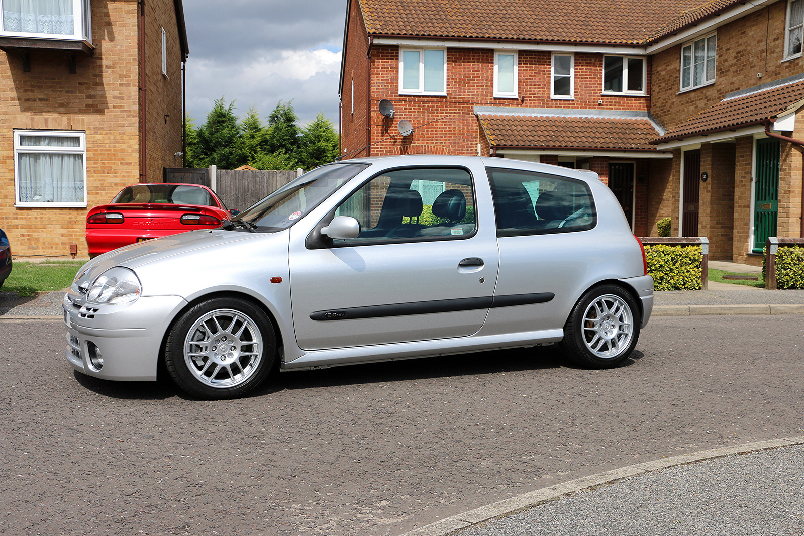

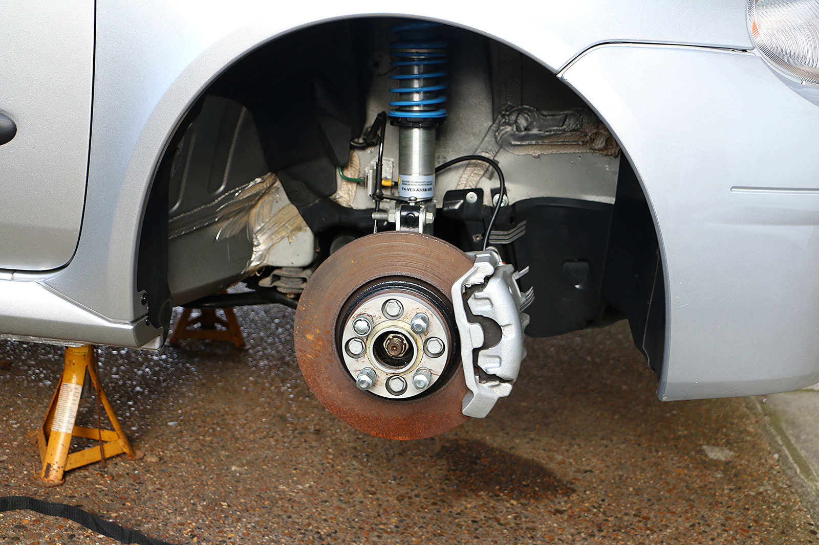

Fitted these today, but sitting pretty high. I stuck to the height recommendations in the booklet they provide. How low did you guys go, especially on the rear, do you just wind the adjuster all the way to the top? The instructions say you should leave a 15mm min gap from the adjuster to the top part of the spring mount.
Any info guys?

My rear was set to the lowest which is fine for day to day driving even with a full tank of fuel.
I had very slight rubbing when i had my 2 kids in the back with a boot full of stuff.
004 by Scott Raven, on Flickr
009 by Scott Raven, on Flickr

I've taken the adjuster ring out of the back and the rear is still pretty high tbh but mine is half stripped with no spare wheel
Any info guys?
The lowest is still too high imo. I've got mine wound all the way on the rear and it's still high. Going to be removing the adjuster soon when the new wheels are on I reckon.

taking the adjuster out is the way to go then. Cheers chaps.
How low do you go on the fronts?
I've not yet fitted camber bolts or spacers. I suppose going too low would put extra stress on the shock and other components though
dann2707
Be careful if you go too low. I've got camber bolts and 20mm spacers and it scrubbed on the bumper bracket. Had to do some careful smashing the f**k out of it with a hammer at a track day to sort it.
Doesn't rub now though.
