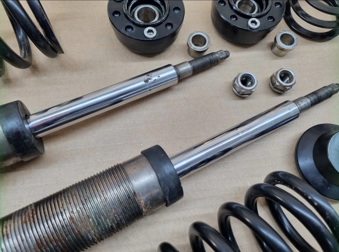

Bought a set of Spax RSX Krypton's that are in need of new inserts and the old ones being drilled out/extracted
Spax want £150+VAT per side plus postage both ways to remove and put new inserts in
The damage
What an unbroken one looks like
The question is, does anyone know of any stock of these on the shelf or know anyone that has made some? I don't mind paying to have them fixed, I'm not a c**t but at near on £400 I expect more than just lobbing in a pair of inserts
From looking at alternative brands like Gaz it looks like they have pretty identical inserts

The insert is the main part of the damper, of course that's gonna be the most expensive bit, the shaft is damaged and the rebound adjuster is toast and even a rebuild is gonna be a shaft and a complete strip and reassembly. Shafts are £50-70 alone.
Those Gaz's are shot with that plating damage too.
The rebound adjuster is at the bottom of the shock mate
The insert is purely to attach it to the car
The Gaz's aren't mine, it's just a picture to show the threaded insert is similar

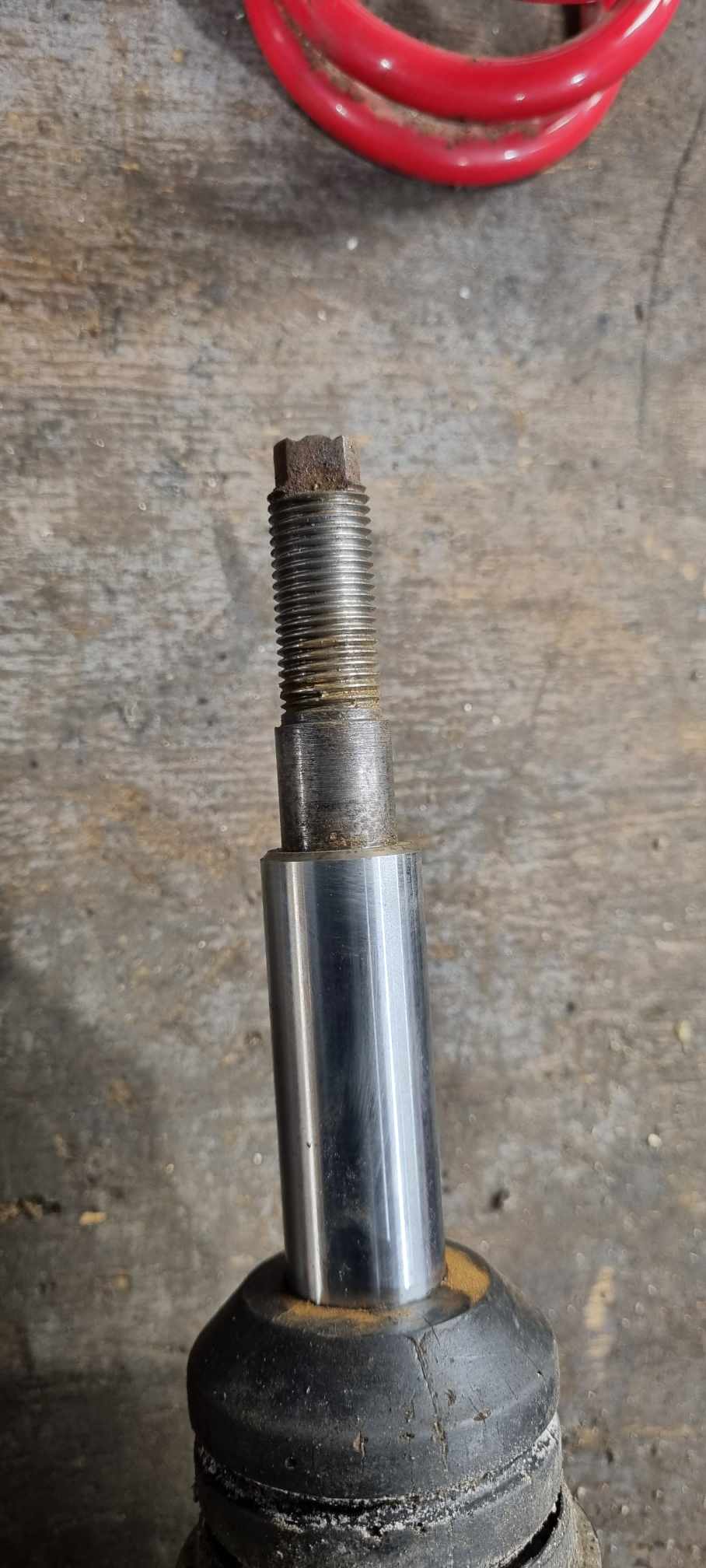

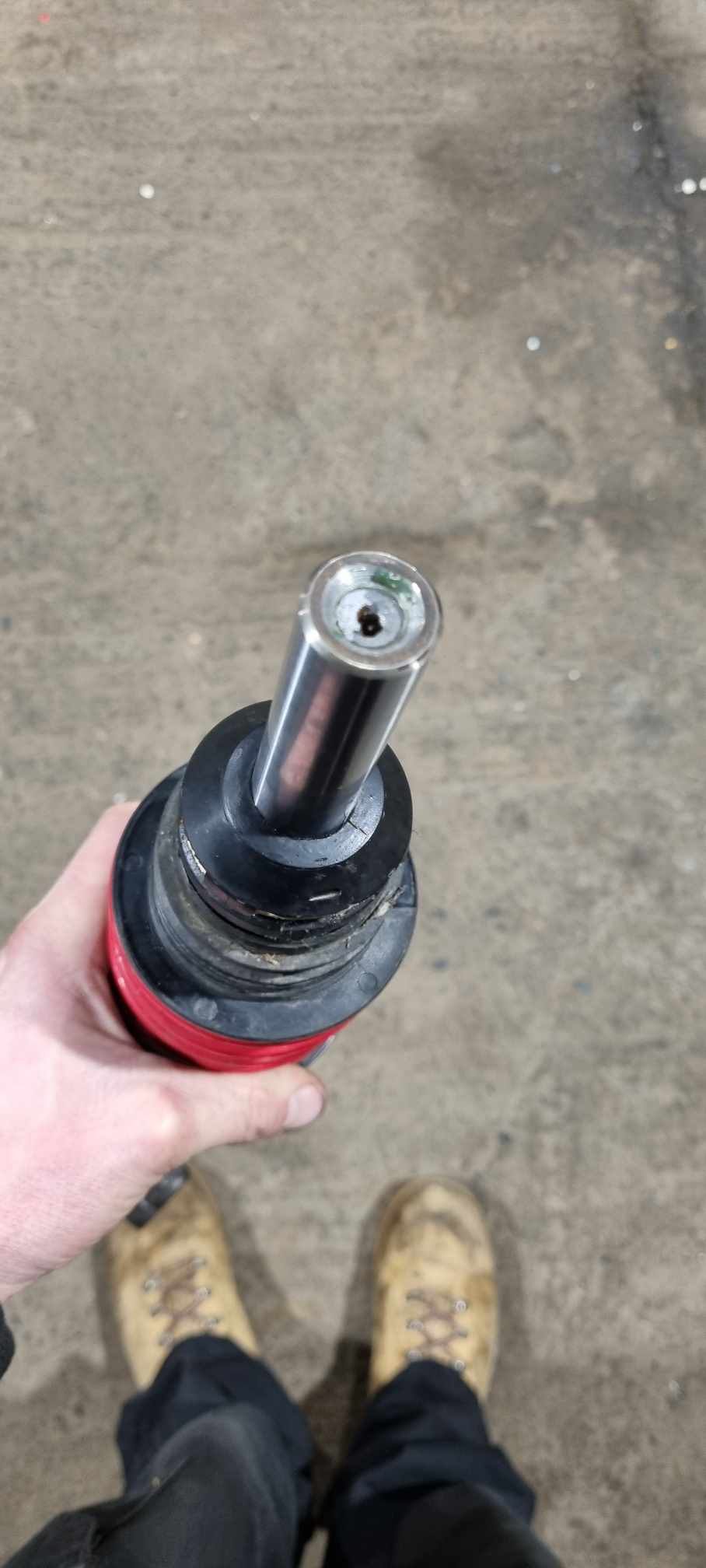

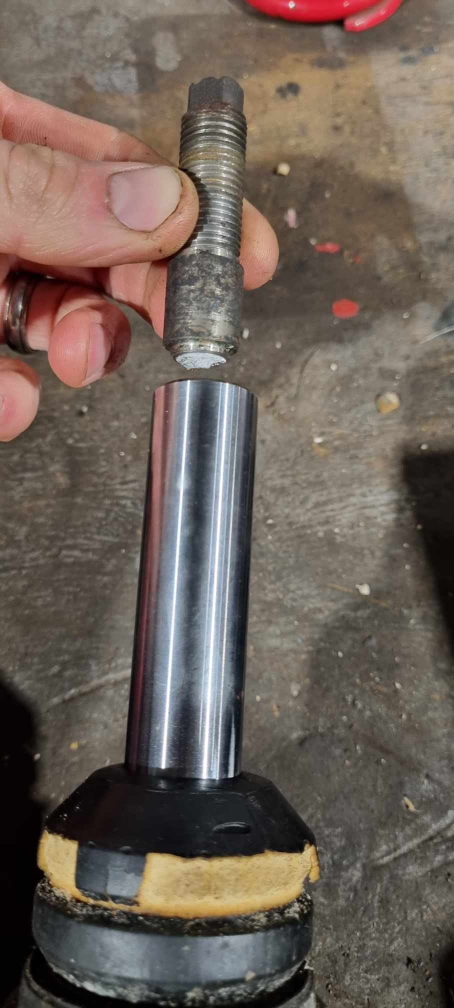

Ah okay they're just a generic threaded rod with an adaptor in there. Yea, Spax and co will still just swap the entire shaft out, they won't drill and swap the fittings, it's not worth their time when there's shafts on the shelf, plus the risk of marring the plating.
I've an old Gaz guy around the corner that makes his own shocks now, I'll ask and see if he's got any floating around.
