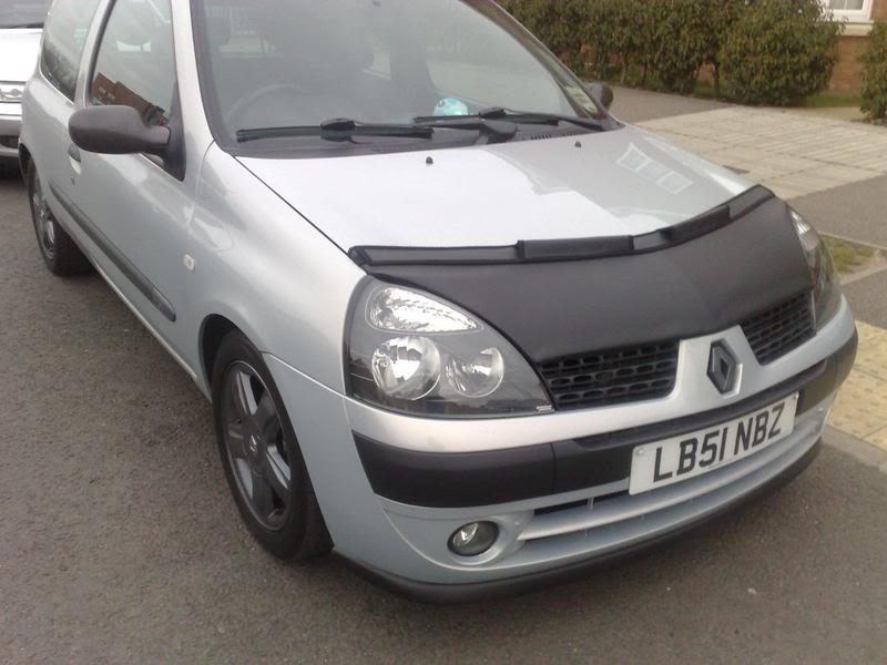

Like this black clio in this picture above, Is it as simple as sand down undercoat then gloss black finish it? anyone done it? if so please let me know thanks :cool:

aint even gotta primer it, just black it if you like.
scuff it with a grey scotchbrite preferably or sand it with whatever you have finer than P320

theres no repair, no damage etc. so just scuff it and paint it.
you can primer it, but theres no need to at all. just creating more work for no reason

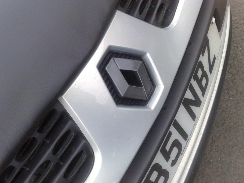

I did mine over my lunch break today, its at home drying now, so driving with no front badge on. Looks good tho! :p

you painted it at lunchtime, and its already back on your car at 5pm?
thats no where near enough time for the paint to cure properly, especially in the frost tonight.

1 layer of primer, 2 layers of paint, then 2 thick layers of lacquer. jobs a good'un :D
