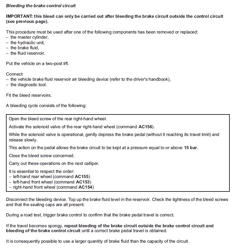

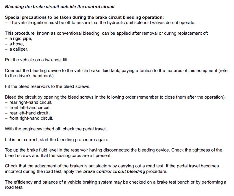

the procedure in clip is as follows. I did mine with Clip recently with a pressure bleeder also attached for the second stage. for each caliper you need to get out approx 200ml for the fluid to have fully passed from the MC to the bleed nipple.
I did two passes on the bleeding section (second image) and managed to get a significant amount of air out of the system.

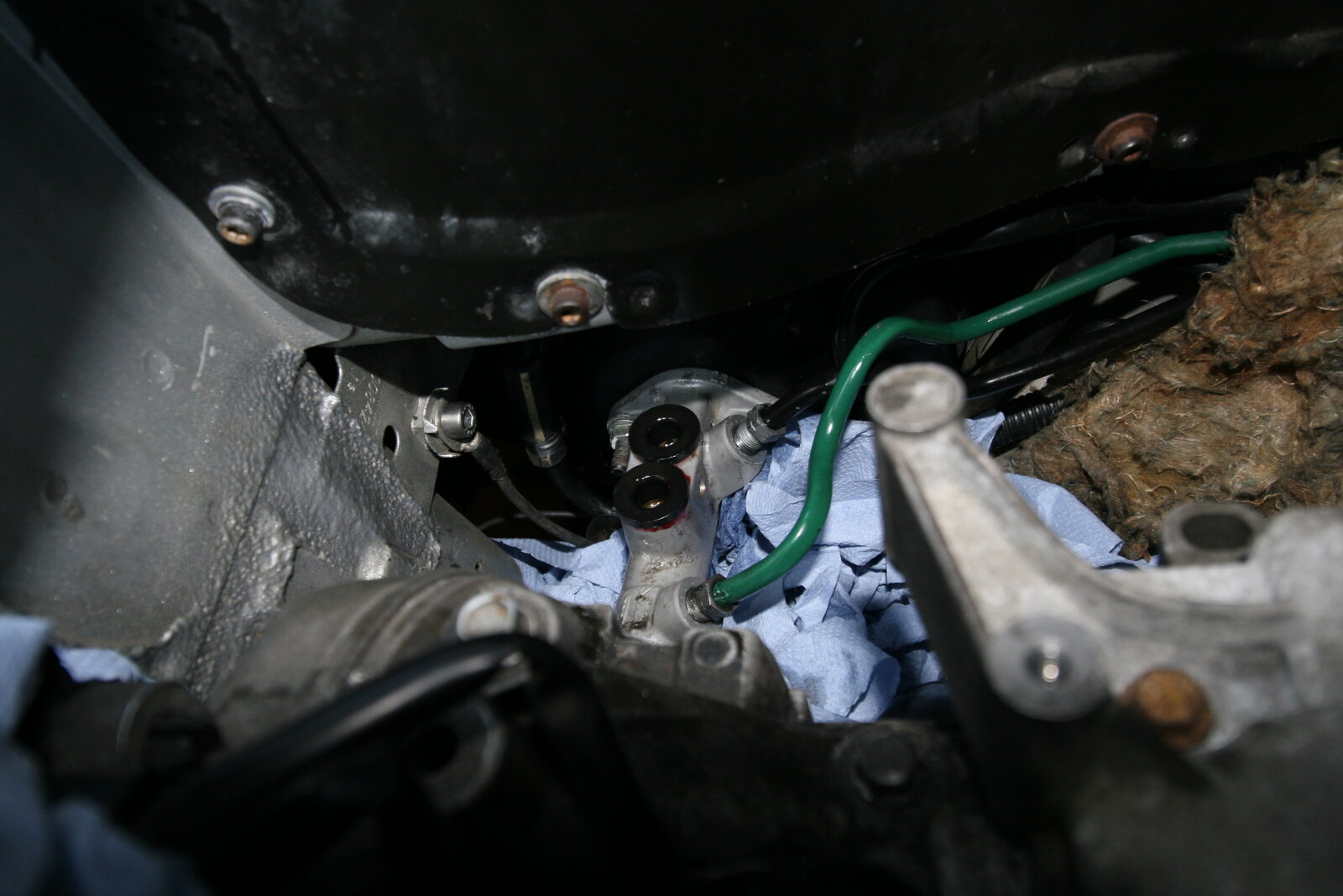

Fluid was pouring out of the black line when I hooked up the bleeder (tyre set to 20psi) I tried to tighten it up more which It did go but it kept getting tighter yet it was already stupidly tight, fluid still poured out. Ive to my enjoyment taken off the rez to get proper access and completely loosened the fitting, the only thing I can think of was it not seating correctly, but Im reluctant to just tighten it back up and try again as this really was a huge kick in the balls and f**k it going wrong again.
Ive tried to hand tighten it as much as I can while wiggling the line so its in the right way but I havnt got that far before it needs a spanner.
I put some red rubber grease on the seals as you can see to try and seal them up a bit, I had no clue if its any point but those seals are useless anyway. Is there any way I can make them seal better?

So Ive taken the line off to inspect it. I think the flare wasnt seated properly in the mc, Im a little worried as the flare doesnt seem perfect now but Ive tightened it back up and it seems to have done up correctly this time (it became tight and wouldnt budge) I also backed off the fitting then re tightened it a couple times. If It leaks again then Ill know its the flare, my fault though:( If I have to Ill make my own line with smaller diameter just to be able to drive the car as It has to be on the road by tomorrow!
Still leaks.. Am pushing the fluid out to empty the reservoir to minimise mess taking the line out then will make a new one.

Made the line last night and so far no leaks.. Have been bleeding it without clip to start, opened up the software and started with the rear right (AC156) but Im not sure if it works because clip seemed to crash nor was there any noise from the pump and air just keeps coming out in a steady stream no matter what.
There is a definite buzzing sound when it's bleeding or doing abs in clip.
Try and keep all the clip cables still when using it.
you need to activate the solenoid before then doing the bleeding. It's weird I know!
