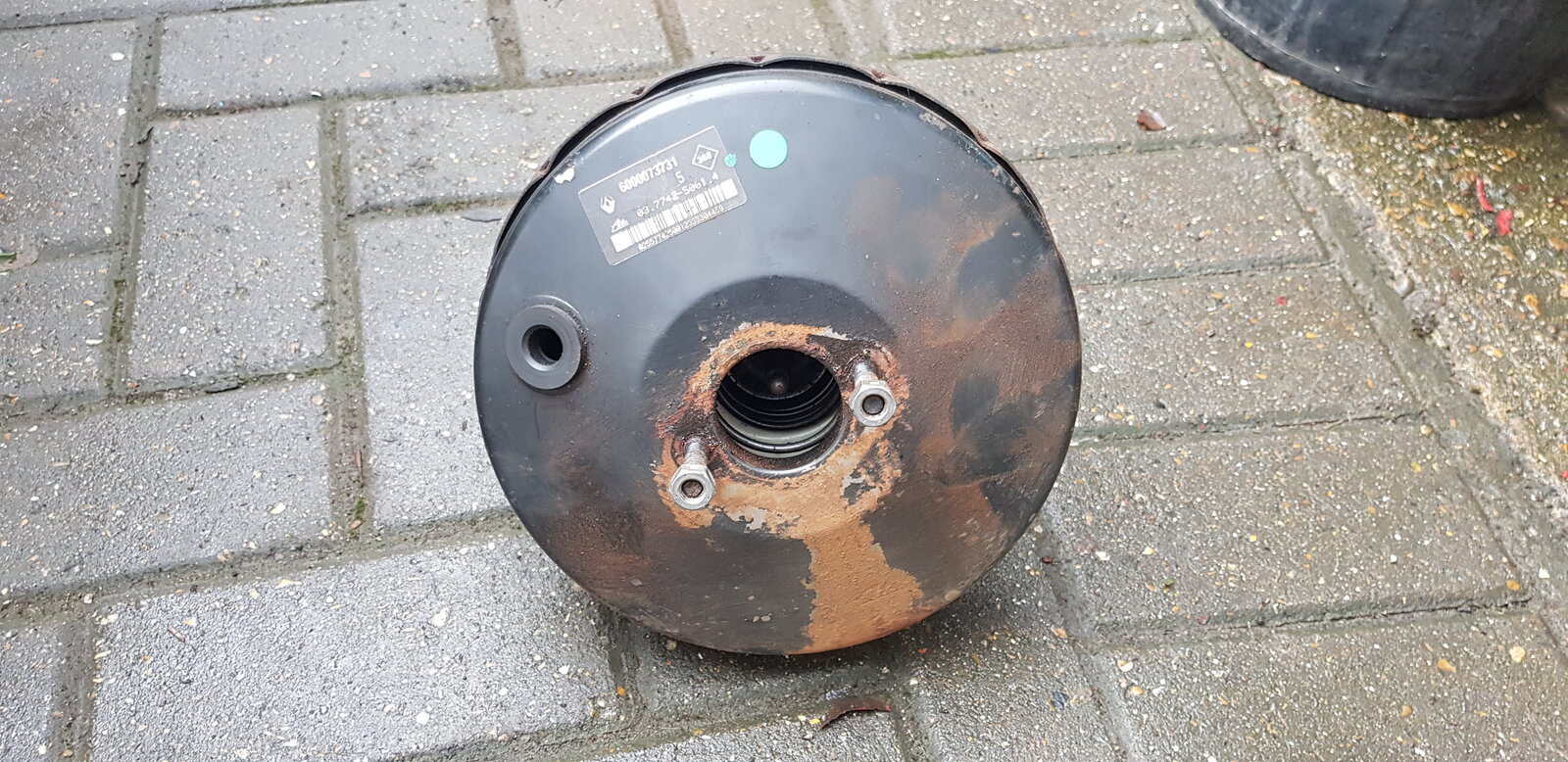

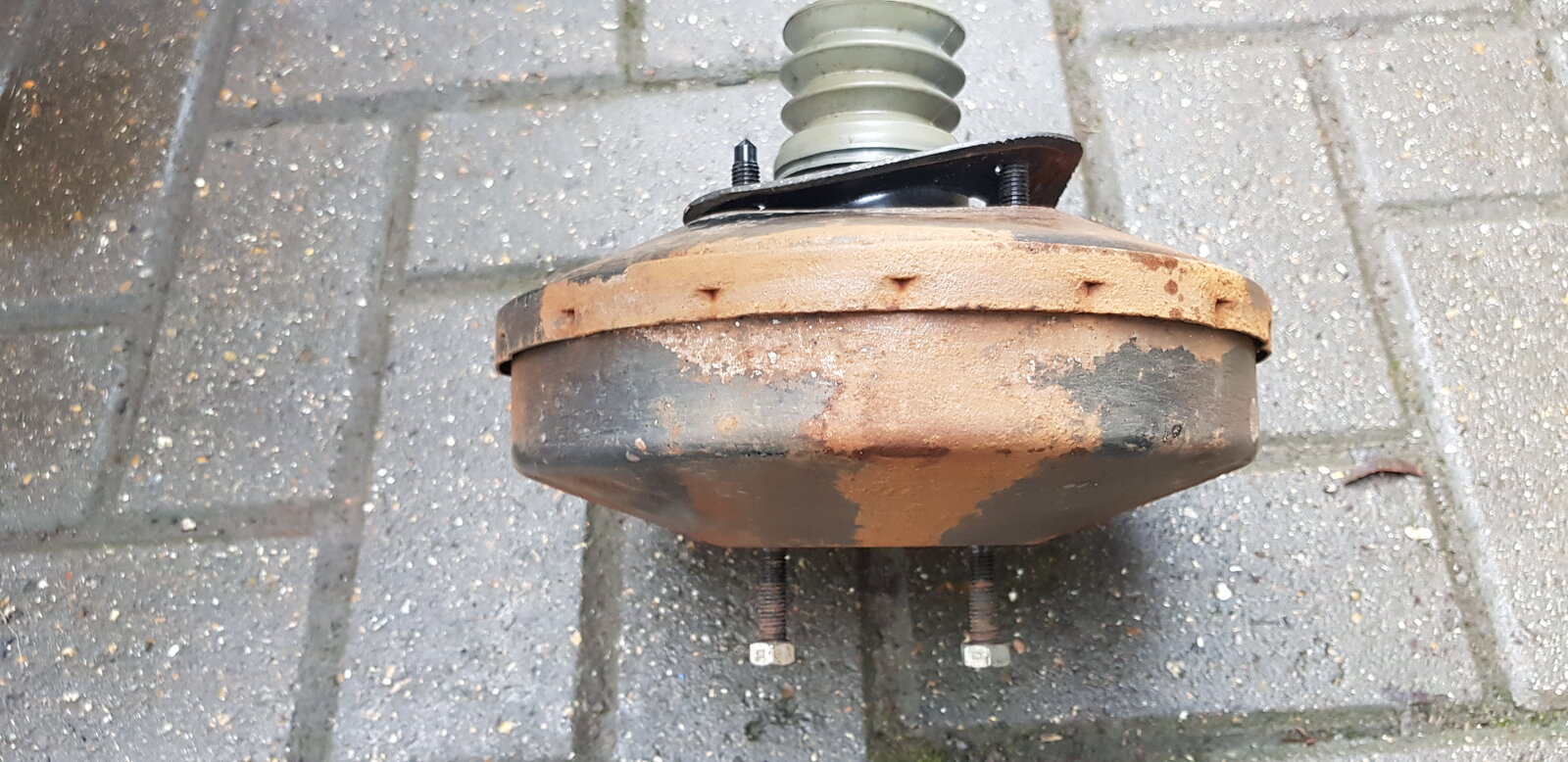

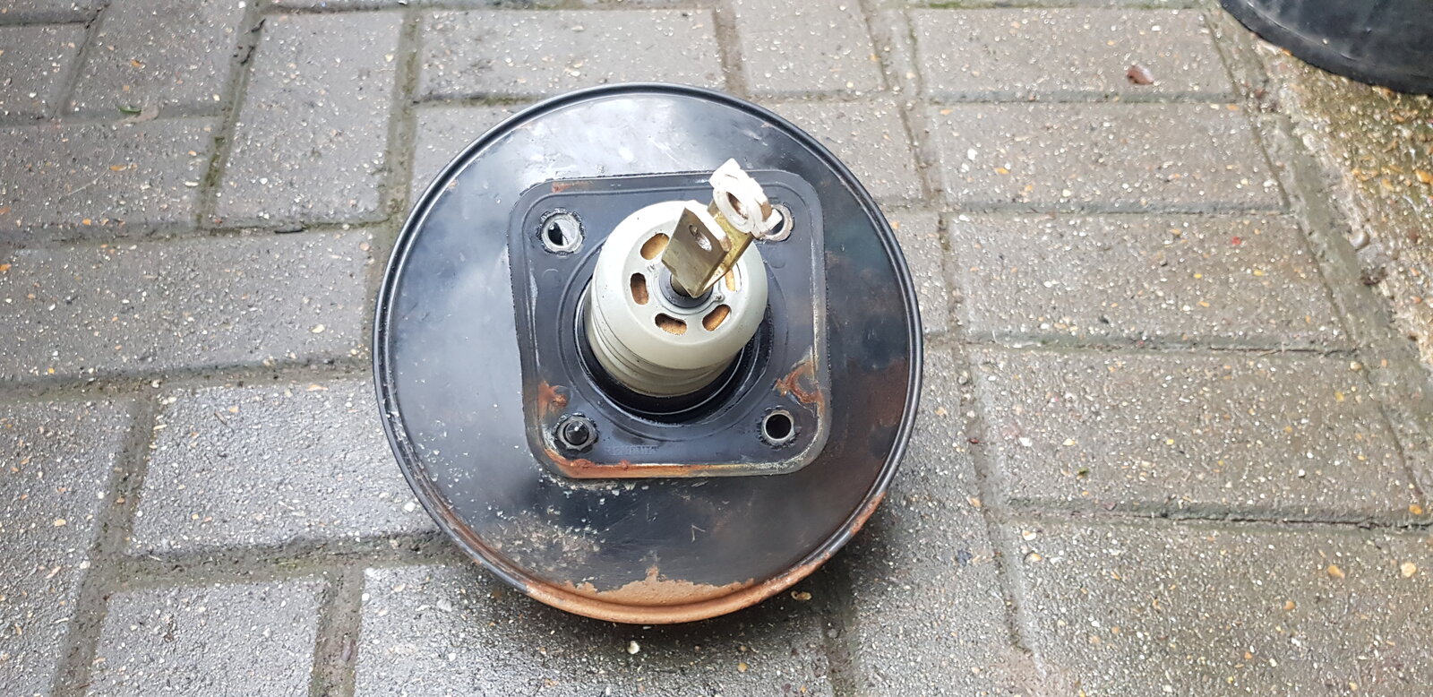

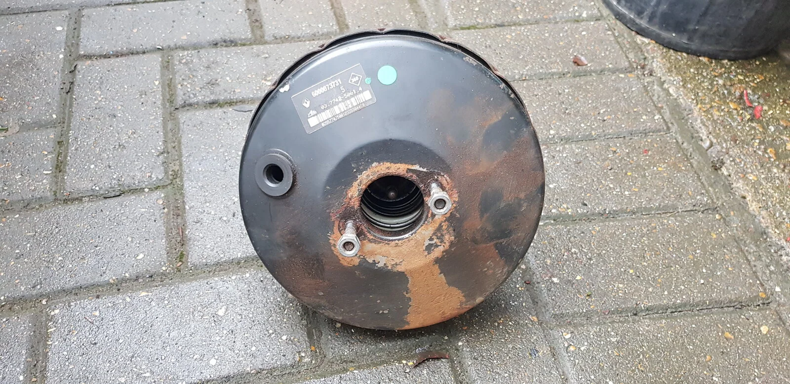

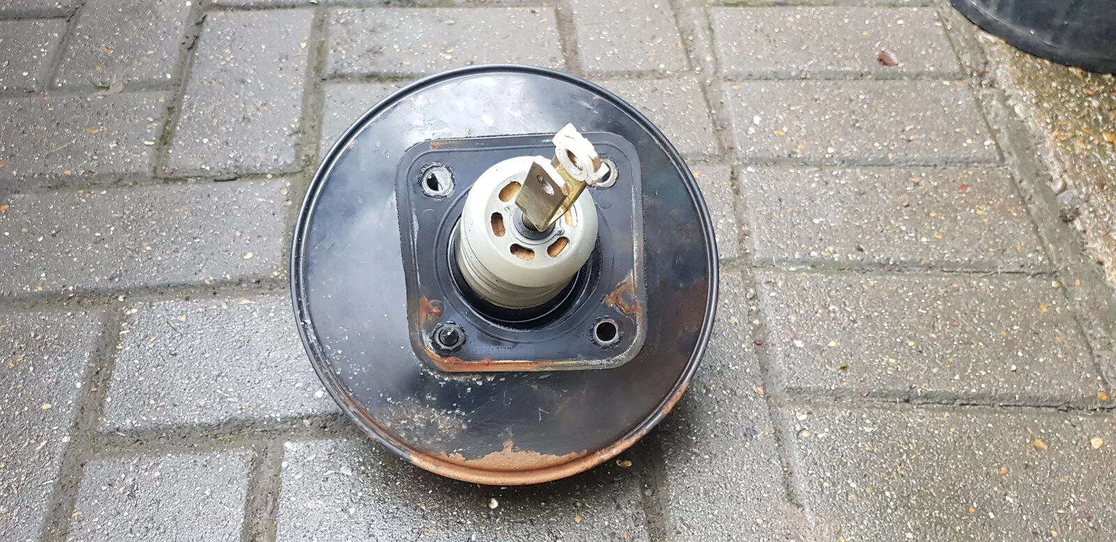

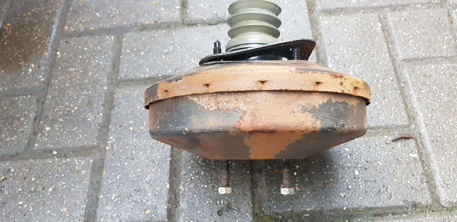

Just remembered I had this. Wire brushed it and just surface rust you can see. Is in really good condition, just needs a proper rub back and paint.
How much do you want for it?
I've just seen one on eBay with pedals and vacuum pipe for £19.95 delivered.
Mbeau
  Clio 172
Was going to say £20 posted so the one on ebay might be a better buy if it's in good condition.
MRBILLYUK
  FF Jeden Osiem Dwa
The one on eBay looks alot rustier than yours , maybe deeper than just surface rust.
I don't suppose you have the master cylinder and reservoir to go with it ?
