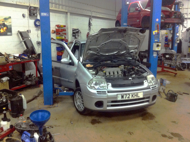

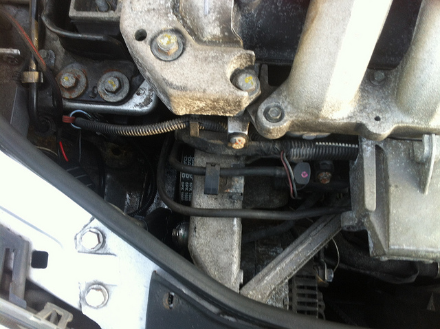

A mech friend did a clip test on it which showed injector two was fried, was lucky enough to get three injectors off specialist breakers (ChisnNic's nicole), went about fitting them this saturday, all fuel lines off, soaked the injector in WD40, replaced, start the car, it roars into life and is as quick as the day BTM fixed it, take it round the block, pull up, smell petrol, open bonnet, fuel lines ruptured.... soooooo....
photo-8 by NaithanAriane, on Flickr
Next step is fuel line(pink marked piping), got some camber bolts, studs n nuts to go on, and a PH2 bumper ready to be sprayed, when I've fixed the lines it'll lose the y0zza race for a y0zza stealth. but yeh, she's sort of back, in a style only we could manage ffs.

Any ideas what we're looking at for that fuel line?
The fuel line.. Next to nothing I'd imagine, off of any of the 9,000 ph1's that are being broken at the moment. Or as Mike says, brand new.
Good to see it's back on the road.
nah you can see the rip in the line, when you prime it hisses out, its 99% due to the pipe rubbing on the belt next to it, never done it before though.
looks a bugger to do.
It's easy to swap.
Unclips down under the car by the drivers seat. UNclip there. Tie string to lower end. Pull pipe out of top leaving string in loop. Tie same bit of string to new pipe. Pull back through. bit fiddly getting it back in the clips, but simple enough.

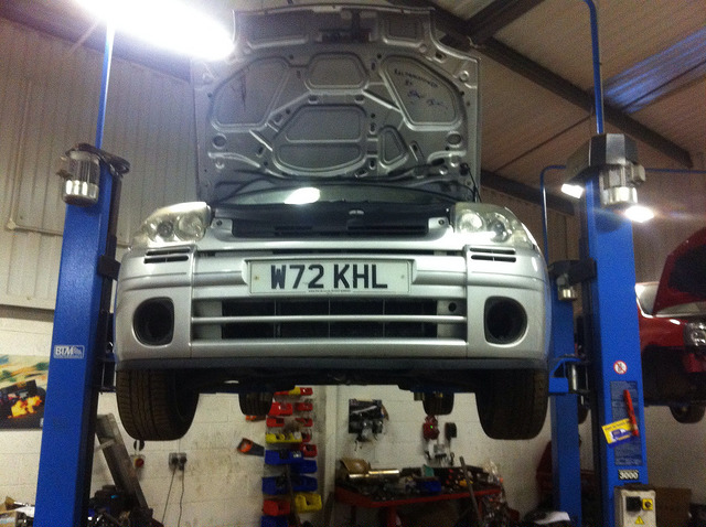

took it on friday for a y0zza stealth back box. I mean the full race system (including decat) is brilliant, but its simply too loud for me day to day in a daily... Yes I've become boring haha. Took a drive from Manchester over the derbyshire moors, rang its neck and got to donington for BTCC media day. Cold day watched the cars then got in it to go to Birmingham. turned the key and it really struggled to start, twice it did it, third time i booted the revs and it was ok...
The car has been showing STOP and the Oil light for a while, however the car has had oil in it, I thought it might be this niggle starting to come home. Anyway got to BTM and left Zoltan to check, this is what I love, he looks in the engine and goes 'Oil Pressure Switch'.
172 @ BTM by NaithanAriane, on Flickr
He walks off and I'm kinda just stood there twiddling my thumbs. He walks out, walks in and has another switch in his hand to which is fitted in minutes. Lights off on the dash. So simple even I could have done it, NOT.

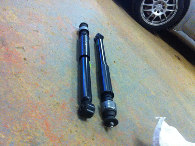

Also sourced some OEM rear dampers and had them fitted and the Spax adjustables taken off so i can sell them, I wasnt aware you can get Cup dampers on a phase 1 so unless we coilover the car we'll switch to them soon when I bin these god awful Apex springs off. The ride on the OEM dampers is alot smoother, although I've only done motorway miles and not stretched the car since I've swapped.
