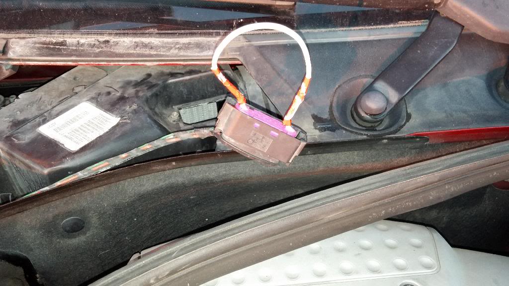

my blowers have stopped working. I've checked all the fuses and all are fine, so after searching on here it is most likely to be the resistor. My question is this - where is it, what does it look like and how do I change/fix it? I have just re-newed my membership hoping to find a guide/pic but cant find one.

I found the resistor and removed it. Now i have bridged numbers 1 and 5 connectors and the fans come on full power as expected. Will it be ok to leave it like this for a few days until i get a new resistor? Shouldn't do any harm should it?

I thought there would be a guide but couldnt find it on here. I did find one on cliodci.net, it maybe the one you wrote? Anyway I've ordered a new resistor now for 3quid so just need to solder it on when it comes.
