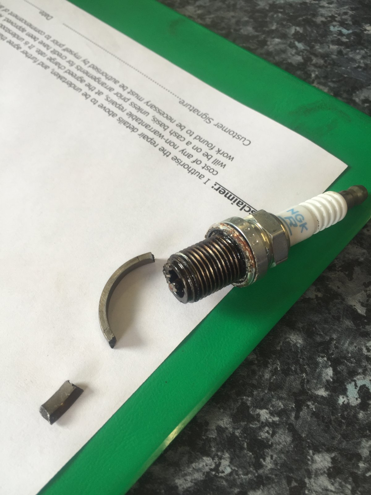

Hi all, engine has gone bang! I recently done the 98 Ron Map. Driven it for 150 miles and then it went.
Do you think it is possible the Rs Tuner Map could be the reason?
All belts, tensioners etc done in November last year by a specialist. Car has full service history, recent oil change, no fault codes.. Etc
The only thing that has recently been changed is the map. Here's a picture of what we found inside (amongst a lot of other metal debris)
Here we go.... This was in the 3rd chamber. Looks like part of the valve seating?? No idea what it's called!

Dropped a valve I take it?
If so I dose happen to these engine's.

Luck mate. I've seen one with a dropped valve on 50k but I've also seen engines run past 180k with just general maintainace. The valves on these are cheap s**t tbh

The overrun map has been known to do such things, but to do it in the space of 150 miles, it'd have to already be on the way out.
