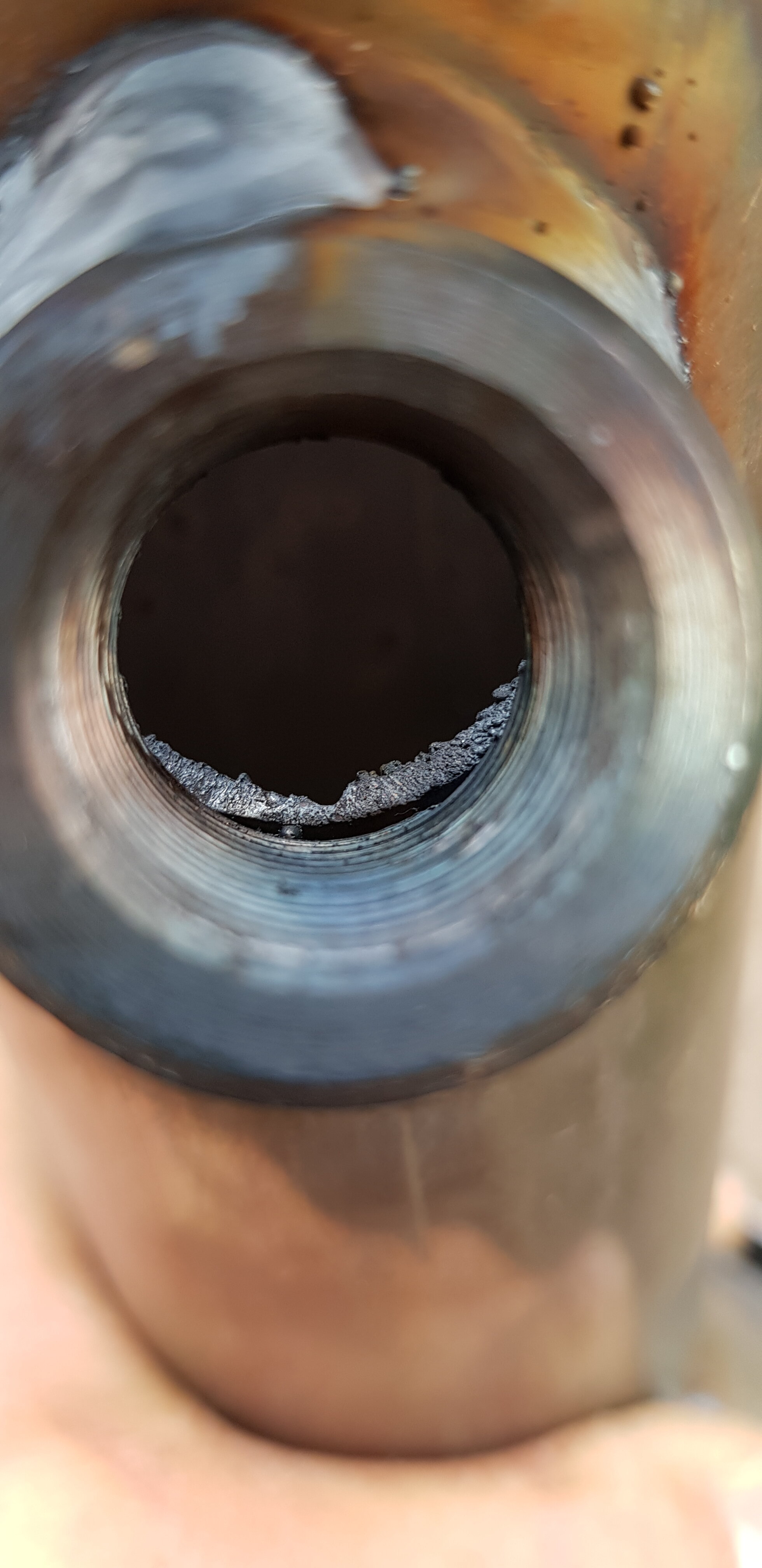

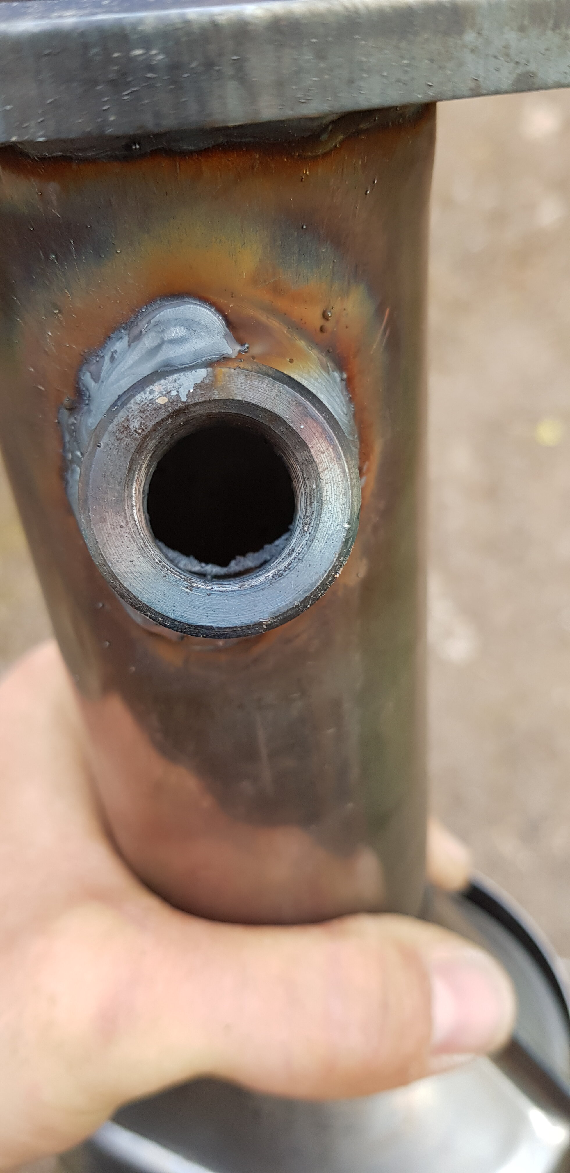

I know, I know, everyones going to say but why did you sell a perfectly good cat and replace it with this shite but I want to highlight the poor quality of BM Catalysts. This is the replacement for one which had the same issue as well as weld splatter in the lambda thread which destroyed a perfectly good lambda.
The threaded part has been welded on in the wrong place causing it to foul on the sensor.
Anyone got a post cat lambda for sale?😫
Had a few of these and recommended them too. Not had any issues with fitment or emissions and have been pleased. I think you have probably been rather unlucky if that is your second one with the same issue. I would either return and hope for third time lucky or get a dremel to it.

I think I will grind it out with my dremel, cant believe I've had two in a row. Good news is that BM catalysts have acknowledged the fault and are sending out a third prior to checking it over.

For the money you're getting for OE cats these days, blueprint items like this are worth the risk. That just needed filing or whizzing over with a dremmel before fitting.
Just ordered my mate a blueprint one for £200. EP3 OE cats are going for £900 this week, madness not swapping them.

I started grinding it with my Dremel it was eating the grinding stone away quicker than the stainless steel.
