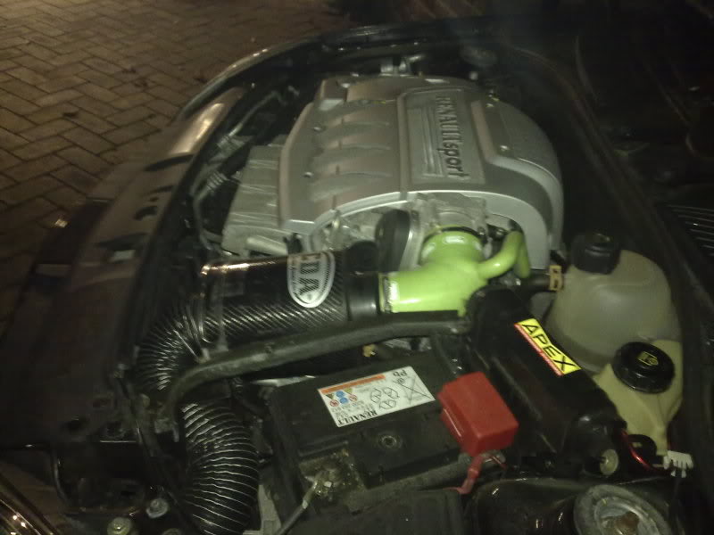

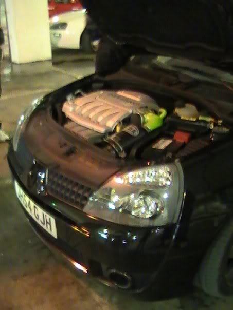

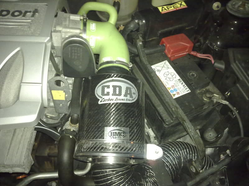

I have just put it...it took me about 2,5 hrs.
Here's some pic:
Bumper down:
This is to remove (is this what you call "acoustic valve"?)
I had to cut this metal plate so that tube can go trough:
Cutted:
Filter on place:
CAF:
The horn is pressing it slightly so it can't move nowhere:
Nice cold air enter beneath the car, mmmm:)
