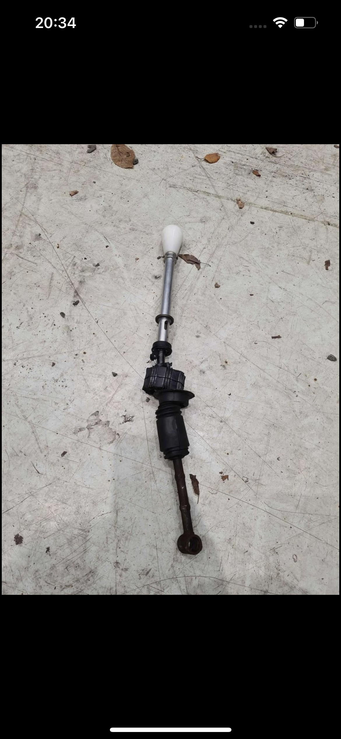

Does anyone know if the BMS shifter uses the Clio shifter hosing as I’ve bought a BMS shifter but has no housing

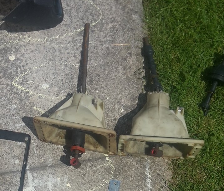

You could put it in a clio housing. It will fit technically but it wouldn’t be any good.
Due to the leverage being different and the BMS being modified and extended
If put in a Clio housing would drop the bottom connection point by about 1-2 inches, and as the BMS is already extended down over the OE scenic, it would massively clash with the exhaust, its quite close anyway when in the Scenic surround.
You want to be sure its a scenic frame, as (I suspect) a normal mk1 megane surround will be similar if not identical to the Clio.
You really need to see the frame to be sure, once uncovered its clear.
In this picture the scenic bar is the clio frame on left, and viceversa on right.

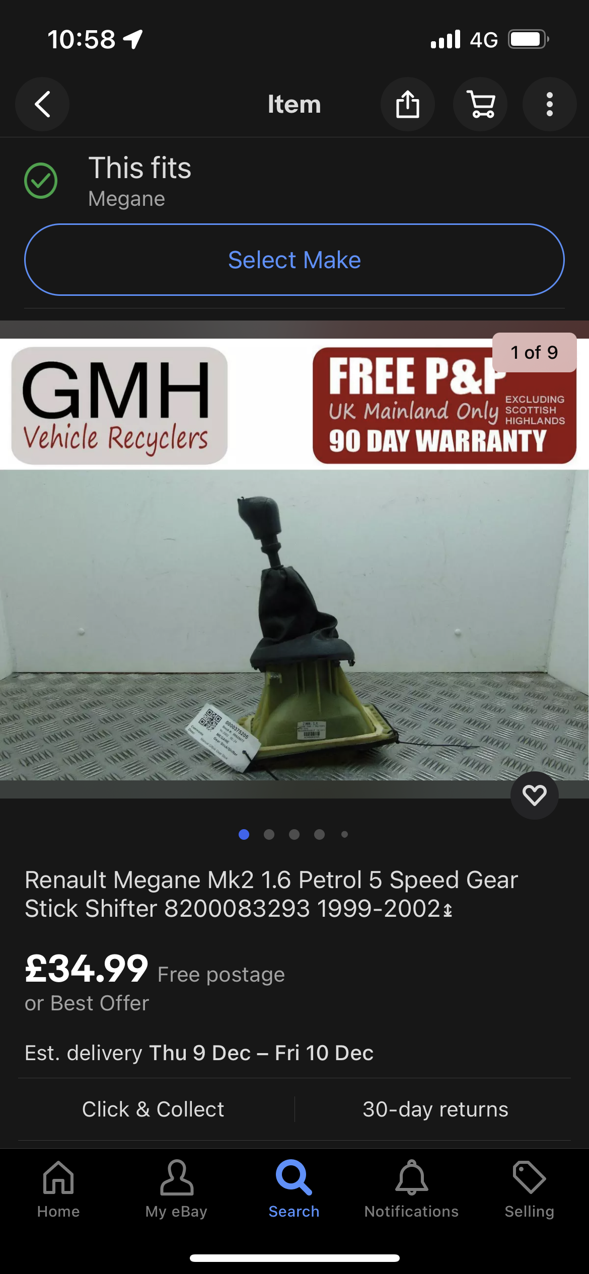

I have bought the mk2 Megane shifter as I put above hoping it will be ok it was only £25 so not the end of the world if it doesn’t fit, the guy who sold it to me said the Clio housing is fine and he has run it like that for years but I feel he might be lying
