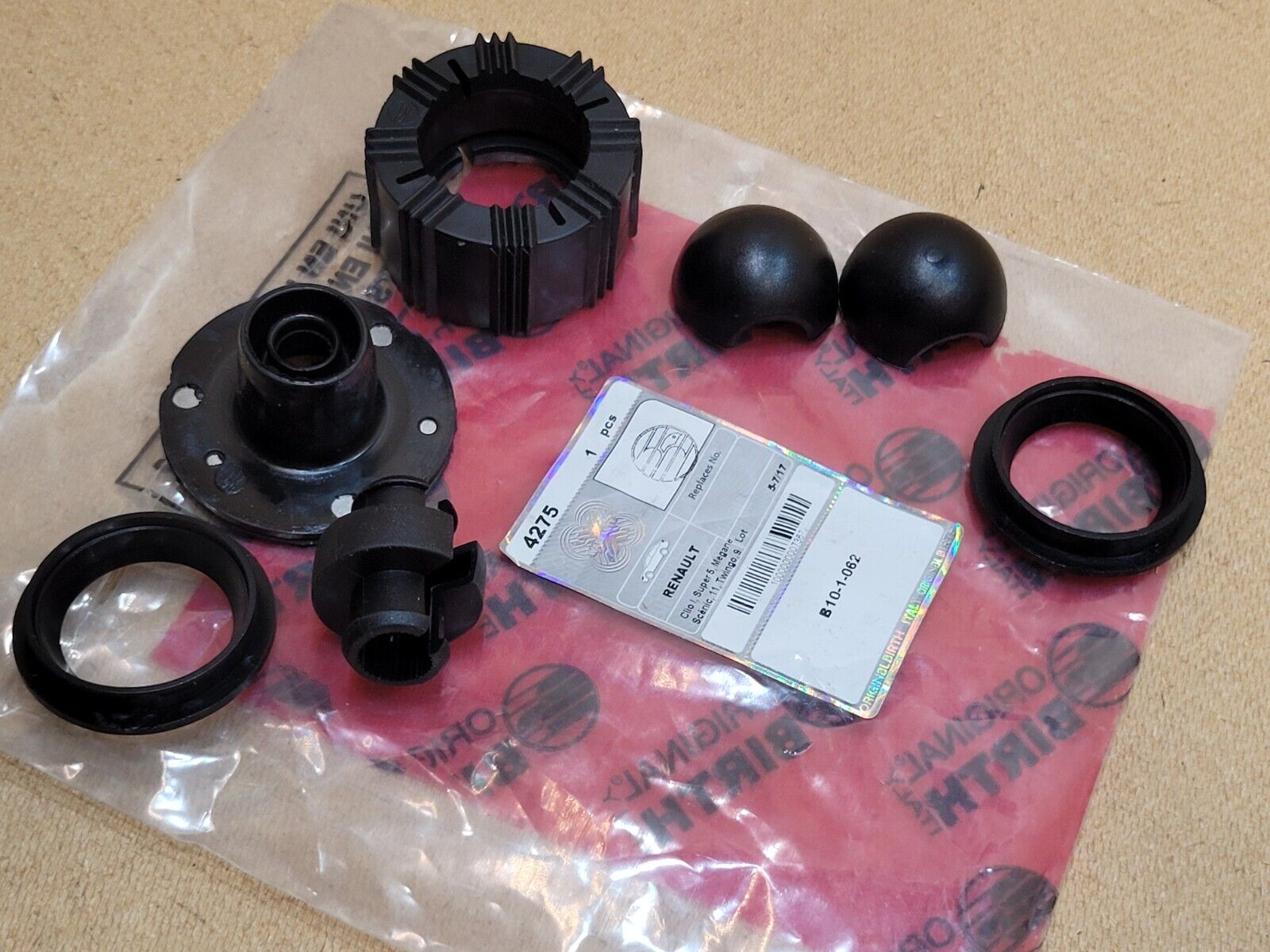

Buy the cheap rebuild kits off ebay for the megane shifter. Between the two top hats that go around the ball, put an o-ring in there.
This stiffens them up.
@Louis this sort of thing? https://www.ebay.co.uk/itm/166240315870

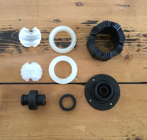

Sorry to hijack this a bit, but I've got brass bushes and a new one of these 7700872205 with a new circlip and there's very little slop in the gear lever.
I do have an annoying rattle from the shifter that I've not been able to find though. How easy is it to rebuild that ball bit (the rebuild kits linked above) and are there any guides anywhere on how to do it? I feel like that's the most likely candidate for my rattle based on where it's coming from.
