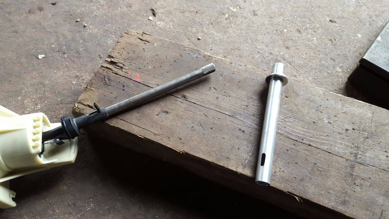

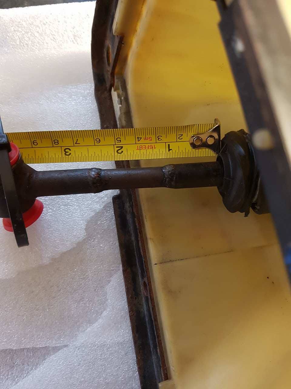

That's some sketchy looking welding haha is it sleeved or just a bar welded in?
Just bite the bullet @182_steve and get a PMS, mines not exactly used as a racecar is it? Apart from boosting its probably the second best thing I done to my clio.
Louis
I Park Like a C**t
Looks just welded in. I was gonna sleeve some for my own design but might just get a short shifter.
The pictures above are of the BMS

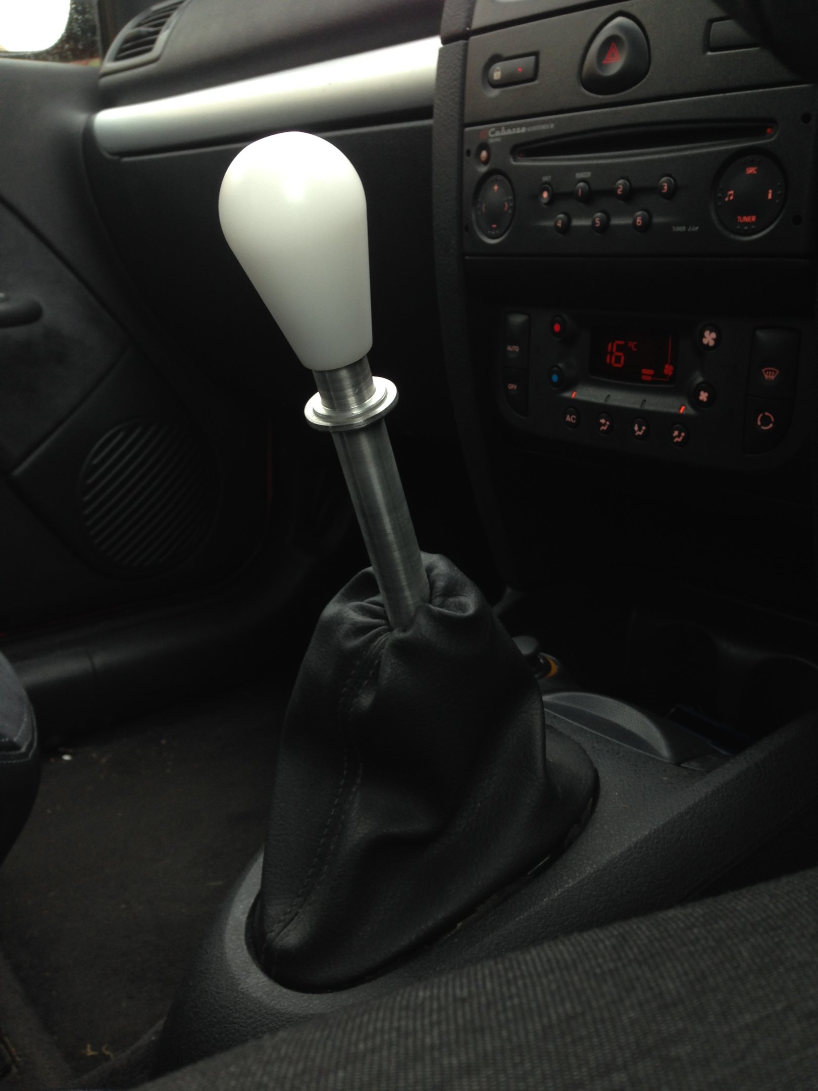

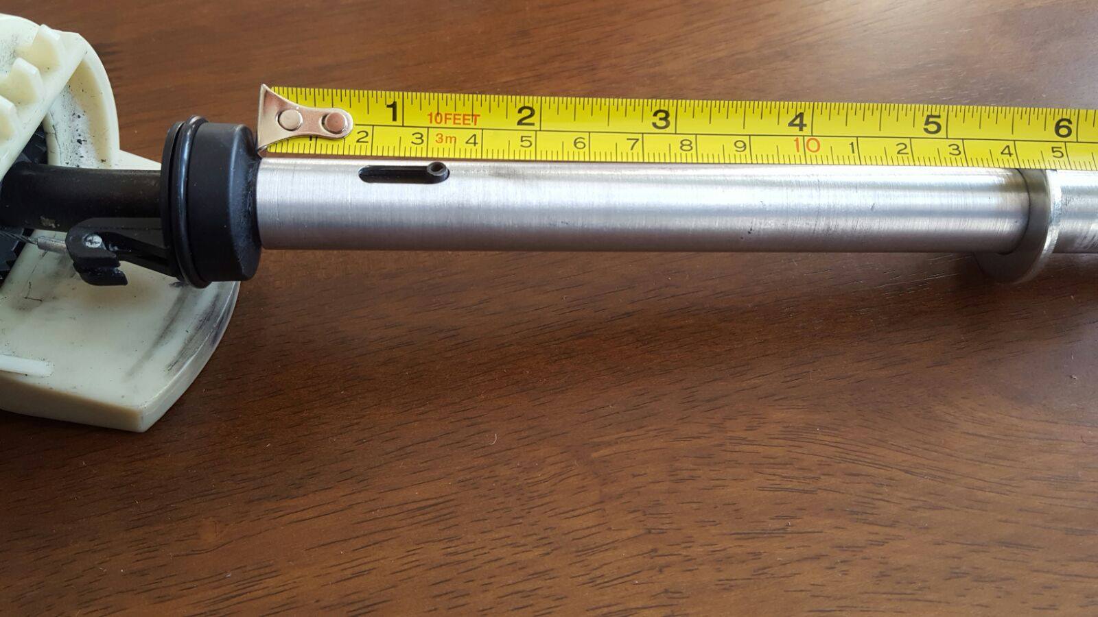

That looks absolutely spot on and exactly what i'm after......... looks slightly shorter than PMS too? That's what I want also
It looks shorter in that first pic in honesty.
Highest point is probably in line with the CD player, so kind of around that height.
