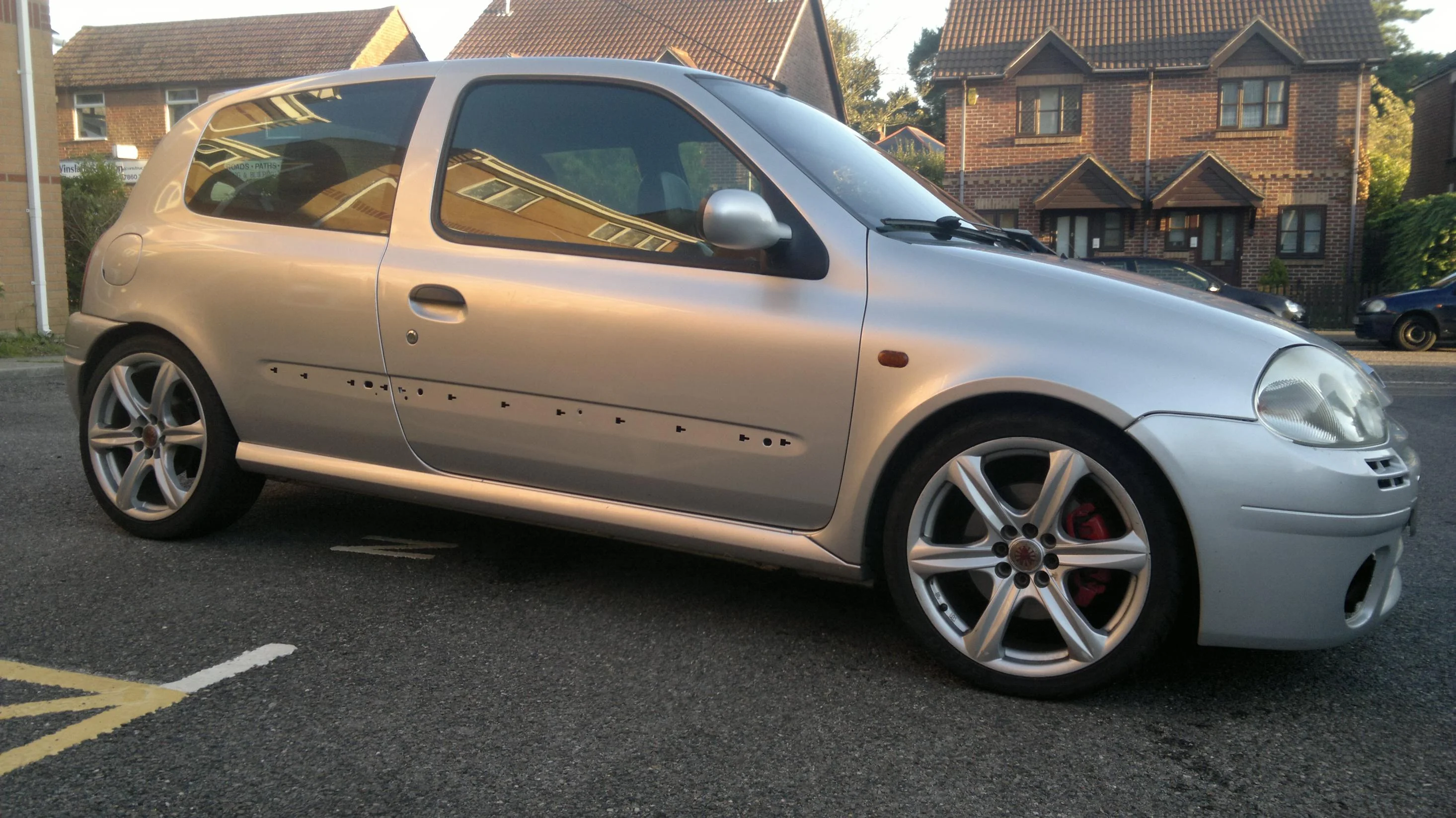

Me and a group of lads have been attending 1 car show a year for about 8 years now, none of us has ever had a "performance car" so for next year we all decided to build/modify a car ready for usc at santa pod 2012. Catch is its on a budget £2500 max including car WTF!!!! All have to be under 2l and N/A . No engie swap ie nova with a 2L and all has to be done at home apart from 2 items. Has to make it to the pod under its own steam and back again.
Object is to pull the fastest 1/4 mile.
Prize . Pride and £500 ( think a lap dance was dicussed as well)
And I've brought a ph1 172
Cost me £700 88thou miles :rasp:
![180920111032.jpg 180920111032.jpg](https://www.cliosport.net/data/attachments/37/37855-b4894560af49ef3d8b90469aa9df5330.jpg)
Was a non runner got it running after a bit of investigation, found the main power suply fuse blown, also the lamda sensor was faulty , ht lead squshed under the inlet manifold and the throttle body was sticking.
After replacing the following;
HT leads £25
lamda sensor £70
coil pack £free (mate was breaking one)
New plugs £35
Cleaned and polished throttle body Free.
It was running ok.
Next thing was to get the plastics off to be sprayed as they looked like some one had brush painted them silver. I also took the door handles, rear lock and wing mirror base's off.
£60 painted from a local body shop (photo's to follow)
Then the wheels where put up for sale got £200
Cost so far £690
Then i went on ebay...:dapprove:
Omp front and rear anti roll bars £160
Clear indicators £7
15 inch oz f1's with tyres £210 (multi fit ones)
And sold the rear speakers for £15
all this has taken the cost to £1052
Oil change and filter done for free buy a local garage just got to put a sticker on the car.
Sunday morning i stripped all the rear out just leaving the front seats and door cards for the moment but they are up for sale to fund buckets and harness.
Will get some pictures up soon.
Not got a clue to do with the engine, got to get a system and a good intake as there is just a powerflow back box and powertec cone filter on it.
Was thinking an ashley system for £189 mild steel i know but its cheap , also on the look out for a standard air box.
Handling wise ? its got some lowering springs on it at the mo and as we will only be going in a straight line i dont think it will matter to much.
But might ask santa (the wife) for some coilovers for christmas. (have discussed this with the lads and as its a gift will not count towards the final price
Found the site very informative so far and any help would be gratefull.
HT leads £25
lamda sensor £70
New plugs £35
It was running ok.
Cost so far £690
Clear indicators £7
Again i will post some photos up soon.
