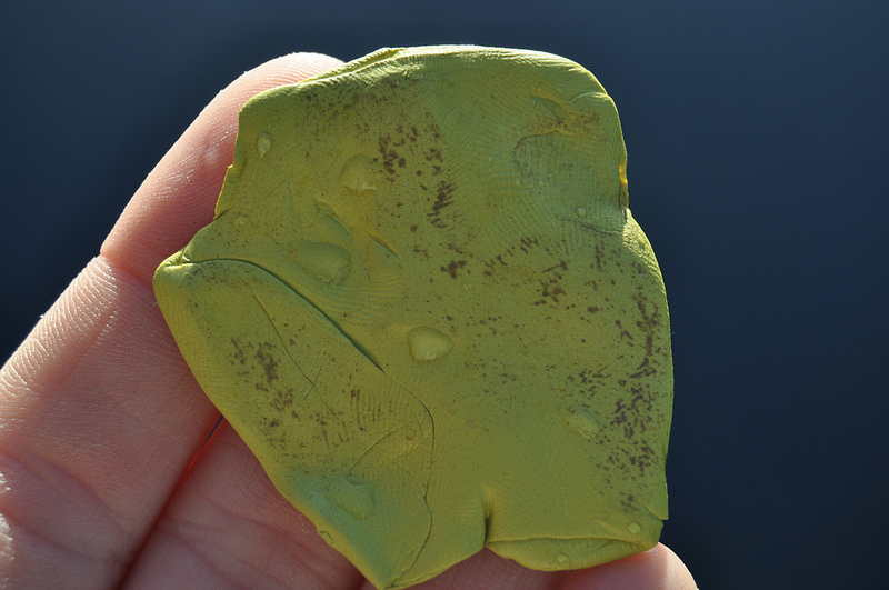

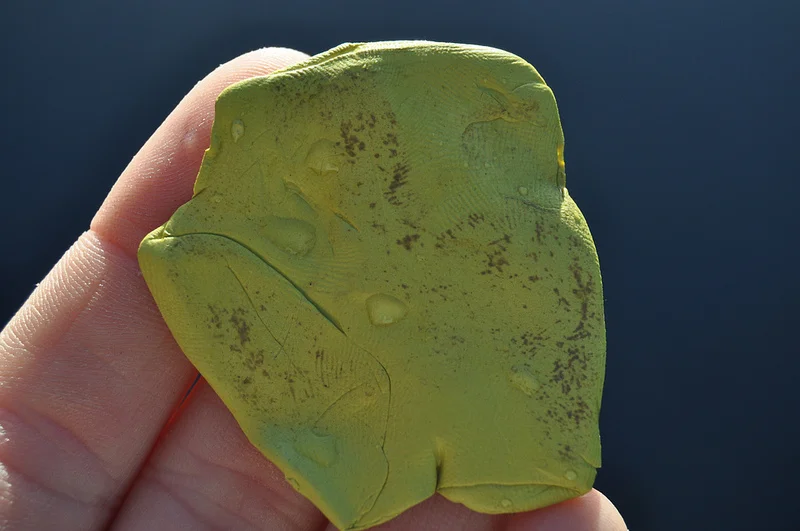

So, I started with the bonnet - rinshed, washed, rinsed, Iron X, Tardis and CYC fine clay (with LT as lube).
Not much contamination left :
DSC_0116 by DEAF N1NJA, on Flickr

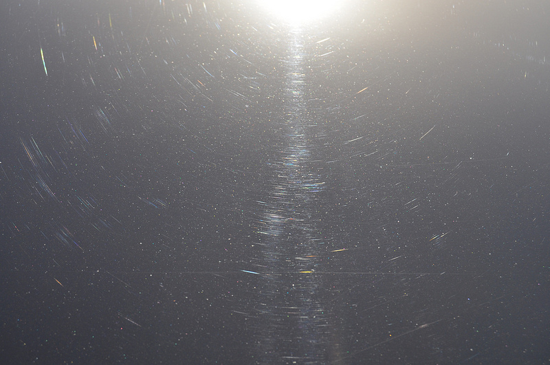

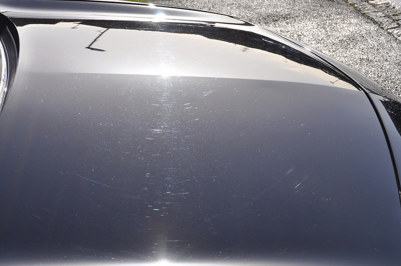

Followed by a rinse off, dry and to inspect the condition of the paintwork...
Swirls and RDS evident :
DSC_0110 by DEAF N1NJA, on Flickr
DSC_0112 by DEAF N1NJA, on Flickr

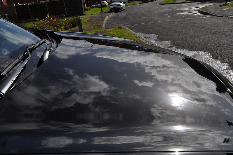

I tried a few combinations, but settled on :
CG Hexalogic green pad with Menz PF2500
Refined with CG Hex white pad + Menz SF4500
Paintwork cleansed with CG Hex black pad + Poorboys blackhole.
LSP is 1 coat of Raceglaze 55 wax.

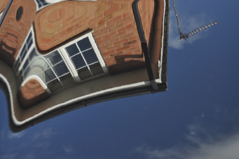

I figure I achieved about 80 - 85% correction, but the paint was a little tricky to fathom, harder than I thought!

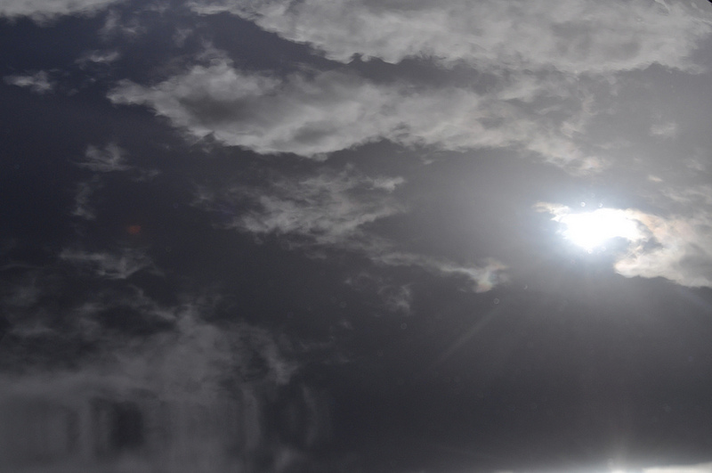

These are the finished results :
DSC_0117 by DEAF N1NJA, on Flickr
DSC_0122 by DEAF N1NJA, on Flickr
DSC_0123 by DEAF N1NJA, on Flickr
DSC_0124 by DEAF N1NJA, on Flickr
DSC_0125 by DEAF N1NJA, on Flickr
