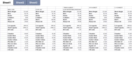

This may help you, a little chart from when I was working out comp ratios in my 182 using MEG 3 RS 265 pistons and rods, ended up using the stock gasket and it’s lovely! 9:1
I went from a low boost setup with stock internals using the ED kit to then the Megane internals and maxed out the setup at 282bhp and didn’t notice much response differences, maybe a tad laggy but this is being dealt with by my new turbo [emoji106][emoji106]
When you have time please upload a better pic. Thanks a lot! This will help me!
