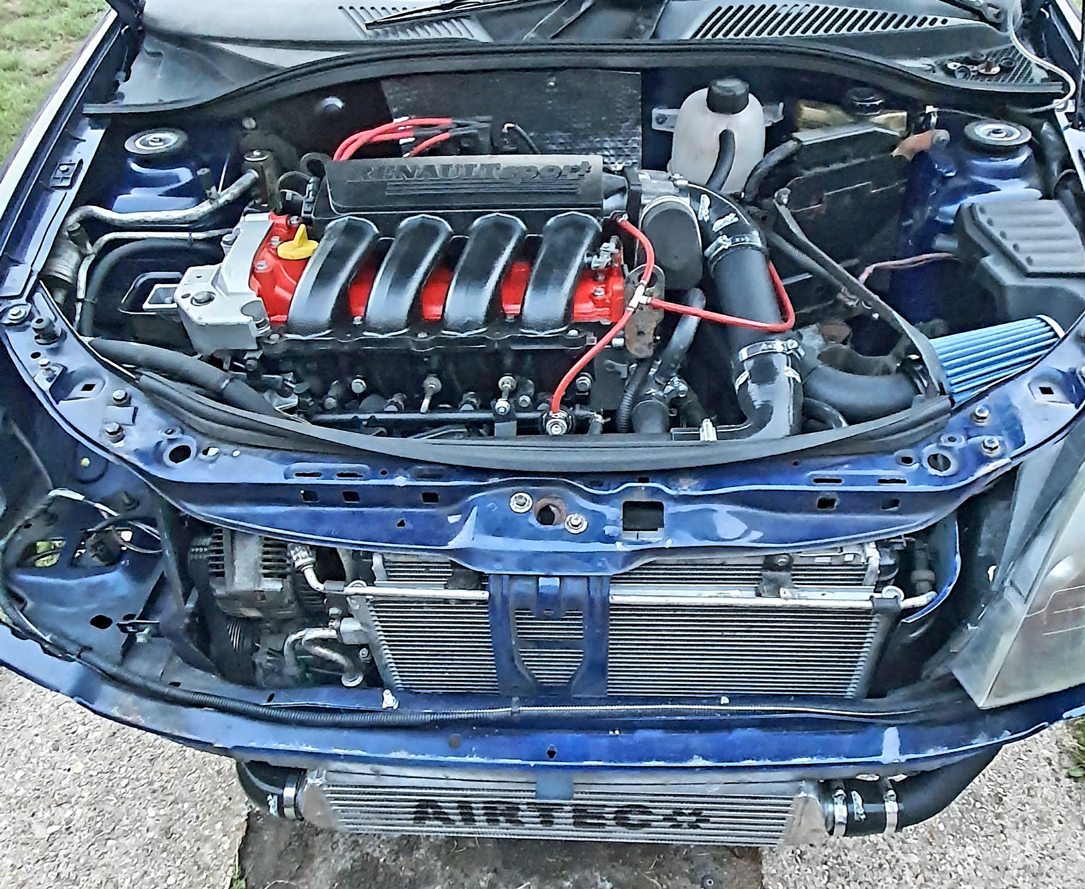

Hi All,

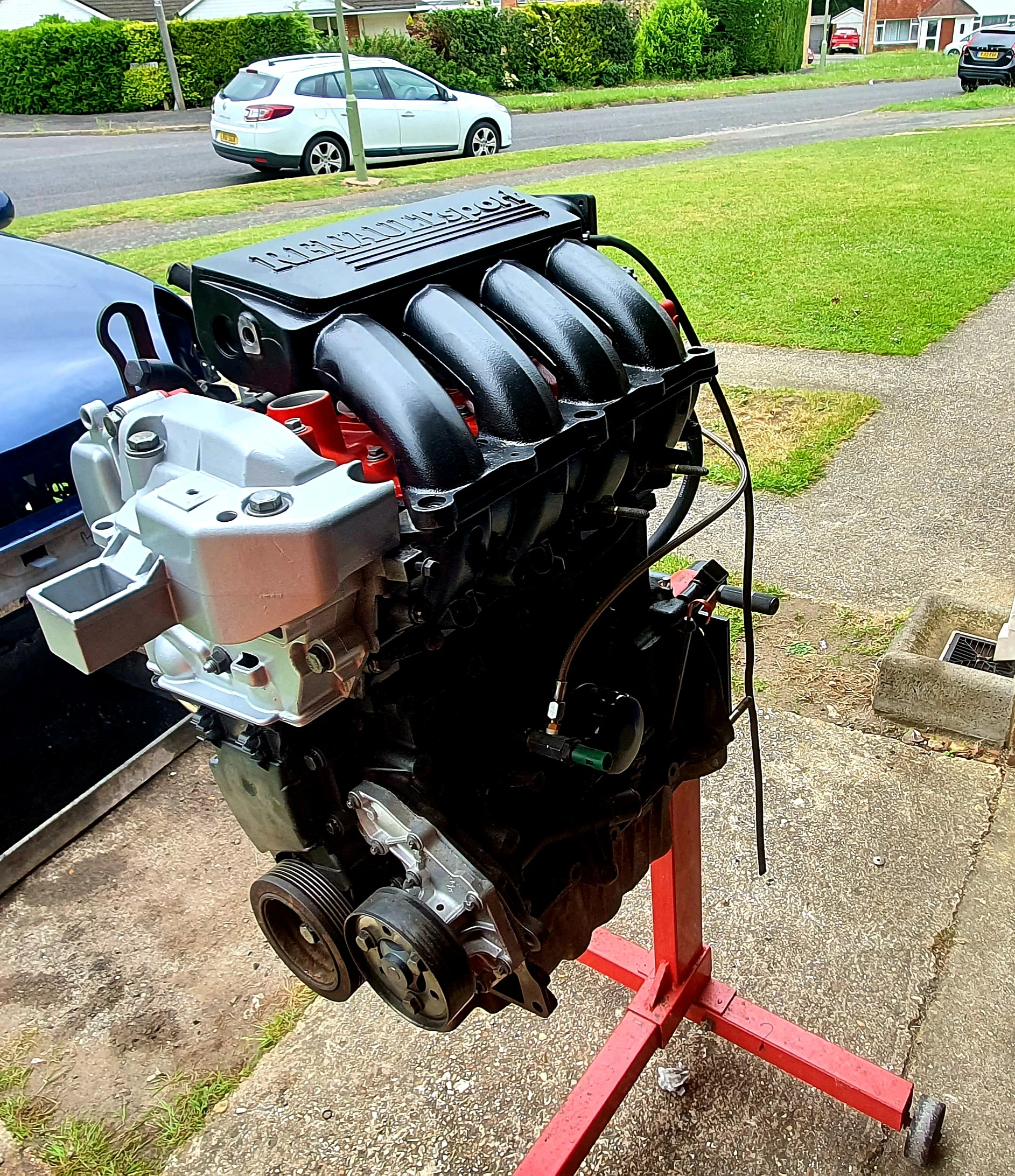

Hoping someone can suggest areas to look at with my newly converted 172 turbo.
Long story short, the engine bent the intake valves a year ago so I decided to rebuild the head, and reinstalled prior to doing the turbo conversion.
New valves were professionally fitted and seated with a very light skim.
Megane 225 MLS gasket fitted, and all bolted down.
New belts and dephaser were fitted, and timing set using genuine renault tools - really took my time with this to get the timing spot on.
Turbo manifold and turbo fitted, 225 injectors, converted fuel rail fitted, EFI ecu flash, MAP sensor and FI module all fitted.
Everything checked and double checked before installing the engine.
It starts well, but idle is lumpy initially and has a few splutters then seems to level out with usual 1#2 lumpiness.
A gentle prod of the accelerator and it seems a bit hesitant and bogs a bit before picking up, and very occasionally there's a pop/poof noise from the engine.
It revs OK once past the initial hesitation.
I've driven it up and down my road....not far as the bumper isn't on yet, and seems to drive OK.
Anyone come across this before?
It's got me scratching my head so any advice would be gratefully recieved.

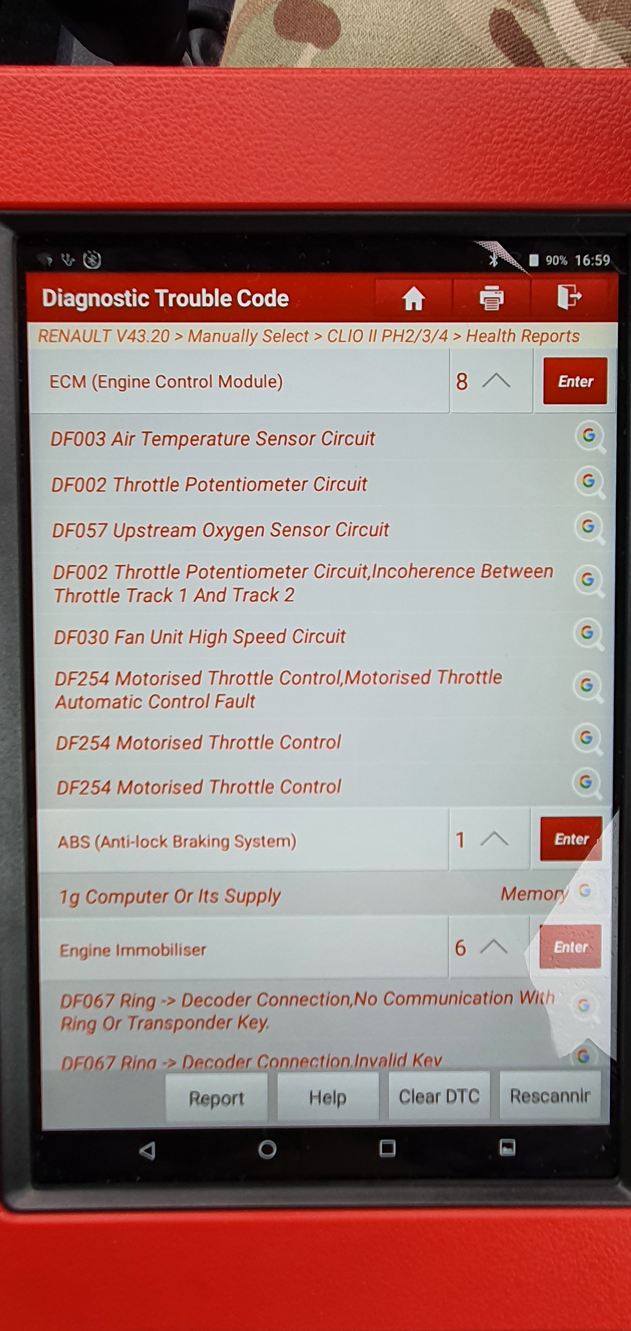

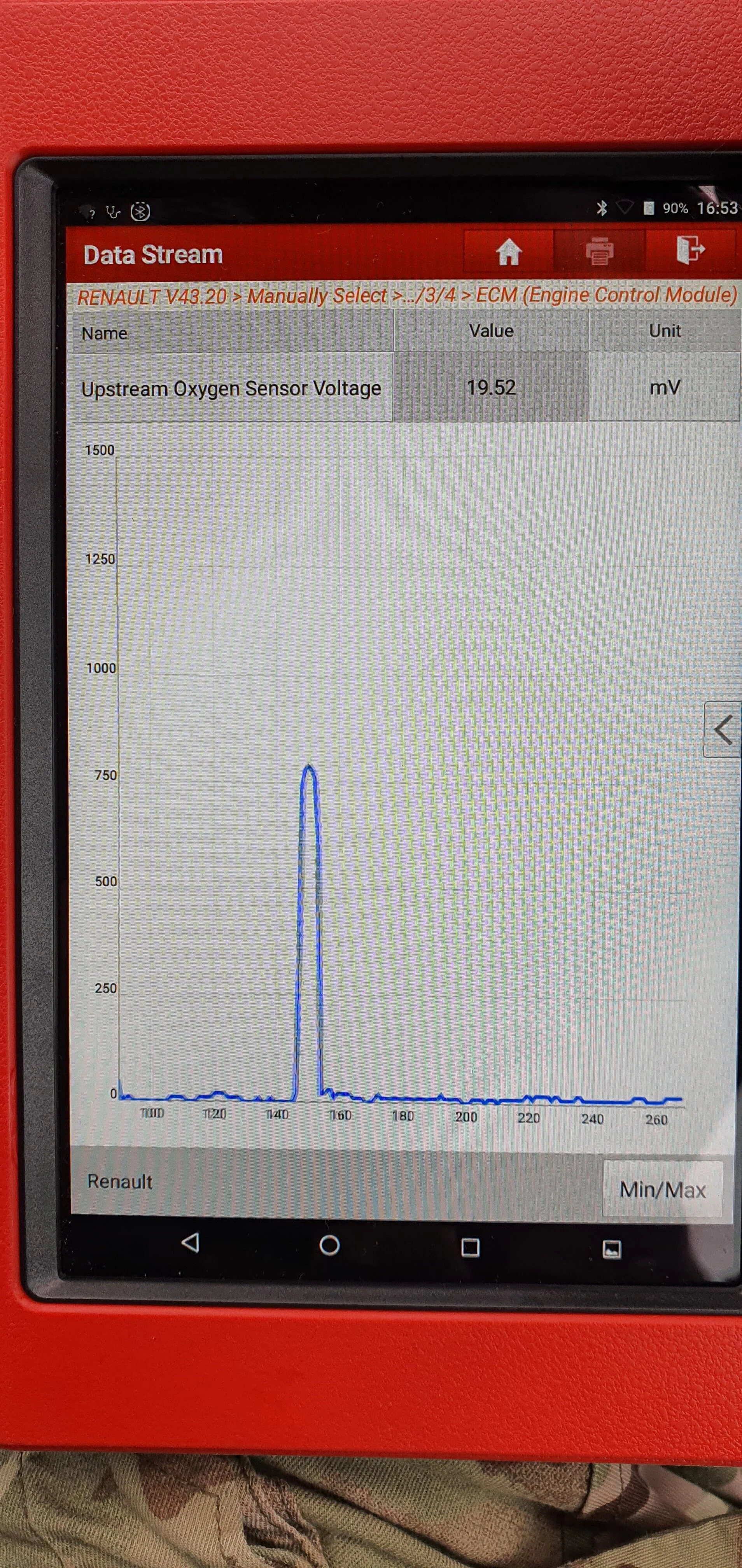

Diagnostics results make interesting reading.
So that looks like both lambda and throttle body issues, as thought.

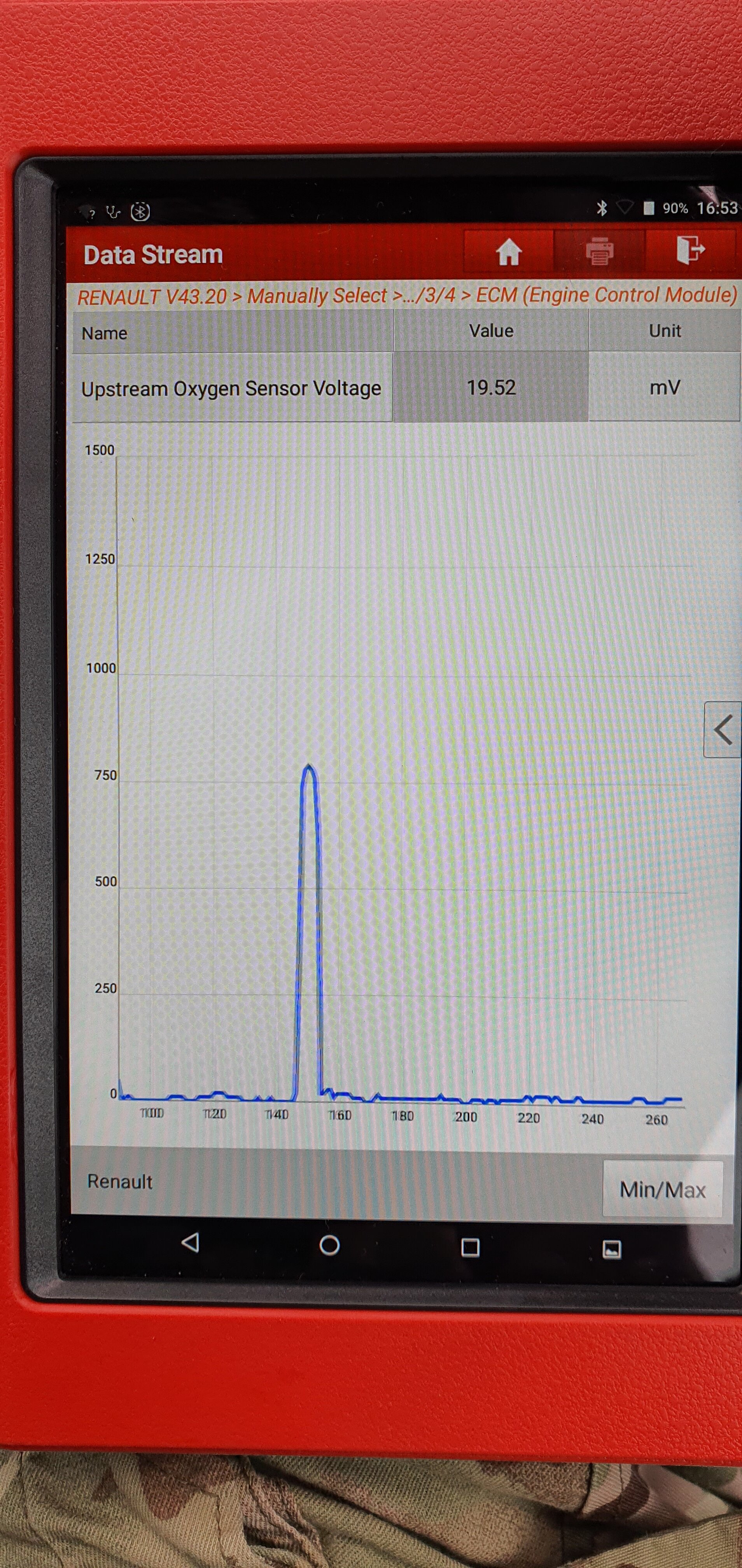

I did record some lambda live streaming too:
Yeah looks like you’ve got enough to keep your hands full there 😂. Is there no-one local who could loan you a working TB for a couple of hours to test it?
Got a TB coming from a clio 200, and two new Bosch lambdas coming from Autodoc.
Oddly the rear lambda wasn't reading at all, though I am wondering if the EFI map has deleted it. Dies say in the blurb that post cat O2 csn be removed 🤷‍♂️

The sensor looks to oscillate properly, but the values seem off - I can't do the conversion to/from mV with my GCSE maths. Can you change the values on the data reader? I'm sure it should range within 1 volt. When warm and could be a lot higher than 1v when on cold start. I think.
