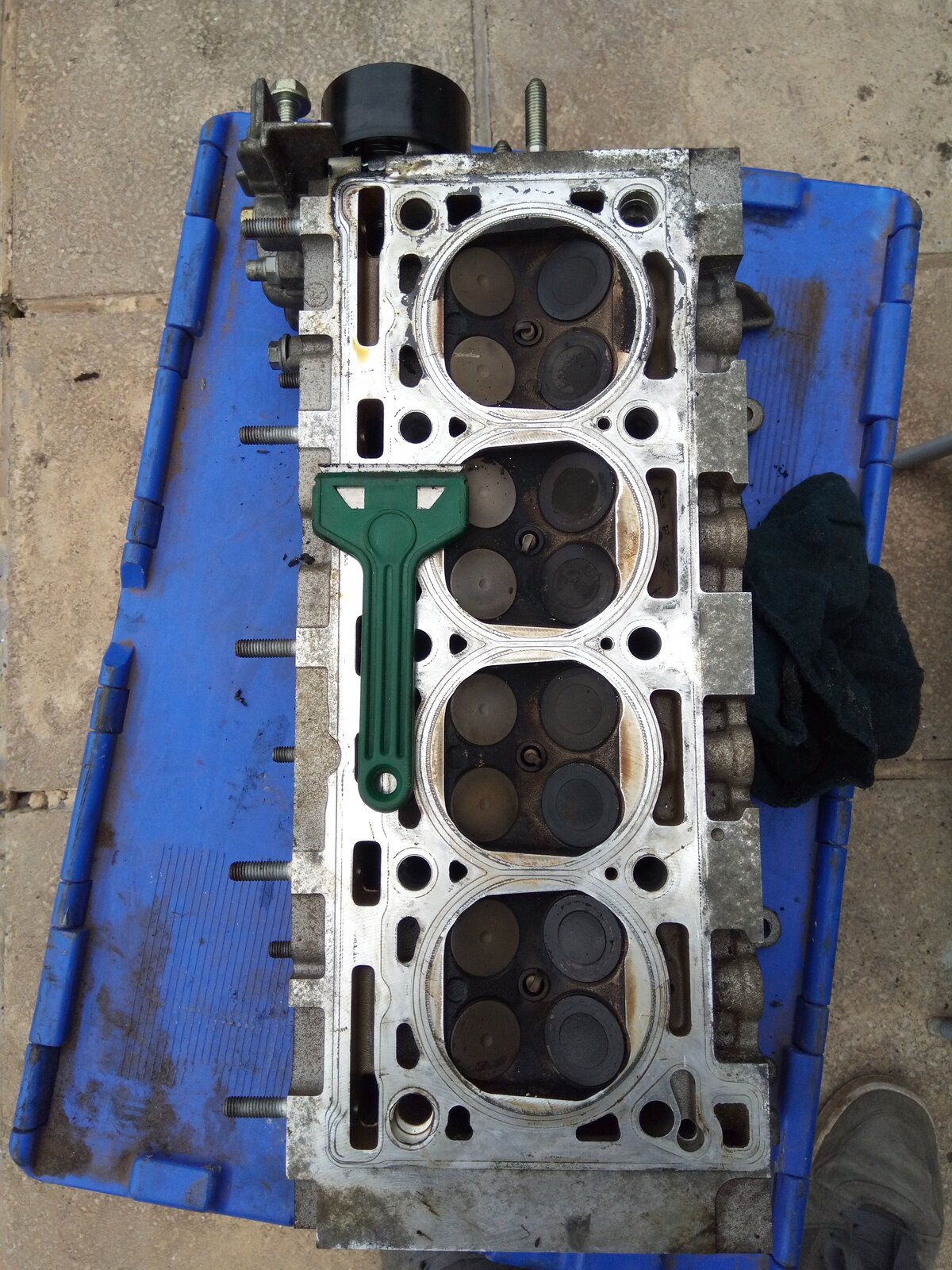

Would have to double check chamber volume but with the 197 head you should be about the same cr as the meg with a standard headgasket.
I'm sure it'll be ok people have run a similar set up to this before and had good results I'll only be running low boost anyway
Will be fine with that set up but with standard gasket you'd find it will be more responsive. Meg gasket drops compression by almost 0.5 ish fwir.

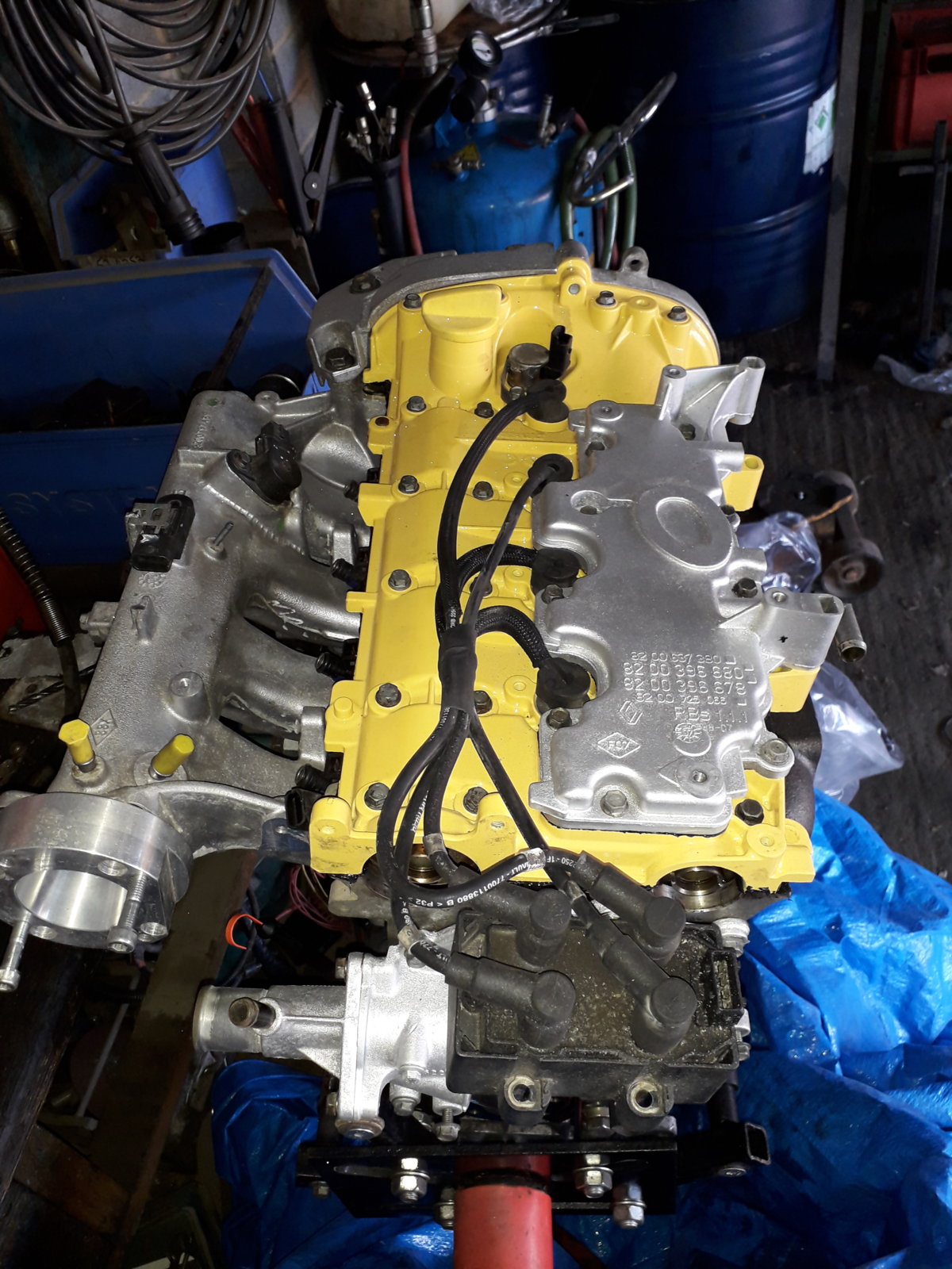

It's having my own concoction of random renault parts that should leave me with a pretty strong engine able to do 250 bhp +

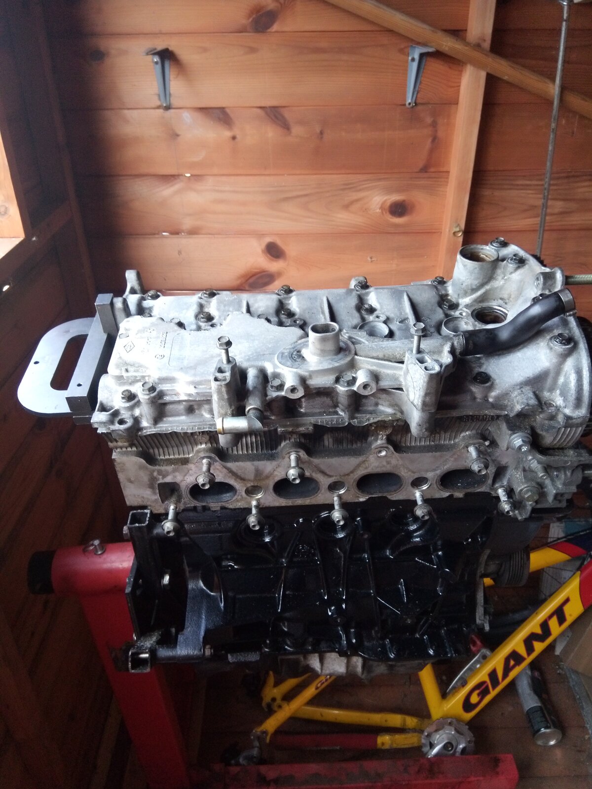

Low mileage 172 ph1 bottom end
225 head gasket

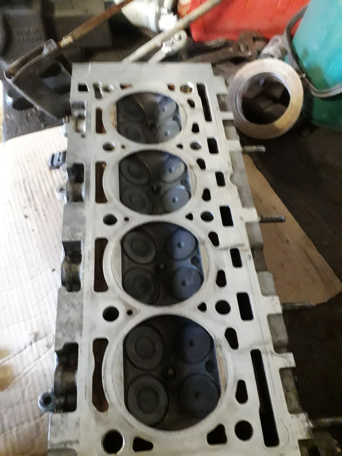

Low mileage 197 head
172 cams
250 inlet
172 ph1 throttle body
225 injectors
250 fuel rail
WTF
Are they actually all interchangeable / mix-and-match-able??!
That shell looks so good, though. I want.

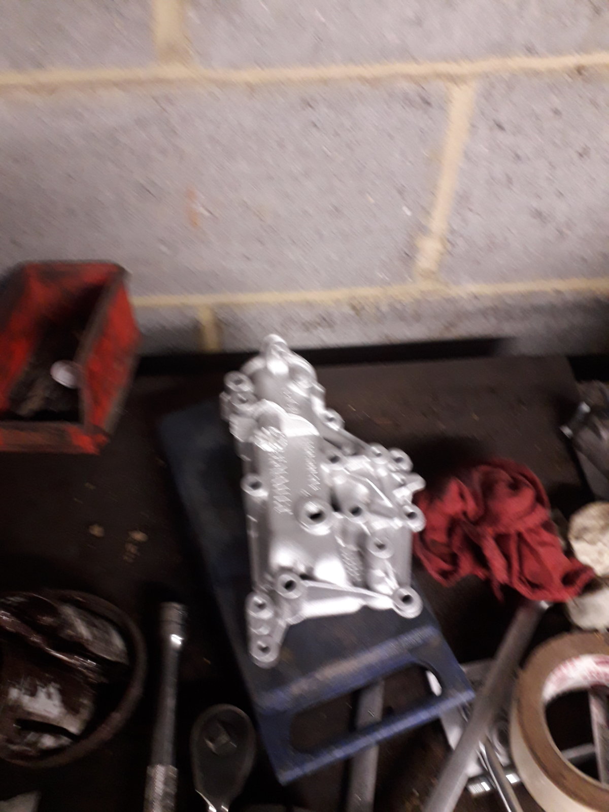

250 inlet looks pretty smart even if it does precious little other than help it clear the bonnet

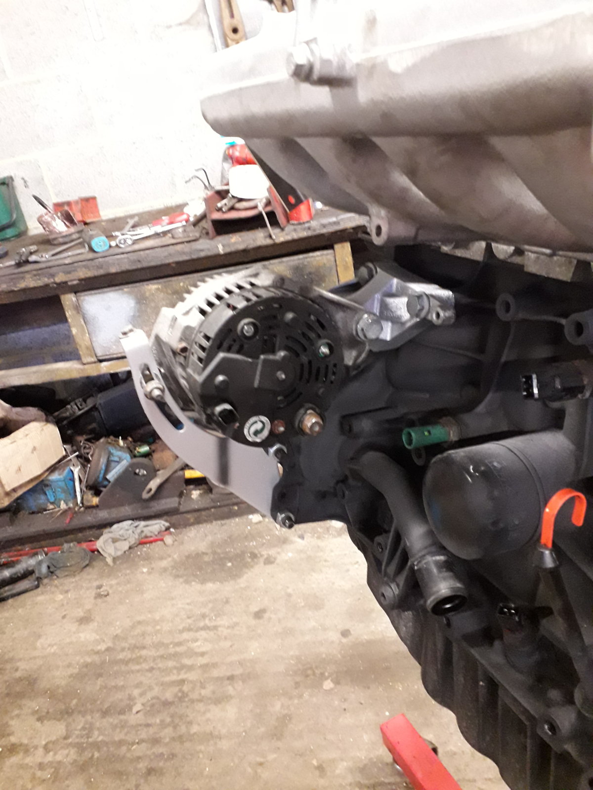

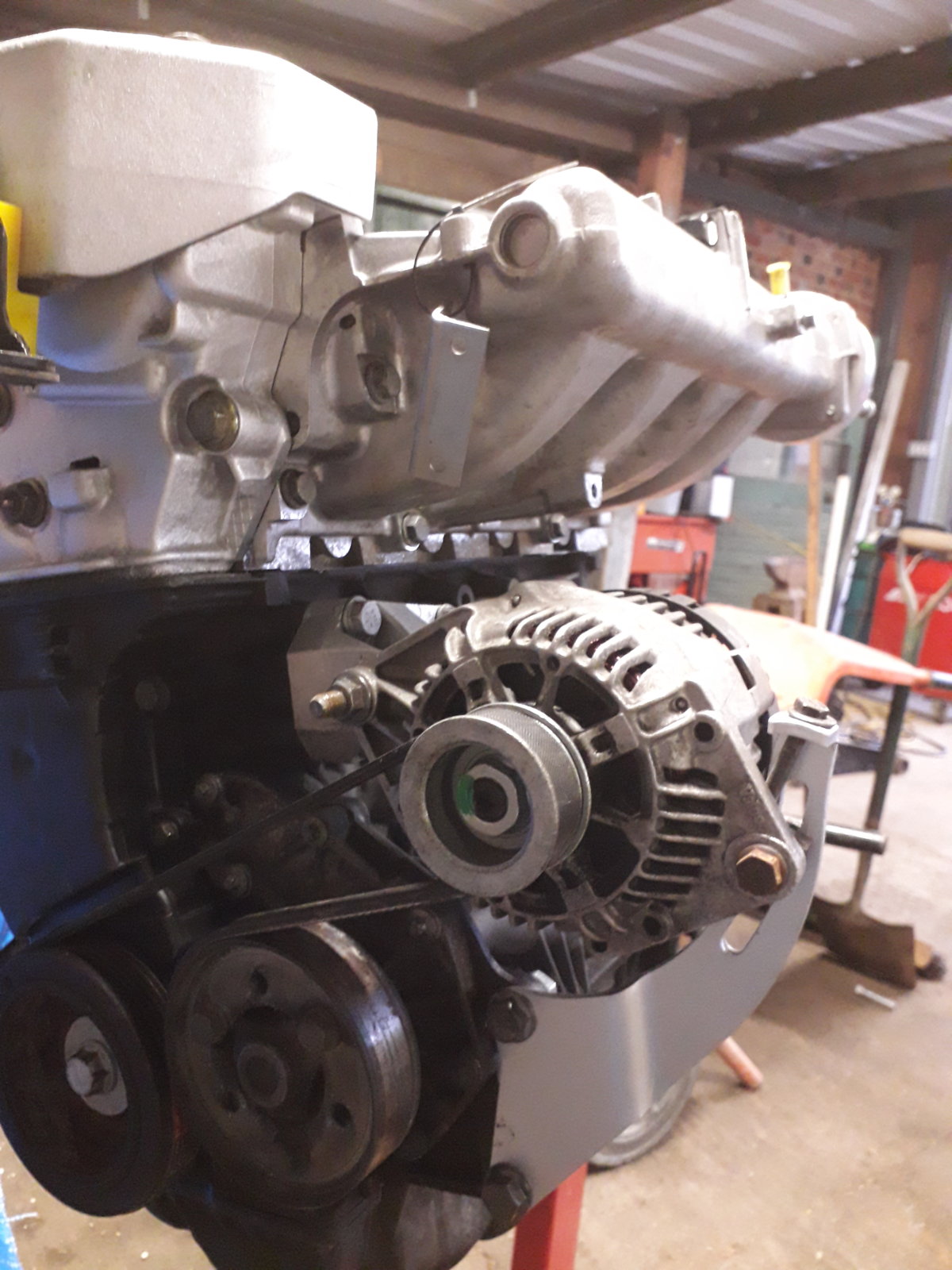

The Volvo non power steering tensioner cup mount and cup alternator with a 5 rib belt I think simplifies and neatens the engine up a lot

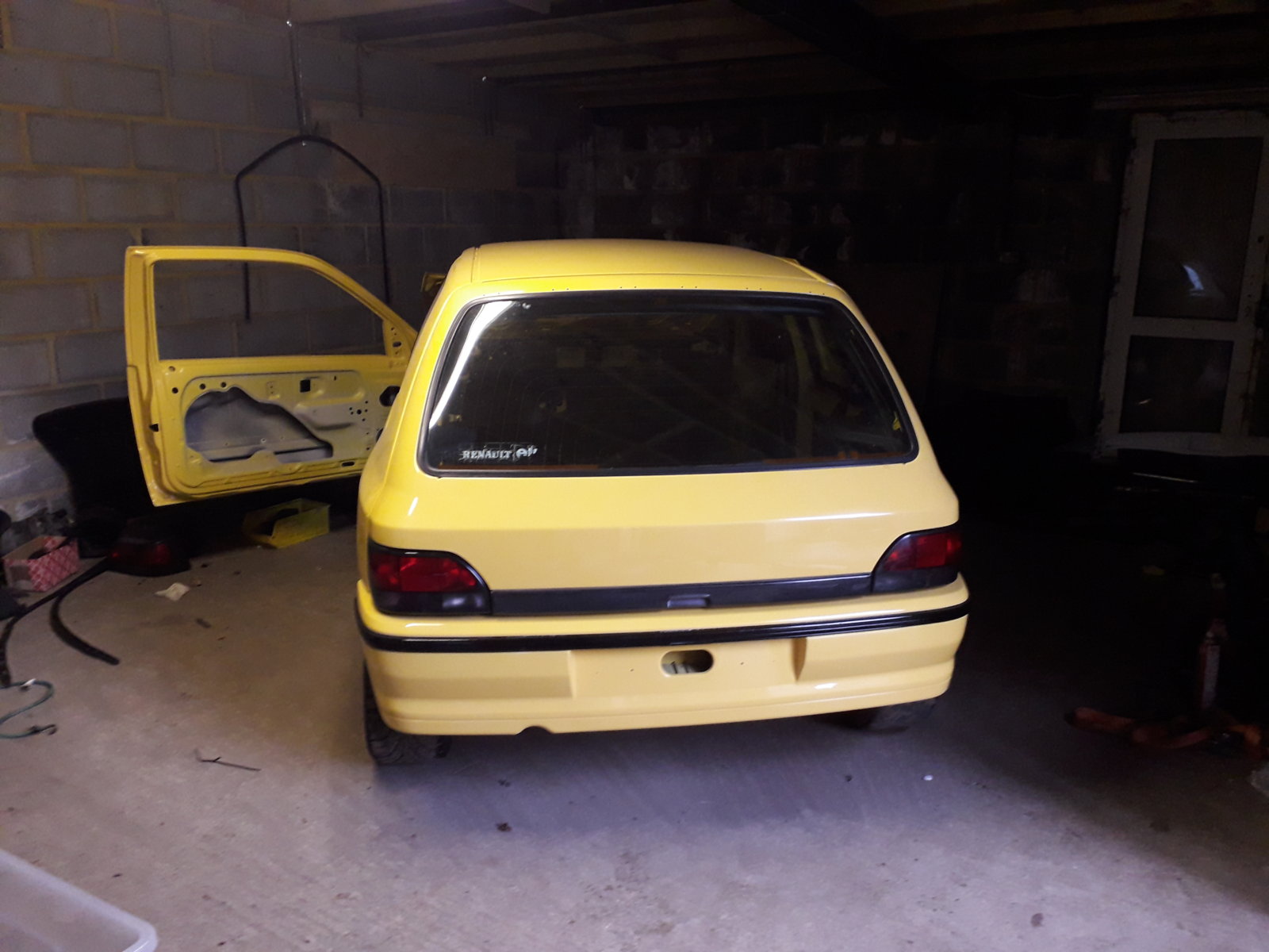

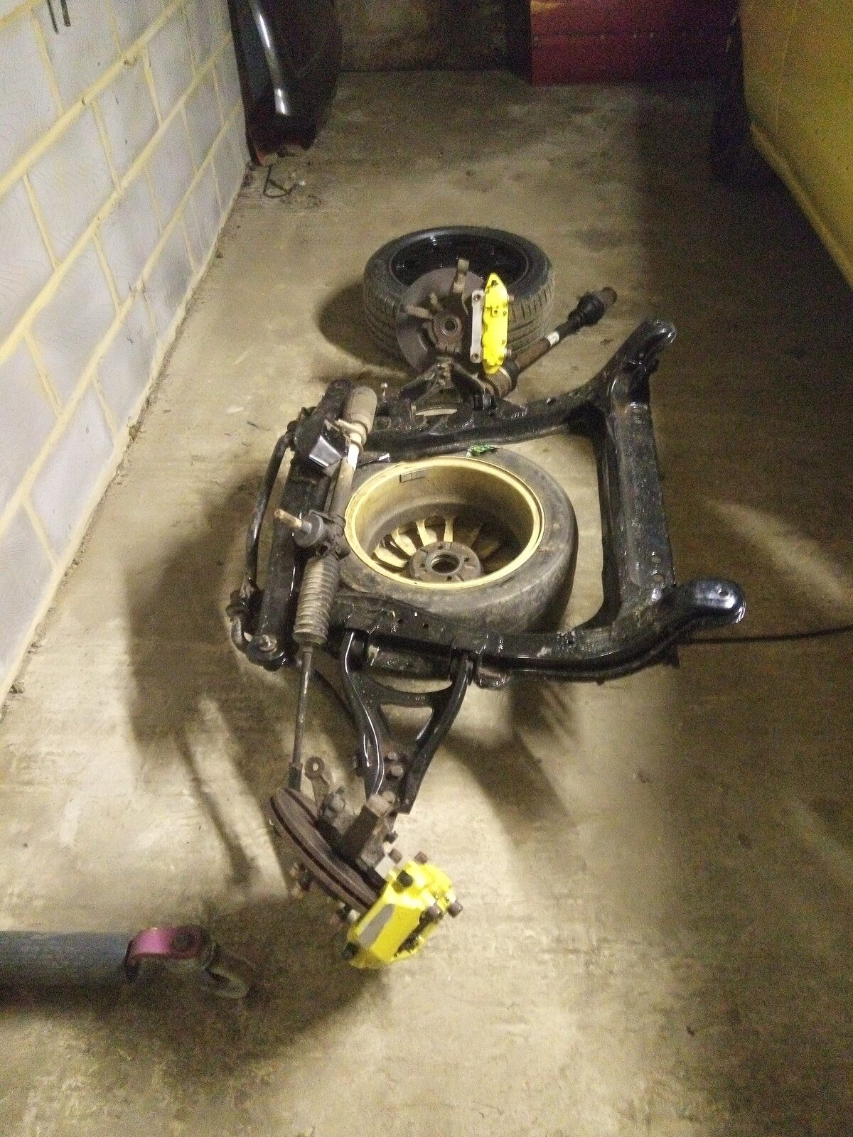

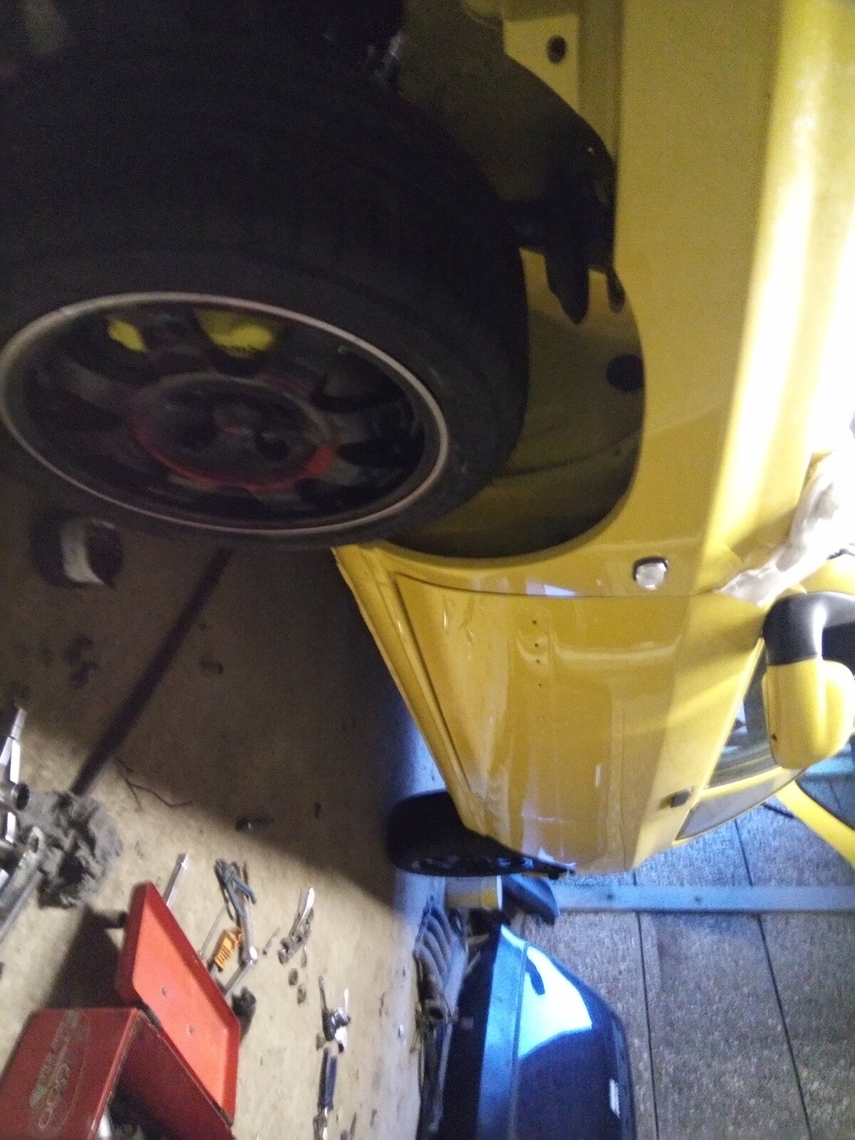

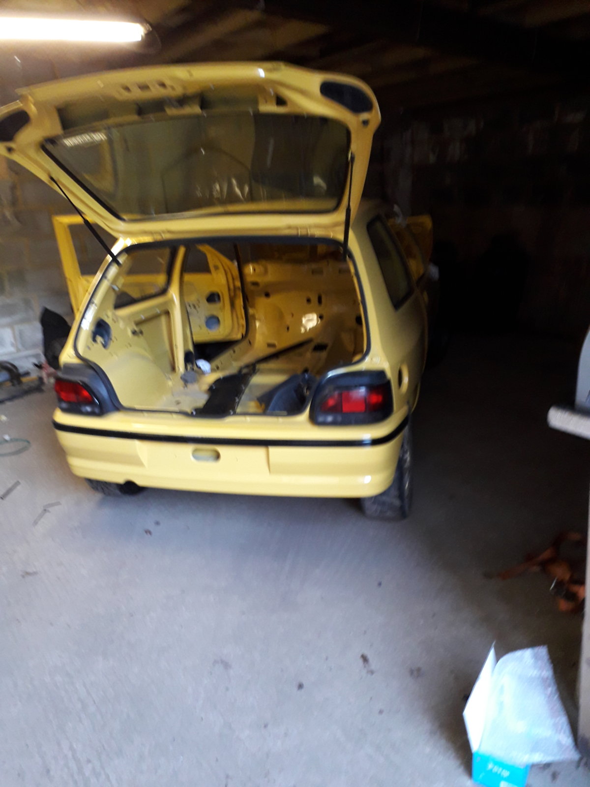

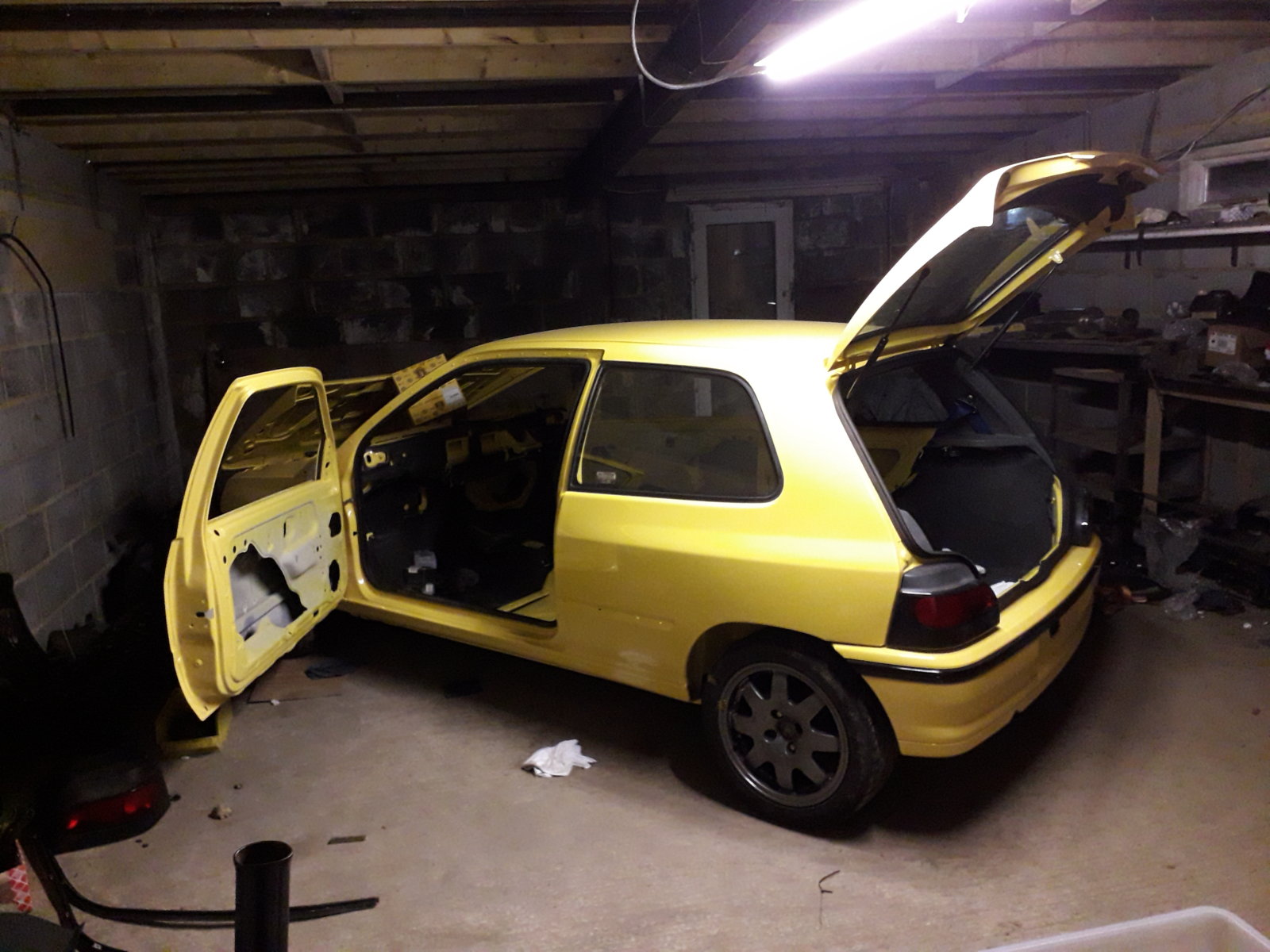

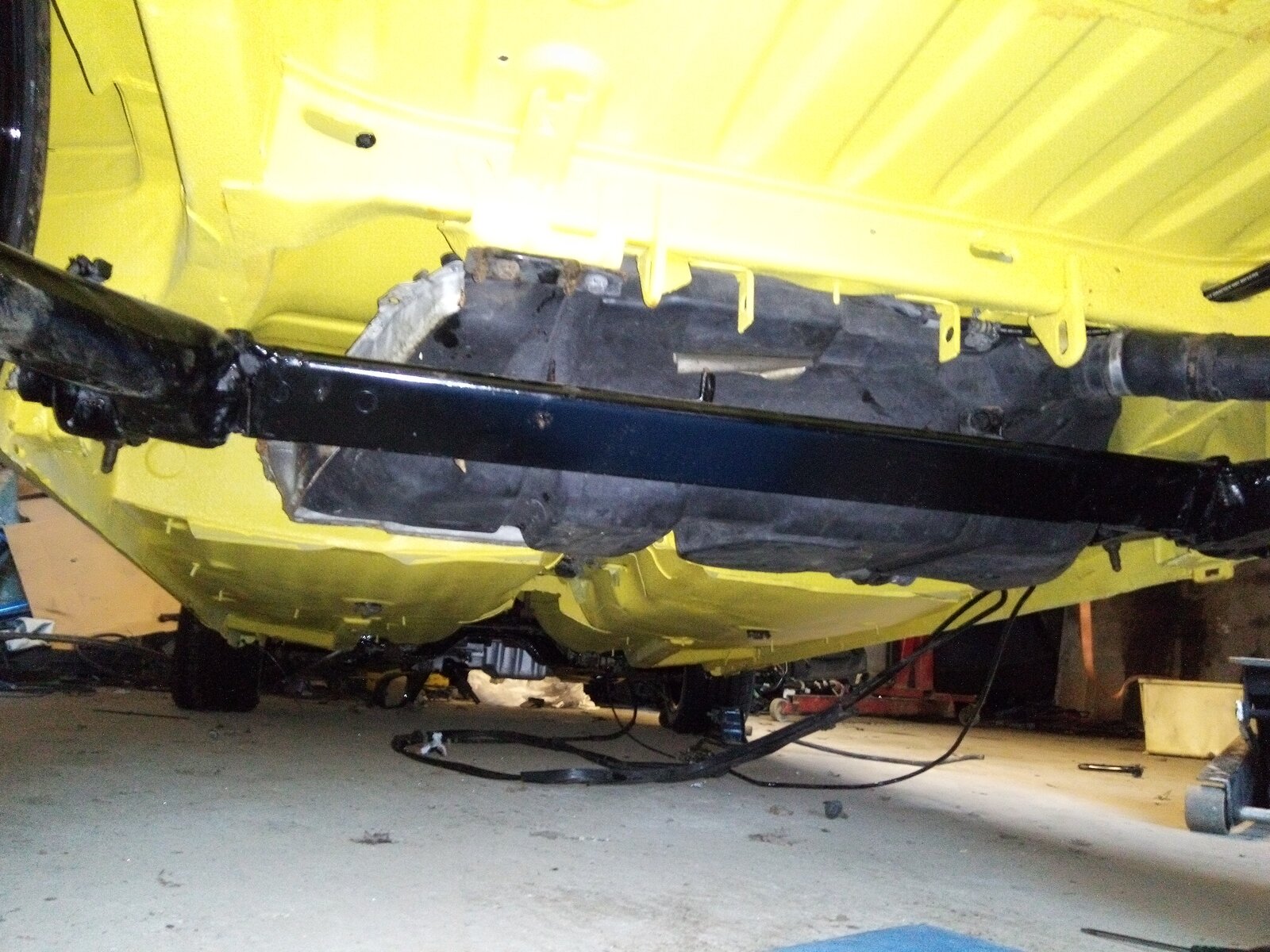

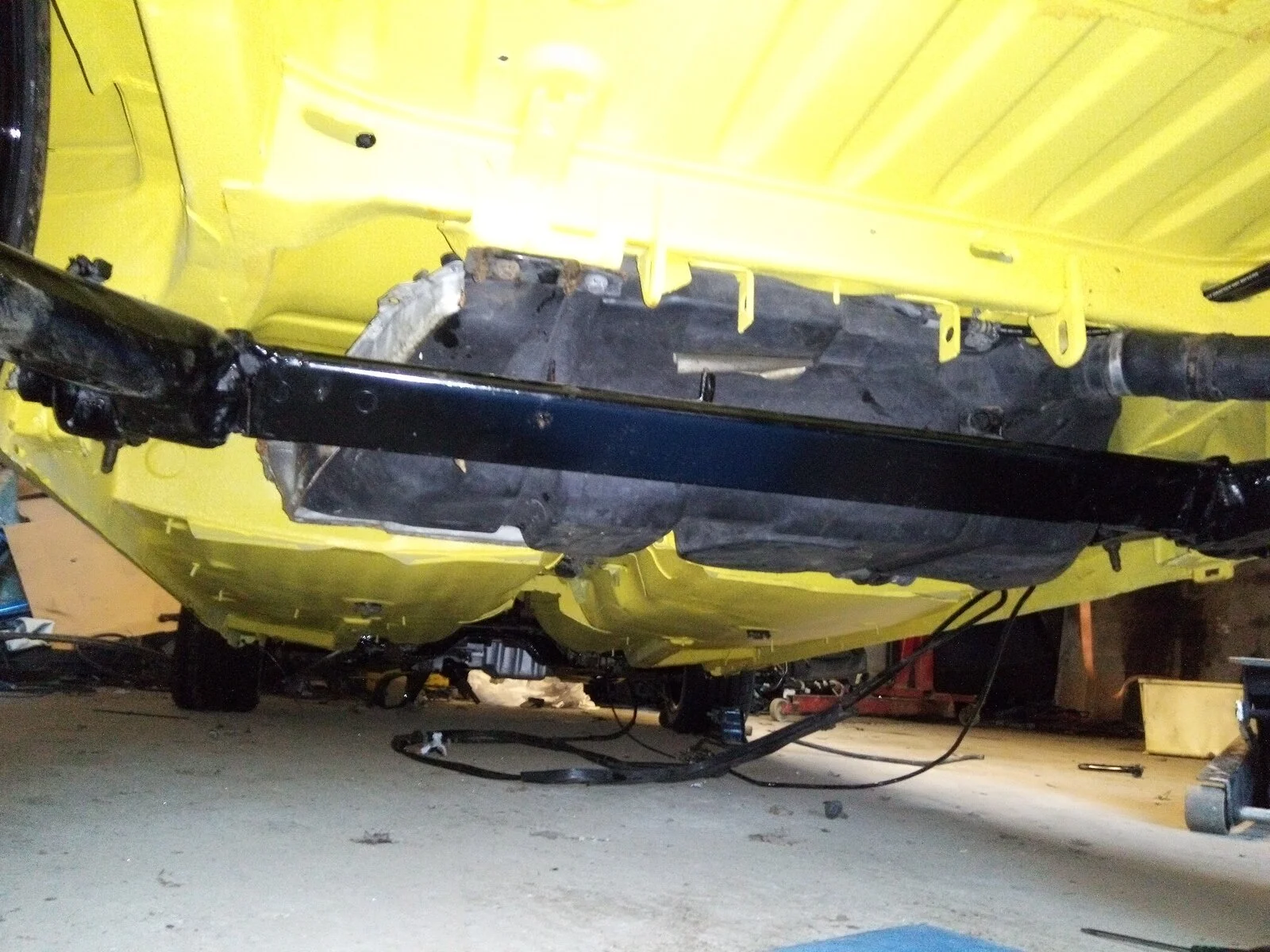

sorry there hasnt been many updates i managed to run over my smart phone with the lorry so lost all the pictures but its now full of interior and now has a seam welded subframe and modified to suit the 172 rad i have been slightly ditracted recently by my other project but now ill be giving the yellow car my undivided attention

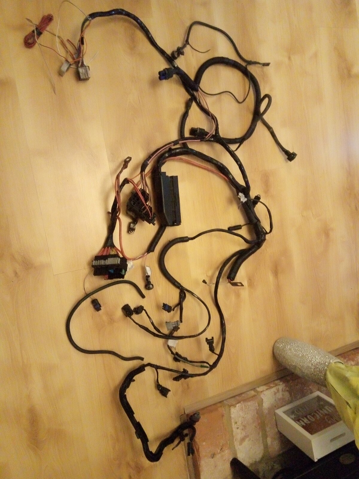

As far as the turbo conversion goes I'm going to get another shell fit the turbo engine get a exhaust system made boost pipes made finish the omex loom get the conversion just right before swapping it all into the yellow car without it being off the road too long

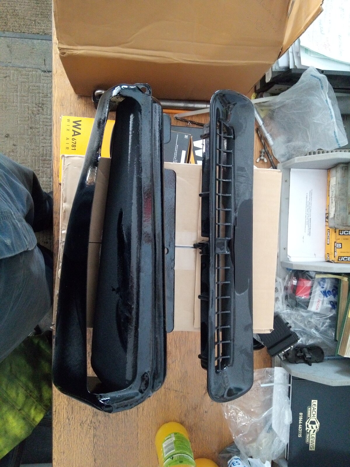

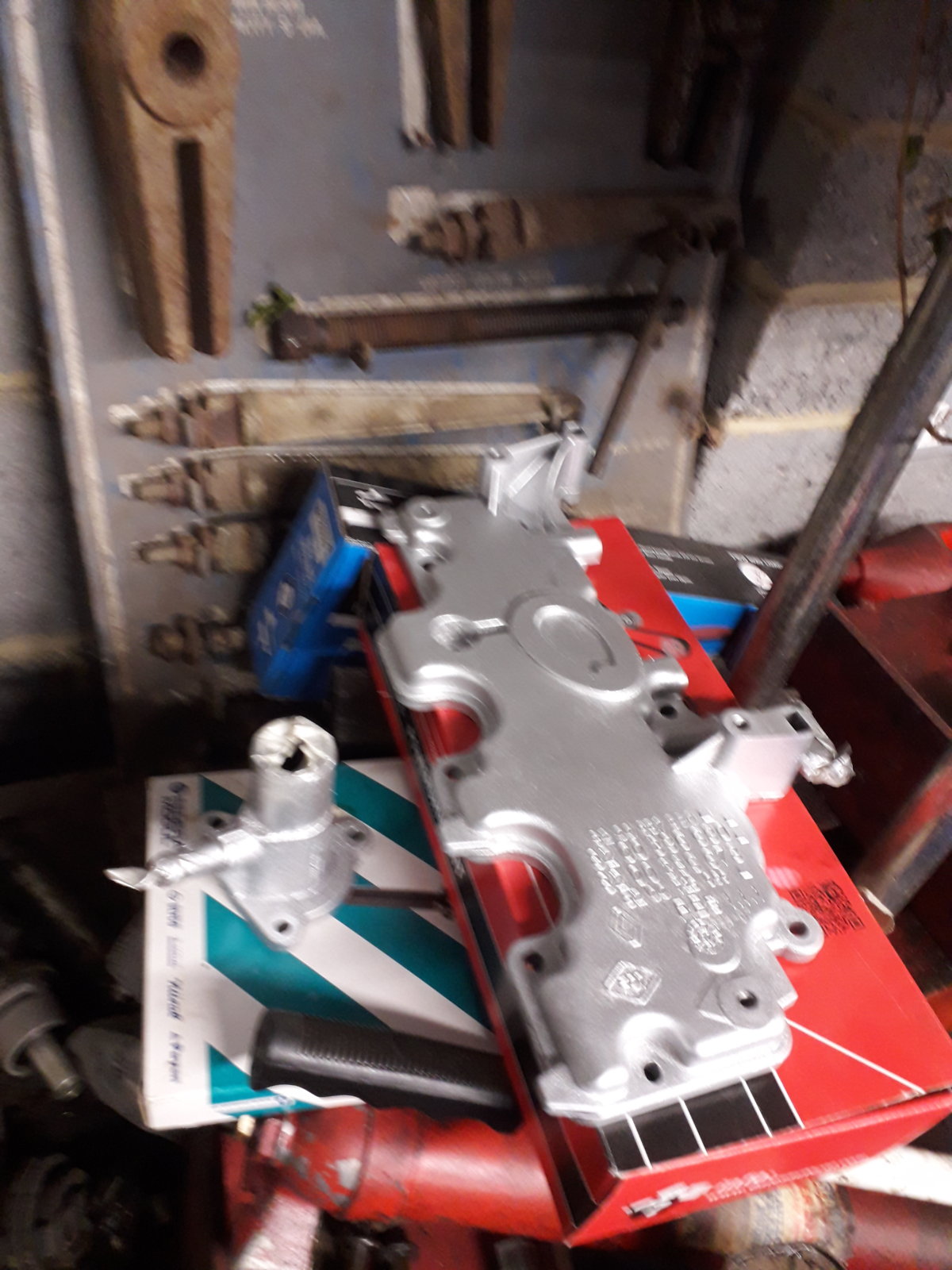

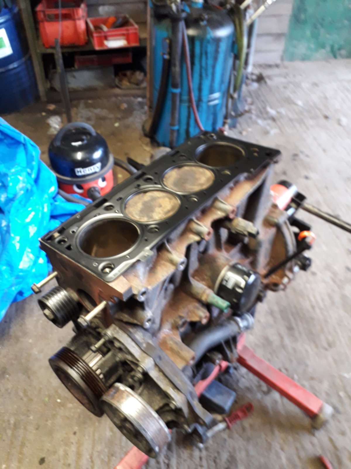

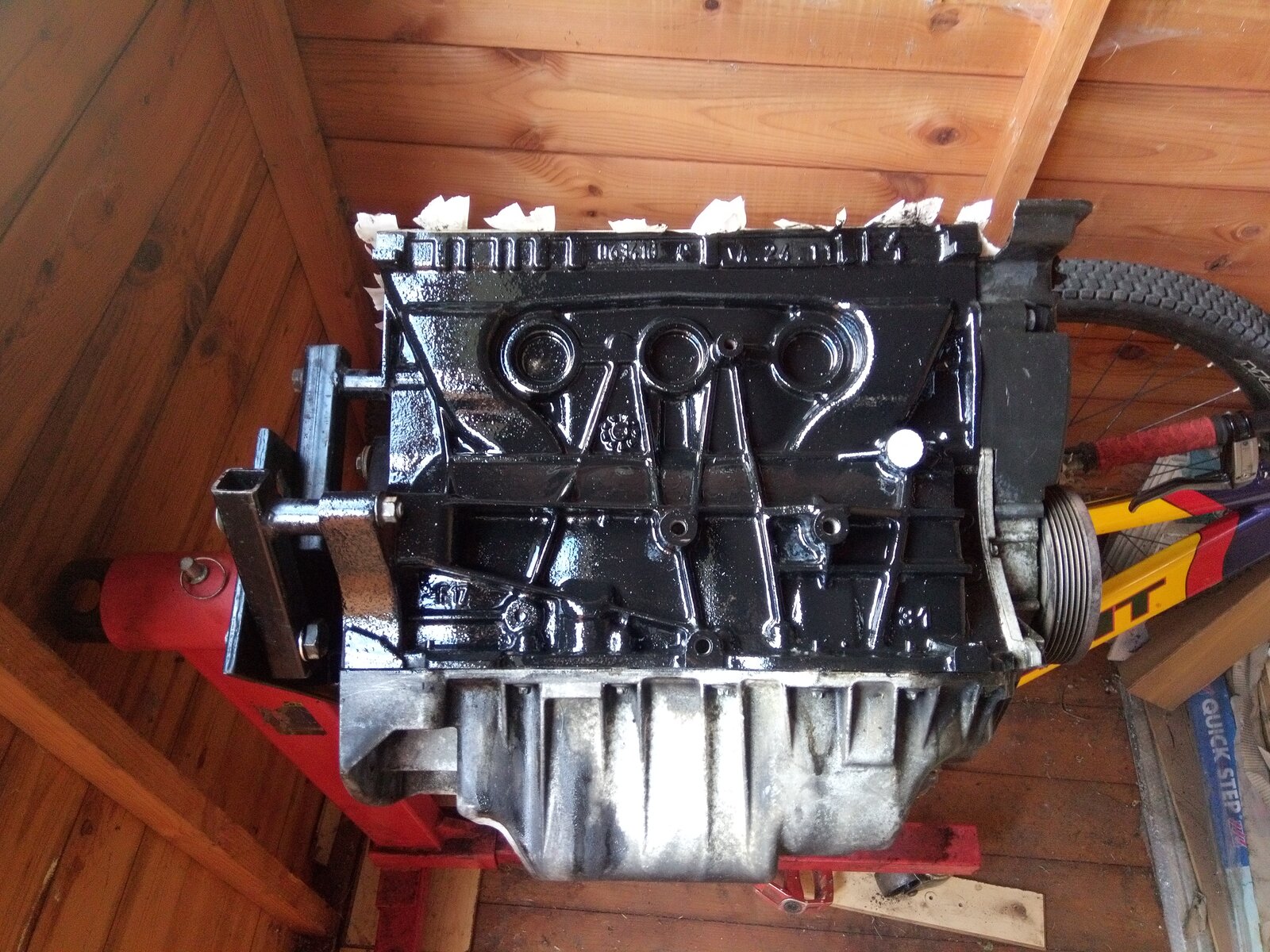

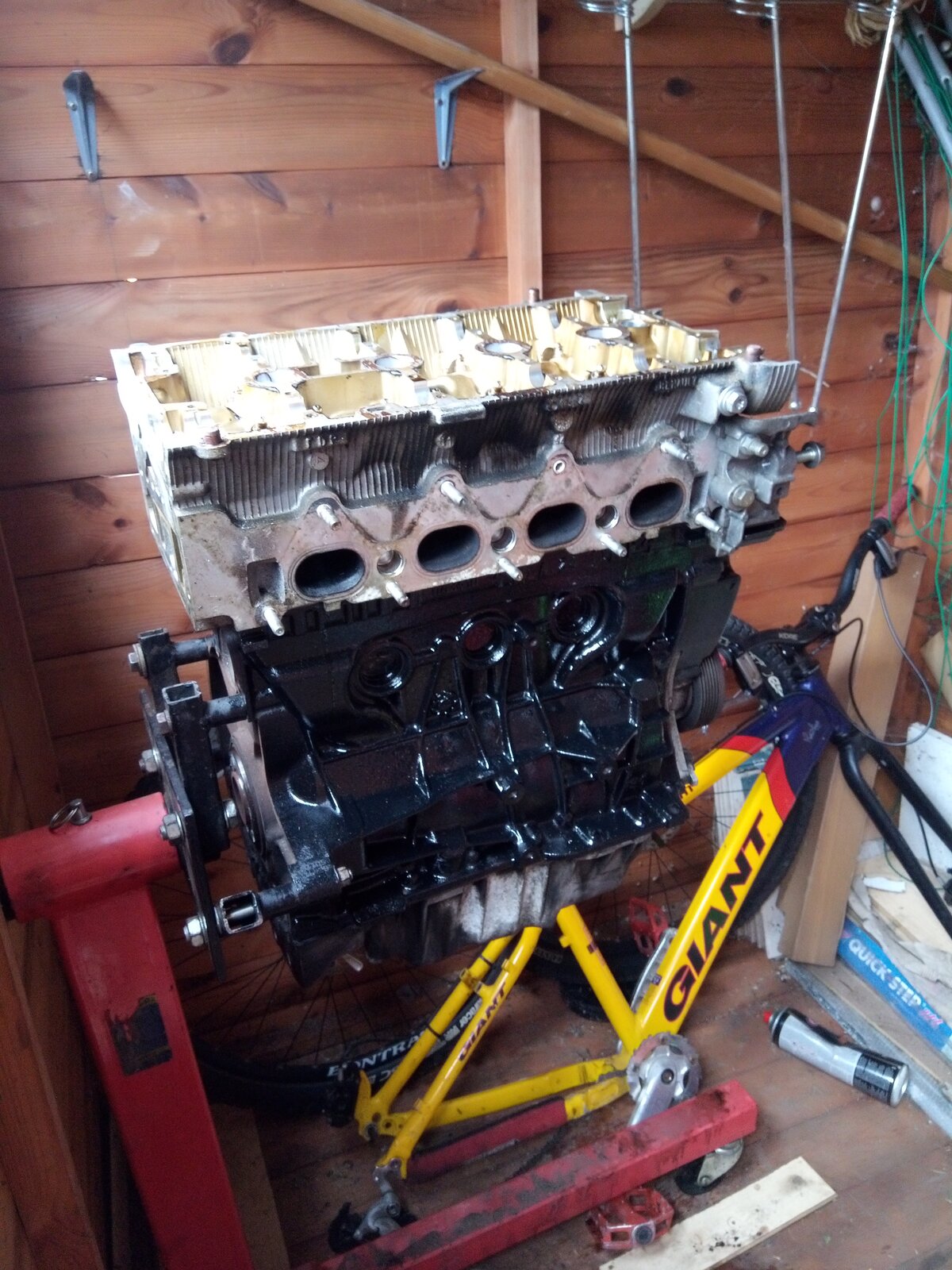

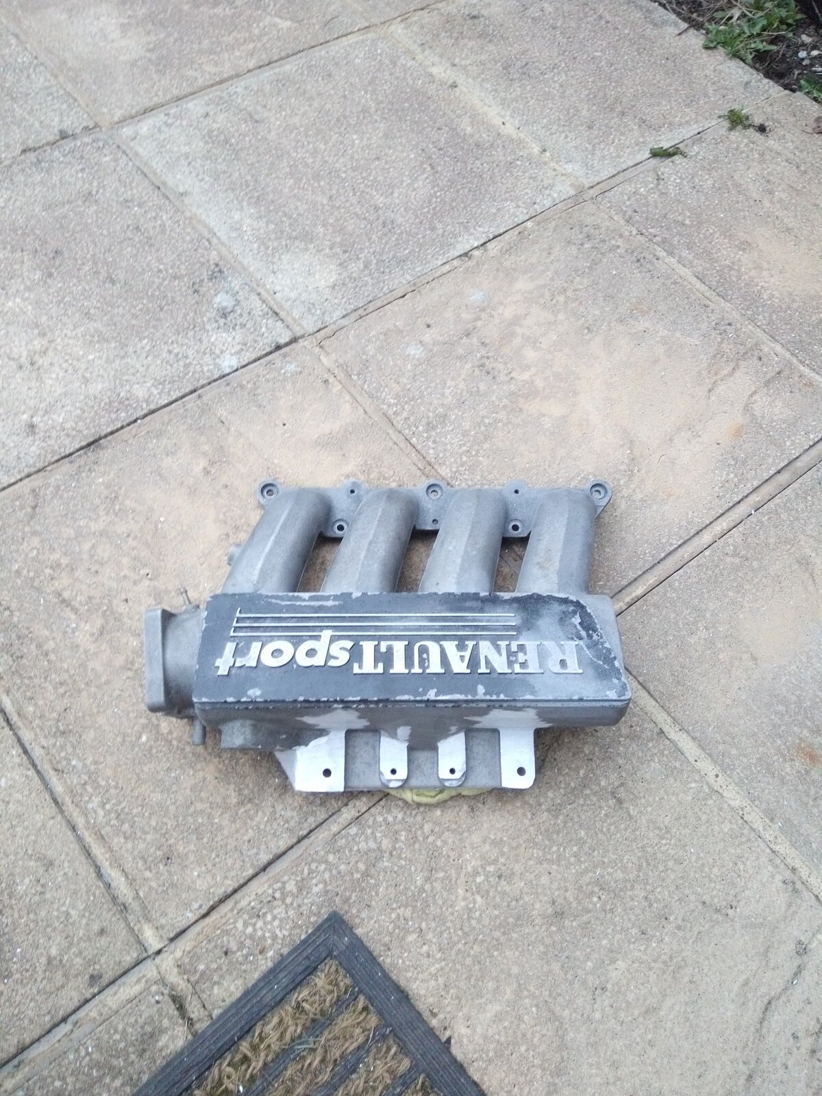

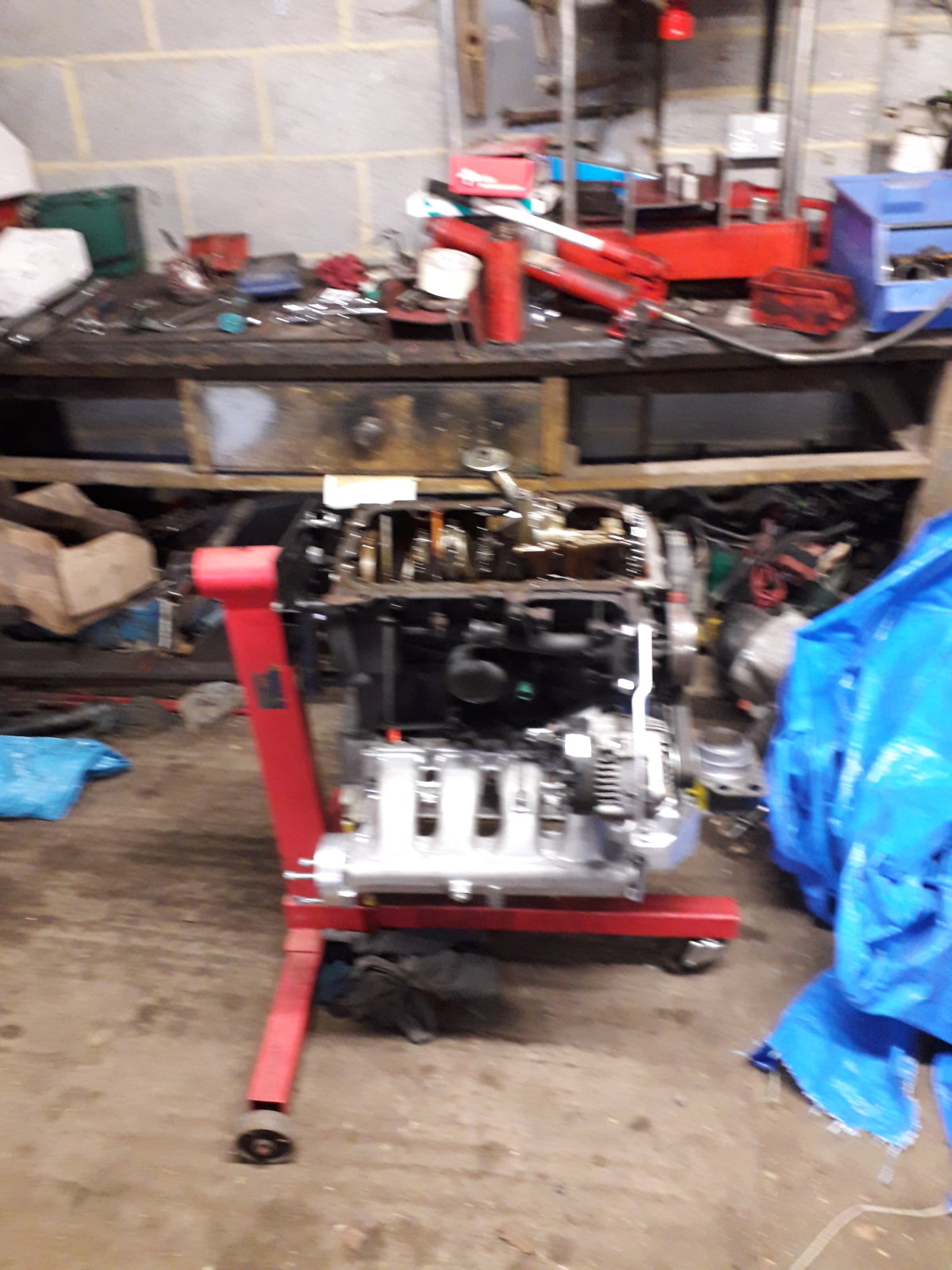

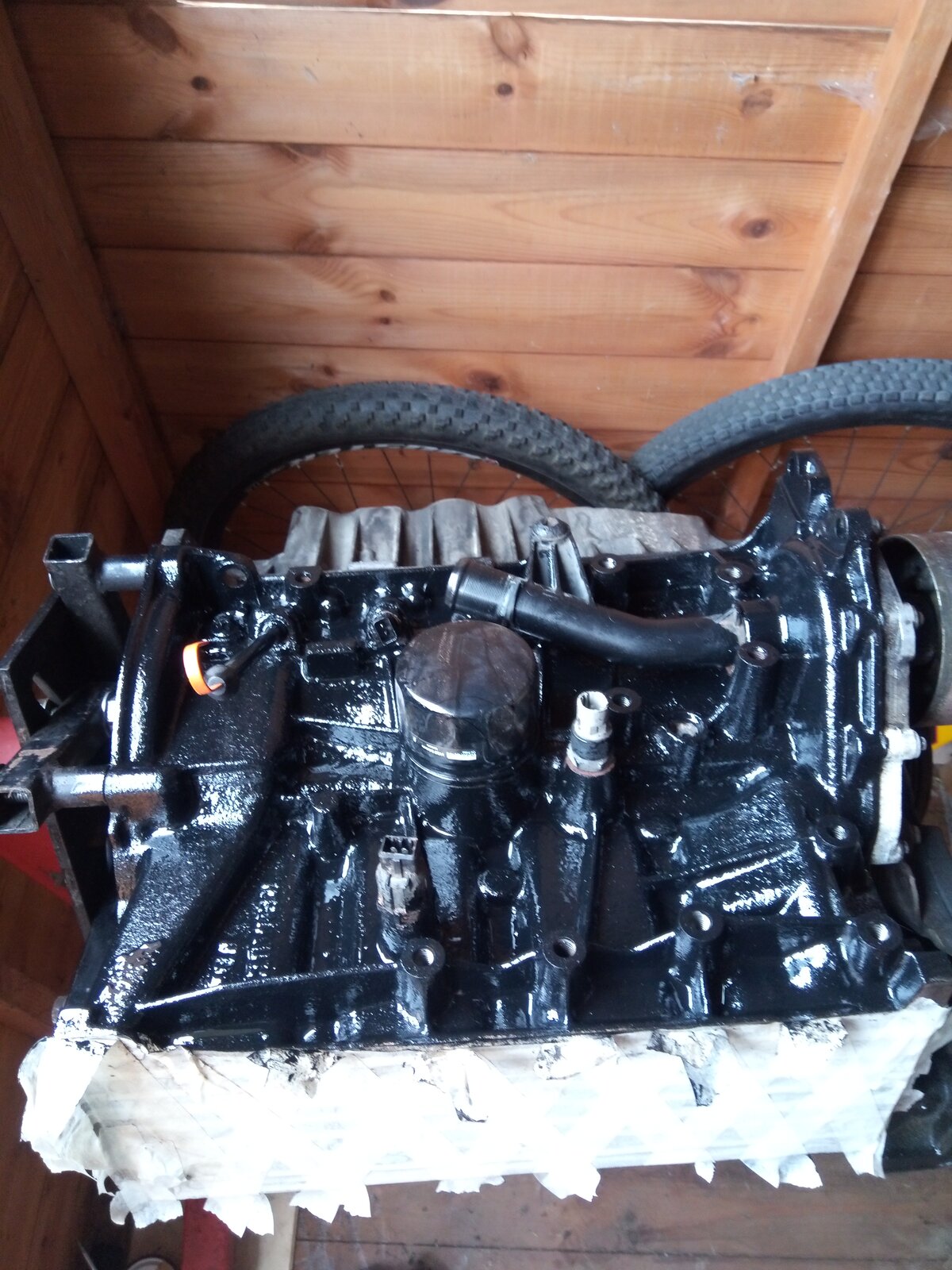

Only a little progress today cleaned off my block for a kick of paint and modified my inlet to remove the coil pack holder hopefully this will clear the rain catcher witch I'm adamant I want to keep

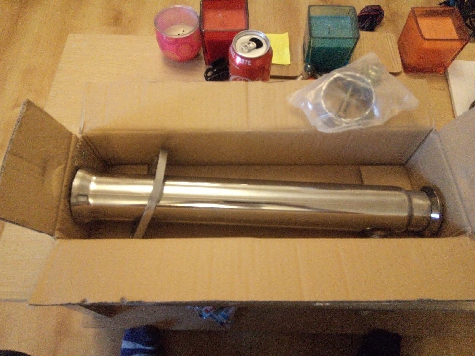

Few bits have arrived today most important was the decat

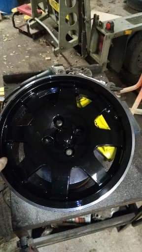

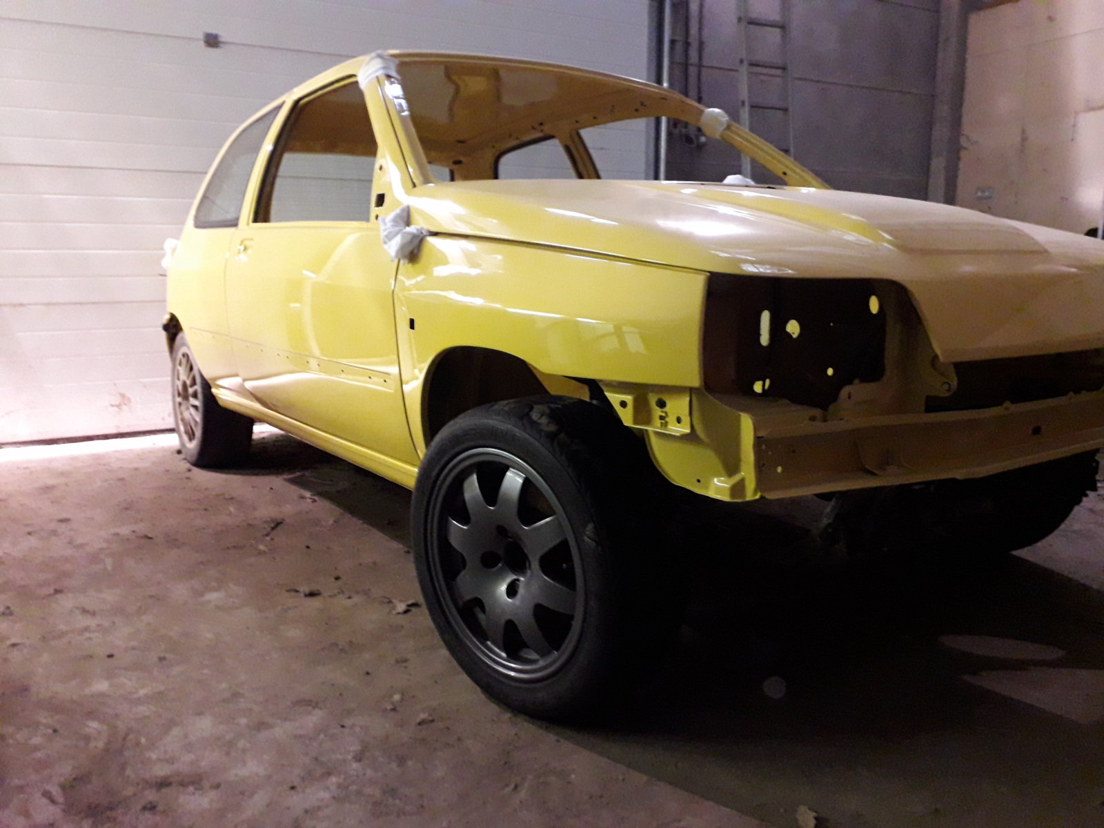

Few bits I missed out I sold the grey Williams wheels I had when a black set came up that I had to have black was always the plan anyway

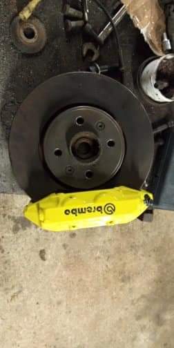

A set of 225 calipers came up cheap in yellow too so I snapped them up

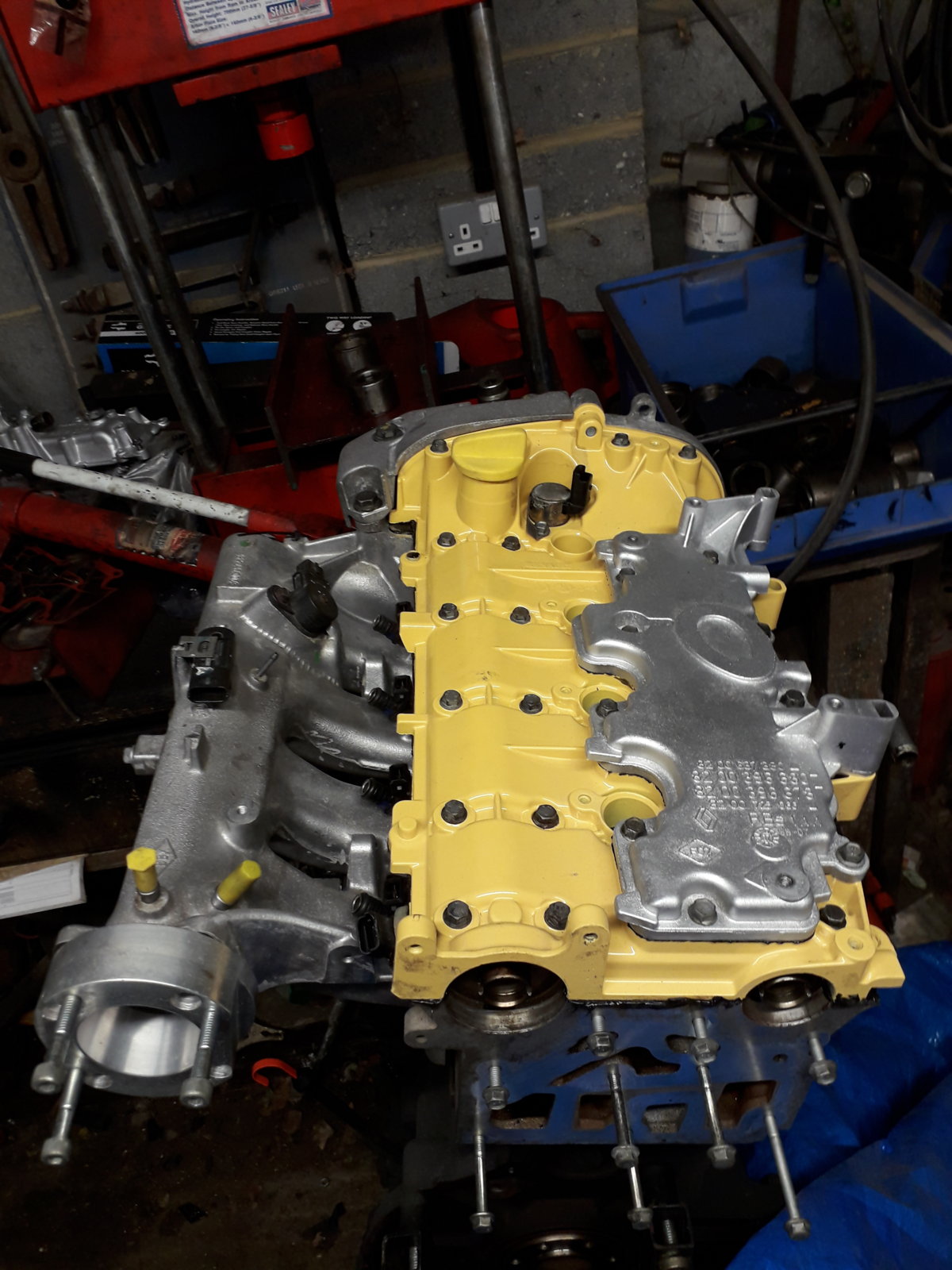

Sent my inlets off this morning for paint

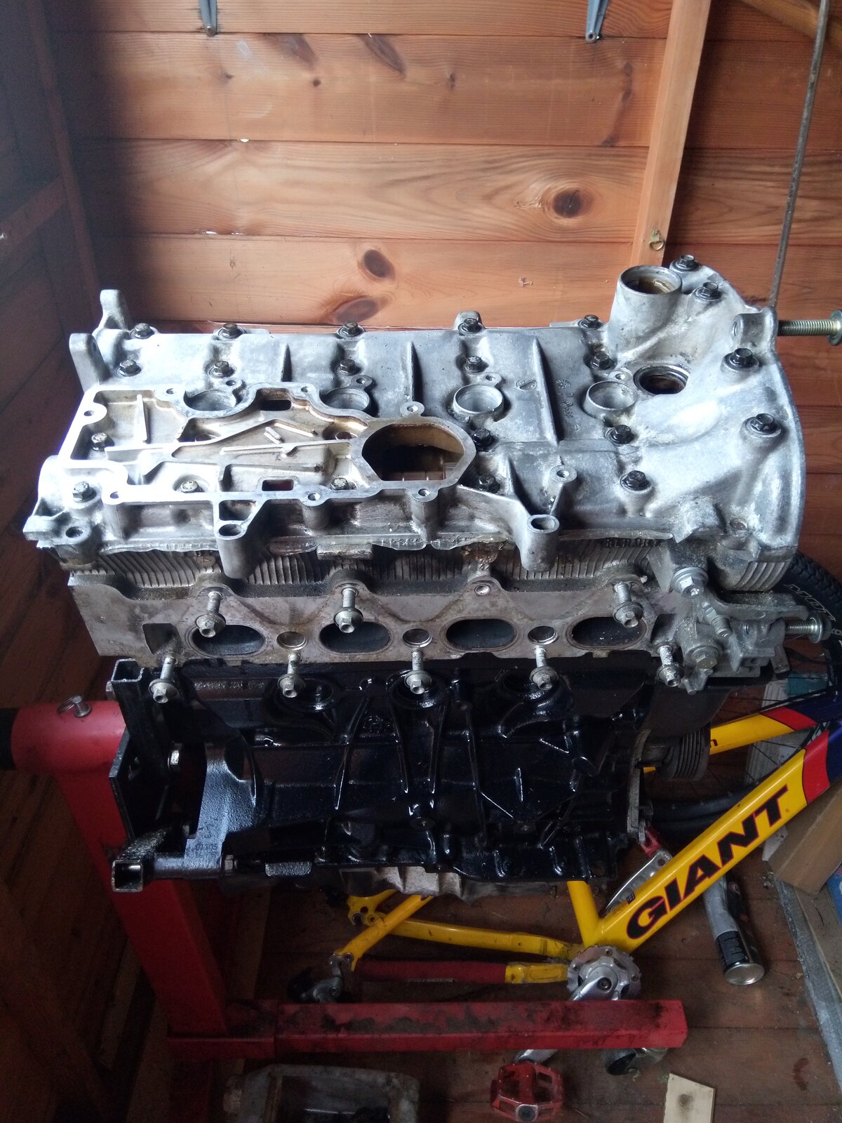

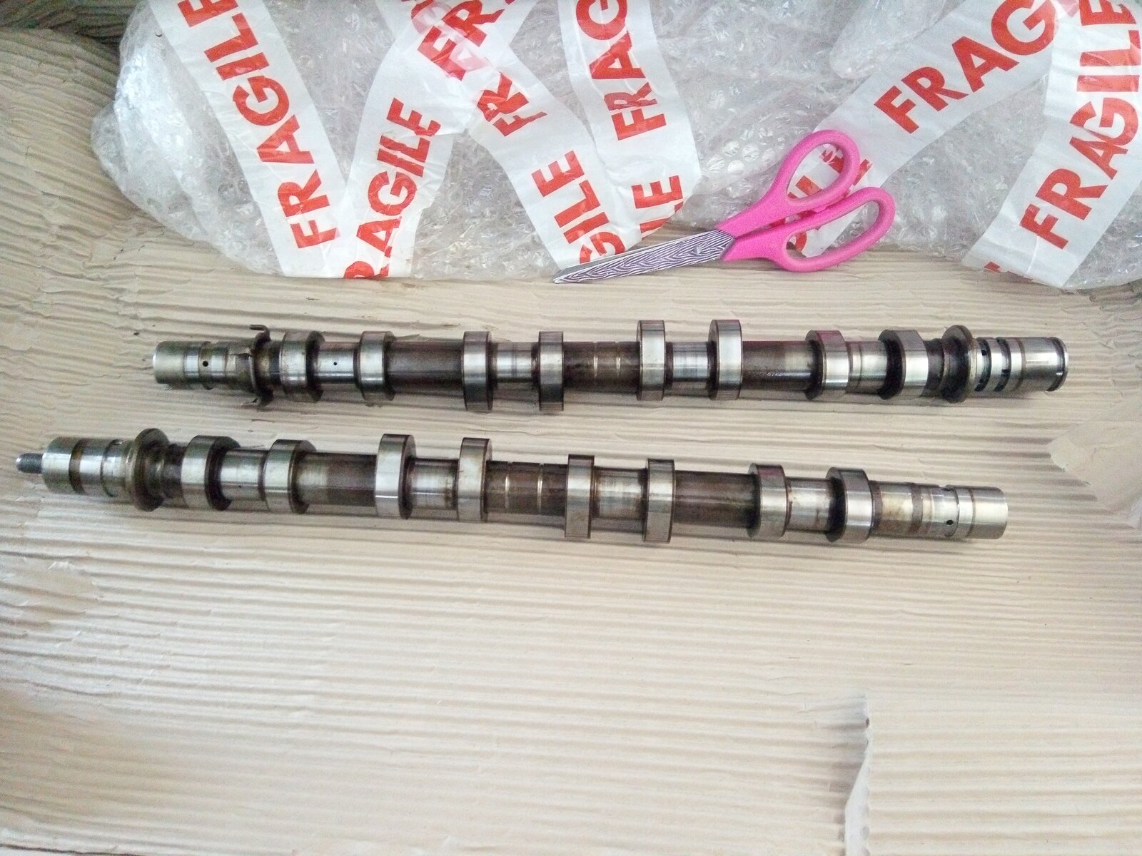

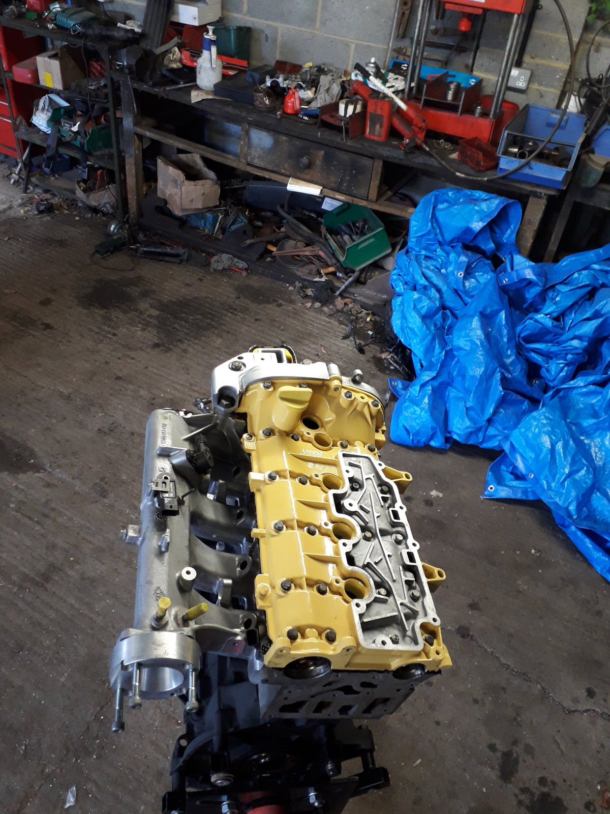

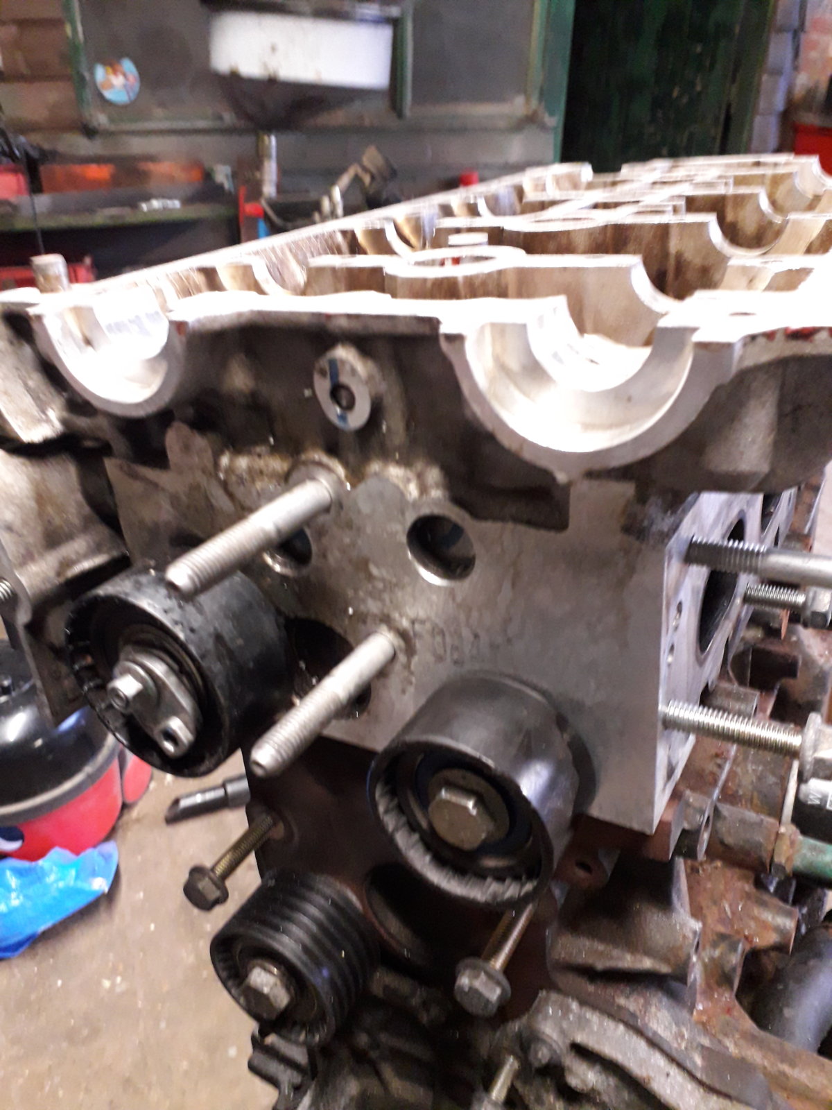

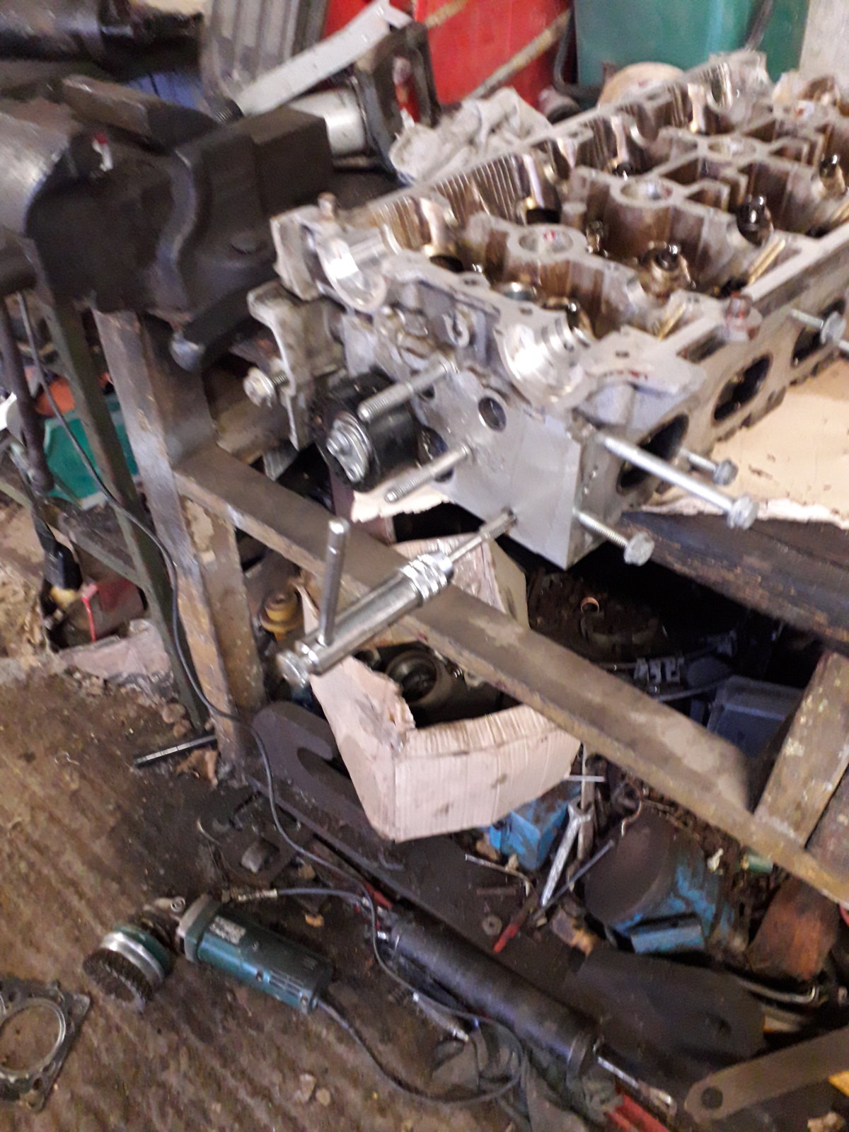

Got round to fitting my 197 cams today got another engine to nick the rockers and all the bolts out of as I've lost loads of stuff doh just waiting for the advanced timing tool to turn up and I'll be nearly finished

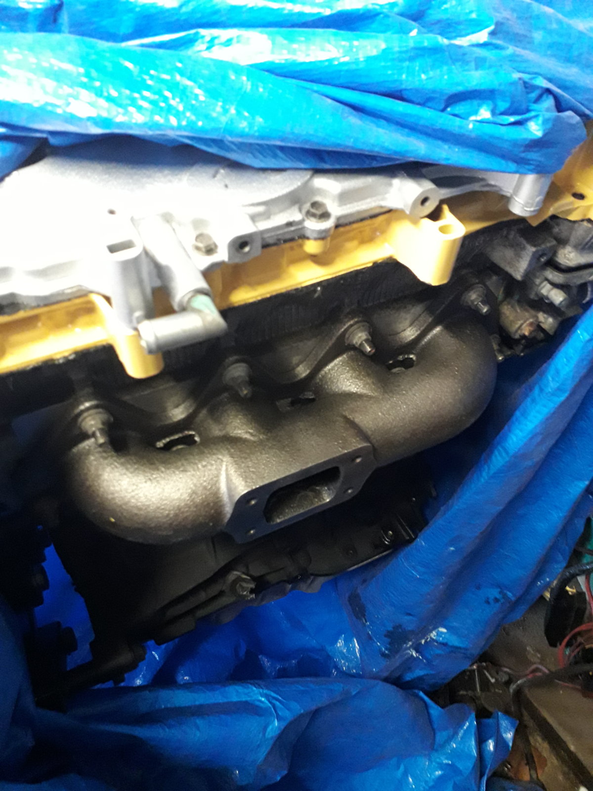

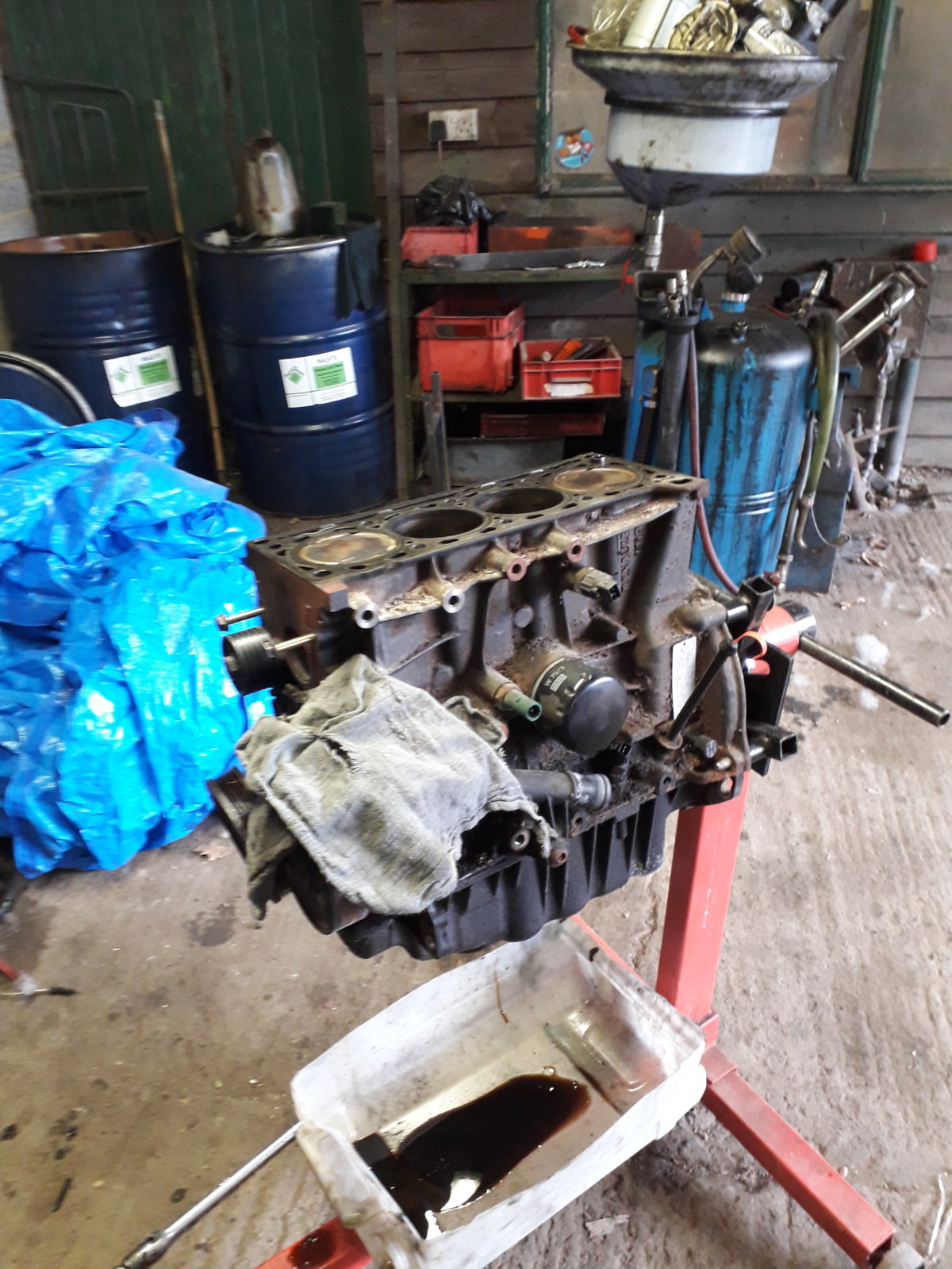

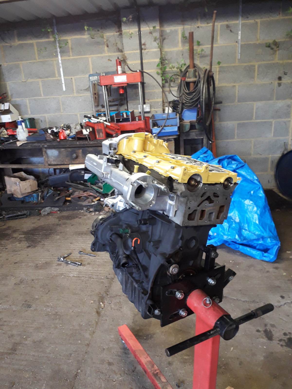

Found some time today to remove the boosted engine from the bay and take off a few bits I need like coil pack alternator setup clutch just waiting for a few gaskets and a mount to be delivered
In the mean time I replaced the cambelt with 8 degrees advance on the inlet cam got all the covers back on
