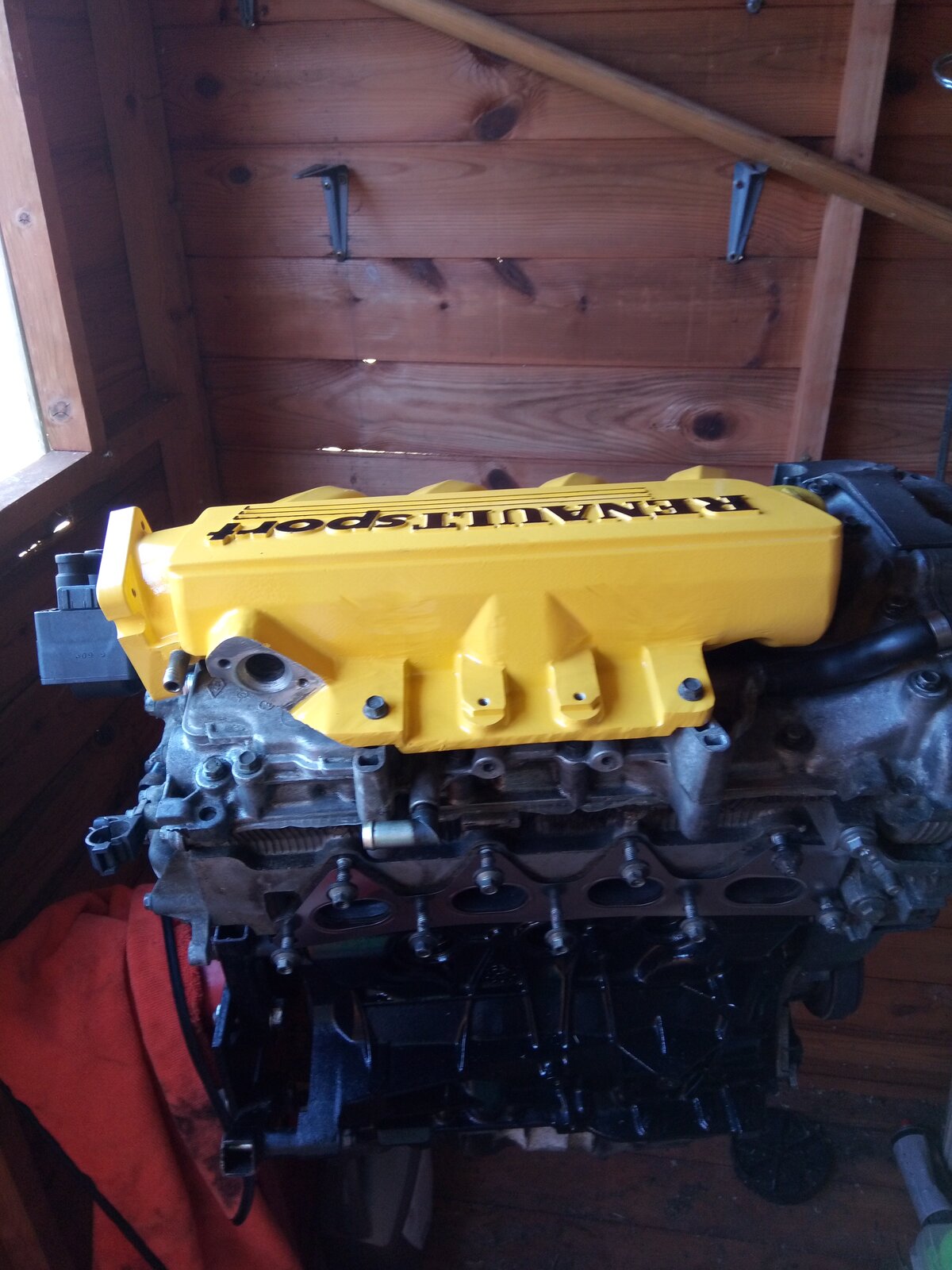

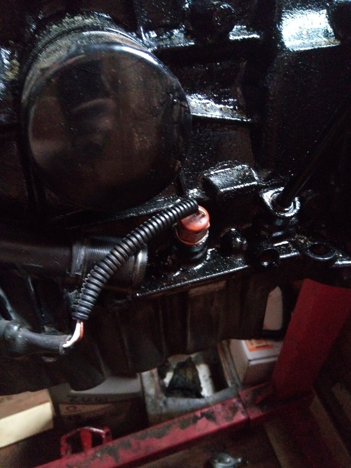

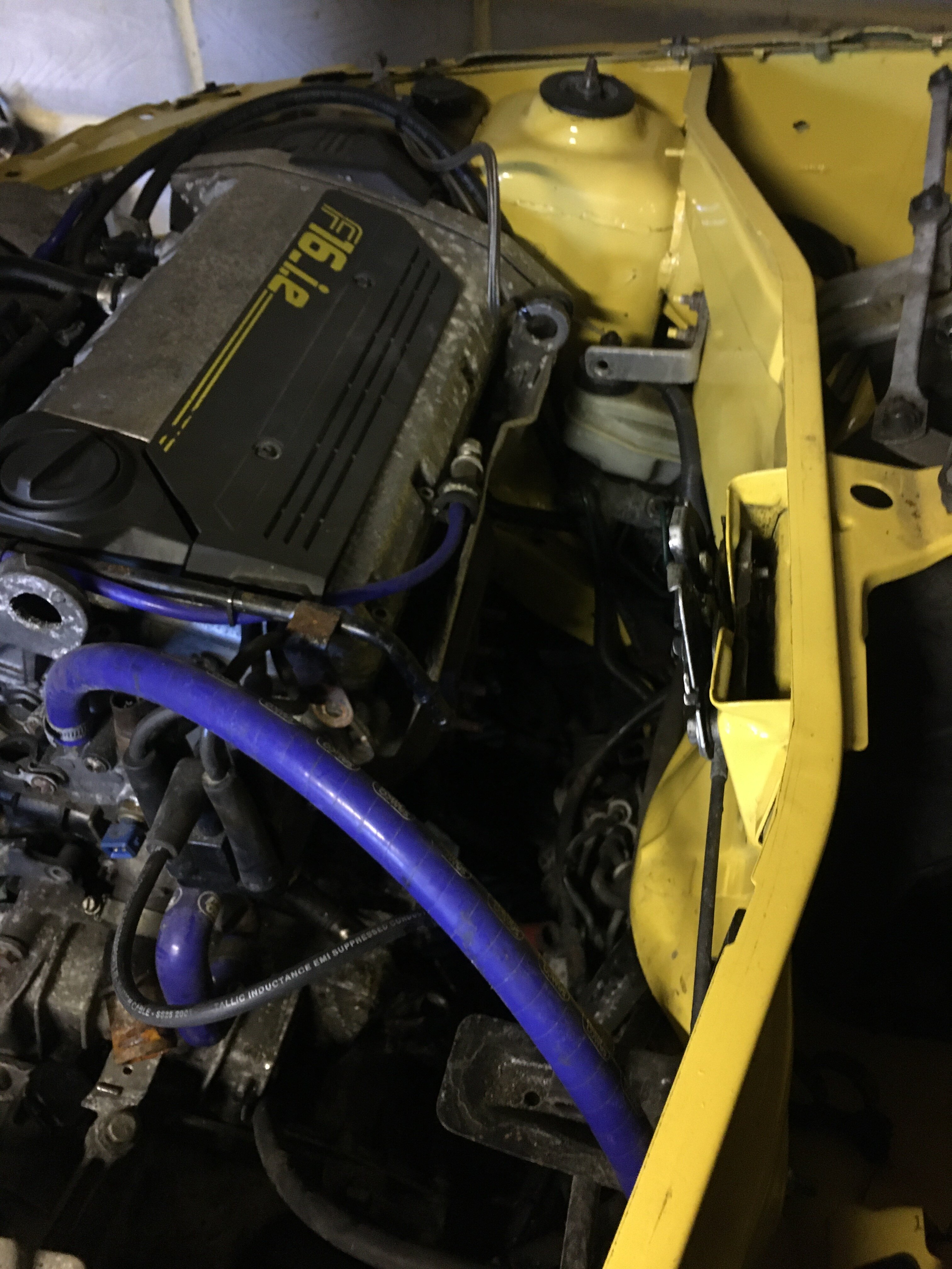

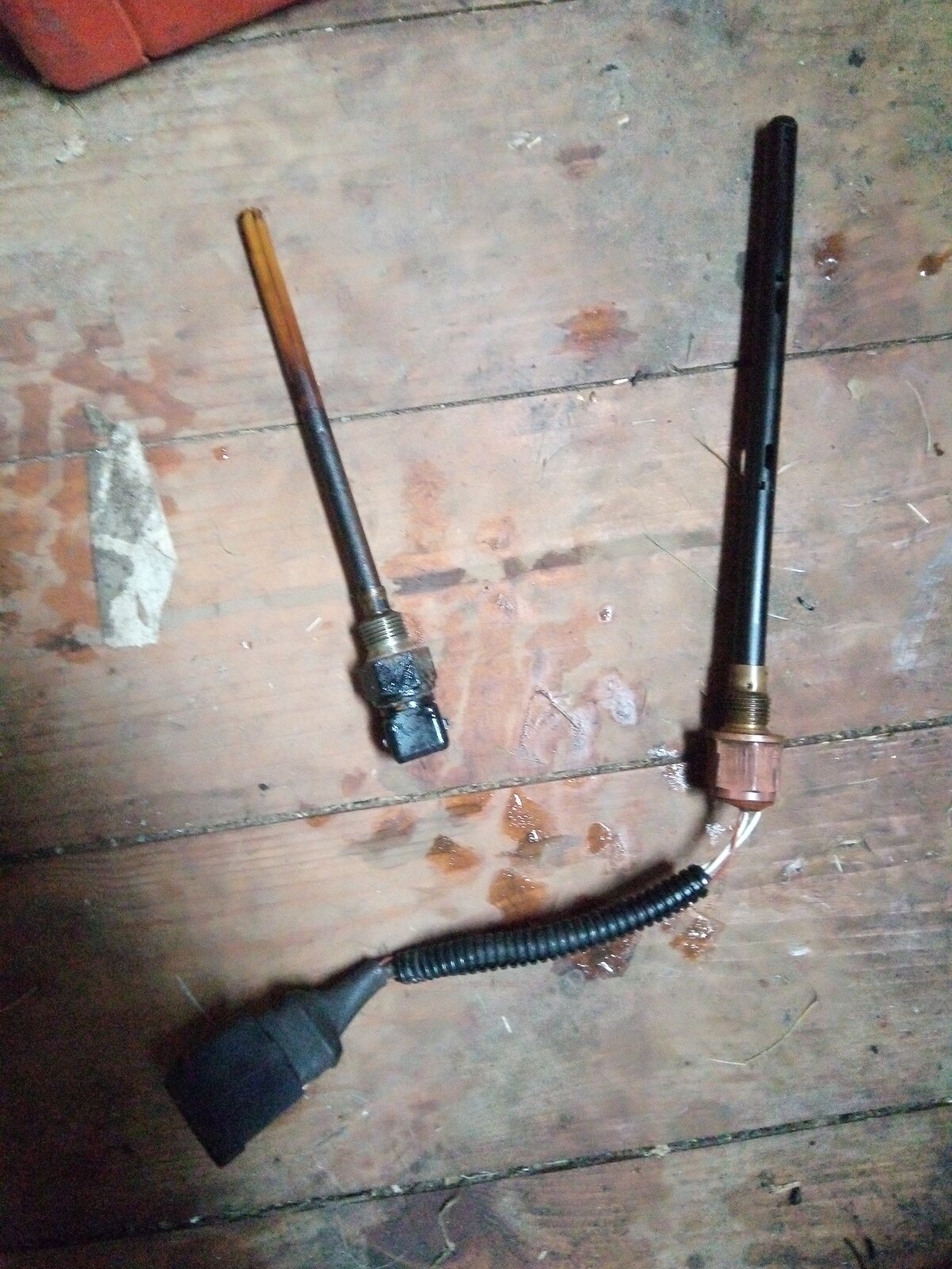

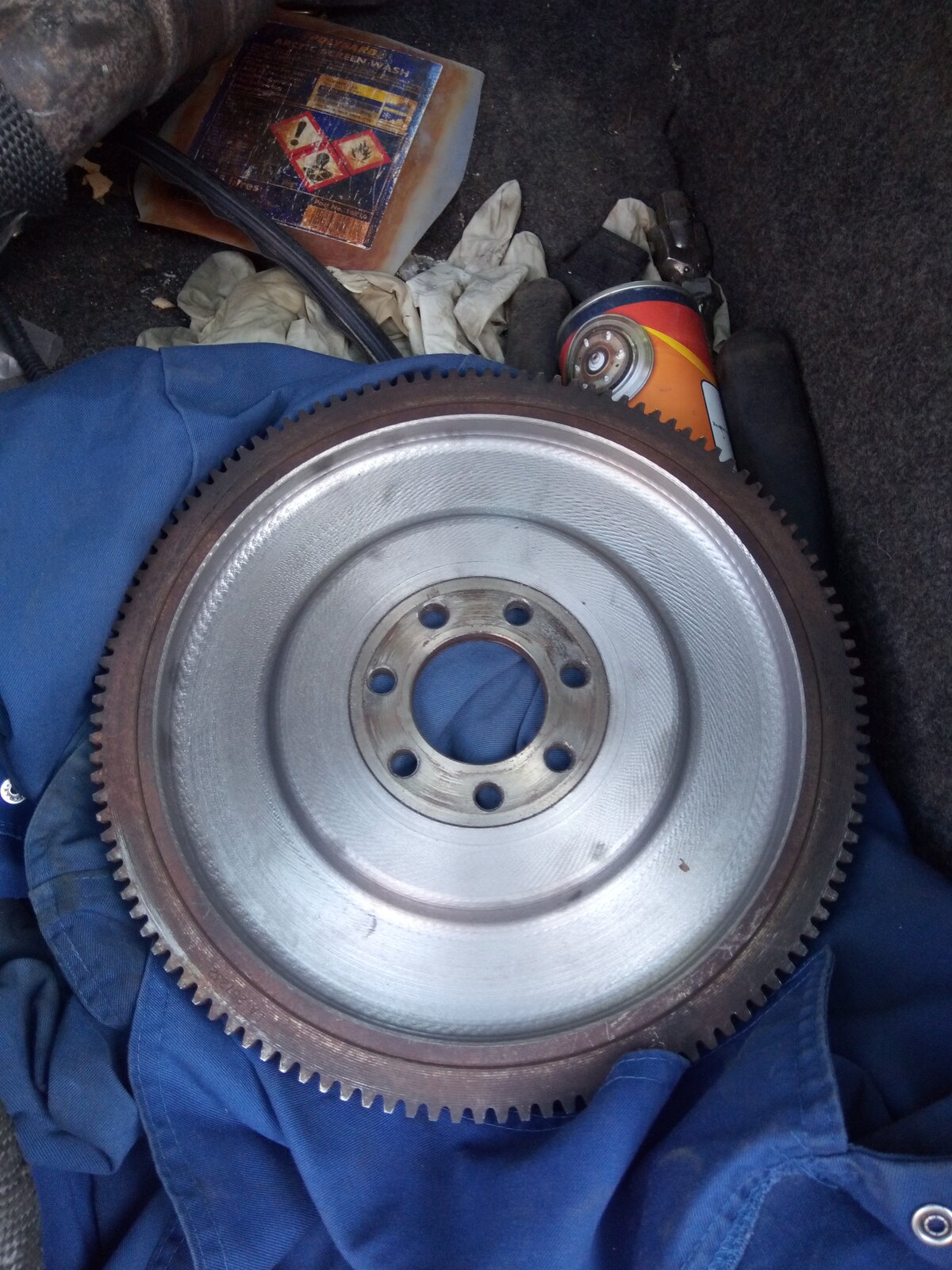

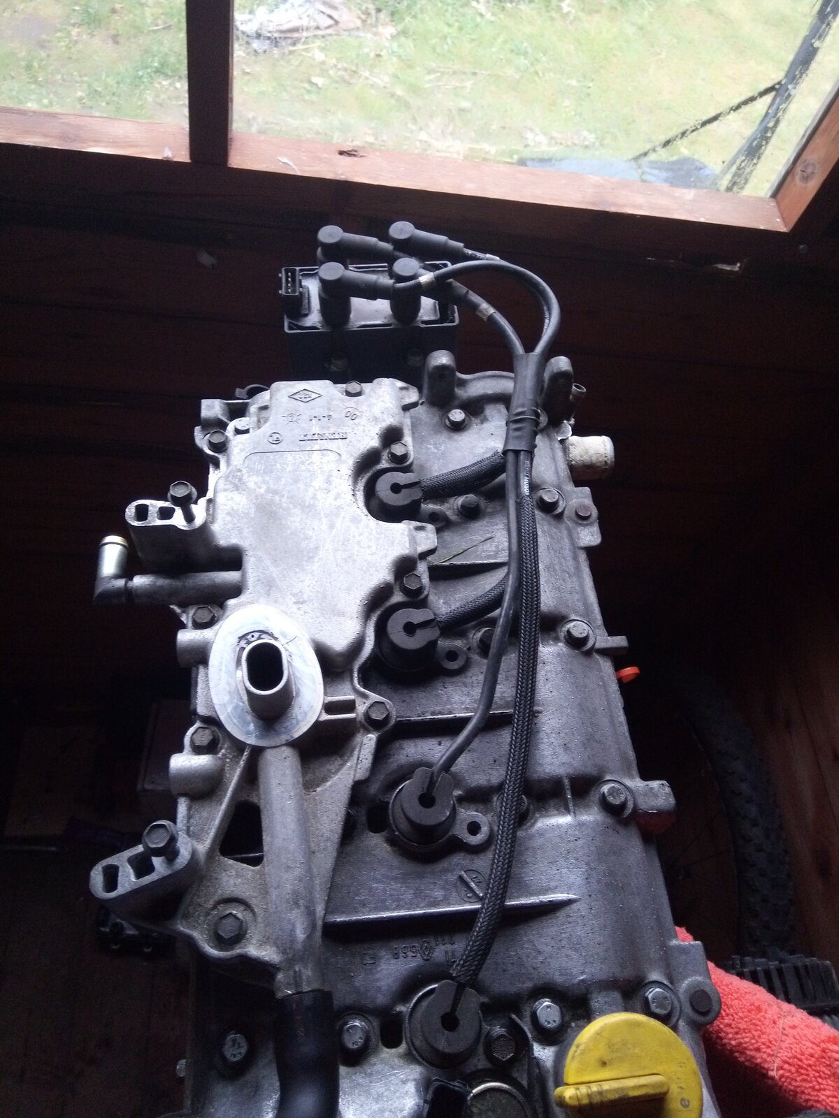

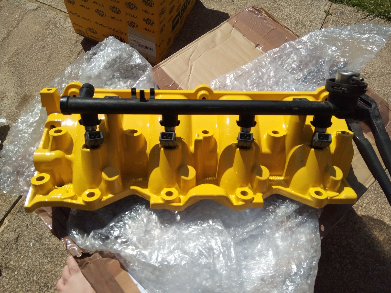

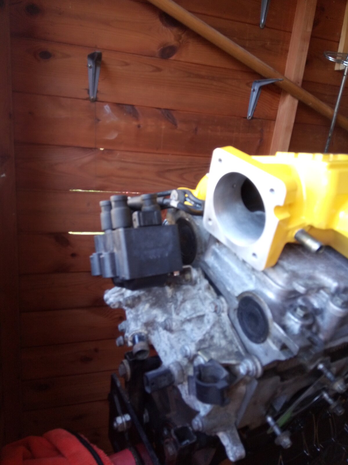

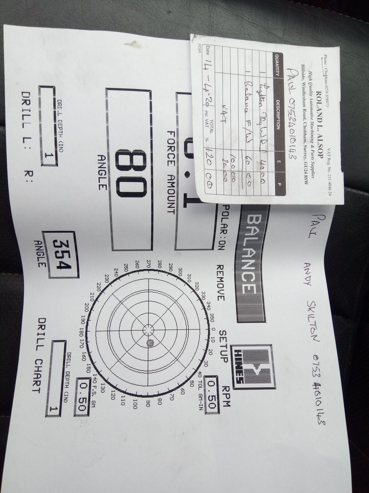

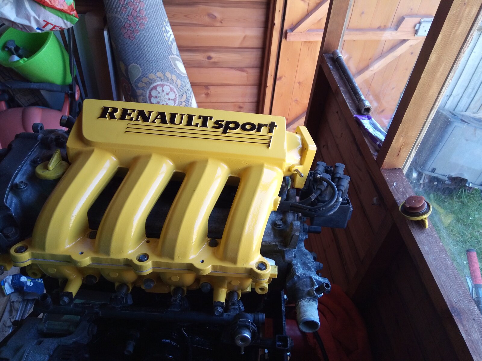

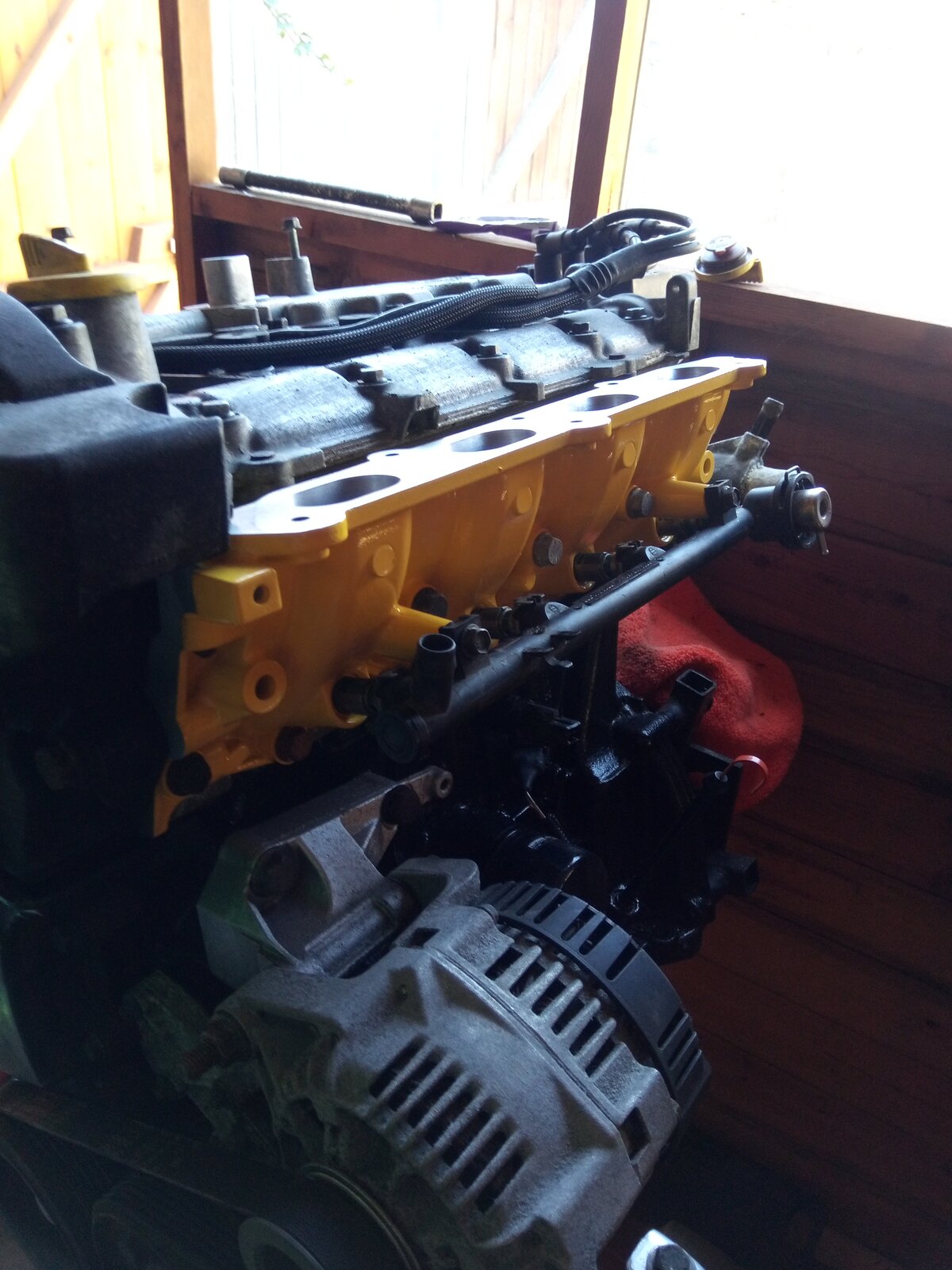

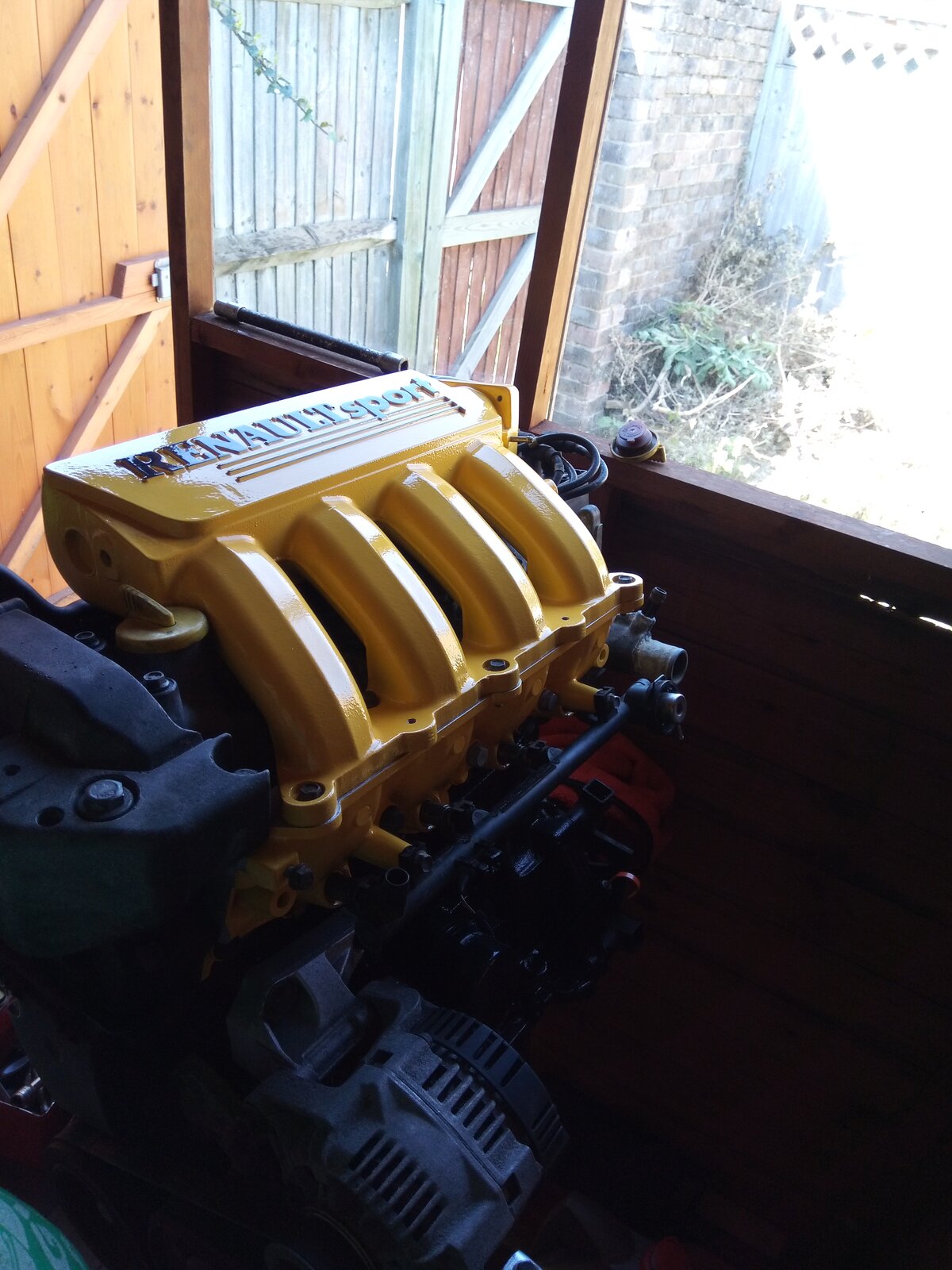

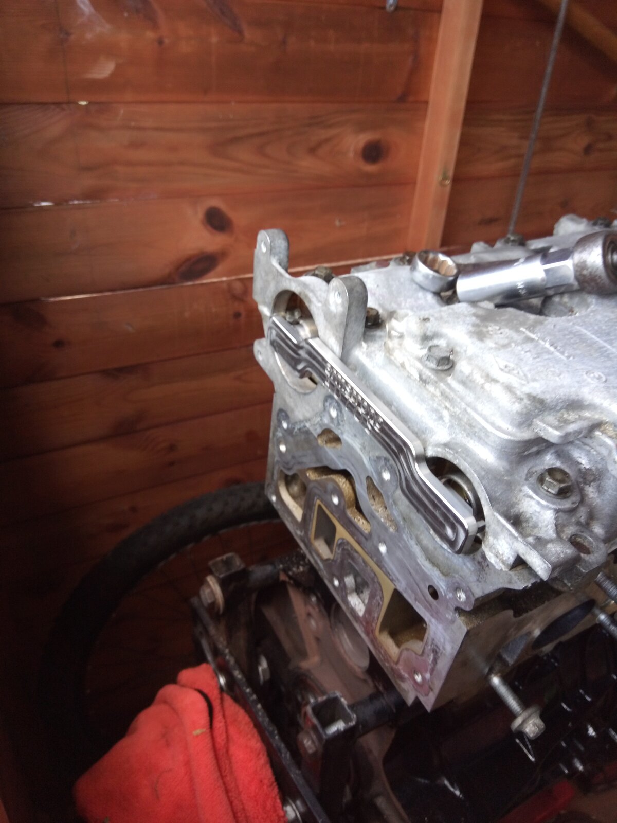

Little bit more progress today unfortunately i can only work as fast as the postman delivers started with the thermostat housing and coil pack then swapped out the oil level sensor for a 16v oil level and temperature sensor slowly coming together picked up my flywheel the other day too had it lightened and balanced every little helps

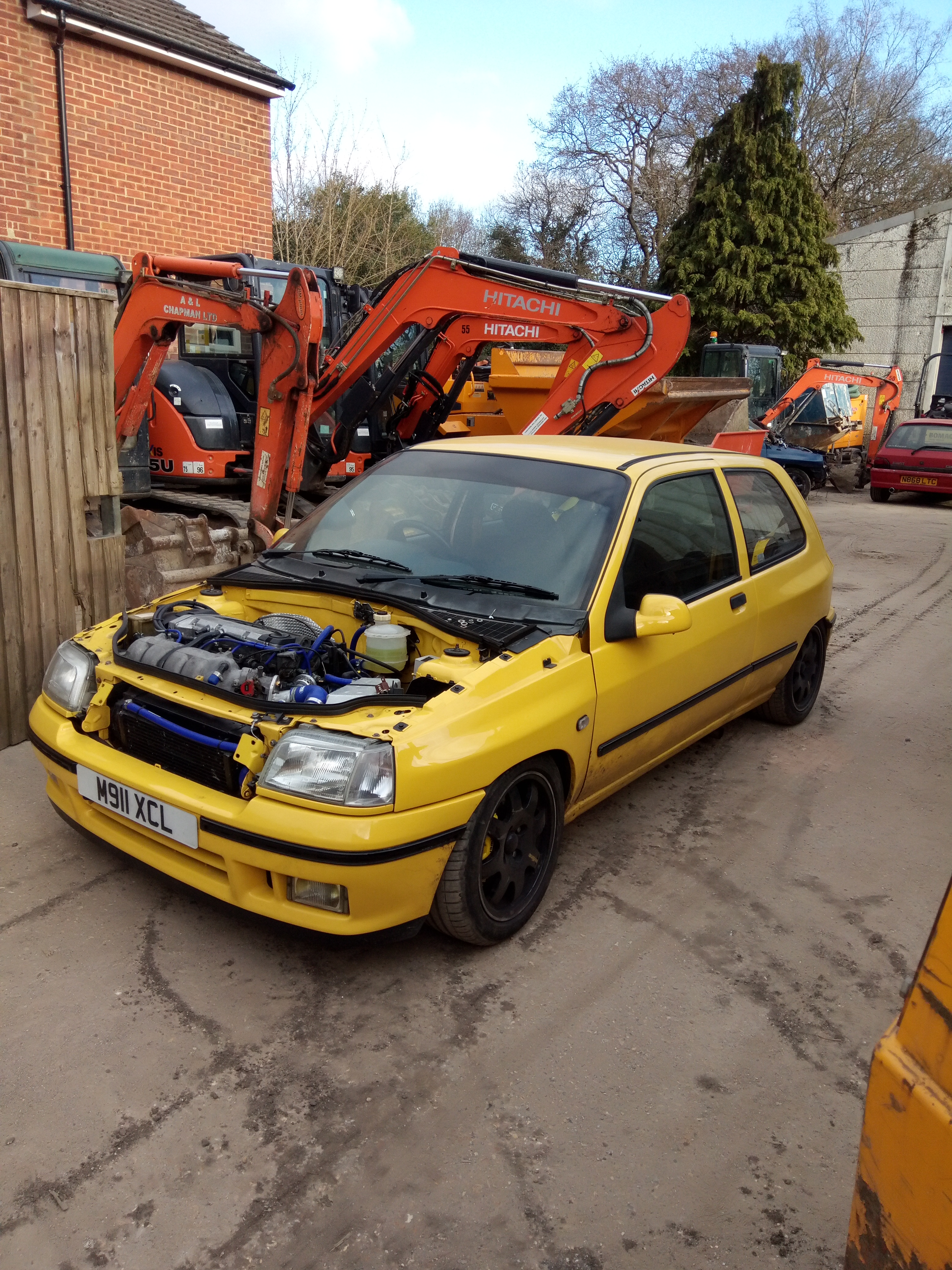

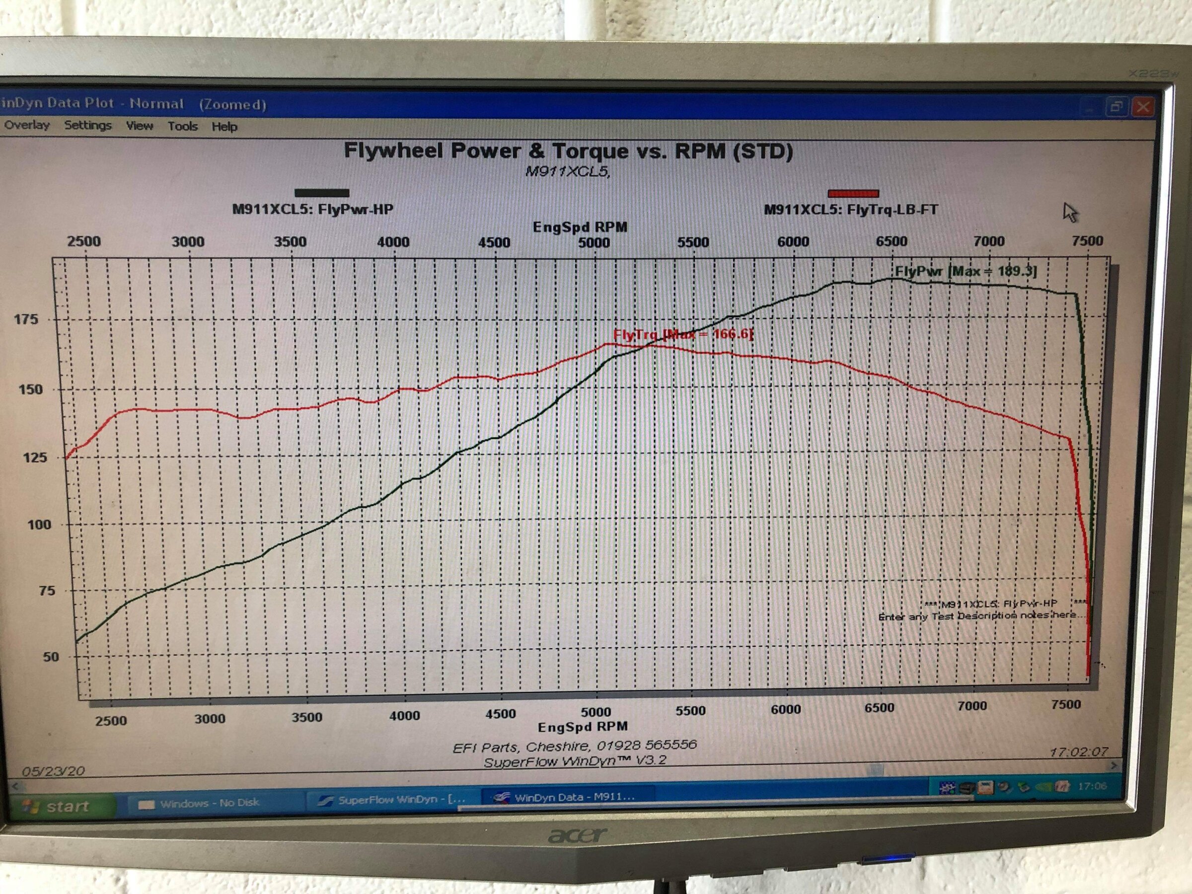

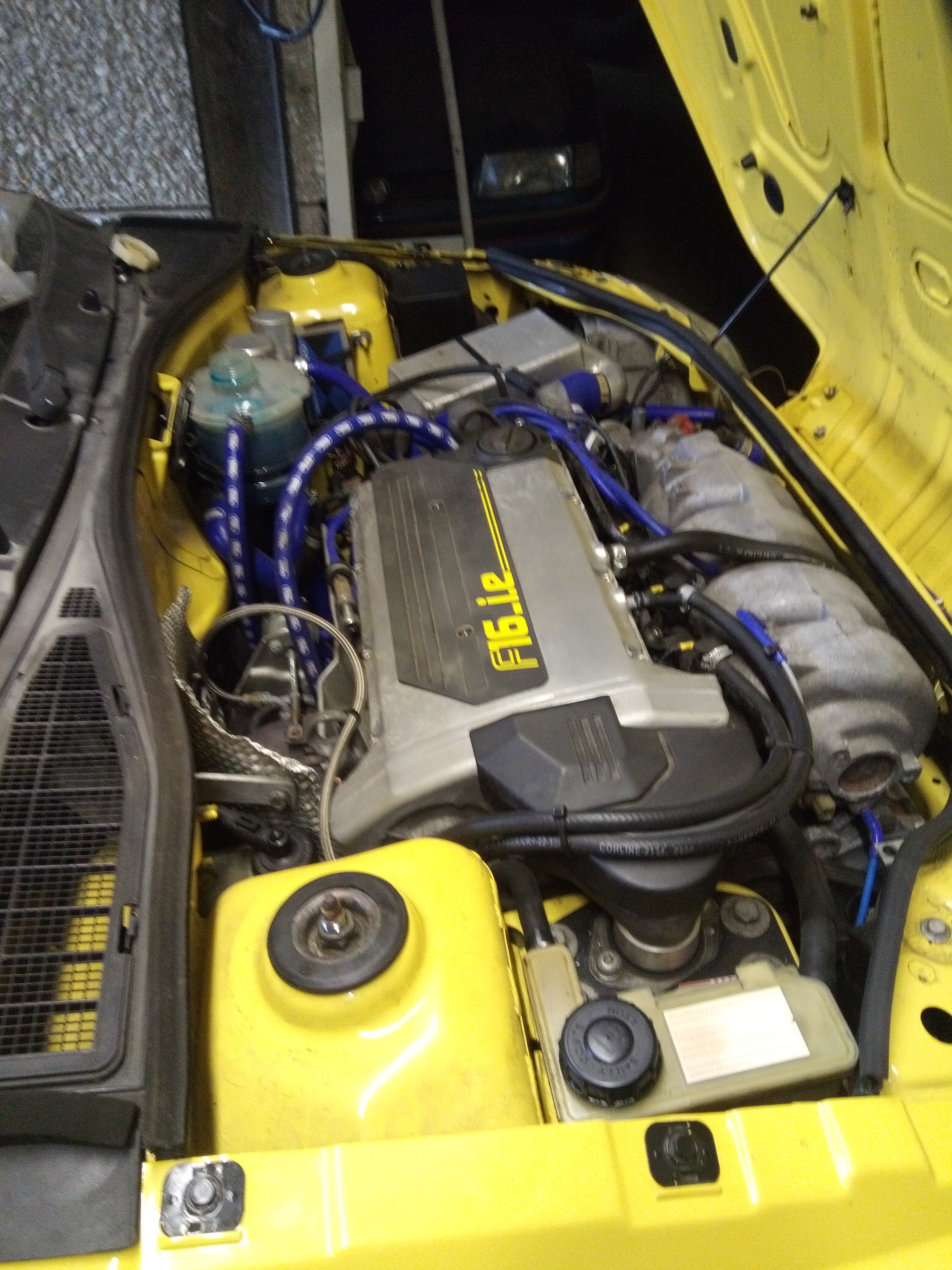

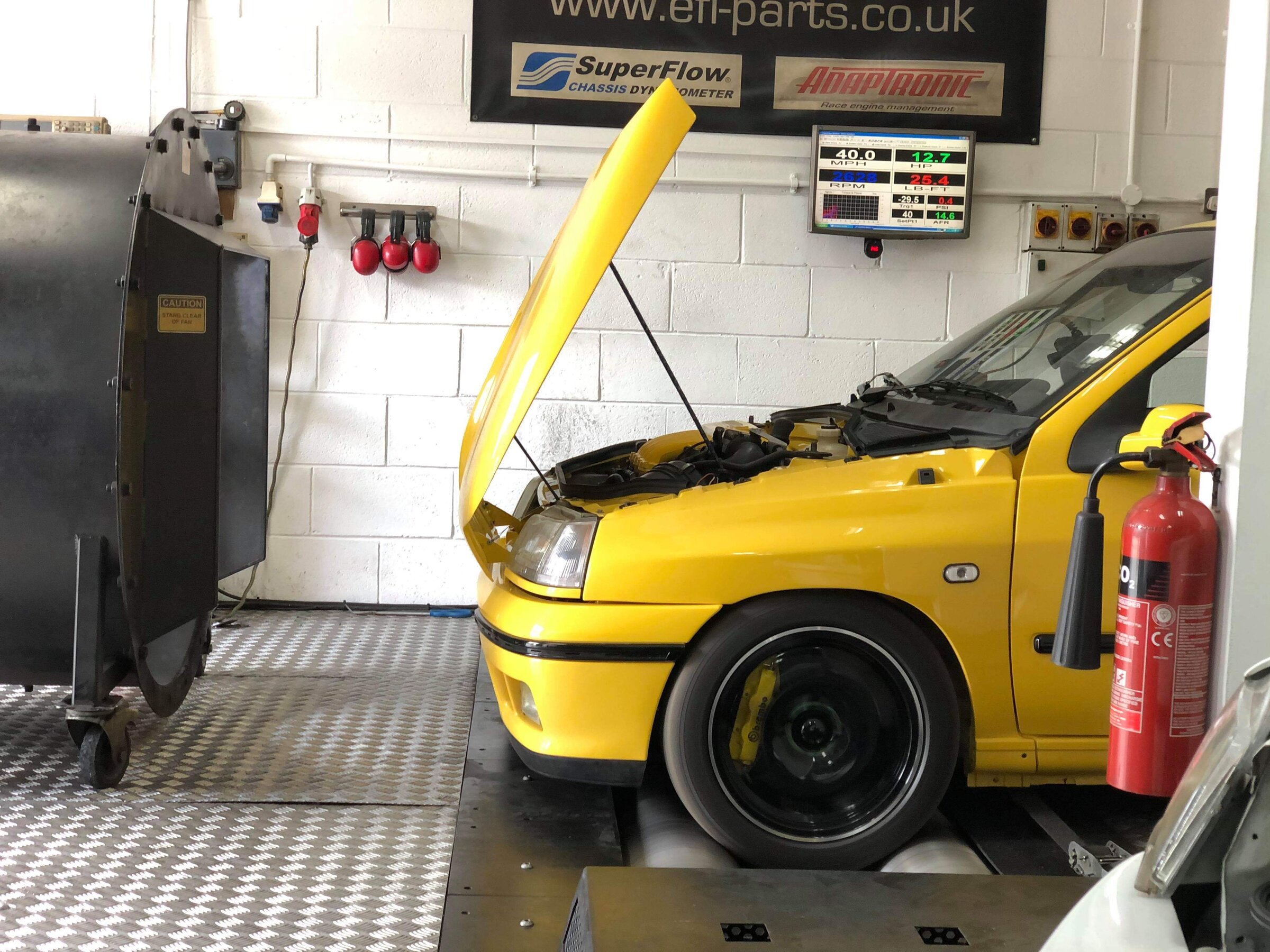

Didn't realize I abandoned this thread here probably time for an update cars running driving taxed motd etc for a while now mostly trouble free other than it cracking a front arch 😭 I had it mapped at efi (as if there was anywhere else) made a healthy linear 189.6 bhp only the 2 inch exhaust holding it back since being on the road it's done 1800 trouble free miles and I'm quite enjoying it n/a 😂

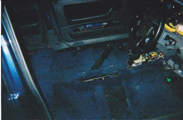

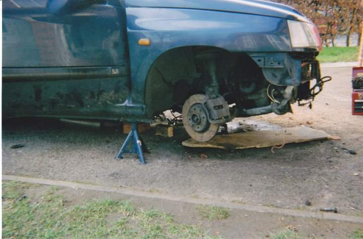

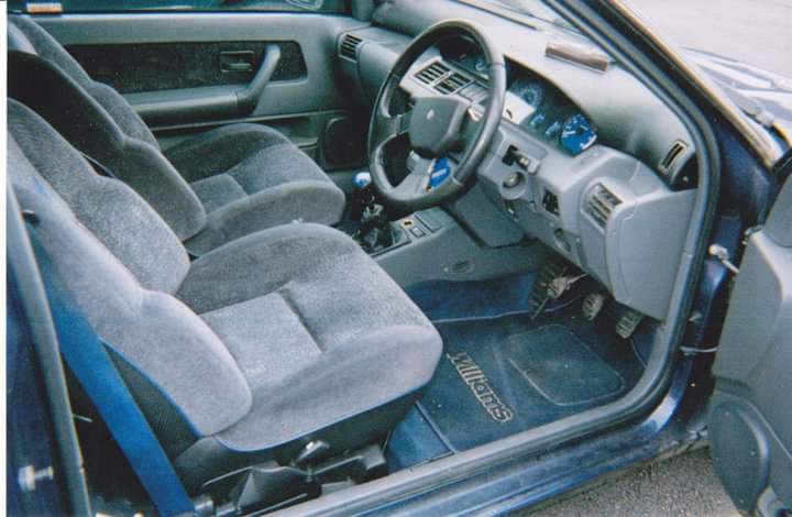

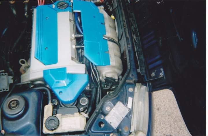

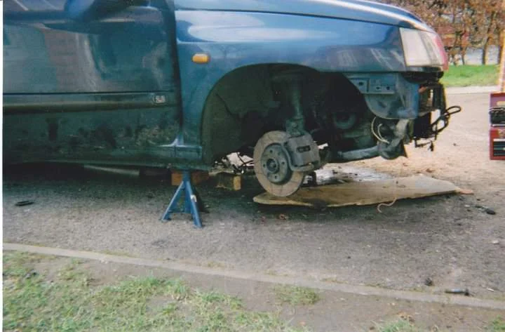

Found a few pictures from back when I Williams replica'd it nearly 15 years ago and the Williams 3 that I broke to do it.

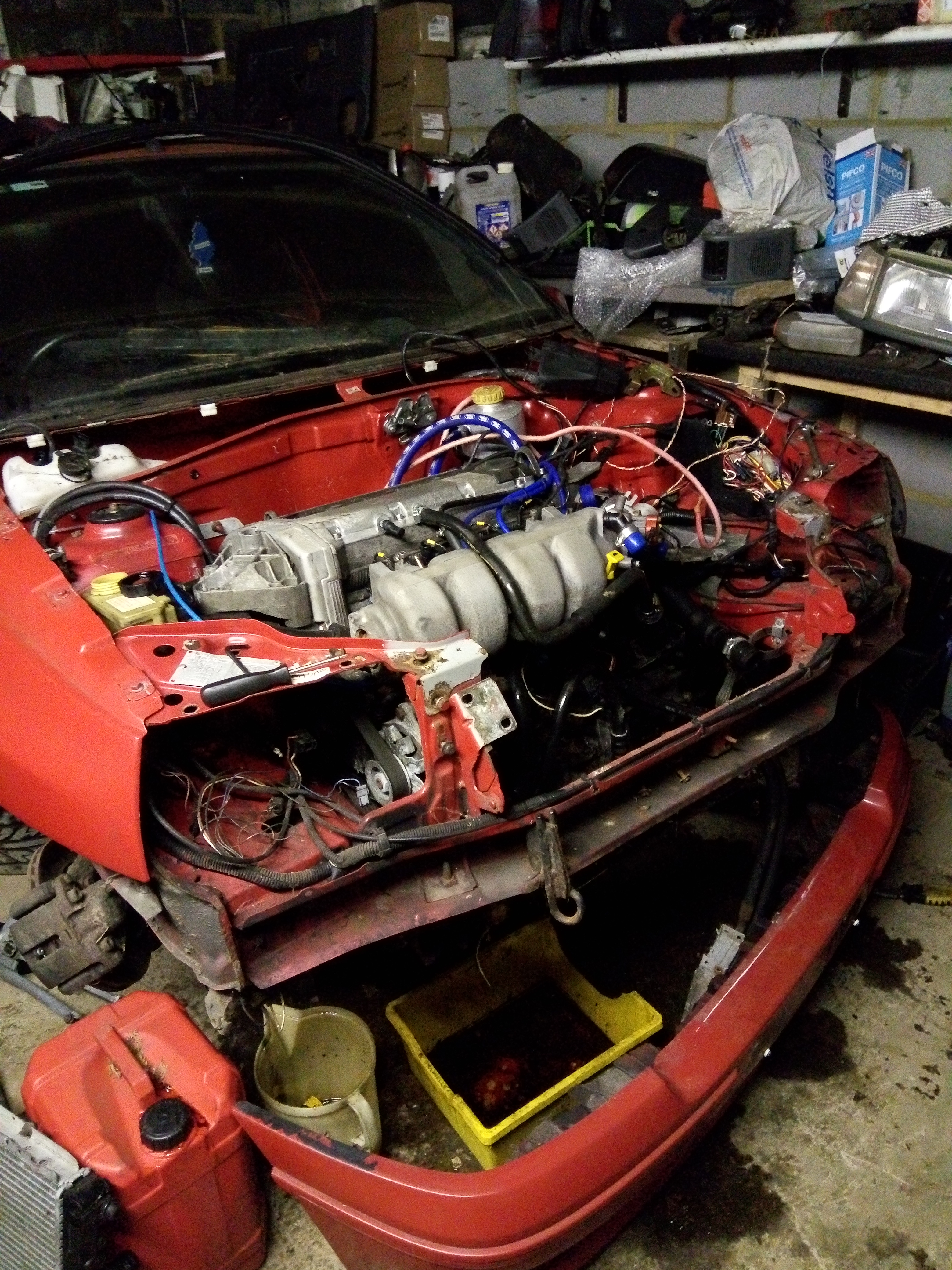

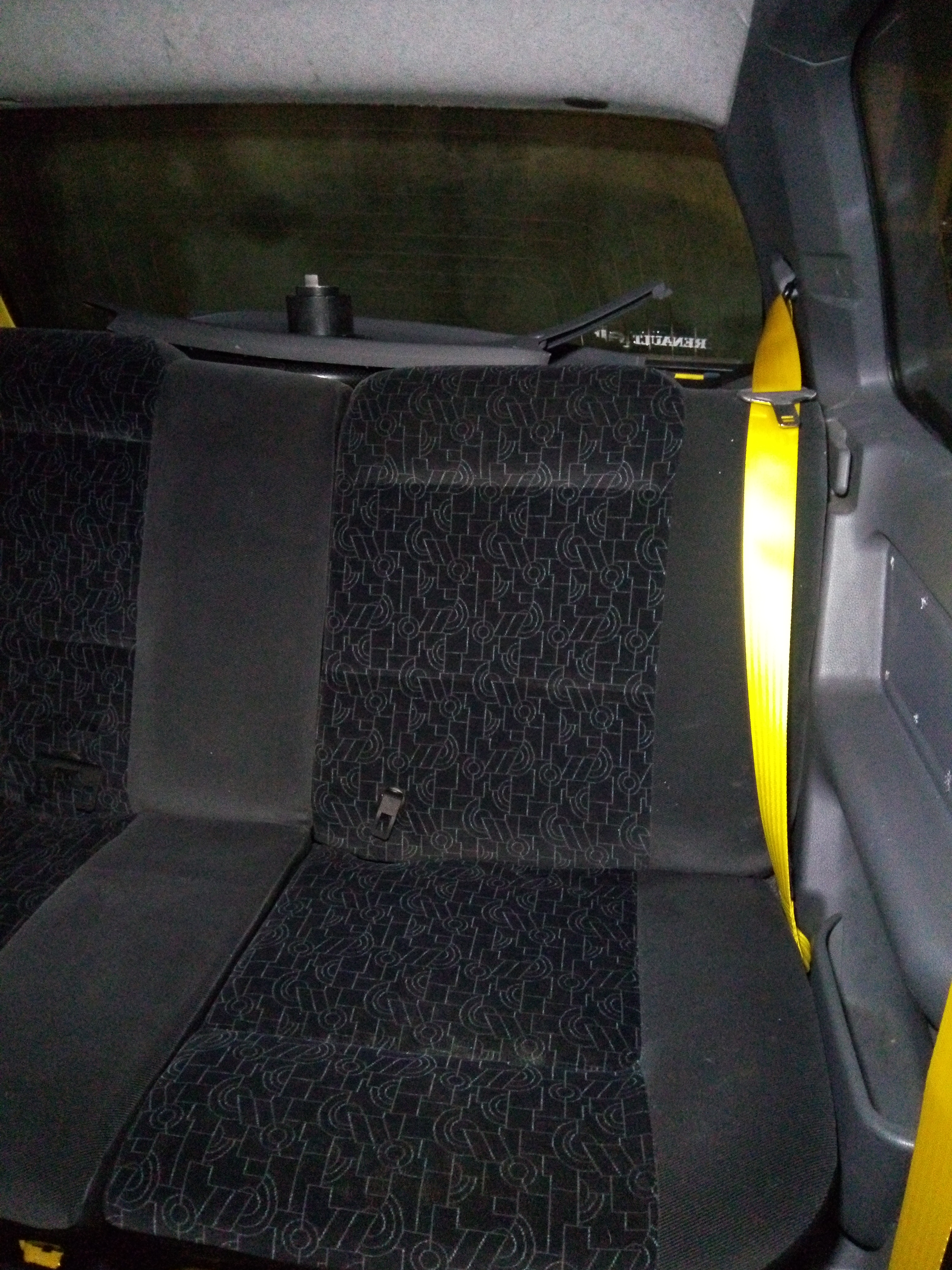

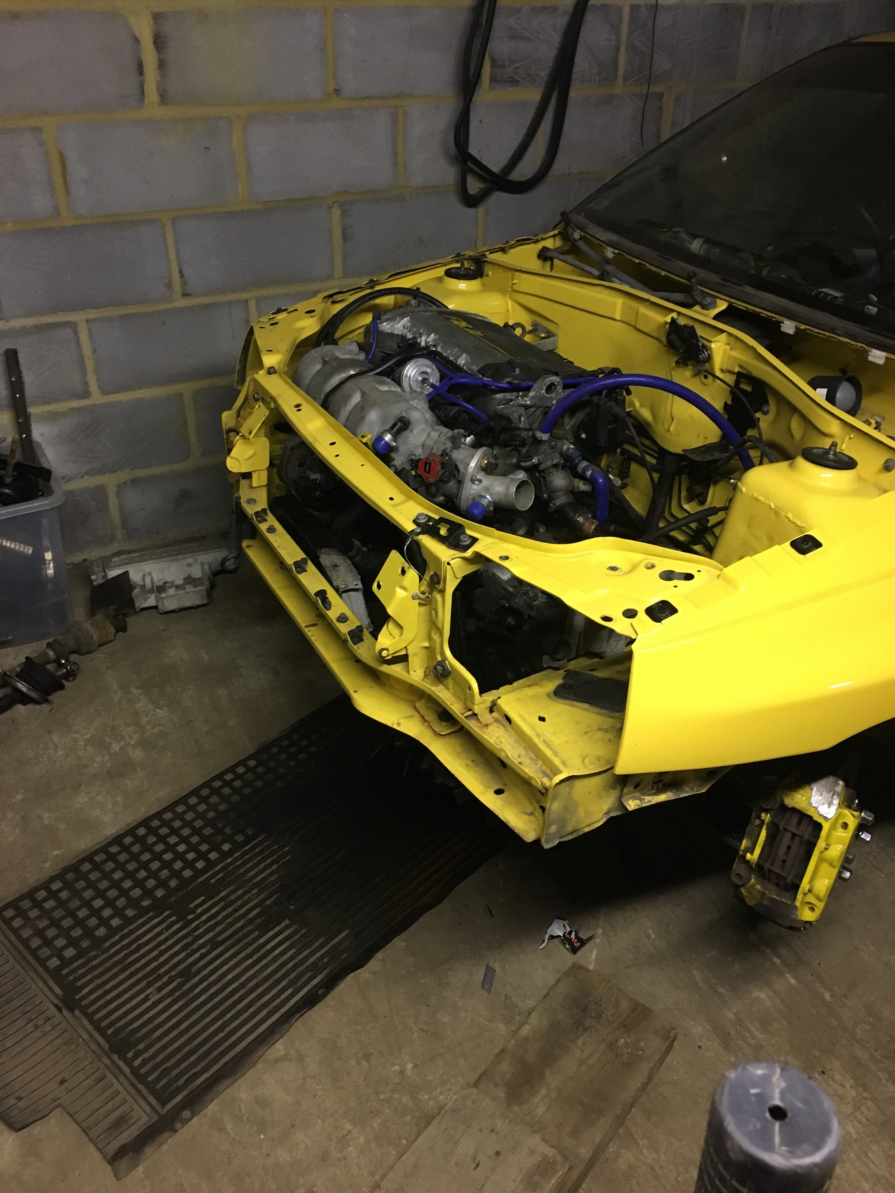

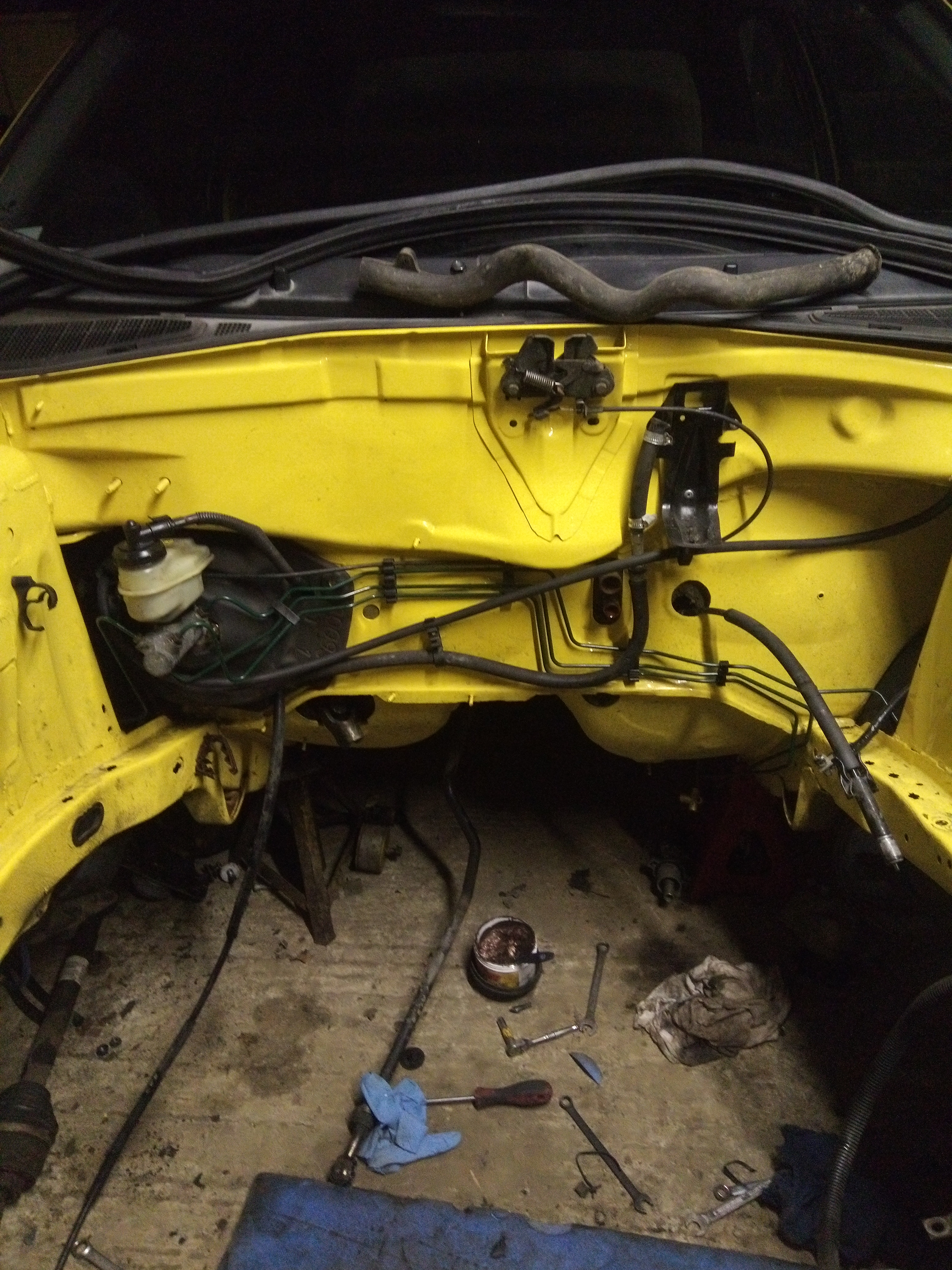

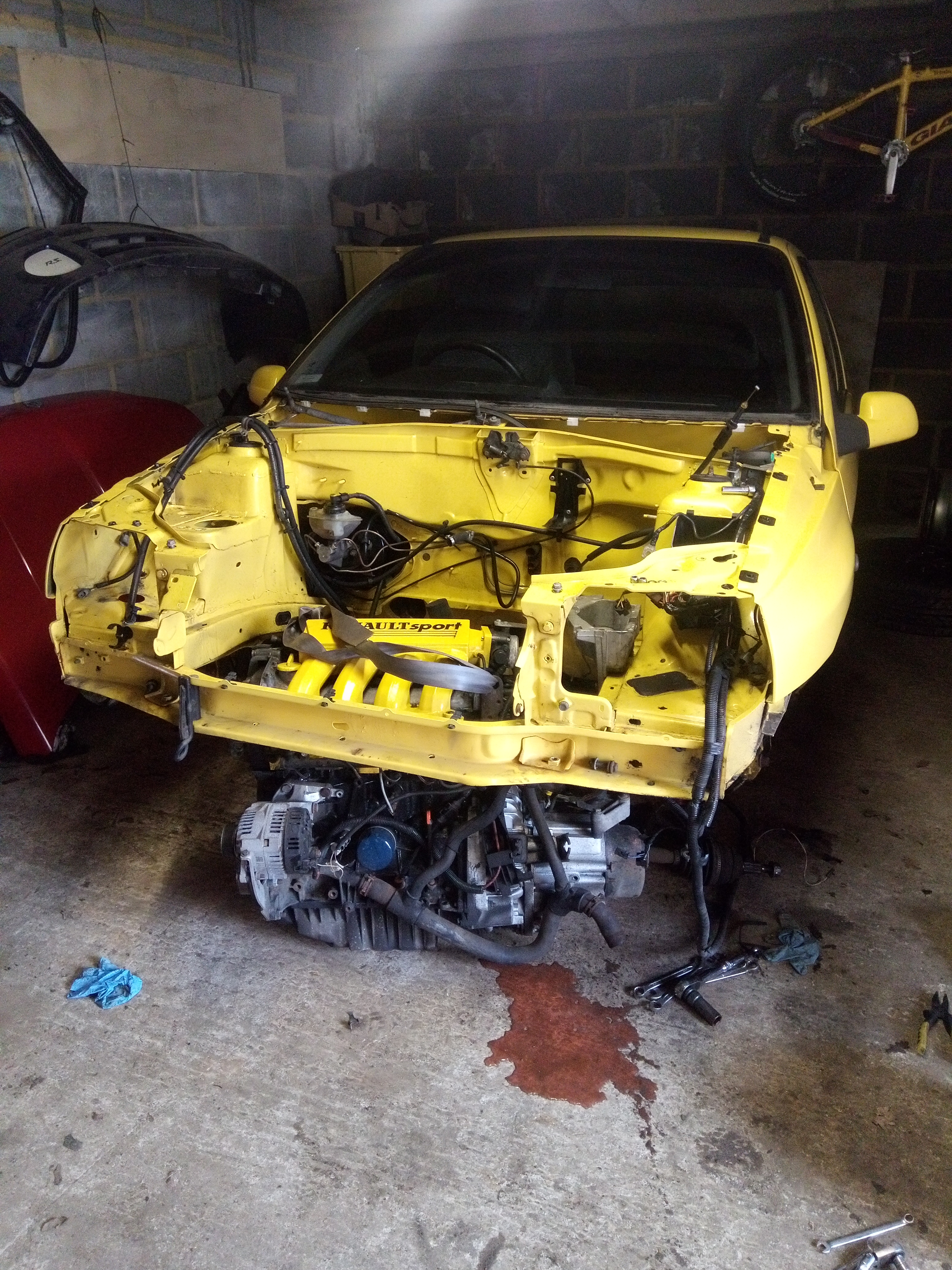

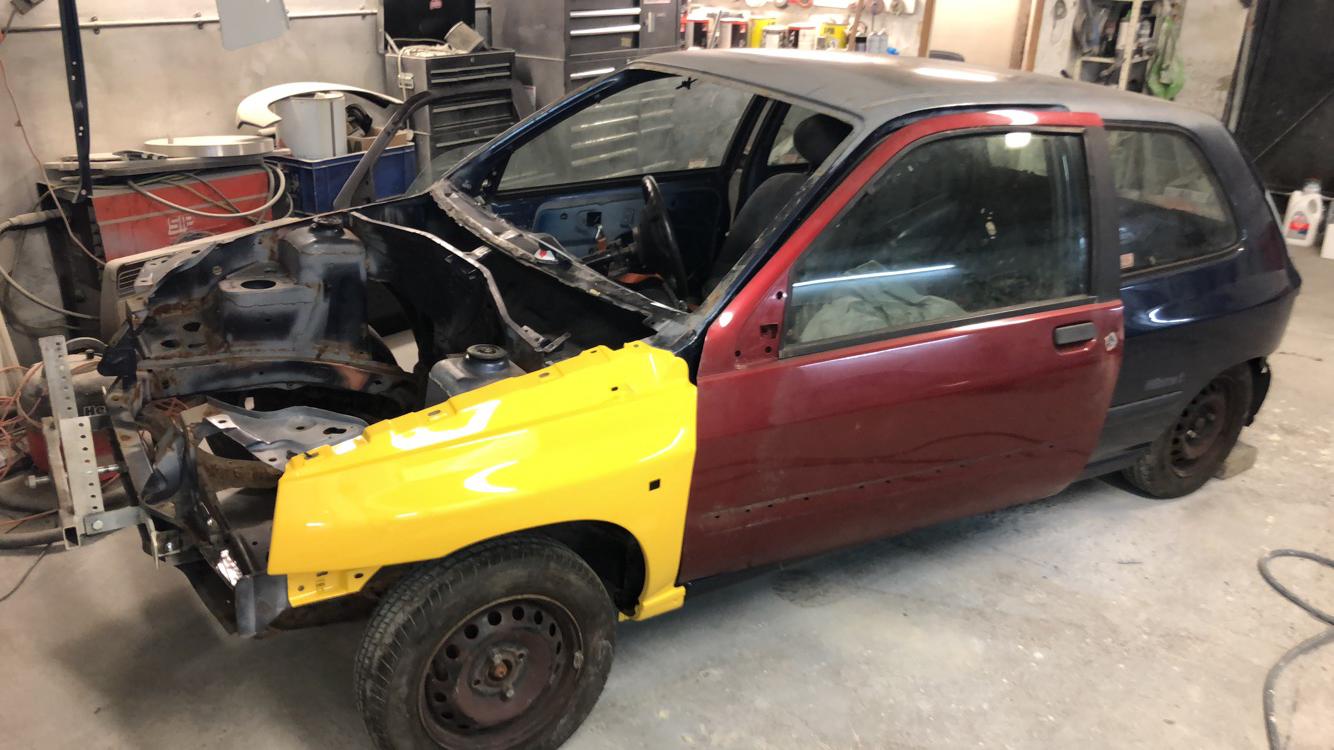

Well the rebuild has begun I've pulled the engine out subframe off ditched the Williams seats seat belts dash I'm fitting the OEM seats and dash. I've removed the entire loom too it was a little sad pulling something apart that works so well but it's the right thing to do

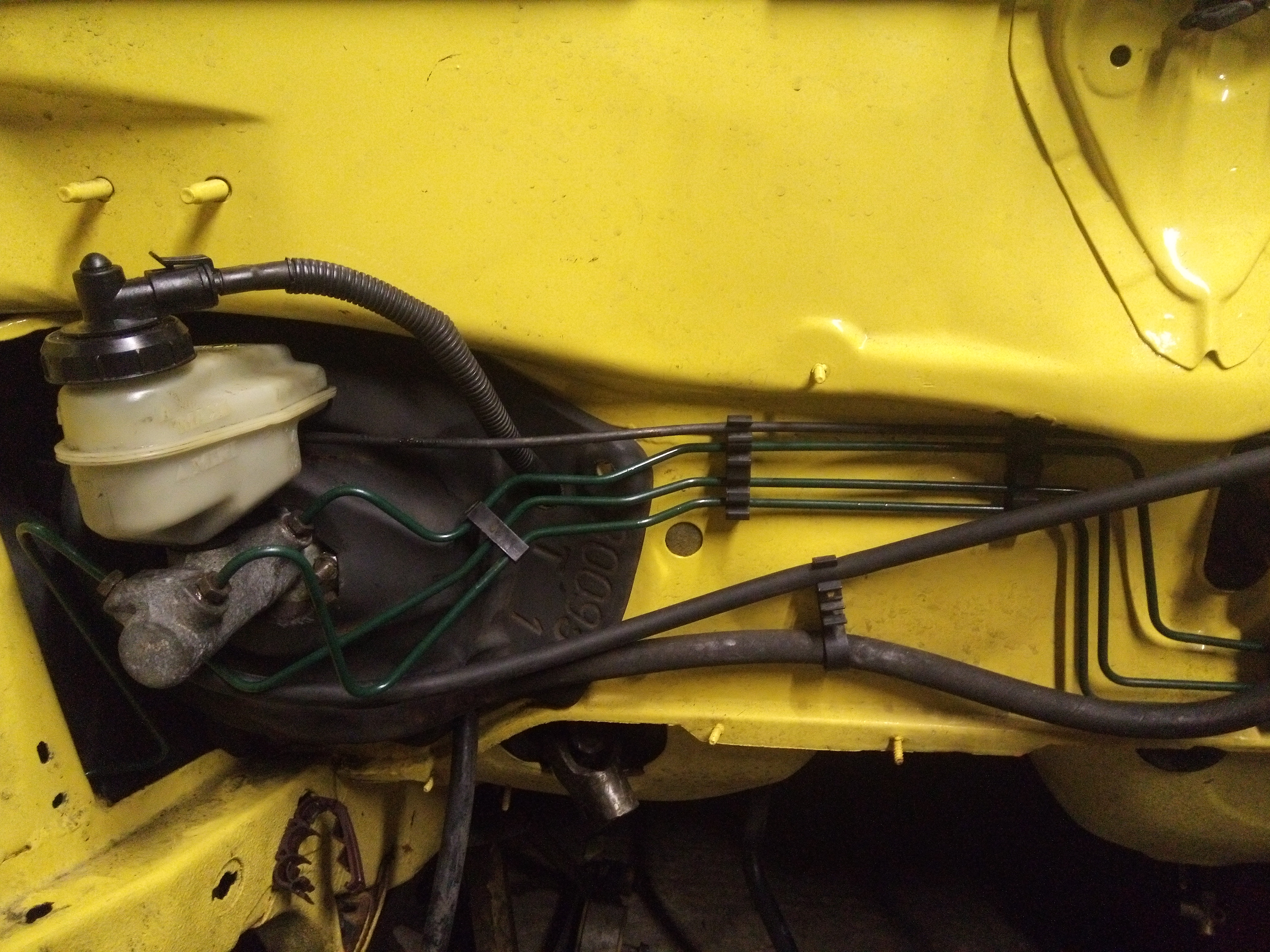

Returning a few bits to standard there was no real need to to upgrade the master cylinder to a 172 cup item so its gone replaced with standard and standard brake lines and even the little foam bit that covers the servo.

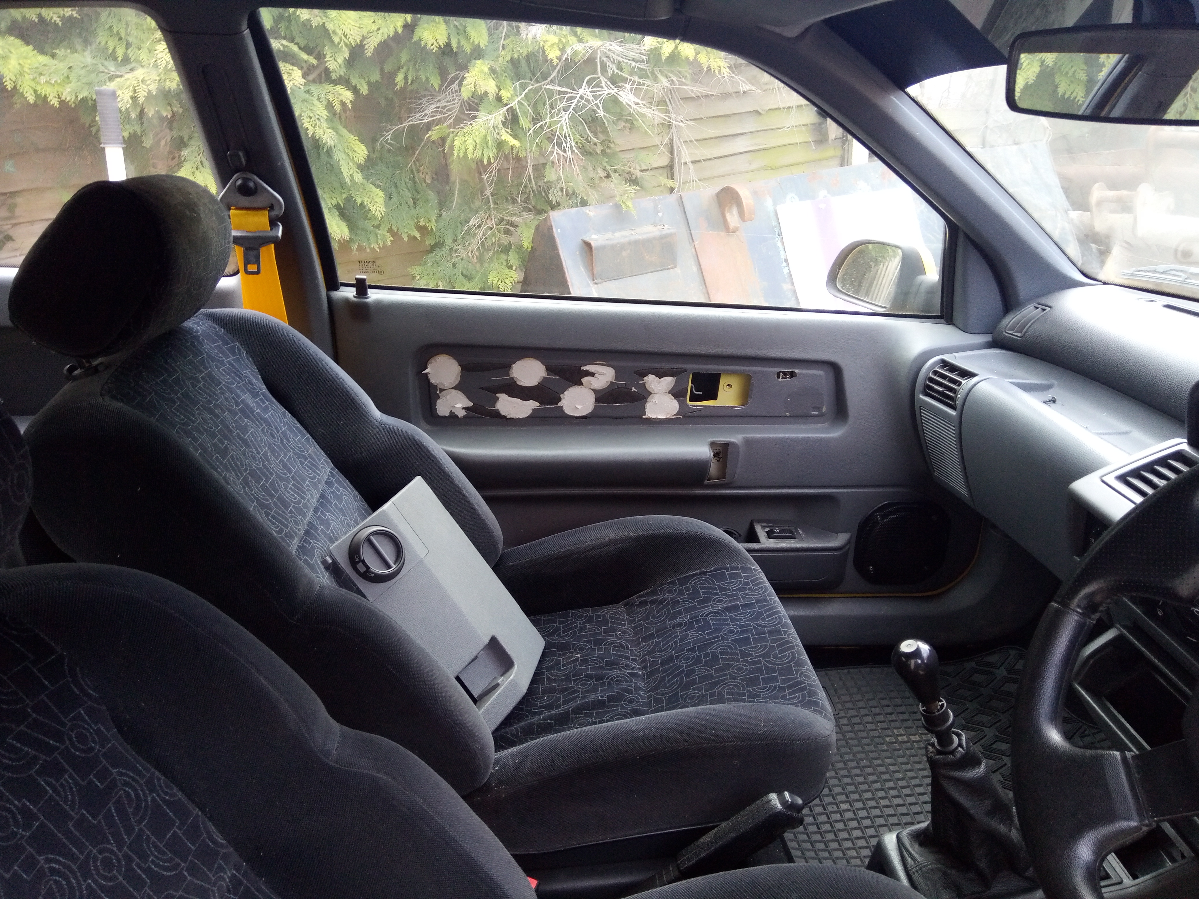

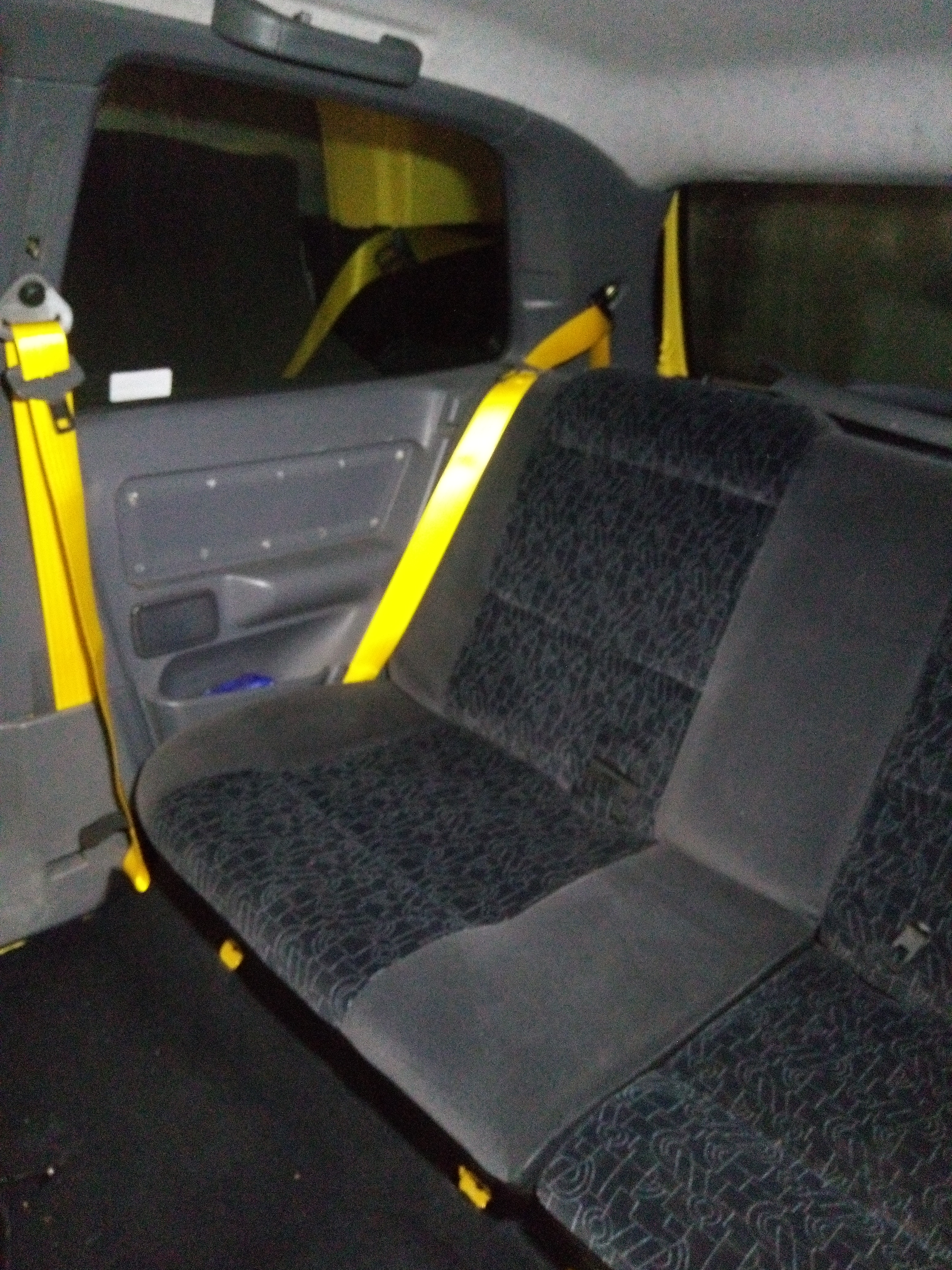

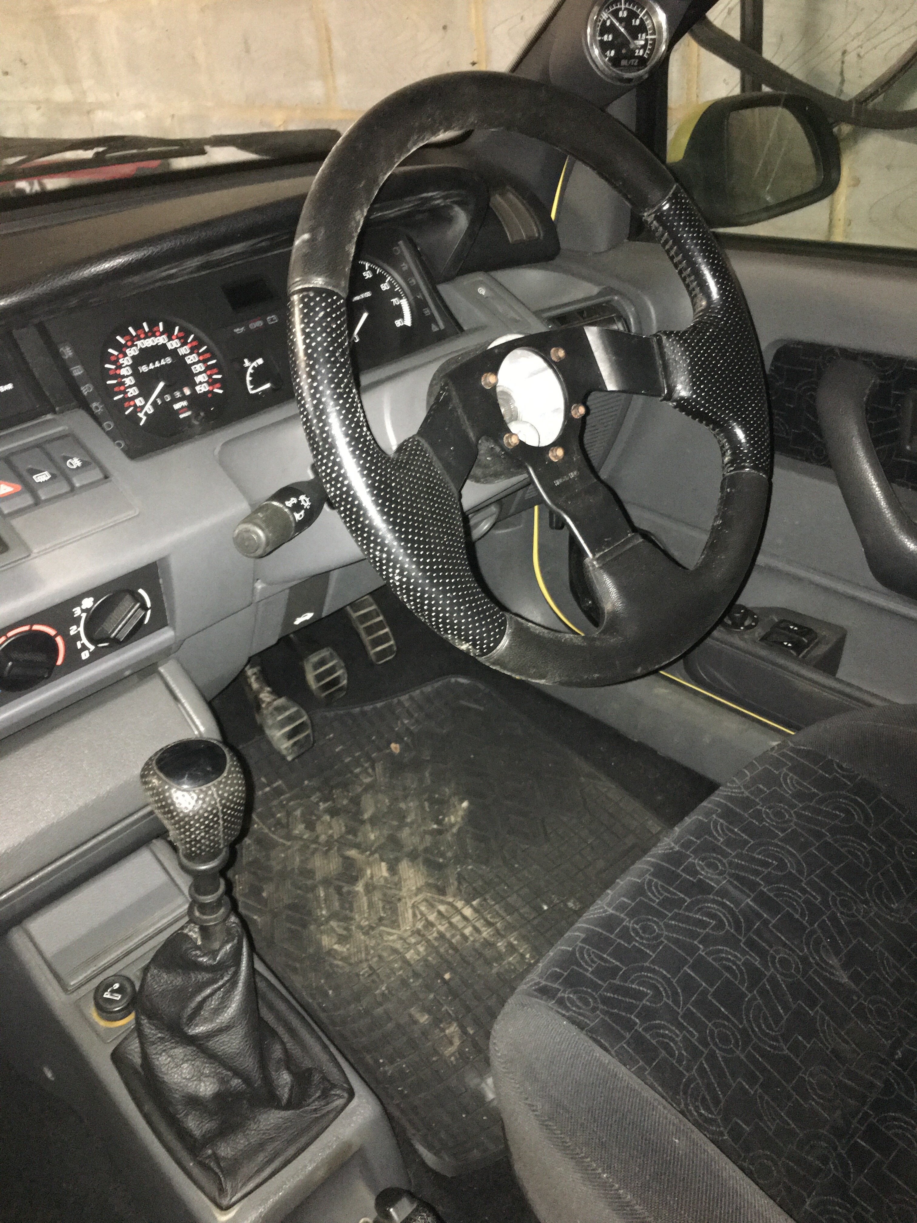

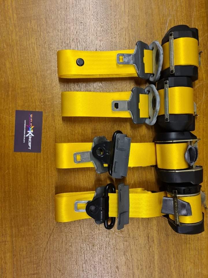

I've removed the Williams seats,seat belts and dials, the seats and dials will be replaced with standard items but the seat belts I've had re webbed in yellow 😍

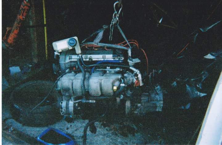

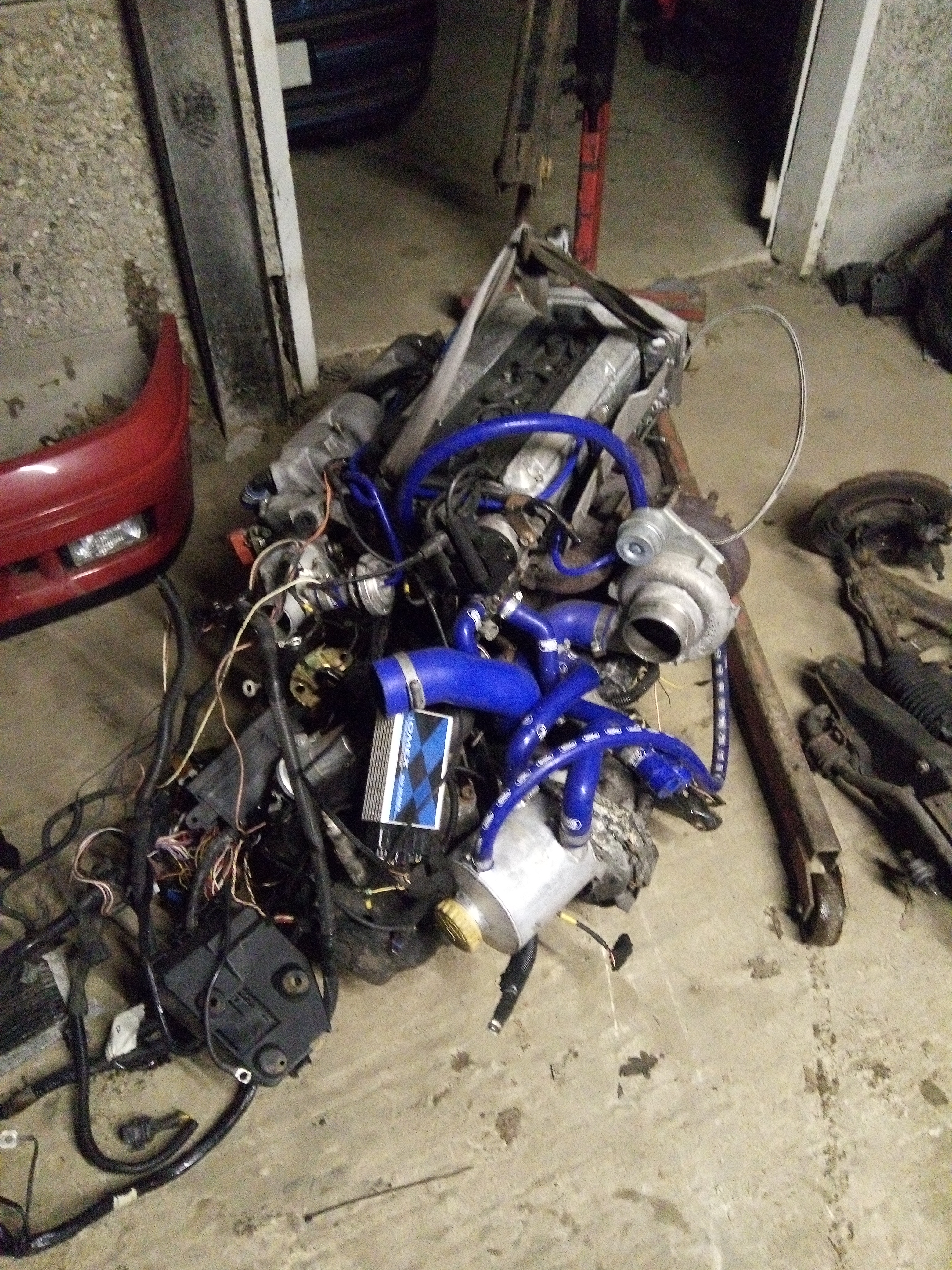

If I seems like the engine just turned up like I didn't build it yes that's the case .I recently purchased a mk1 with this engine already in running driving forged mapped etc supposedly runs 350 bhp so in theory after a little tidying and refining it should just bolt in and drive happy days.

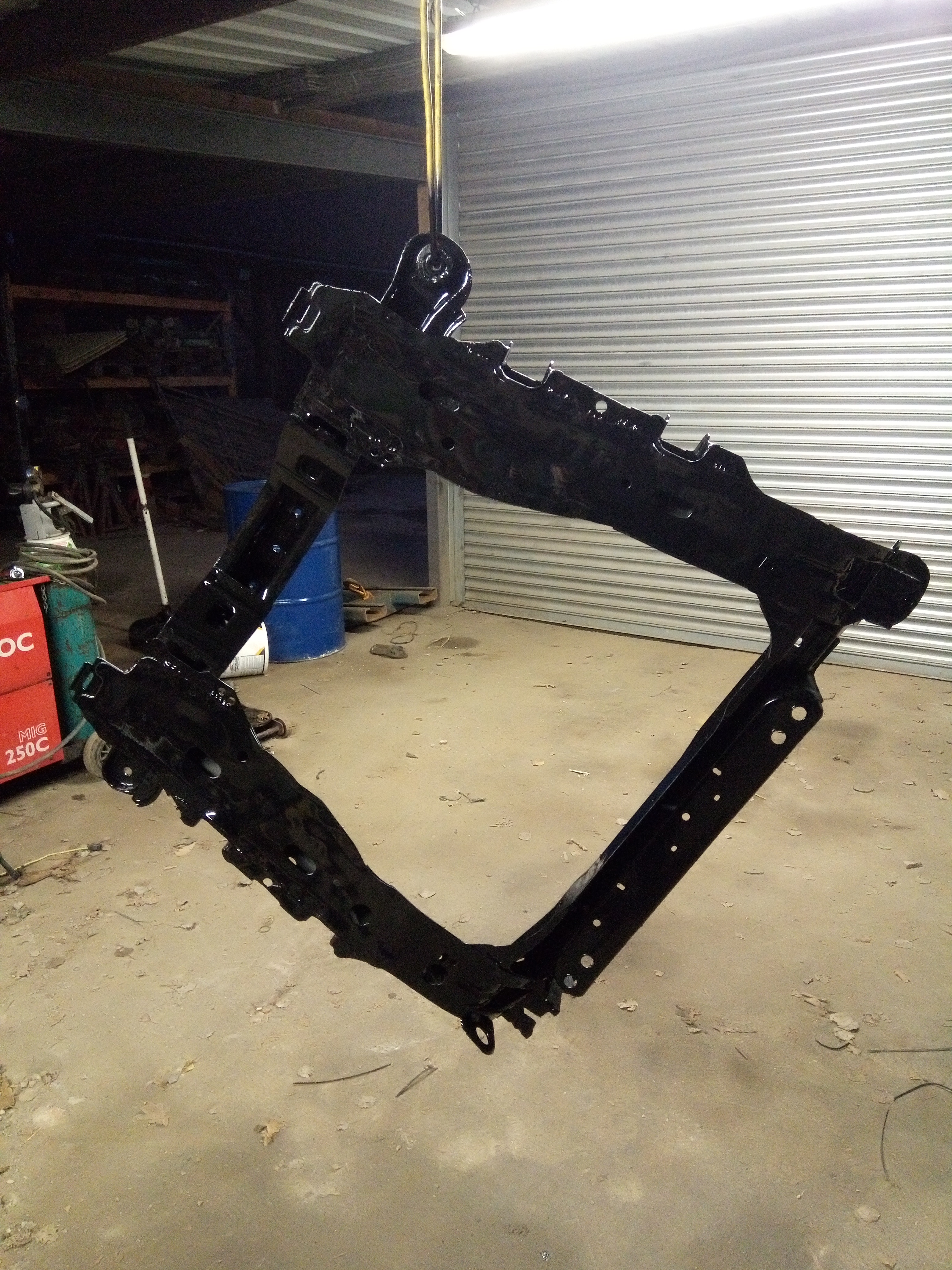

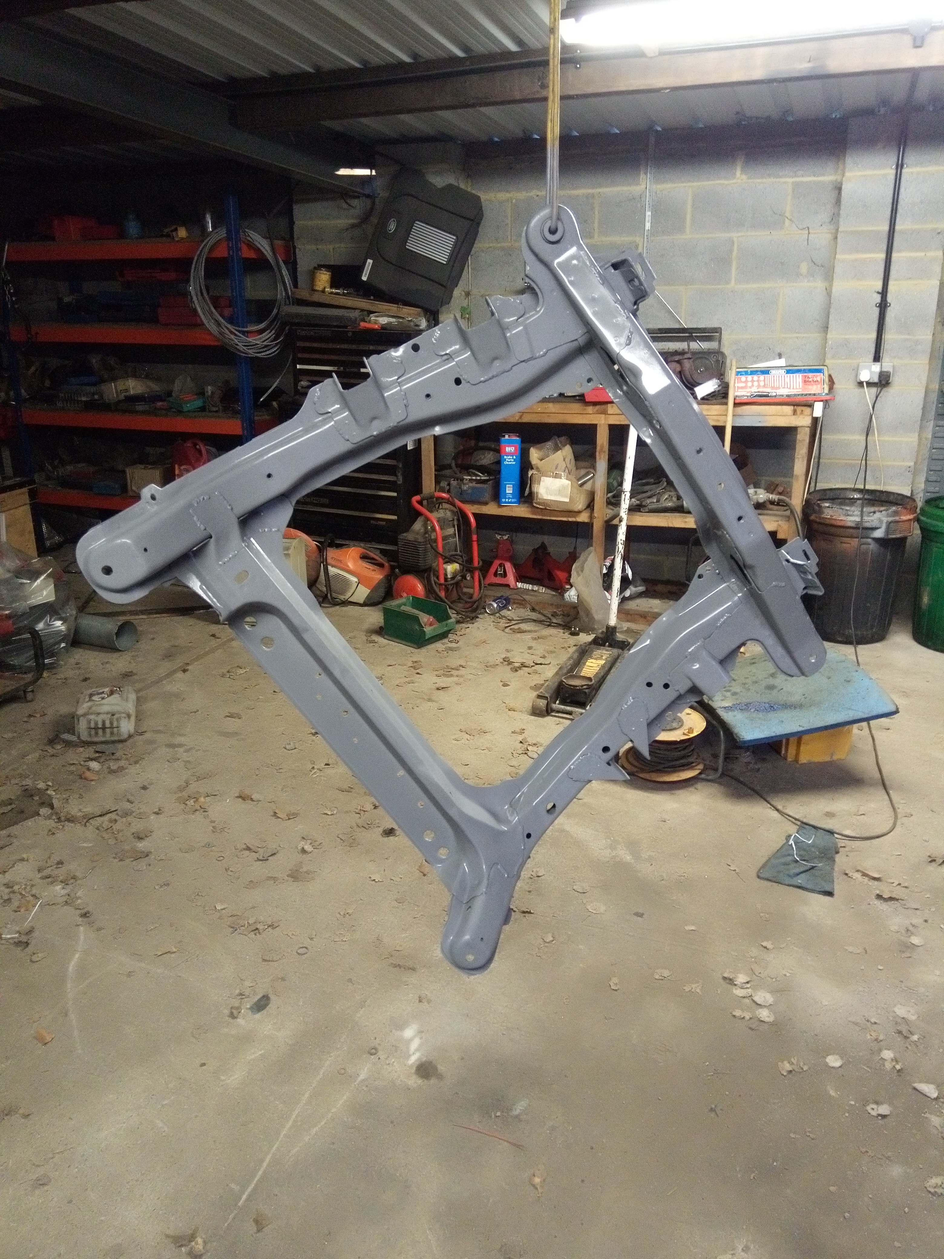

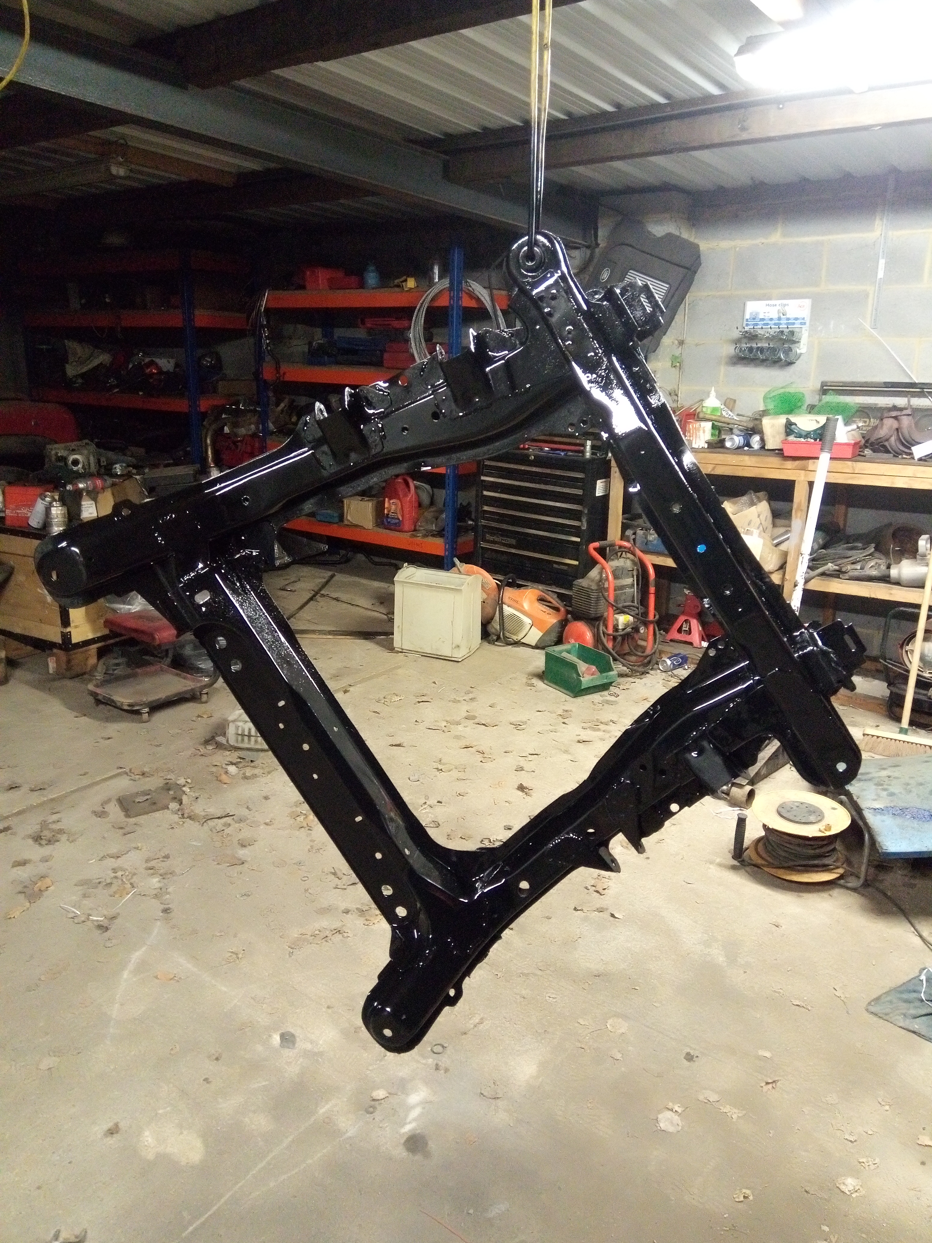

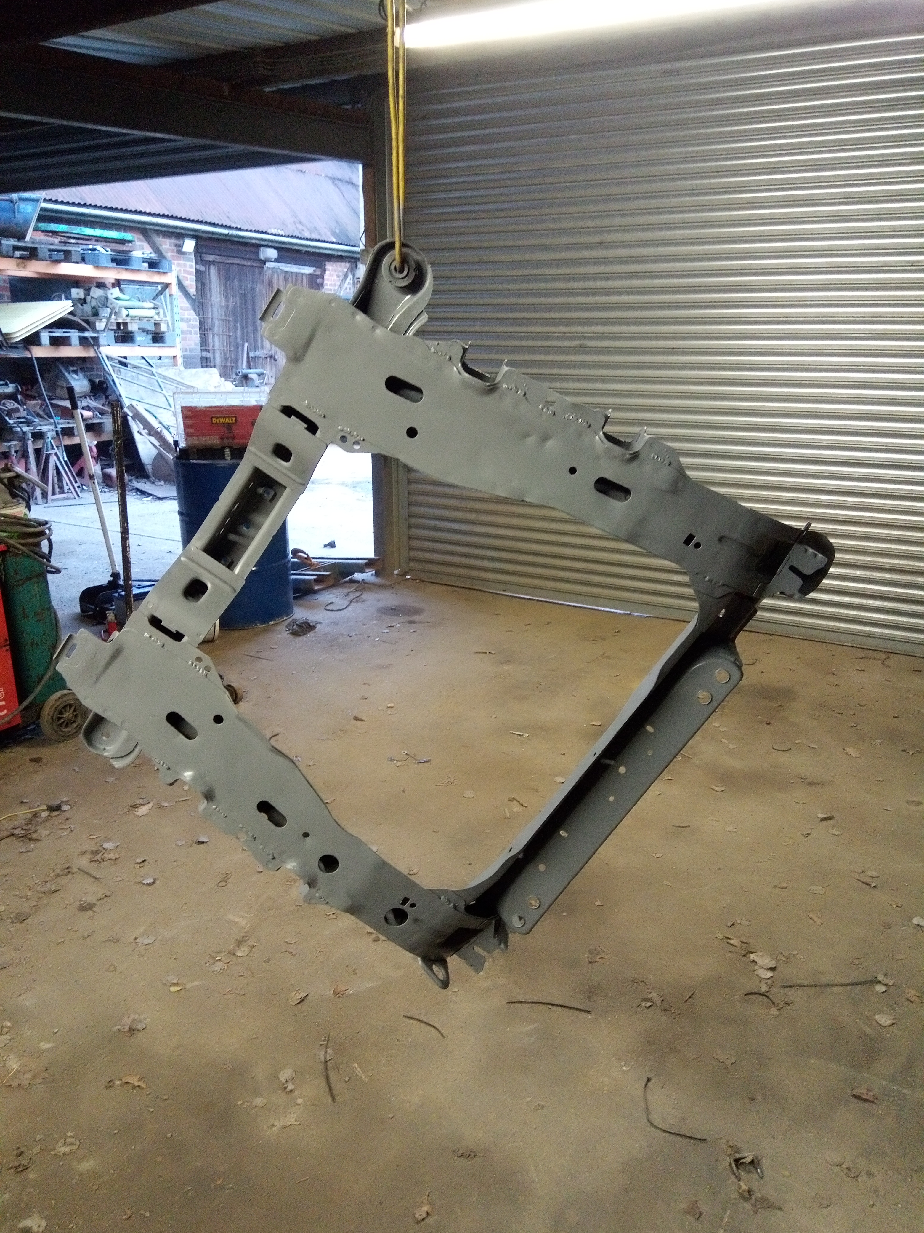

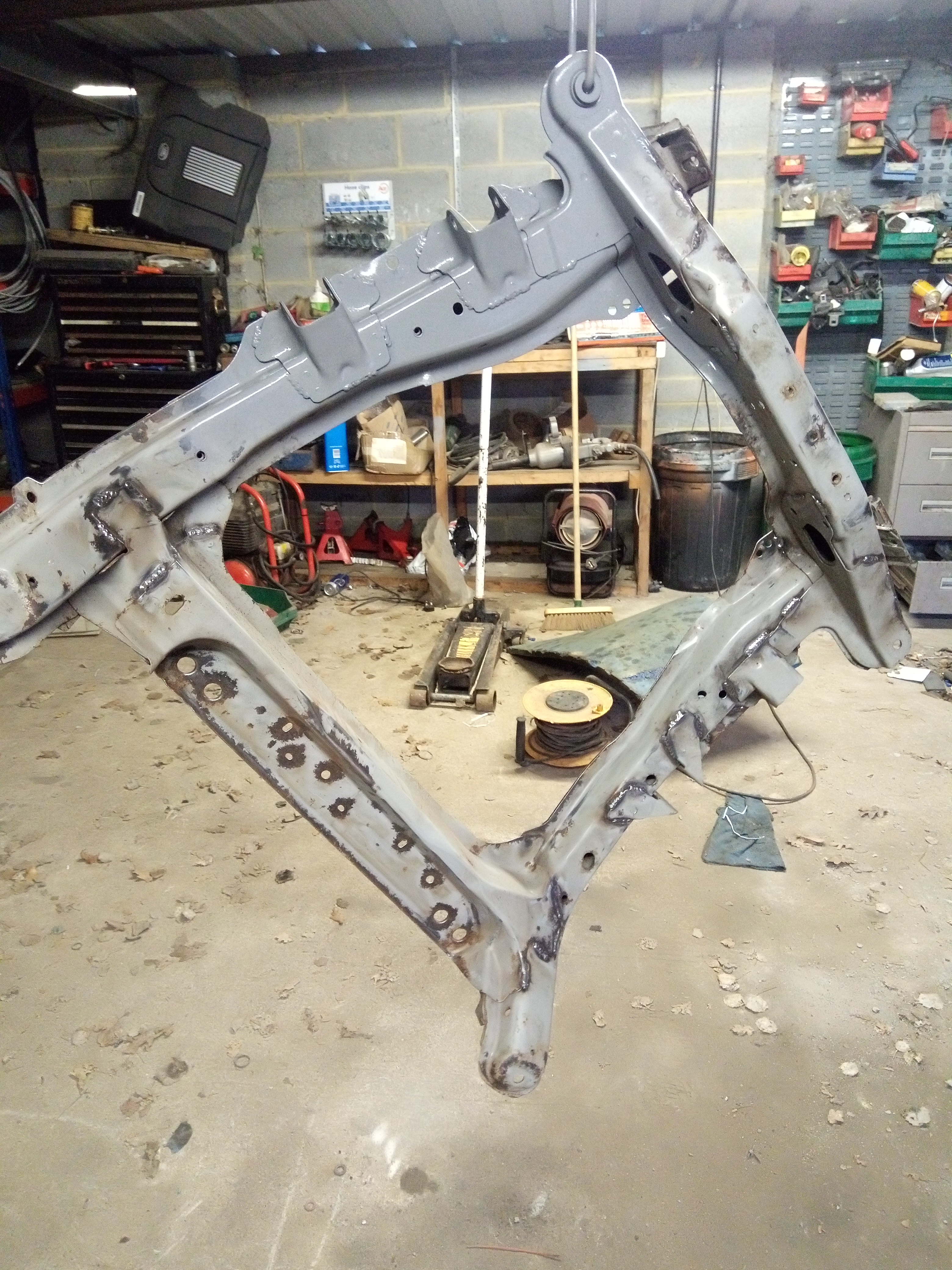

Just a little progress seam welded the subframe and painted it gloss black now I can really get on with the rest of the build
After a few more long evenings and all of today I finally got it running I had to put a live to the starter to get it to go for some reason but it goes and sounds very healthy .

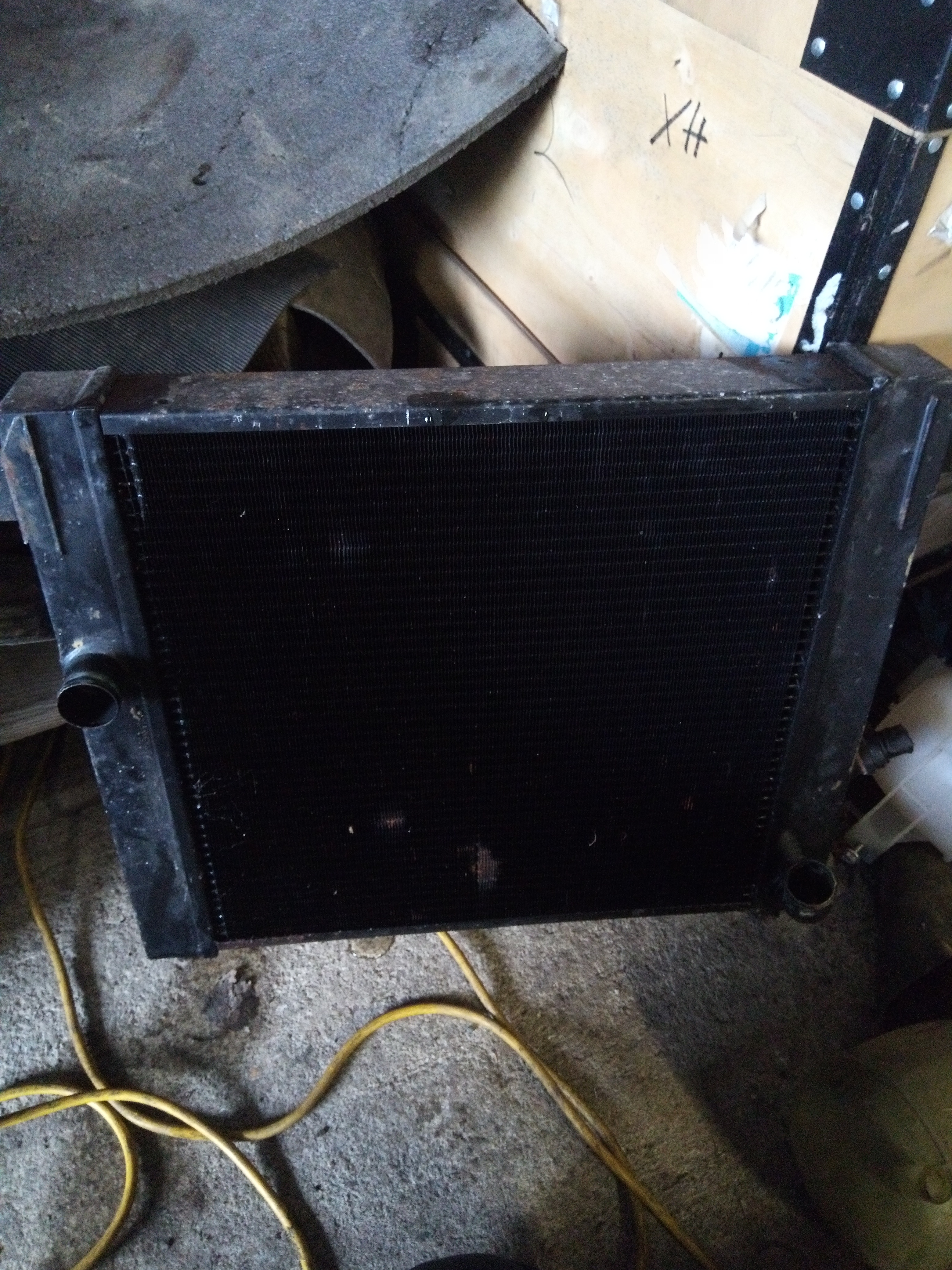

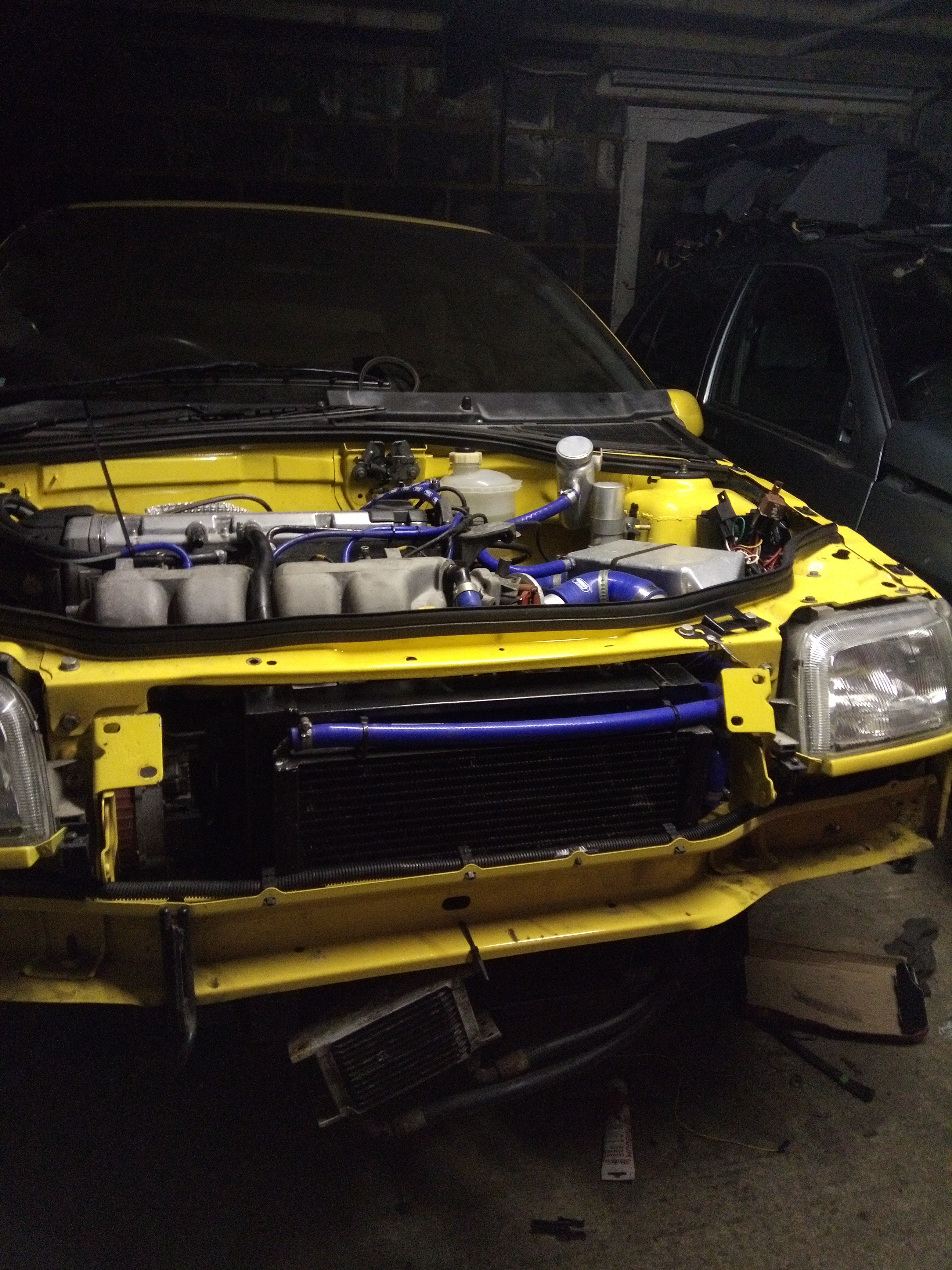

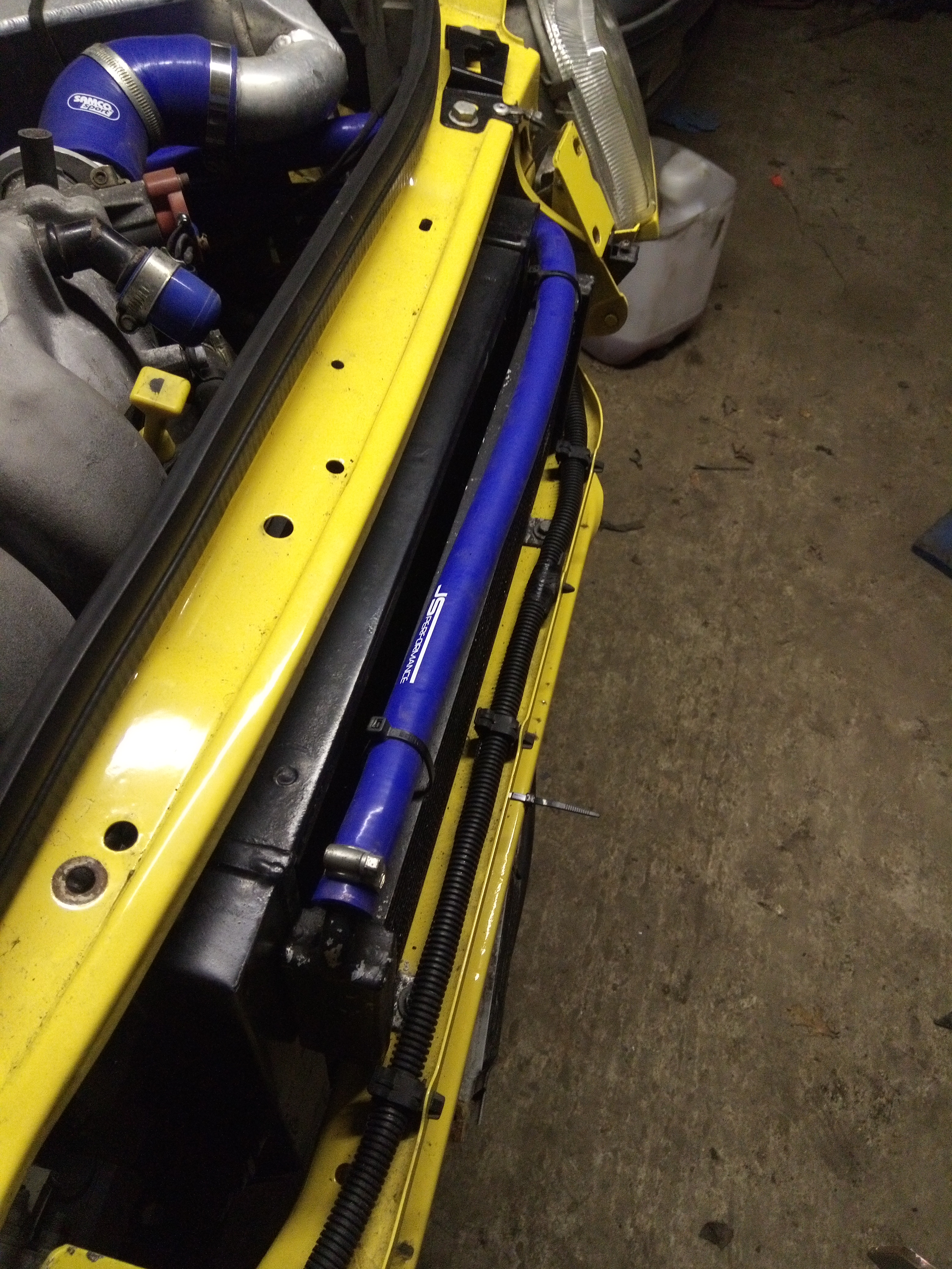

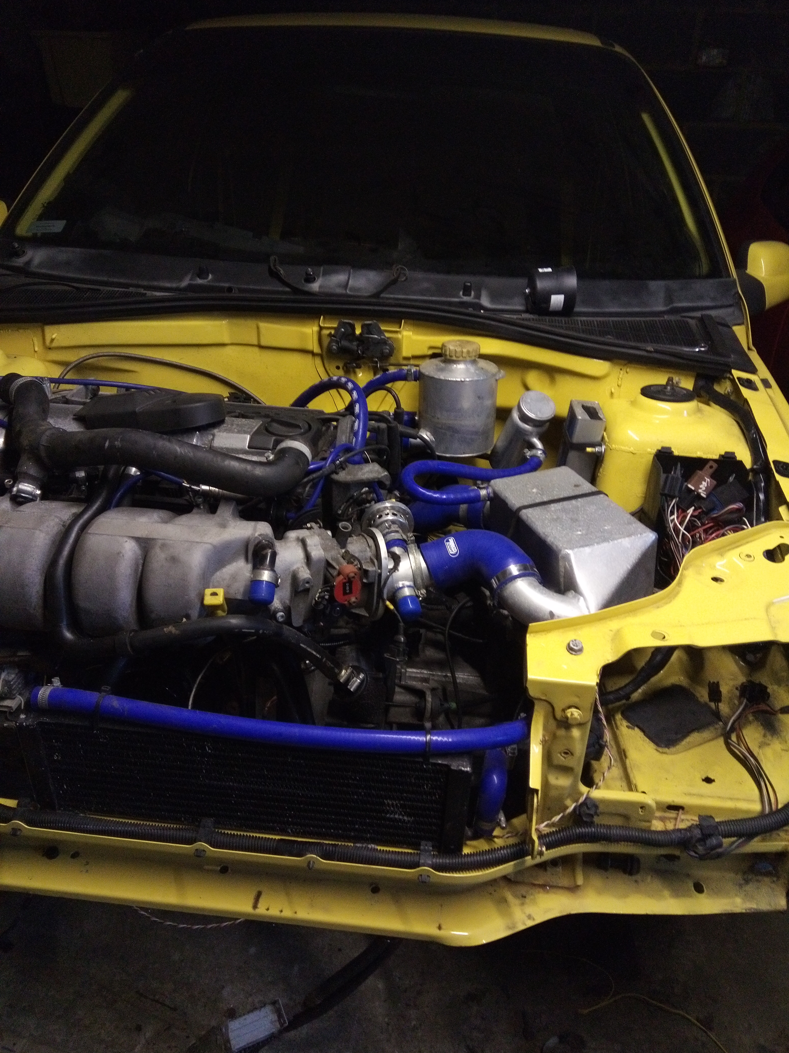

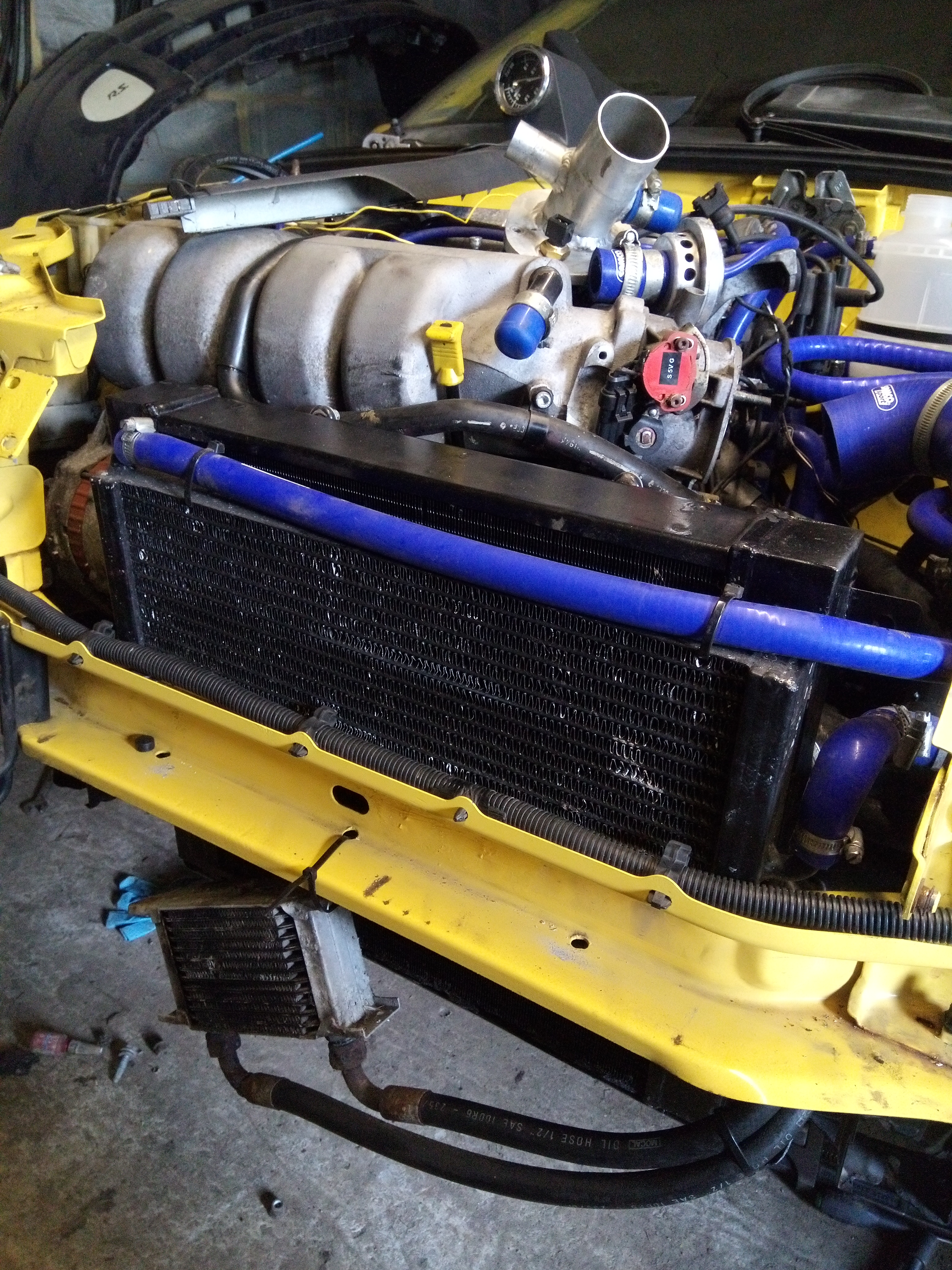

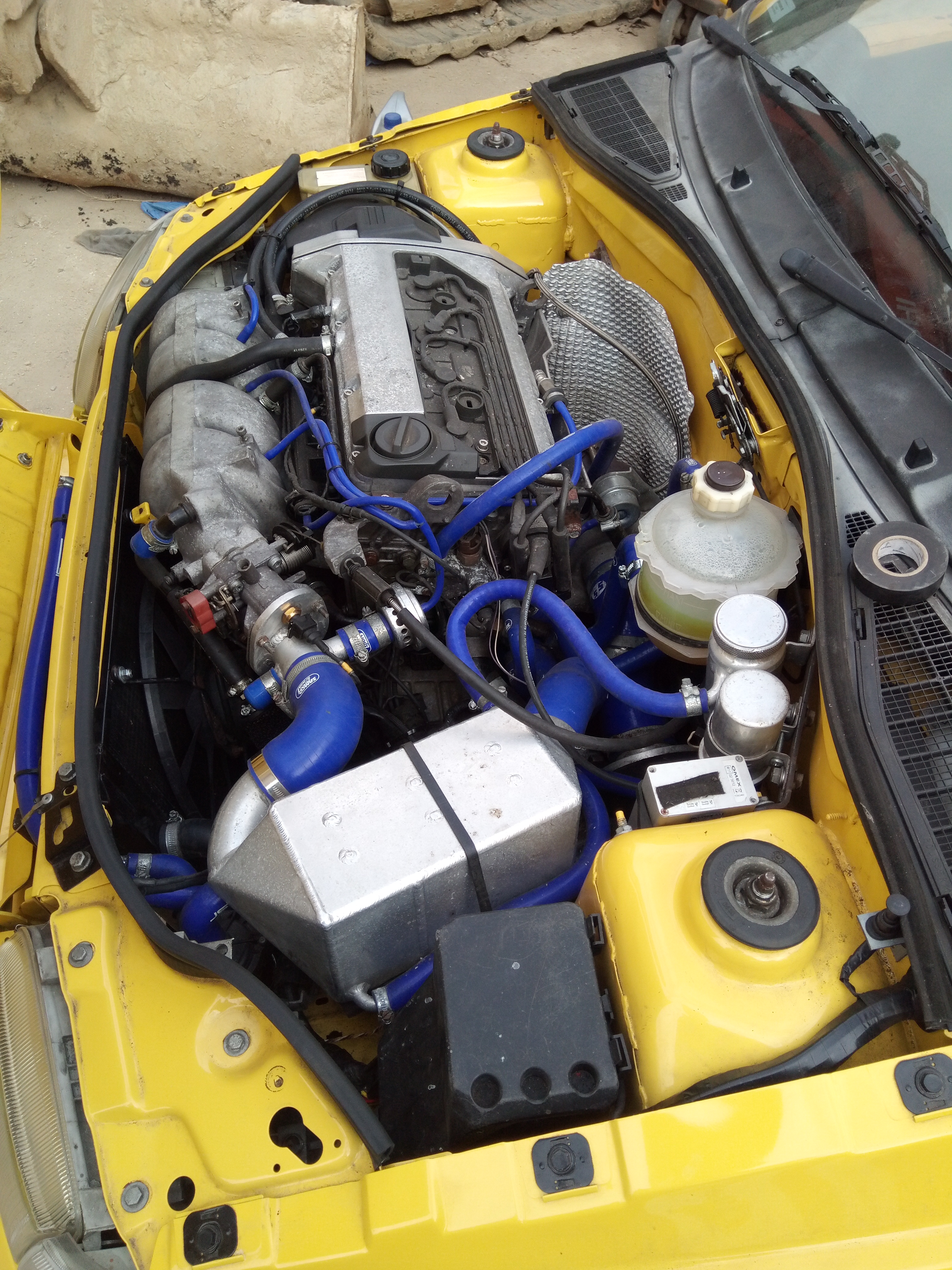

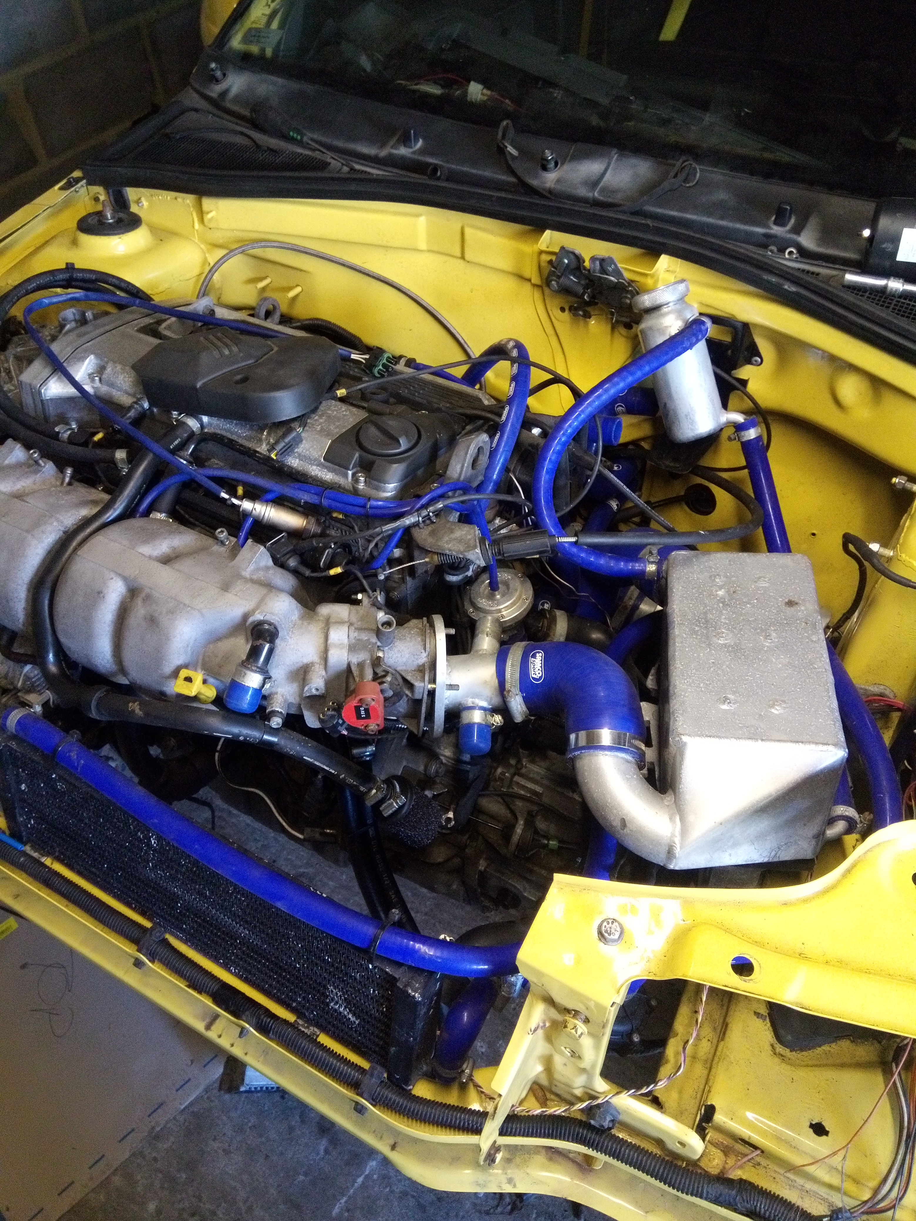

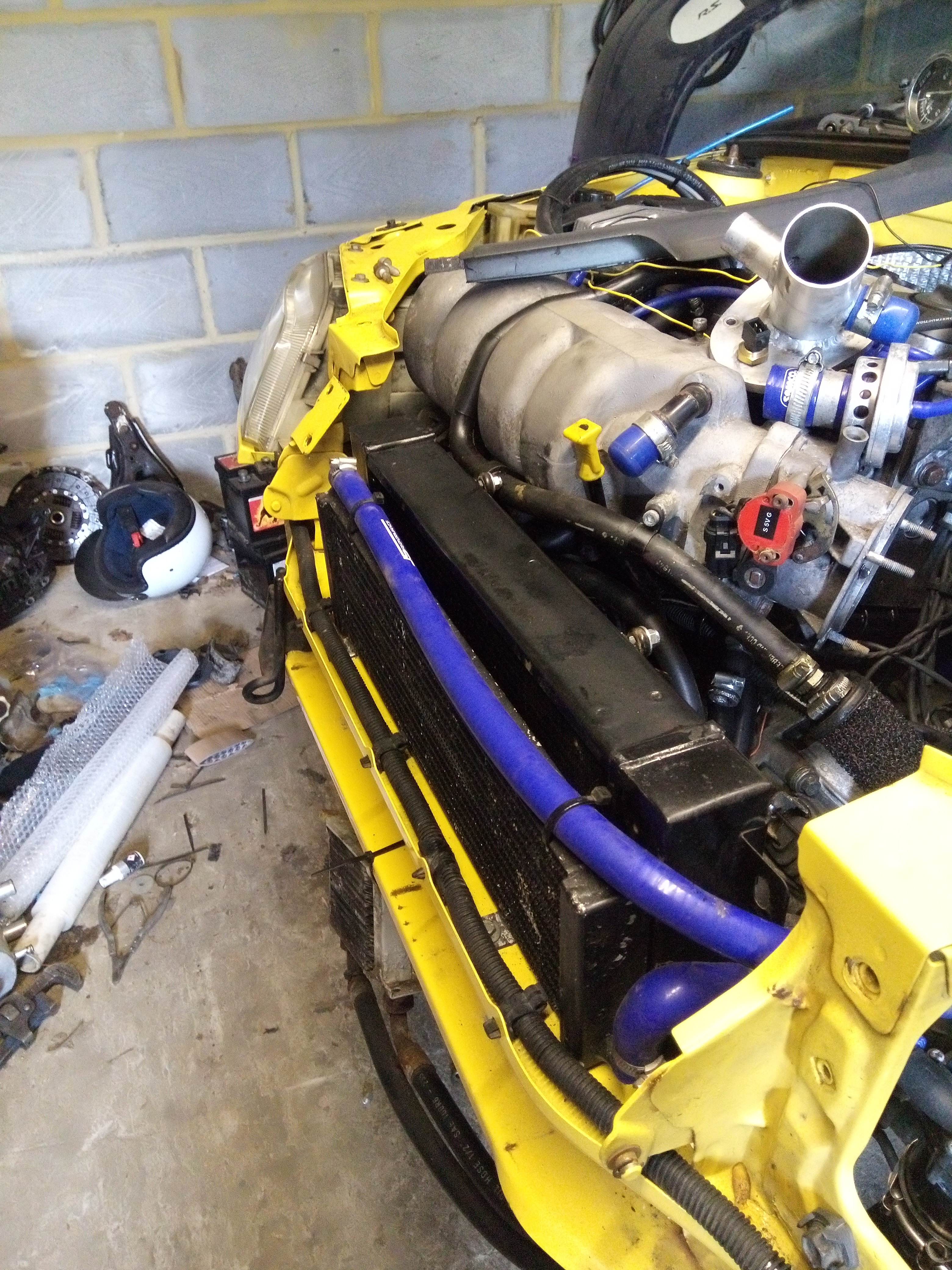

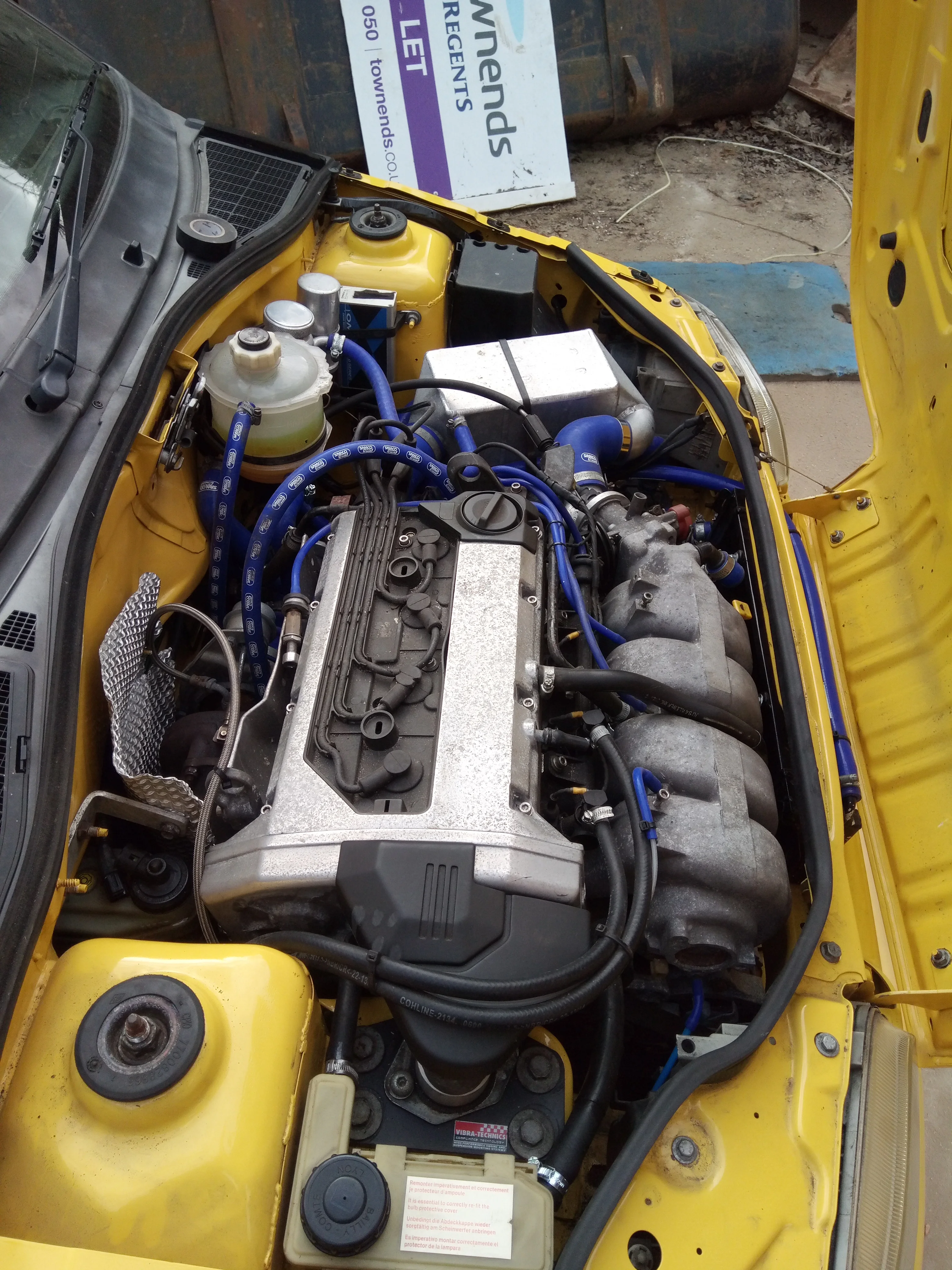

I'm chuffed with how professional the charge cooler and super fat rad look there all neat and snug .
Everything is all together now just need to make a little bracket and bleed the brakes hopefully all is well

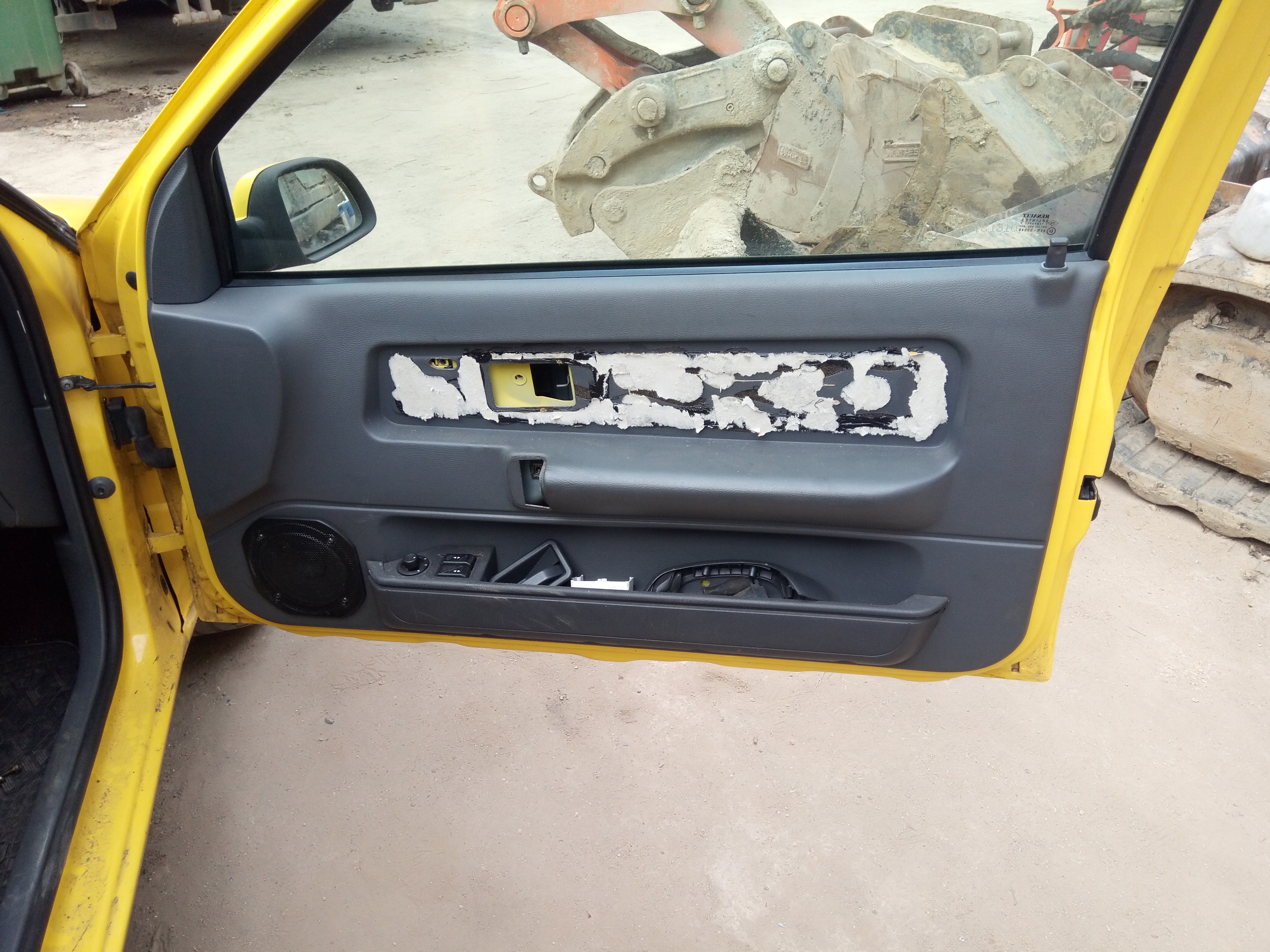

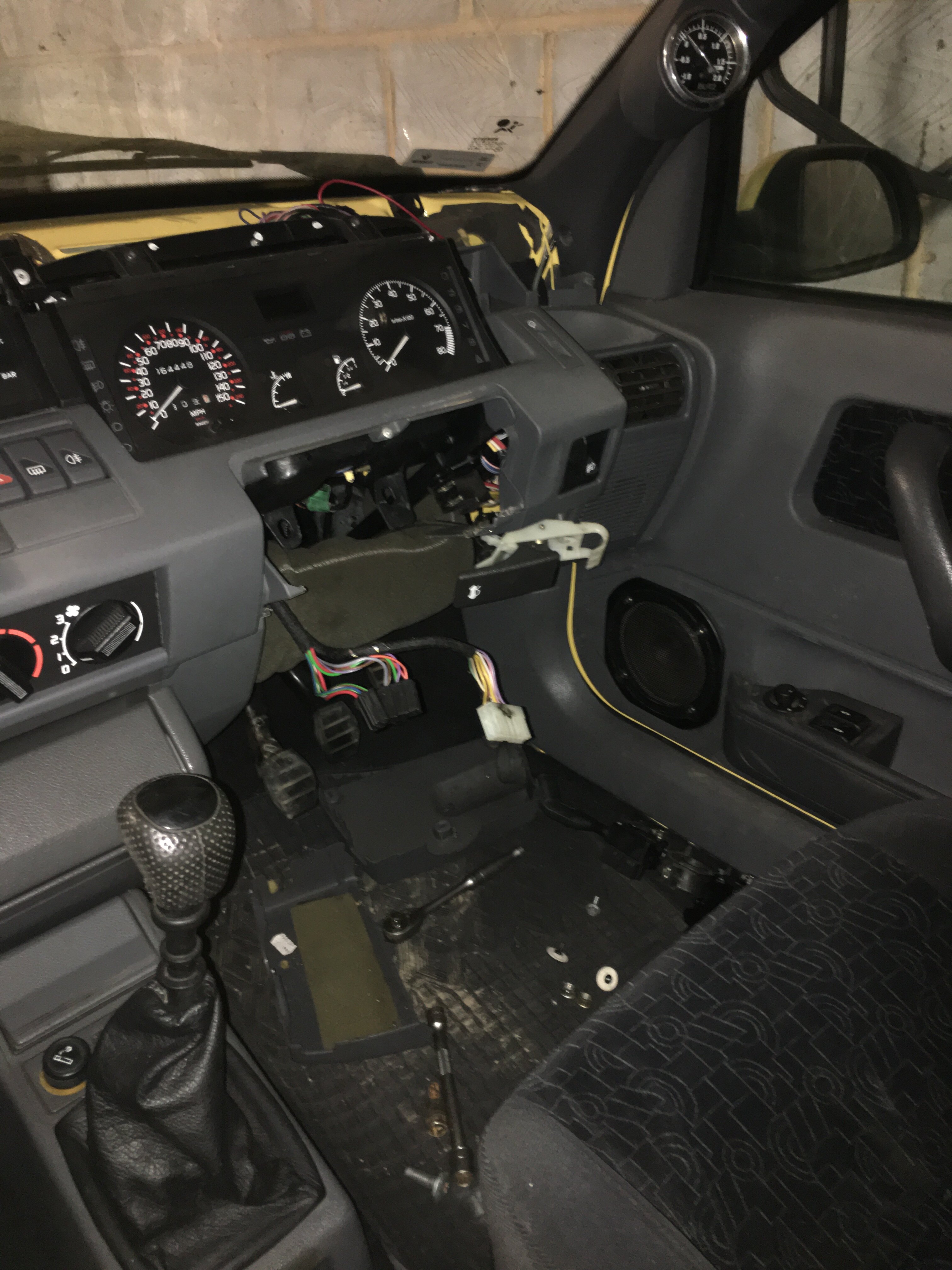

So I got the brakes bled and the door cards stuck on after changing the entire loom it turns out the one I fitted has the central locking wiring missing do after changing it last minute Saturday I now have fully working alarm and remote central locking

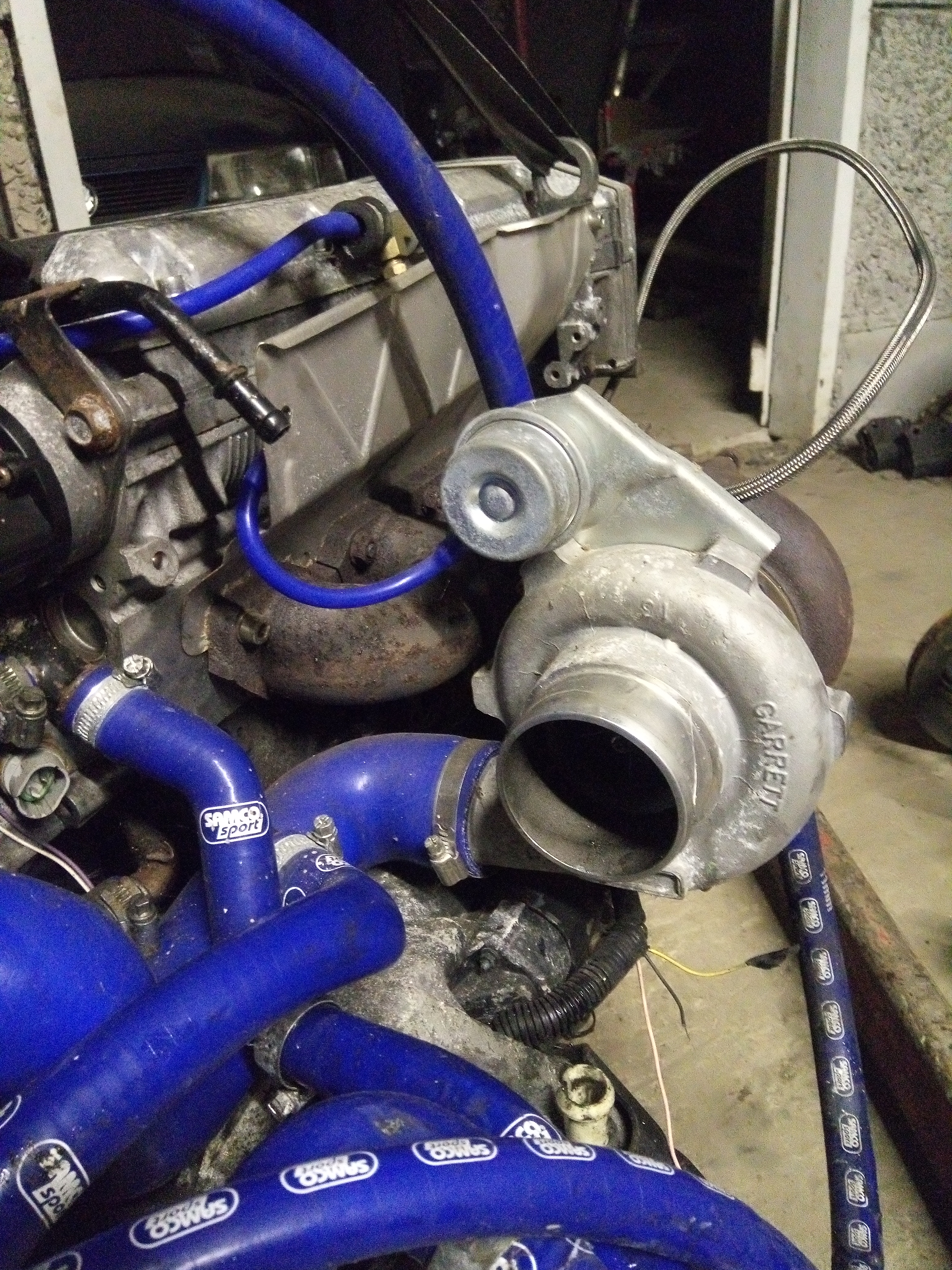

So the basic spec is a BB tunning turbo conversion modified for high boost
GT2876R turbo
Vxr injectors
Omex ECU and loom
Fully forged
Charge cooler
Triple core rad
During mapping it made 306 bhp and 274 lbft I'll be getting that checked very soon

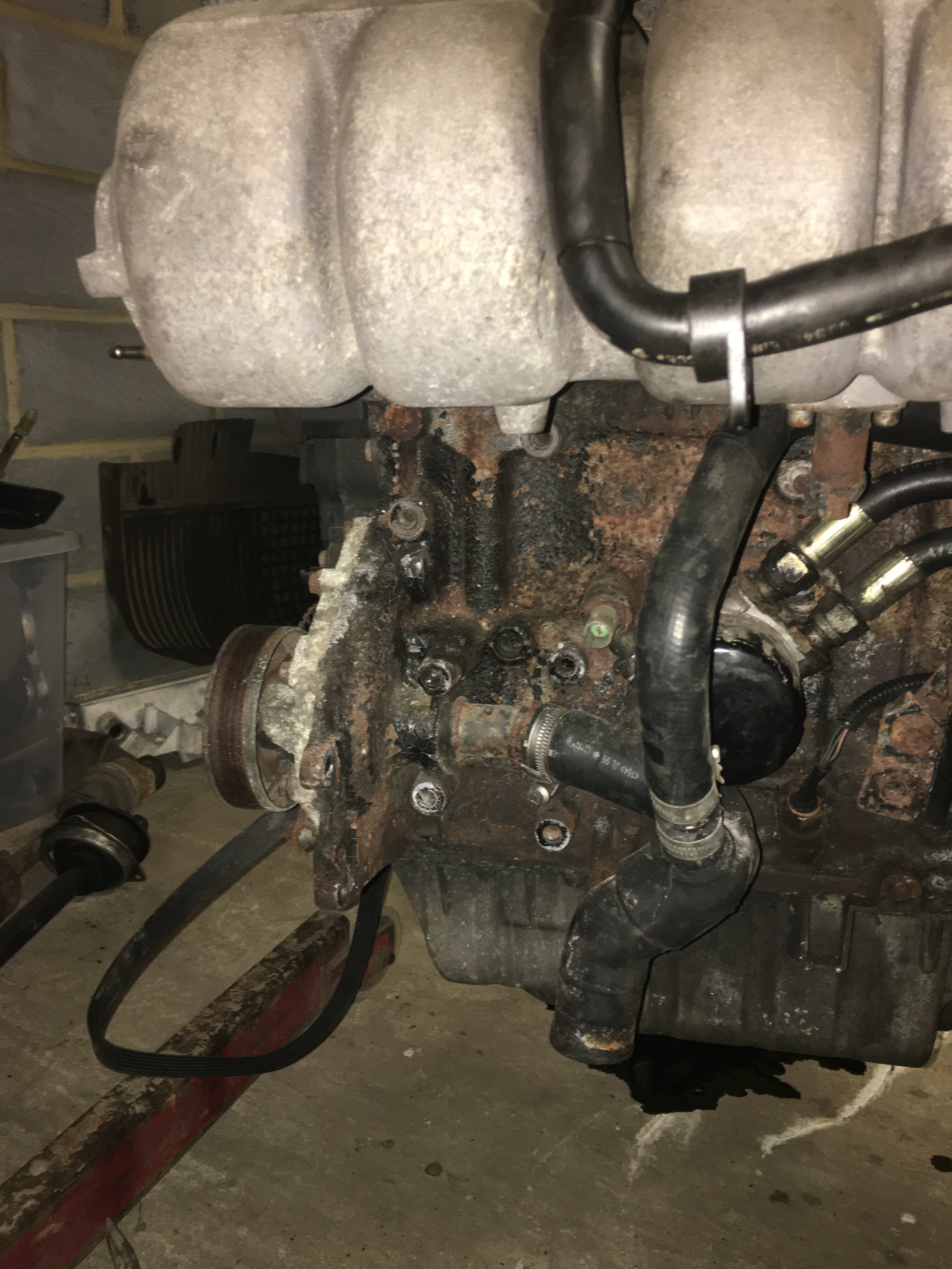

So after just a few short days on the road it's back in bits popped a core plug out that could be a sign of a cracked block pressurising the coolant system but I really hope not anyway I'll put it back together with a new one 🤞 give me a good opportunity to change the clutch fork for the longer 172 item to give it a bit more driveability sorry about the awful picture quality

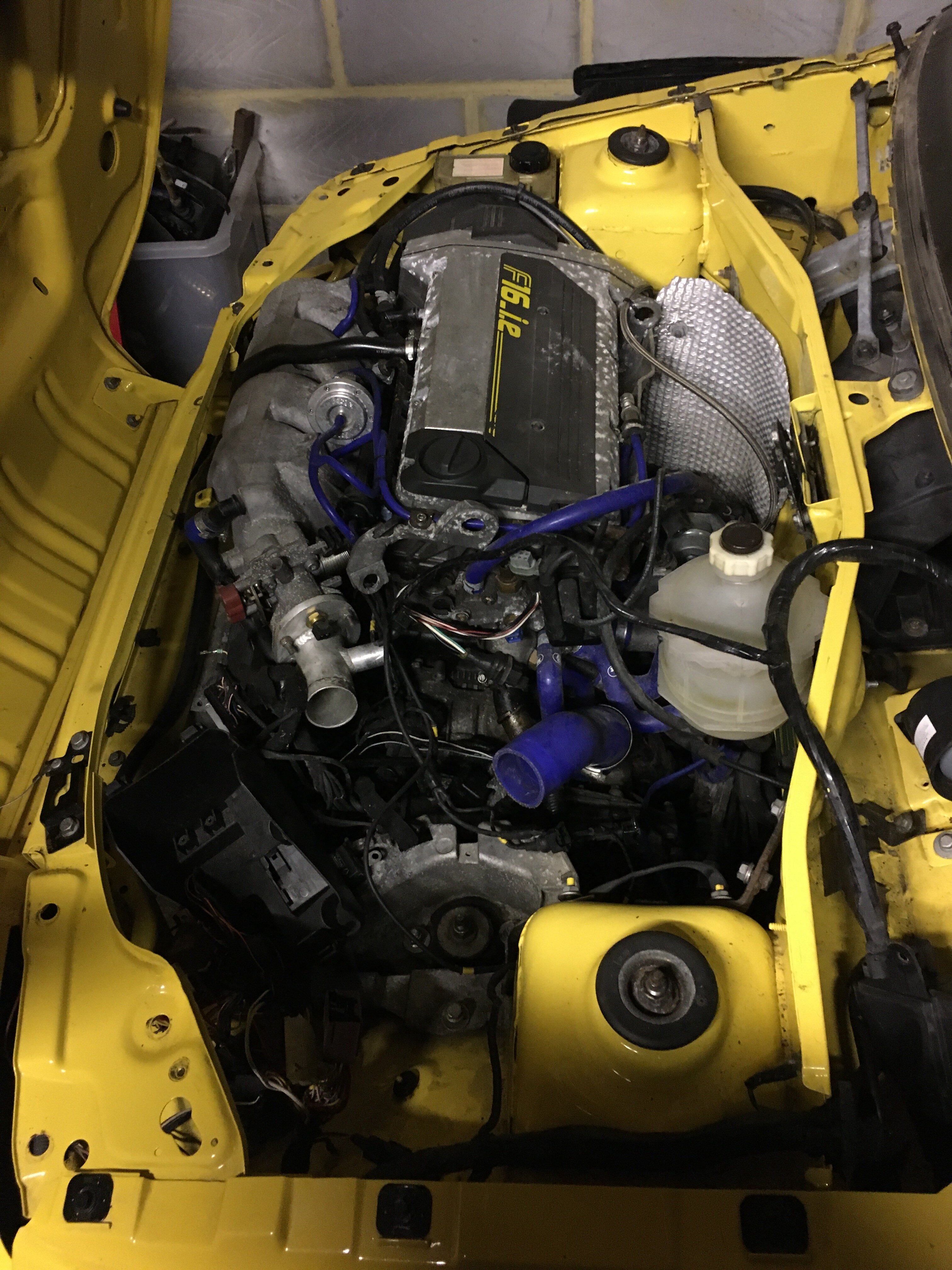

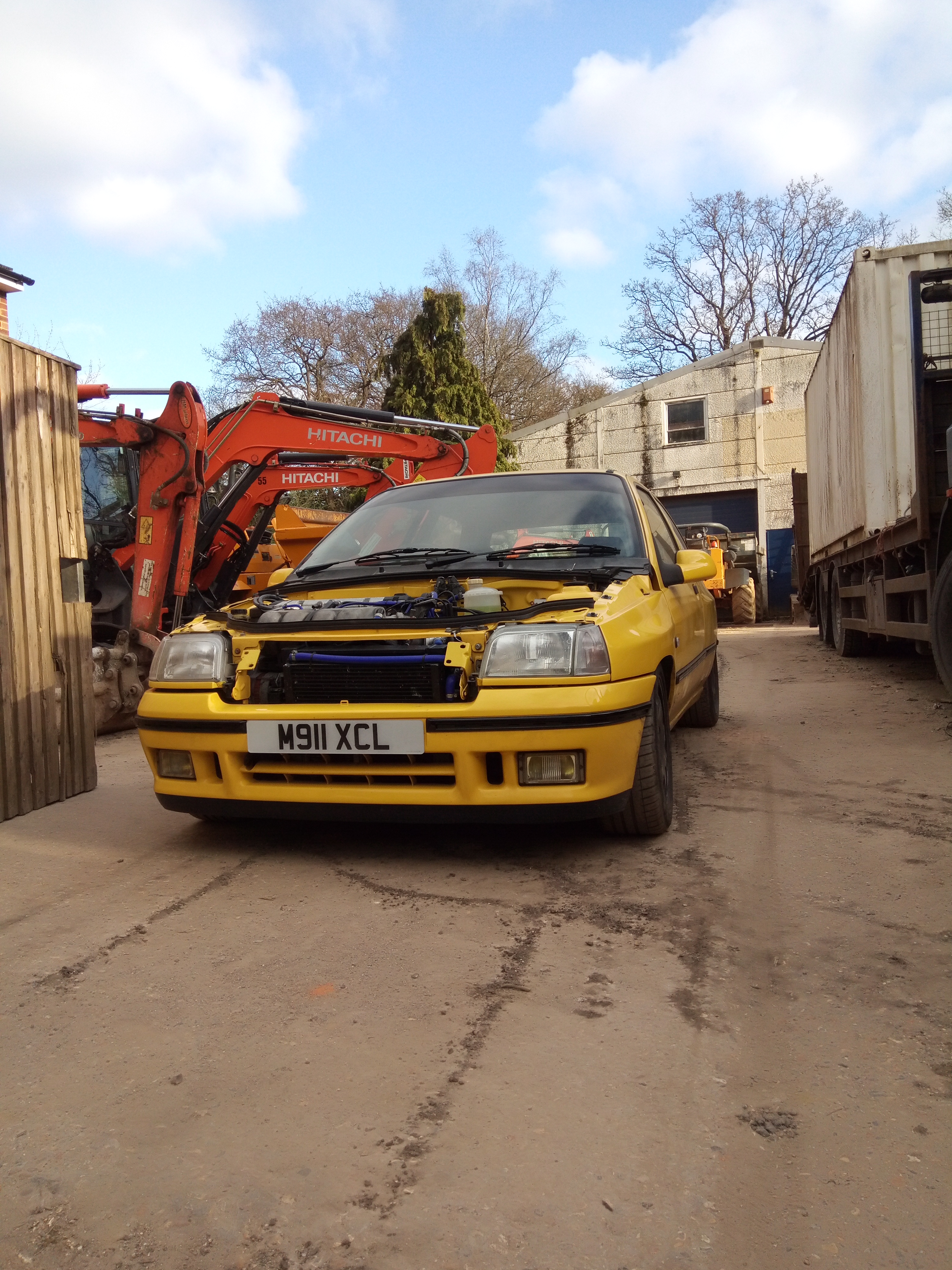

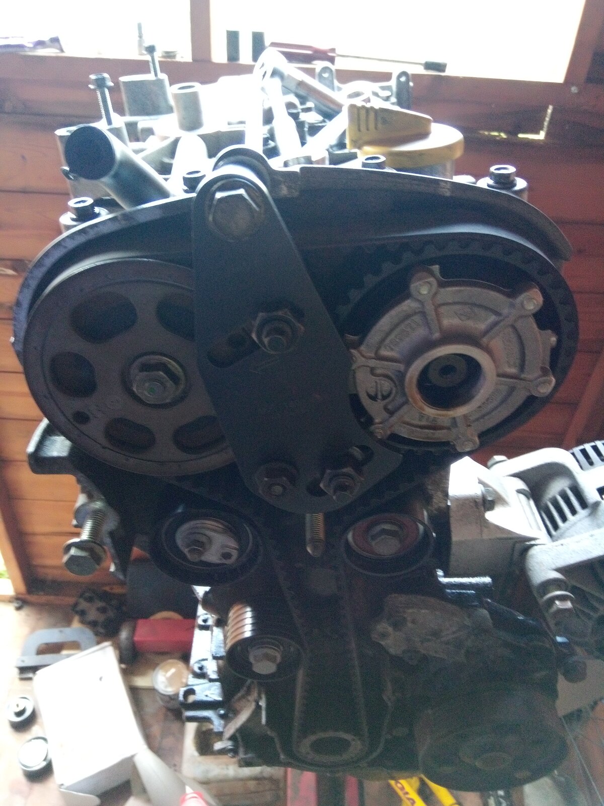

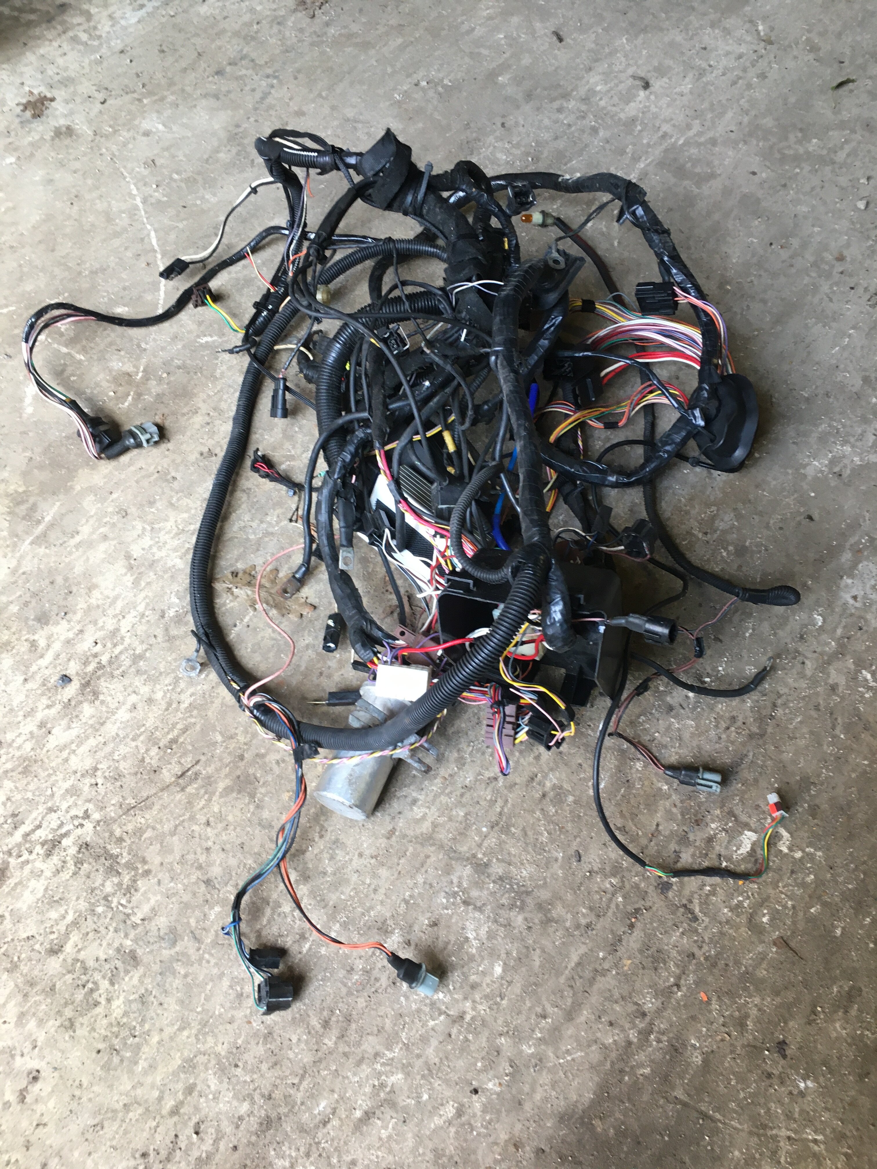

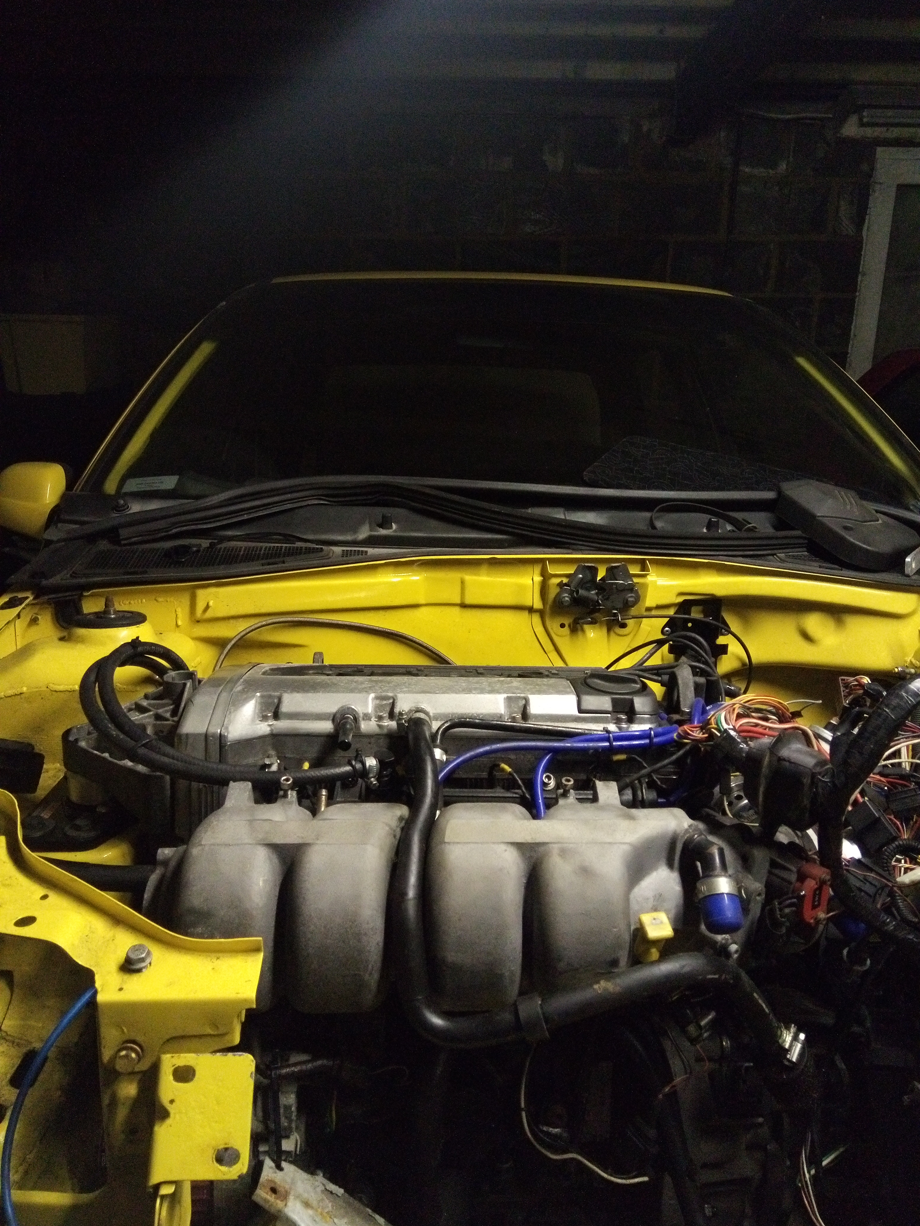

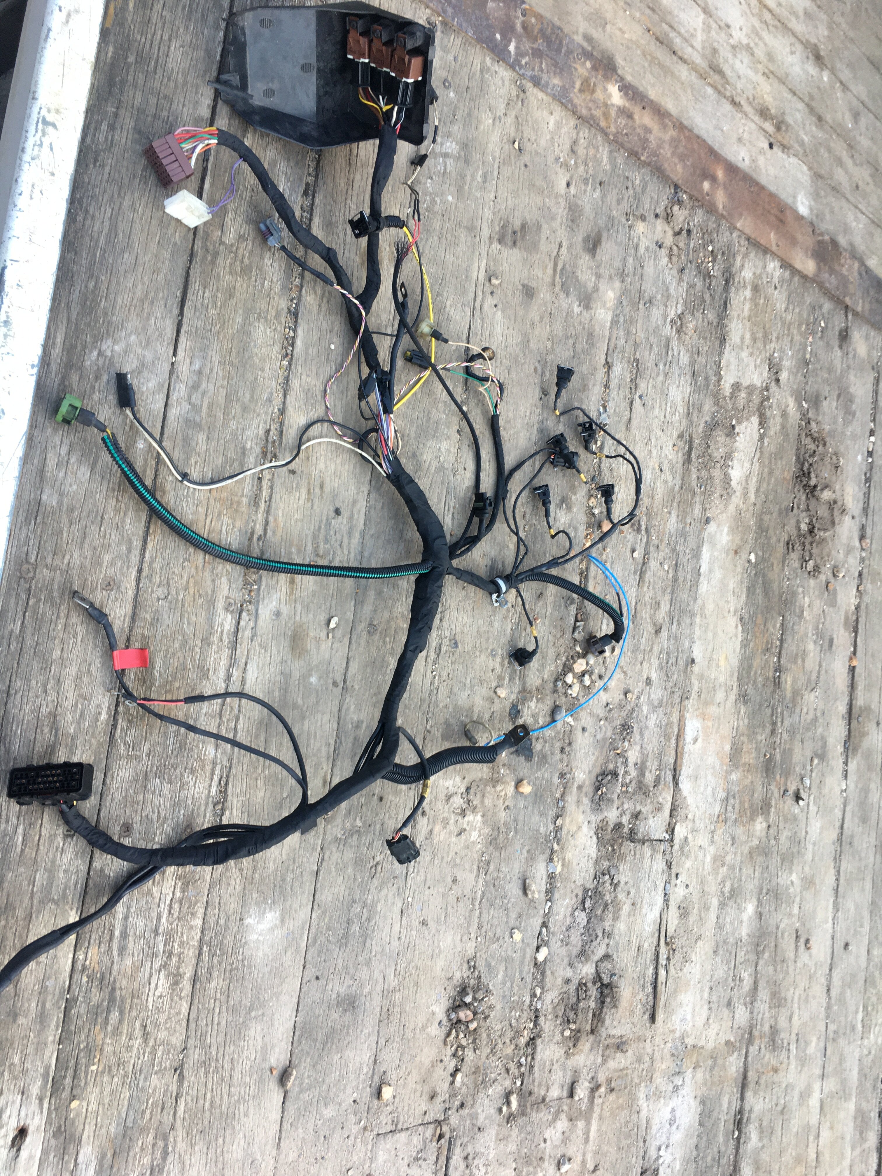

After an exceptionally busy three months of being back in the uk I finally found time to start work on the turbo valver I started with the wiring loom. I was never happy with the loom it is extremely messy and bulky essentially two looms cable tied together badly . So the plan is to strip it right back loose everything I don’t need keep everything I do repair and modify accordingly.

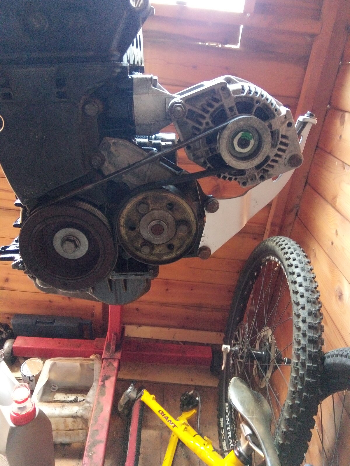

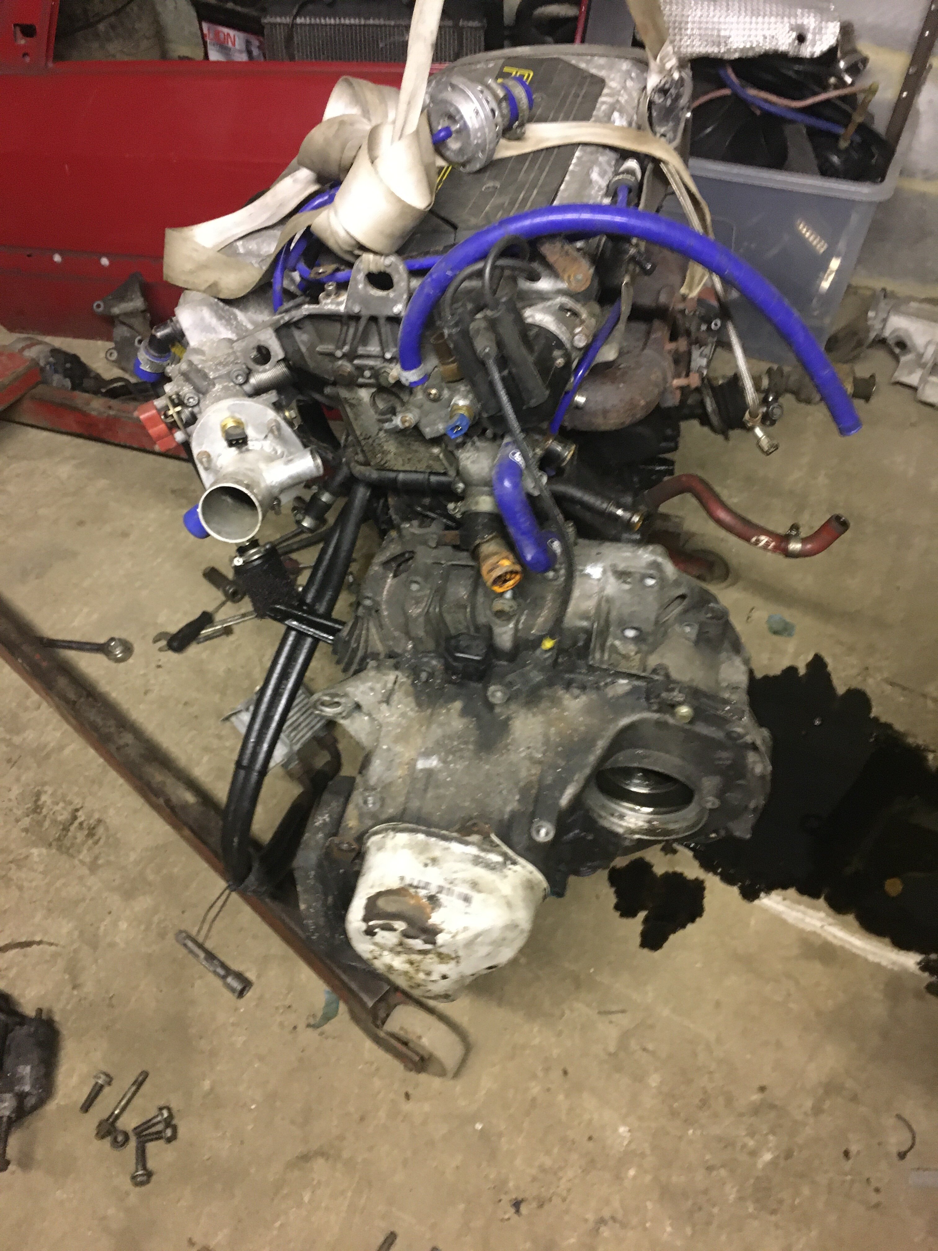

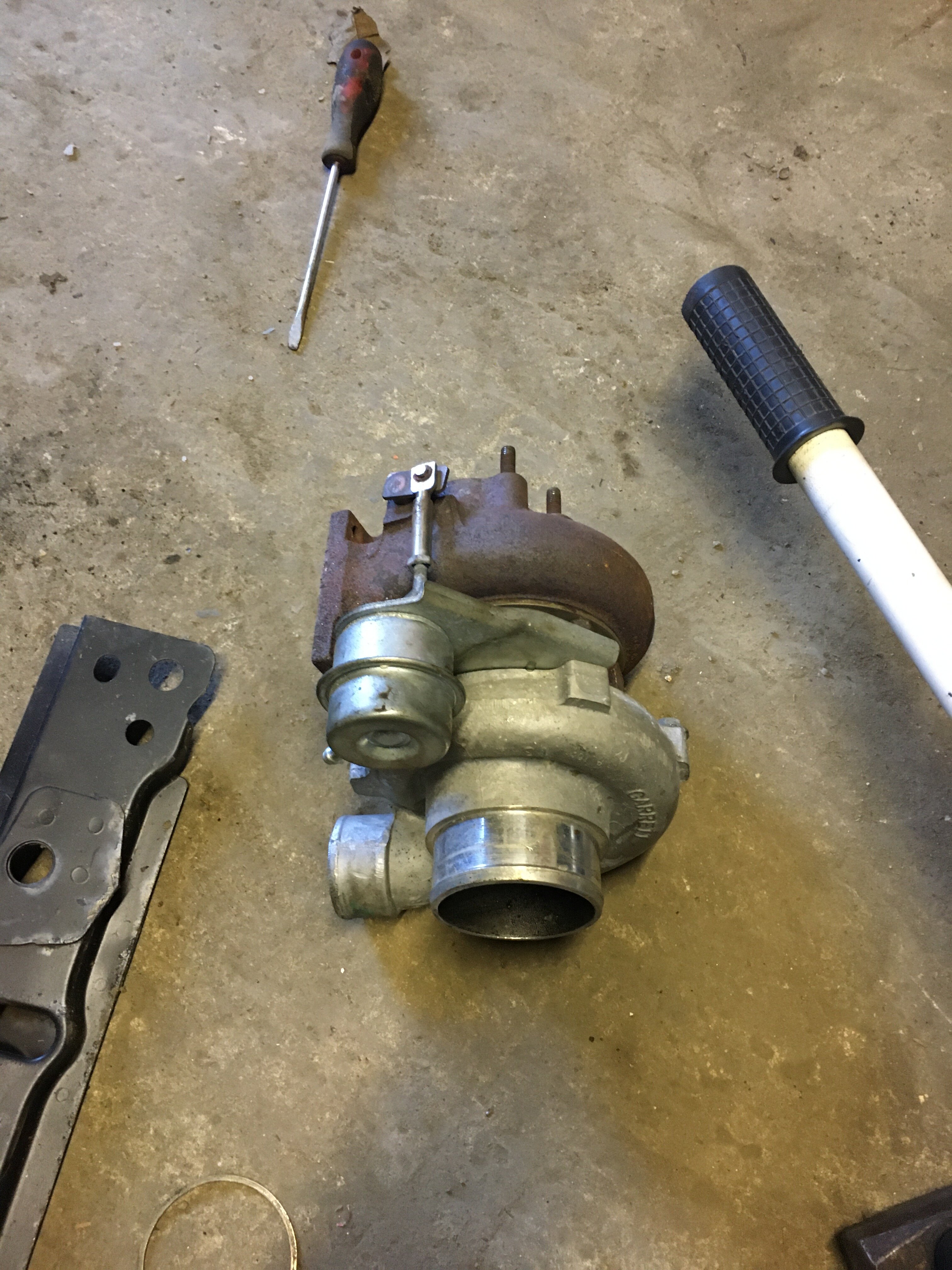

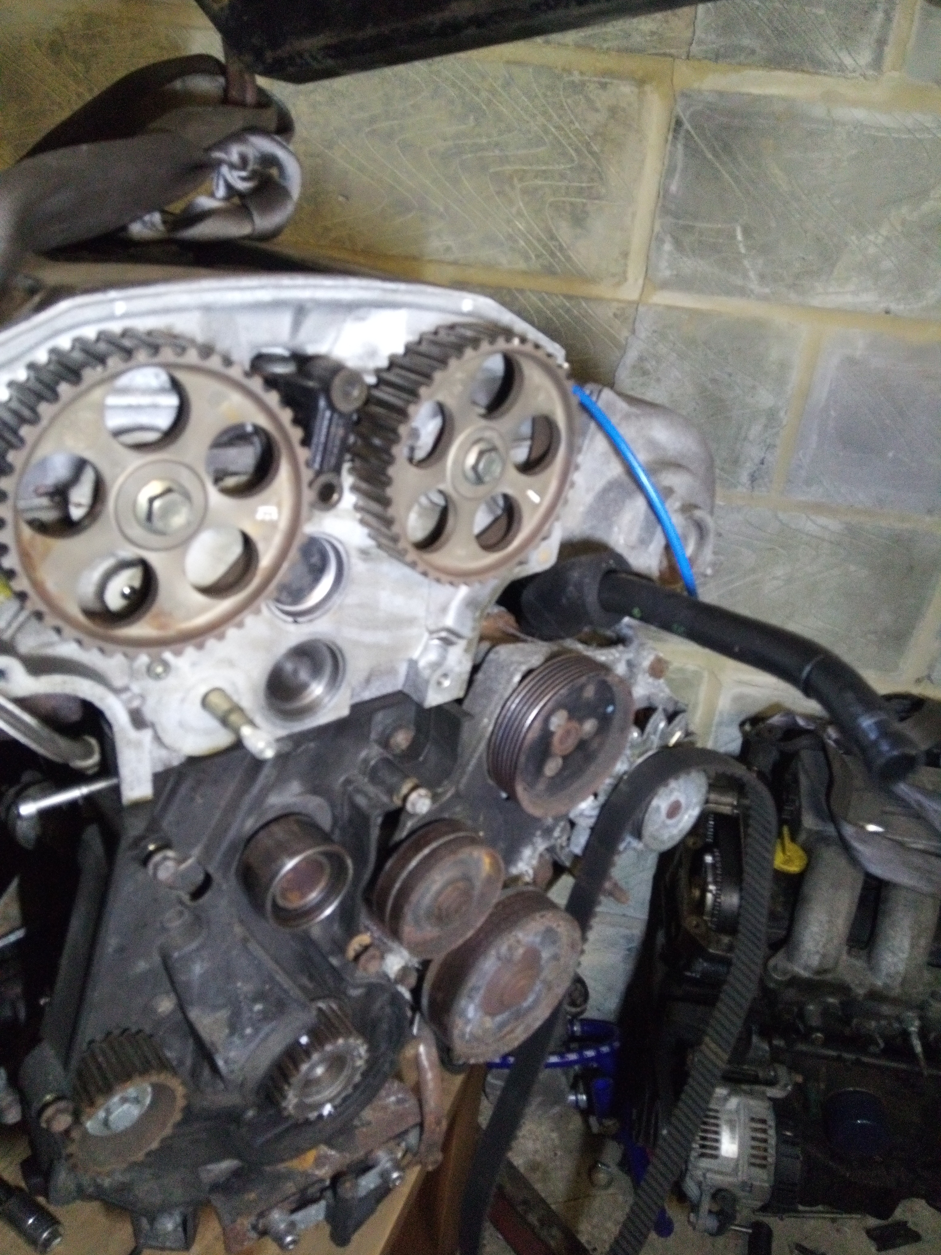

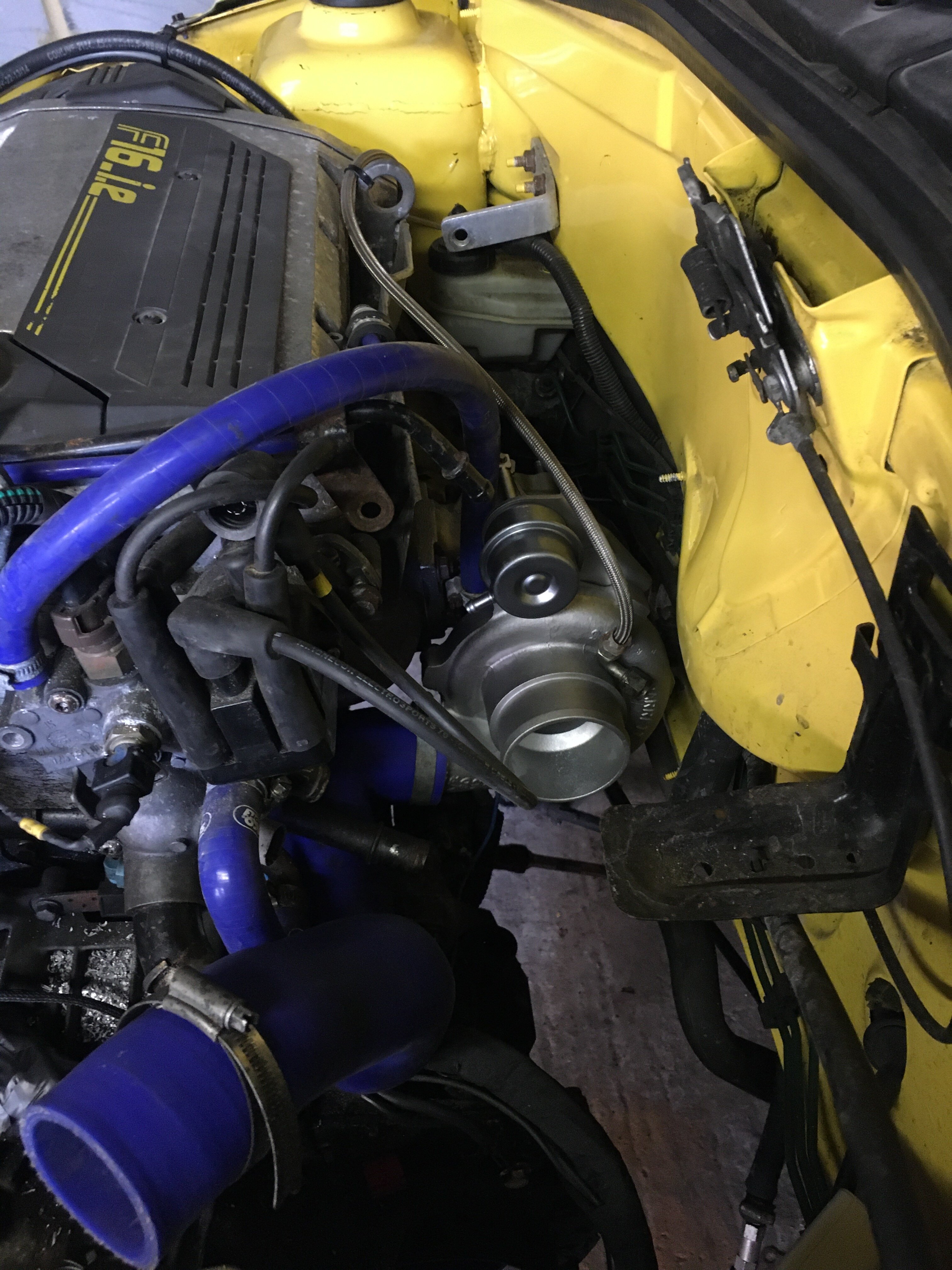

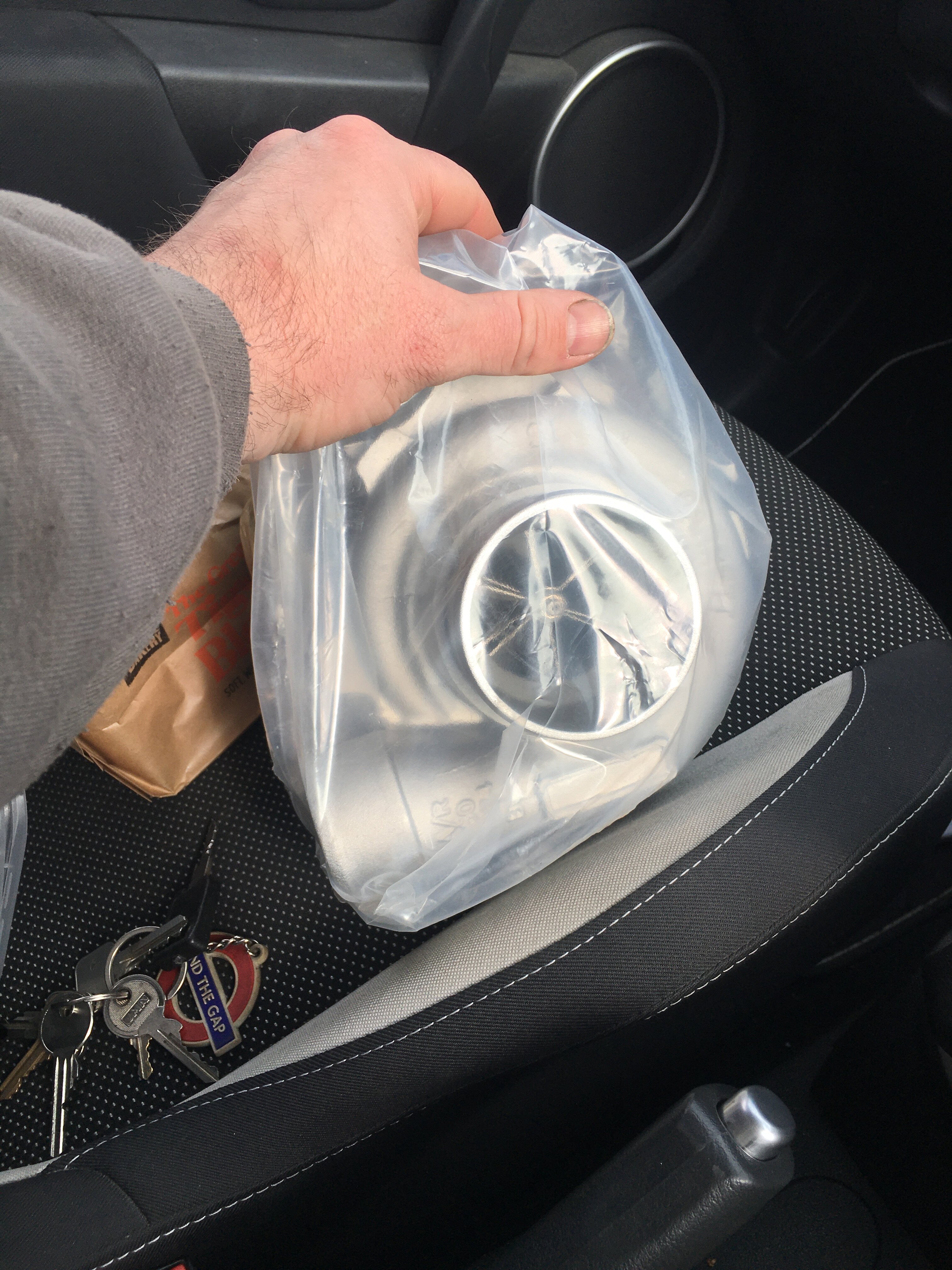

Finally got round to getting the turbo off should have done it weeks ago really but no matter it’s been sent off for a rebuild

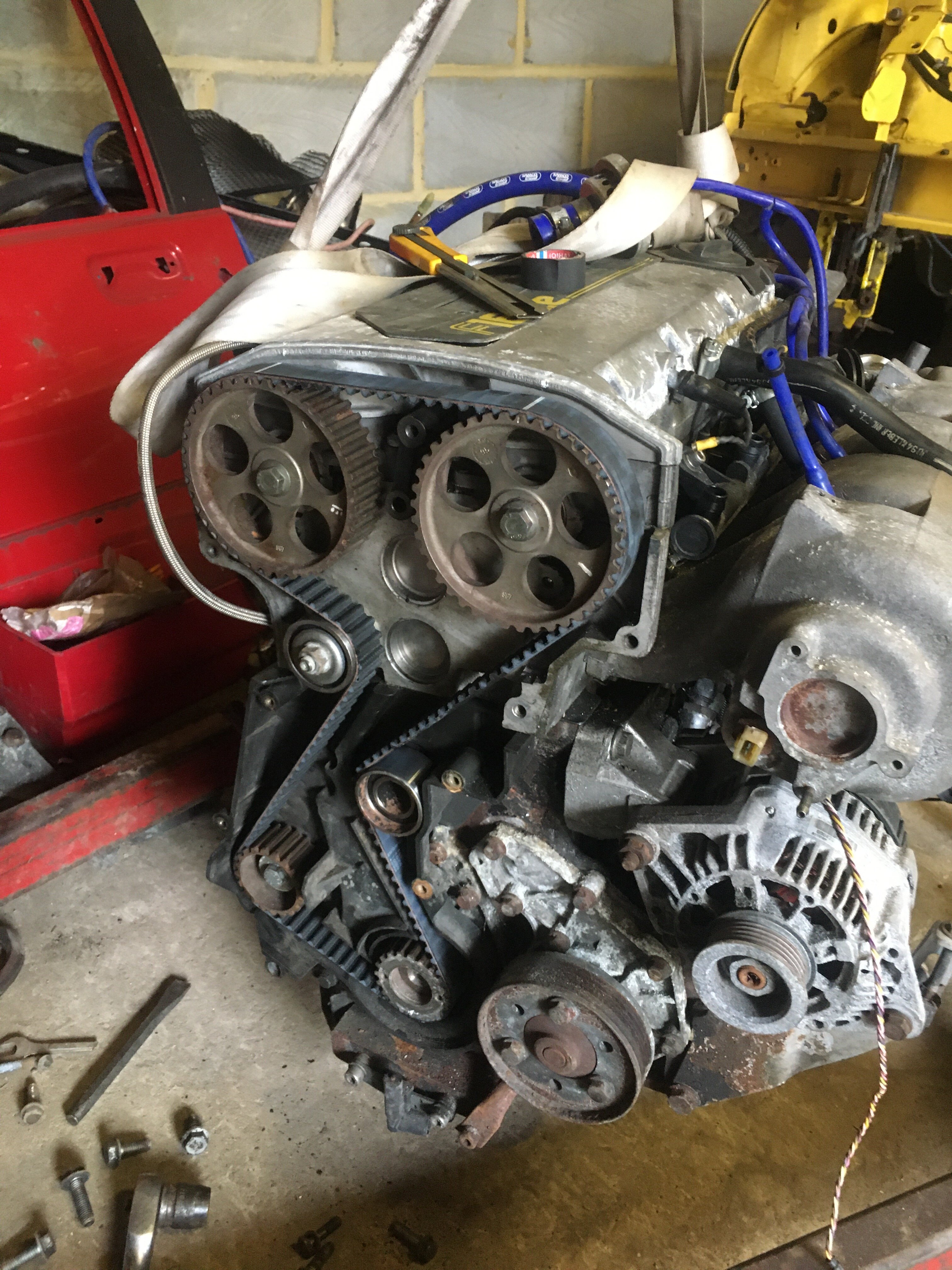

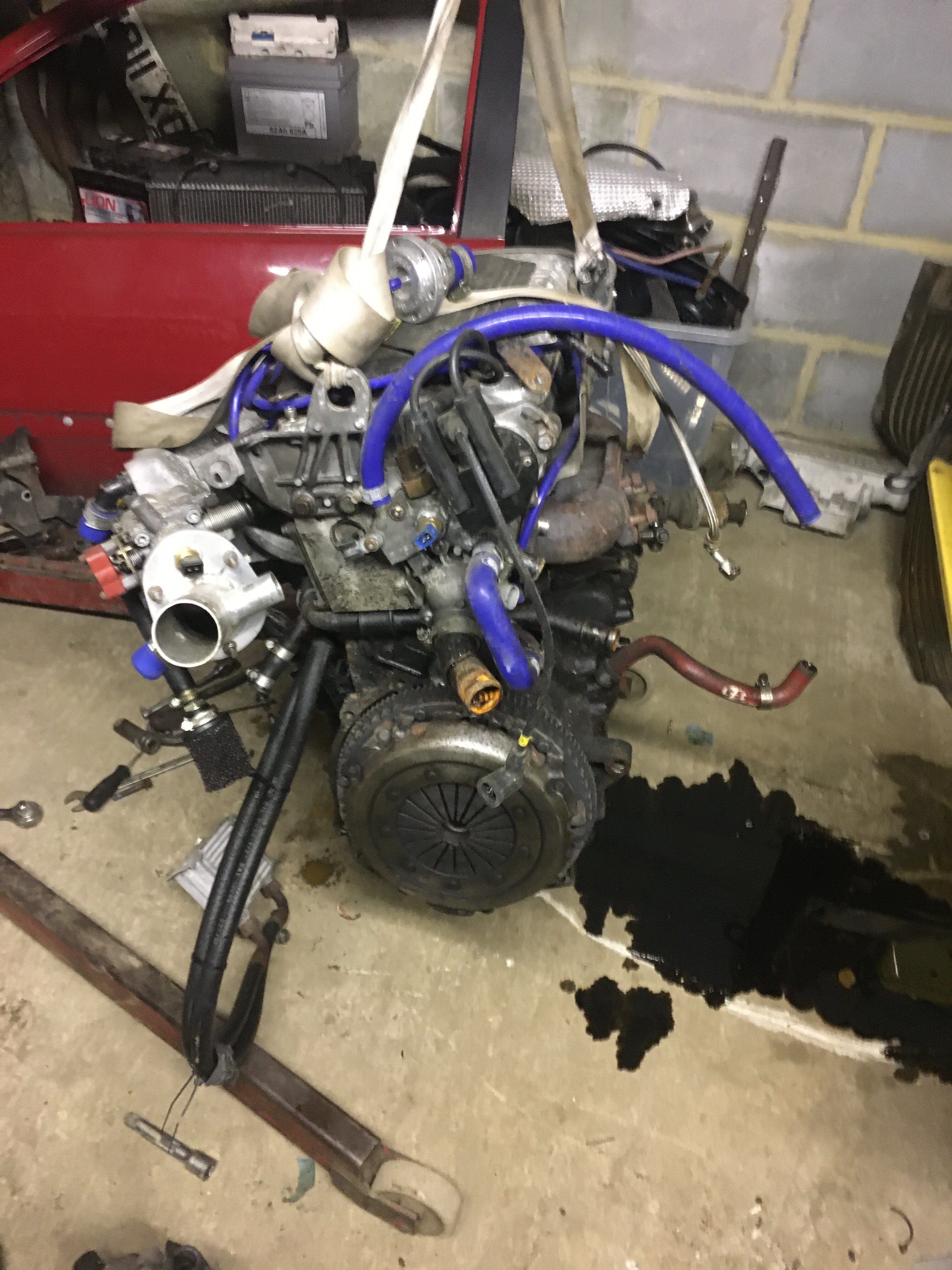

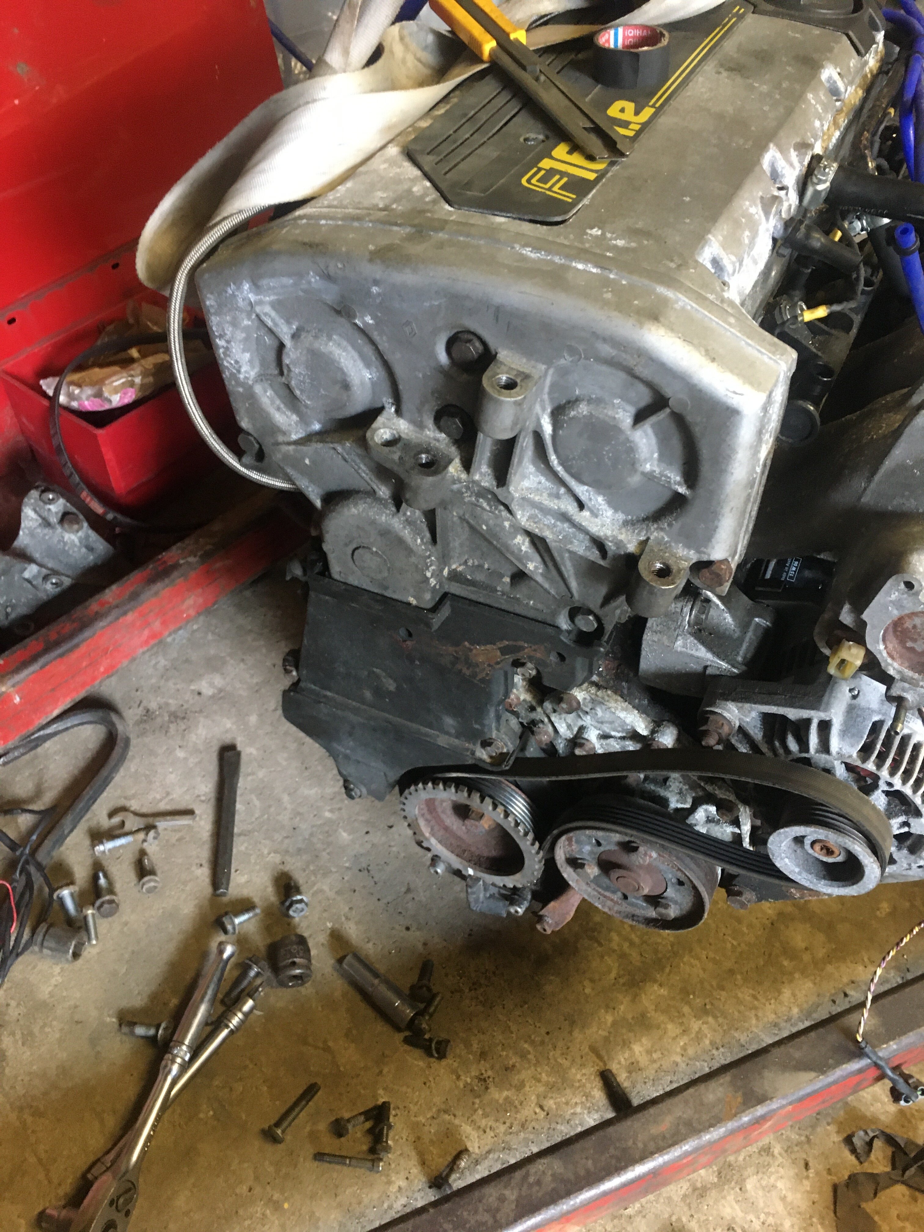

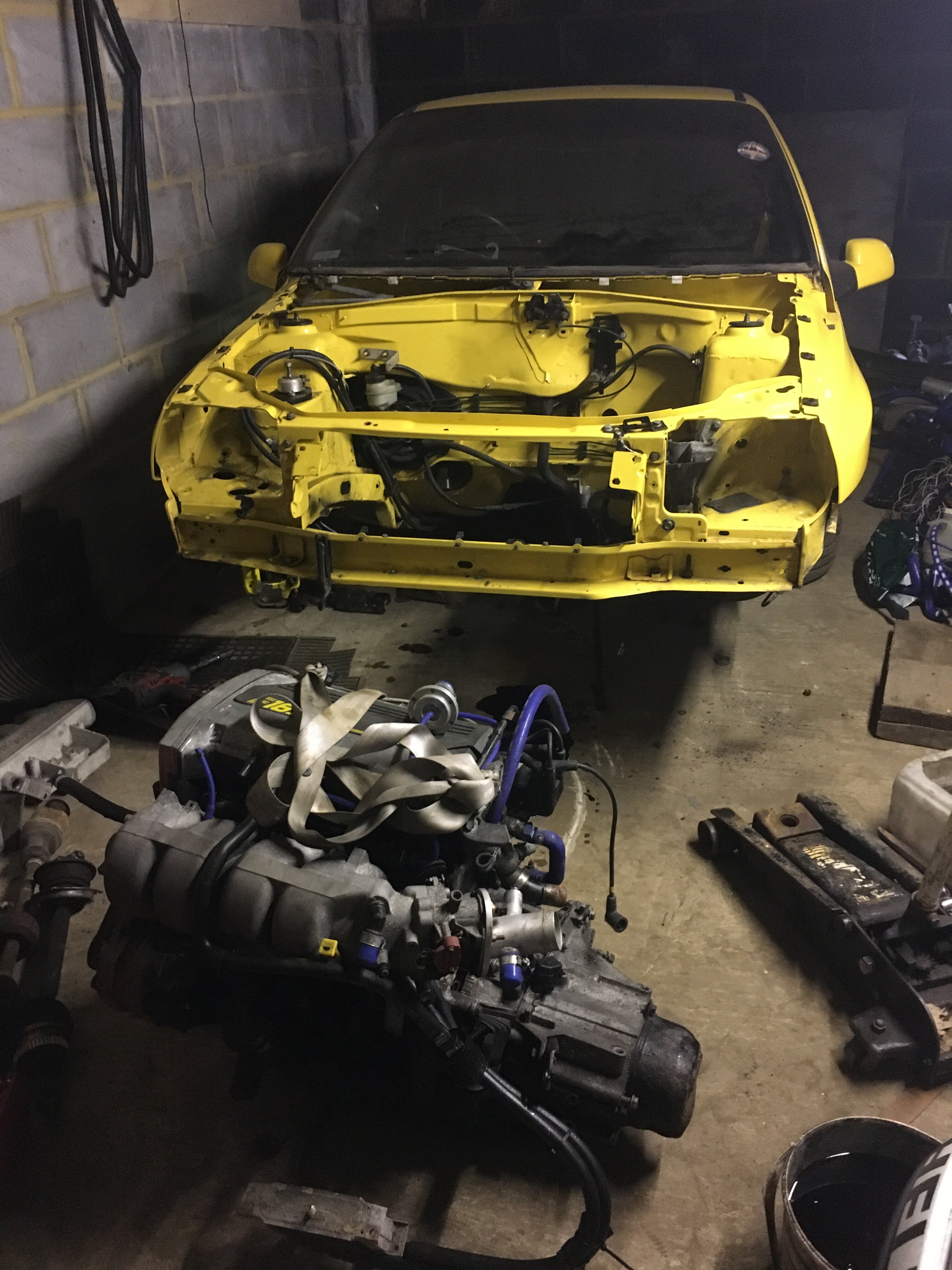

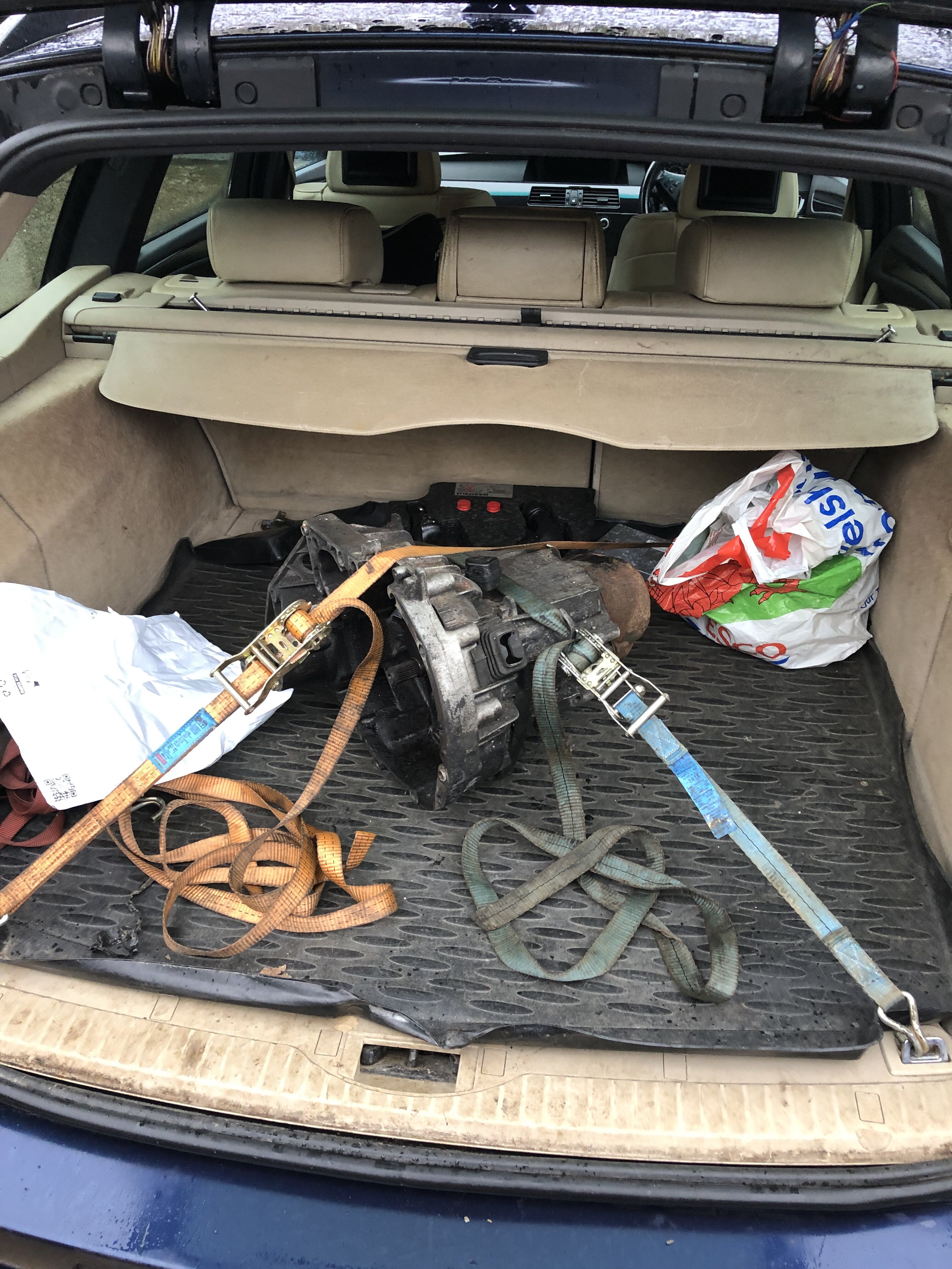

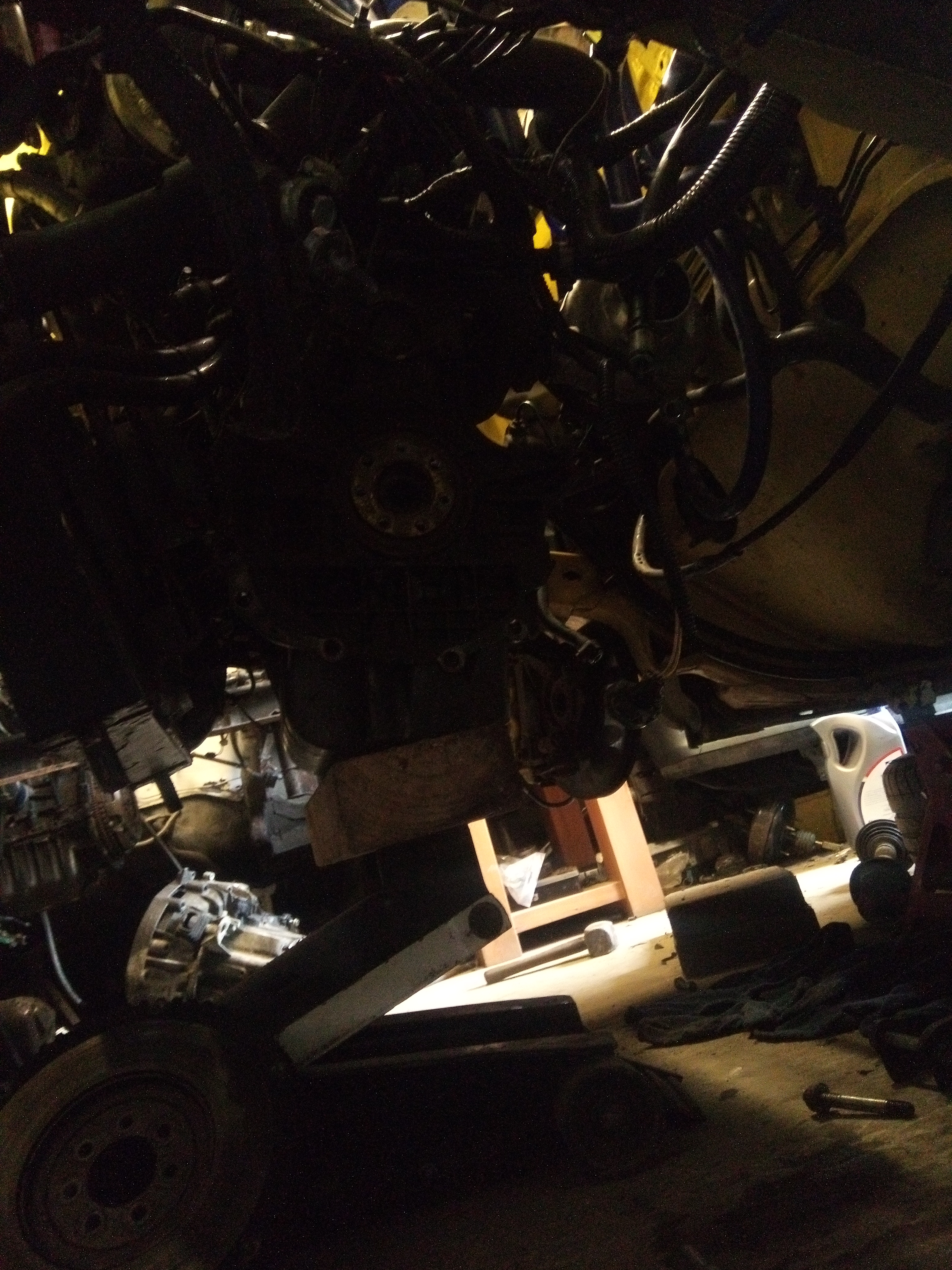

After removing the turbo I started the process of removing the engine something it pains me to do but it needs a replacement gearbox and a cambelt so makes sense also it will make the removal of the god awful power steering much easier.
I’m hoping to get this running and driving by the end of the month ready for a map at efi so I can use it again as much as possible before I go travelling again

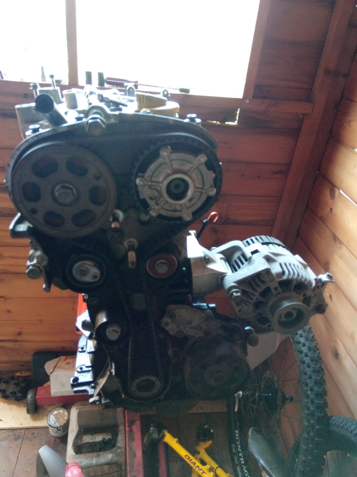

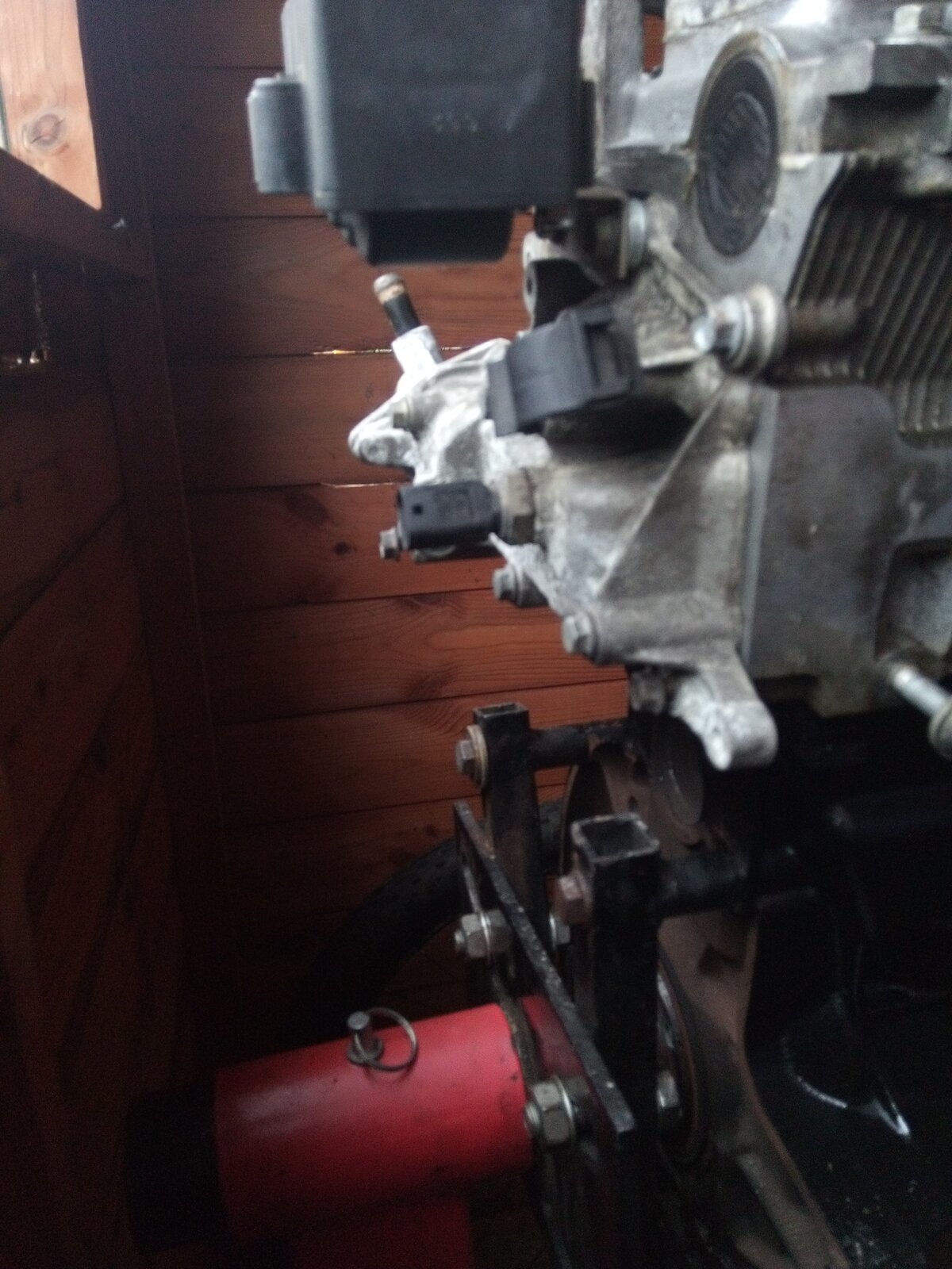

So the engine is out

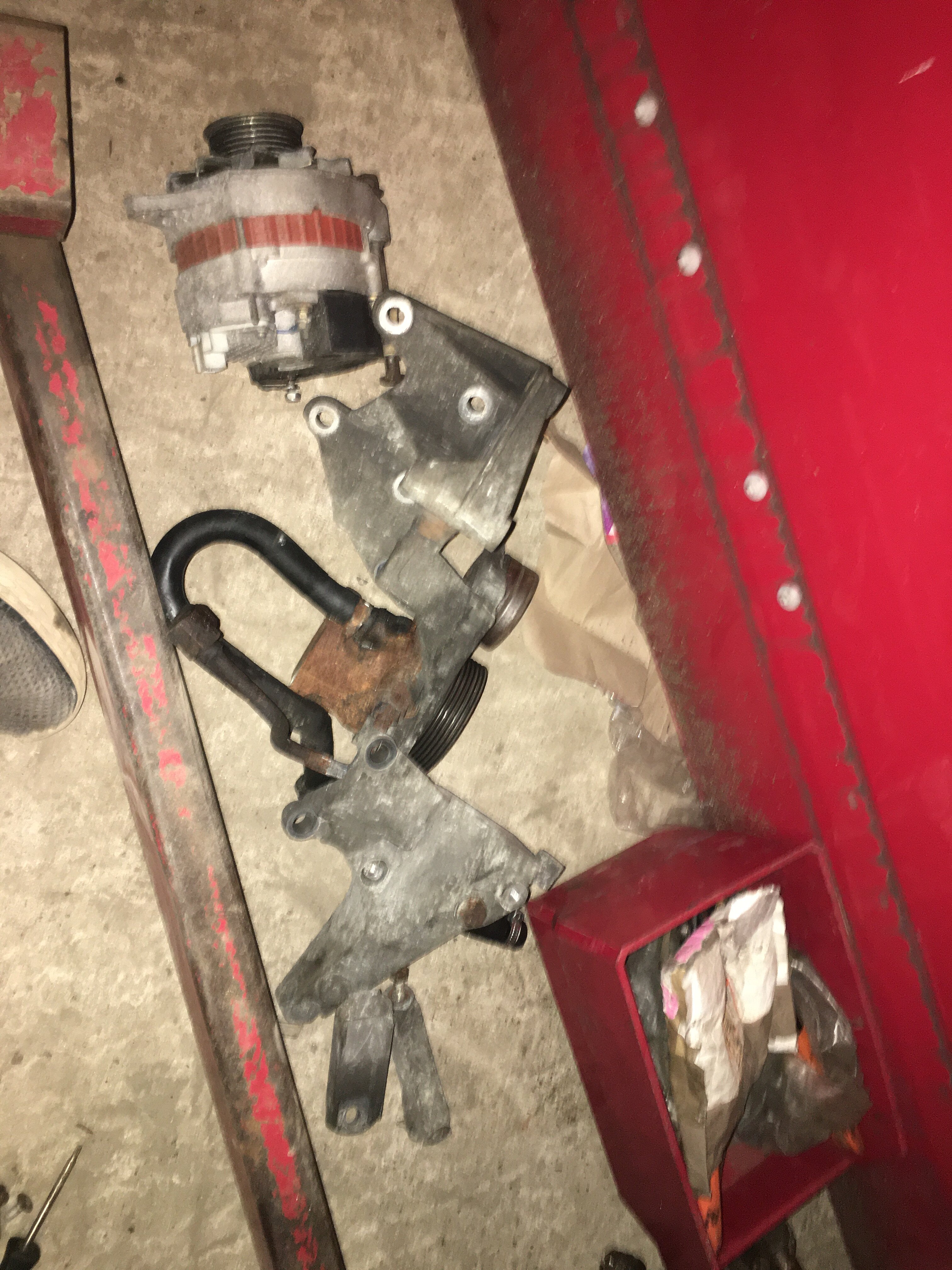

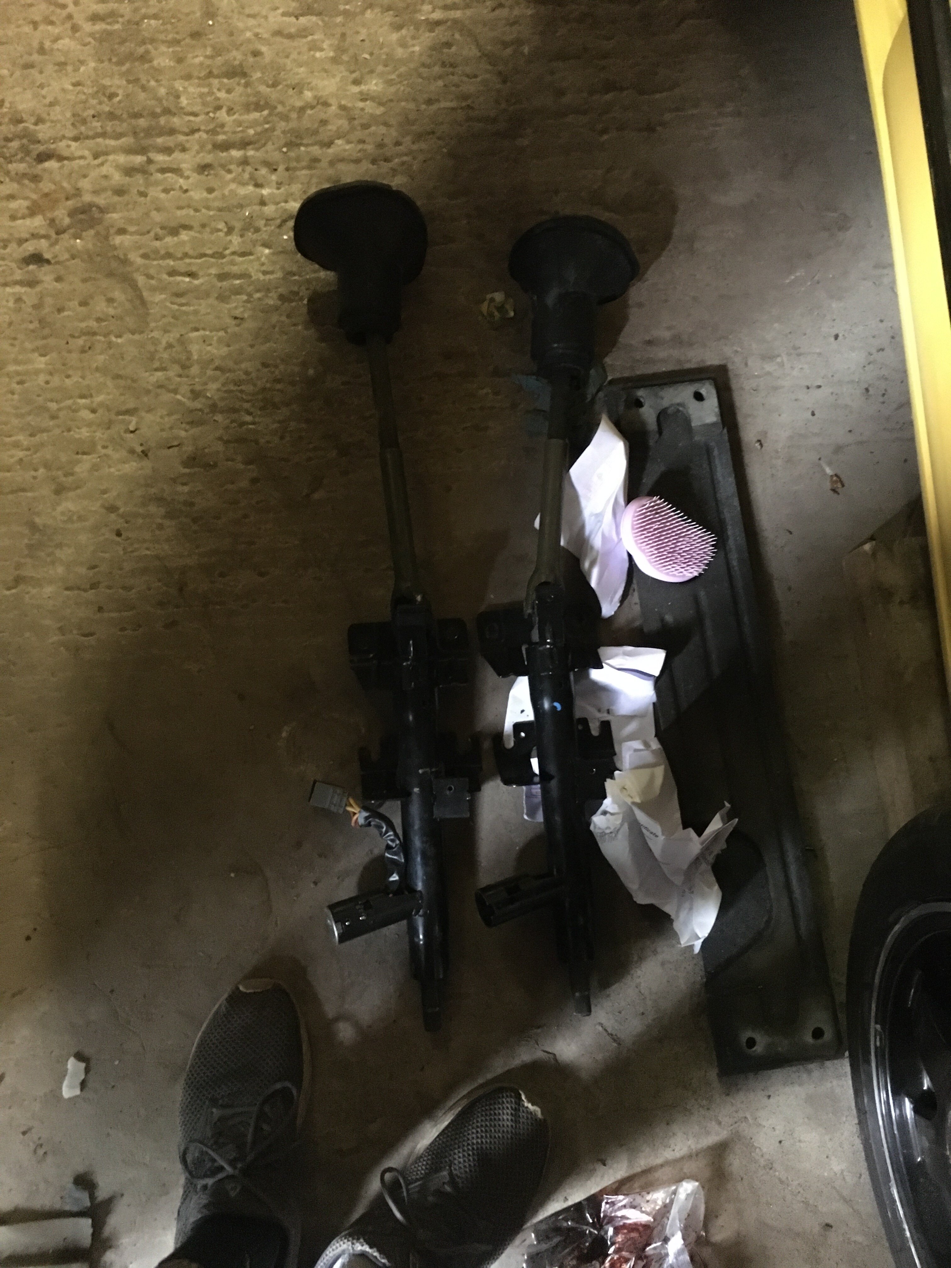

I then set about removing the power steering I’m replacing it with Volvo mountings no idea why I even fitted the power steering to be honest
Then I removed the old box and fitted a new box I’m hoping this box should at least last the rest of the year before I can afford the box I want

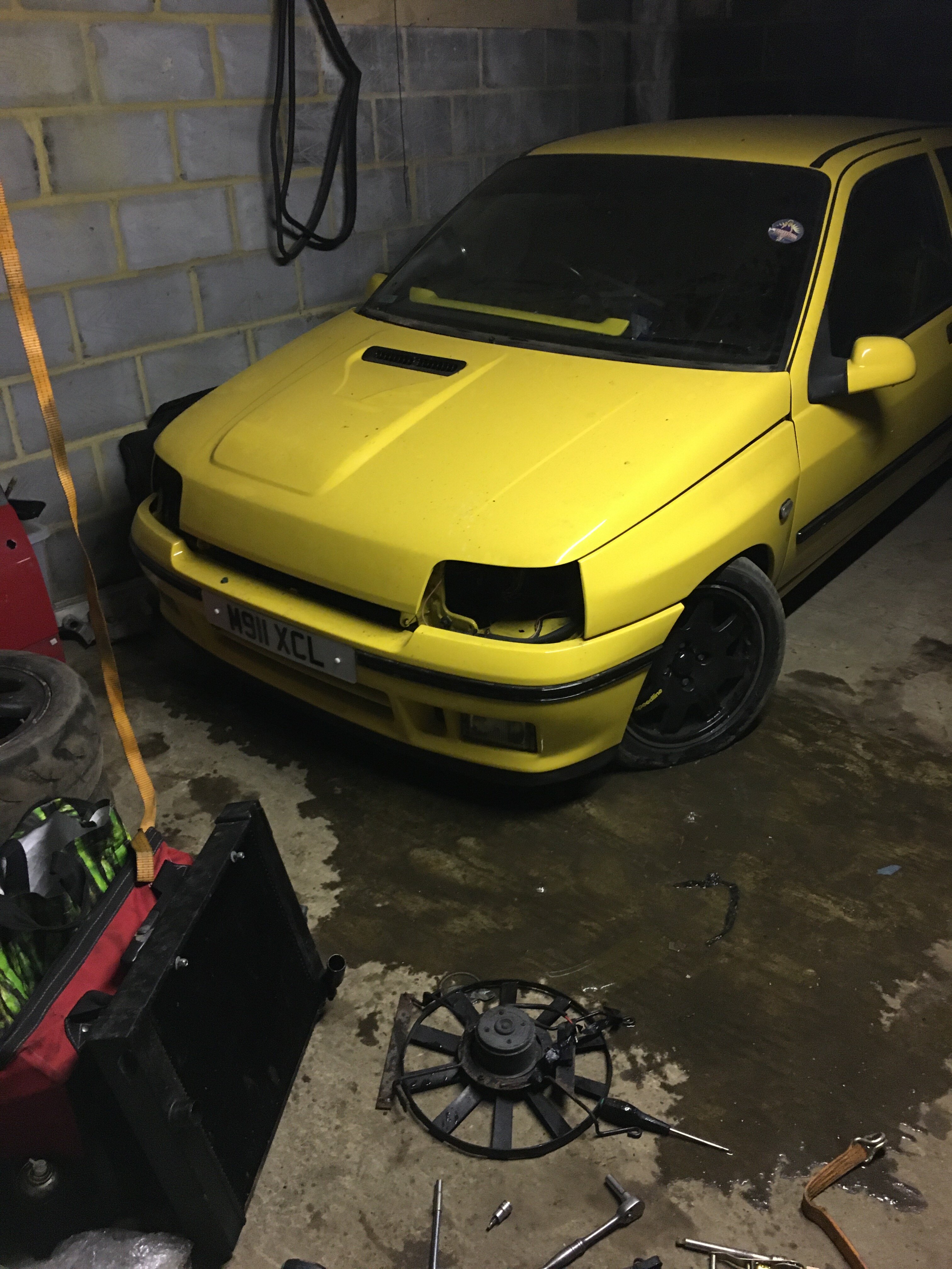

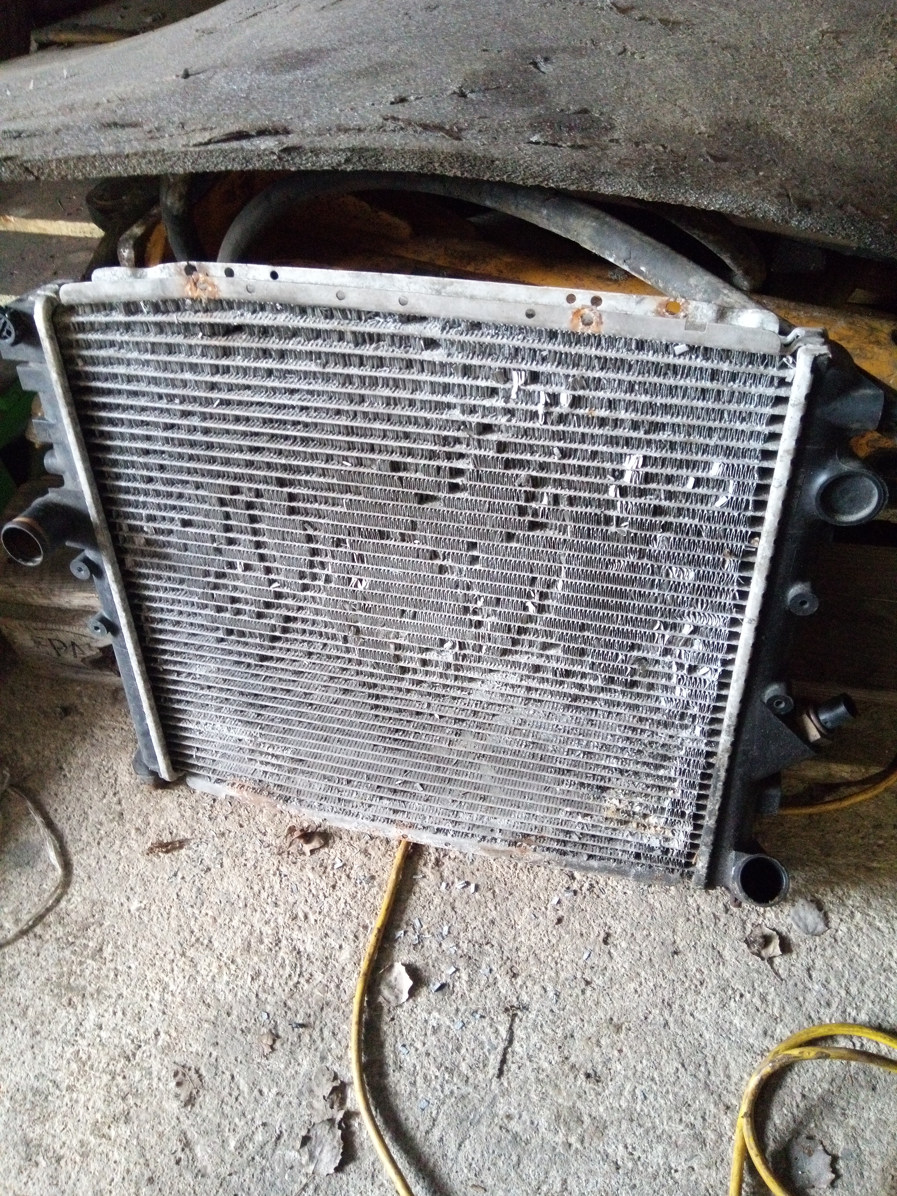

We’ll mapping didn’t go that well after suspected fueling issues the car won’t idle or map properly but we reached the limit of the charge cooler witch is about 280bhp 16 psi
I thought is was injectors so replaced them and no change I’m going to try a fuel pressure regulator next and see what that does
Seen as I’ve been blessed with time now it’ll be getting a intercooler too

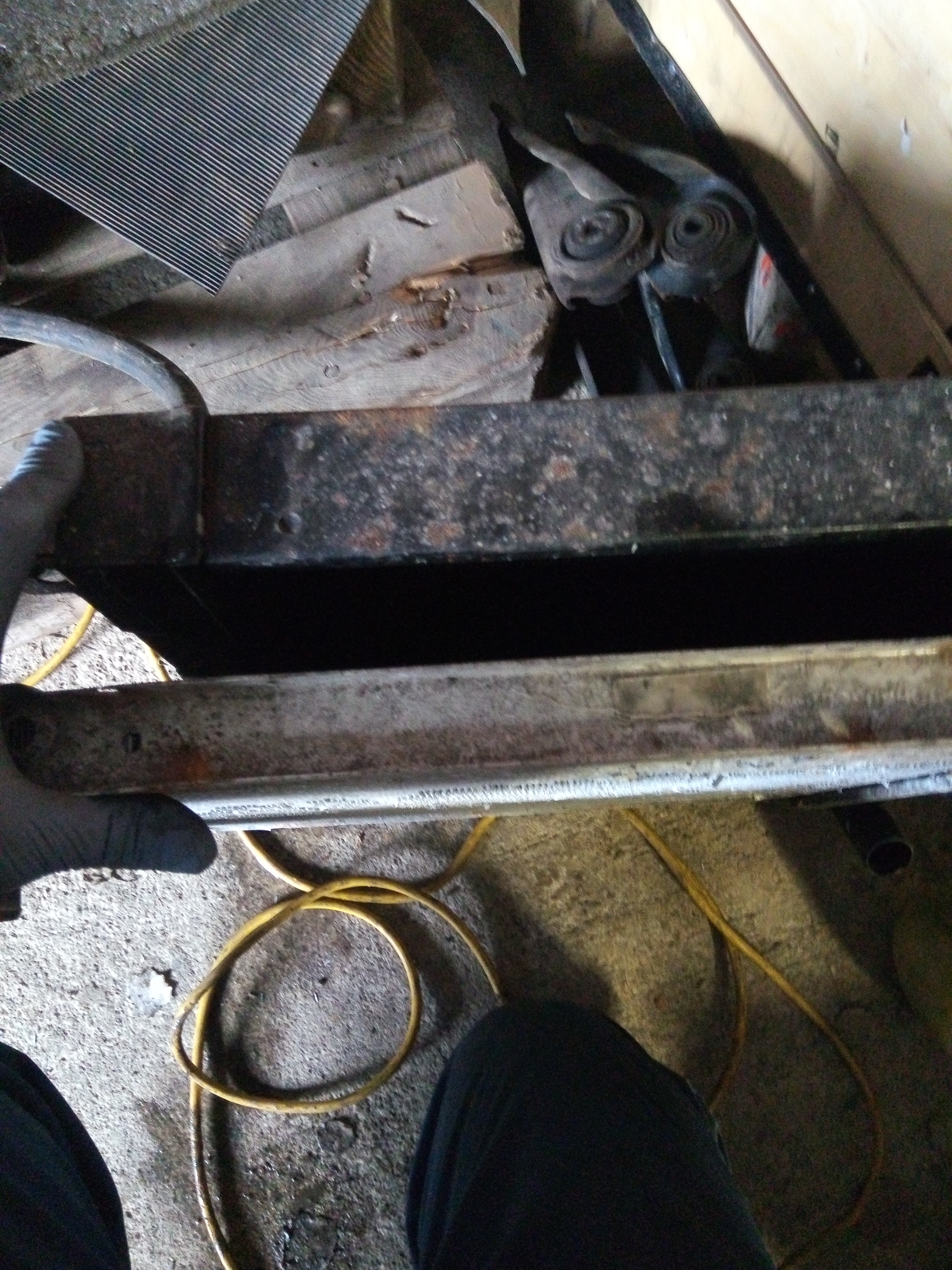

You do right getting the chargecooler gone. It looks similar to pace r5gtt chargecooler core that was available years ago, didnt work well. Stick a ching spec bar and plate intercooler on they perform great, at a 1/4 of the cost of a branded cooler.
@Brigsy it is the same pace charge cooler, BBPT spec setup this same as mine was. I never had flow issues with the cooler and the very short boost circuit was decent for response etc, however it just didn't cool well enough for anything more than the occasional 1/4 mile squirt or dual carriageway blast. Soon as tried to track the car with that setup it fell apart
@Coops Mk1 Yep i thought it was the same core/cooler as can remember bb tuning re using the gtt bits on the f7r back in the day. Crap really the cores used to split, pumps fail etc.
As said I never had a single issue with mine other than overall efficiency wasn't up to the job on track
