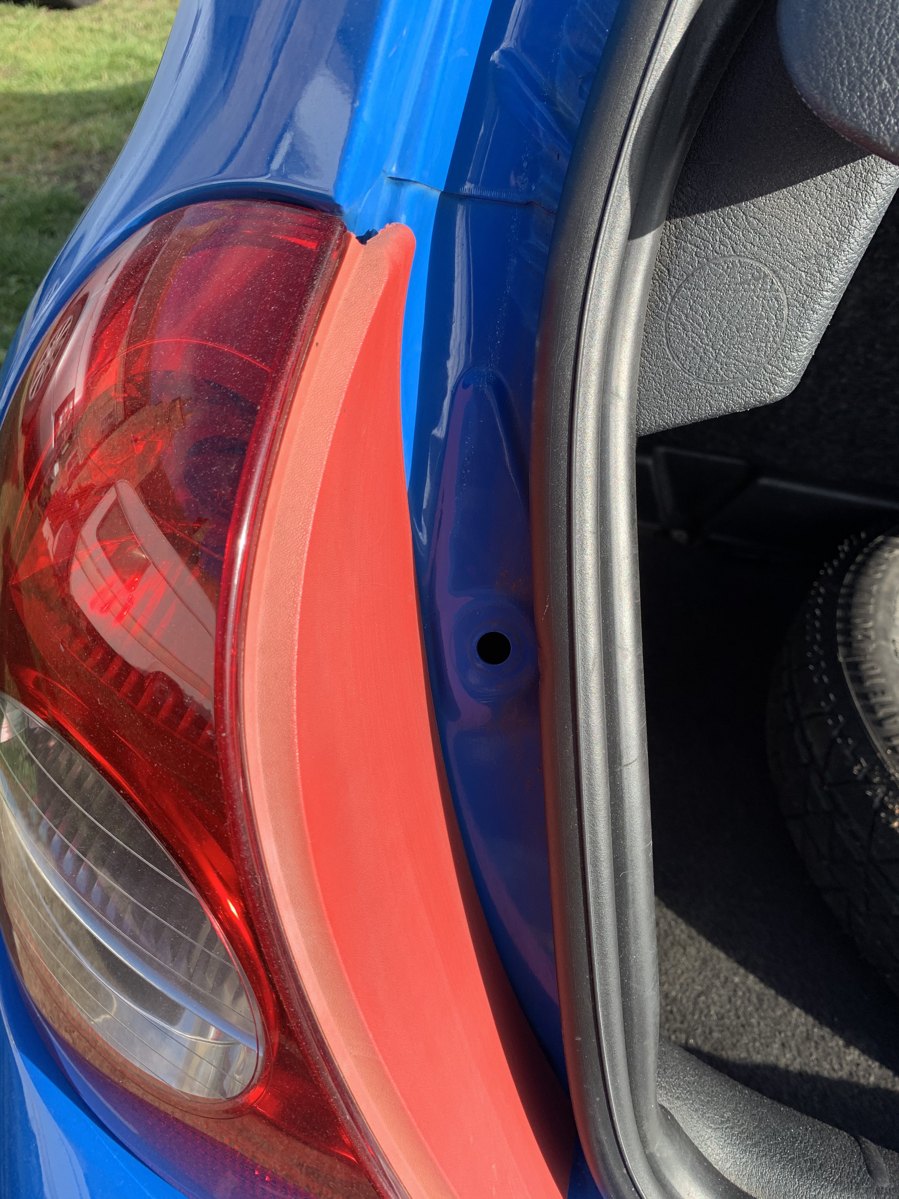

Does anyone know a part number or where I can buy boot grommets as shown for my 182? Just bought the car and one's missing, not ideal when I don't have a garage!

You'll be able to get them from renault, but I'd just measure the hole size and buy a pair of universals on ebay and replace both sides. Seal them in with tiger seal as they're prone to leaking and youll be grand

Sounds good to me, will I sound like a complete spacker calling them boot grommets or will they know what I mean?

I'd advise against the standard grommets as they tend to leak. I replaced mine with nylon bolts so there is no chance of it ever leaking again
I did see that in your thread but I'm not a fan of how they look. I've not had any leaks on my Arctic with some sealant around the originals. I'll probably just buy a set before my car becomes a swimming pool this week with how the weather is looking.

I can't remember which thread I read yesterday but someone replaced them with Renault ones. Pretty sure they were something like £3.
