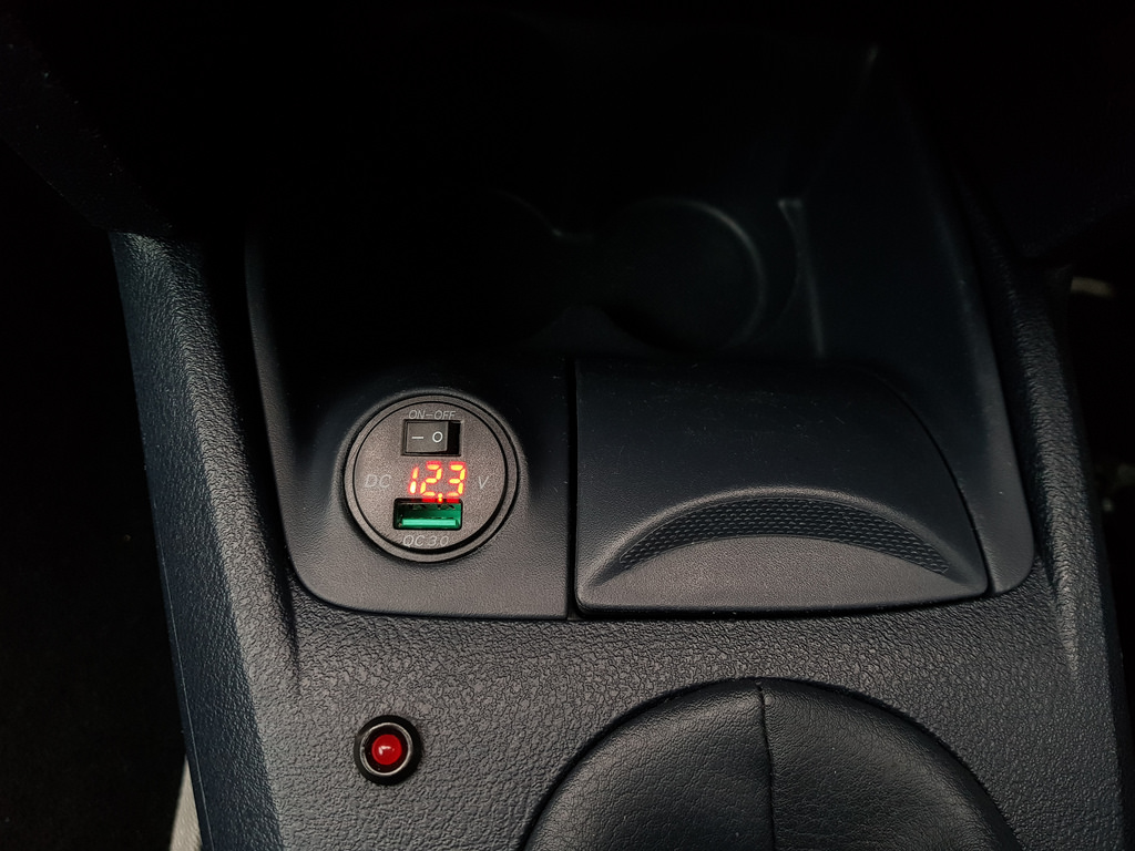

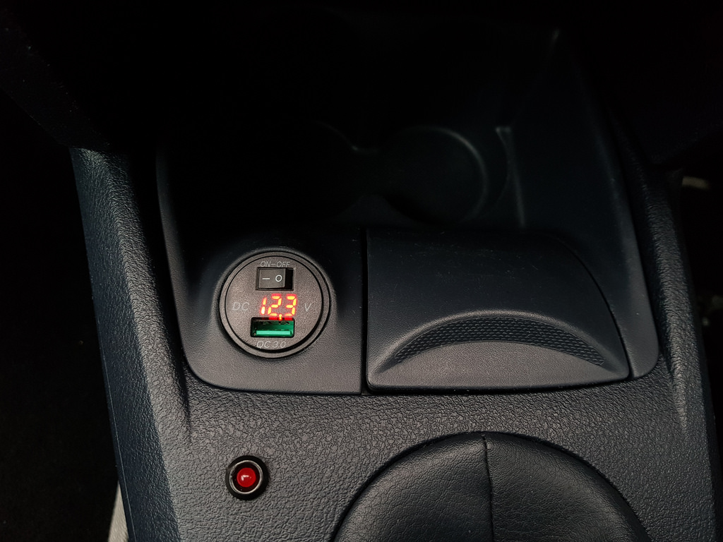

Installed this today. Had to file it a lot to fit. Quite happy with how it turned out though
I don't use them. It distracts me more trying to use them than just pressing the buttons on the head unit, which are right by my left hand on the gear lever anyway and I can see them.

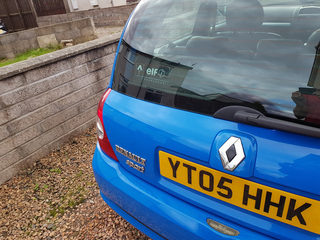

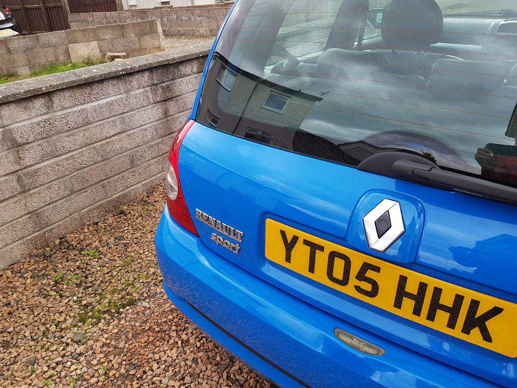

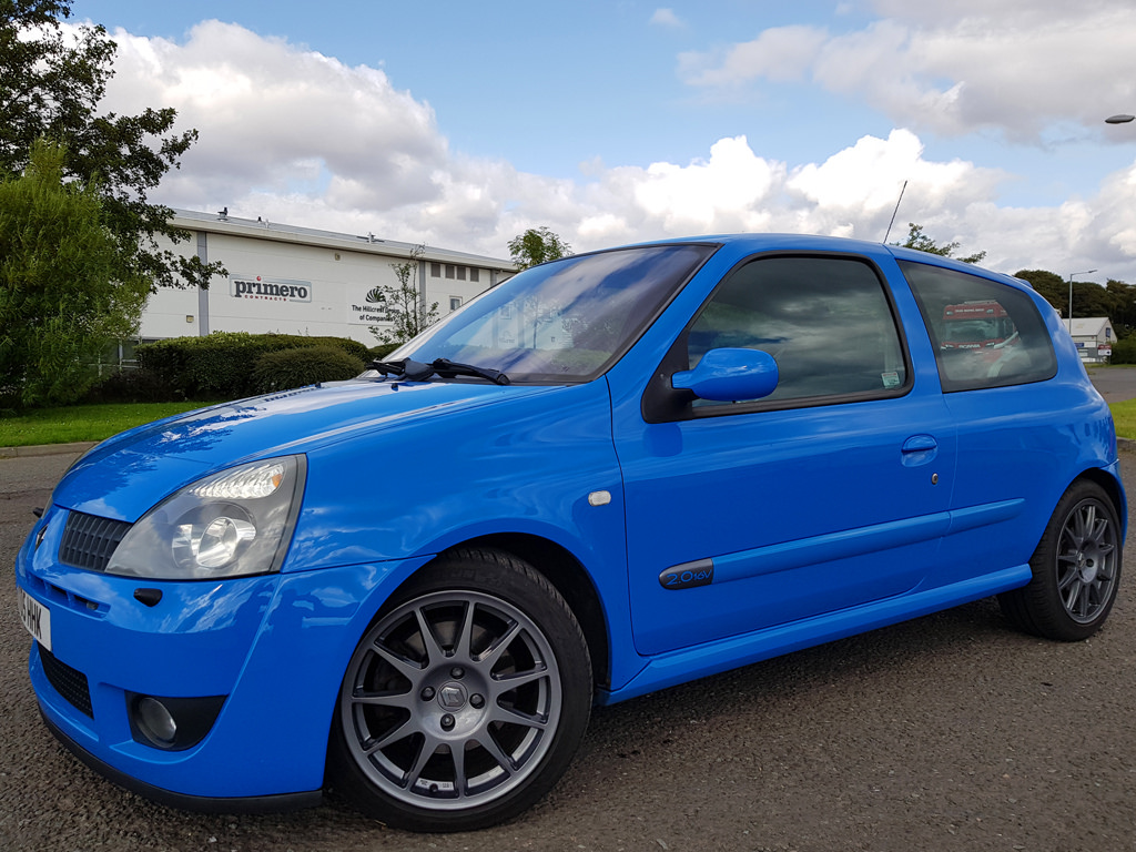

De-stickered the windows
And fitted silver visions

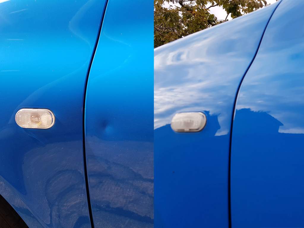

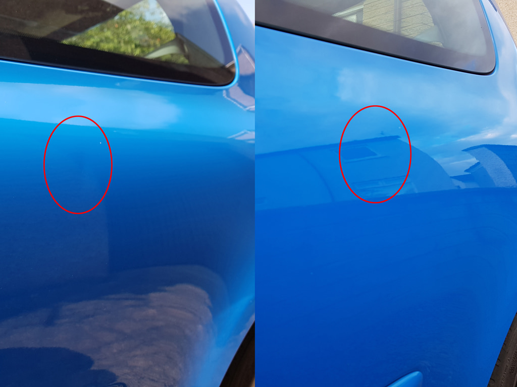

I've booked the car in next week to get all the minor dents in the doors and one in the roof sorted. There is damage on the drivers door from an egg that I don't know what to do about
It's funny sometimes how we are all different, i'd have f'ing loved to have had those original stickers in mine and you've ripped yours out!! I had to buy the Renault/Elf rear one but never got the sides lol!

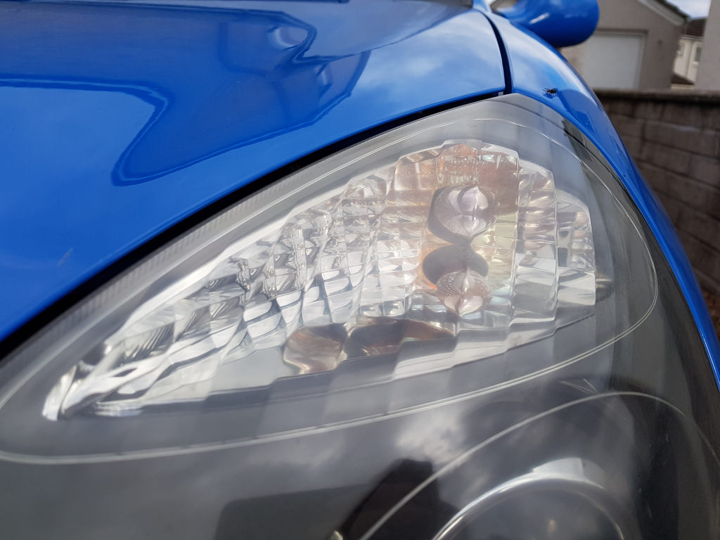

Next on the list of things to buy is a new number plate light, one side repeater which looks a bit cloudy and new carpets. But that will wait till after winter

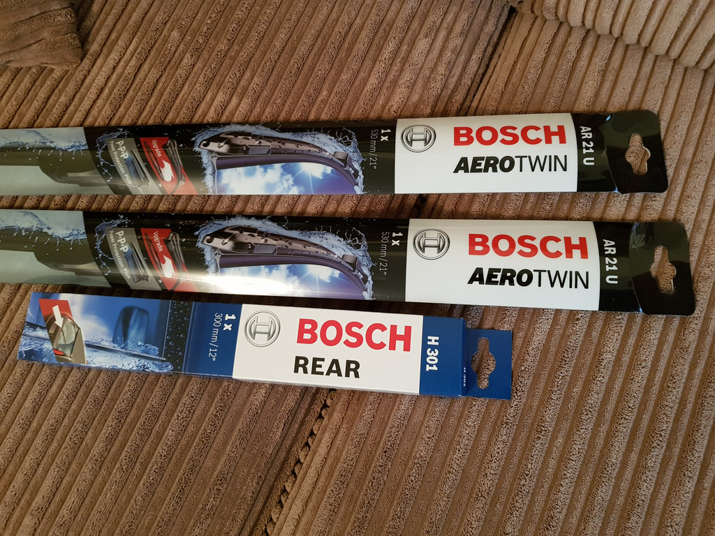

What you do think of the Bosch wipers? I bought a set and they do not clean the windscreen well at all
Djw John
Scotland - South
I've used Bosch aeroblades for years and never had an issue with them. Just bought Halfords ones cos it's barely doing 1000 miles a year and whilst I've no idea if they're good yet or not they're damn ugly!
They work fine for me in terms of cleaning. But the old set and this new set squeak a little when they first start to move and I have no idea why. I've had bosch ones before and they didn't do it ?

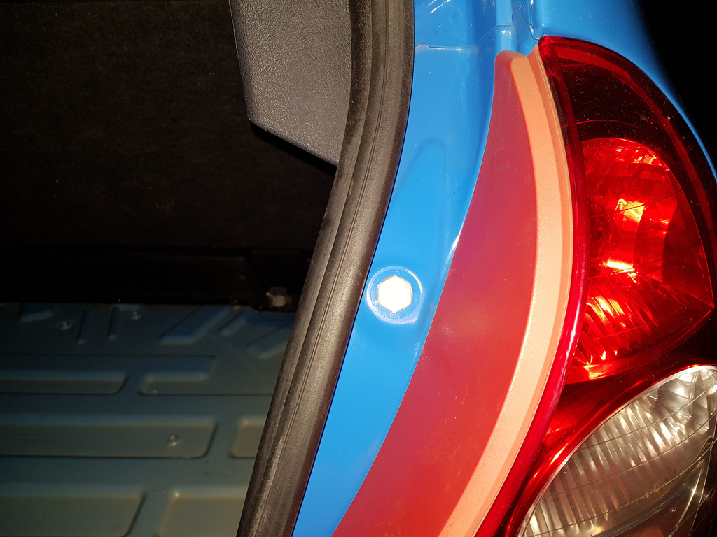

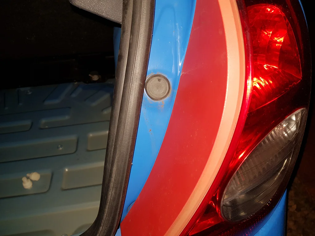

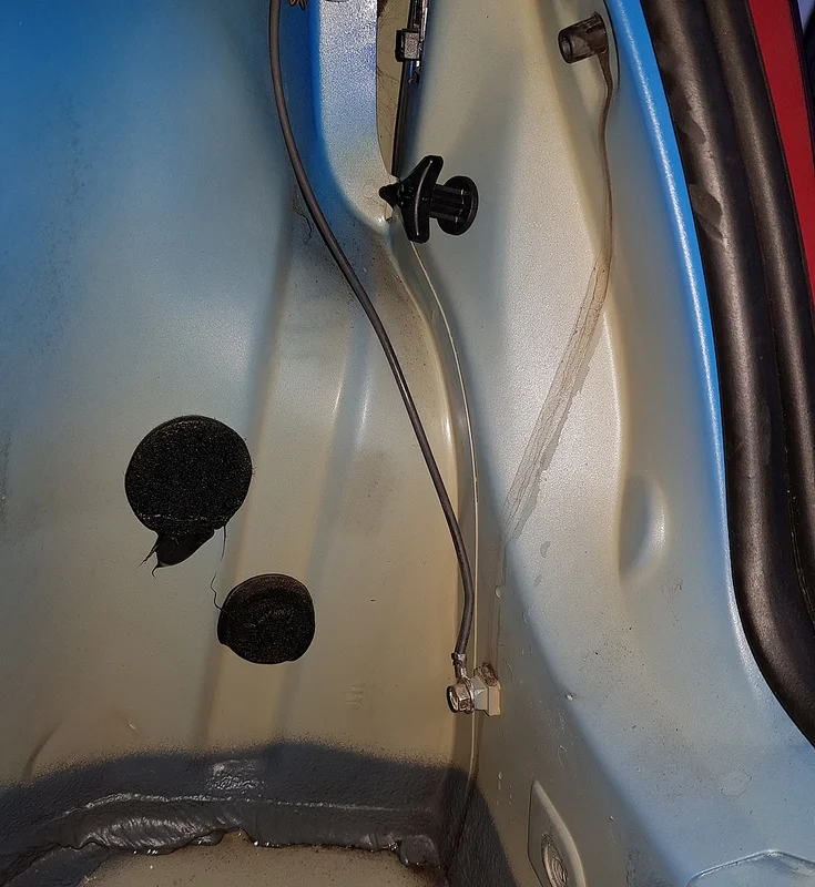

I gave the car a quick wash today, then as I went to prepare the boot for the new carpet found this on both sides. So I'm not totally to blame for the dampness.

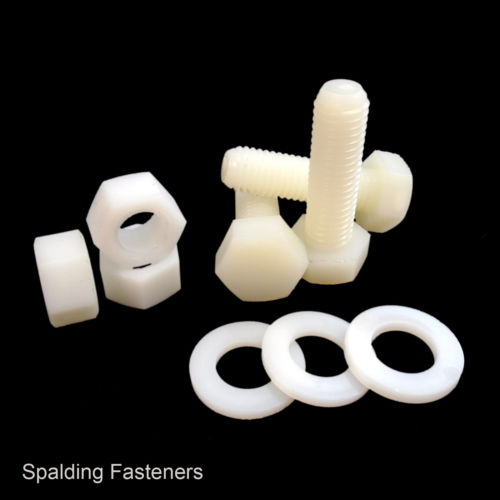

I've ordered some nylon nuts and bolts to replace the standard plug. So that should be that sorted ?
See the black plug at the top right of the pic with the water lines running down from it? It is basically just rattling around in there and doesn't seal the hole. There is a rubber bung on the boot that I think is supposed to press on the plug when it is closed, but maybe due to age everything has shrunk a little. Seems to be a common problem
Big_Steve_T
Aaaah... when you know what you’re looking for it makes perfect sense!! Thanks ?
I dunno but it's never going to be as water tight as this. Plus they actually damage the paintwork by rattling around and trapping water under them, as you can see from the ring around the bolt

Can you provide a link to the nylon washers?

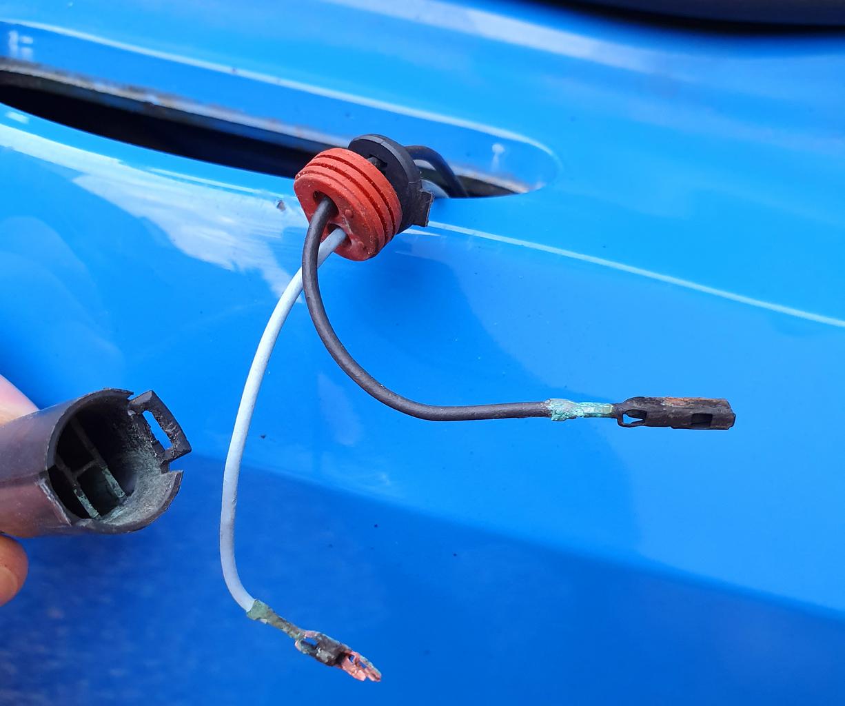

Nice easy job tonight. All you need is a screwdriver. Should take a couple of minutes. Nope, fucked it ?
One of the pins was corroded and stuck in the connector and snapped off when I disconnected it.
Where can I get a replacement connector?
On a positive note, the new one looks clean and pretty
